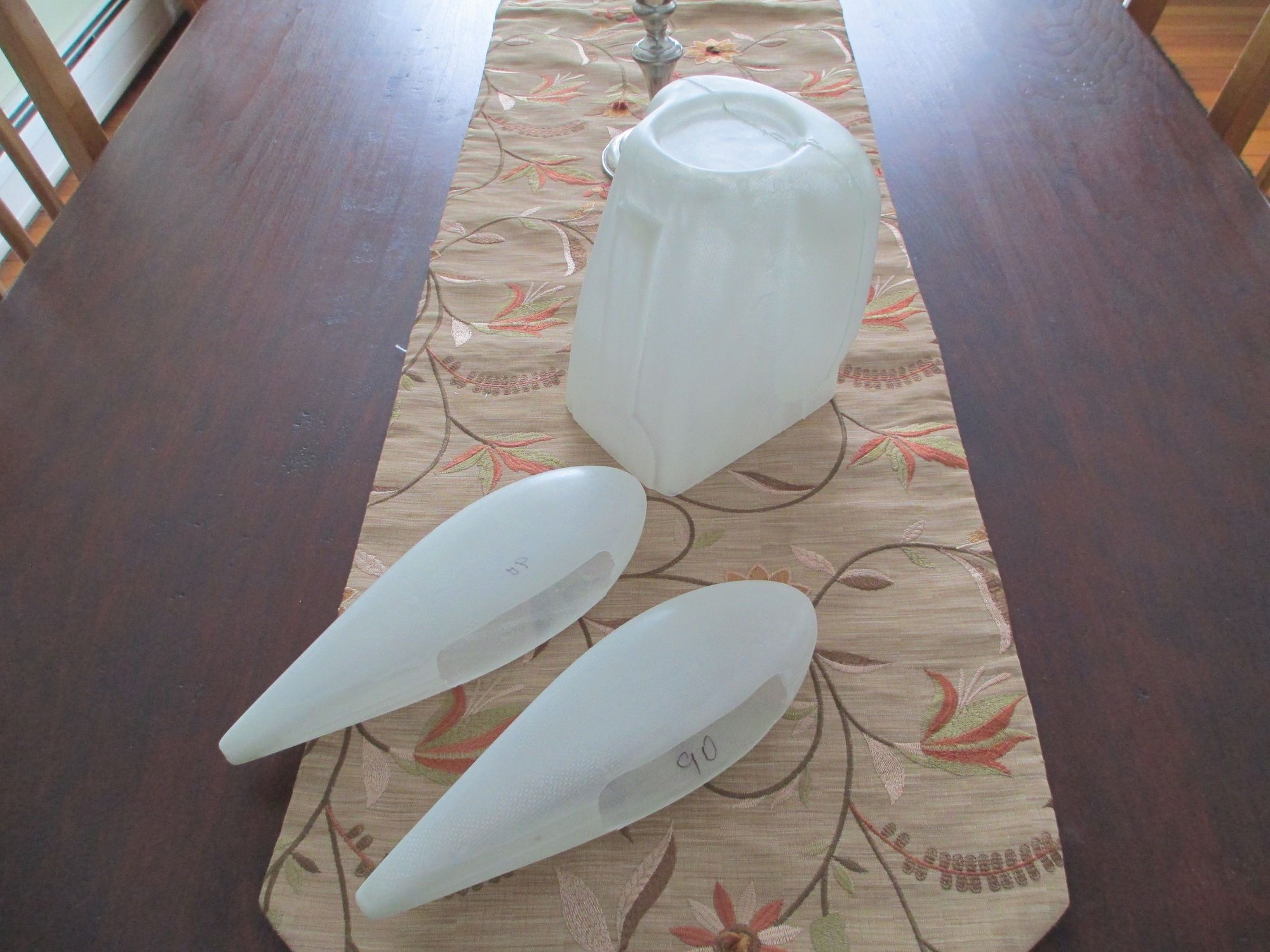

My fiberglass cowl and wheel pants arrived today! Great timing...
Wully (12-21-2021)
