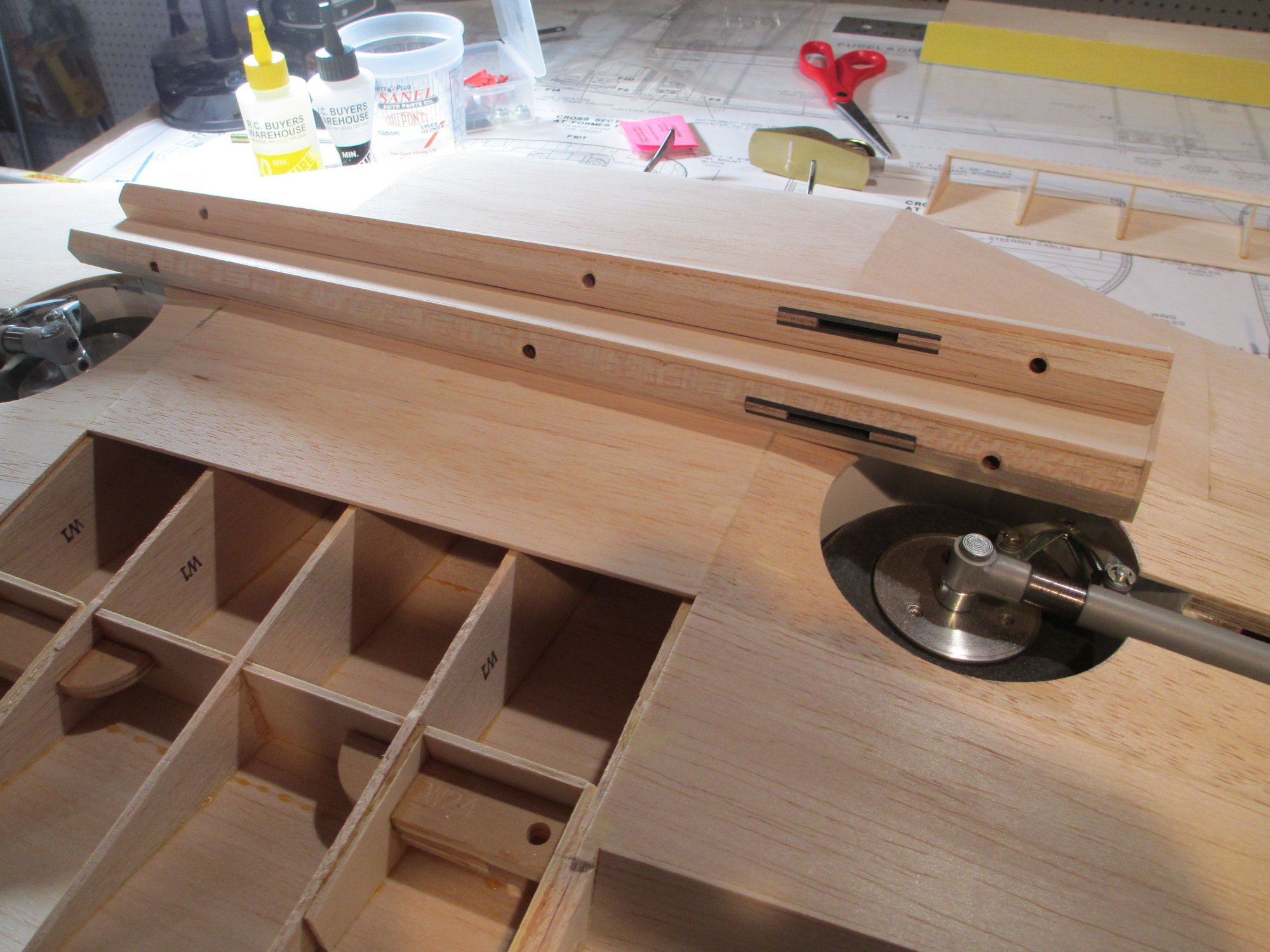

Builder's tip:
It just occurred to me that I had forgotten to mention a certain step while gluing in the remaining sheet of balsa on the aileron surface that I think you will find useful. As you know the top portion of the aileron was sheeted, but the bottom surface was left uncovered. After the hinge blocking was installed I spread Titebond glue on all of the rib surfaces in preparation of the bottom skin. I did not apply Titebond along the trailing edge of the aileron's sheeting, instead I used a thin bead of epoxy. Try this the next time you join the top and bottom TE on your aileron or flap and you will find that the epoxy will give you a very rigid edge that the Titebond glue won't be able to do.
#346
You may have been wondering how I was going to be able to install/remove the drive shaft ...note the hole directly in front of the servo hatch.
A picture is worth a thousand words...
The right aileron was cut free from the wing, the remaining hinge blocks were fitted and glued in place.
#349
Note that I drilled for my hinges before I beveled the leading edge. One side of the bevel done.
You can see my scribe line that guides me.
Hinge hole detail.
Hinge pin fully seated.
Finally, both ailerons are done. That was a bit of work!
Nice tight hinge line gap.
