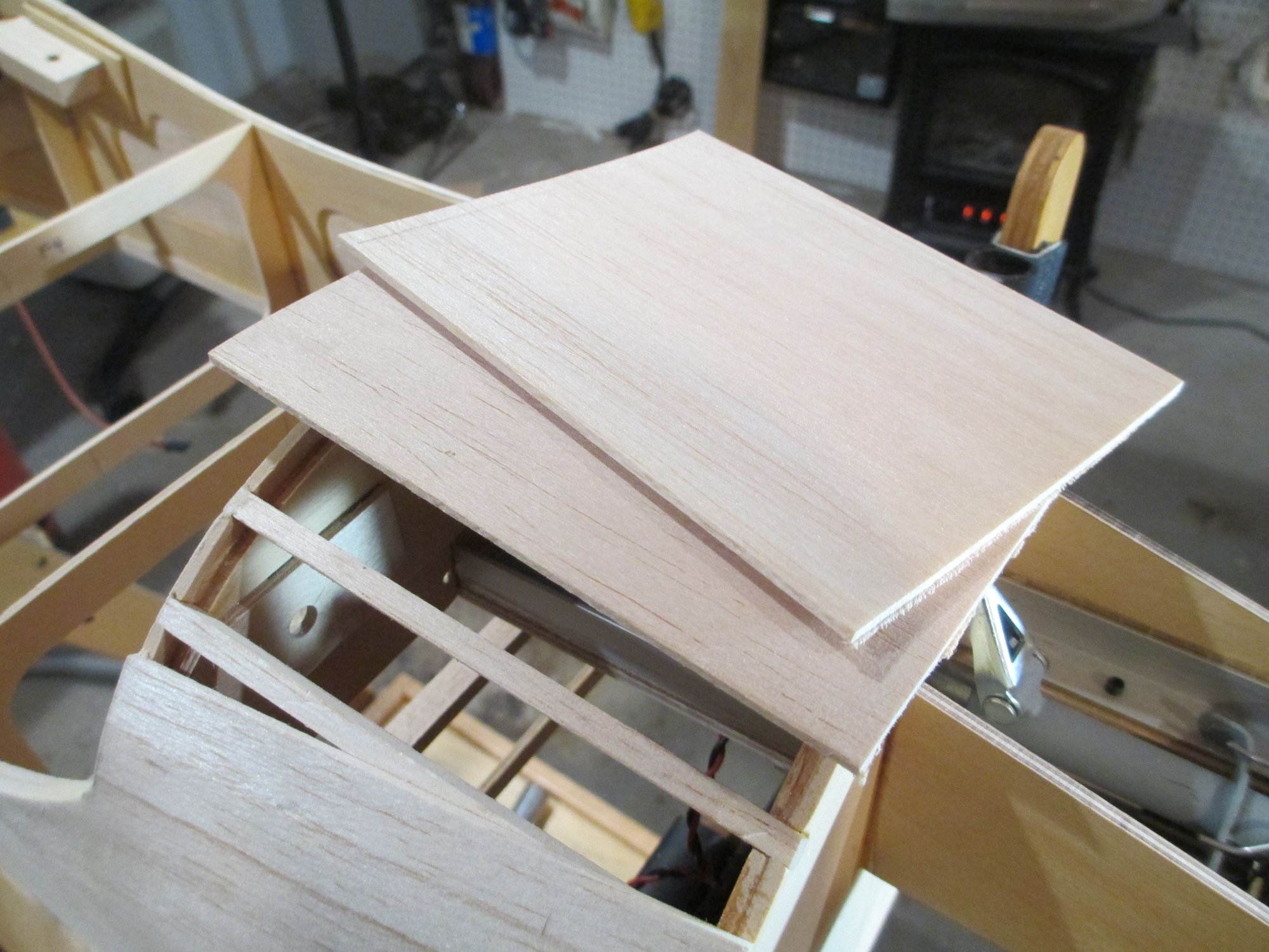

The plans indicated the area around the nose retract be built up with a series of small frameworks from leftover balsa that would support the sheeting around the nose wheel cutout. I however wanted to make it stronger and out of one piece...
Using left over balsa sheets, I decided to make a lamination. Laminated lumber is always stronger than one solid piece. I used the fuselage's framework as the form to clamp to, duplicating the exact curve of the fuse.
I used epoxy instead of glue for the laminations. I'm not afraid of the slight additional weight from the epoxy. The weight is where I want it...
End result, one solid 3/16" thick piece. Now it's time to cutout the wheel well for the nose wheel and strut.
