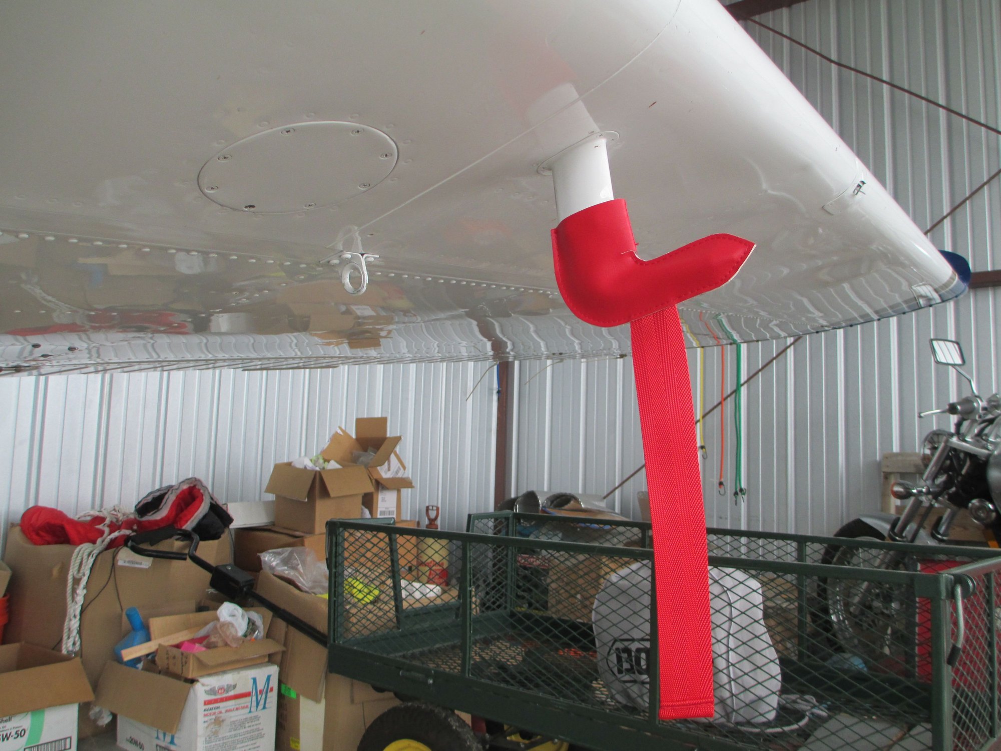

Now that there's a proper pitot tube, is it also going to get a pitot tube cover with a red "Remove Before Flight" ribbon?... and maybe cowl plugs?... and wheel chocks?... and... LOL
But seriously, BEAUTIFUL!!!
Thank you Steve, funny you mention the red "Remove Before Flight" ribbon, as I am making one!
I've heard it said that great minds think alike. Apparently the same applies to maniacs who strive for authentic detailing in a model airplane! LOL

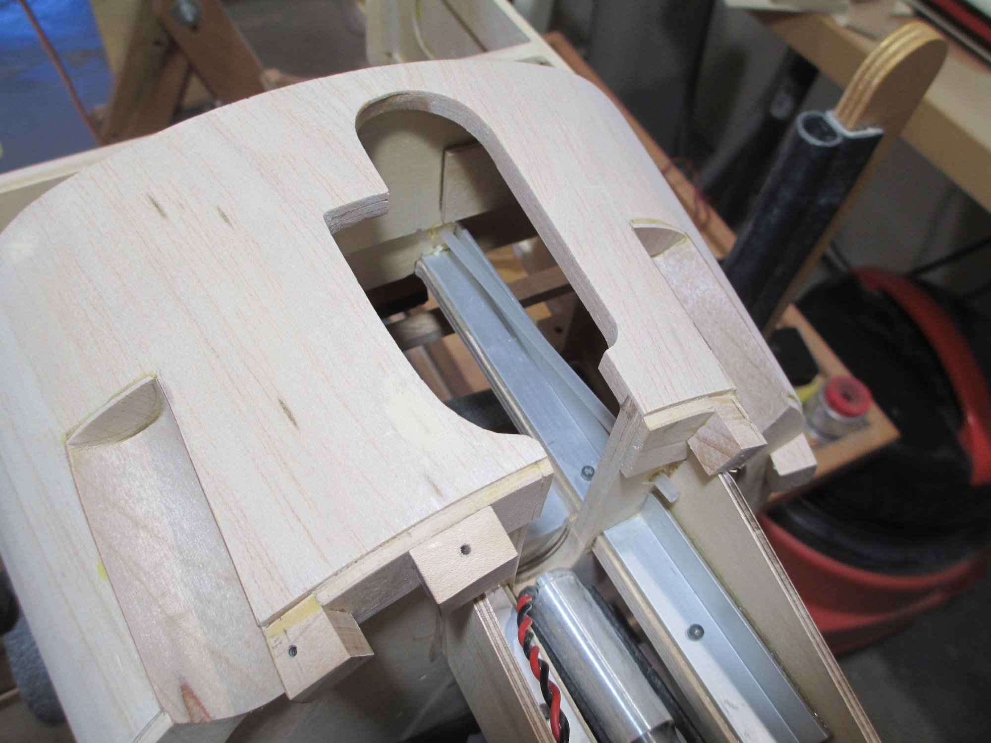

Now that I have the exhaust, I can ensure that the pipes will exit the fuselage in the exact position.

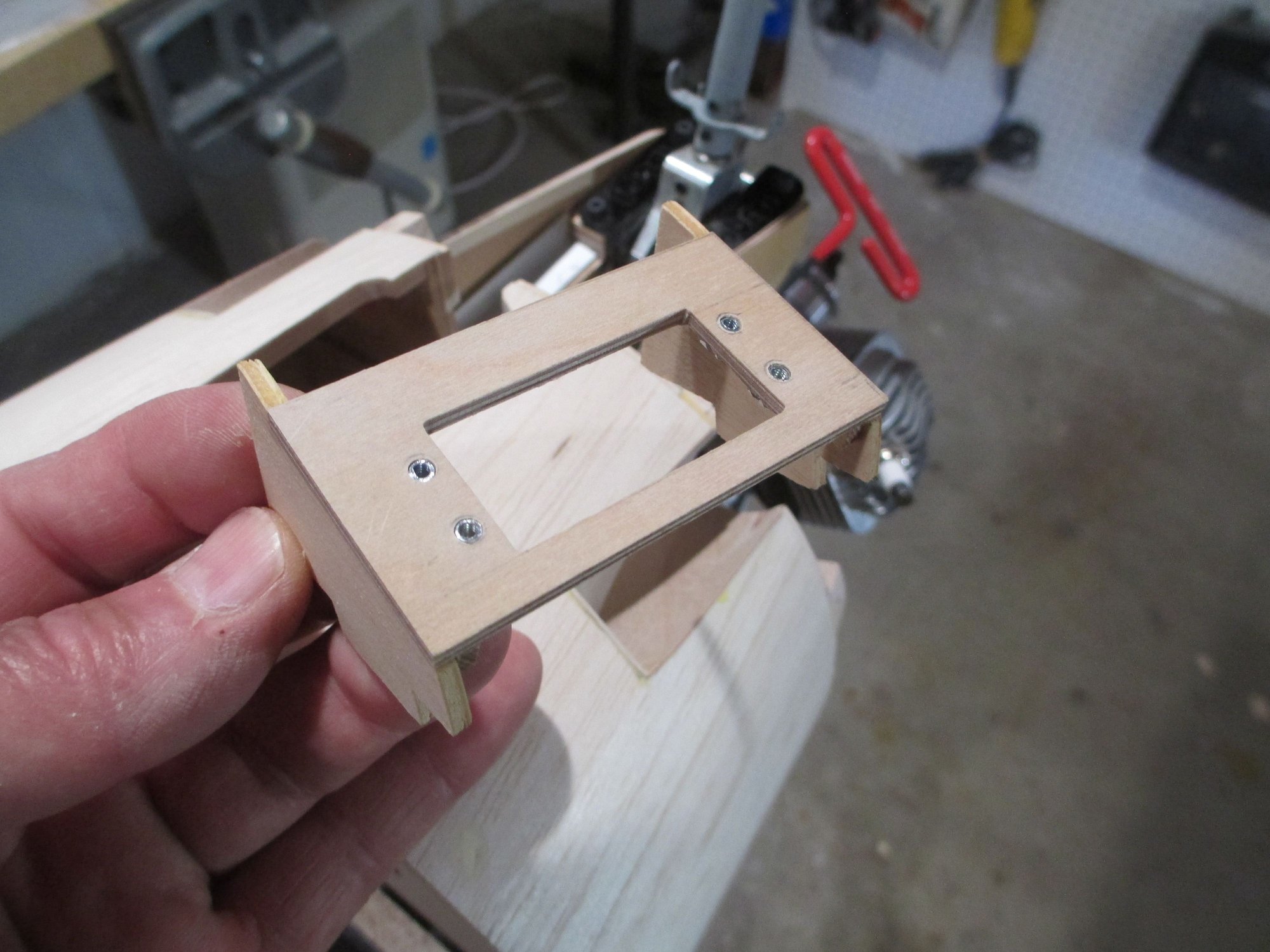

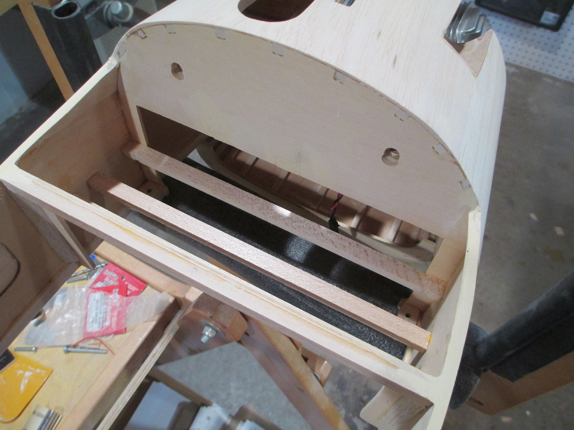

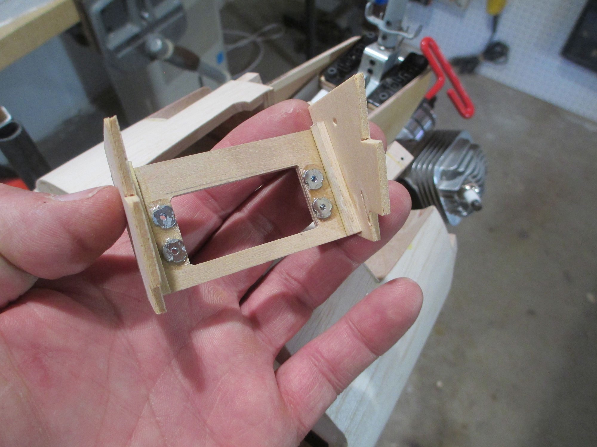

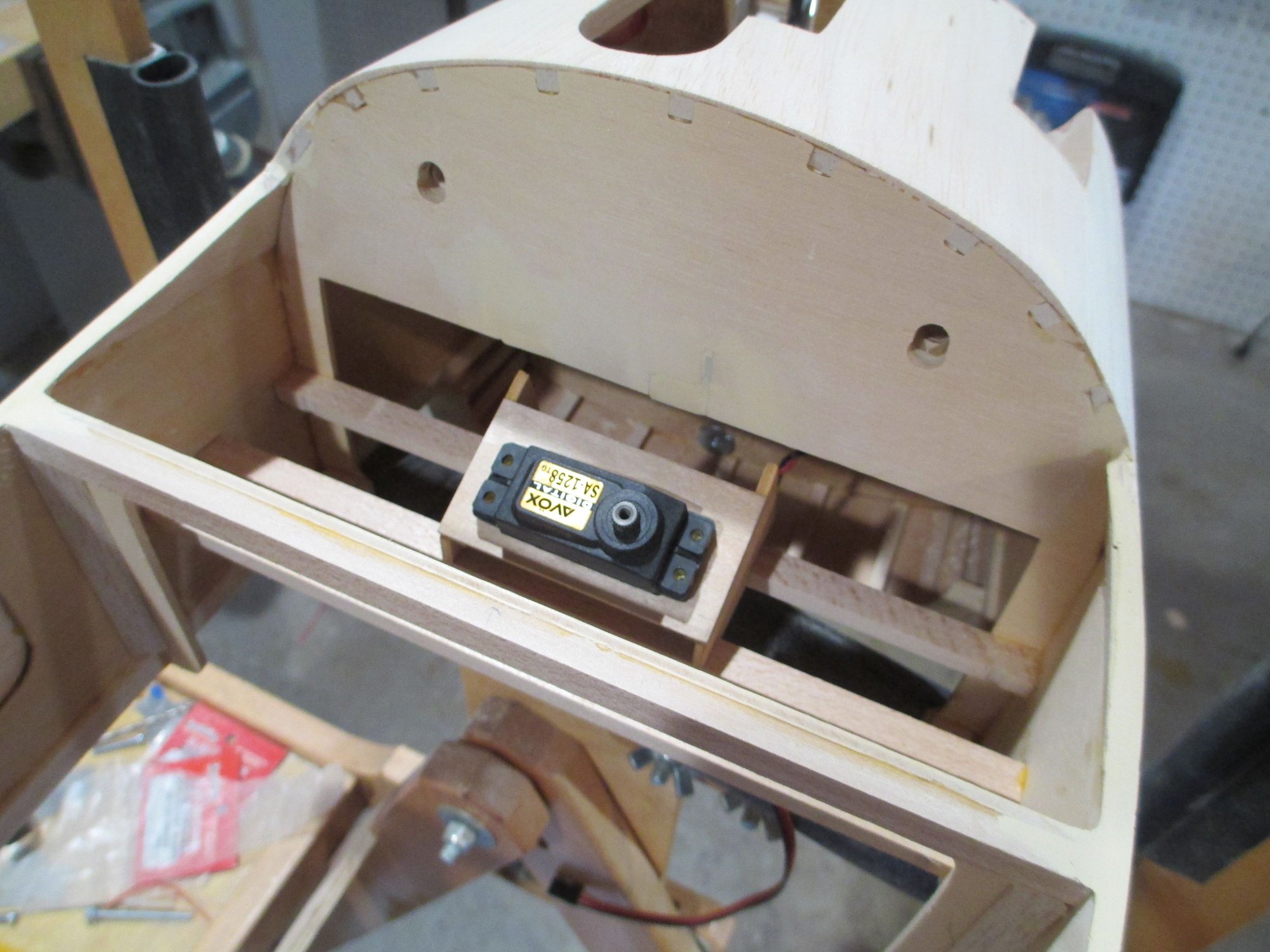

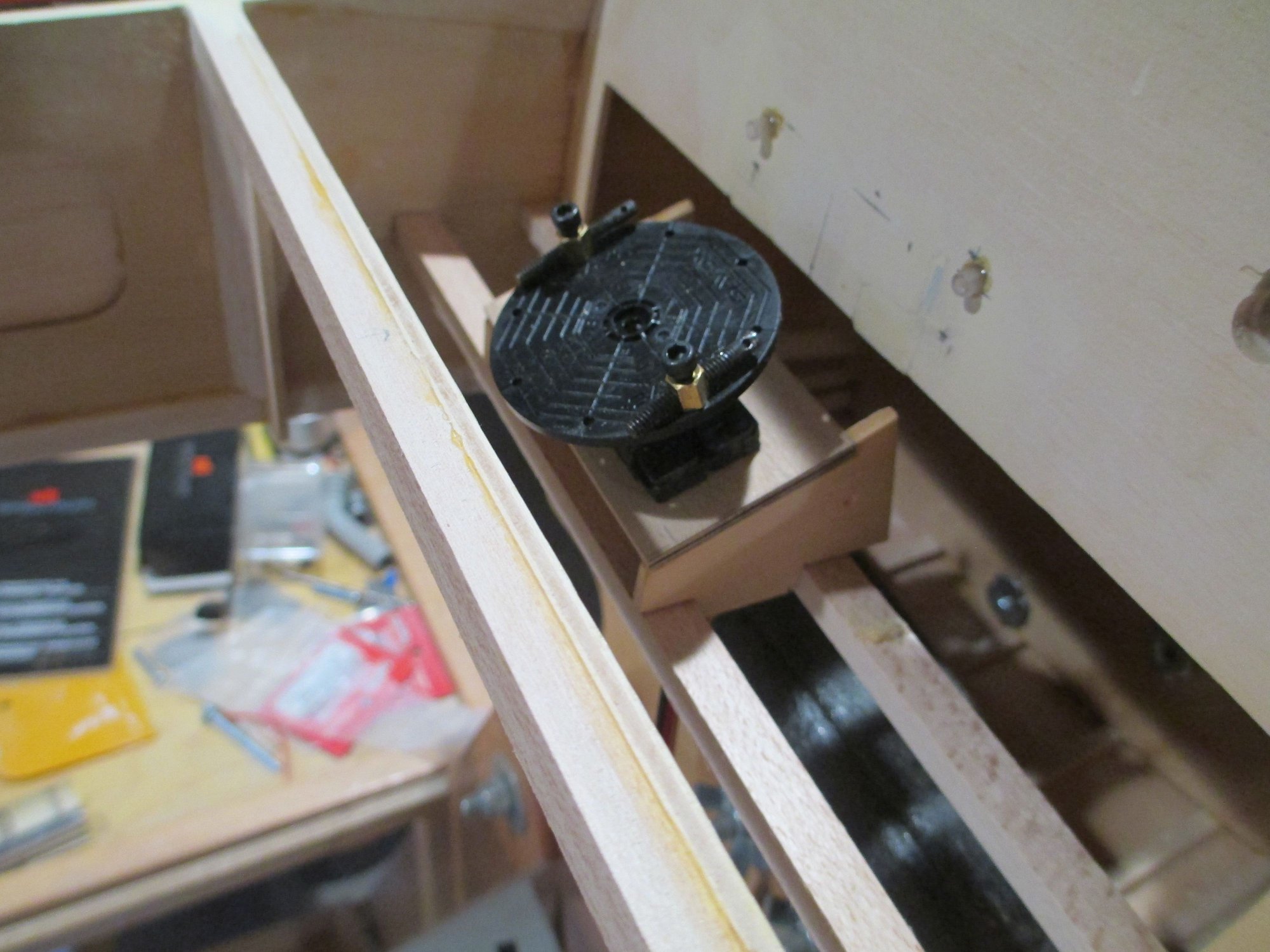

It's been such a long time since I've worked on the fuselage portion of this project that I had forgotten what and how I was planning on doing for the steerable nose wheel and throttle! The forward and aft servo rails are where both servos will be placed.
The nose steering pull-pull servo tray was fabricated. Like all of my other servos, my preferred method to secure it is using four 2-56 x 1/2" cap head bolts.
The back side of the servo tray. Note how all of the blind nuts have been epoxied in place. This tray will fit in between the forward and aft servo rails.
In place, the servo tray can slide on the rails until the exact location is found, at which point it will be epoxied in place.

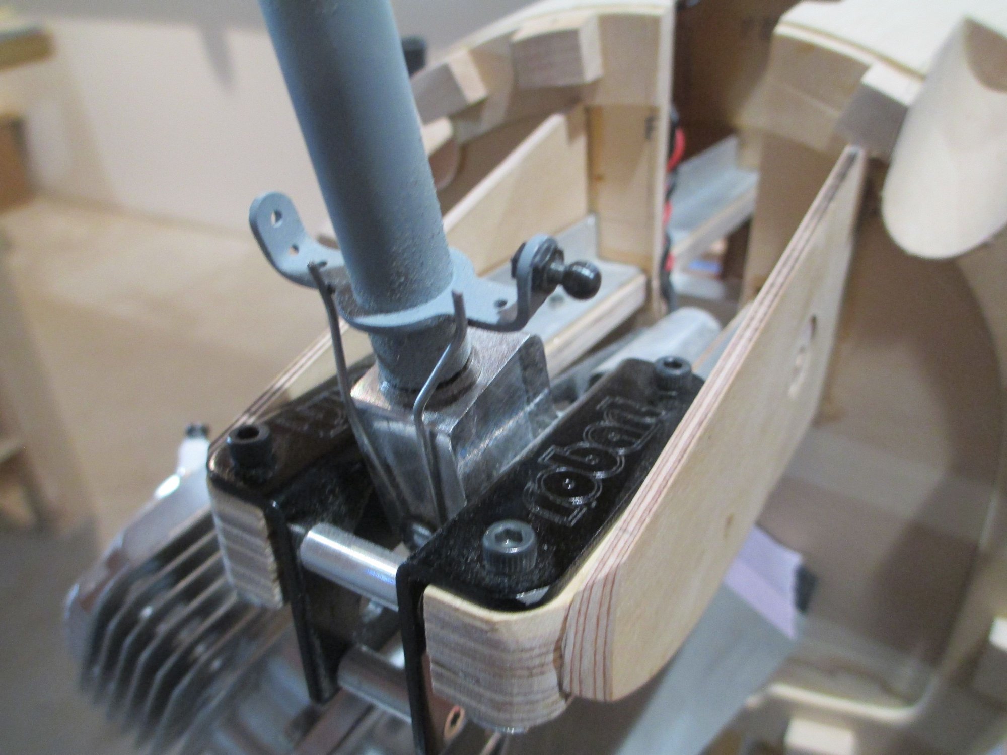

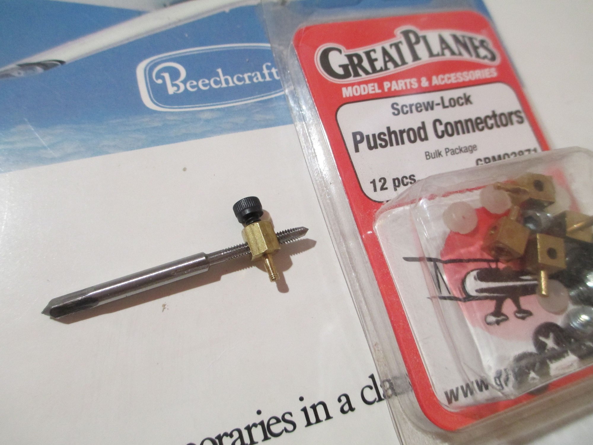

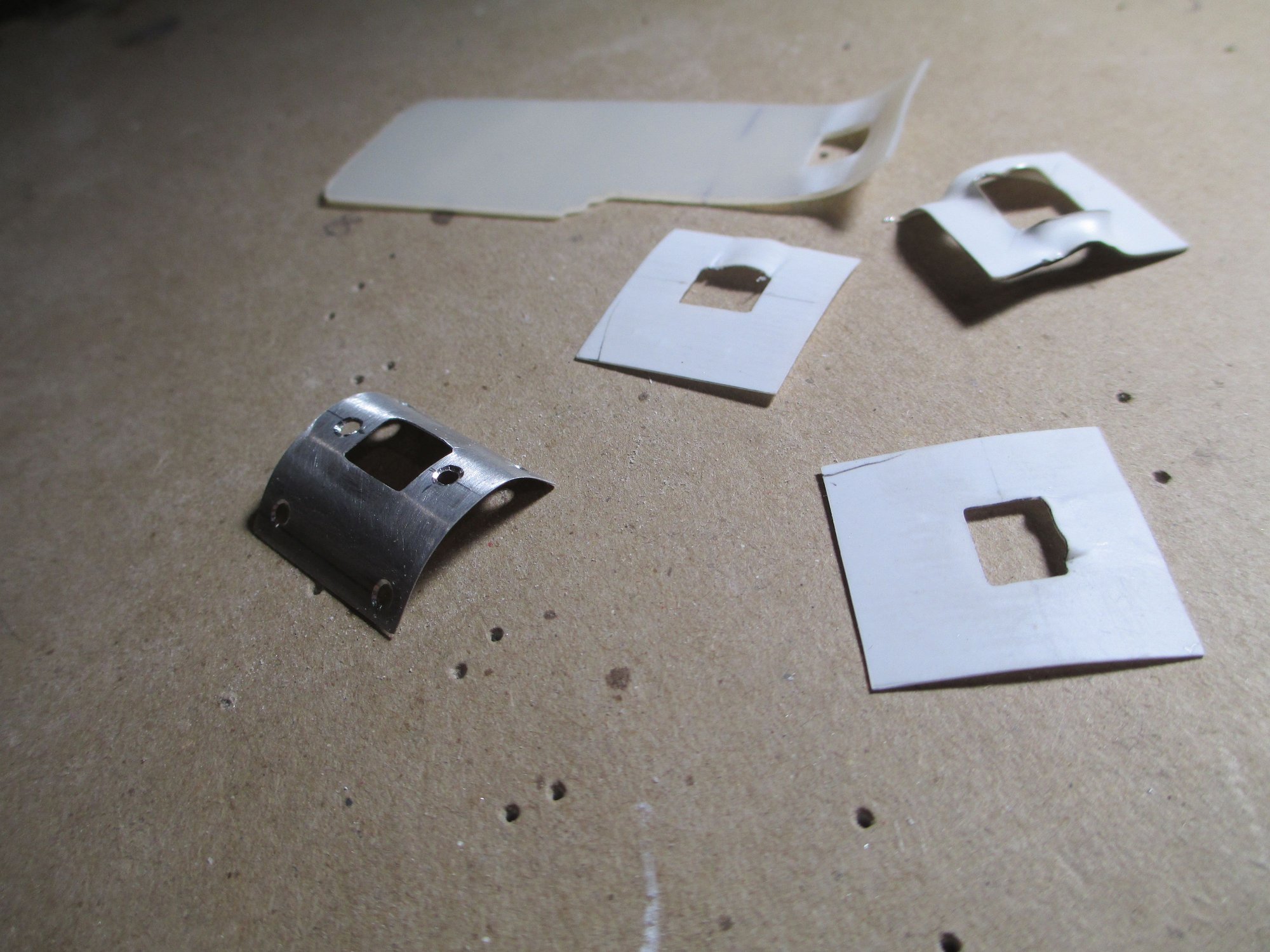

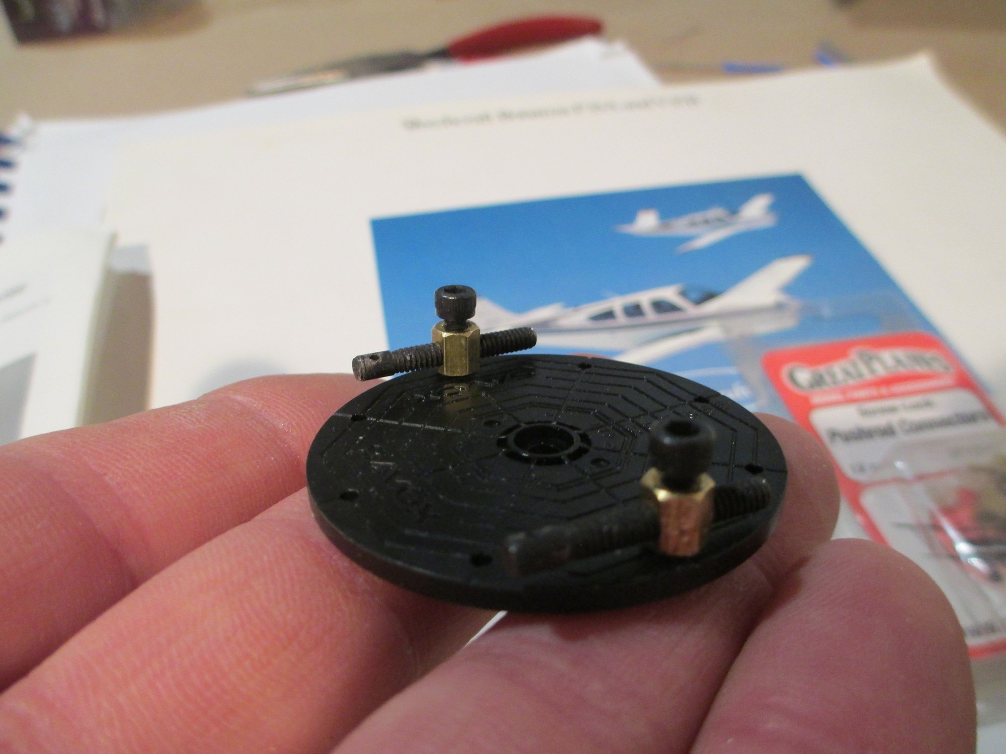

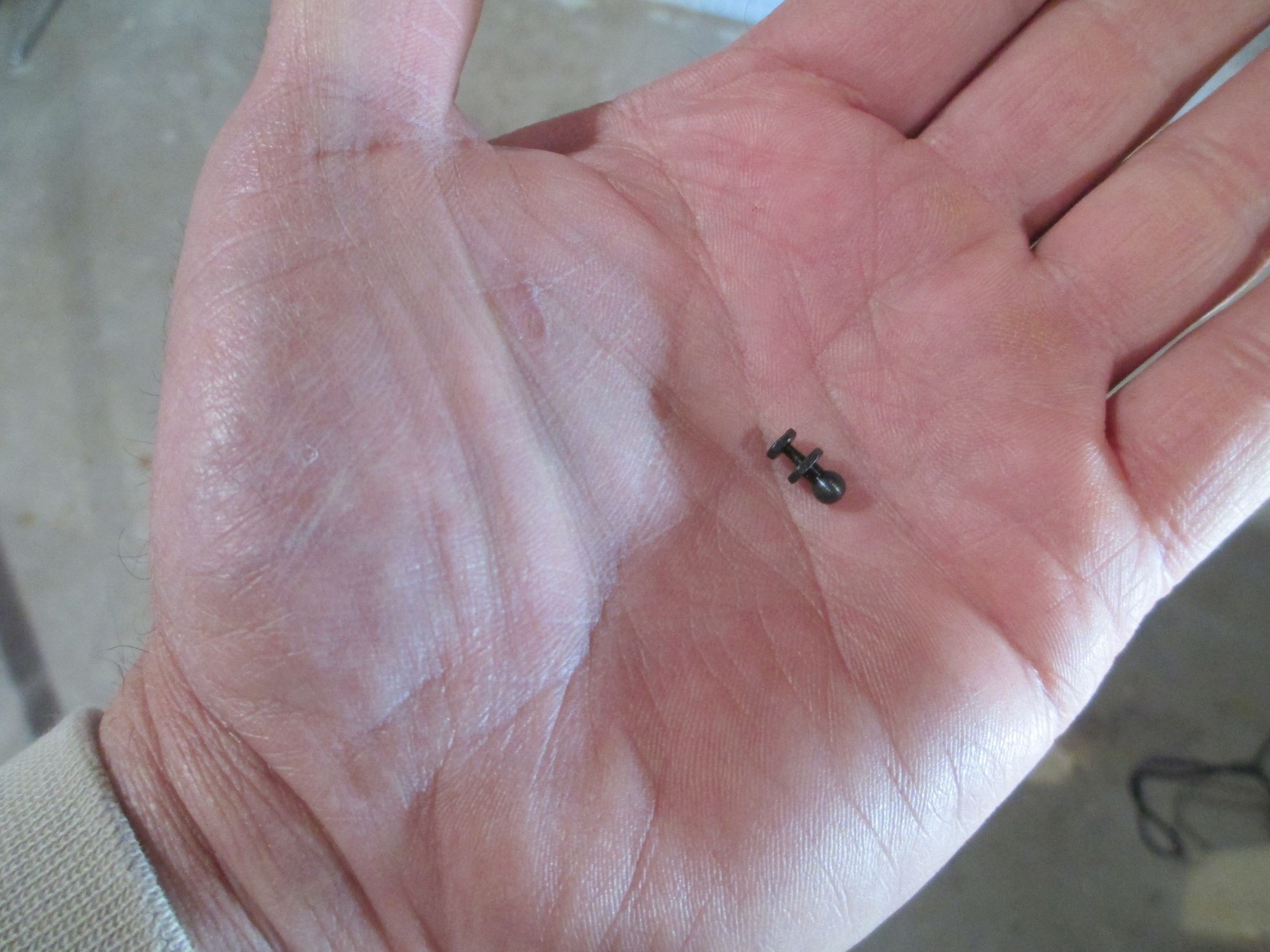

There's a reason why you've never seen a gas engine in a Bonanza, the whole process if fraught with obstacles and resistance. It's a good thing that I'm stubborn! I felt pretty creative and inventive today, I hope that it pays off...🤞
Today I spent quite a bit of time deciding whether to start setting up the throttle or the pull-pull system for the steerable nose wheel. Deciding that the nose gear needed precedence over the throttle, that's where I began. Note one of two ball links that I installed on the steering arm. The ball links will serve as a means to connect the ends of the steel pull-pull cables.
I dug into some of my inventory and had a couple of these that I used for the ball links.
The plastic socket was discarded and not used.
Next was to figure out how to link the pull-pull cables to the servo arm. Again, I dipped into my stock and got a little resourceful. I decided on using two of these pushrod connectors. The hole in the connector isn't threaded so I tapped the hole using a 4-40 tap
I think you can see where I'm going with this. Each cable can be adjusted from here.
I installed the plastic guide tubes that each steel cable will run though and epoxied them into position. Once dry, I'll be able to make up the cables and see if this works!!!
