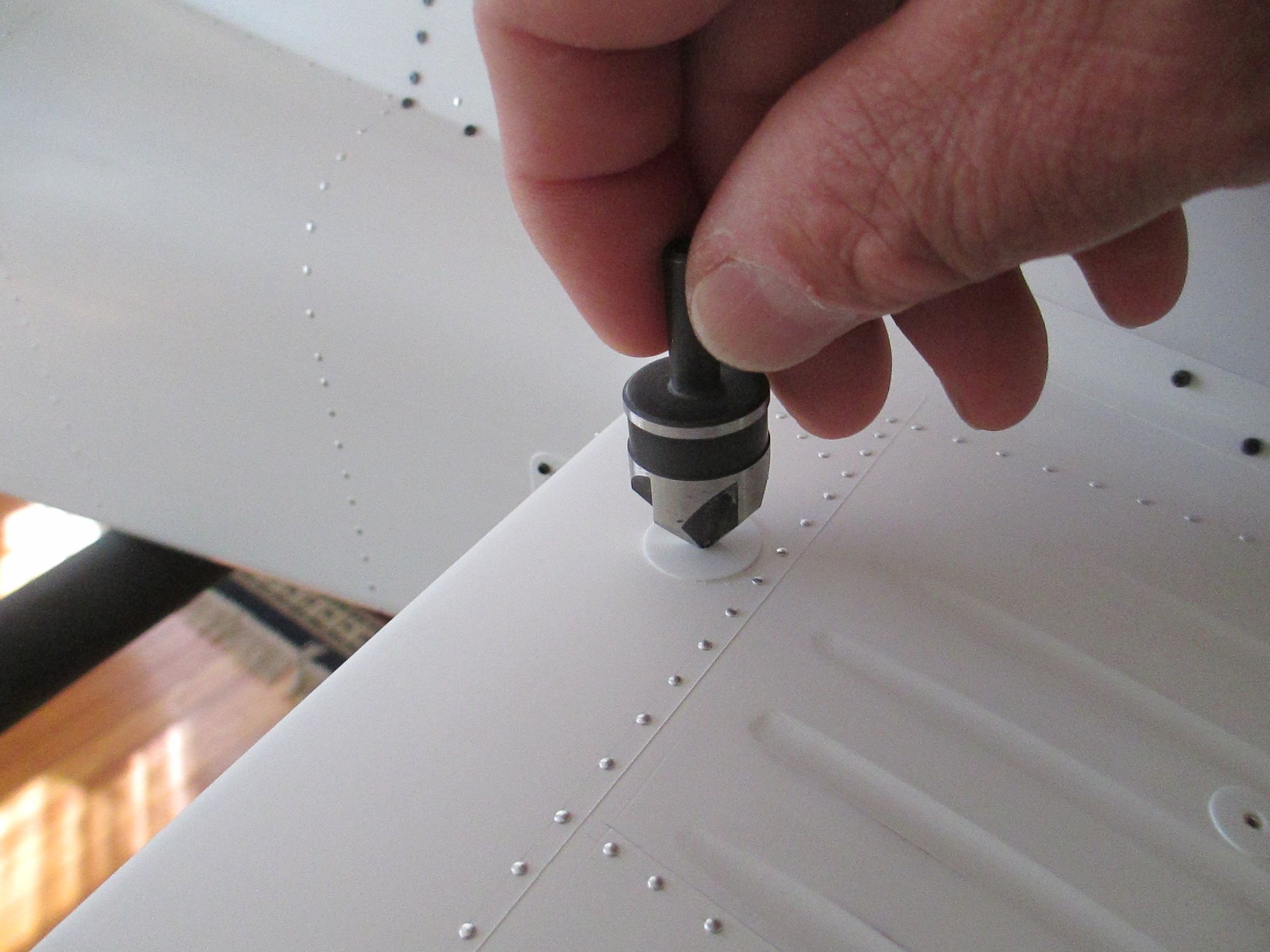

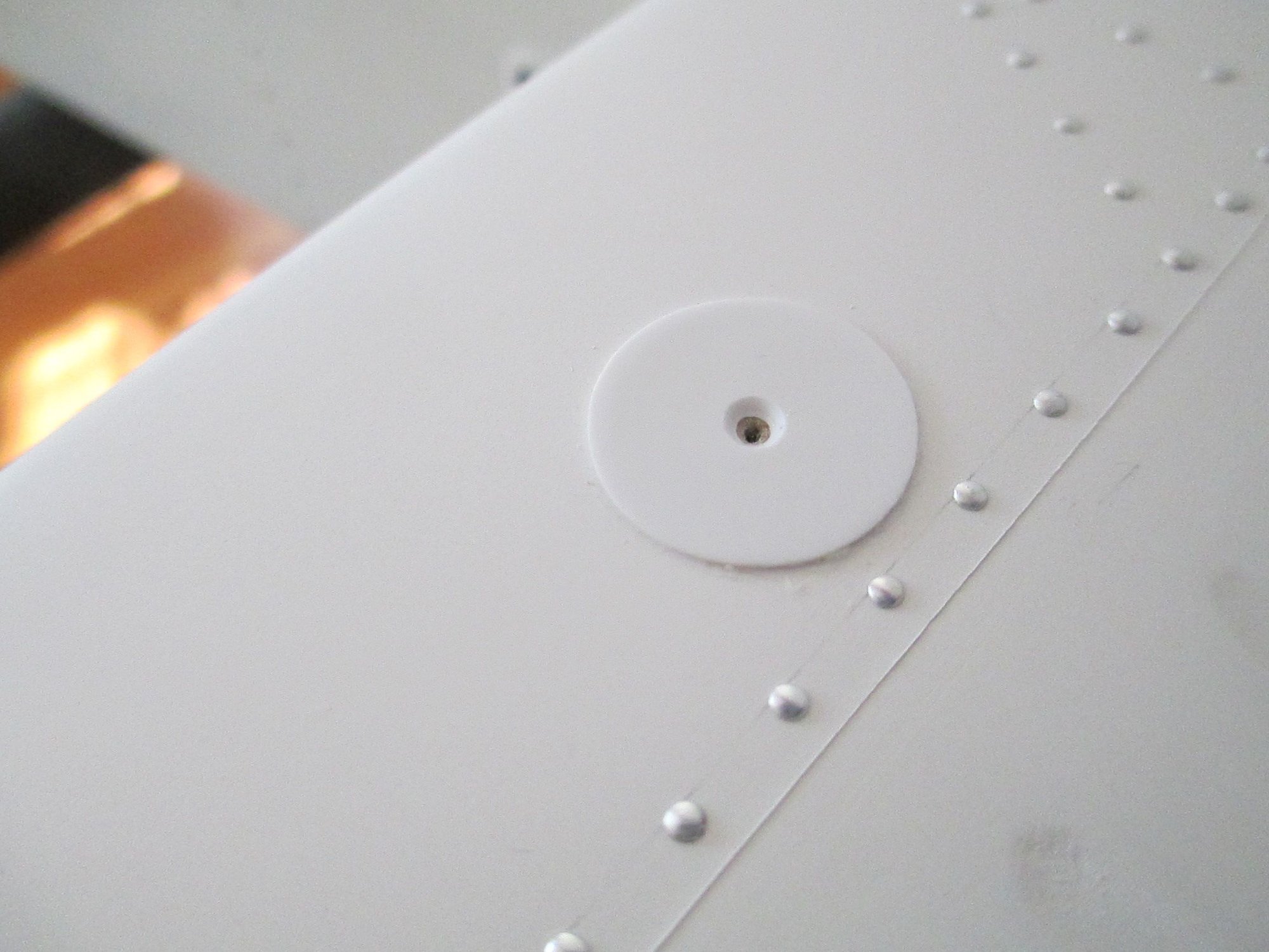

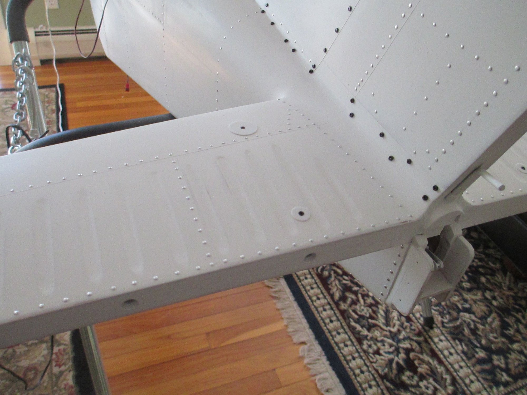

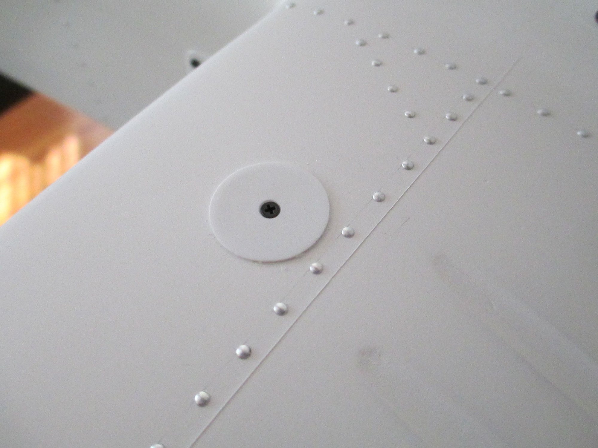

Needed to have the top of the #0 x 3/16 flat head tapered sheet metal screw, flush with the top of the hatch panel.
I accomplished this by using a wood countersink bit that I spun by hand.
A few quick turns and here is the result...

I love the inspection plates!
