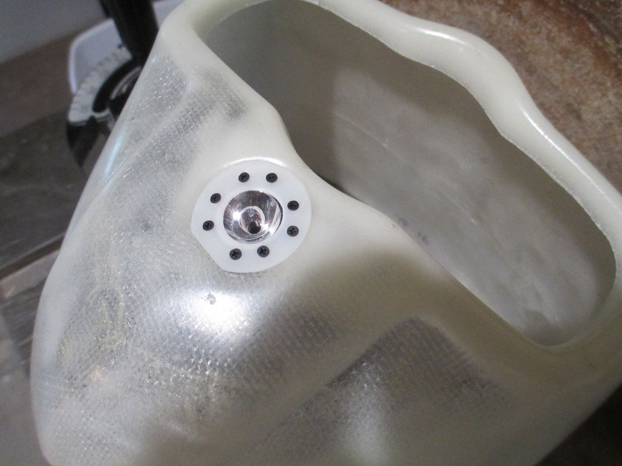

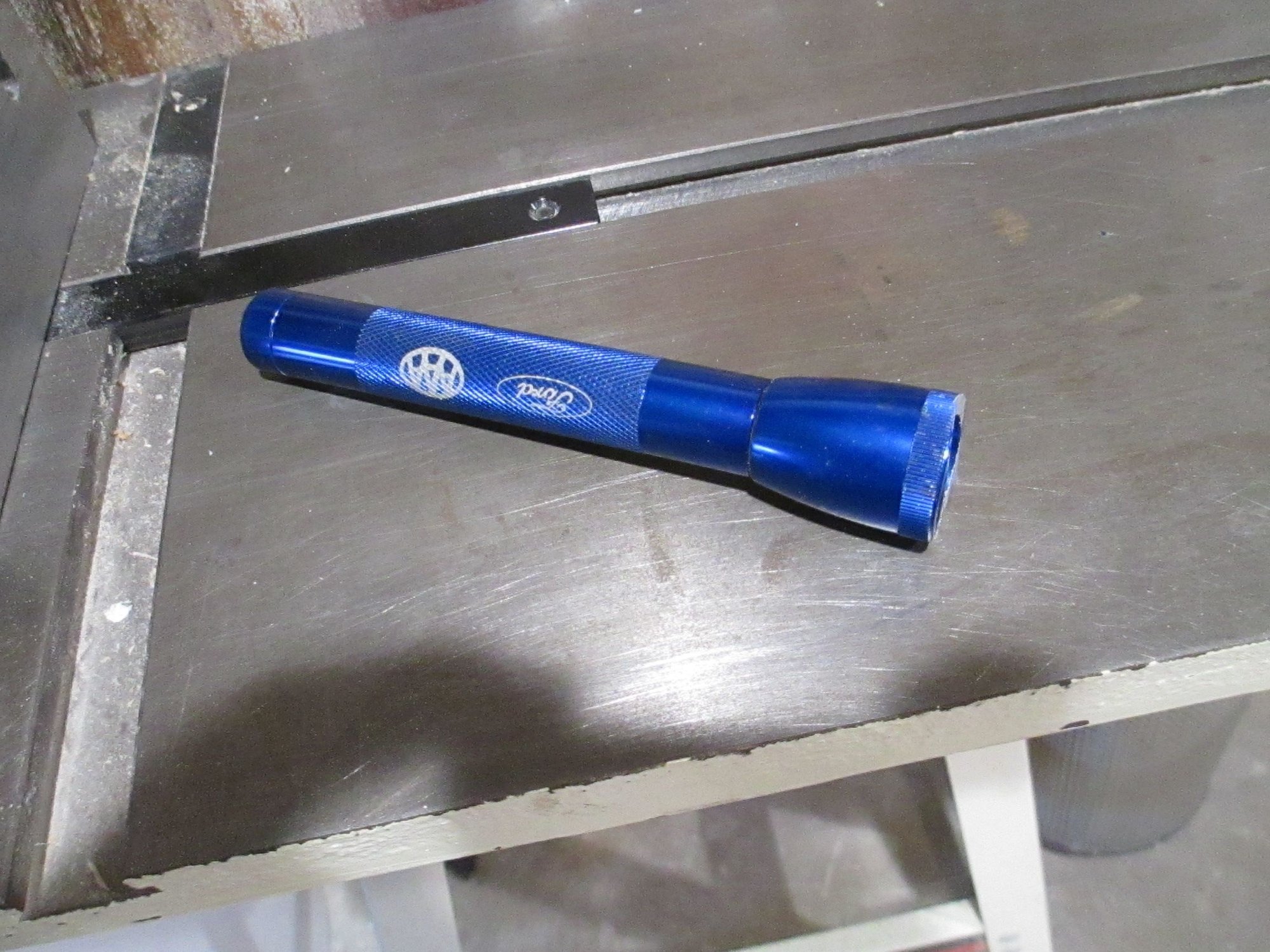

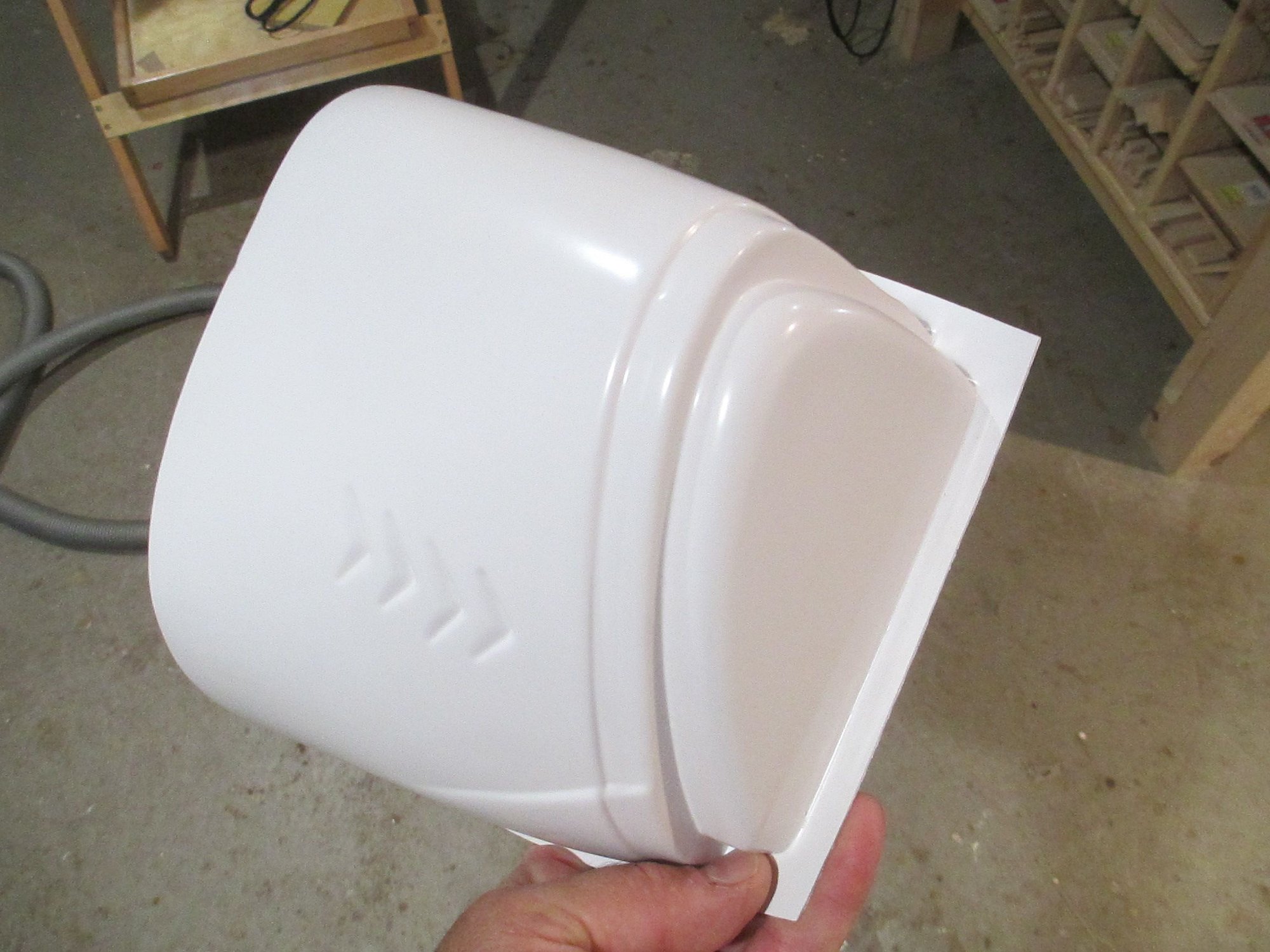

OK Waleed this picture is for you. I can't tell you how much I've been thinking about those plastic parts you had asked about. I finally solved the mystery to that puzzle. Look carefully at the front of the stock cowl half, look familiar? You had apparently removed that section and assumed it was for something else. Those are scrap pieces not meant to be used!
With the canopy completed, it's time to start on the cowl. Before the sanding and primer is sprayed, I want to address a few of the scale details found on the cowl. I will fabricate the landing light located directly under the spinner. After giving it some thought, I decided to cut up one of my old Mag flashlights. The reflector was salvaged and I will use it for the landing light.

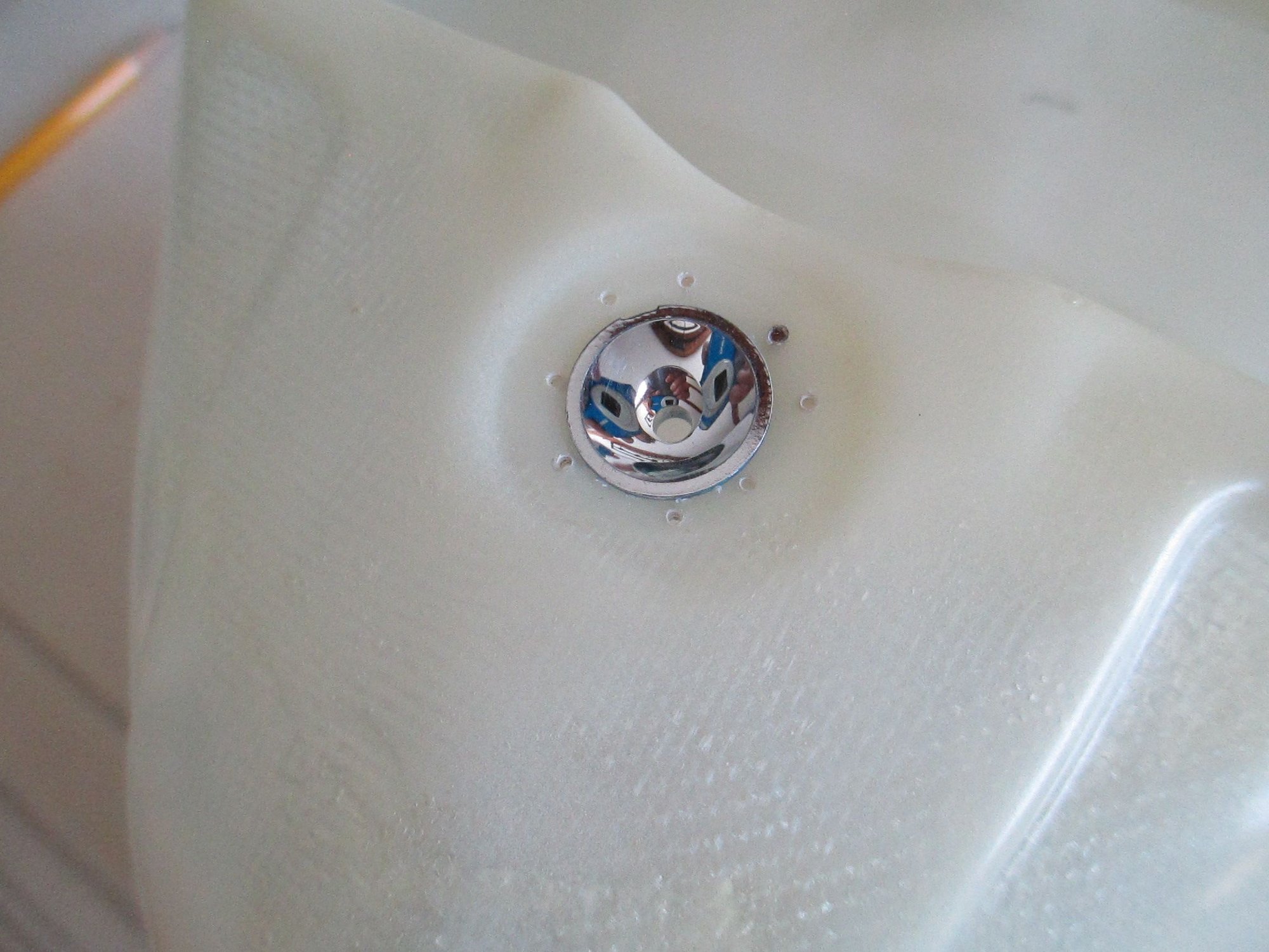

A receiving hole was cut in the cowl for the reflector.

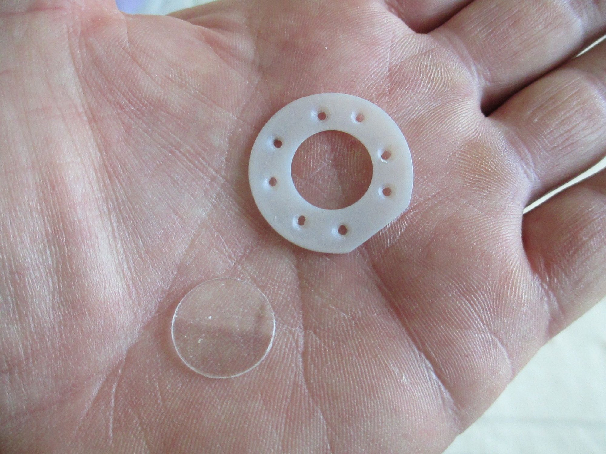

I fabricated a mounting ring that replicates the full scale version. I could use the lens from my flashlight, but I think I will probably end up making a new one...
Eight screws hold the assembly in place. This will be removable should the light need servicing in the future.

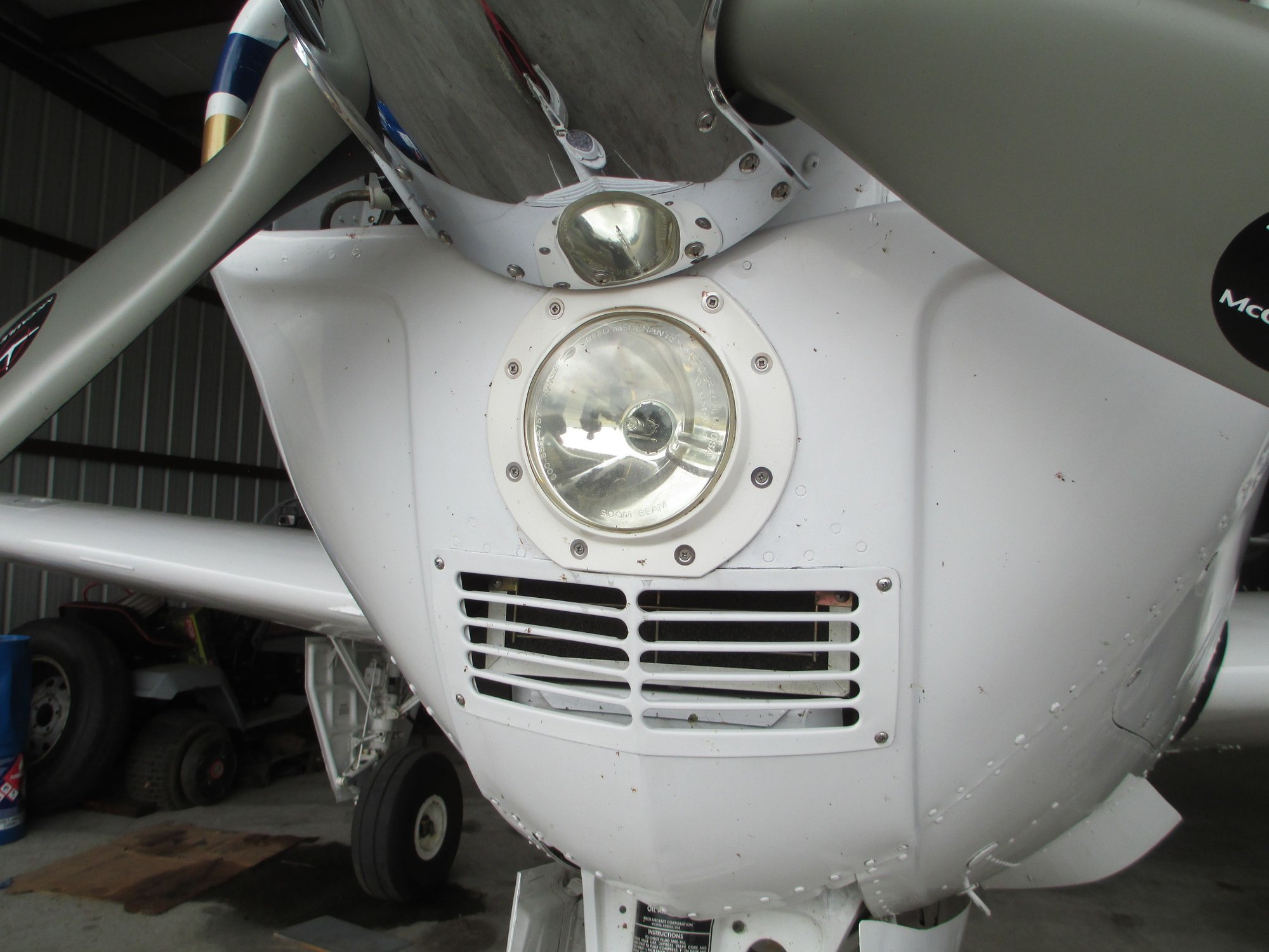

I think I successfully captured the look of the full scale landing light.

Its too bad they don't mold the grill in the cowling so you just have to cut the gaps out. I have a fiberglass cowling for a Globe Swift project made that way and they embedded carbon fiber to strengthen the fins.
Old 08-24-2020, 10:46 AM
  #1322
VincentJ
VincentJ's Avatar
Join Date: Mar 2011
Location: Peterborough, NH
Posts: 4,448
Received 53 Likes on 48 Posts
While the grill isn't spaced exactly like it's full scale brother, it will do. I was afraid to space each bar in the grill closer thinking it would weaken that area too much making it vulnerable to breakage.
