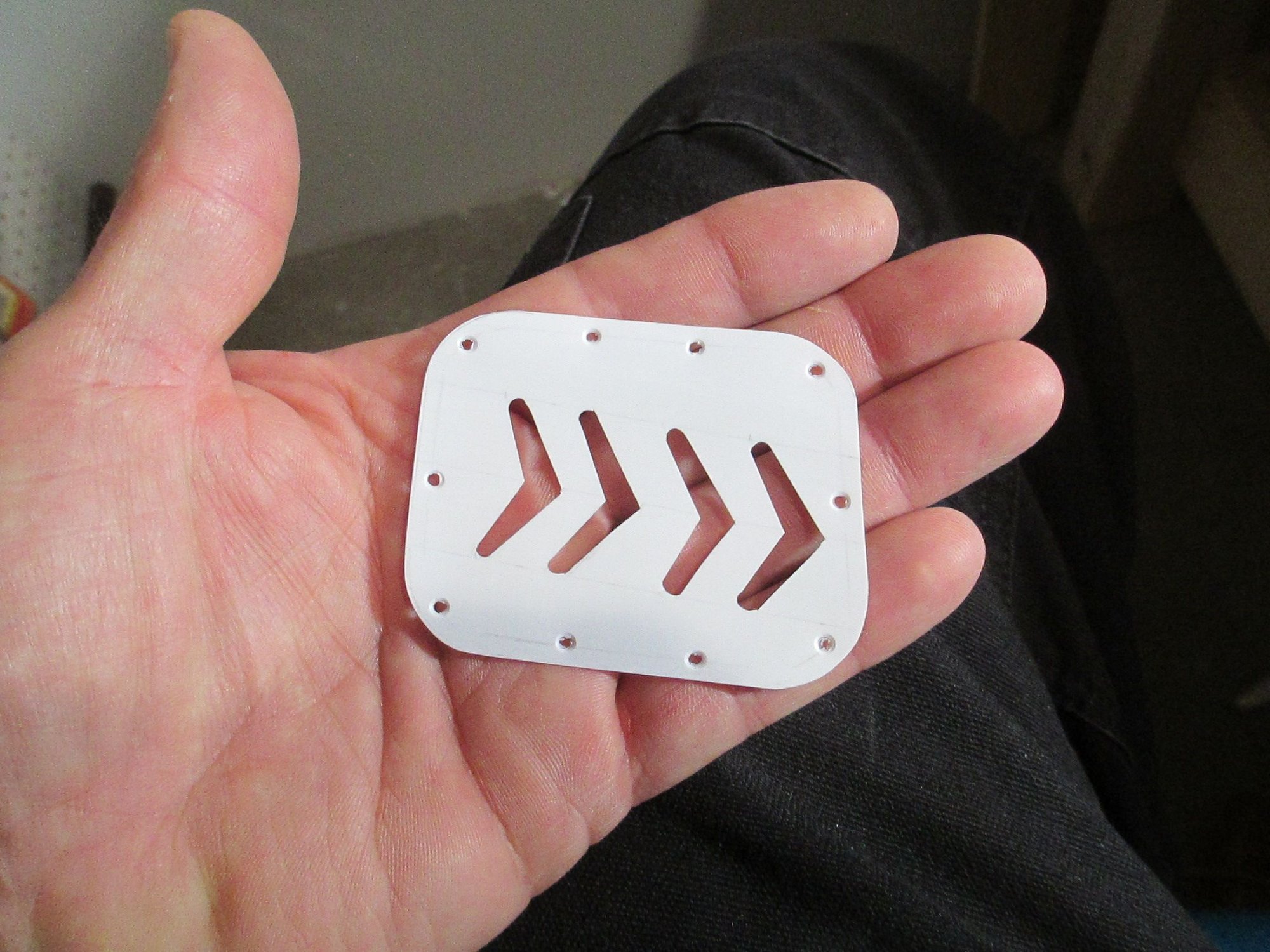

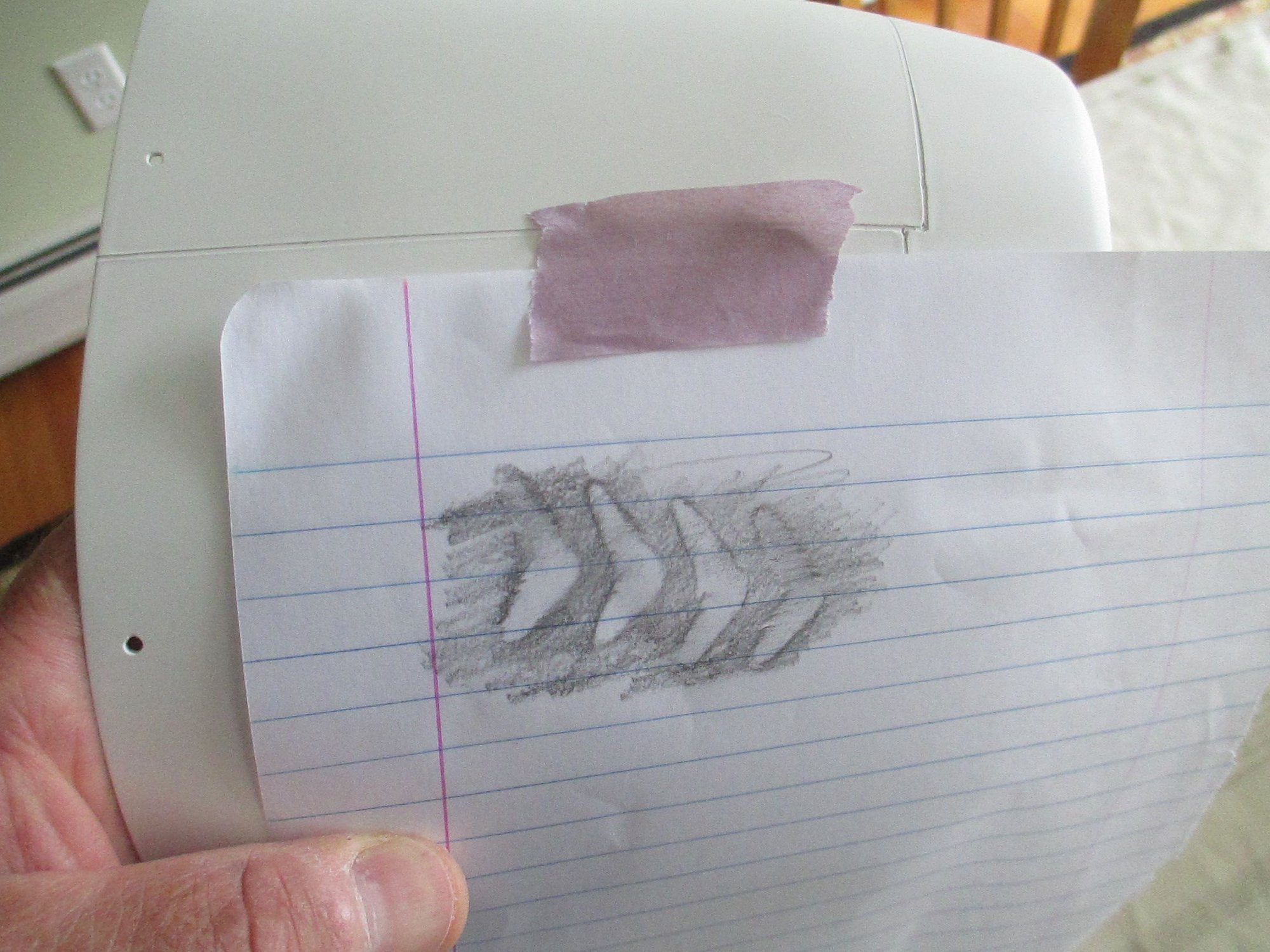

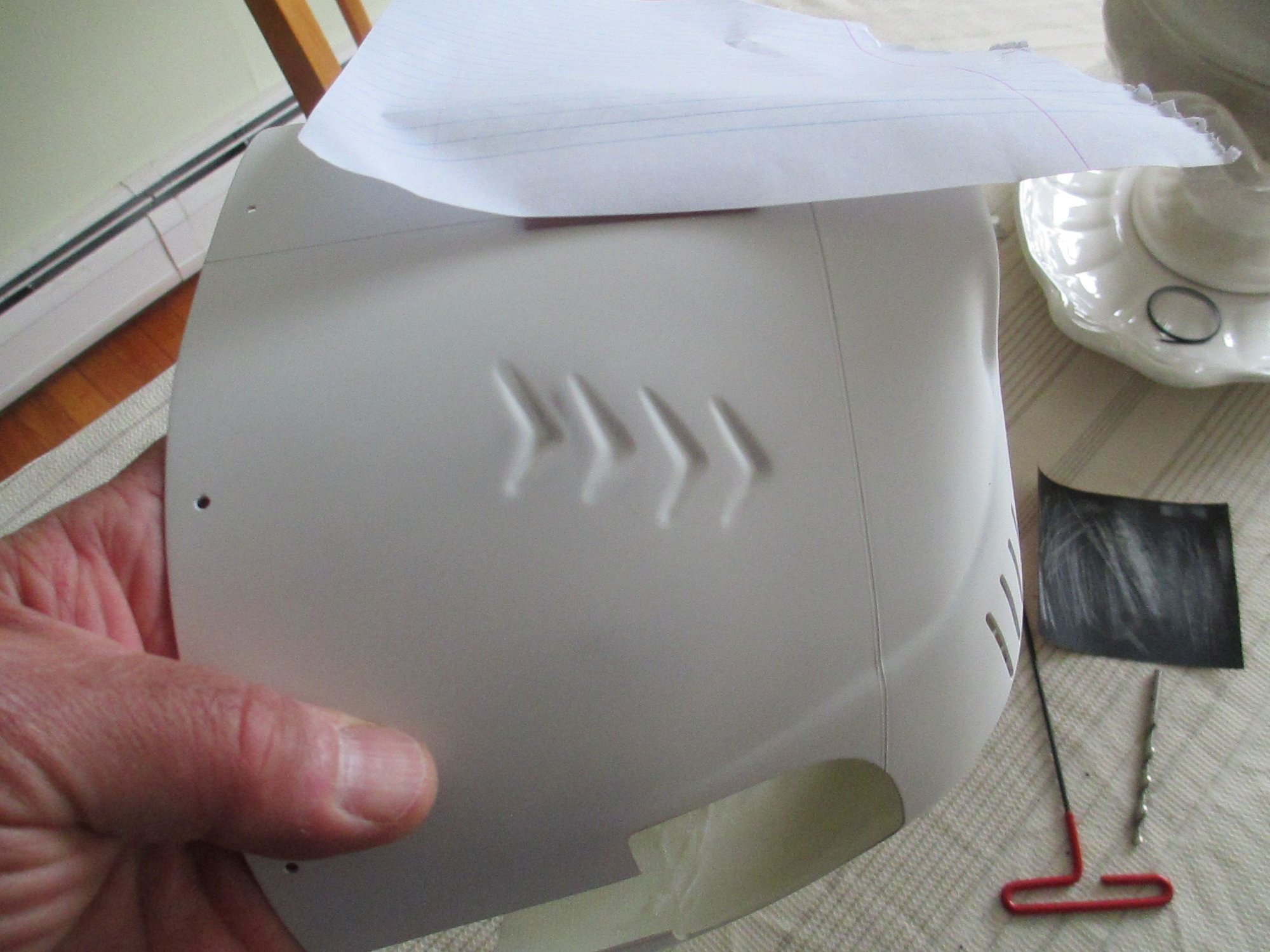

Sorry this photo is out of sequence. It shows how I located the vent positions by lightly rubbing the side of a pencil on the paper.

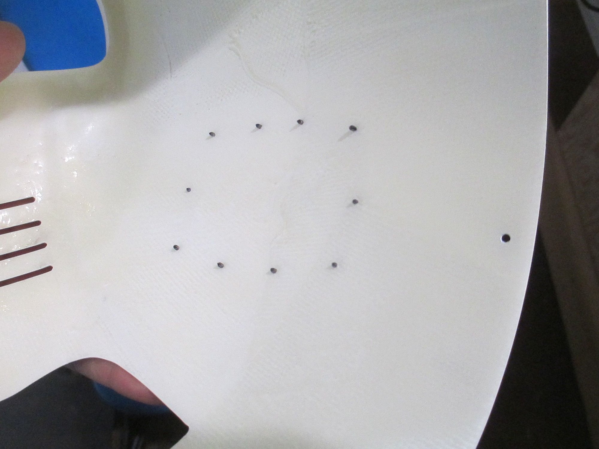

I decided to make a plate to better replicate the full scale cover over the cowl vents. To get the locations of the vents correctly I simply placed a sheet of paper over the top.
I transferred the vent locations onto .010" plastic stock and cut them out. I also drilled and chamfered ten holes so the screws will sit flush once installed.
The screws protrude inside of the cowl about 1/16". I can trim them off or just simply apply a bit of adhesive to cover the ends...
Next I will remove the screws and apply glue on the back of the plate, then reinstall it permanently. I think adding this plate gives the vents more visual depth and adds realism. Now to do the other side!

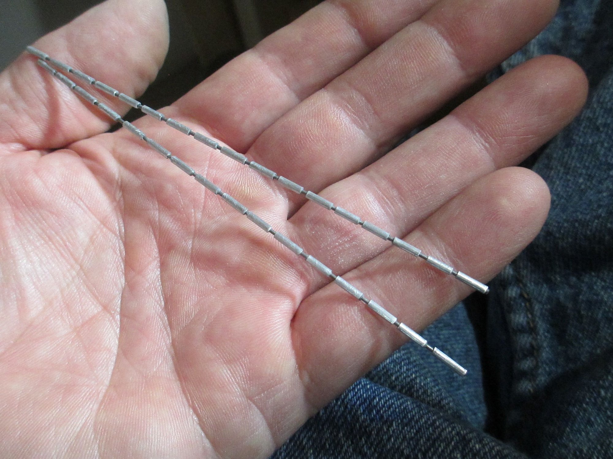

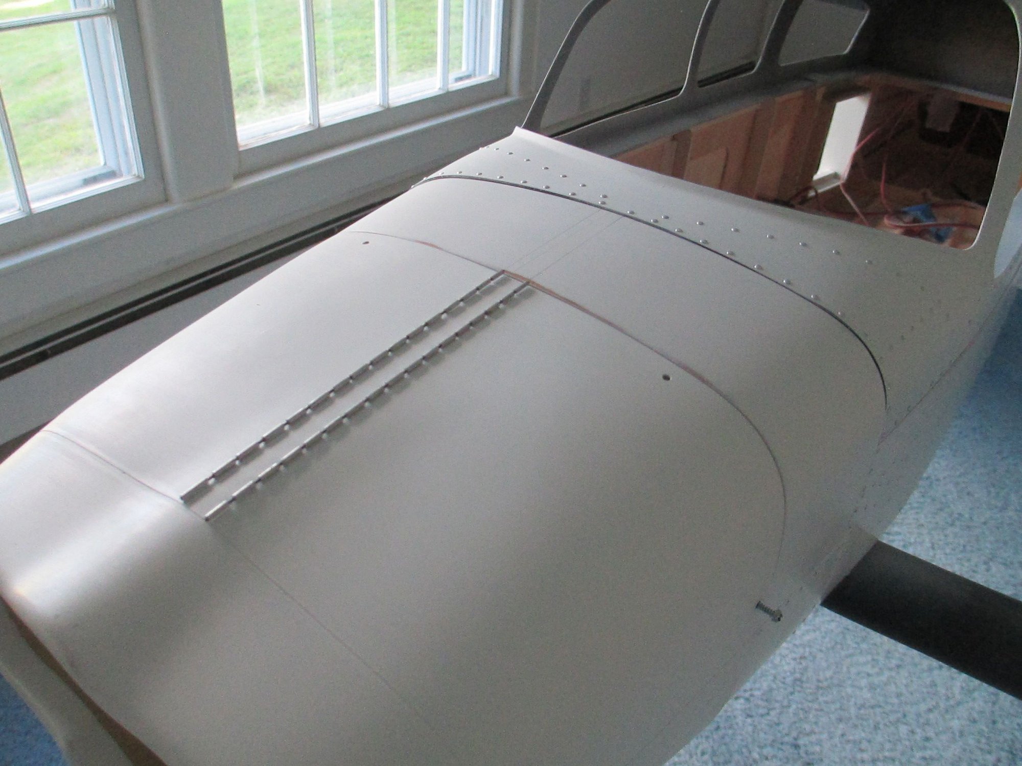

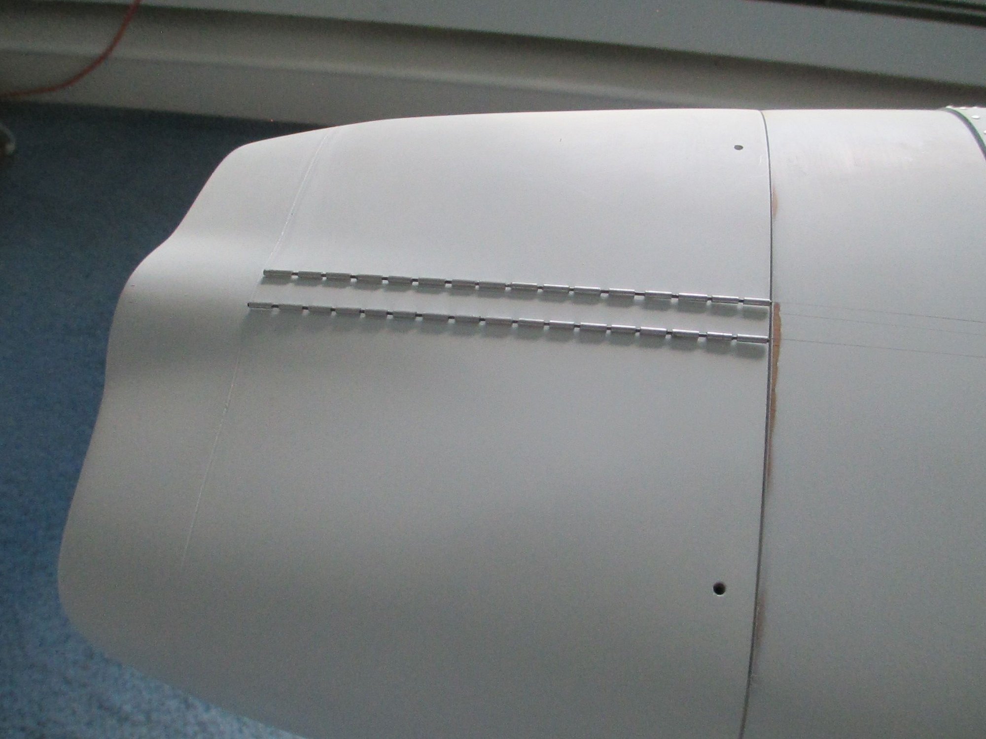

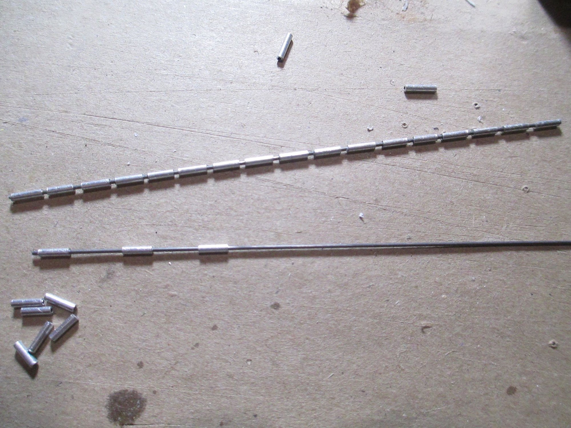

The cowl sure has a lot of detail that definitely takes time to make. I still have two handles for each cowl half to fabricate, not to mention all of the rivets! Each detail added, better creates the appearance of realism for this model...
Two hinges are being made for the cowl. The hinge segments are made from 1/16 x .014 K&S round aluminum tubing that I cut into 1/4" segments. Each segment slips over a length of piano wire that fits snugly inside of the aluminum tubing acting as the pin. A very tiny drop of thin CA holds each segment onto the pin.
Two lengths made are ready to be installed.
The hinges will be secured to the cowl using epoxy. Two additional short length hinges still need to be made, the hinges will continue and end at the canopy parting line.

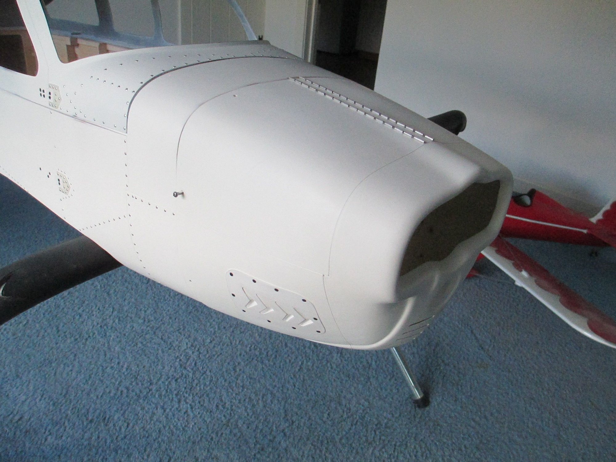

Started to add rivets to the cowl.
I also added the external 24V hatch.
