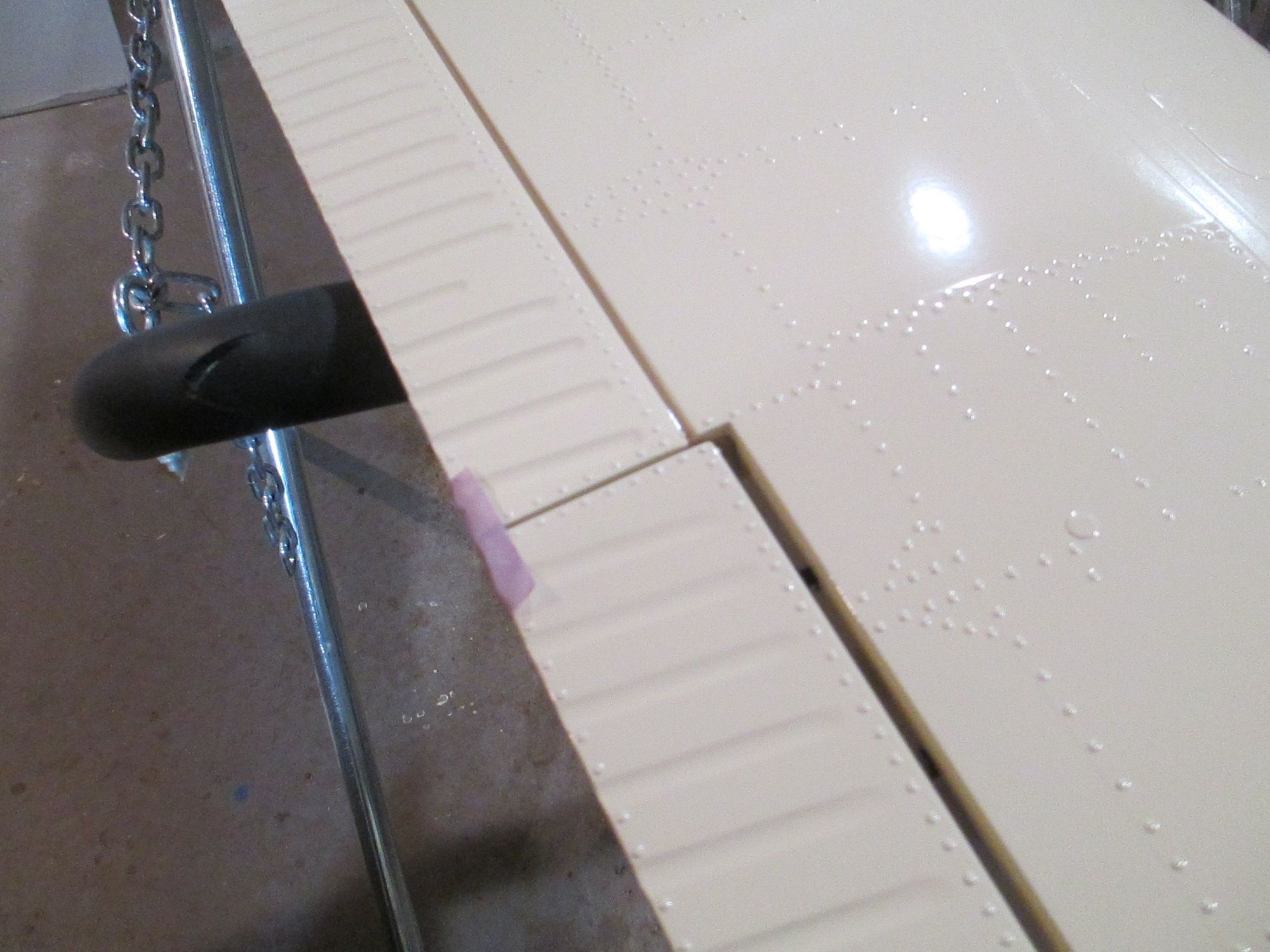

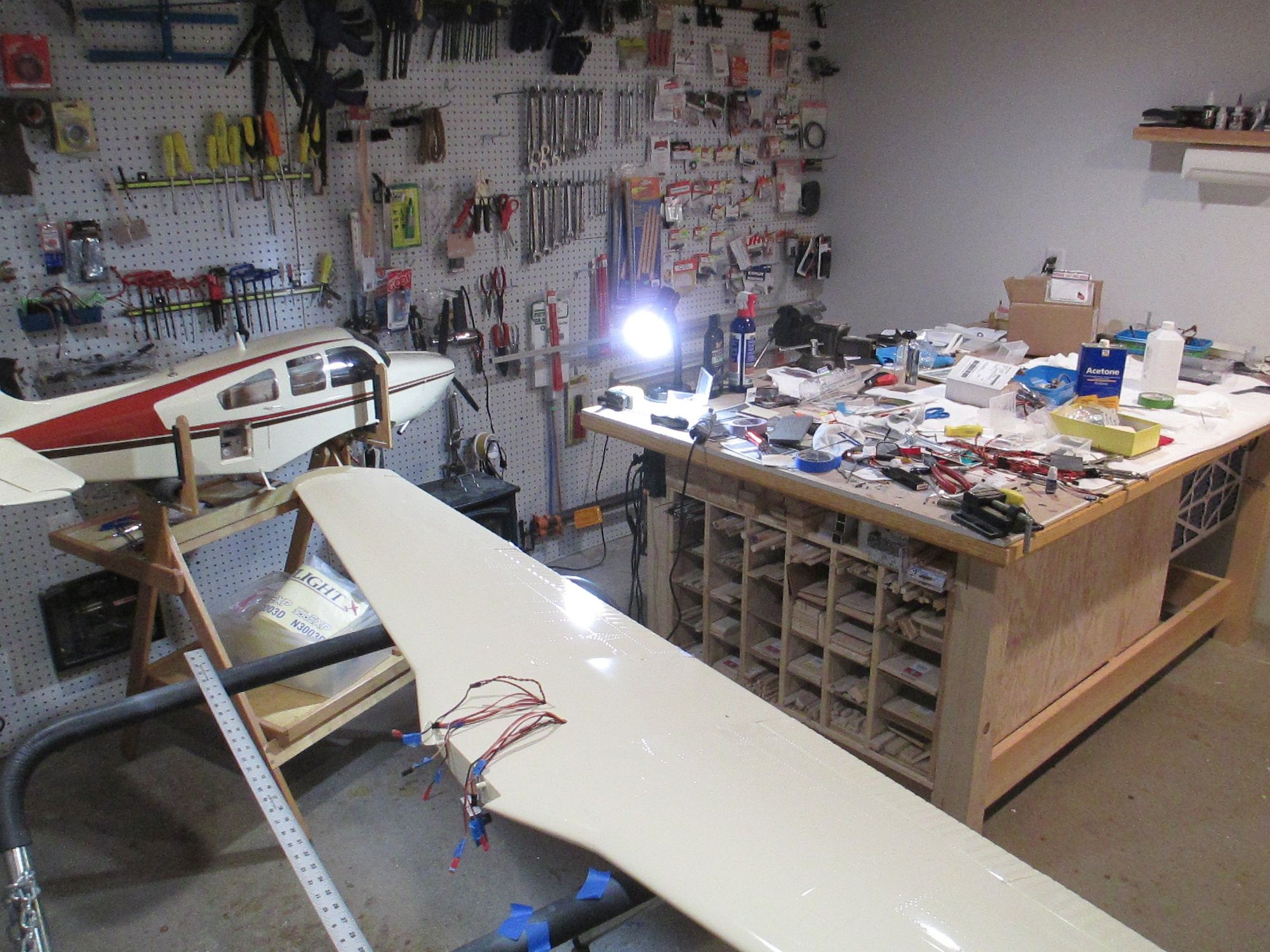

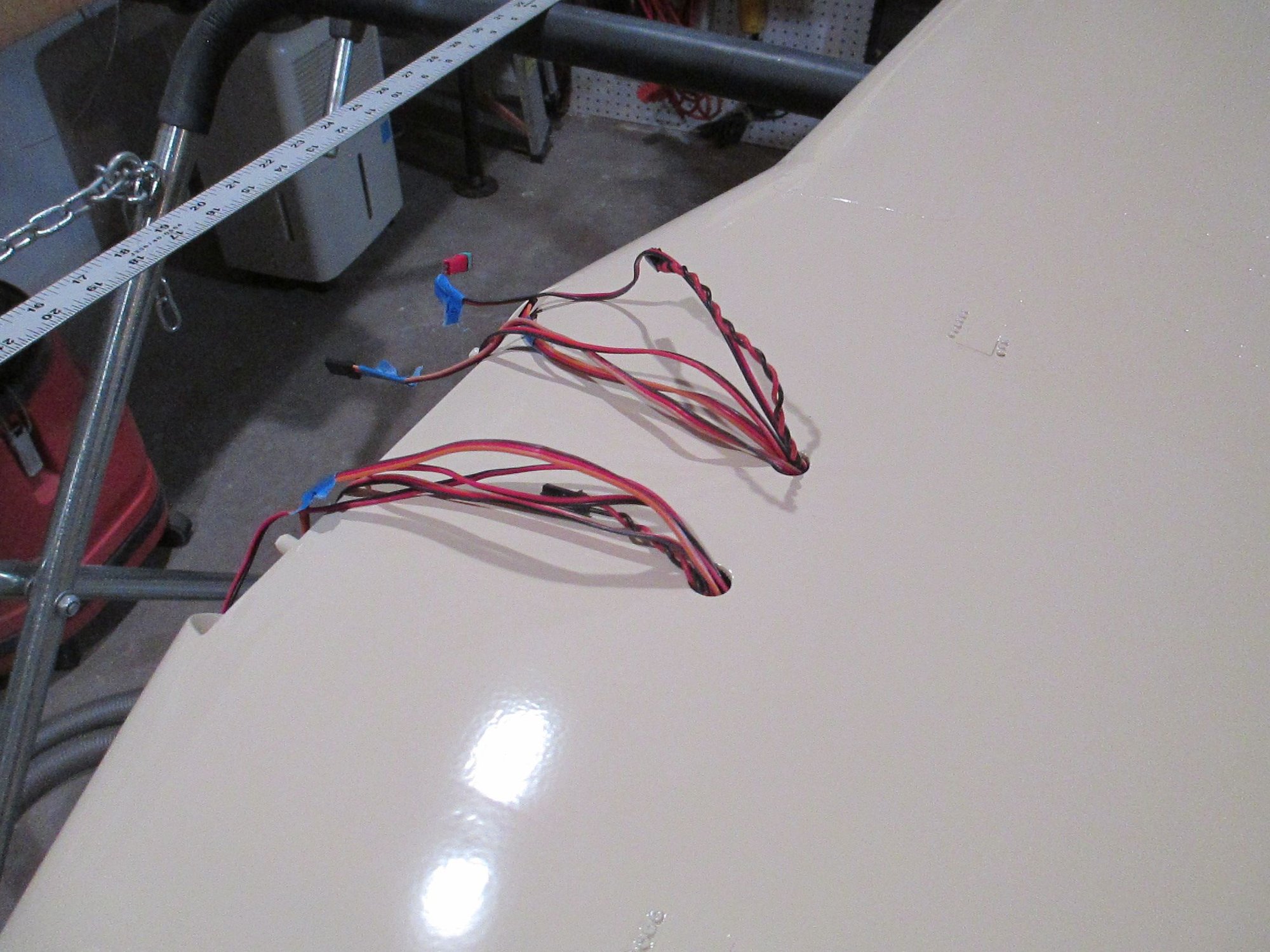

Having gotten both ailerons working yesterday, today I was determined to get the flaps installed and working.
Everything was cleaned and dry fit before any epoxy was mixed. Once satisfied that everything was in order, they were both permanently installed.
This Bonanza sure has a lot of wires everywhere!
I don't know what happened, but my work bench was perfectly clean a few hours ago. That means it was a good productive build session...

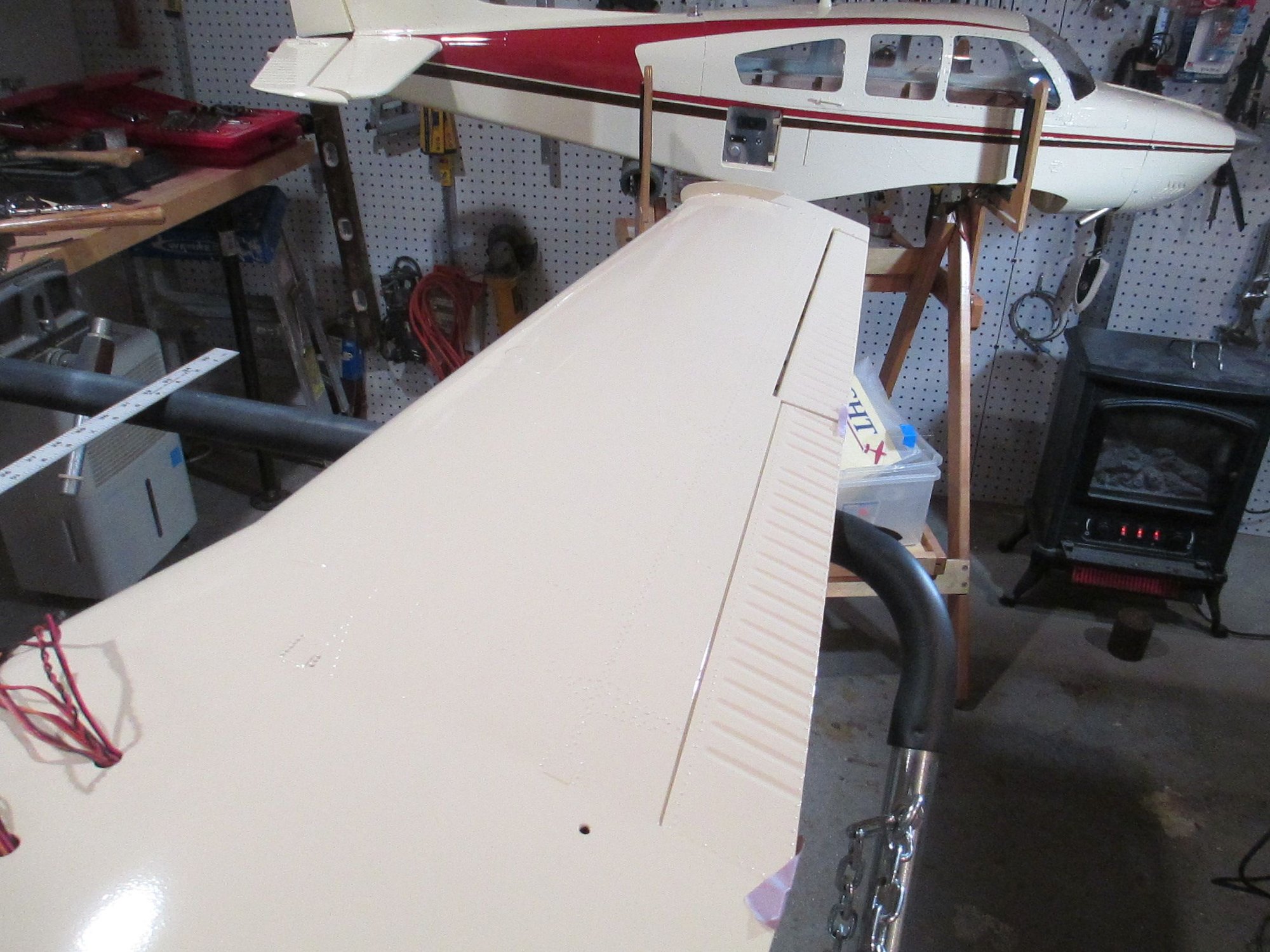

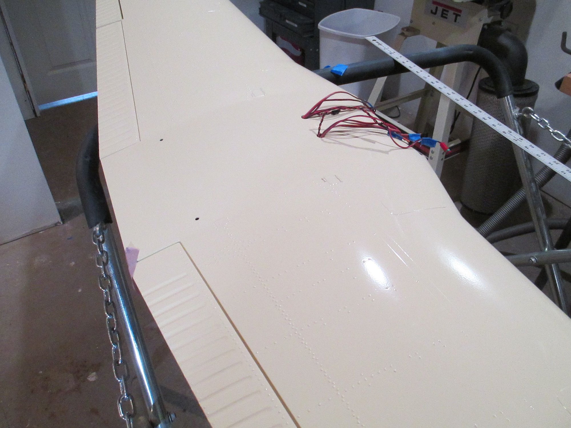

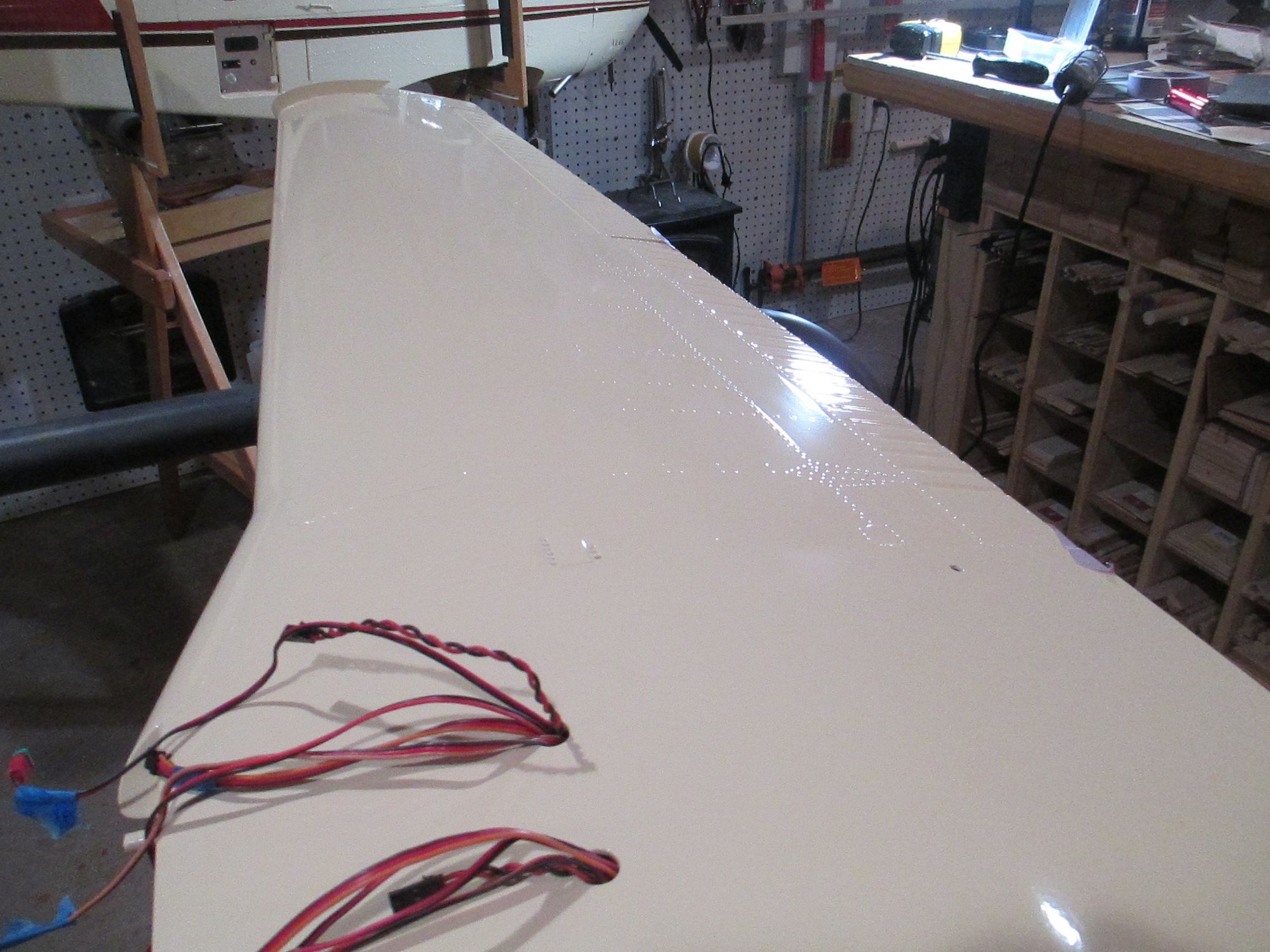

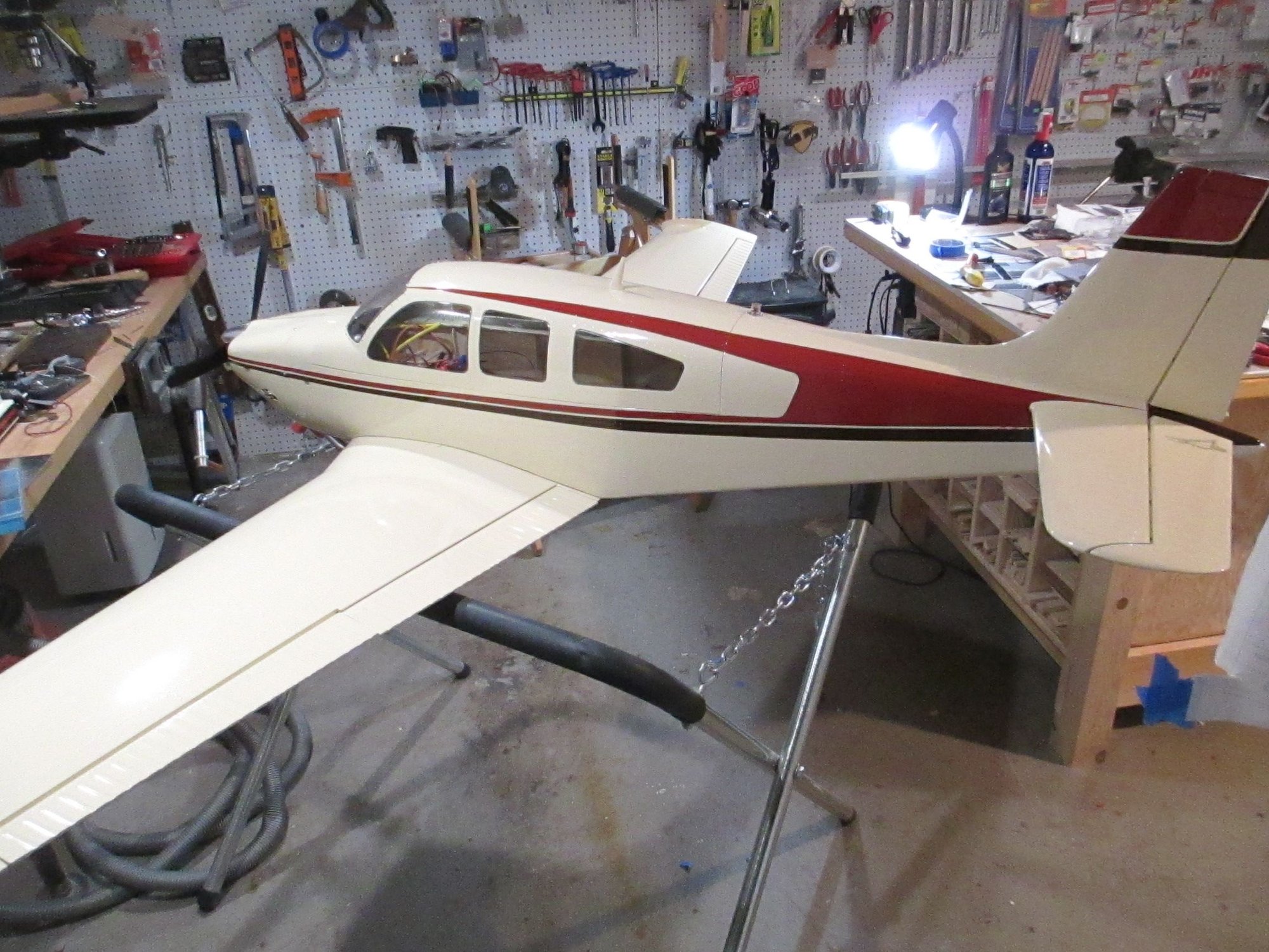

The wing was installed to the fuse to check for fit. I allowed for the thickness of the paint, but apparently I still need to remove 1/32" from the aft center section of the fuselage to make the wing slip on and off easier. The gap on the trailing edge of the wing will all but disappear once the wing bolts are tightened. I don't want to be struggling at the field trying to get the wing on, so with just a minor adjustment it should be fine. I am also taking the opportunity to lay out exactly where the black textured wing walk paint needs to be applied.
If you're wondering as to why I haven't installed the cargo door to its hinges, someone left the cargo door home so the small strip of rust color never got applied! it will have to wait until I mix more of that color to spray the wing tips...

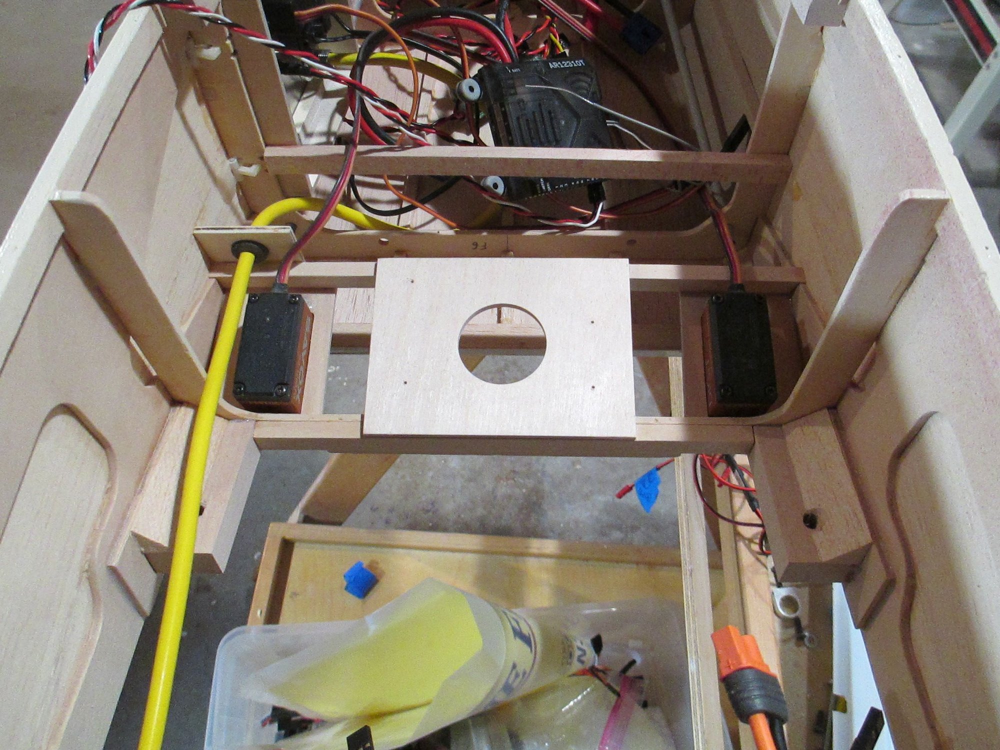

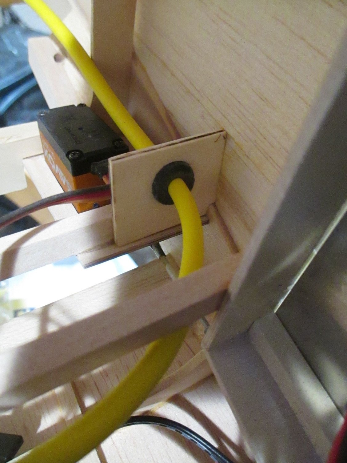

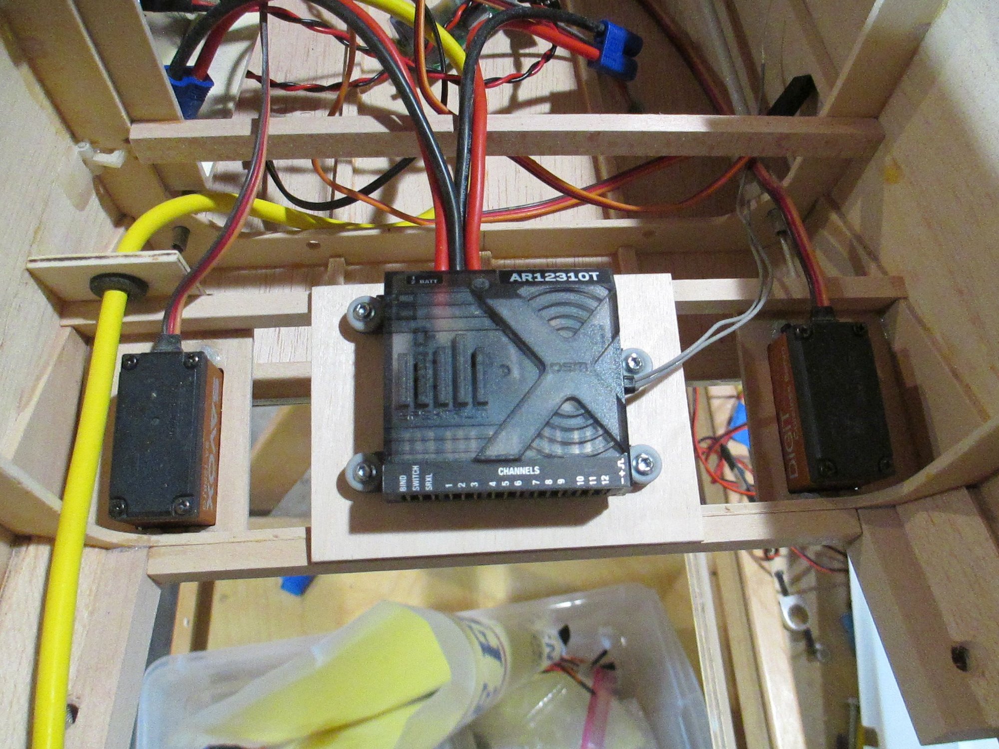

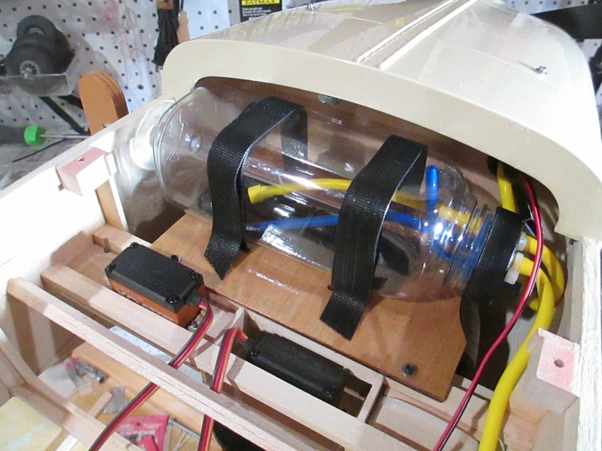

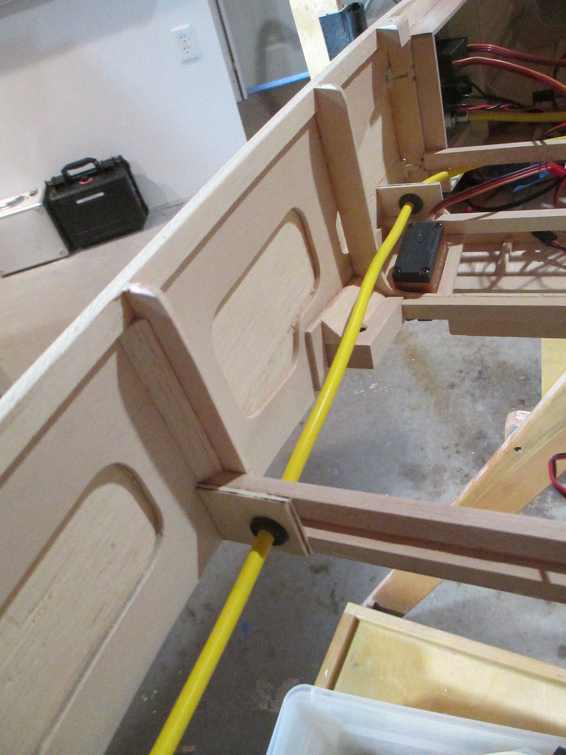

Fuel tank has been assembled and installed. I'm using a 12 ounce 4titude gas tank which combined with the DLE-20 engine should give me about a 12 minute flying window. The clunk's fuel line that came with the tank was scrapped and replaced with the yellow fuel line manufactured by Sullivan ProFlex. I have been running this line now for three seasons and haven't had to replace hardened fuel lines that one would encounter using Tygon.
Pro-Flex line comes in two sizes, Standard and Large. I'm using the Large 3/16" which is perfect for gas engine applications. It can be purchased in a 2' roll or 10' roll. I ran the fill fuel line parallel to the side of the fuselage being careful to anchor them in place with rubber grommets along the way.
After much thought about receiver placement, a mount was fabricated and glued into place. I chose this location for a variety of reasons.
This location will allow me future access to the wire connections should I need to. As large as the inside of the Bonanza is, it is very tight on space as the interior is taken up with the cabin features. I will have to be creative on hiding wires!

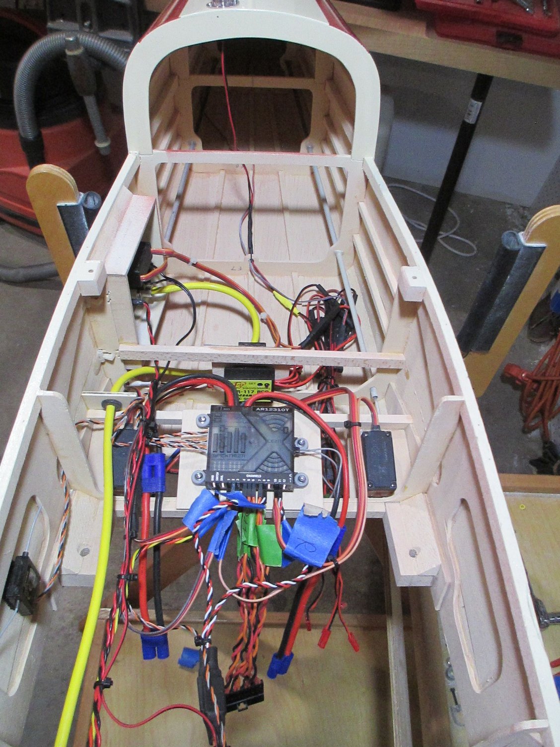

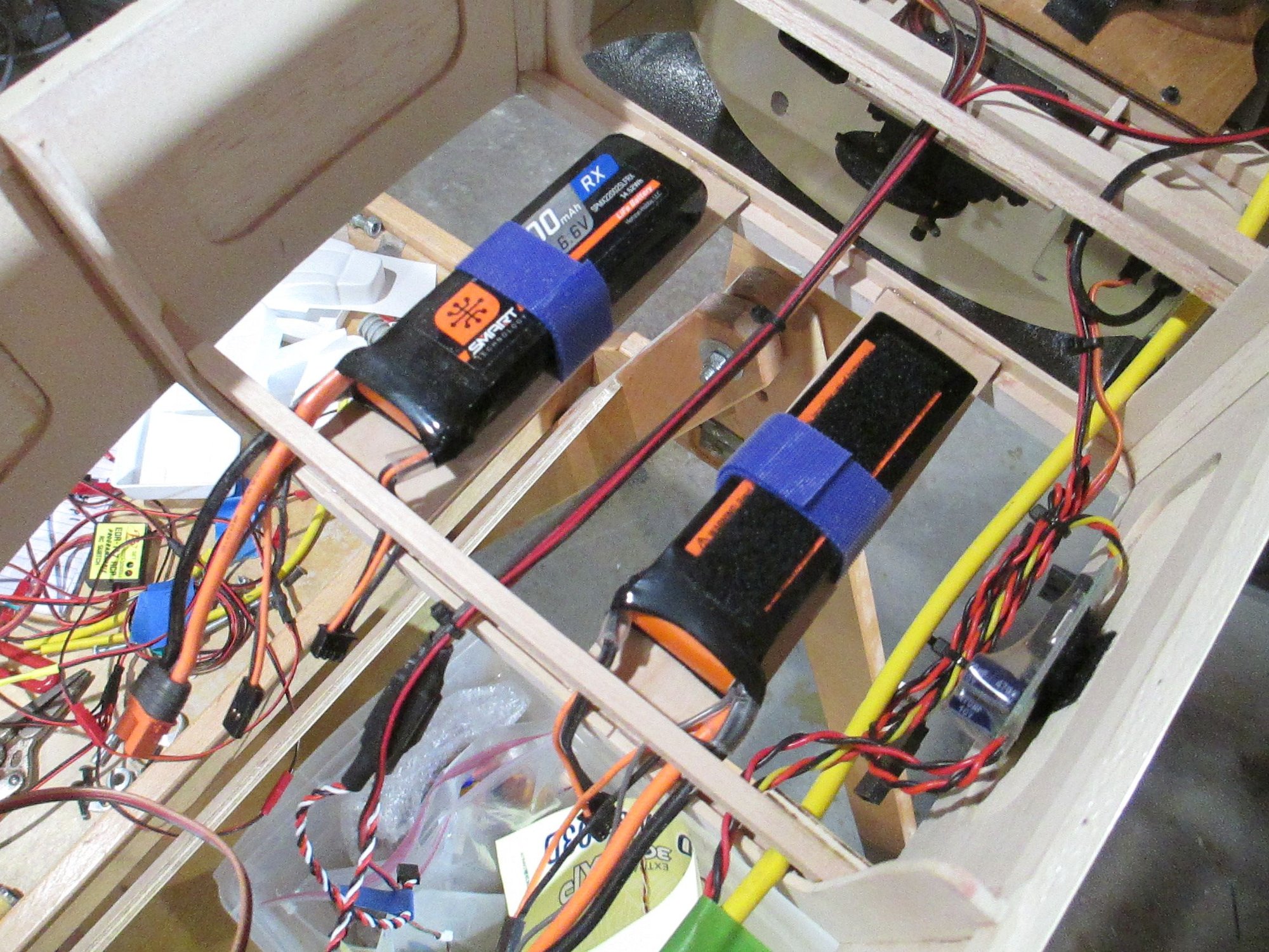

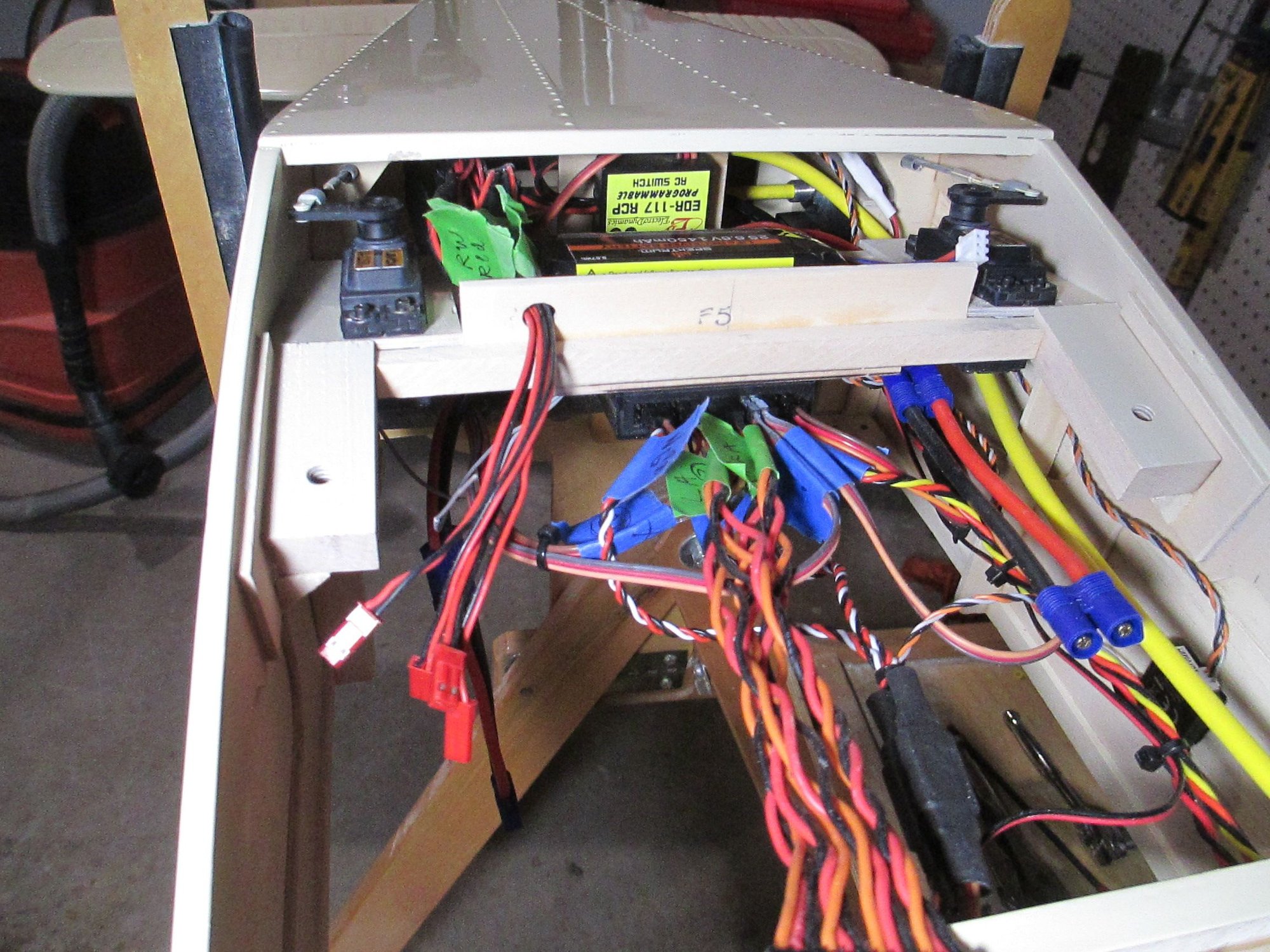

I'm starting to sort out the tangled mess of wires. I'm using two 2200 mAh LiFe batteries for all the servos and ignition, navigational lights will have its own battery. It is obvious that I will need to make up two battery extensions to connect the batteries to the receiver.
The placement of these batteries was a compromise of many different factors. I know that I wanted to keep them as far forward as possible for CG purposes and I need the batteries to be in a location where they can be easily serviced and charged. Not an easy task when space is very limited...
Note the Ultra IBEC (mounted on right) from Tech-Aero Designs. This eliminates the need for a separate ignition battery and mechanical on/off switch. Using a designated channel of your choice on your transmitter, the ignition can be shut off with the flick of a switch. I've been using these on all my gas planes with 100% reliability.

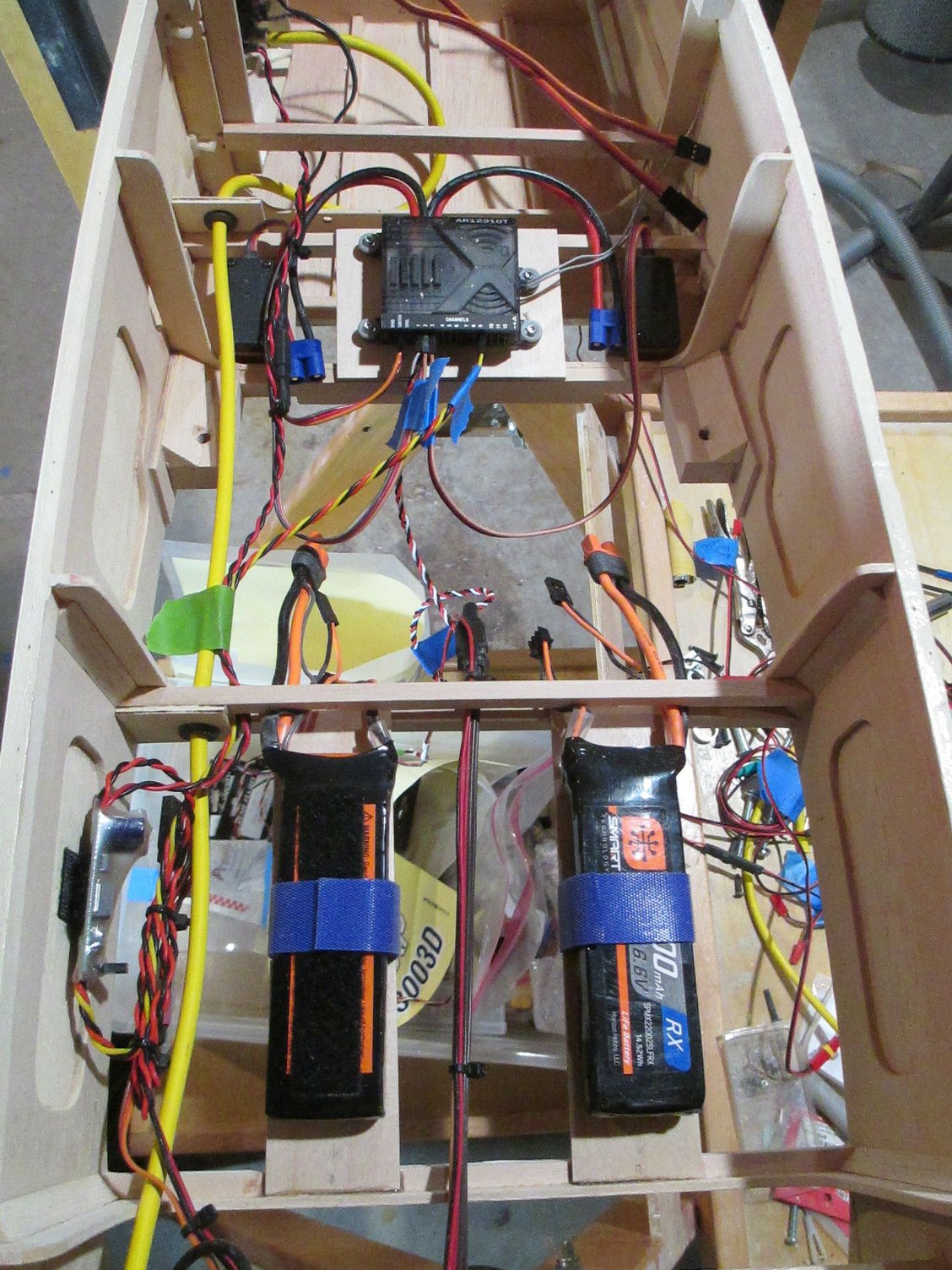

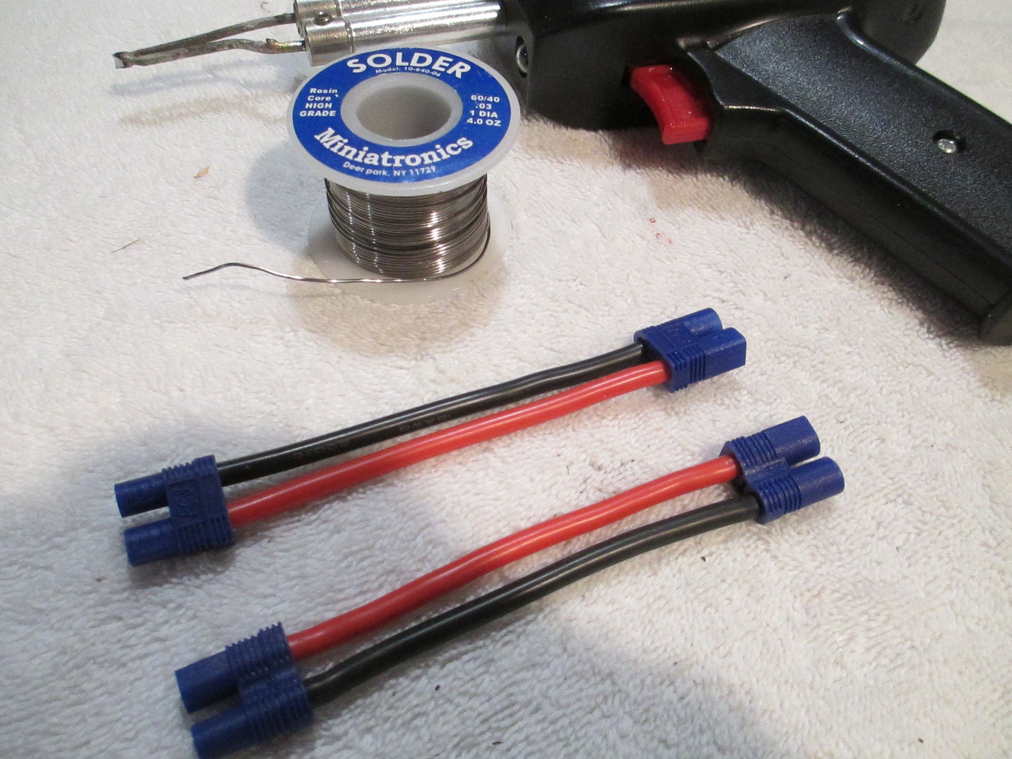

The distance between the receiver and battery required two four inch extensions to be fabricated. I wish battery manufacturers sold their batteries with leads 12 or more inches long, without any terminal ends soldered in place. This would allow the installer to fabricate their own custom length leads, eliminating the need for extensions!

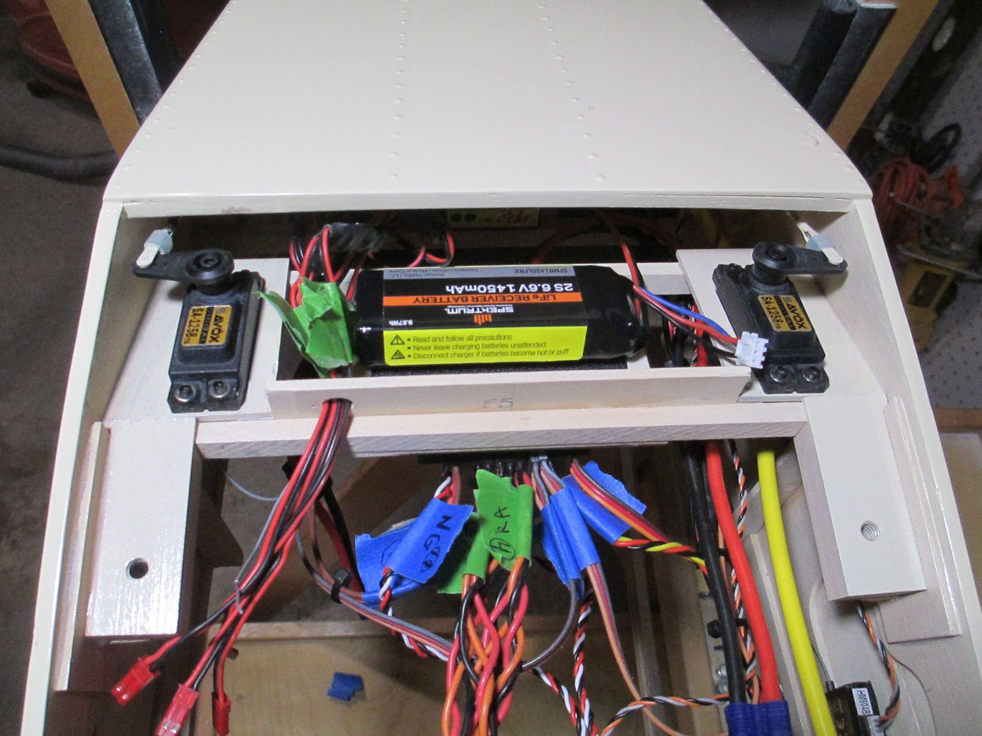

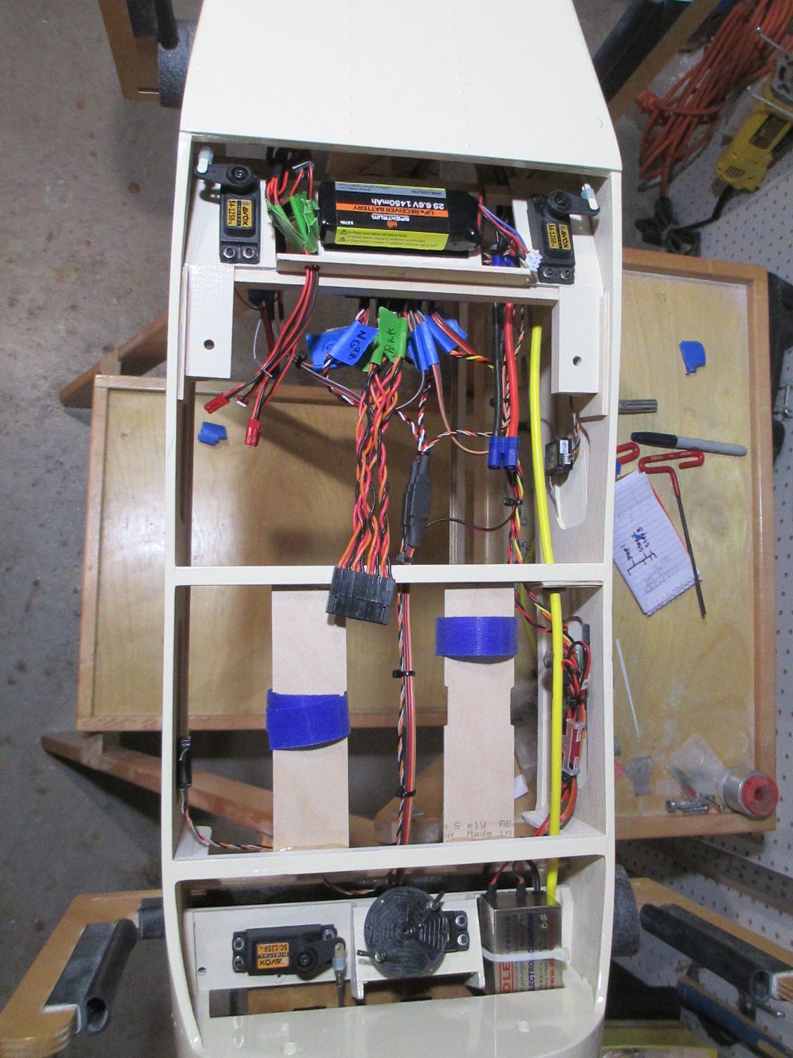

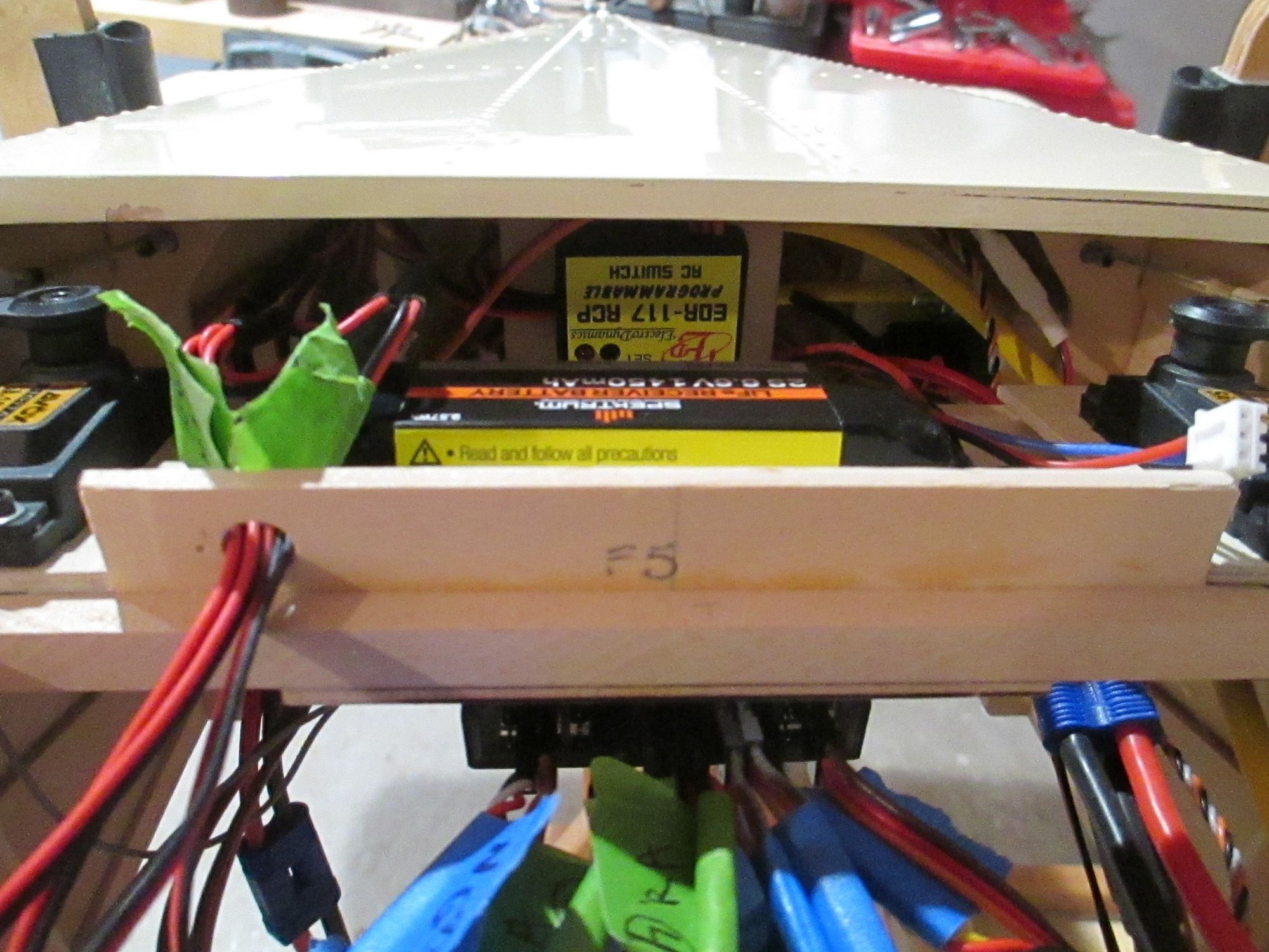

Top view of the wiring harness. Everything from this view will be covered over by the bottom of the cabin interior making anything inaccessible. Note: All the tape on each wire will be replaced with tape from a label maker.
Bottom view. Everything from the bottom will be visible and accessible with the wing removed. Note the Navigational Lights battery placement between the servos. This battery will be charged through the baggage door, but the balance plug will only be accessible from the bottom.
This is a 1450 mAh Spektrum LiFe battery. I prefer to use LiFe batteries rather than LiPo's. These batteries need not be removed to charge, unlike LiPo's. It's secured in place with hook and loop tape.
Again, everything must be accessible from the bottom. The box tucked behind the battery is the programmer for the navigational lights. The four wires passing through F5 is where the connections will be made for the wing tip lights.
I do have access to change the programing of the lights by pressing the "set" button.

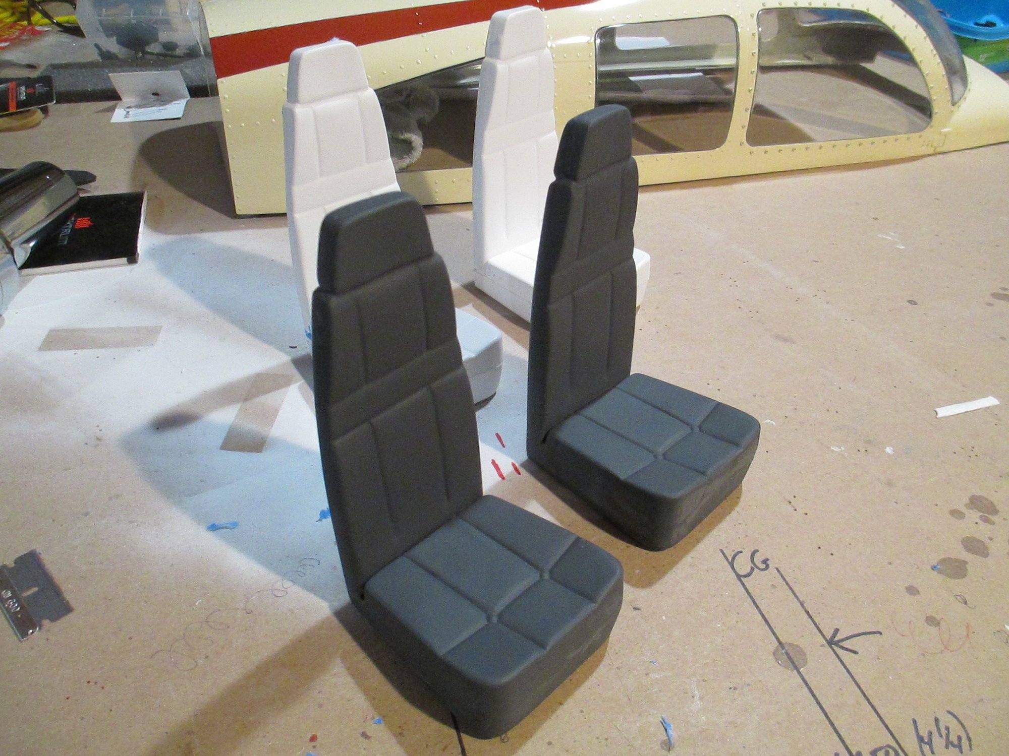

Work on the cabin interior is well under way. All four seats have been assembled, but only the two front seats have been primed. The two seats in the rear still have a lot of sanding/filling before primer is sprayed. The final color(s) of the seat are still yet TBD.
