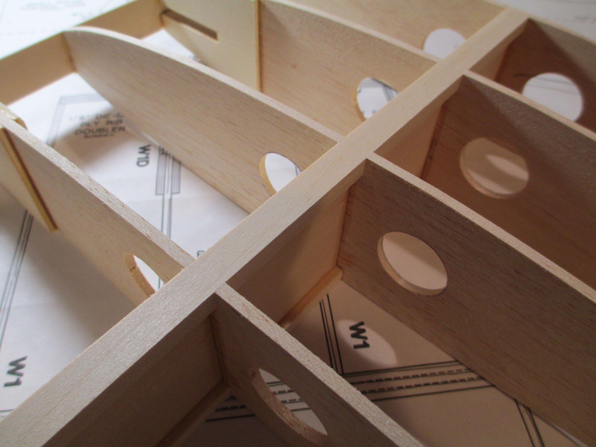

Here is the plan to build the Center Section that will ultimately join the right and left wing panels together.
Before I can start to assemble the Center Section, four (W1) ribs need to be reinforced with 1/8" birch plywood doublers shown. These will be epoxied to the appropriate side(s) of each rib. Care must be taken to be sure that each doubler is epoxied on the correct side of each rib...
So here is a bit of a building tip that I often use when epoxying small parts onto something larger such as you see here. After applying the epoxy, use small spring clamps securing the parts together. These spring clamps will do a good job of applying enough clamping pressure to hold the parts in alignment. If needed, you can slide the parts if they move out of alignment. I will keep the spring clamps on for about 10 or 15 minutes. Checking the unused epoxy left in my mixing cup will tell me when the epoxy is starting to firm up a bit.
Once the epoxy has started to firmed up, I remove the spring clamps. Lay them on a flat surface and apply weight over the top and allow them to fully cure. If I had tried to go from spreading the epoxy to this point I can pretty much assure you that the parts will have slid out of alignment, causing you pain and aggravation. Allowing the epoxy to firm up, gives just the right amount of resistance that stops parts from sliding.

Today was one of those days where you take one step forward and three back... It all started with the delivery of the mail. I was eagerly awaiting supplies that I ordered. Of course when I opened the box I was sent the wrong items, so off to the post office to re-box and send back! OK, VJ just a minor set-back, you'll assemble the wing's center section. Right, until I notice I'm short one rib!!! I looked everywhere for it, I don't think it was in the kit. No problem, I'll cut my own rib. Oh no, this rib is 1/8" thick, and I don't have the right balsa stock to make it. Stop what I'm doing and jump in my vehicle to buy a sheet of balsa that's 35 minutes away... Sorry for the rant, I feel better now.
The rib that I had to duplicate is the first one on the bottom.

Preliminary dry fit before glue up.
Everything lines up as it should, time for glue.
This is what it takes to make sure that all of the ribs are plumb and directly over the lines of the plans.

No one will ever know the middle rib isn't original!
Old 08-20-2019, 07:20 AM
  #193
VincentJ
VincentJ's Avatar
Join Date: Mar 2011
Location: Peterborough, NH
Posts: 4,582
Received 117 Likes on 107 Posts
I have to tell you Mike, it fits better/tighter than the other ribs!
