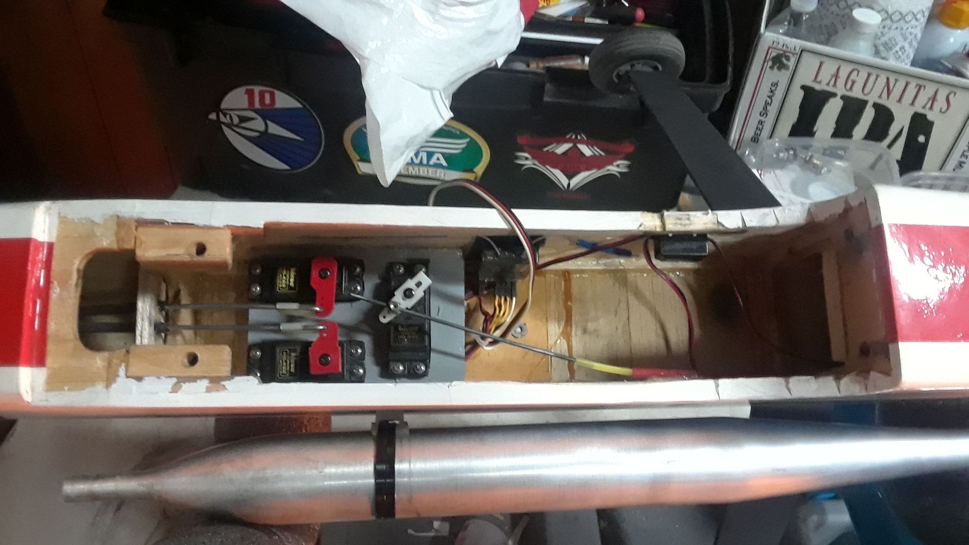

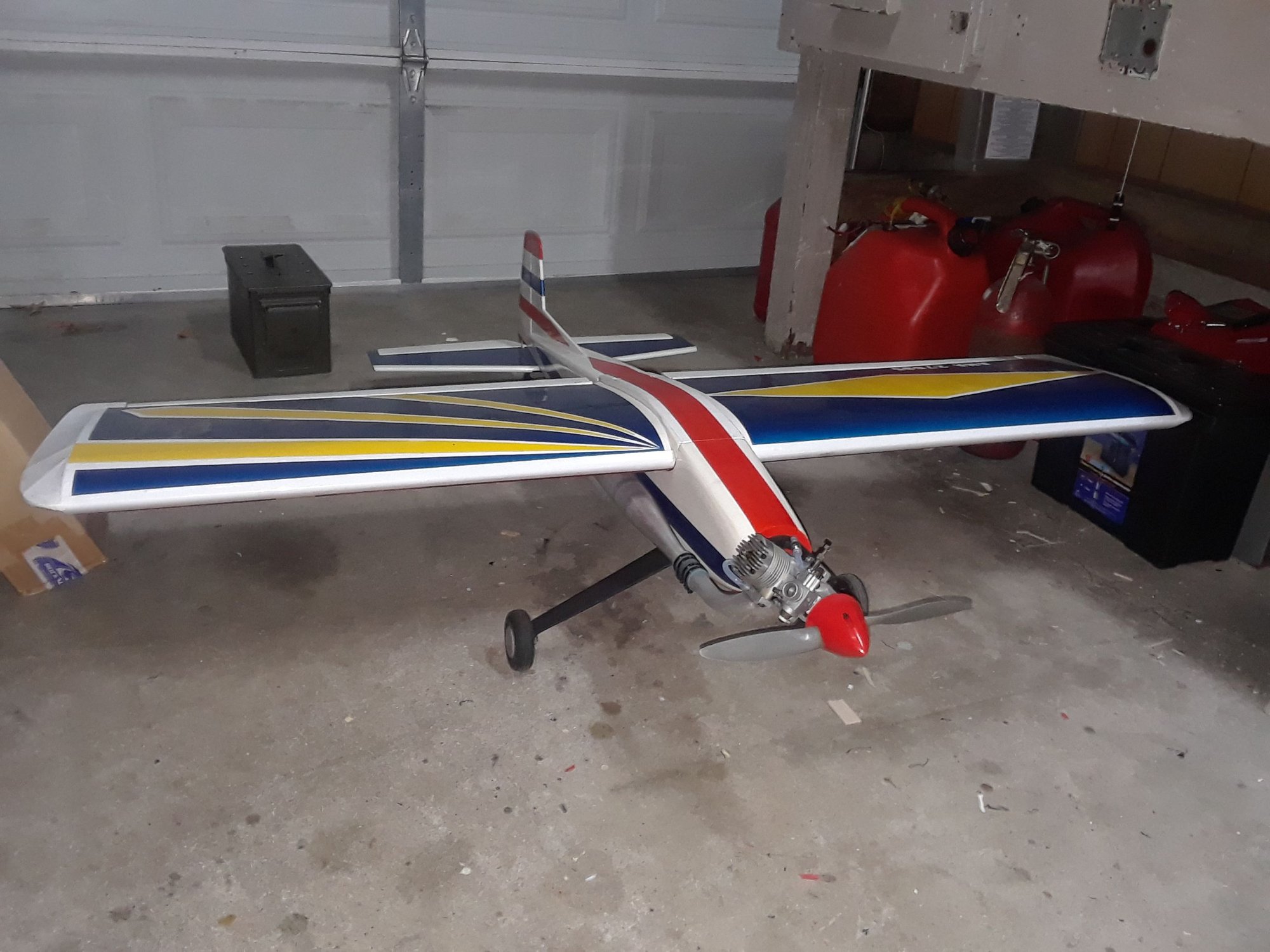

I got this airplane some time ago, I'm just about done with the refurbish ( have to work on the wing now ) and would like to ask if any one has an idea where the CG location is, I have a way to calculate the 30% position if I have to but I want to try RCU first.

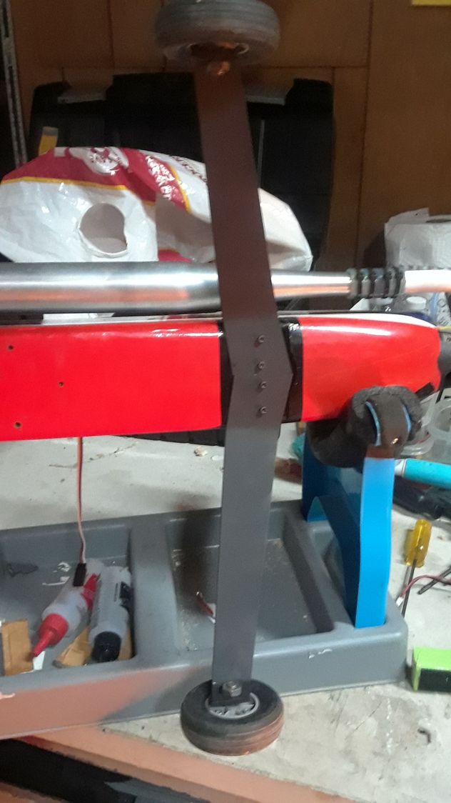

It came with an OS Max 60 and a Mack pipe, turning a 11/7, I converted it from tricycle to tail wheel to eliminate a lot of dead weight it had on the nose and the tail, removed the servo tray and build a new one, the landing gear came from BTE models ( Venture ) the original metal gear weights twice as the new one, and painted the new gear black, added Robart 2 3/4 scale wheels ( had them ) clean the engine, pipe, heather, new APC prop, I think I easily removed nearly a pound off of it, may add the dual Aileron servo, but for now, I will fly it with the one it has on the wing.

Agreed on the standard CG, I suppose I'll start with about 33% CG, since it has a rectangular wing, I'll set the CG over the spar, actually I did that a few hours ago, I used the 1300 mah LIFE bat to bring it to balance by placing the batt juat behind the wing saddle inside the lower part of the fuse.

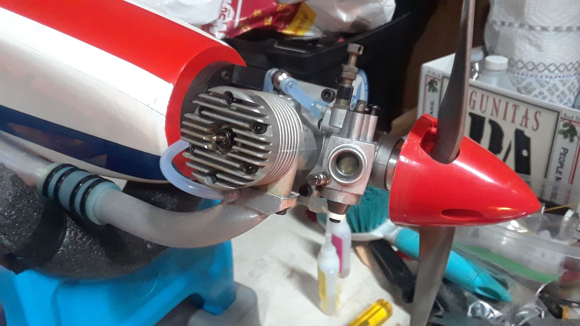

Engine test run.

Maiden is done, all went well, CG is right on, this airplane is just a joy to fly, couldn't be more happier.
