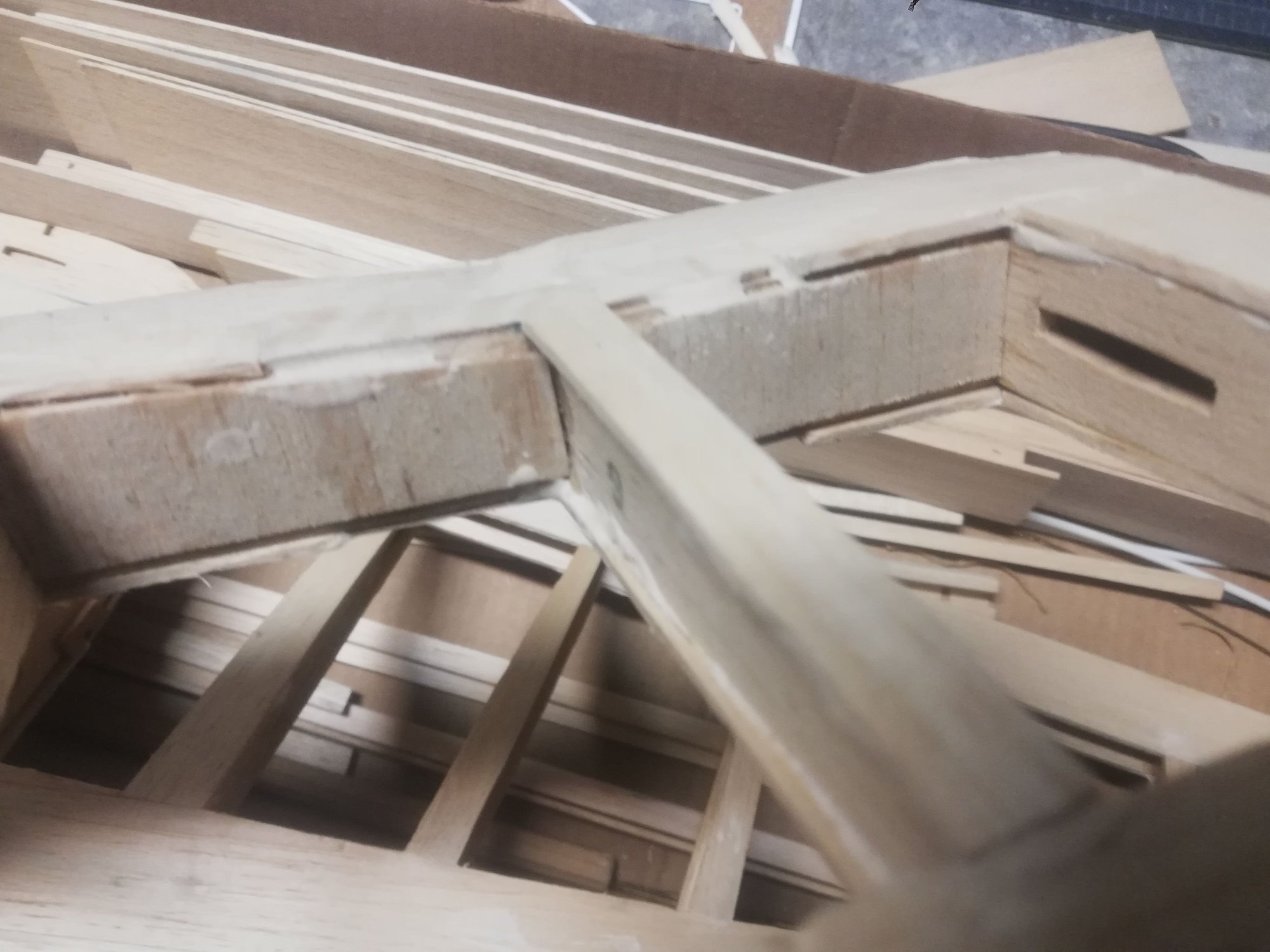

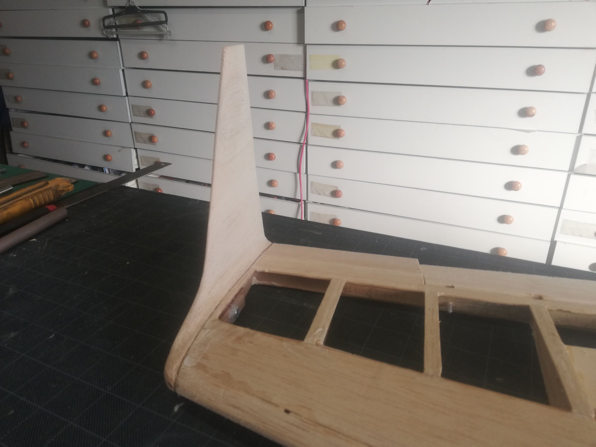

The tail part, a lot of work already done...ventral fin in place, delta fins to go.
The construction quality example
Another good example...

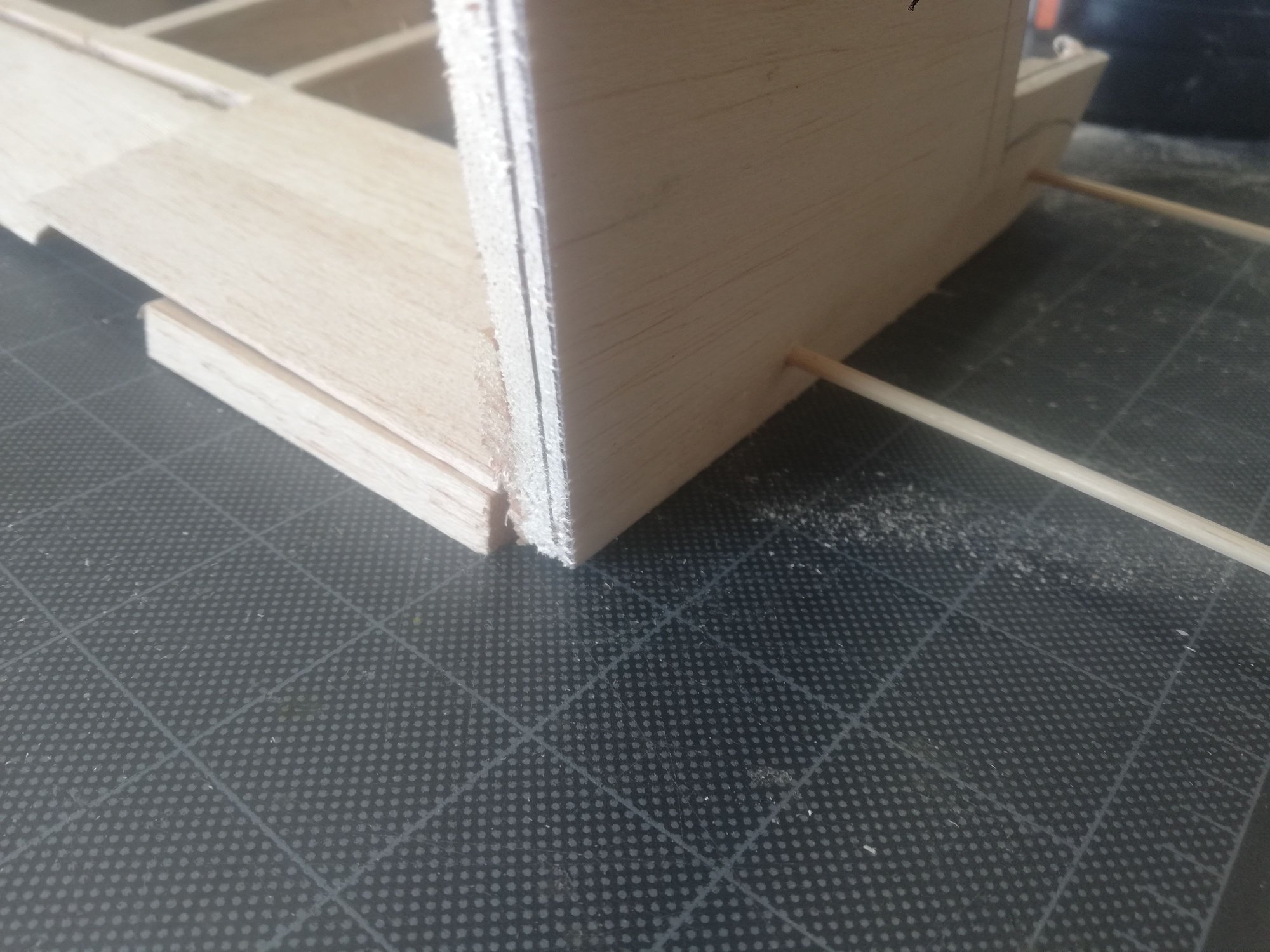

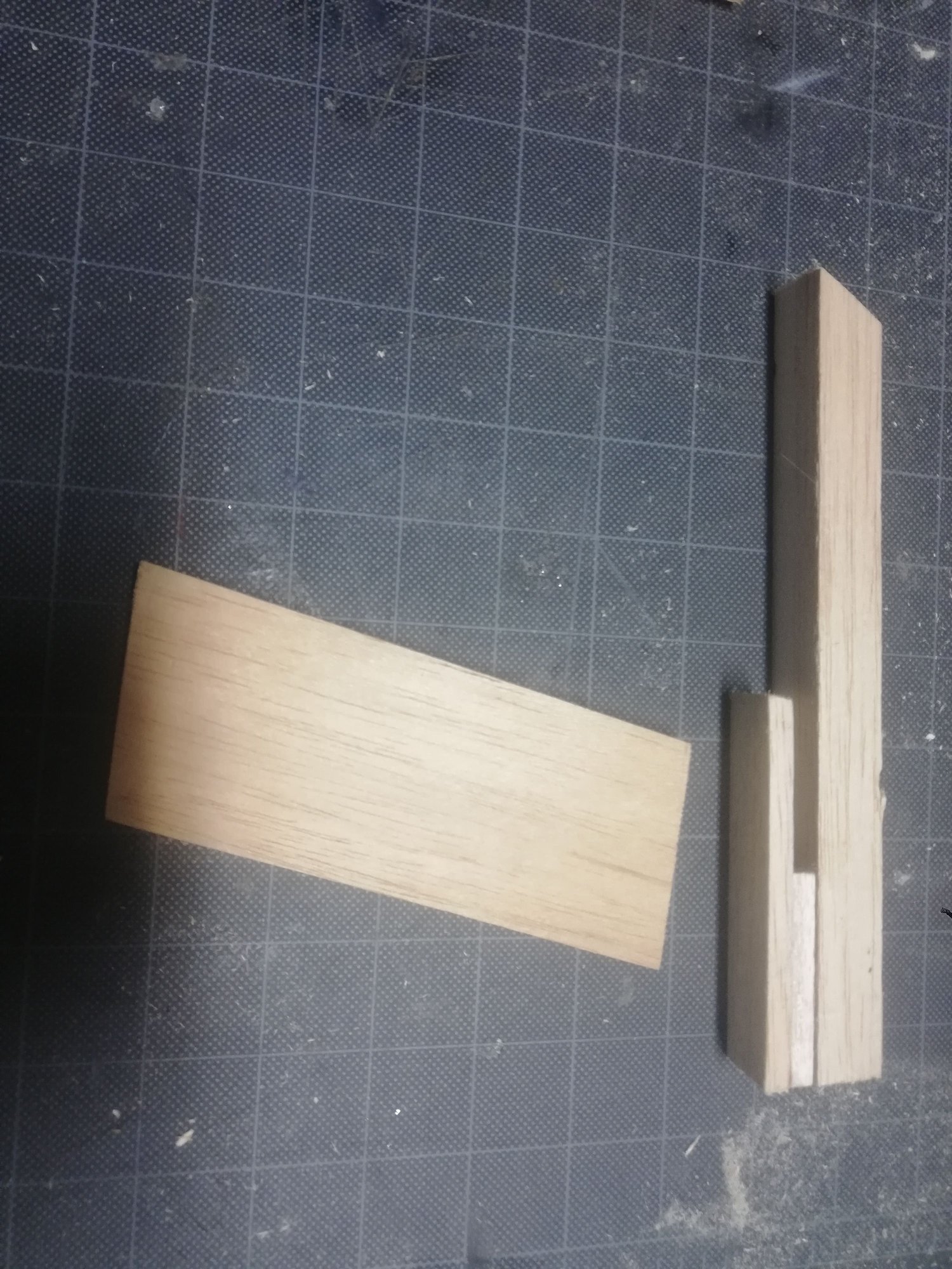

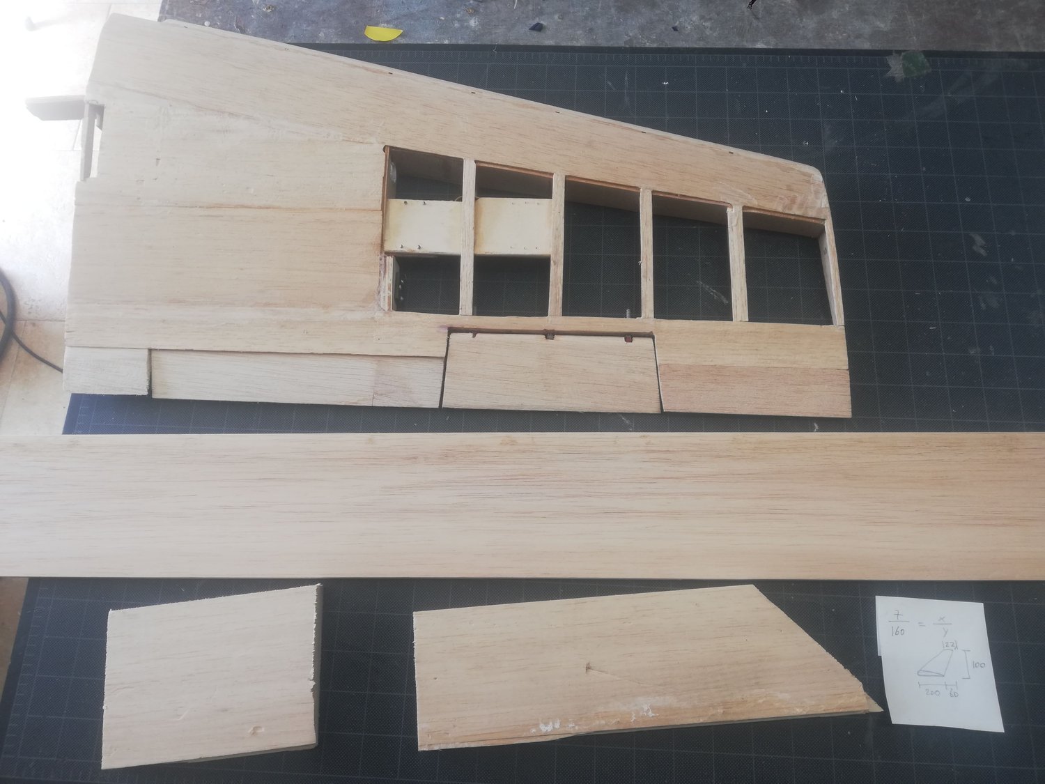

Horizontal stabilizer, made from 6mm balsa plank, solid, and 1mm plywood reinforcement
Again construction...

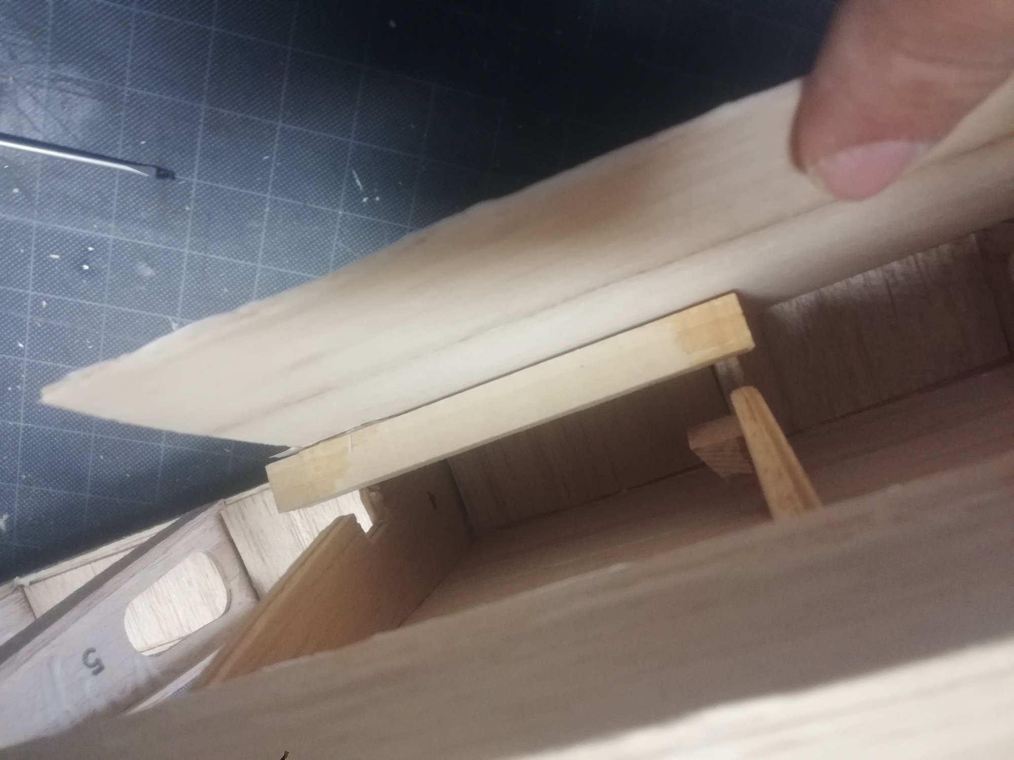

Evidence of problems
last vertical stabilizer parts and rudder.

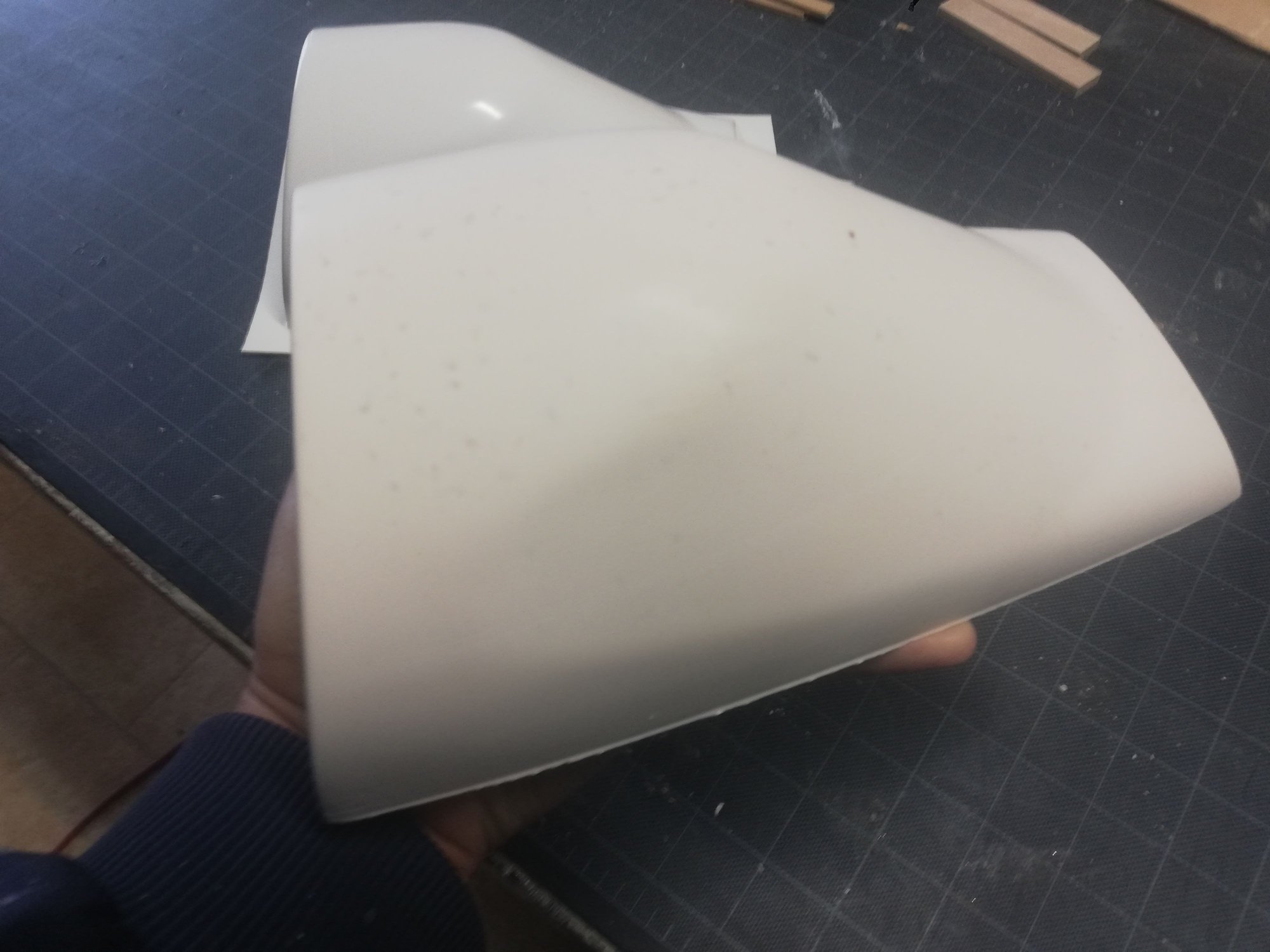

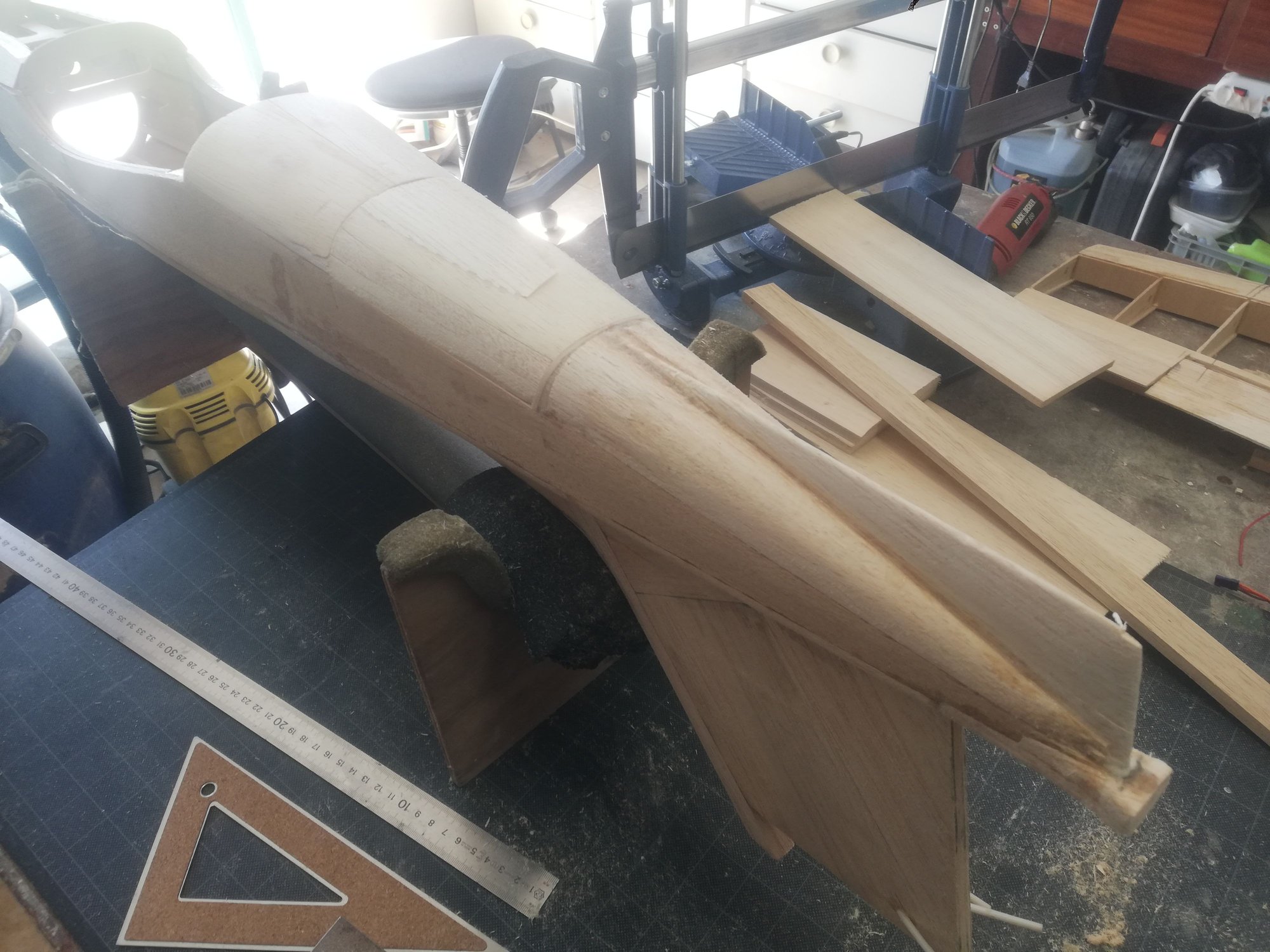

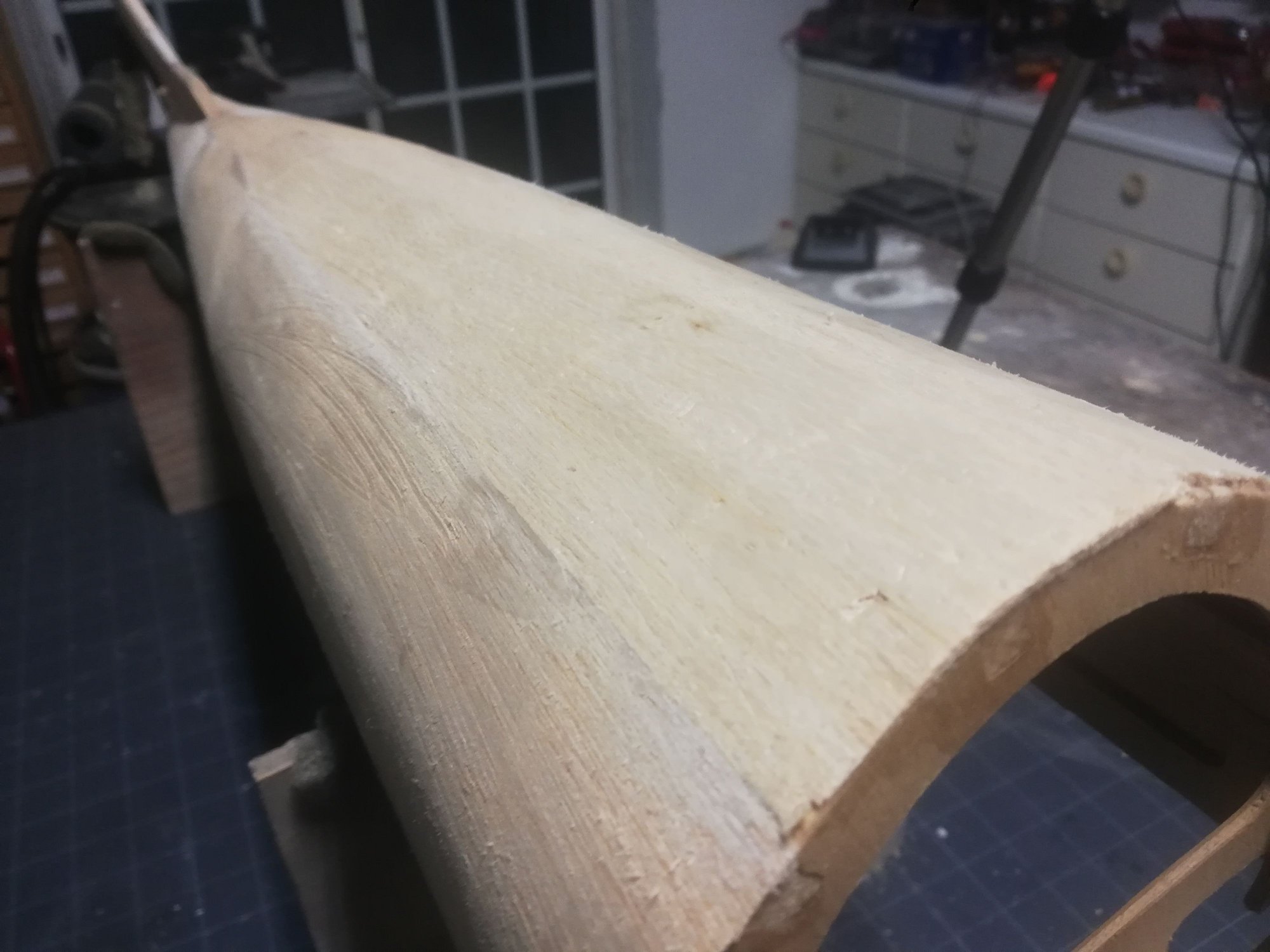

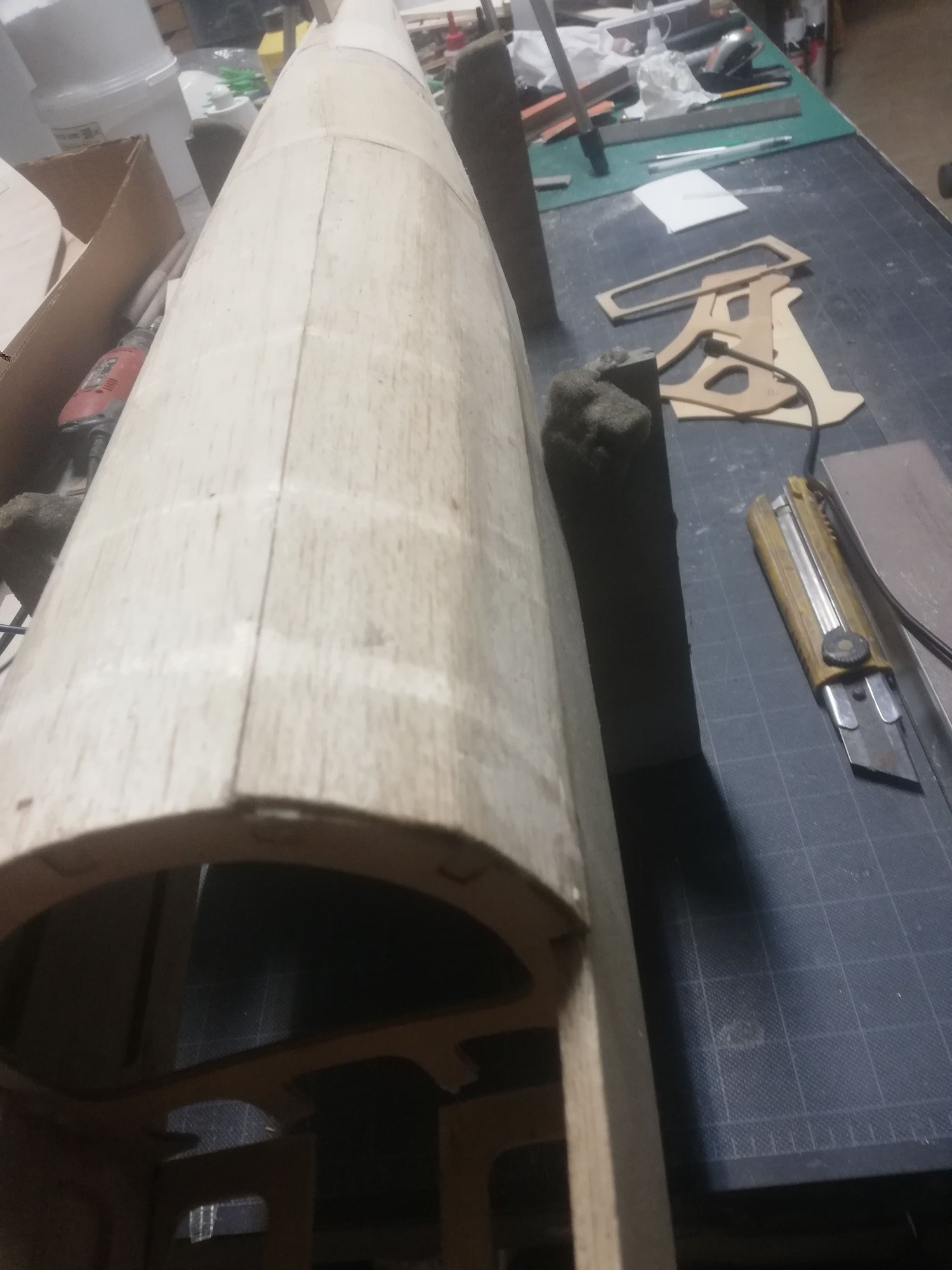

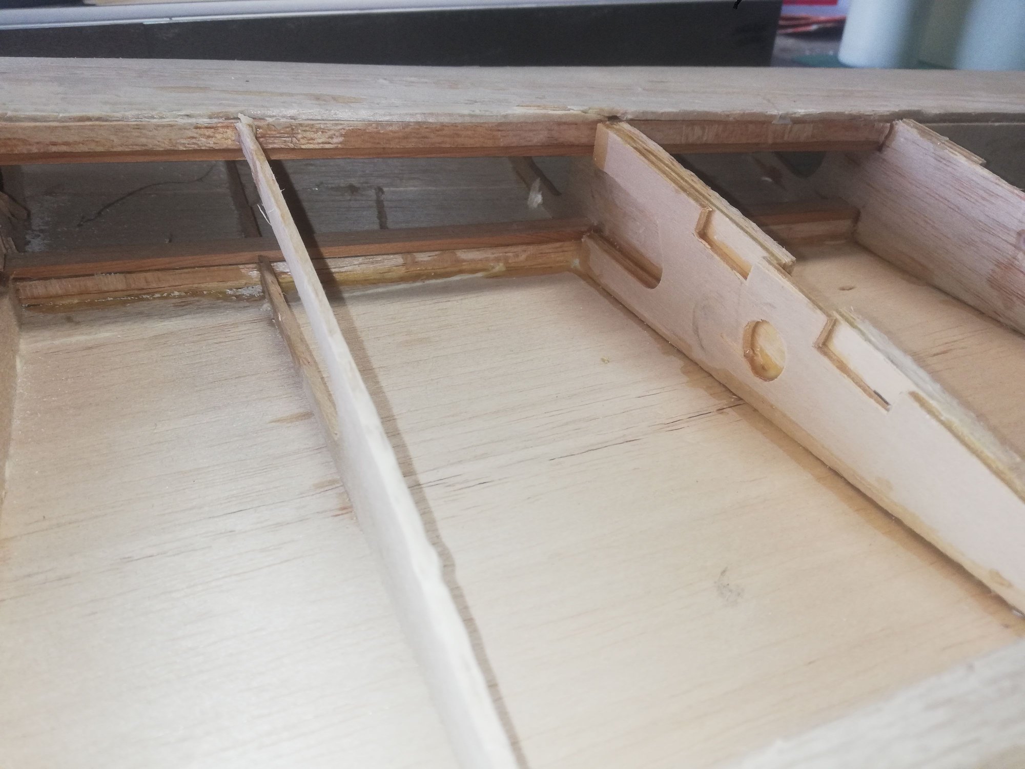

Today I started with some sanding of the fuselage and straightening a twisted former.
Then I casted the Cowl and canopy, you never know when you need one and I do not know how hard is to find one...and as I have a vacuum forming machine, I like to keep the moulds.

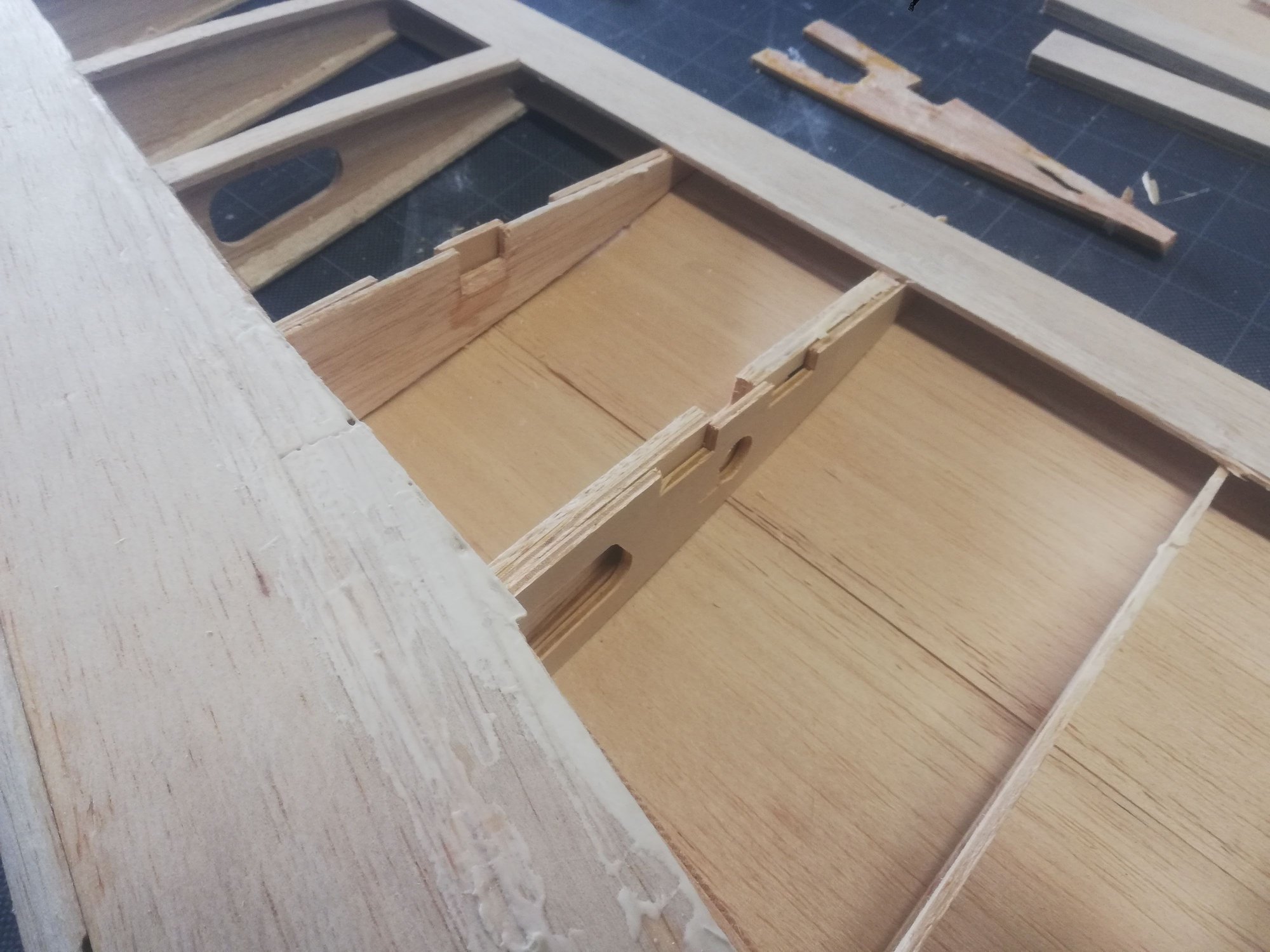

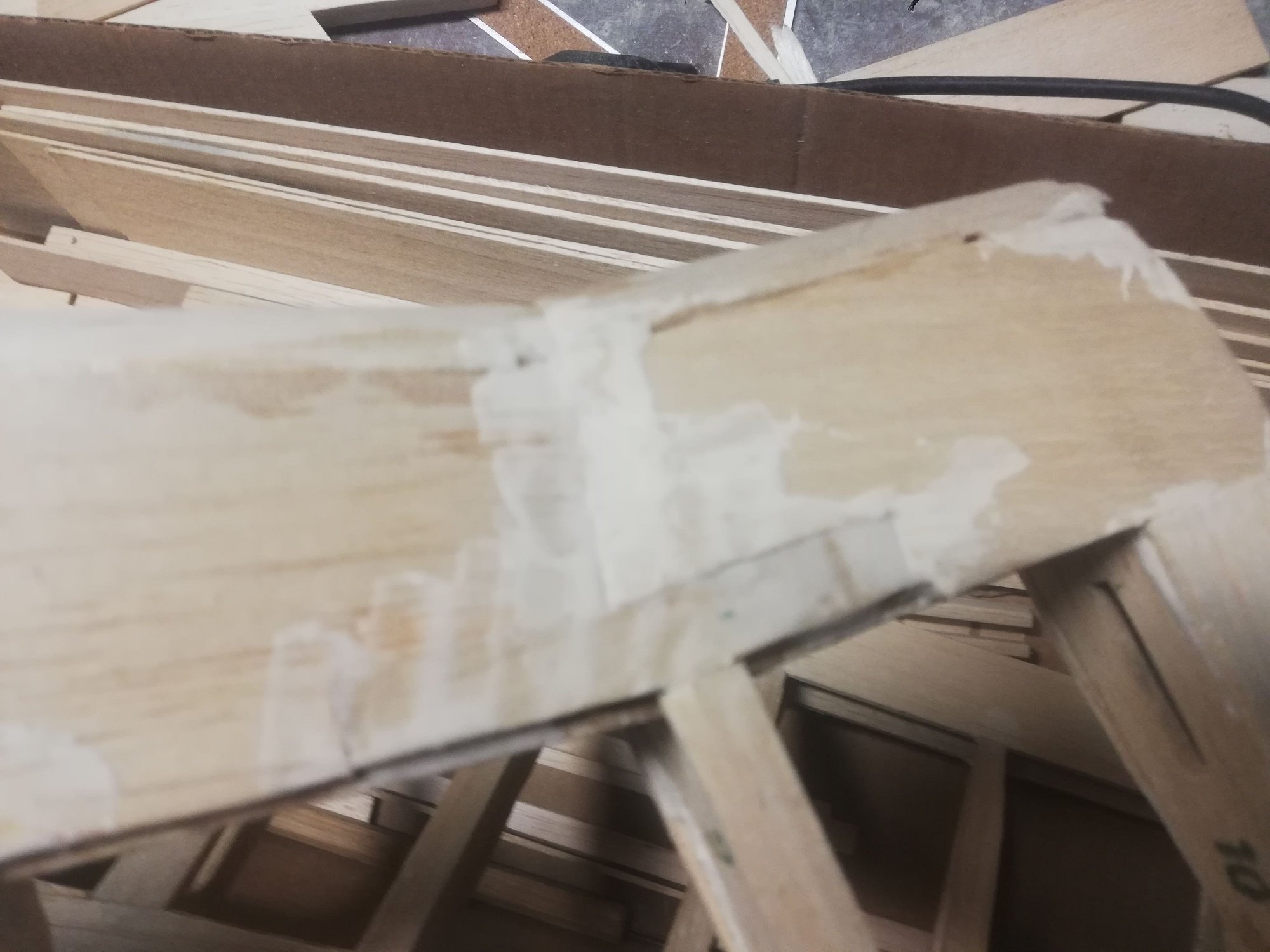

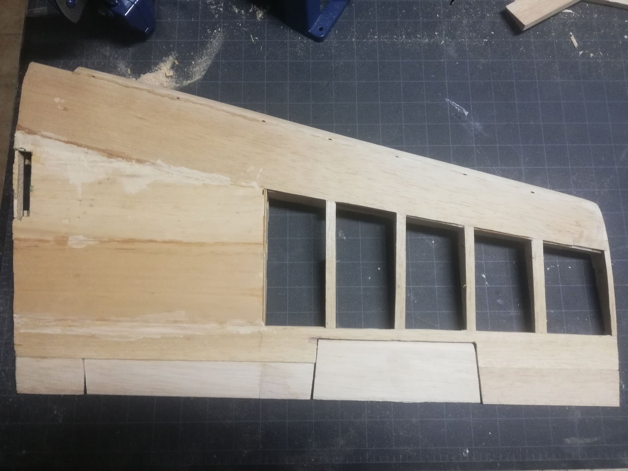

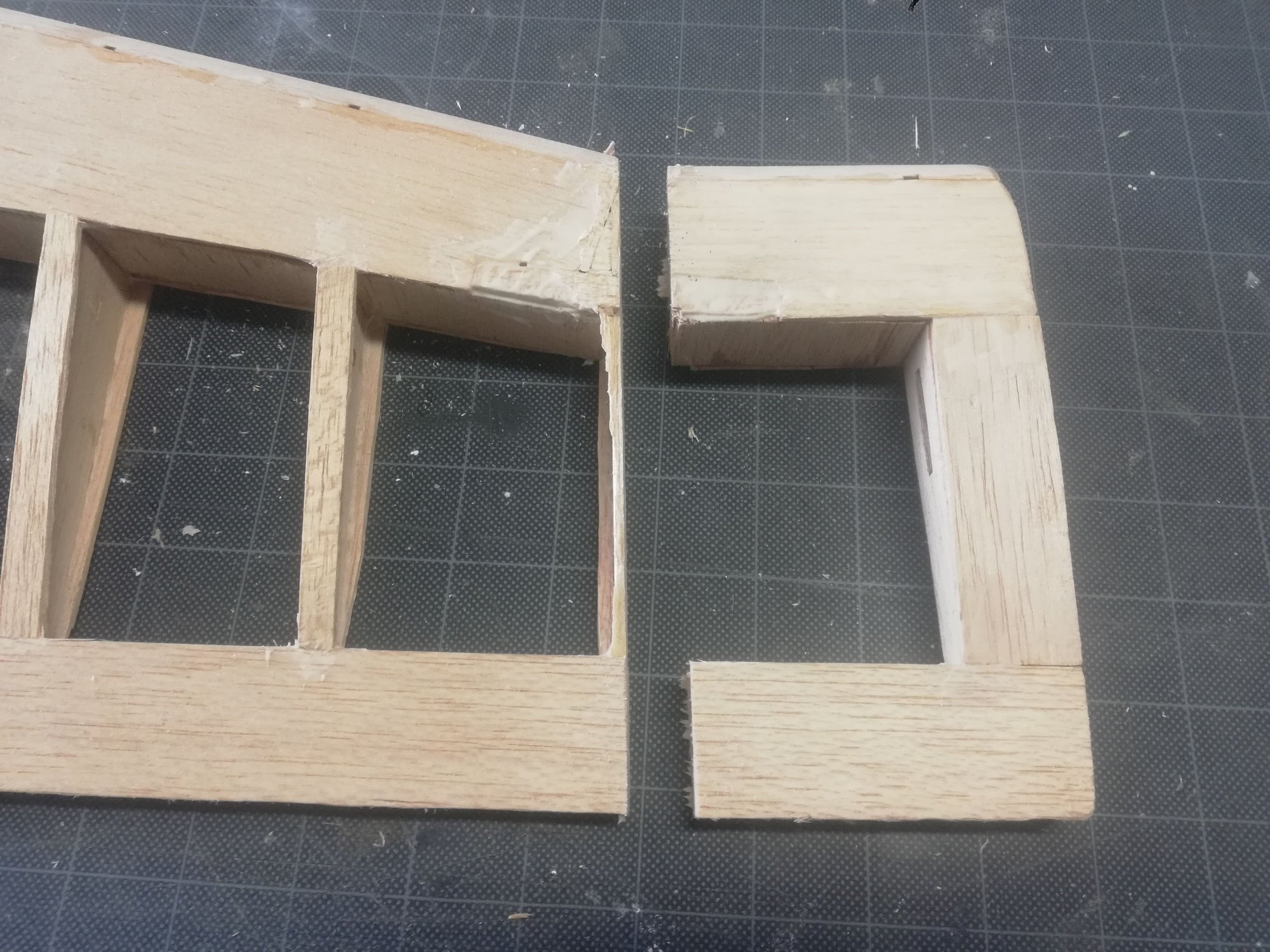

I decided to try to save the kit wings, but I was very worried with the construction so I removed the bottom wing skins...and I am glad I did: both fixed gear mounts were removed easily by hand, one of them coming attached to the wing skin and I believe that there is two wing spars missing on ea wing...photos and video will detail these issues.
I also took the opportunity to saw the extensions of the wings off, and now starting to think on the winglets.
Last but not least disaster struck: I found out I am out of cyano
Quick trip to the computer to ordered some, but still some days to delivery. Well...I have a lot of carving and sanding to do, just the winglet molds will take at least a day only for the plug.
Fly safe, be safe, good health to you all.
Fuselage before sanding...
...and after sanding
Twisted former before correcting...
...and corrected to what I could do.

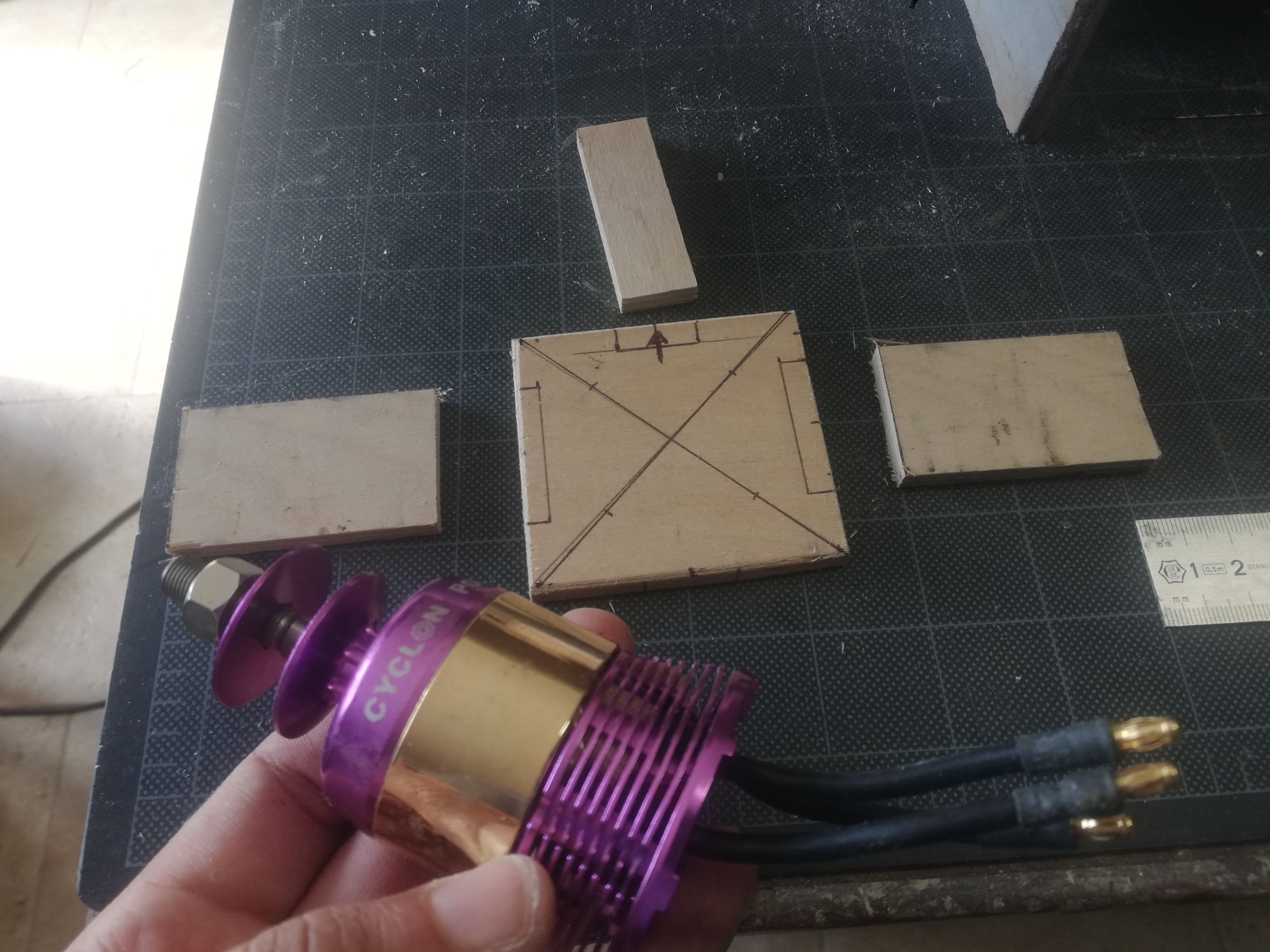

The motor I will use: Cyclon Power 55 3T, 1400W on 5 cell and 11x6 at least, maybe I can change for a 10x8.

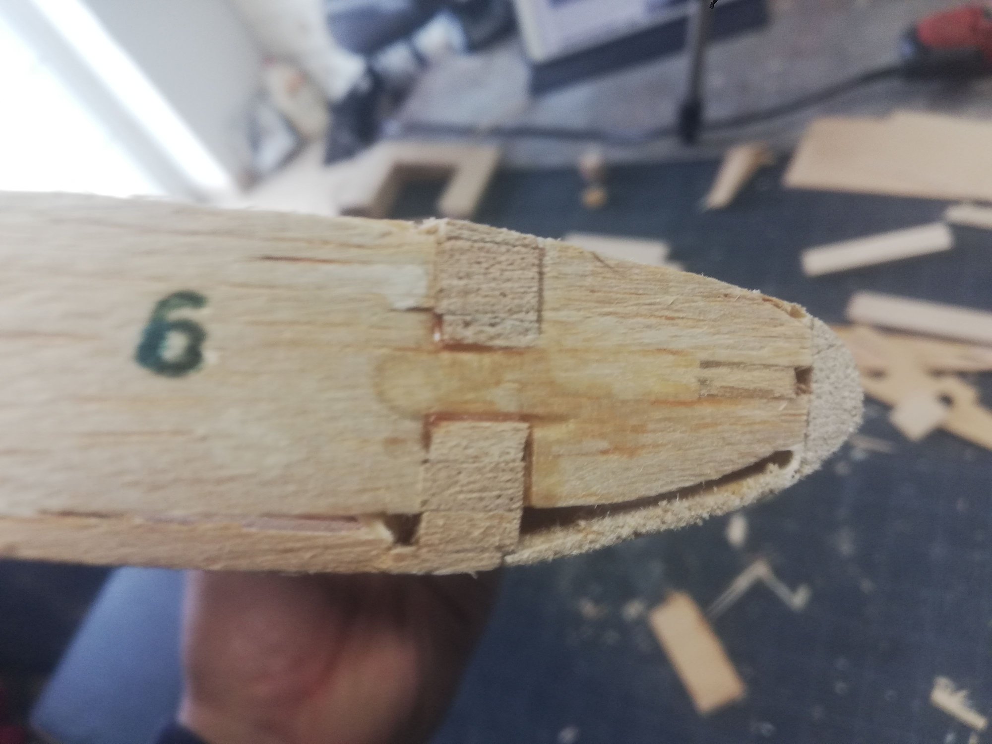

Incorrectly applied wing skin
Dry fitting retractable landing gear wing rib doublers

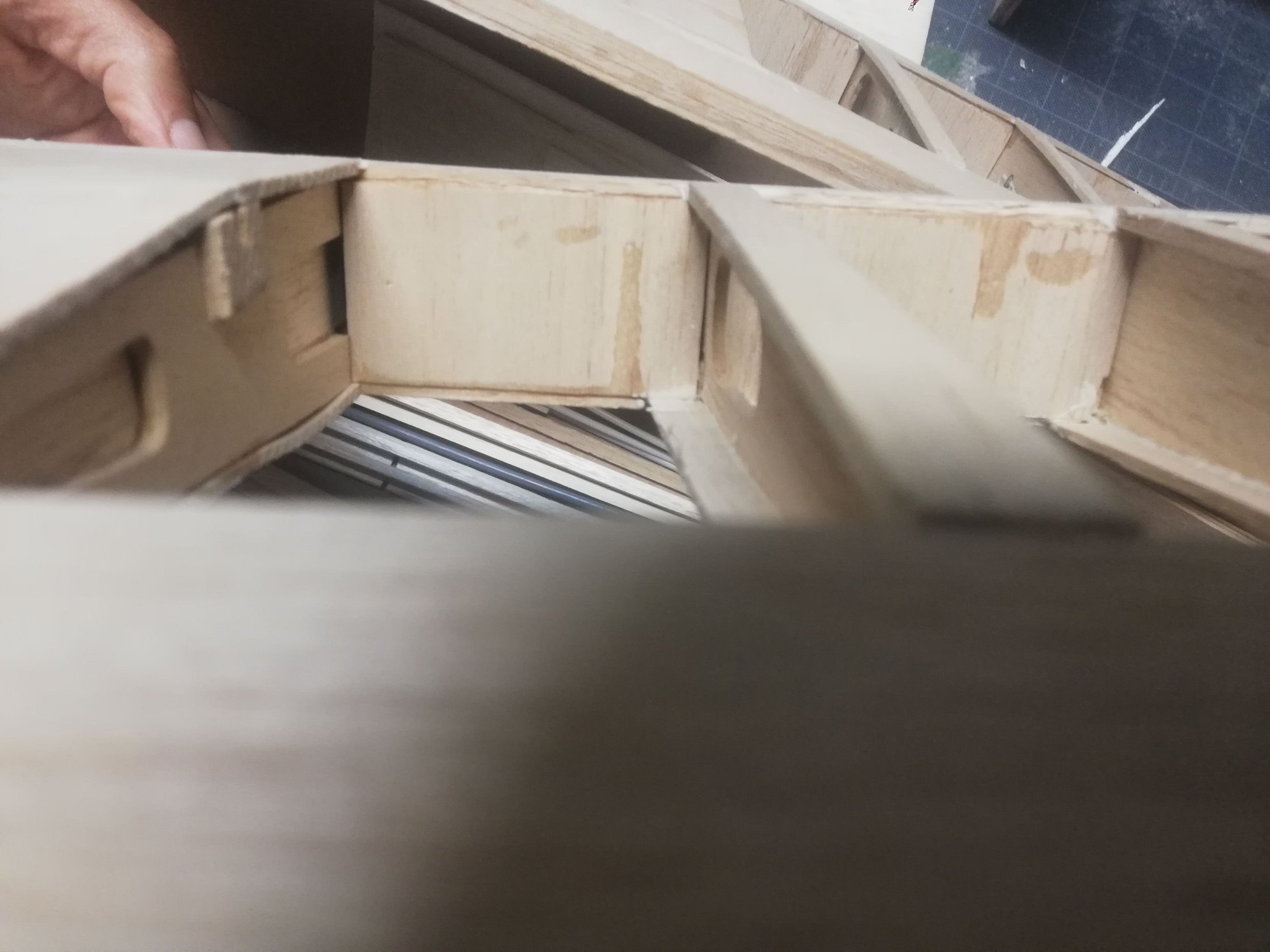

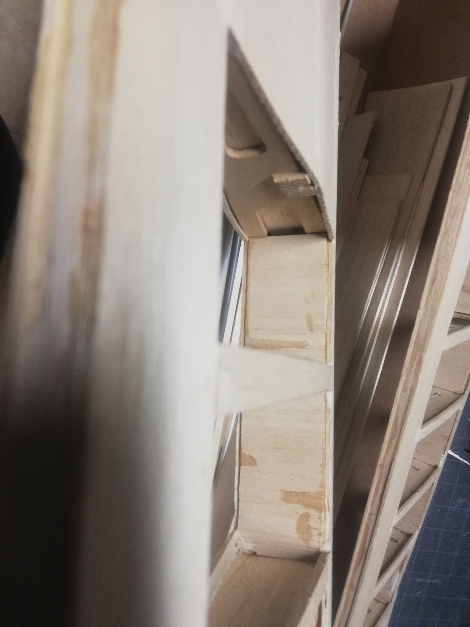

poorly fitted shear webs
Extension out, now a Lear 31 wing , winglet to go
don't even know what to say...

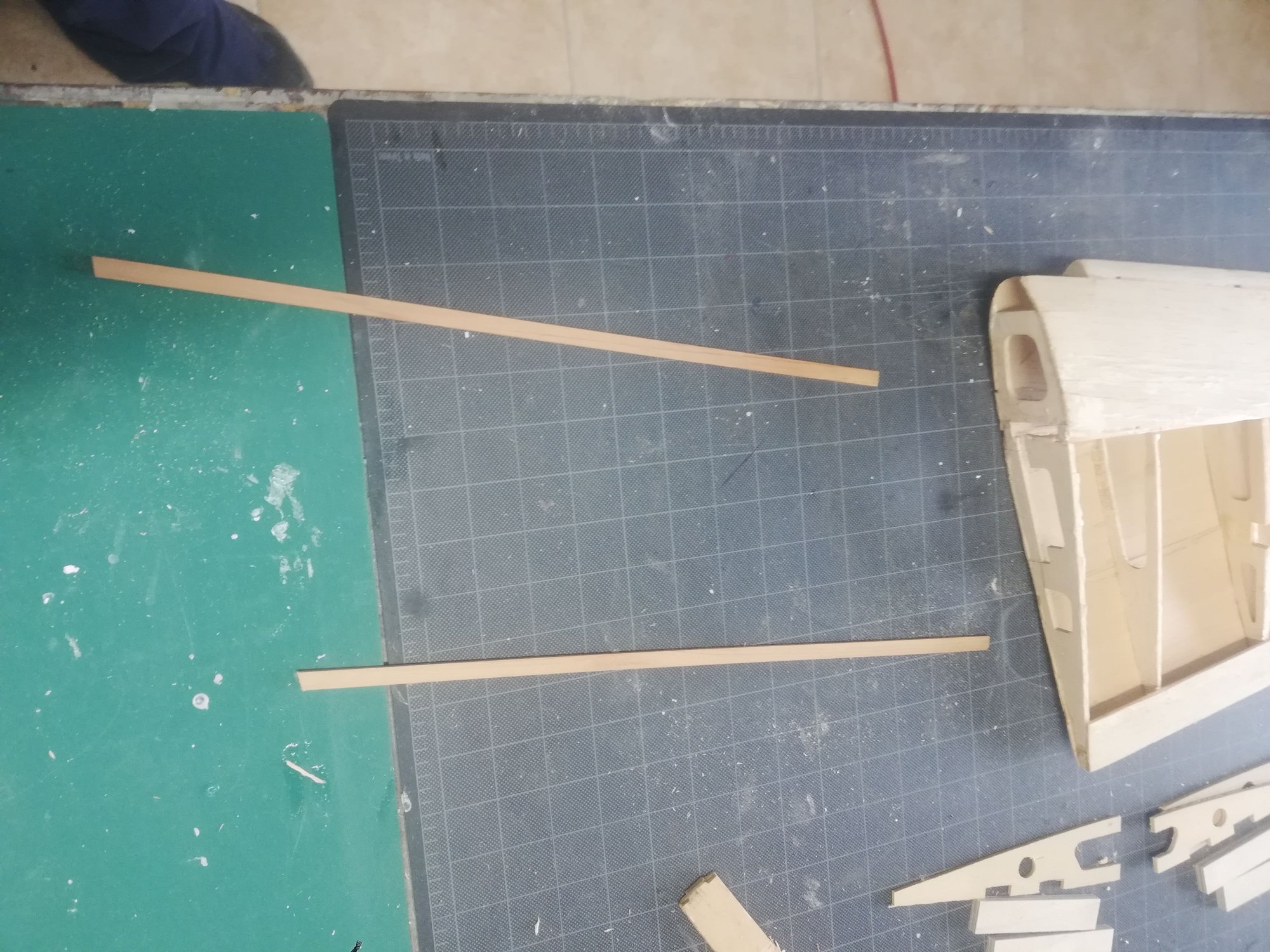

the space on the die cut wing ribs, one layer of wing spar missing. I glued in 2 pine 3 x 10mm spar, about 40cm long on ea wing
Additional spars ready to glue
spars and rib doublers in place
Casting the canopy
Cast for the canopy

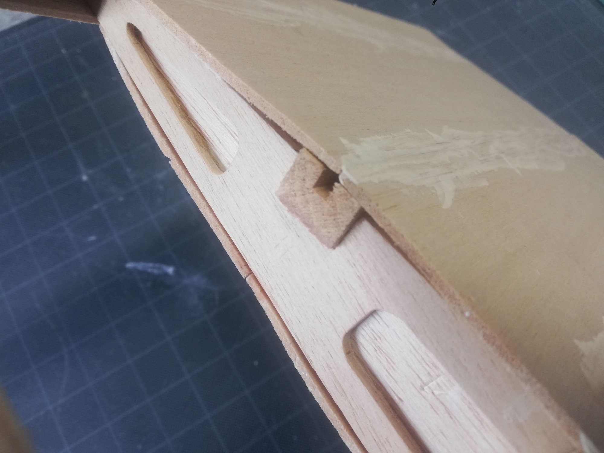

The fixed landing gear came attached to the wing skin, no torque block, no glue
A better view of the space on the ribs where now lies the additional pinewood spar

Additional wing spars glued in place
another view, with wing roots now matching nicely

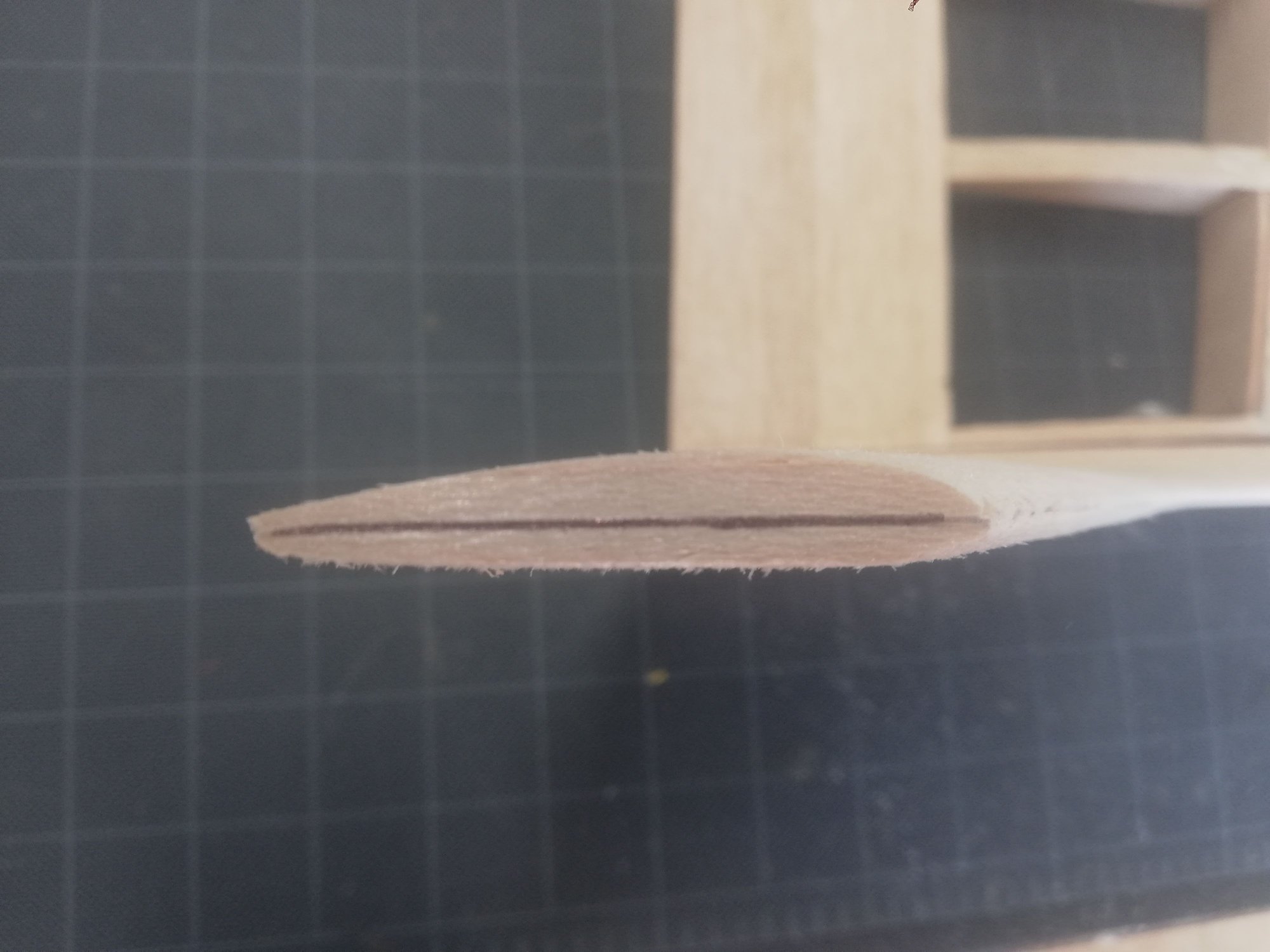

Starting the work on the ailerons, and fitting the fixed tip trailing edge
One piece solid balsa aileron
The hardwood to be glued between wing ribs and skins, to take the pin hinges.

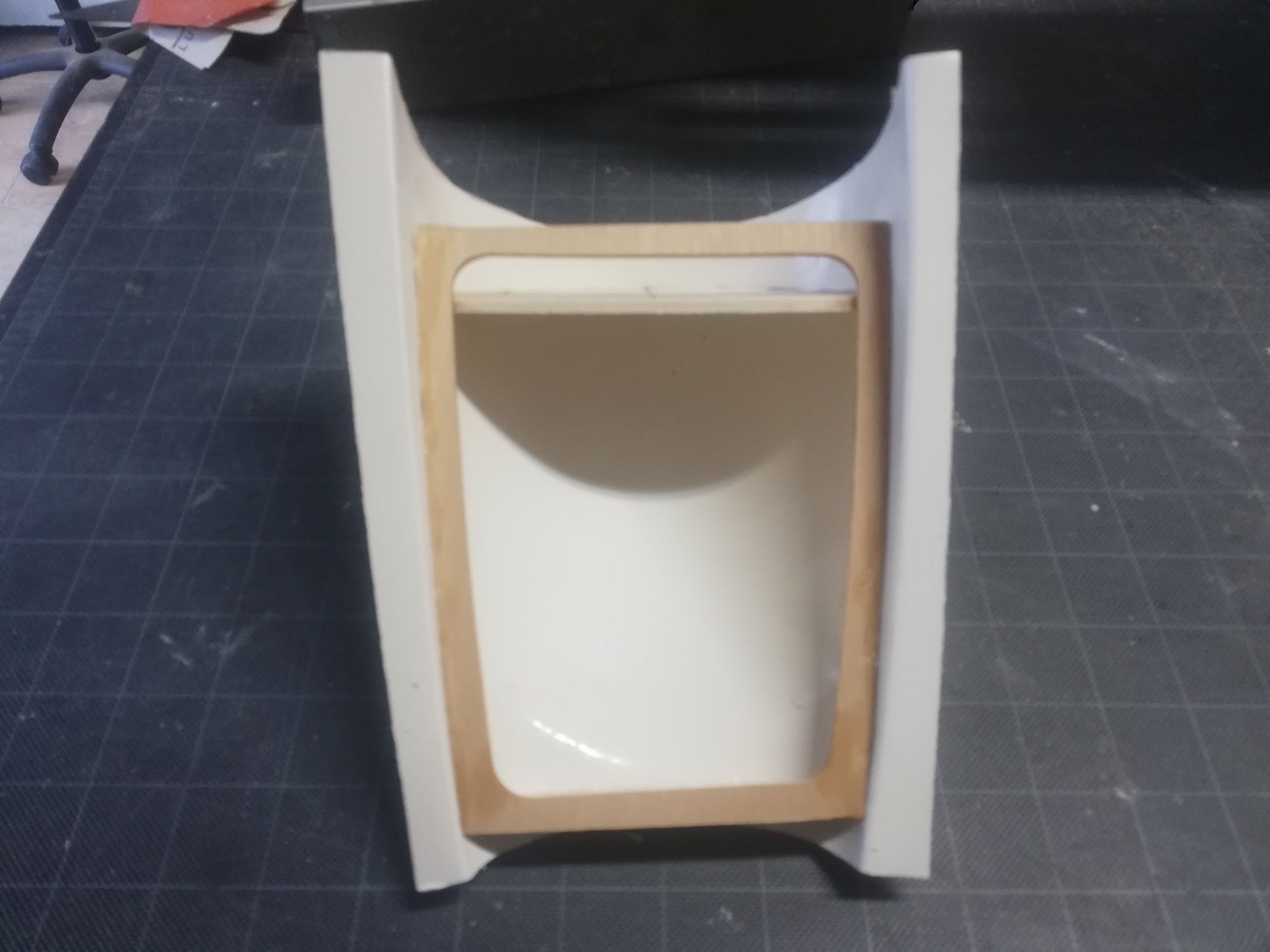

I have been able to make a decent progress on the rear of the fuselage, rear hatch, the engine mount. As I am making a lot of modifications on the kit, sometimes it takes a good time to make something happen...like for example the motor mount.
The videos I am uploading to my channel explain in more detail the modifications. For those who have not found it in the search, here is the link:
Rear underside of the fuselage profiling finished, only awaiting the Delta fins.
Rear hatch, Solid balsa (hollowed on the inside) instead of built up structure

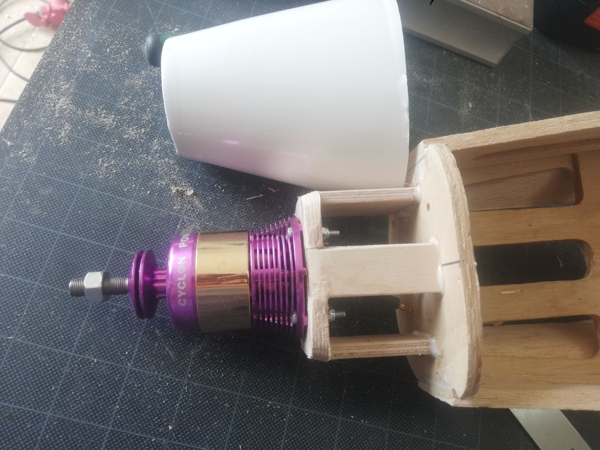

Fabricating the parts for the engine mount
EXCELENT! I Due to the motor need to be 45mm away from the original kit firewall, I have space to install the landing gear retracting the wheel FORWARD, as per the full size...so lucky!
Dry fitting to check
Motor mount glued with 5 min epoxy and motor attached to start cowl adjustments
Starting the canopy trim
Inside structure for the canopy
Almost there, but already looking nice...

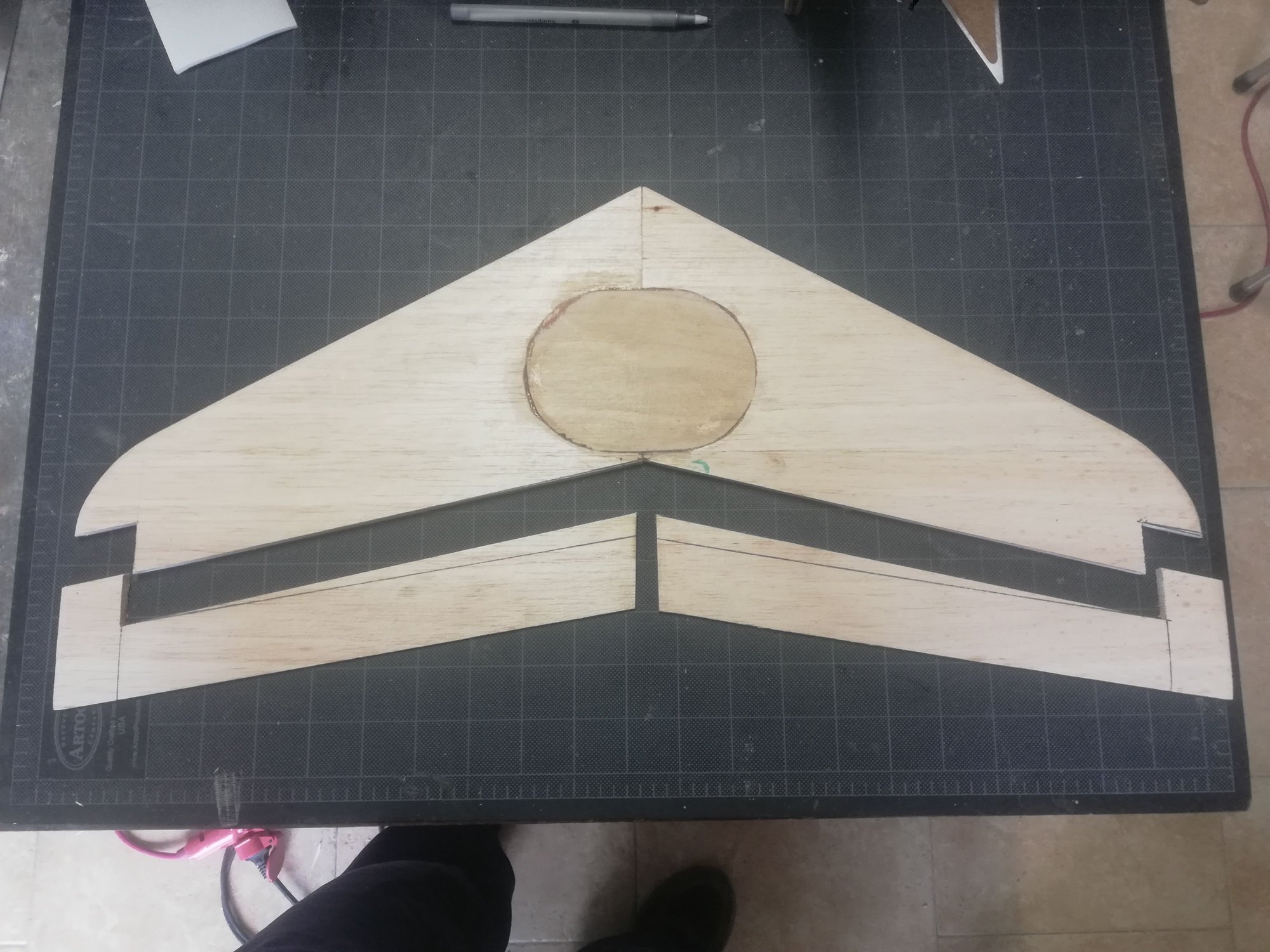

Starting to cover the horizontal stabilator...

The horizontal Stabilator modified to use scale like control surfaces (standard elevators lines visible)...as f I already did not have anything else to worry about...but it is worth it!

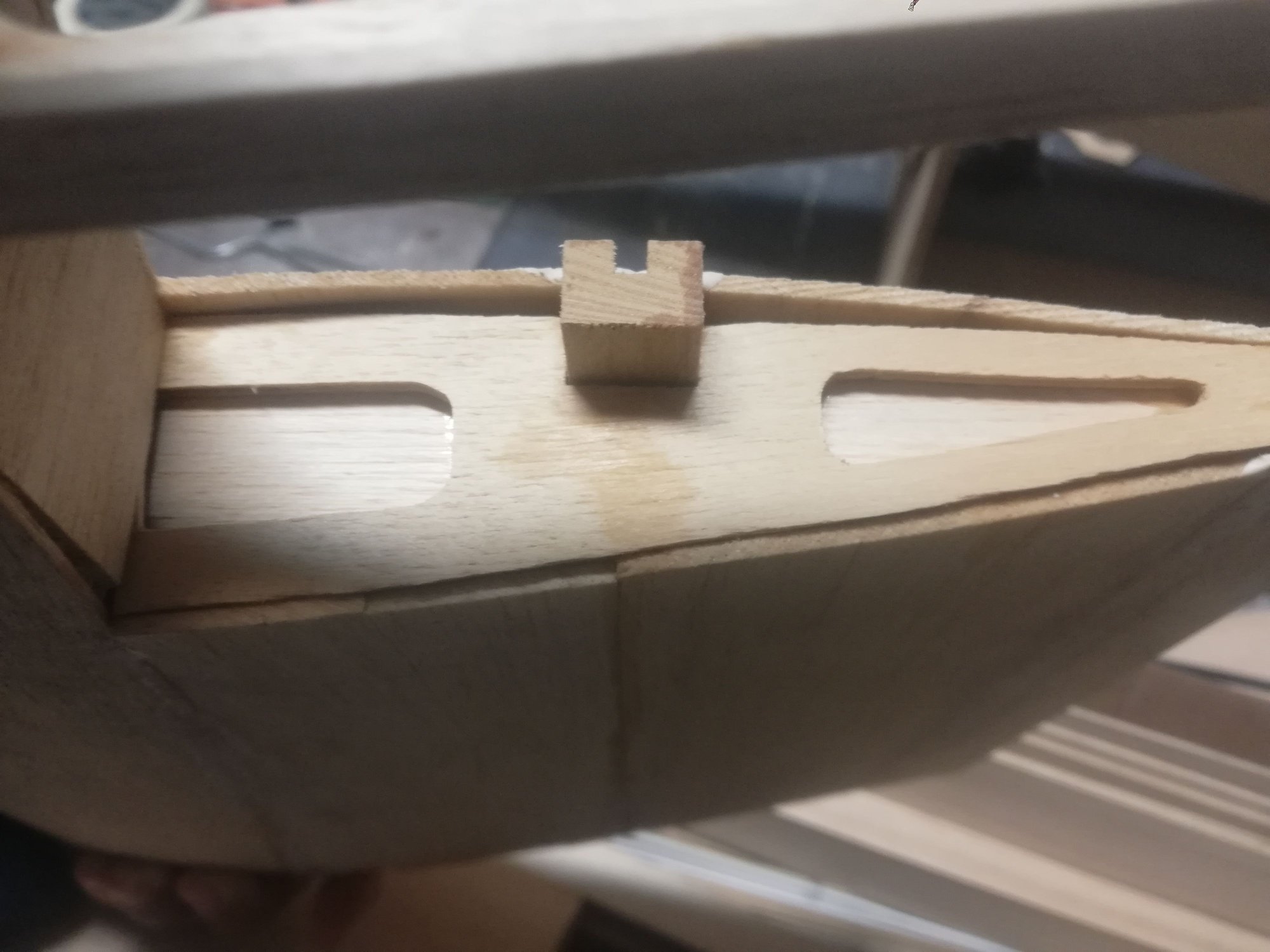

The horizontal stabilator mount, ready to receive the stab. The small marks are from a phillips screw driver. I normally do these in order to give the epoxy some more gripping area.

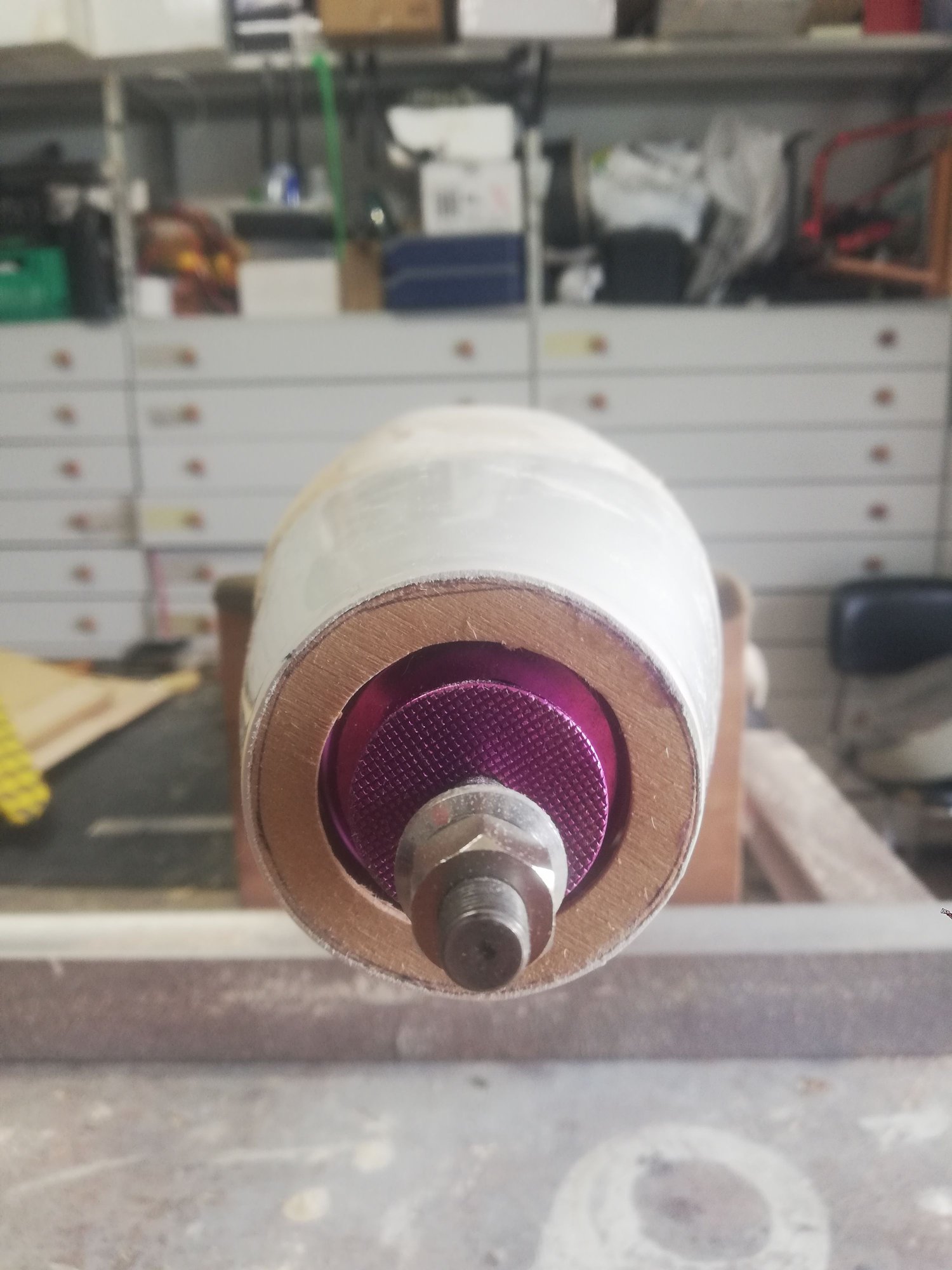

Almost finished fuselage. I have not decided yet if I cover it or if I fiberglass it...but probably cover.
Front view showing the nose cone-motor alignment (plywood ring still to be glued in place.
Always good motivation boosters these lets-see-how-it looks-already moments

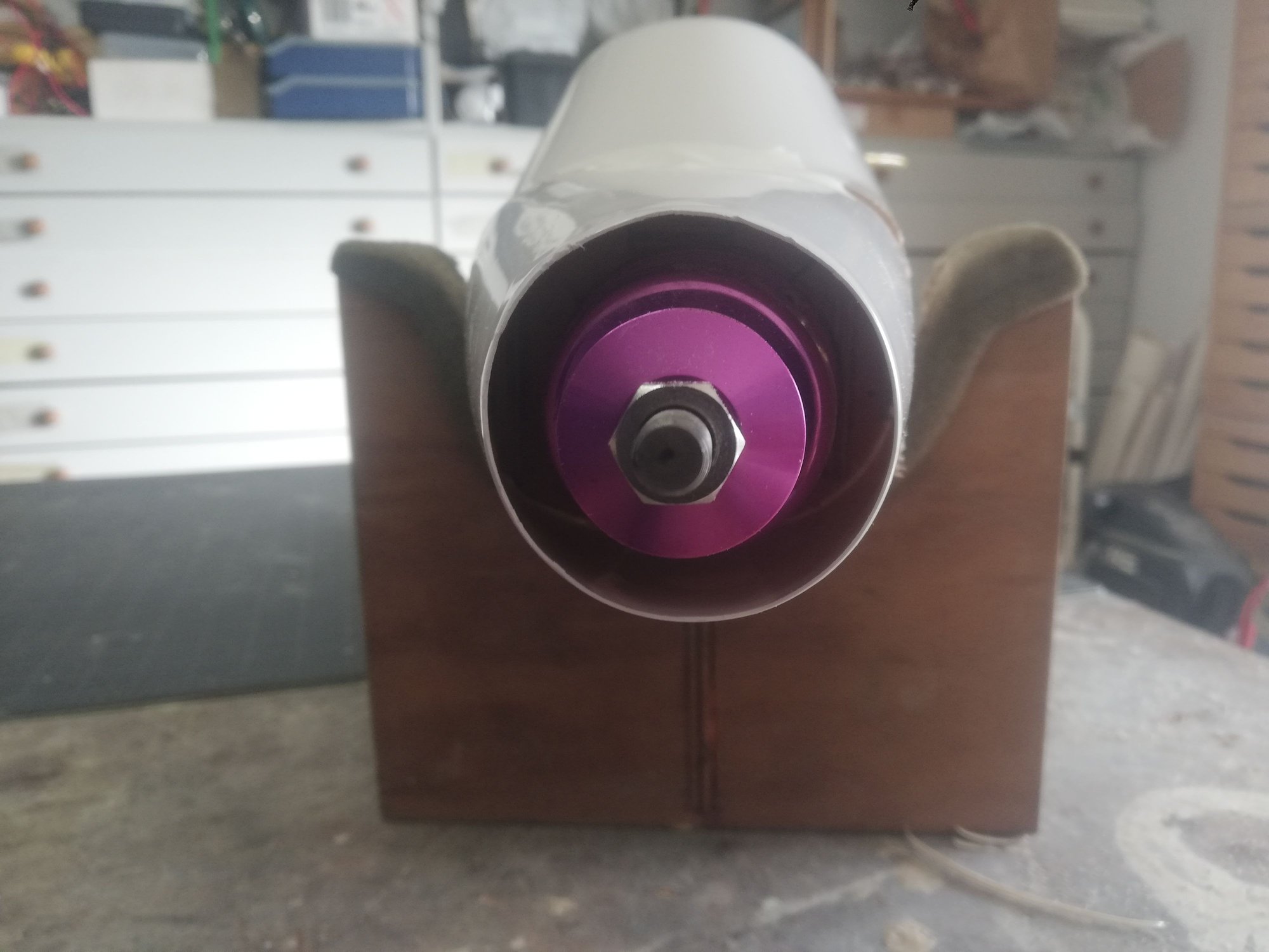

The cowl is secured with 3 neodymium magnets and the hatch with 4. Both are completely secure. I really like the no screws options.
The elevators are controlled by a single HS-5745MG (7 Kg 0.12s) and the rudder with a HS-475HB (4.4Kg), both already installed.
Tomorrow I will post the video detailing a little more these subjects and with two tips/tricks.
Front view: the spinner has a larger than noral gap to the cowl ring because there is no provision for cooling as this kit was intended for ic engines...this is were the cooling air will enter the cowl, and it will exit via the first two cm of the nose gear door.
another view of the motor-cowl alignment

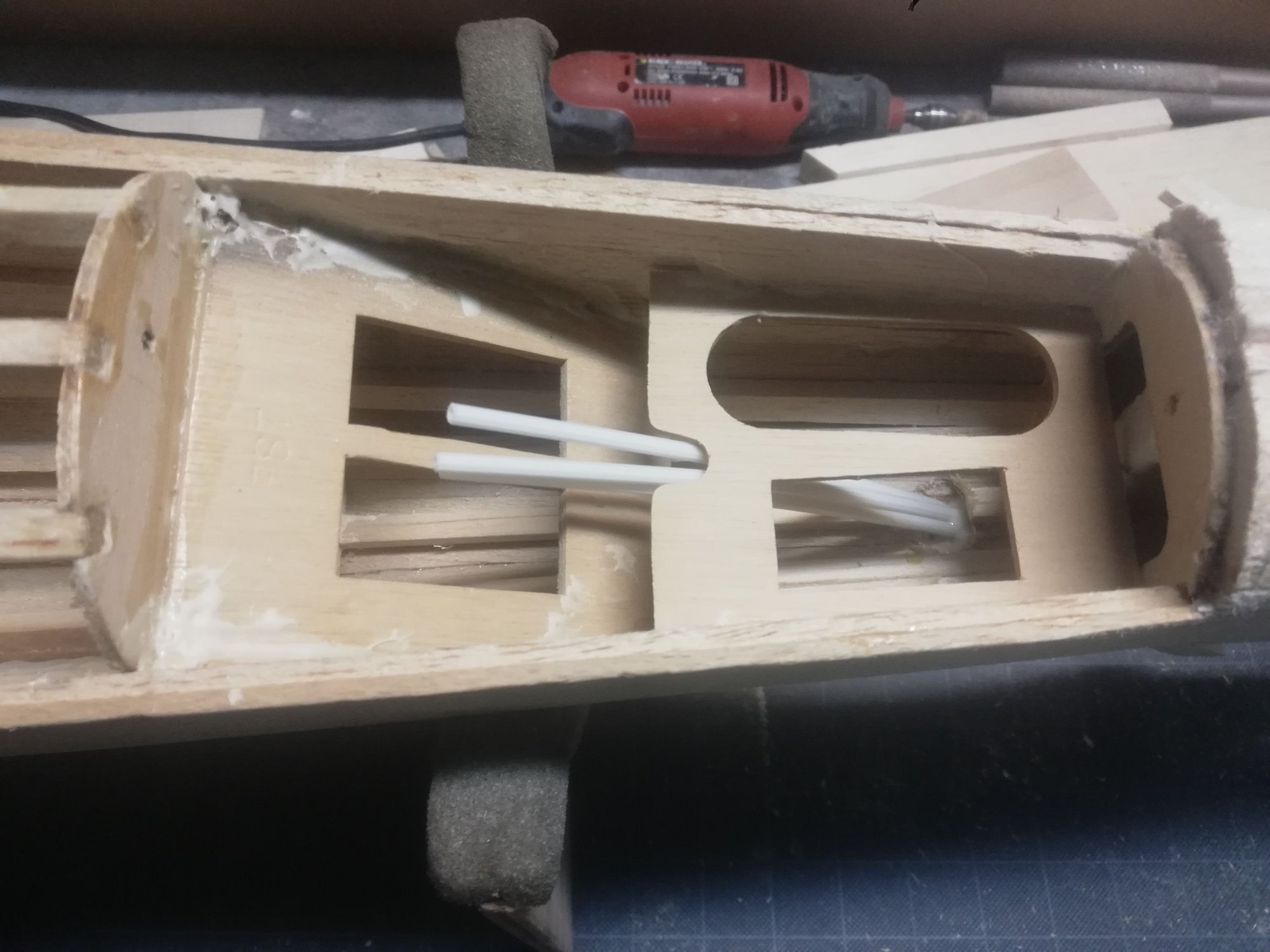

Fuselage servo installation. I had to enlarge the slot to the left in order to get some space for the elevator servo arm

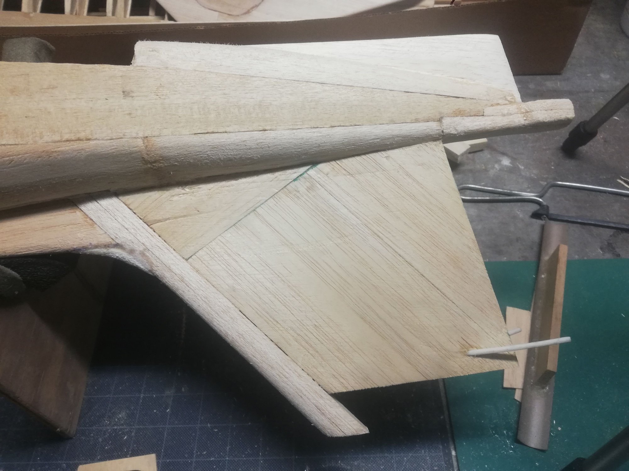

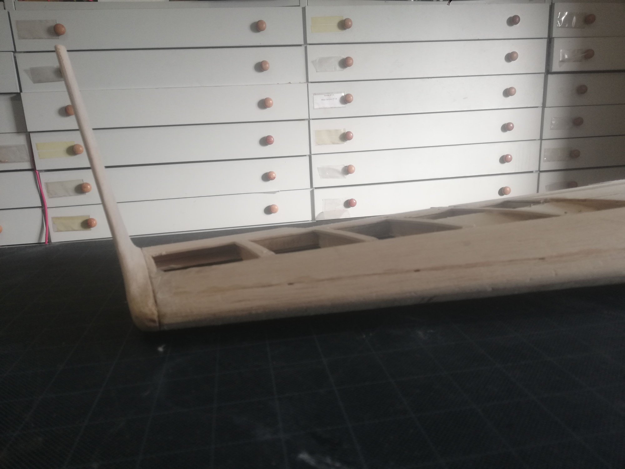

The big task was the winglet, I have finished one of them:
Starting the task: one 8mm balsa plank and some scrap pieces...now get the measurements. It will have scale dimensions to the kit wing tip chord (200mm)
After about half an hour, the profile is found. The strip of stock aileron was perfect to get the tilt angle
aligning and installing the two wood pins
After two and a half hours of a LOT of sanding and shaping and watching photos...the result. Again, the dimensions are scale.
front view showing tilt angle
the leading edge blending to the winglet is very complex, 45 min here
rear view
top view
