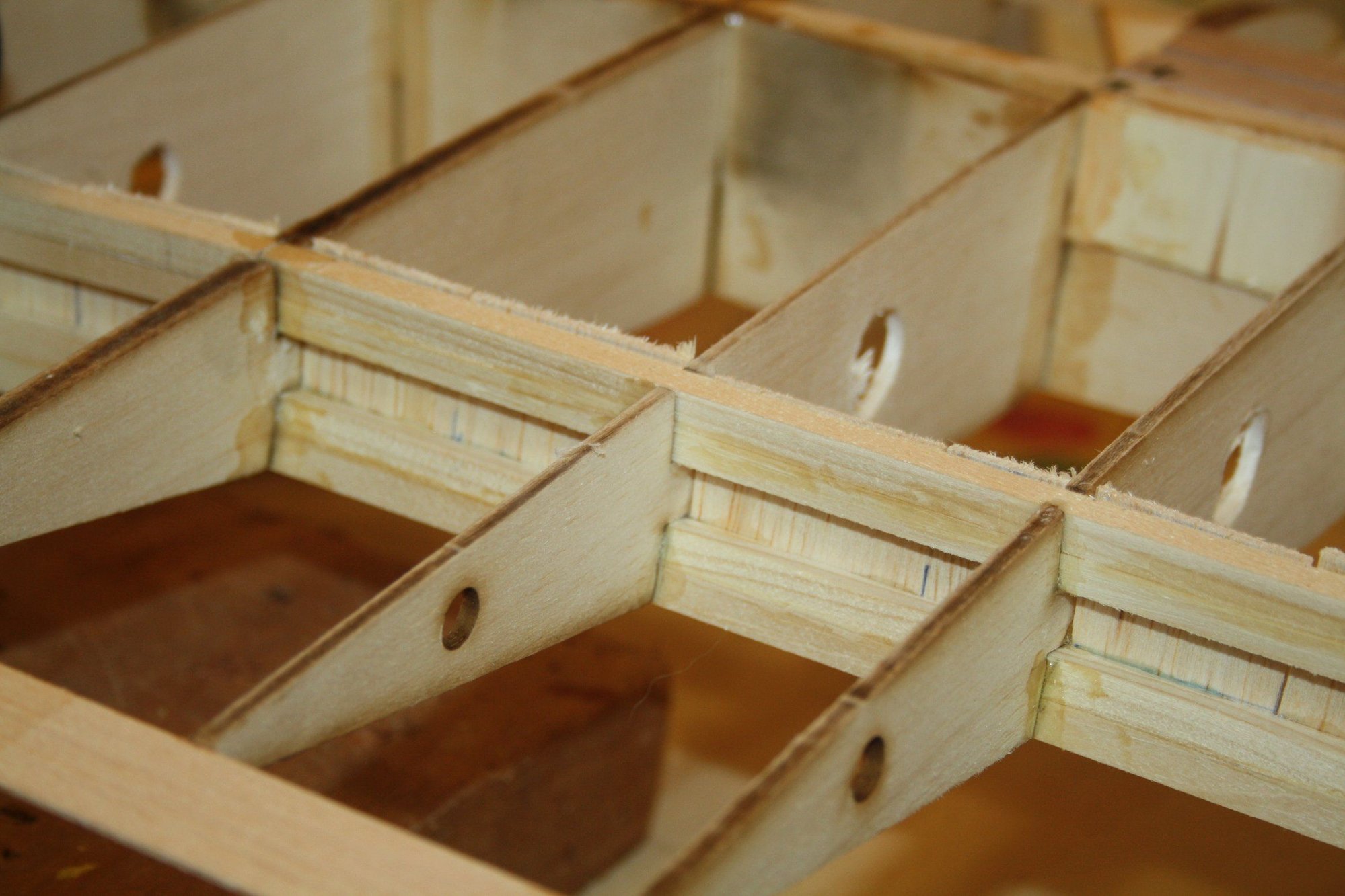

I sanded the wing-tips shear-webs and spars to shape and started to shear-web the "rear spar".
Cheers,
Eran

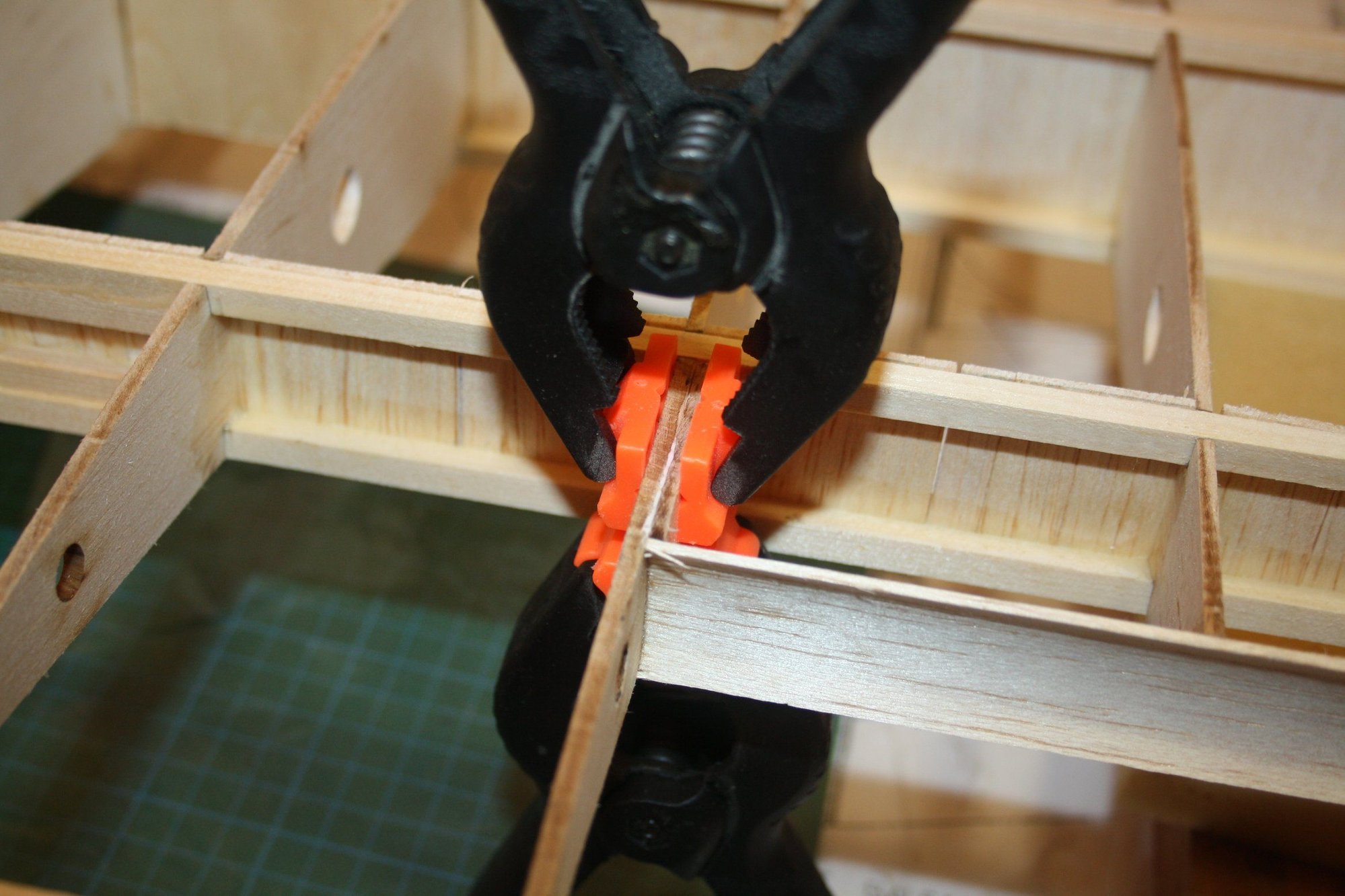

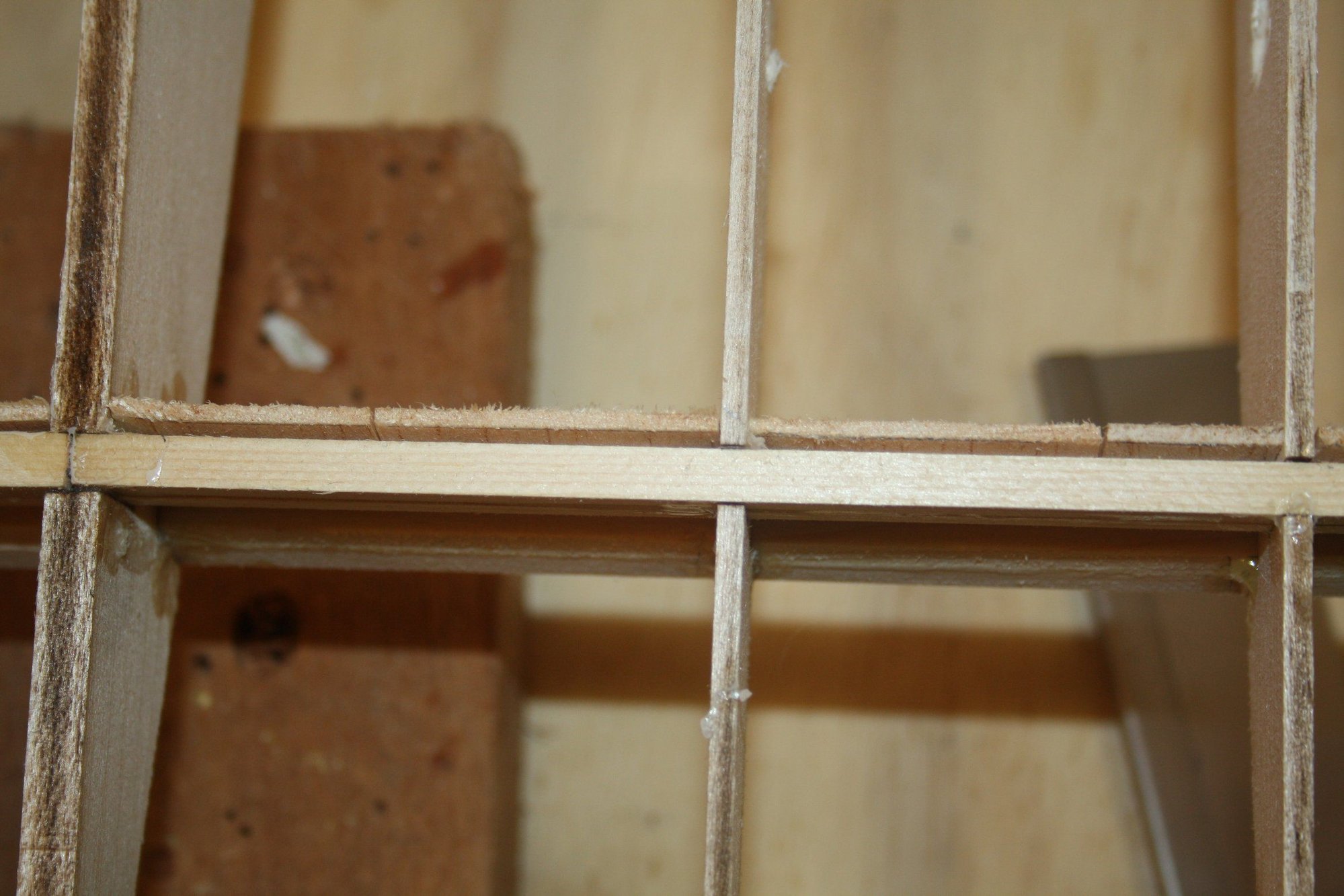

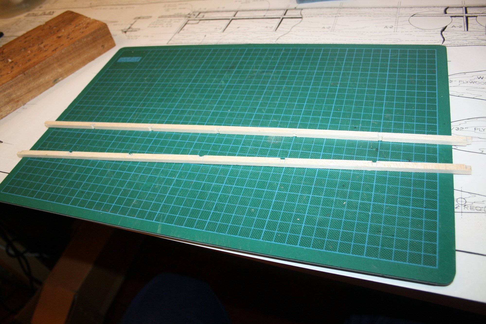

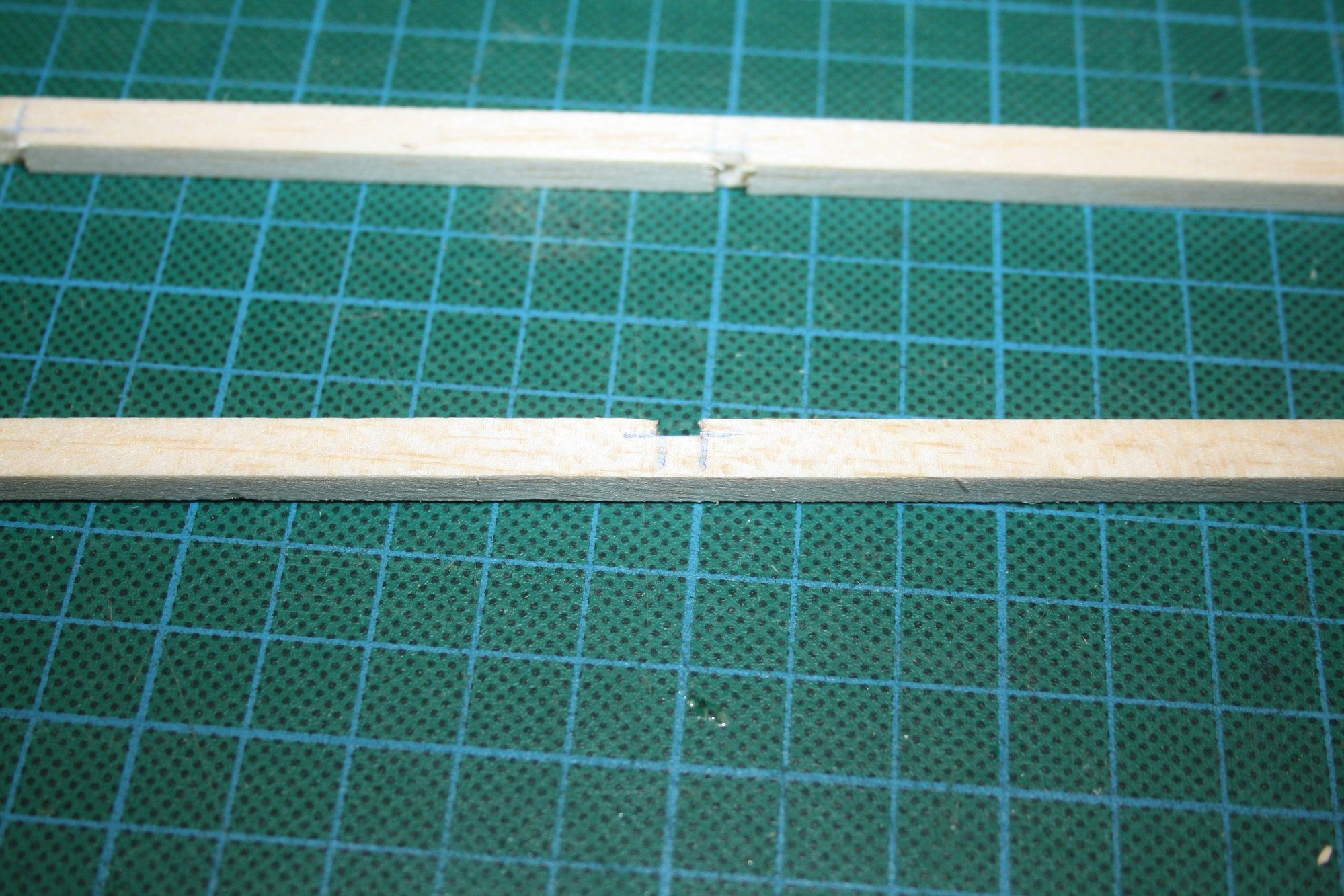

Making slow progress, I completed the shear-web on both main and secondary spar and sanded it all.
You can see an issue that came up on the secondary spar centre section. It is made out of two spruce sections on each side of the rib. Due to the angle of the spruce sections, there was a gap between the shear-web and the "outer" spruce. I filled the gap with PVA glue.
In addition, I made and glued the blocks for the landing gear mount supporting the upright section, laminating the blocks in opposing grain direction.
Cheers,
Eran
Old 08-18-2020, 03:52 AM
  #32
sensei
sensei's Avatar
Join Date: Jul 2002
Location: SAN ANTONIO, TX
Posts: 2,756
Received 9 Likes on 8 Posts
Cheers,
Eran
looking good!
Bob

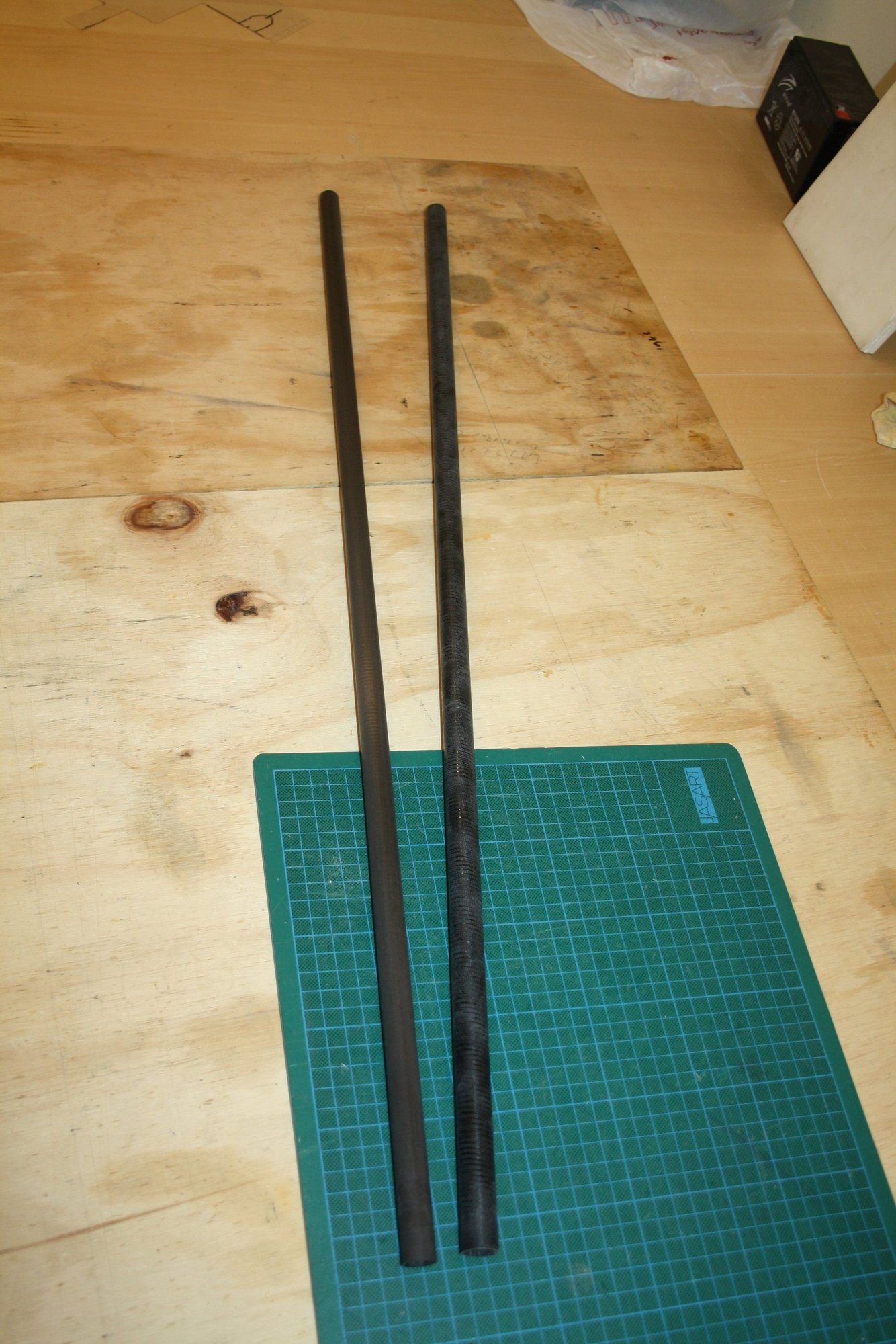

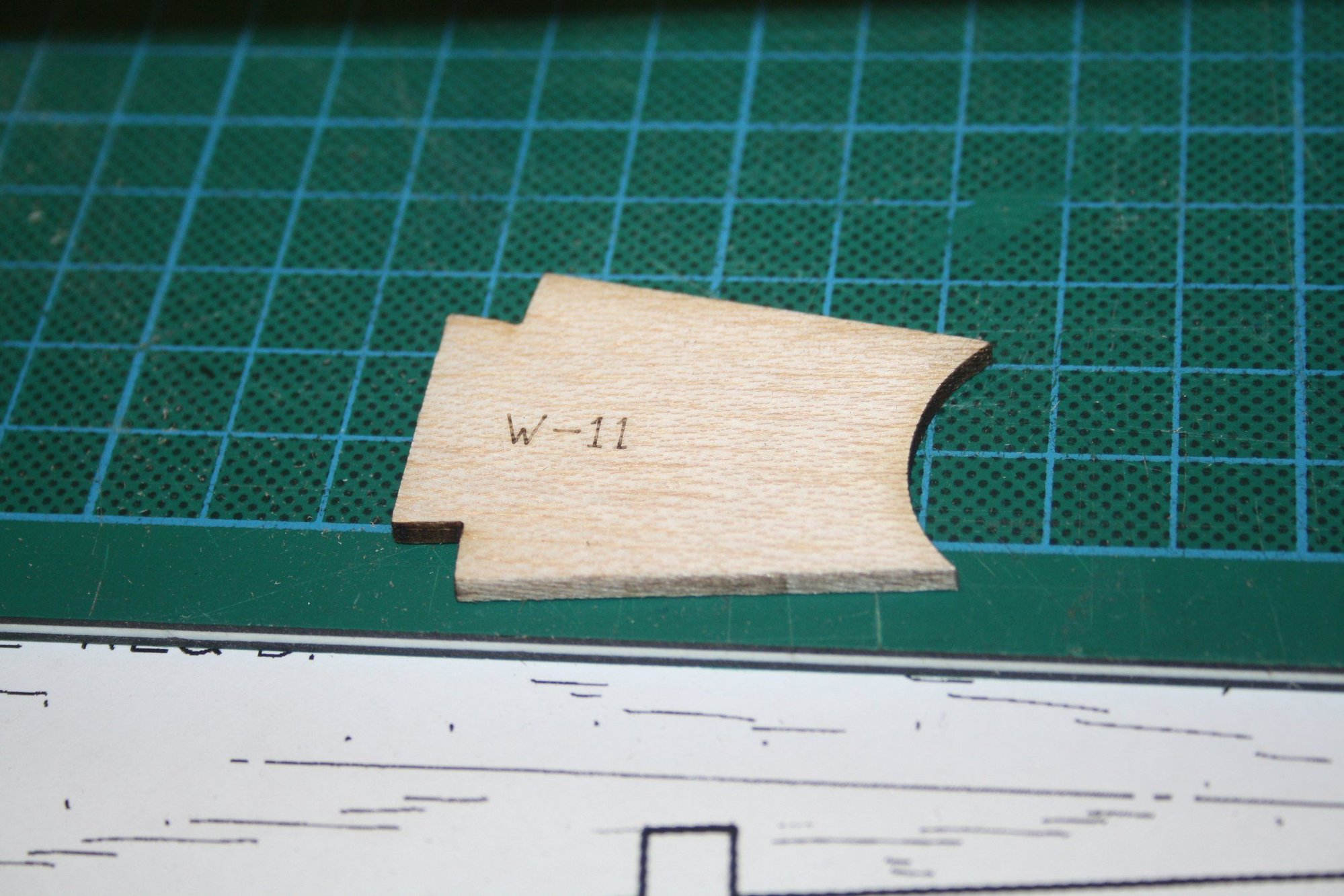

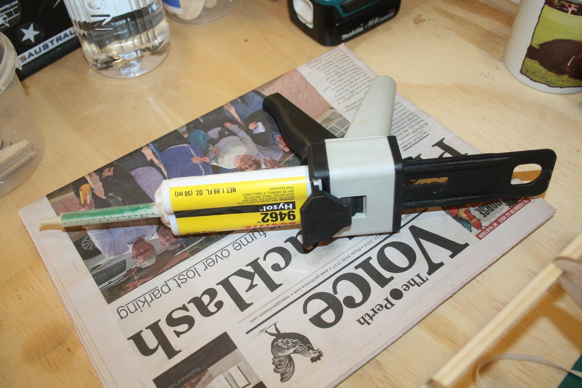

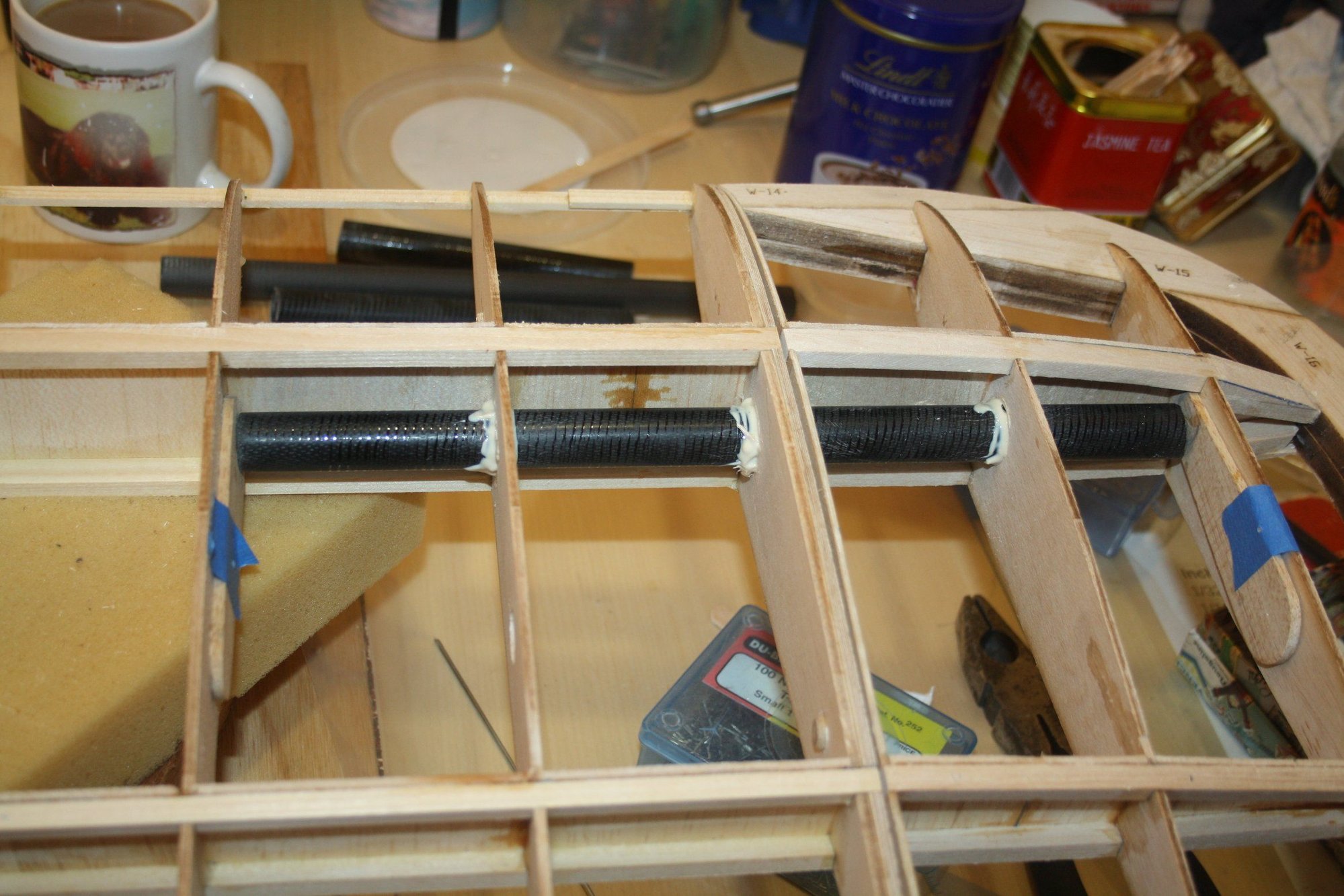

I finally had some time to progress with this build.
I thought that I will build the ailerons today, however, I realised that I am missing some correct size balsa. My current plan for the ailerons is to use CF tube throughout the aileron as a hinge. To do this, I will need to create a hole in all the "A-2" formers. When I was removing the formers supplied by the laser cut kit, I found that they have supplied formers designated as "W-5" with holes in them... There is no reference to these parts in the plans. I guess that a previous client requested it and they have added it to the kit since.
I also realised that I missed a sub-former "W-11'", which I have rectified as seen in the photos.
The CF load bearing "wing-tube" and sleeve for the wing-tips arrived today, so I got into this instead. One side done, one to go. I am using the Hysol Epoxy for the CF to wood joints.
Cheers,
Eran

I don't know if you noticed or not, but that Hysol is almost three years out of date. That said, I doubt it will hurt anything since we use out of date materials all the time for training and testing at work.
Old 08-26-2020, 03:48 AM
  #35
erans
Join Date: Jun 2008
Location: Perth WA, AUSTRALIA
Posts: 905
Hydro Junkie - I have been using Epoxy that is over 10 years old recently and it is as good as new... I truly think that the expiry date on some products is for marketing purpose (i.e. to get you to buy another one unnecessarily).
Cheers,
Eran

Actually, the expiration date on that Hysol is when it starts to lose some of its adhesive properties. If you were to use it on a full sized aircraft, it could be a serious issue. For your application, in this case, GO FOR IT!!!
Old 08-26-2020, 05:20 AM
  #37
erans
Join Date: Jun 2008
Posts: 905
Hydro Junkie - Gluing the sleeves serves a purpose of stopping them from sliding out (when the wing tip is not in situ). The glue is not used for structural purpose. The load bearing is done by the wood around the sleeve (the ribs).
In addition, lets remind ourselves that this is a model aeroplane, not a man carrying machine which must comply with regulation. In that case, using within date products will be mandatory and complied with.
Cheers,
Eran

And I totally agree with you. If I didn't, knowing how the shelf life dates work, I would have been saying "DON'T USE IT!!!!!!" as soon as I saw it. Since I work in aviation, using things like Hysol has to be with care. That said, there are just some things that work and this is a case that applies to. Only problem with Hysol is it can be heavy unless used with caution. Glue away as I'm looking forward to seeing the results

Couple of photos of the sleeve in place and I have just glued the CF sleeve on the other side.
Cheers,
Eran

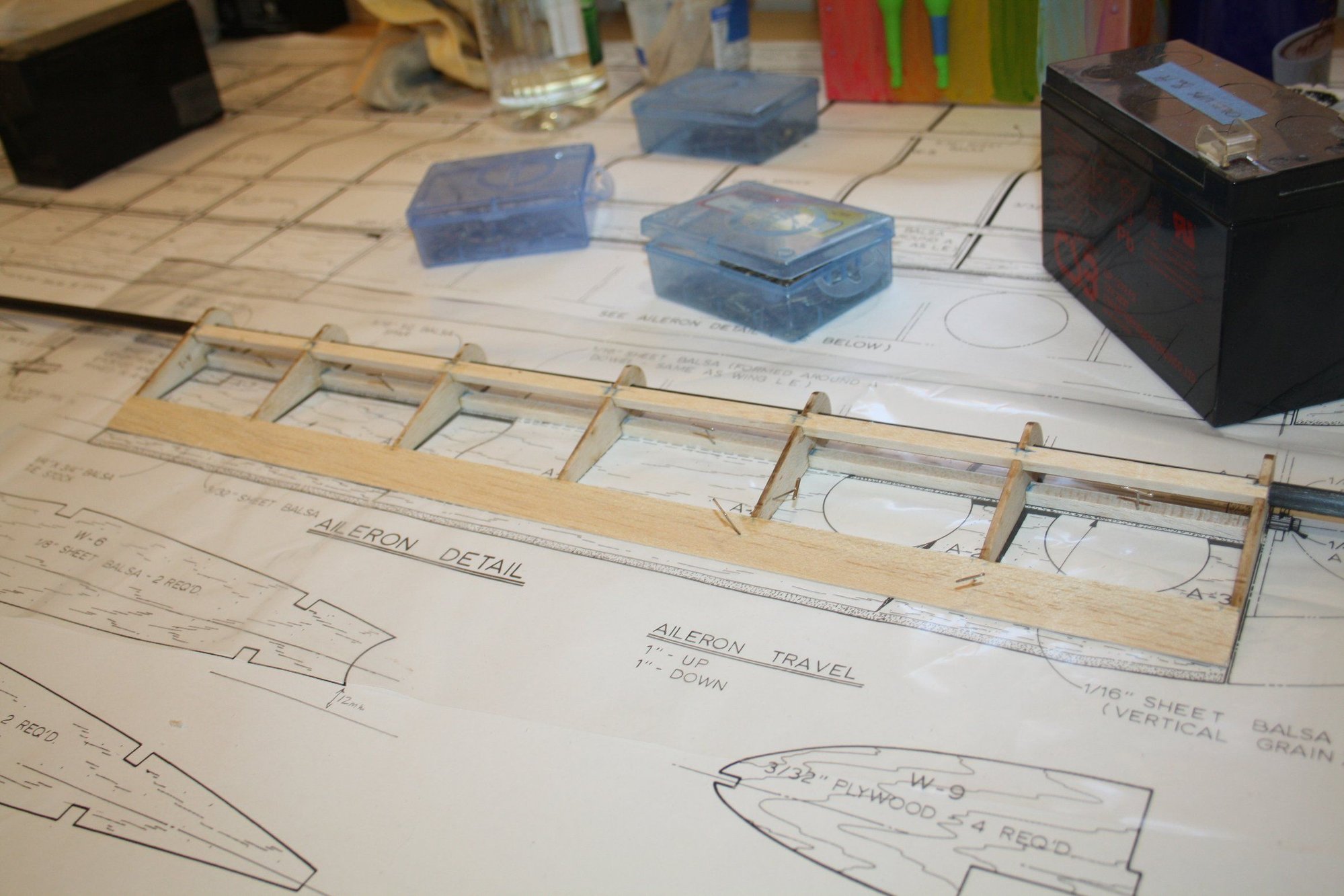

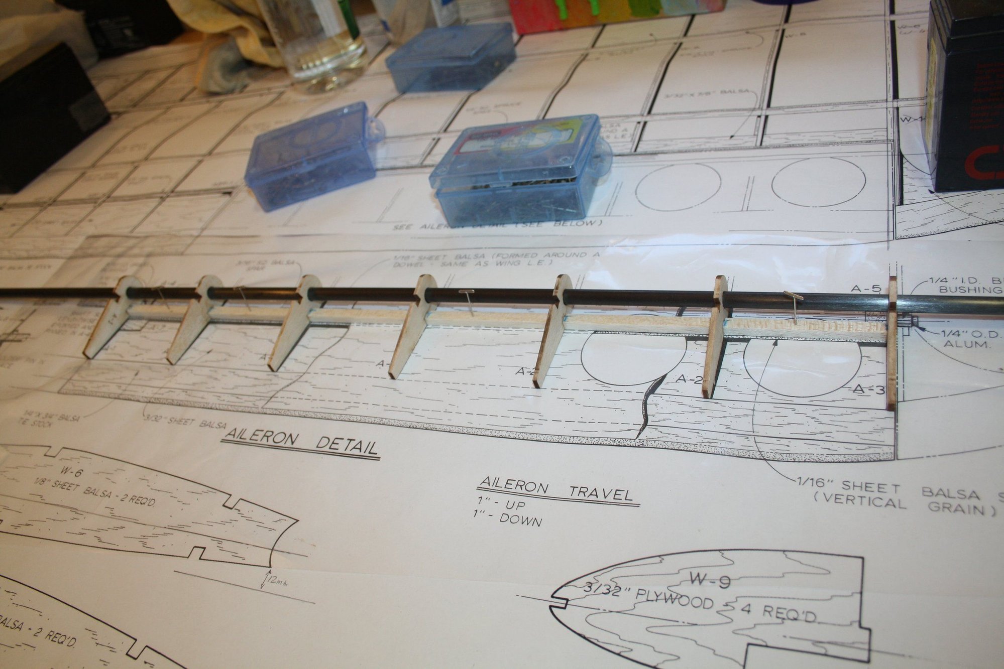

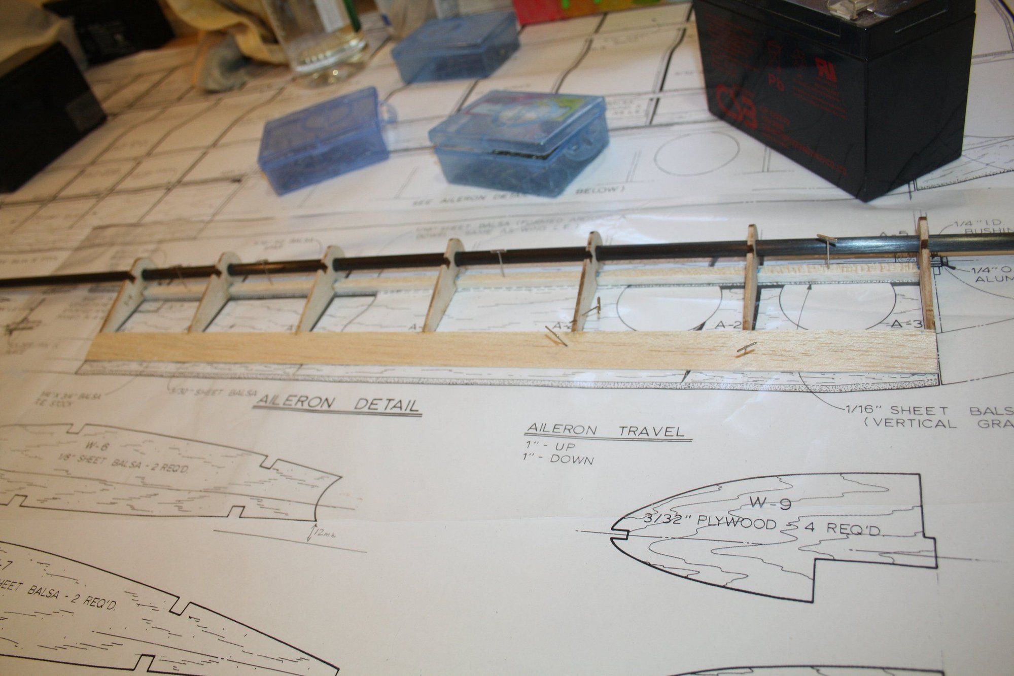

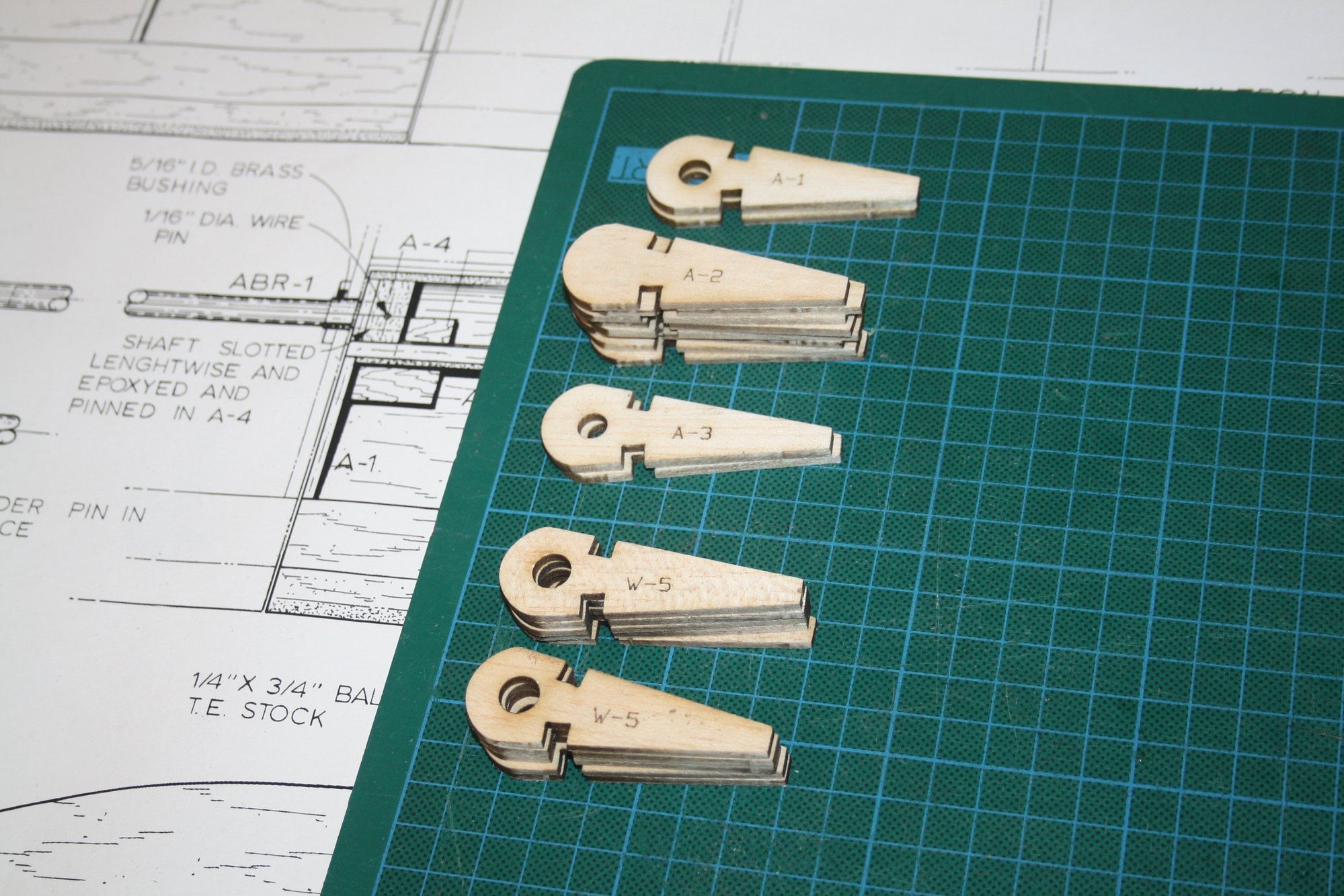

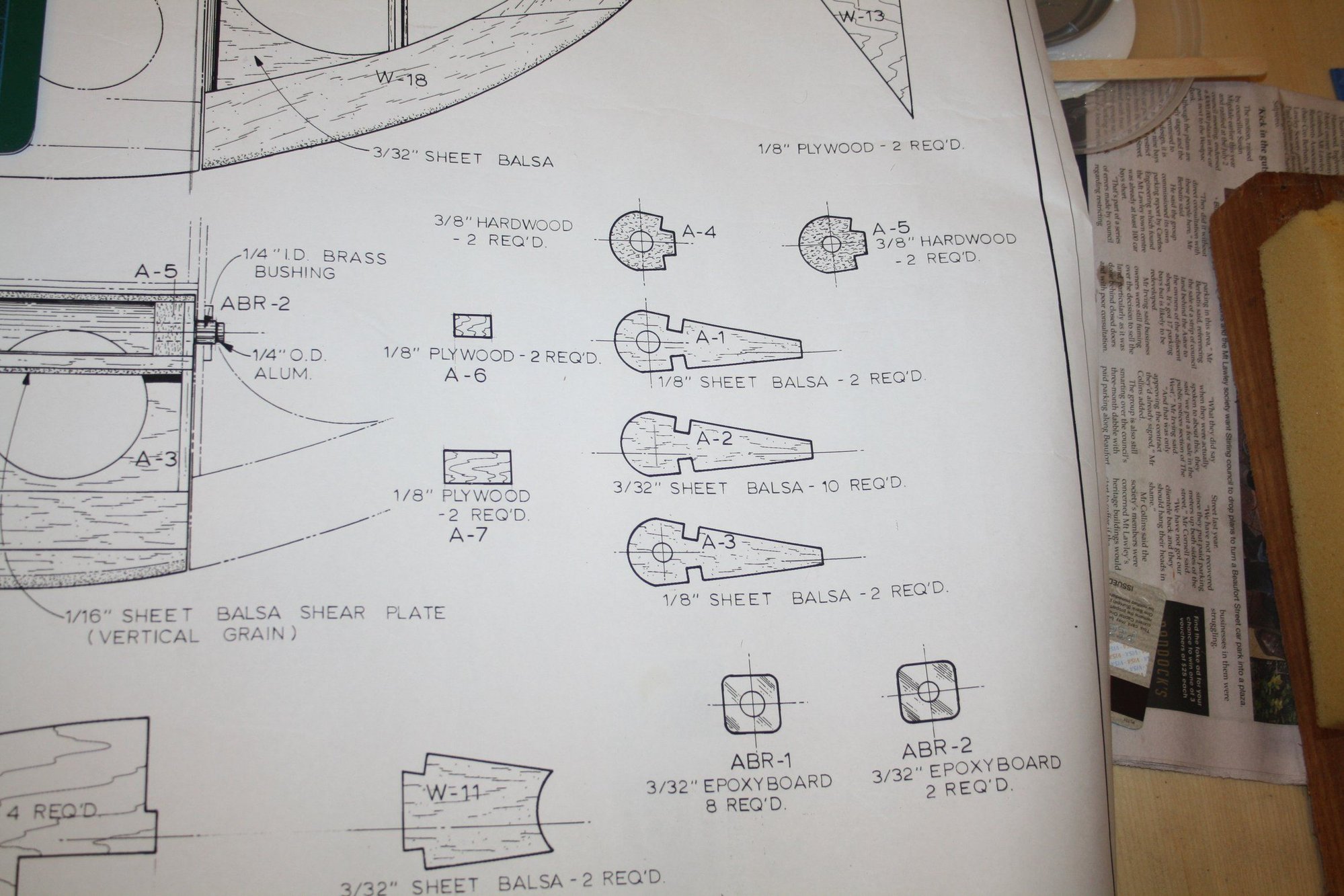

I started to build the aileron. Sometime getting the correct size balsa is difficult here, as in this case where the plans call for 3/16" SQ balsa spar. All that was available in the shop was 1/4" x 3/16", so I notched it to fit.
Cheers,
Eran

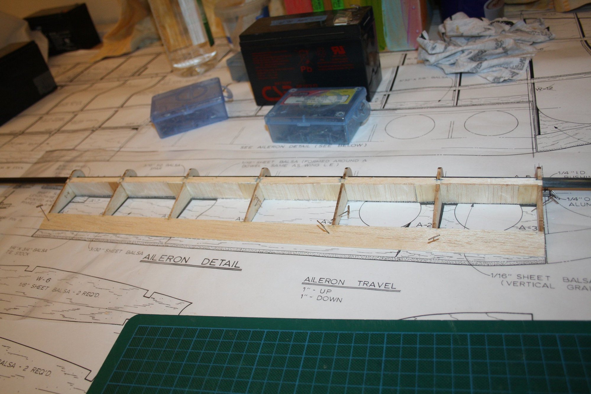

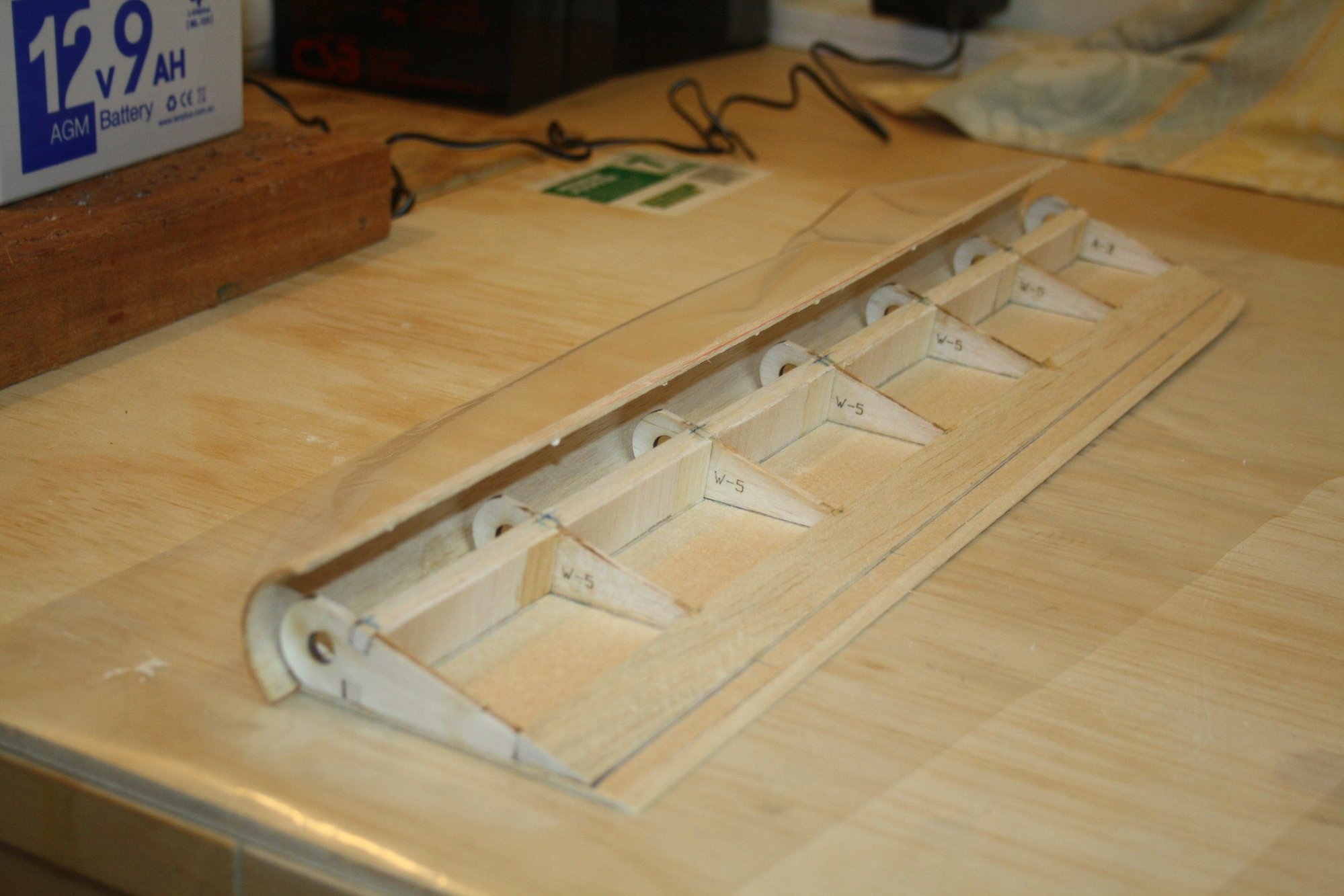

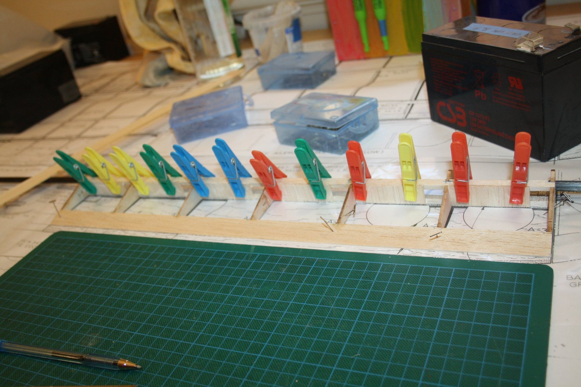

Preparing the bottom sheeting for the aileron, I cut it to shape and sanded a bevel at the edge. I then glued the structure to it.
Cheers,
Eran

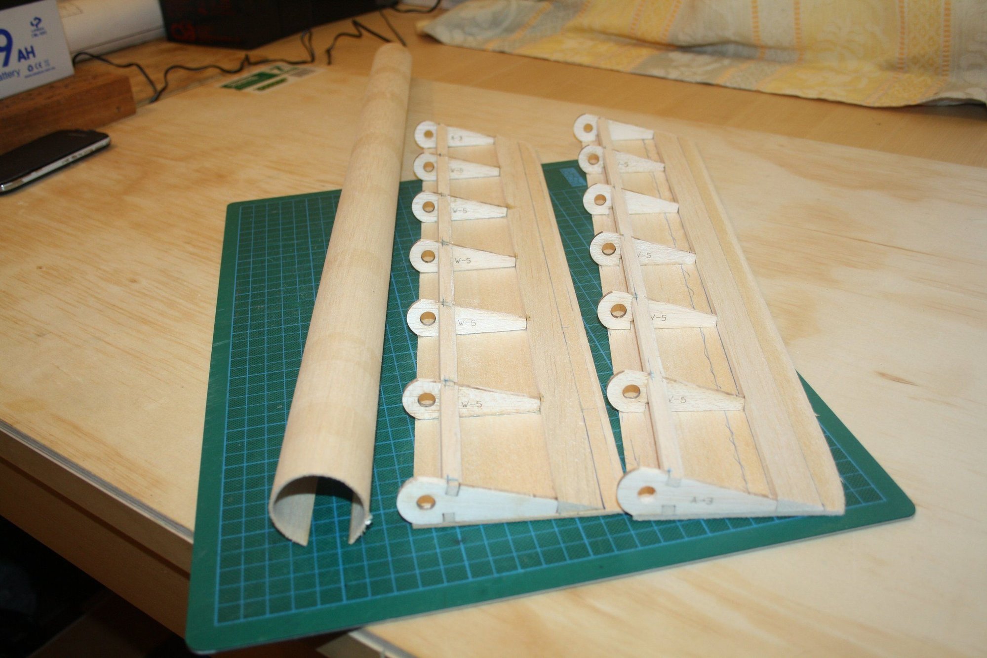

I built the second aileron to the same stage as the first one a couple of days ago.
Today I started the process of attaching the curved aileron LE. It is a bit more involved than I expected, with the LE being of a different width (narrower) to the sheeting.
Cheers,
Eran
