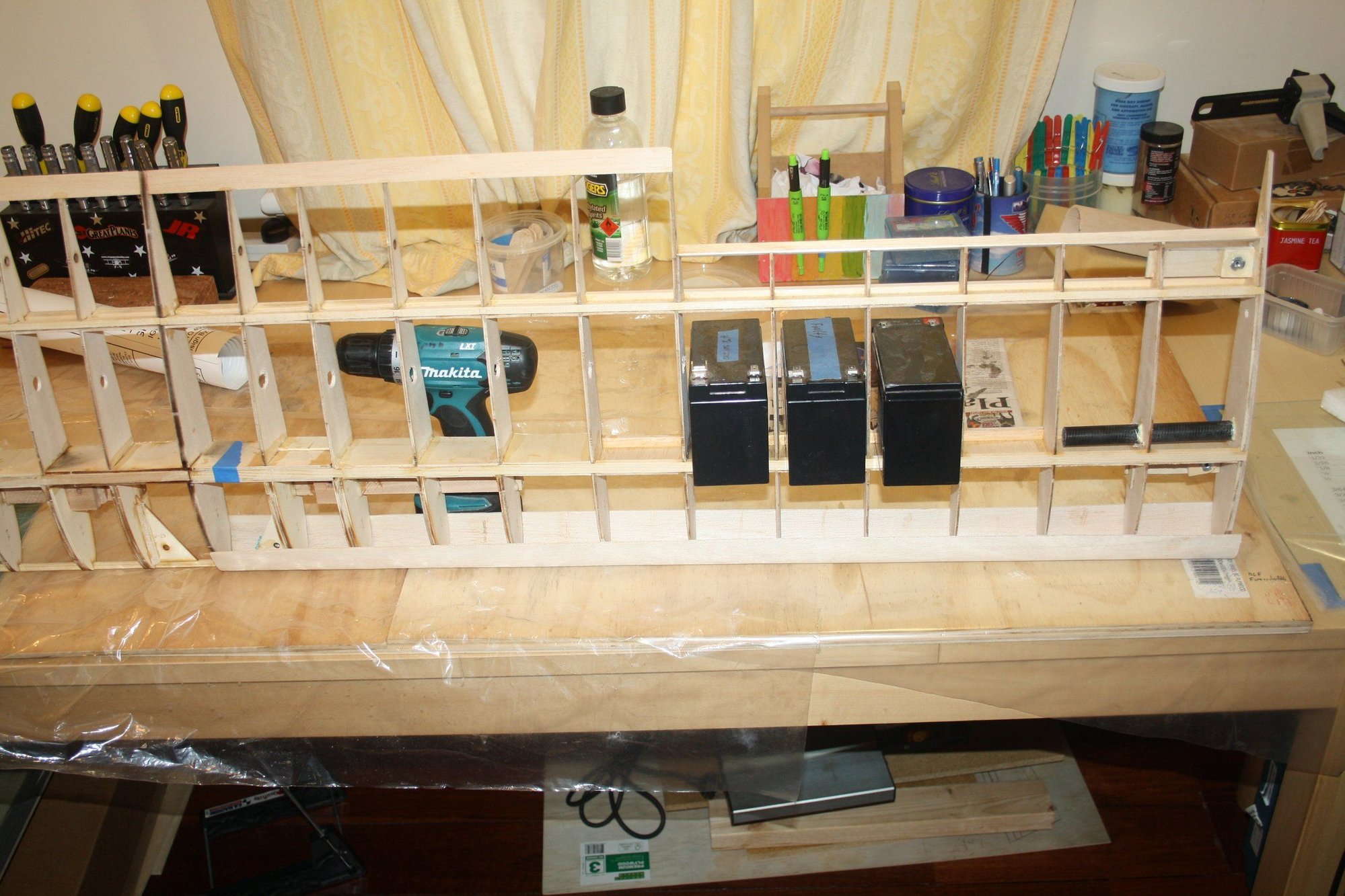

Your equipment selection will have a large affect on final weight. Wheels, tail wheel assembly, battery packs etc. finishing method obviously can get heavy in a hurry as well. Granted an iron on film is not really appropriate for this airplane but there are ways to save weight when painting fabric covering. Knowing that it could turn out heavy unless you start selecting components that will work without adding excess weight is not such a bad place to be.

Originally Posted by Nece View Post
The construction of the Giant Astro Hog is very good. I don't think the construction itself is too heavy. The weight was given by Jerry Bates to be about 16 to 18 lbs. If the plane doesn't get heavier then everything is ok. The problem for me is when it gets heavier than stated because then my engine may be too weak.
The entire wing weighs almost 5 lbs (without servos and without covering and painting) and I'm afraid that the complete model will be heavier than the 18 lbs mentioned.
At 18 lbs. your wing loading will be 30 ozs. with a cubed loading of 10. The Reynolds numbers are pretty high so that makes for a nice flying sport plane. At 23 lbs.the wing loading is at 40 ozs. with a cubed loading of 13, moving you nearly into the racing category and now needing a bigger engine as the weight climbs even more, so as Speed has suggested, be carful with the rest of your choices from here moving forward.
Bob

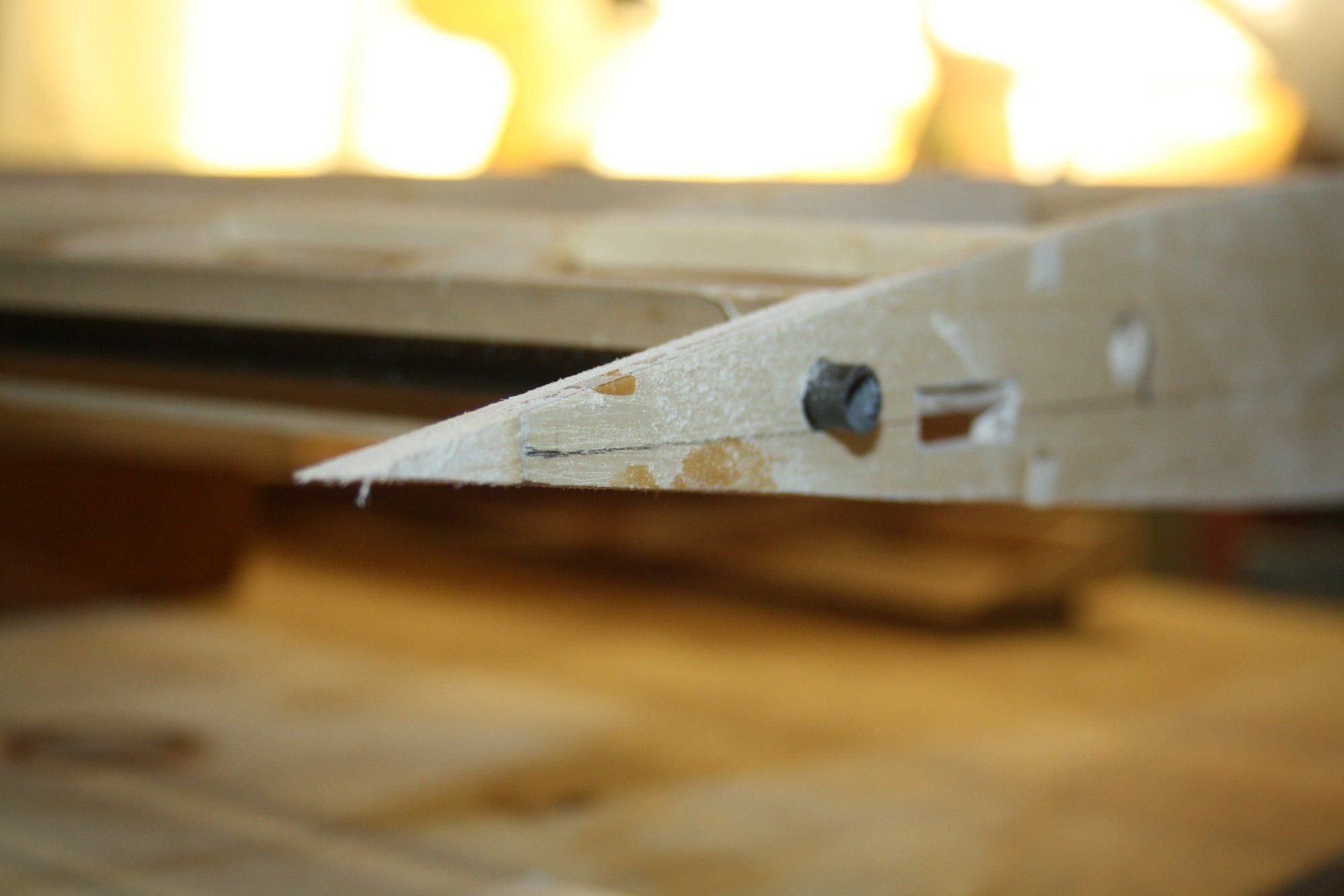

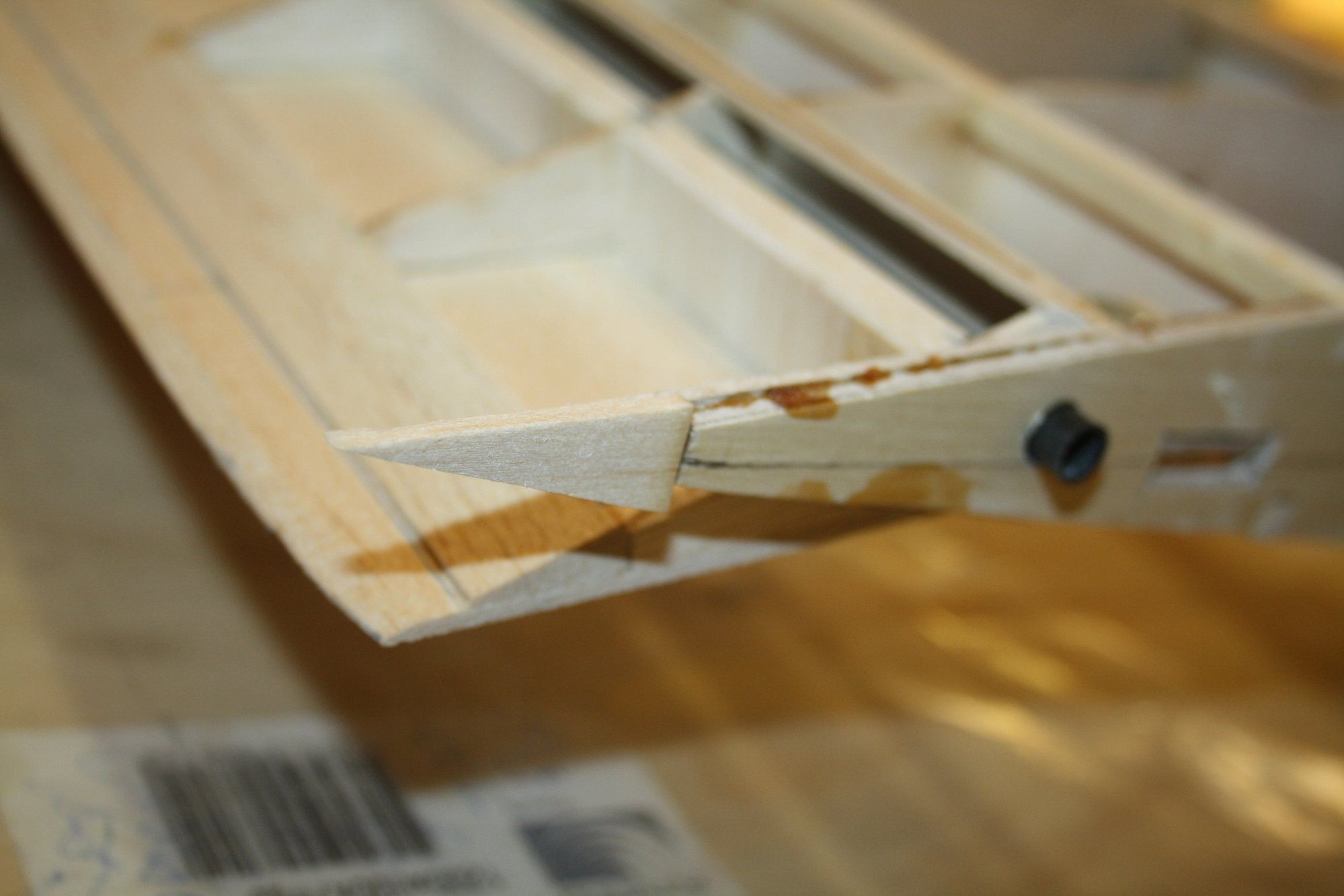

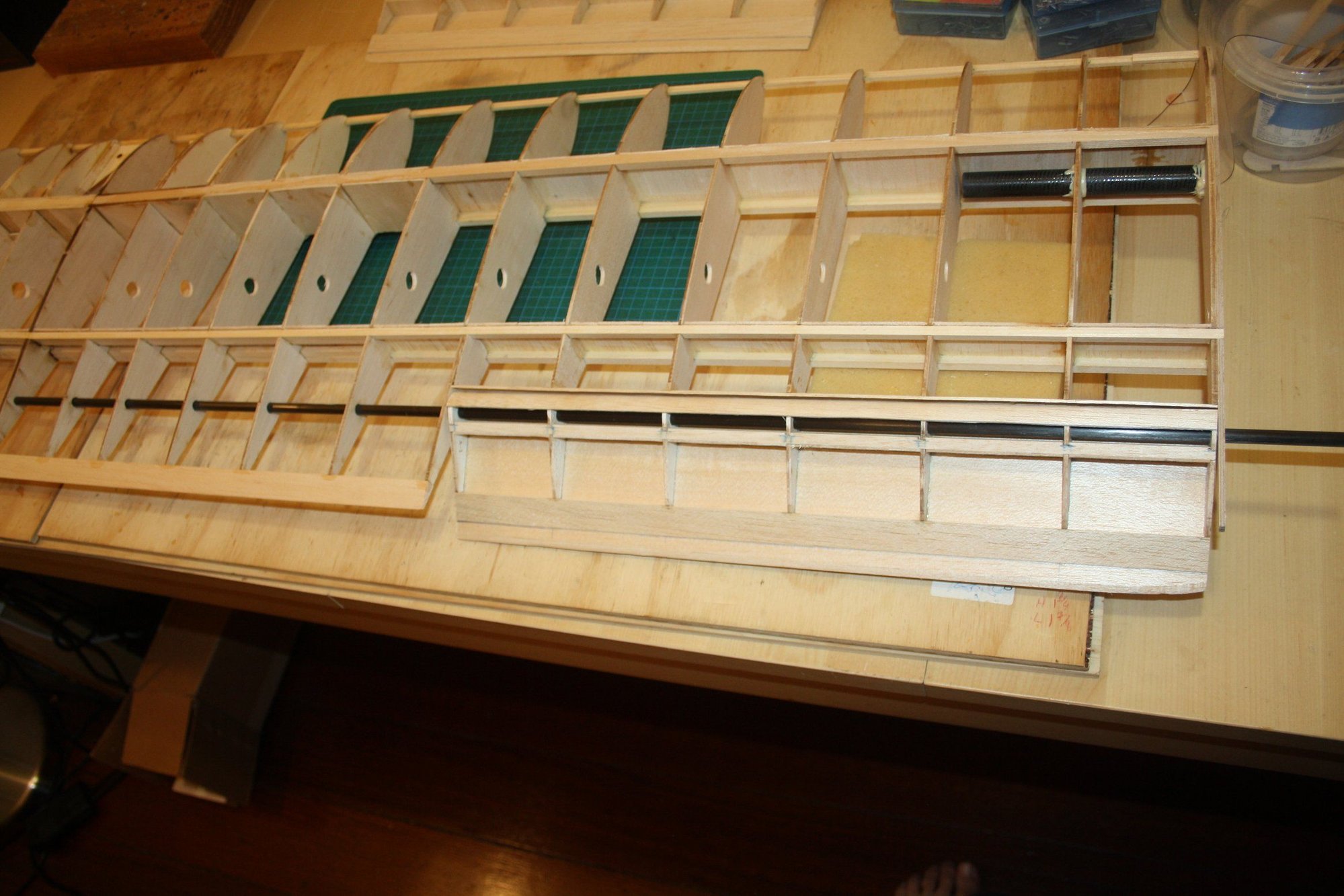

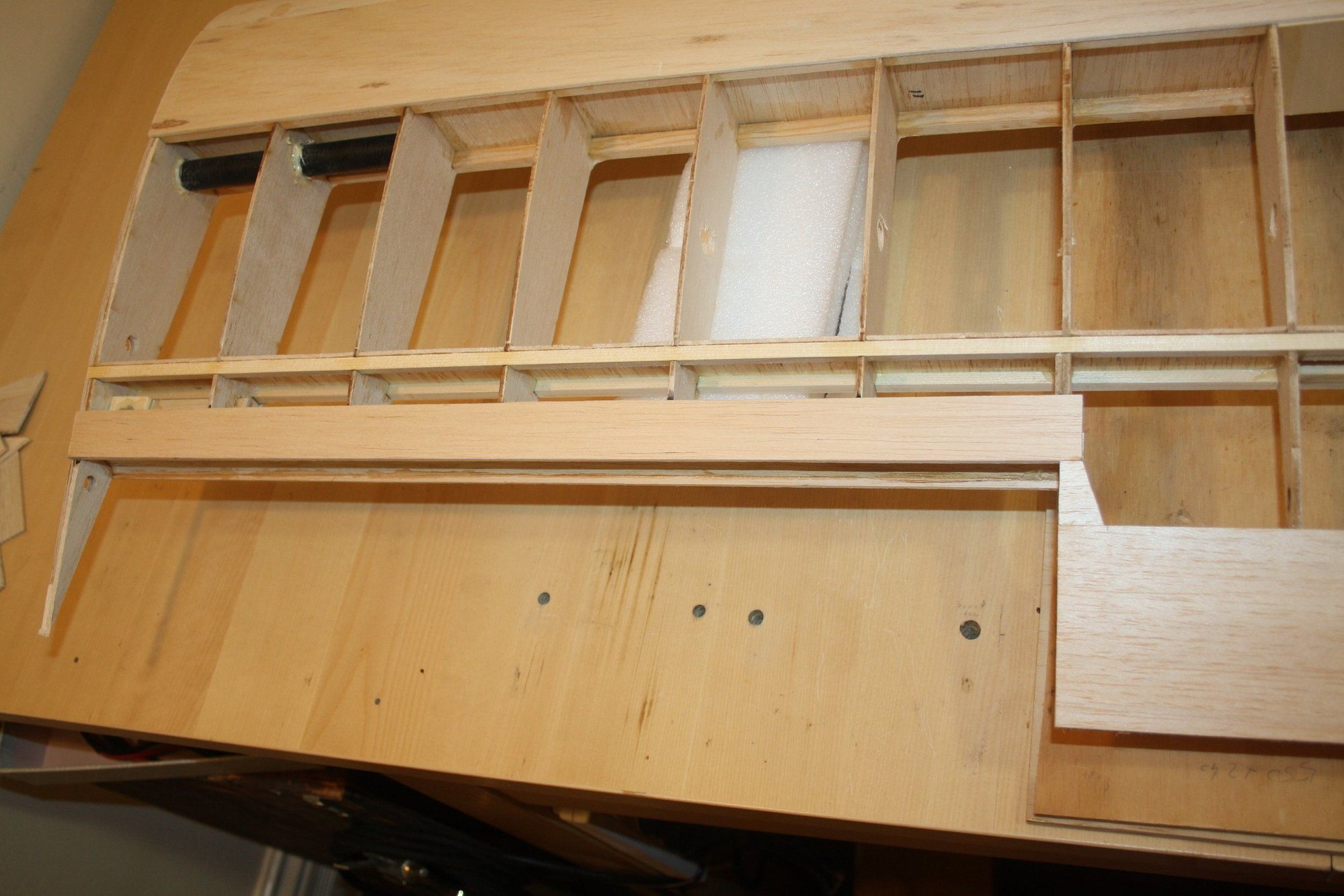

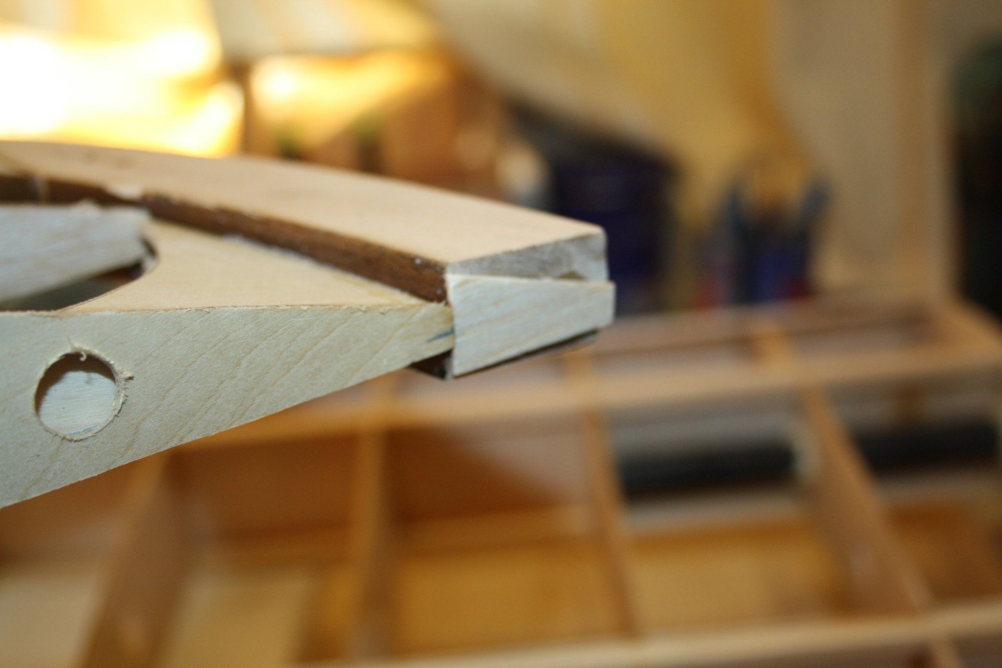

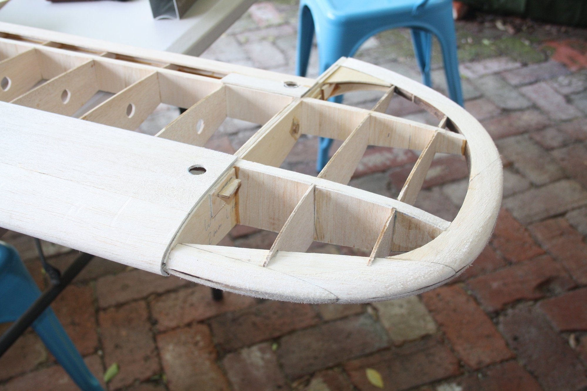

With the ailerons LE glued into place, I checked the fit and it is not far off being satisfactory. Both ailerons move in both directions properly. I then repeated the ailerons fit test with the wing-tip attached to verify that attaching the wing-tips do not create unforeseen issues.
I was not 100% happy with the wing-tips retention, having some minor flex at the TE. I decided to make additional retention by screw towards the TE, similar to the "front" retention. It has resolved the flex.

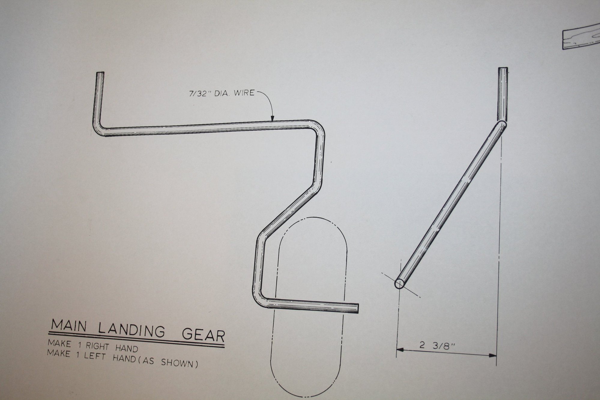

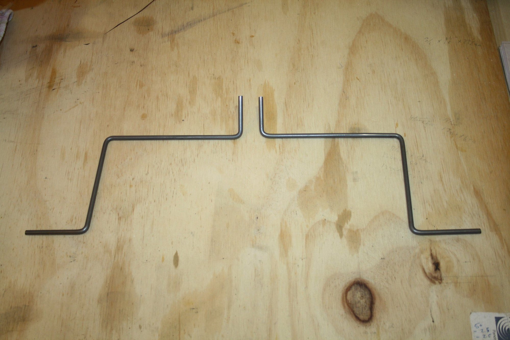

I had the opportunity to use my friend shed today (with enough space around the vice) to bend the landing gear.
A decision was made early on in the project to not use the complex bending pattern showing on the plans.
Not showing well in the photo is the fact that the landing gear has the 2 3/8" bend forward.
Cheers,

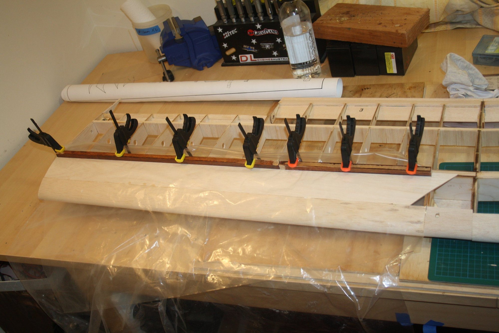

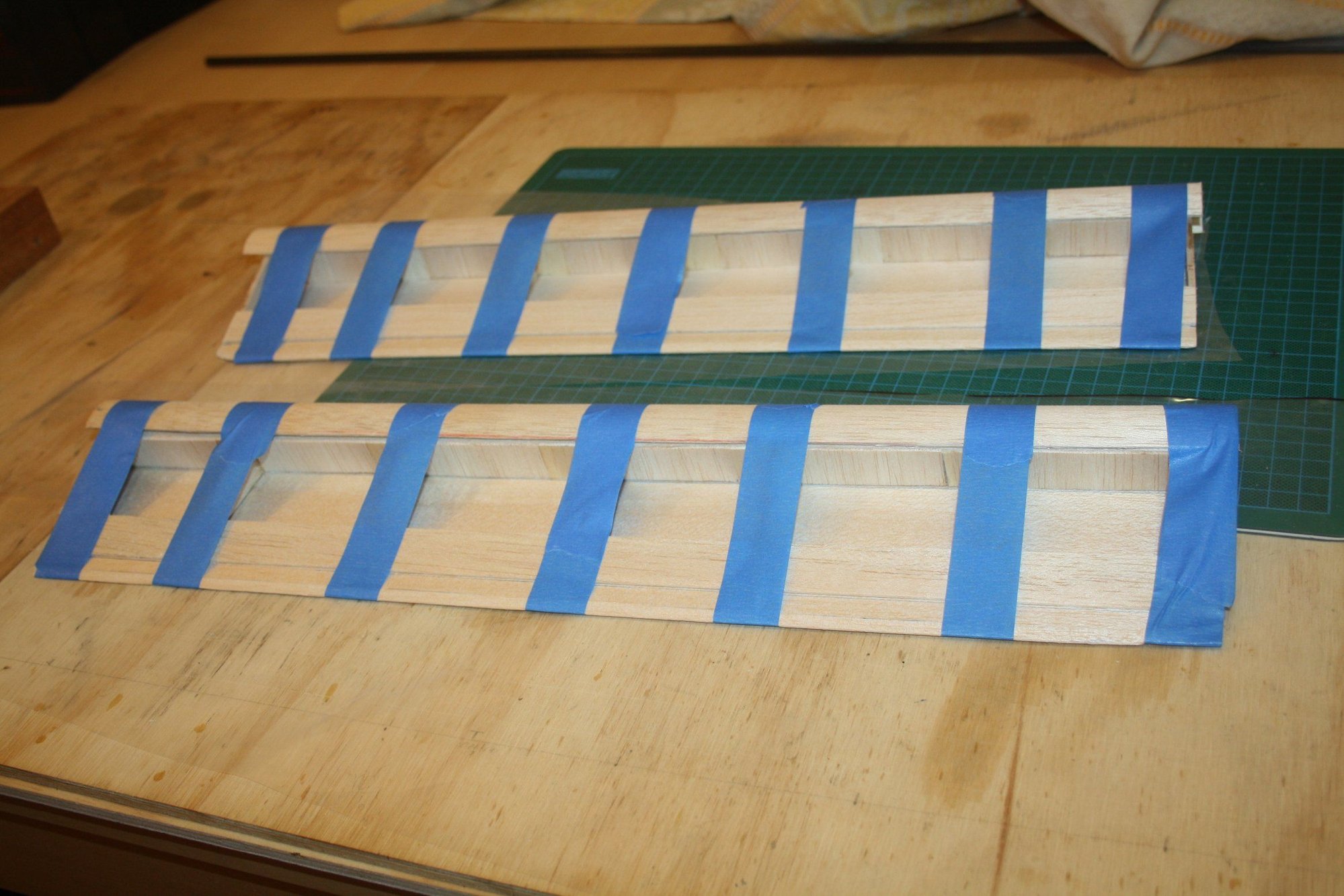

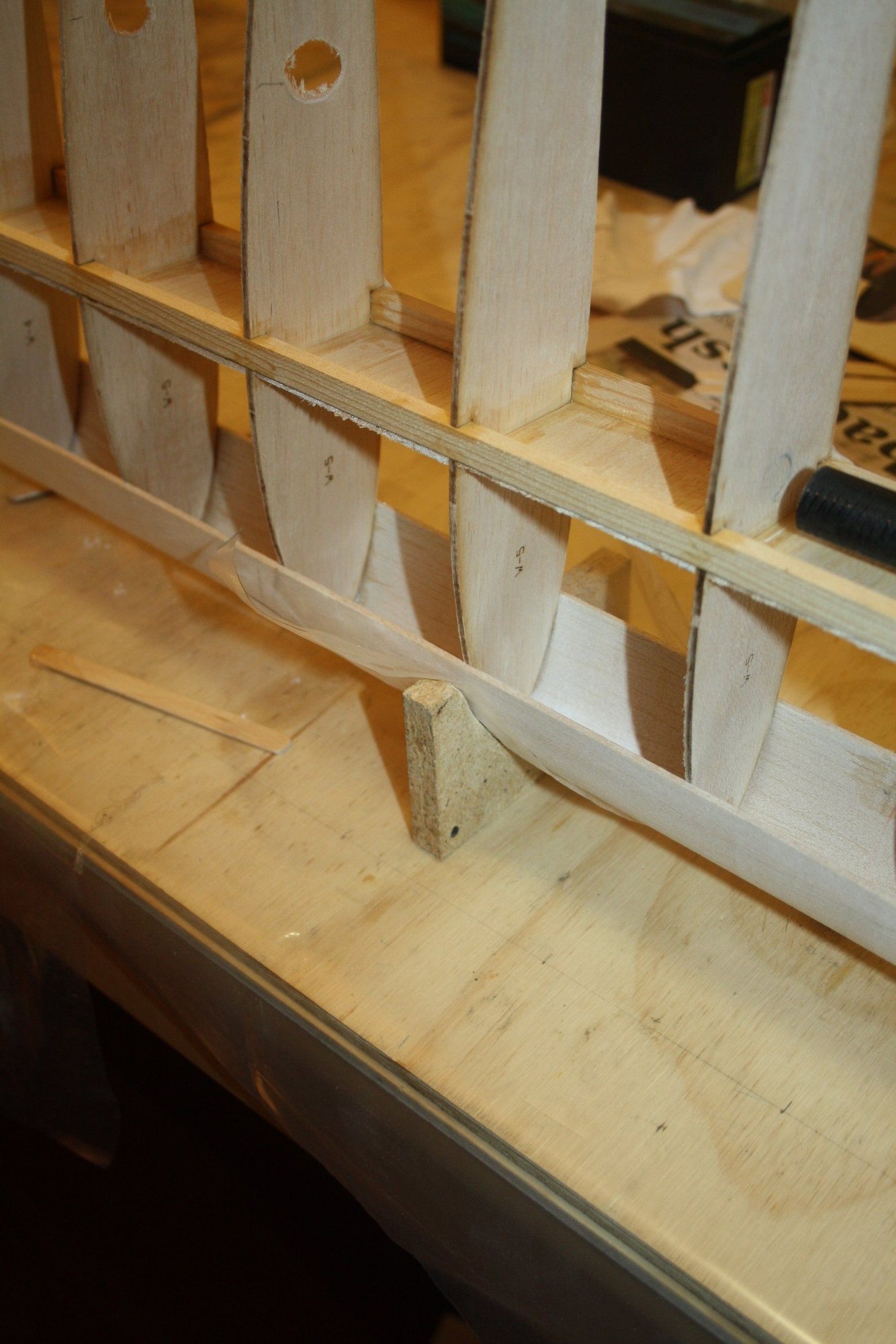

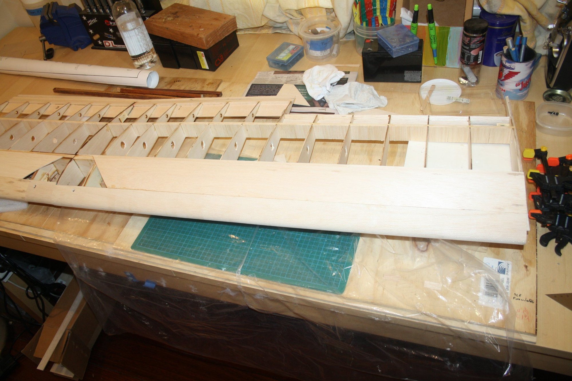

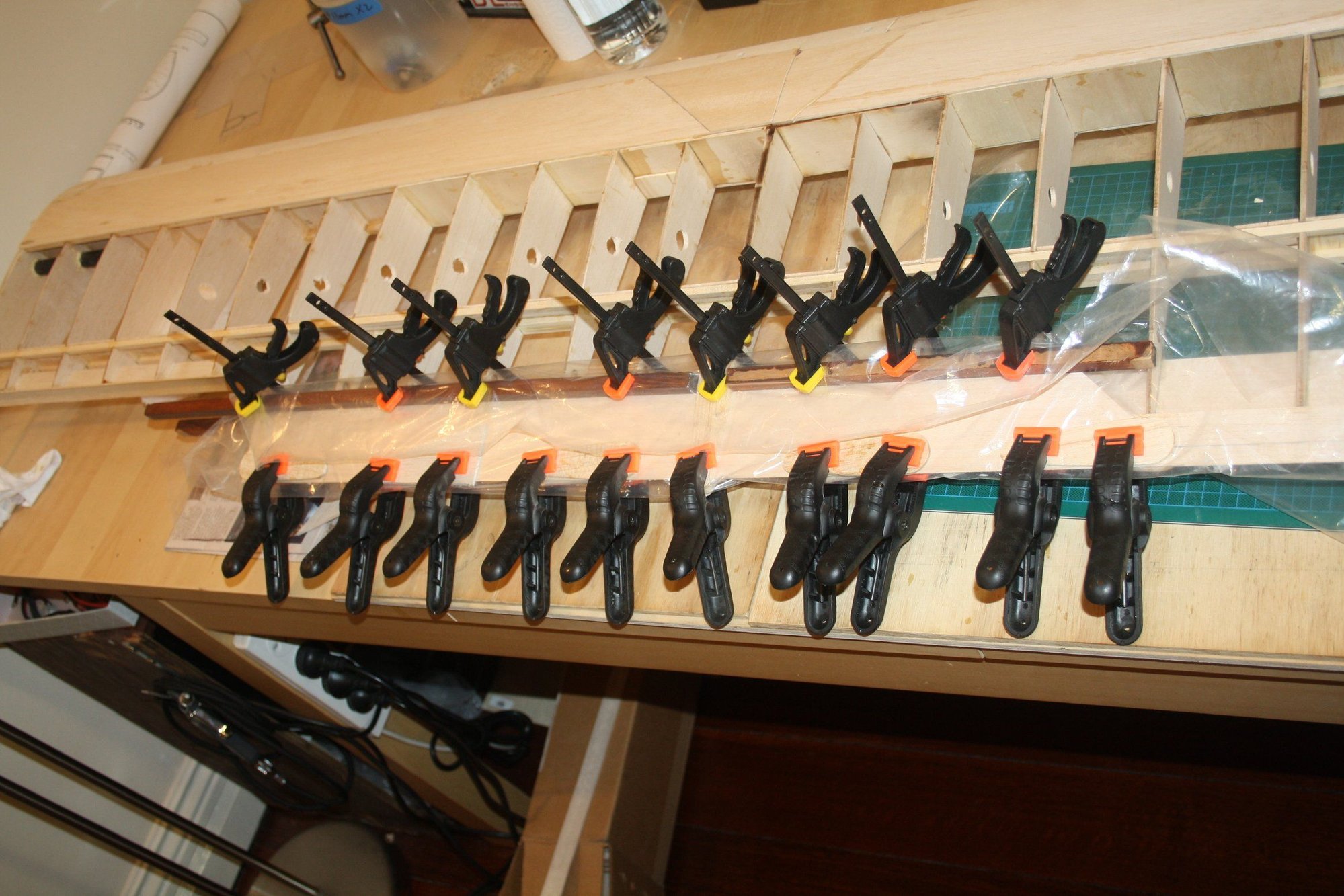

After salvaging the moulded 48" piece from the bin, I decided to stage the glue process.
I first glued the spruce LE to the balsa to fix it into place.
I then made from scrap melamine board a "negative" to the shape of the rib + 2.5mm balsa sheeting. Using this "tool" (and forcing the rib + sheeting into it while the glue dry), I glued each individual rib (first all the "tops" and then repeated for all the "bottoms"). This took quite a few hours...
I then attempted to mould the another 48" x 2.5mm balsa sheet, but it split in half. I had no other choice but to use a 36" x 2.5mm sheet as there are no more 48" sheets in my two local R/C shops.
Using the same technique, I glued it into place and then made a small sheeting piece for the gap.

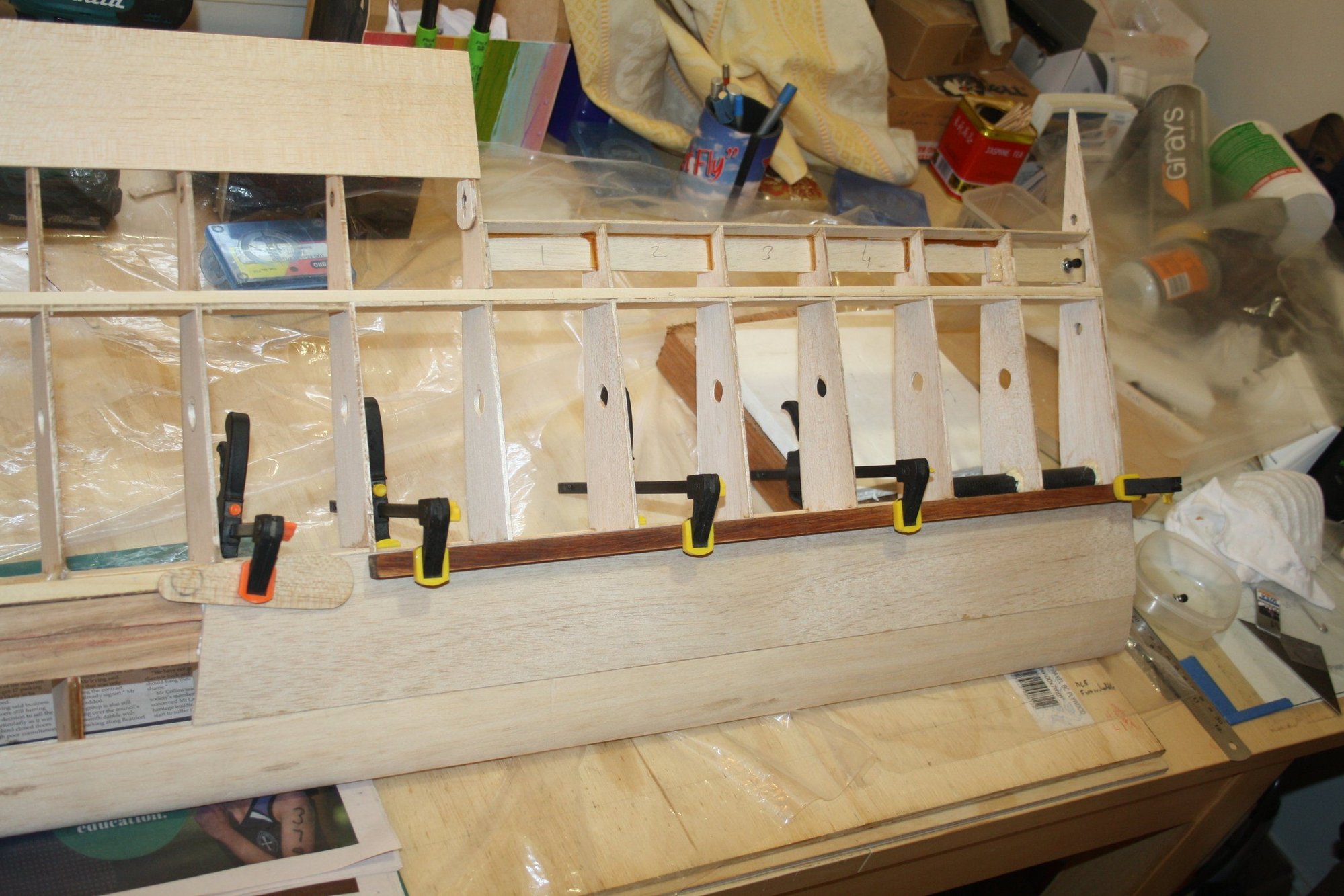

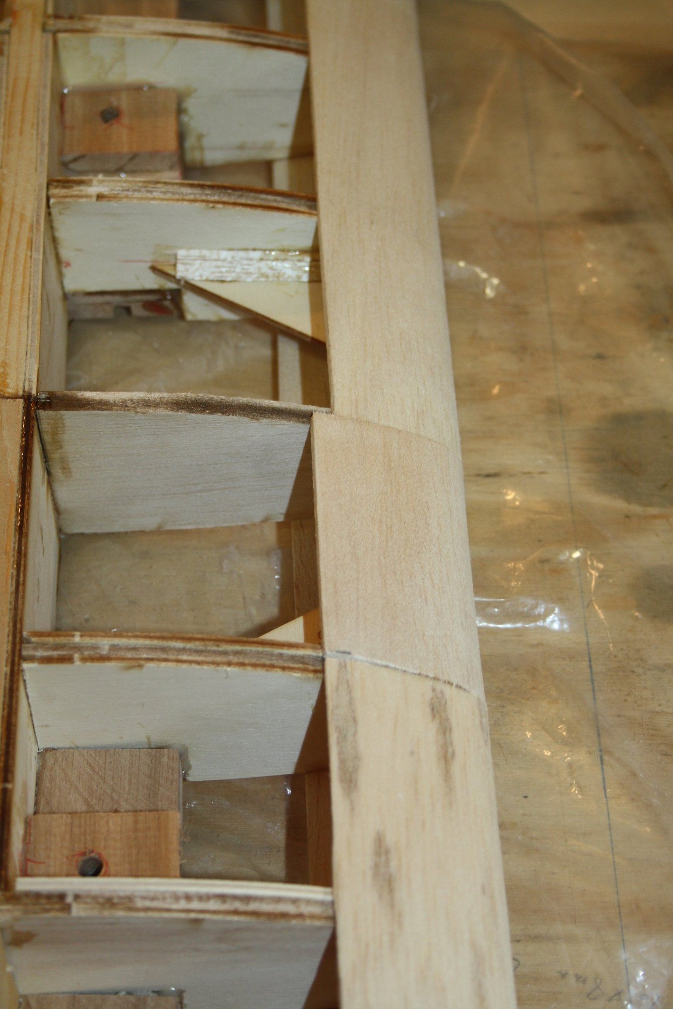

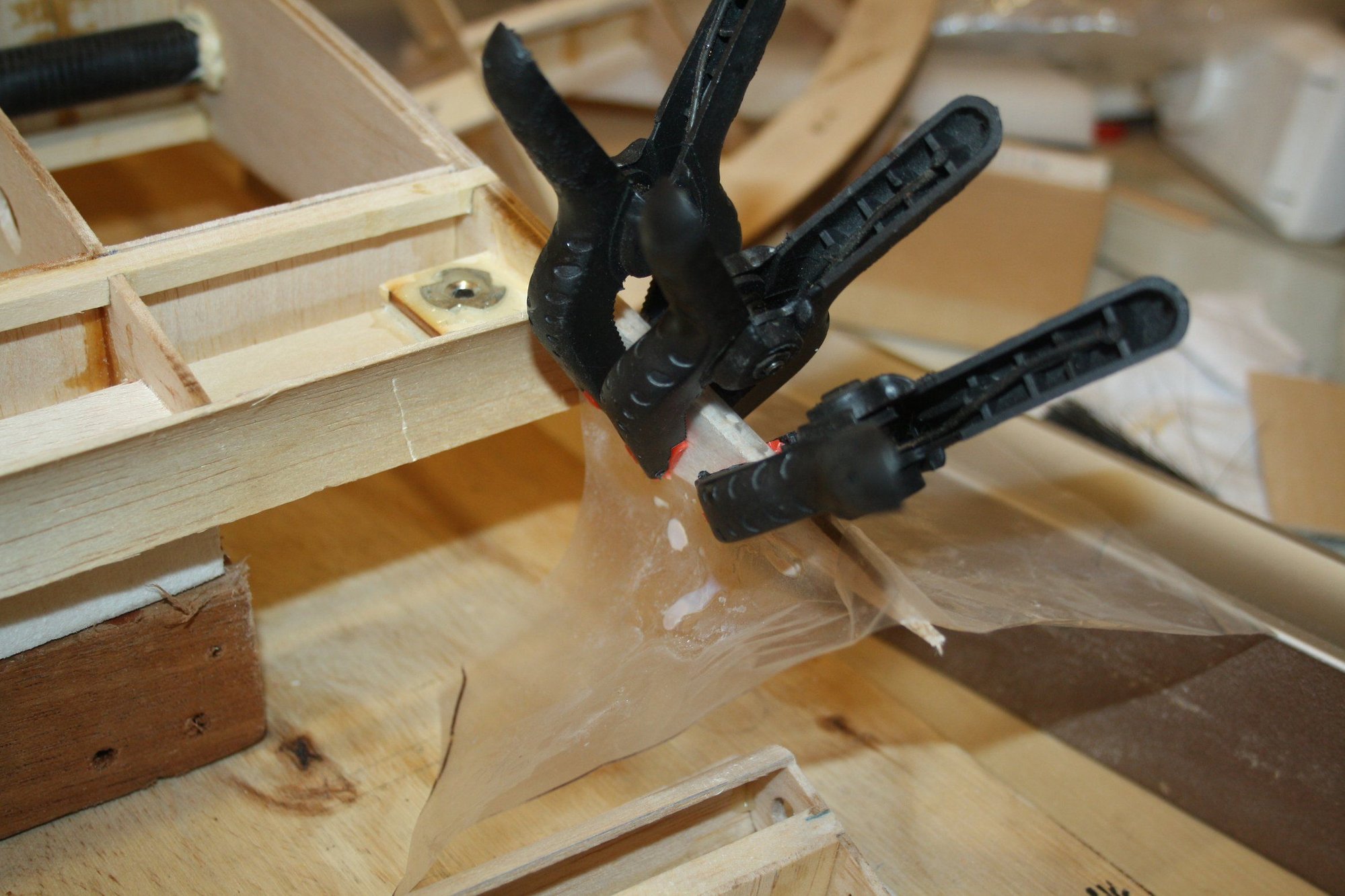

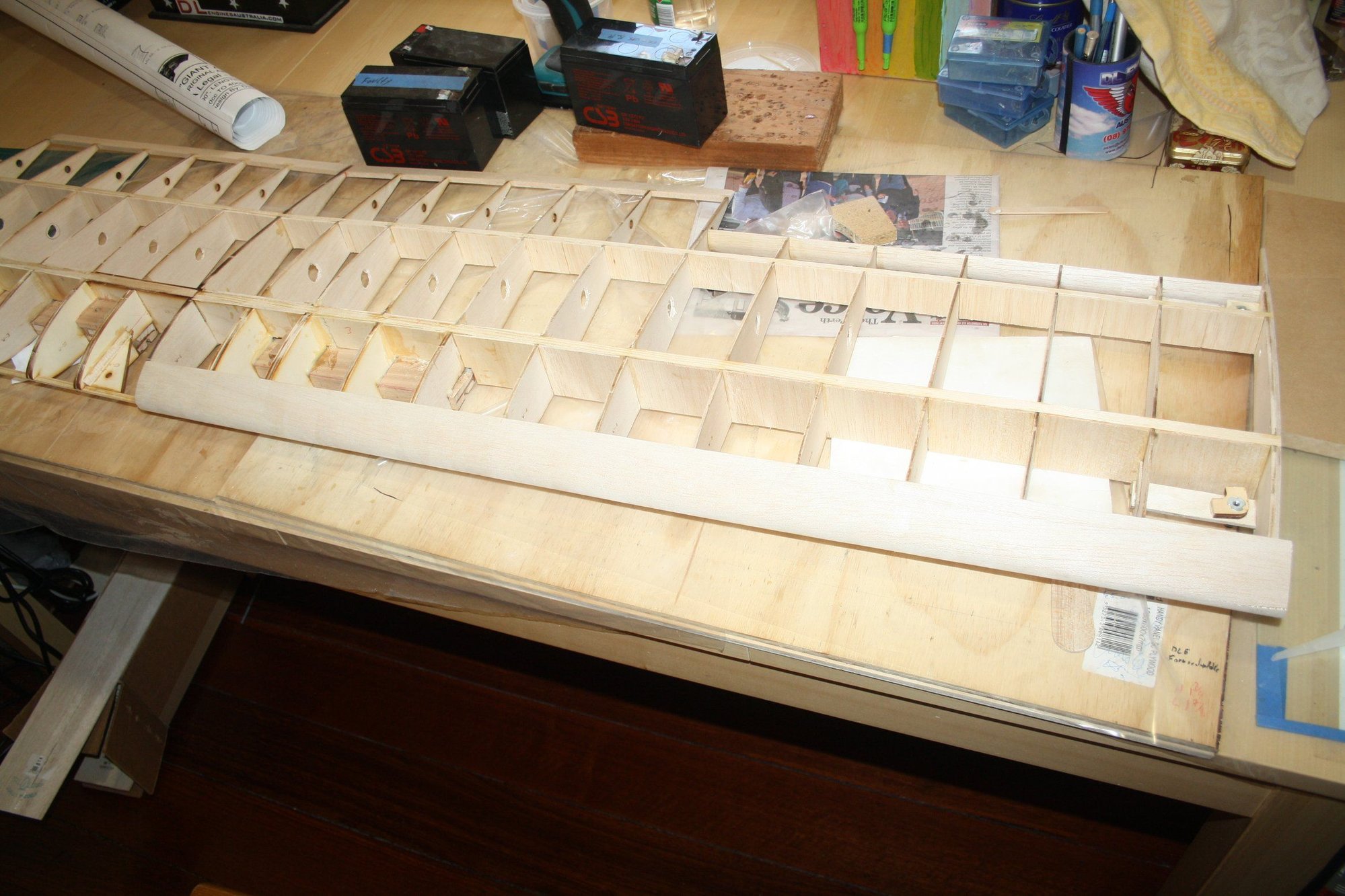

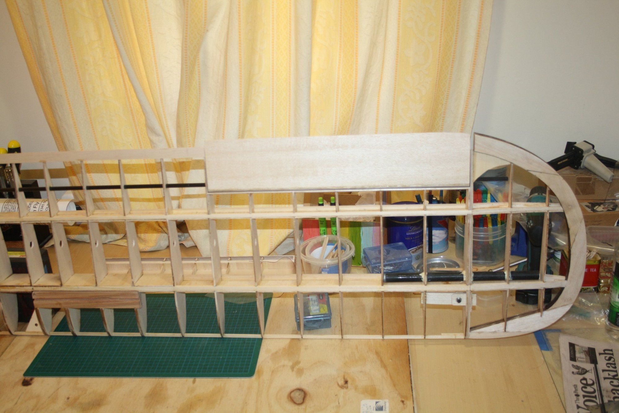

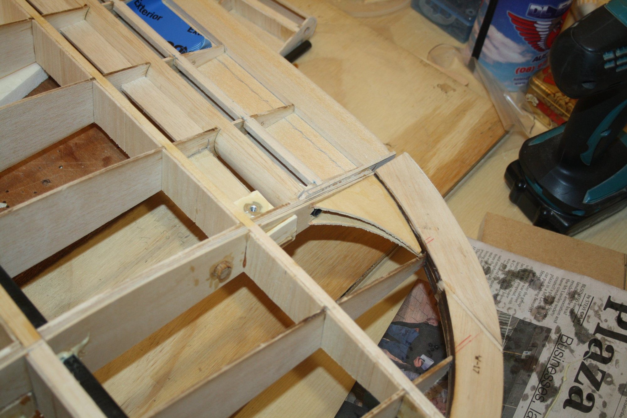

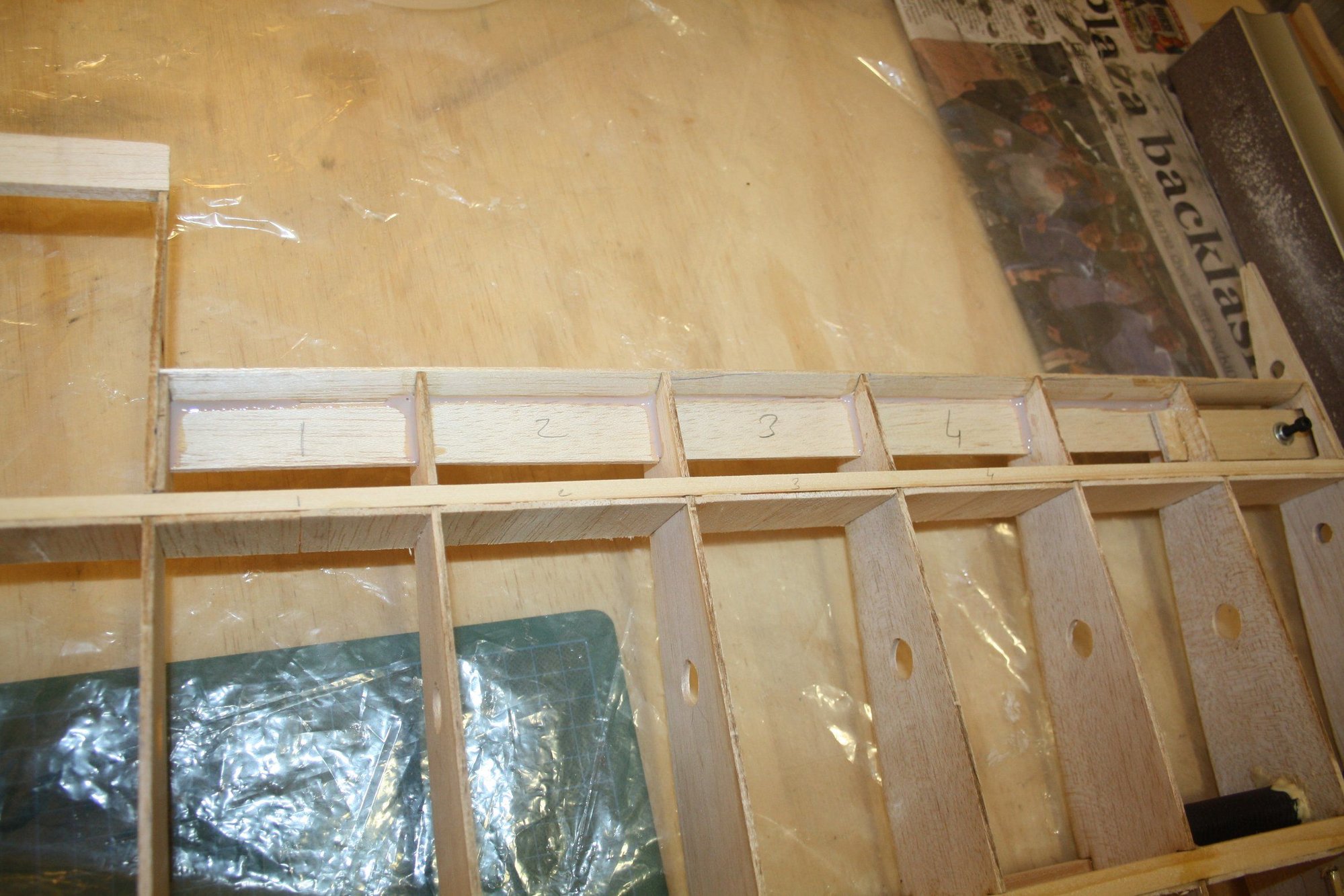

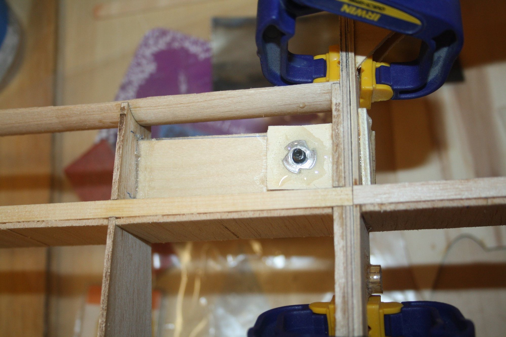

With the LE sheeting out of the way, I can now get on with the final touches for the wing construction.
I took advantage of the easy access to the front mounting wing-bolts plate (located inside the wing, mid ribs height) and made a cardboard tube (out of toilet paper roll) to serve as a guide for the wing-bolt. This is another deviation from the plans which calls for a "foam insert" between the sheeting and the plate.

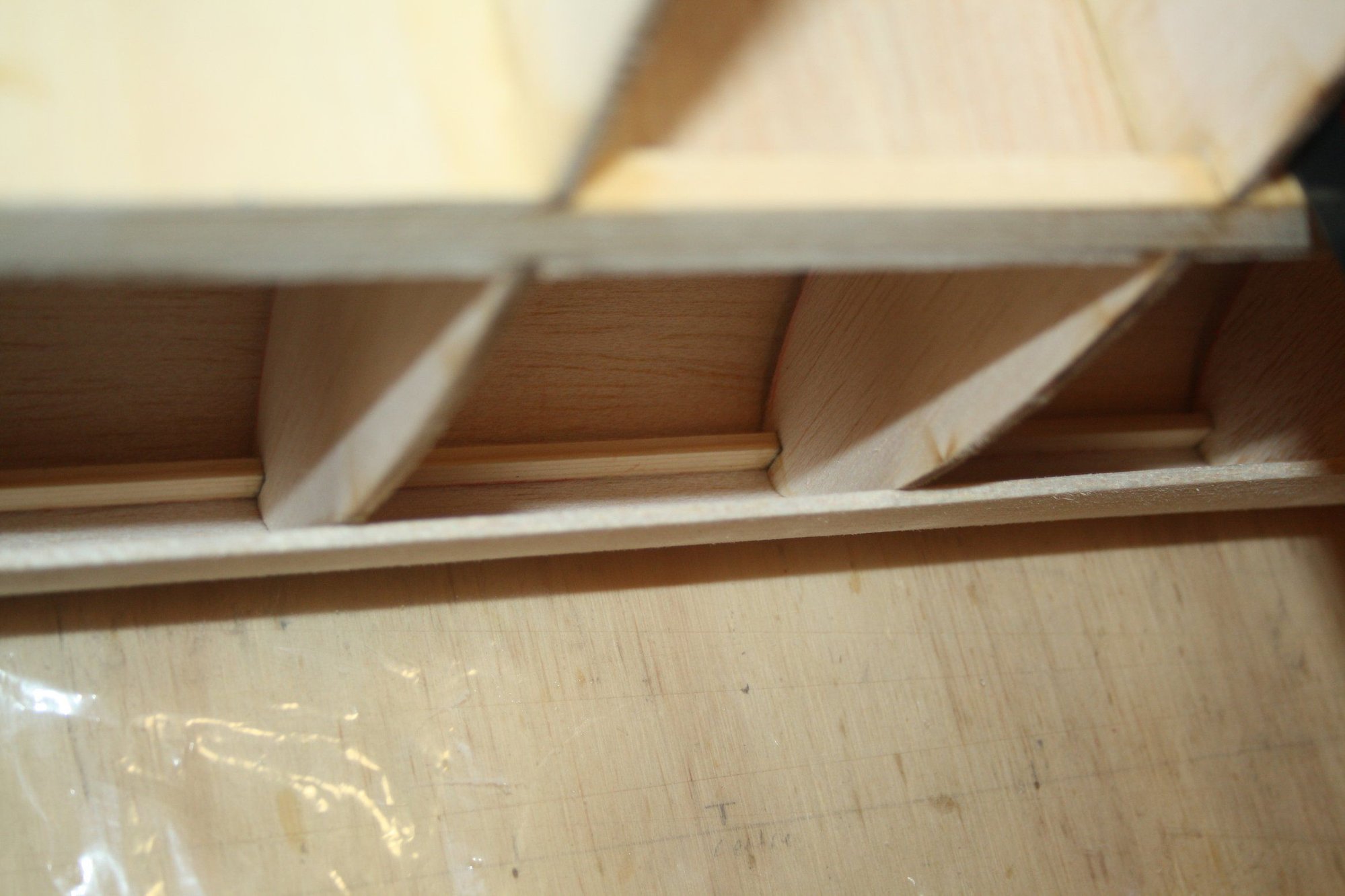

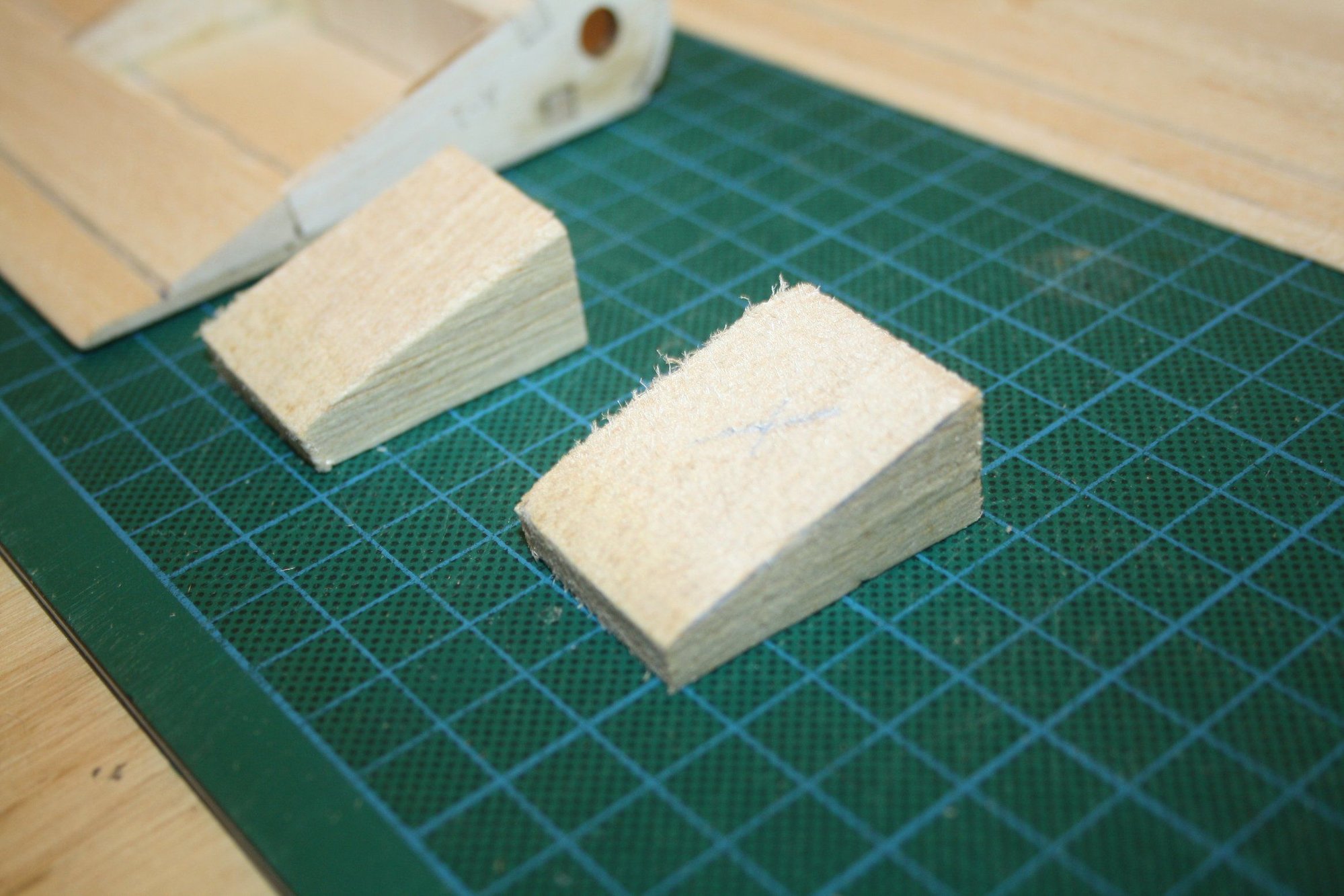

Next, I added the 7/8" x 3/32" balsa pieces to the back of the TE at the ailerons section (the curved TE).
Cheers,
Eran

Bottom of the wing TE sheeting.
Cheers,
Eran

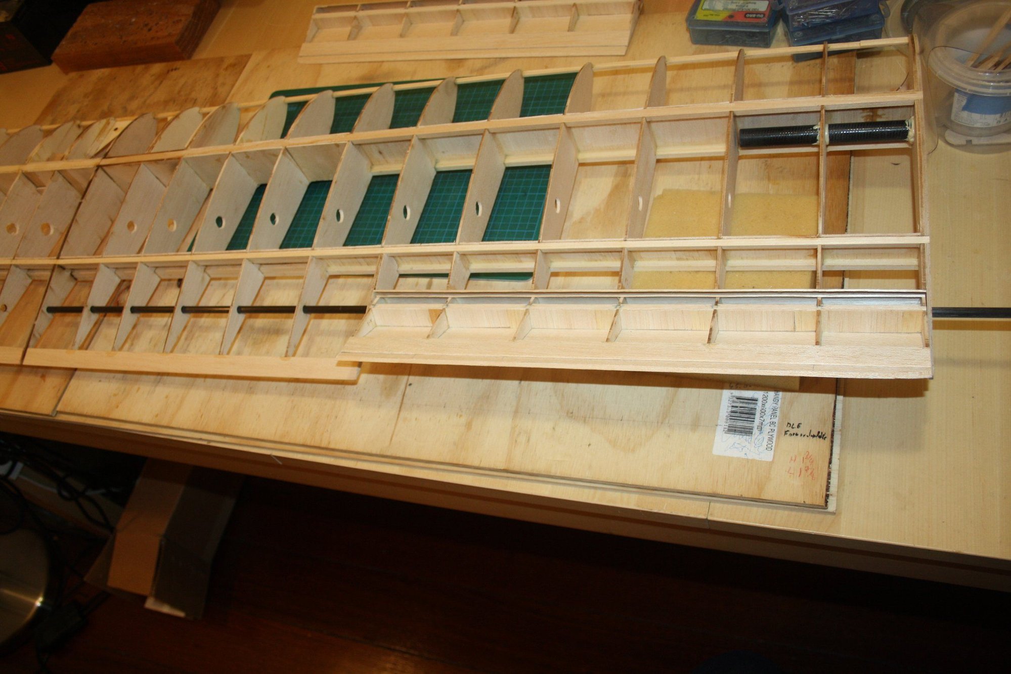

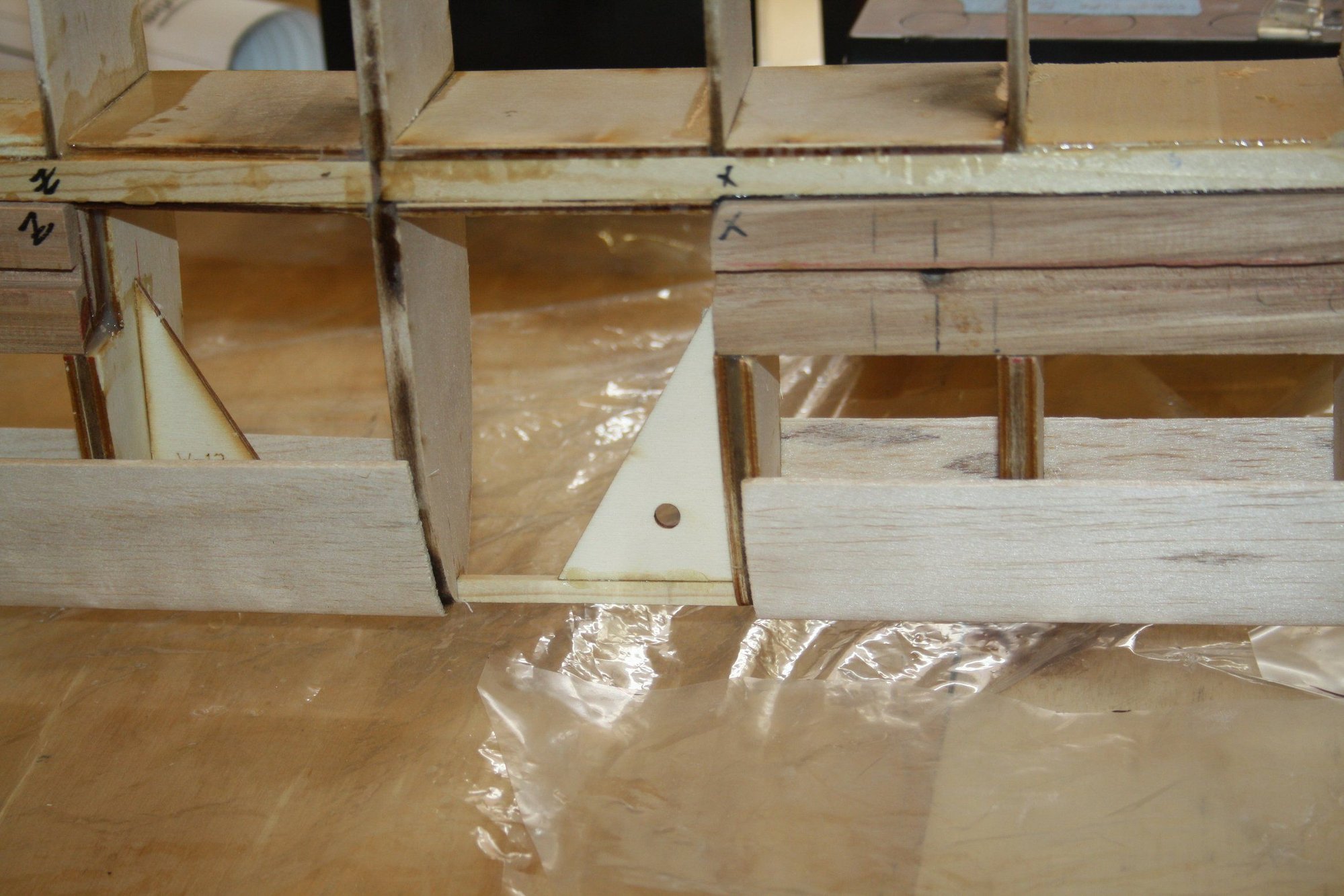

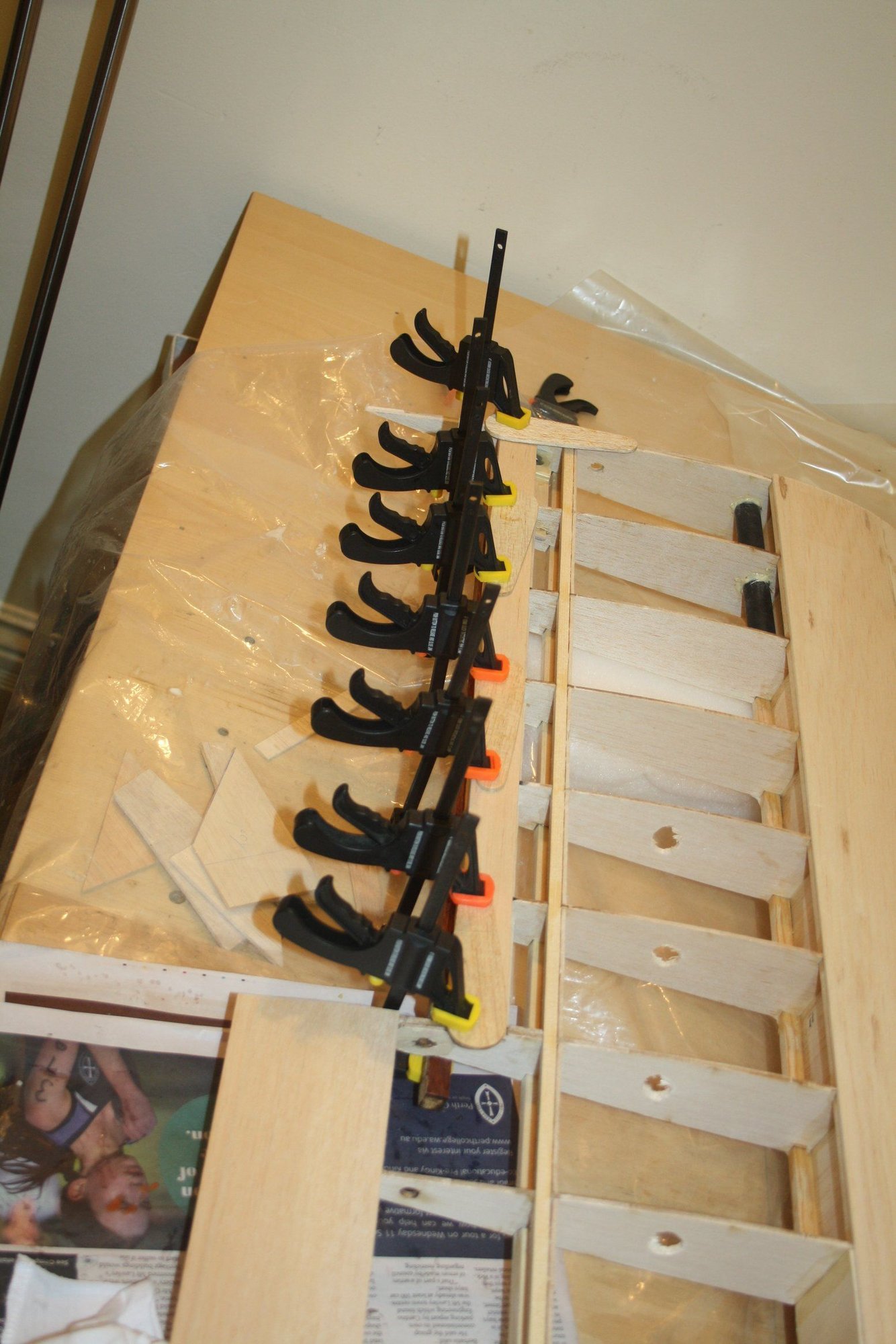

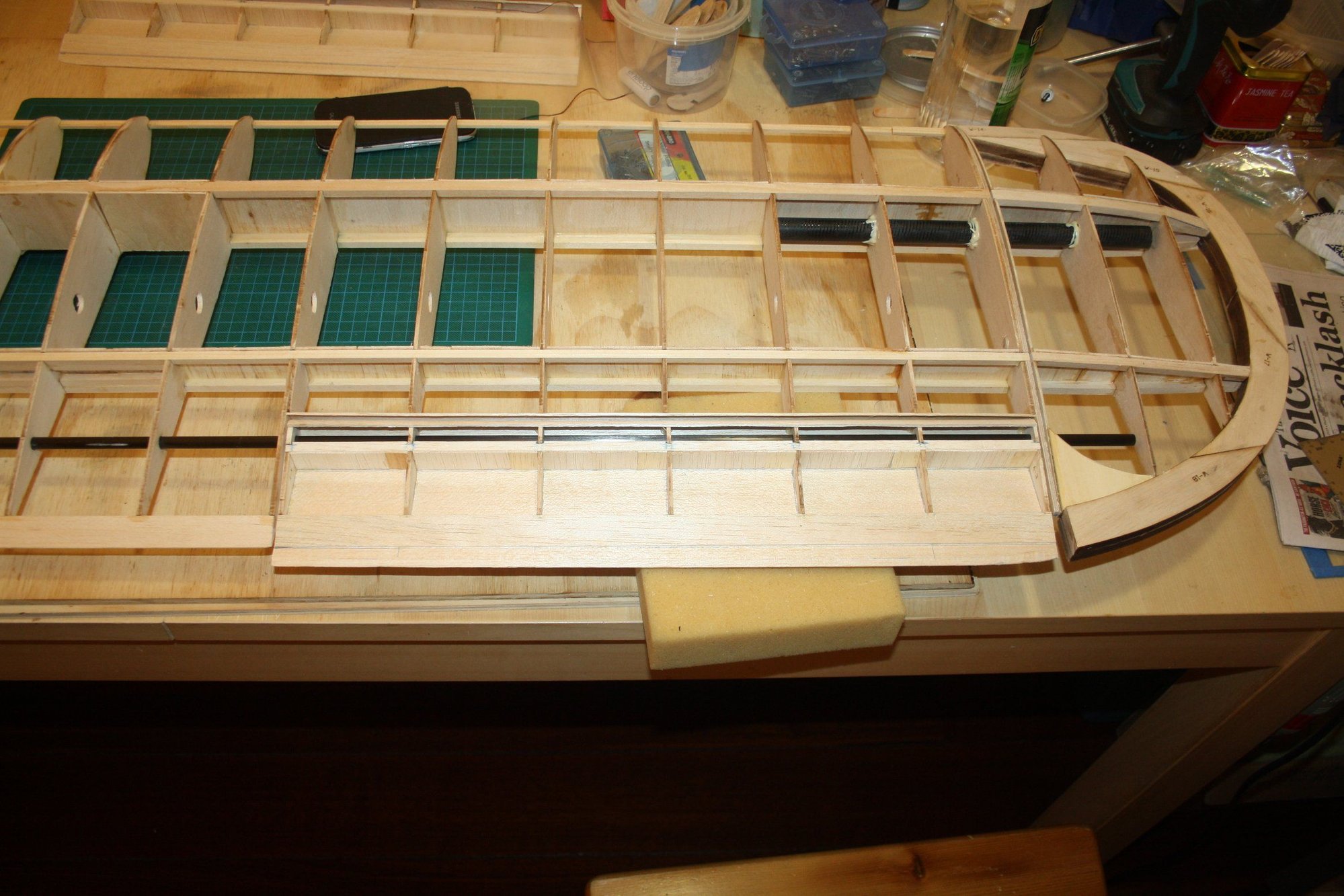

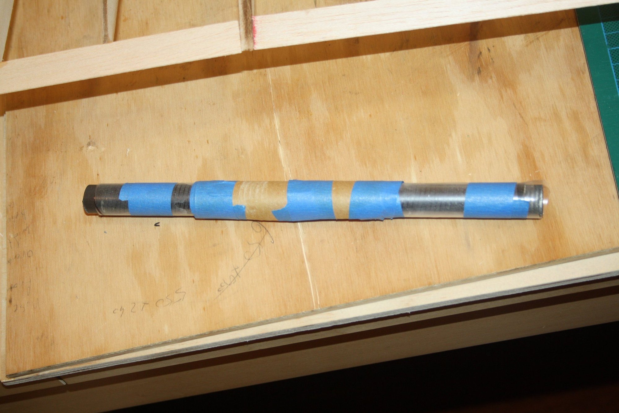

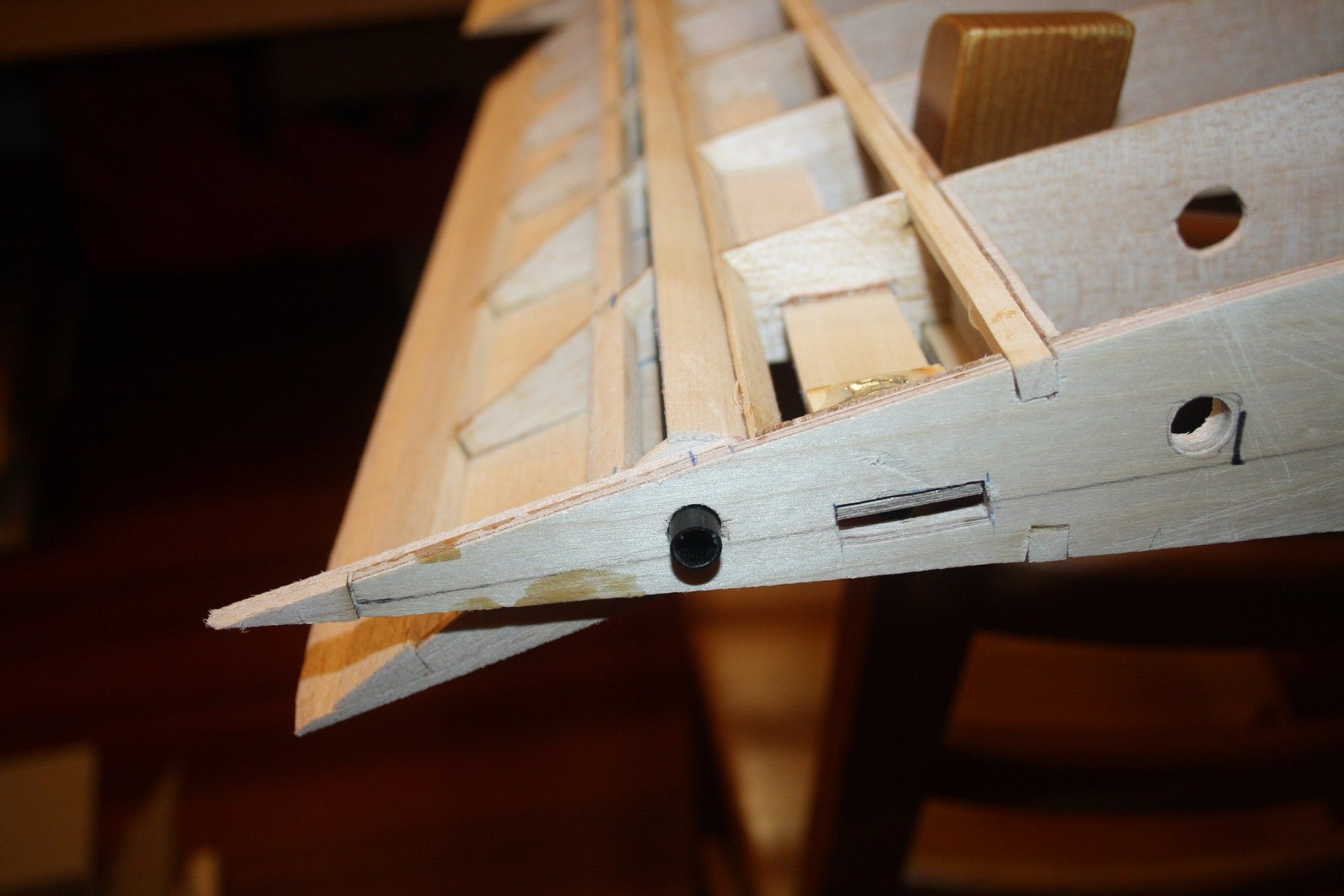

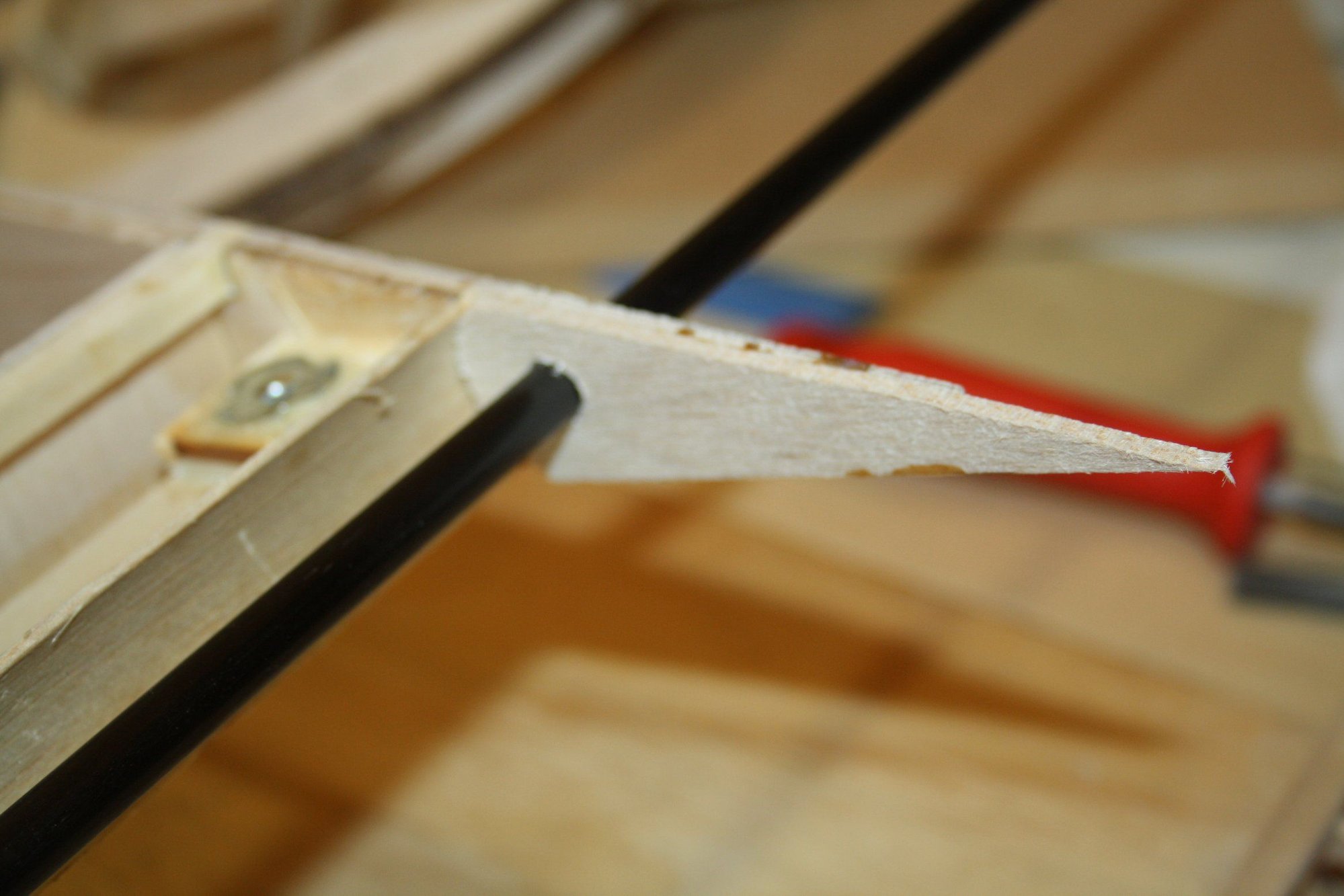

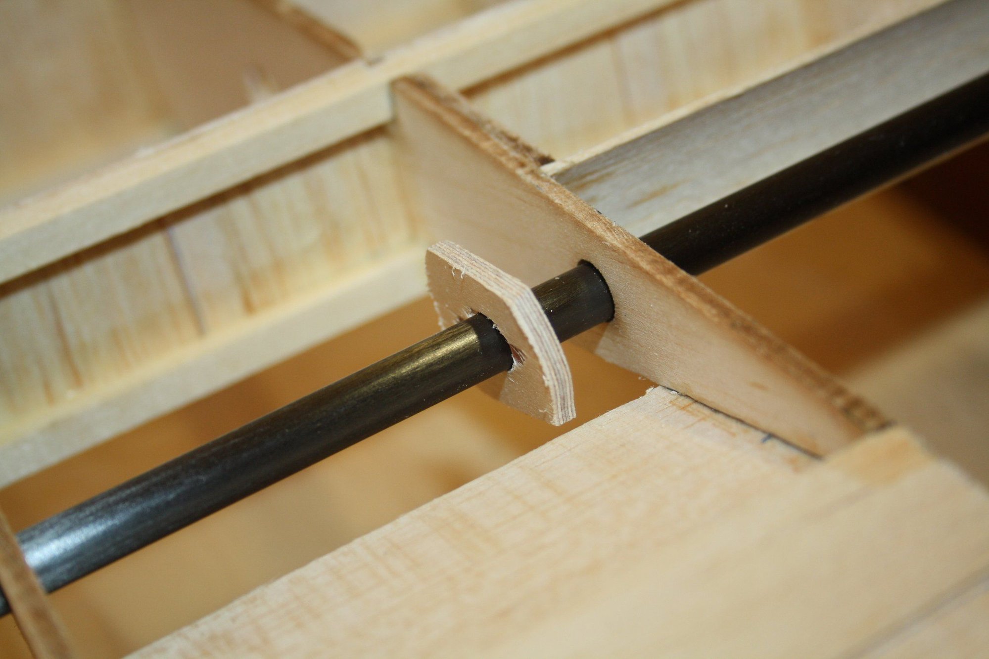

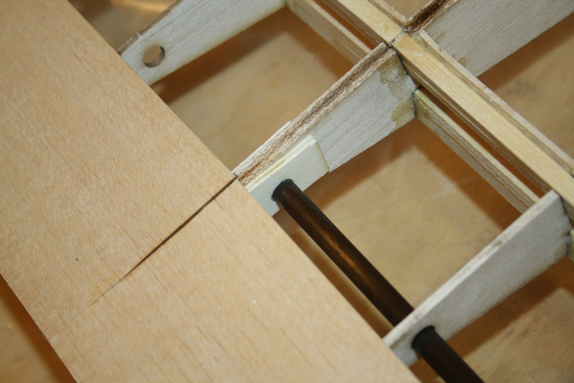

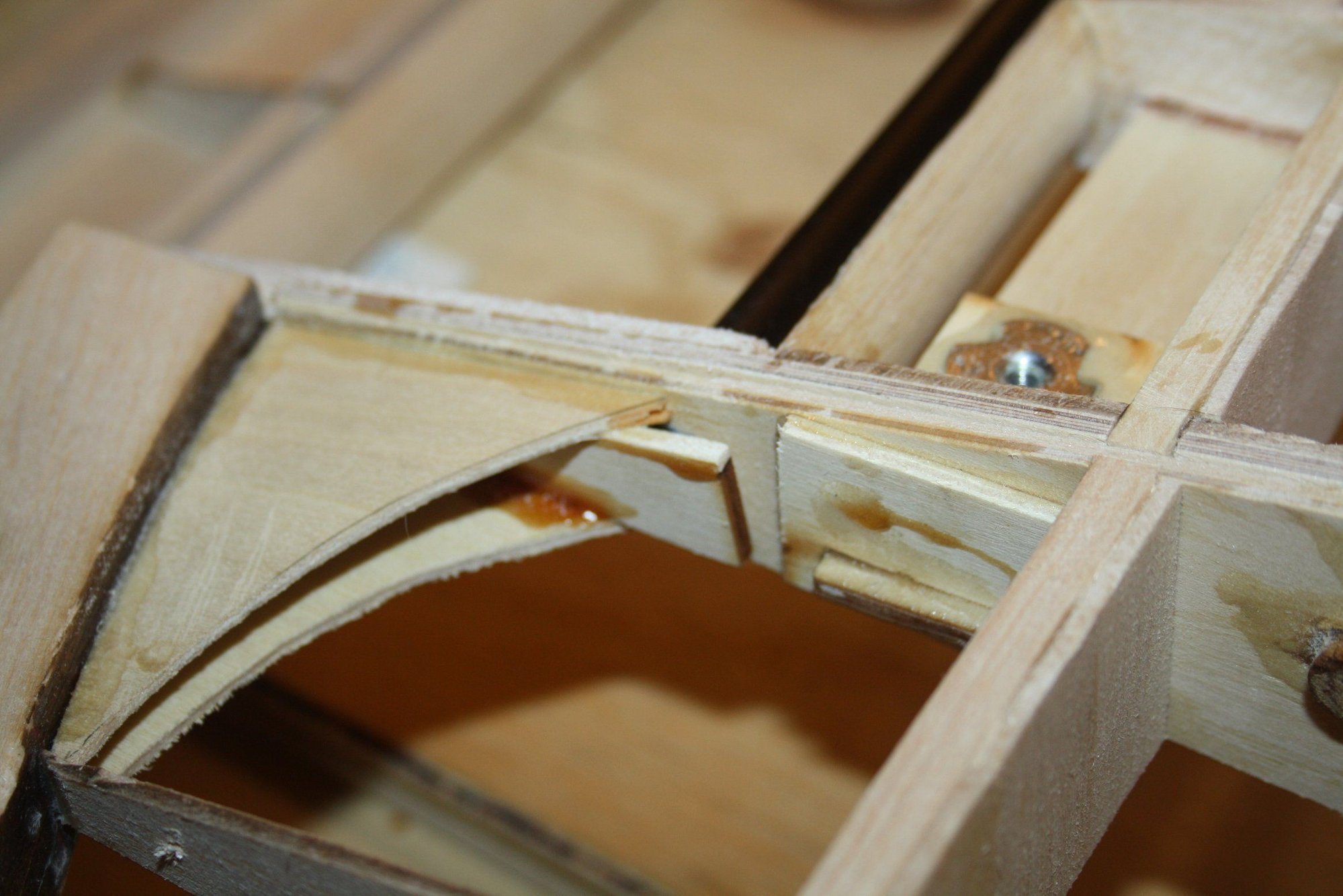

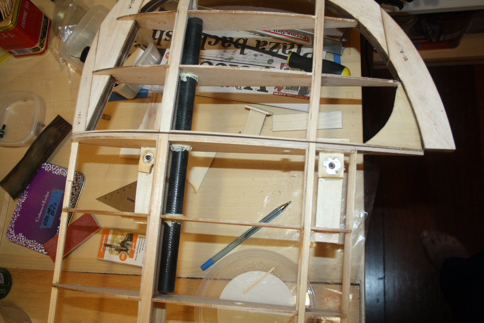

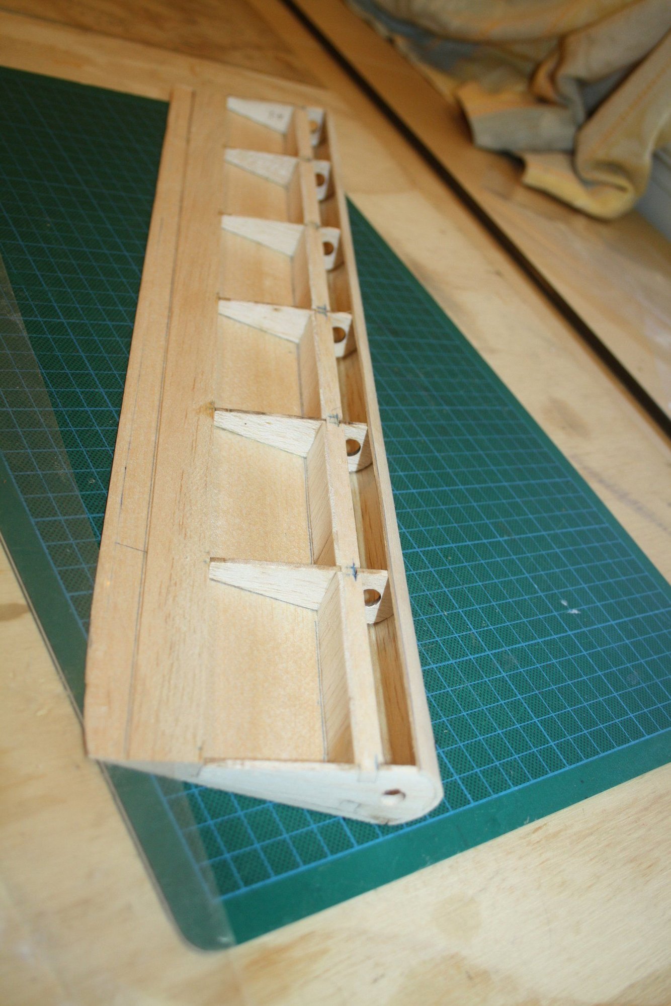

Continuing with work on the wing, I am getting close to permanently fixing the ailerons in place. My current plan is to glue the ailerons to the rod, which will rotate freely in the wing acting as the hinge.

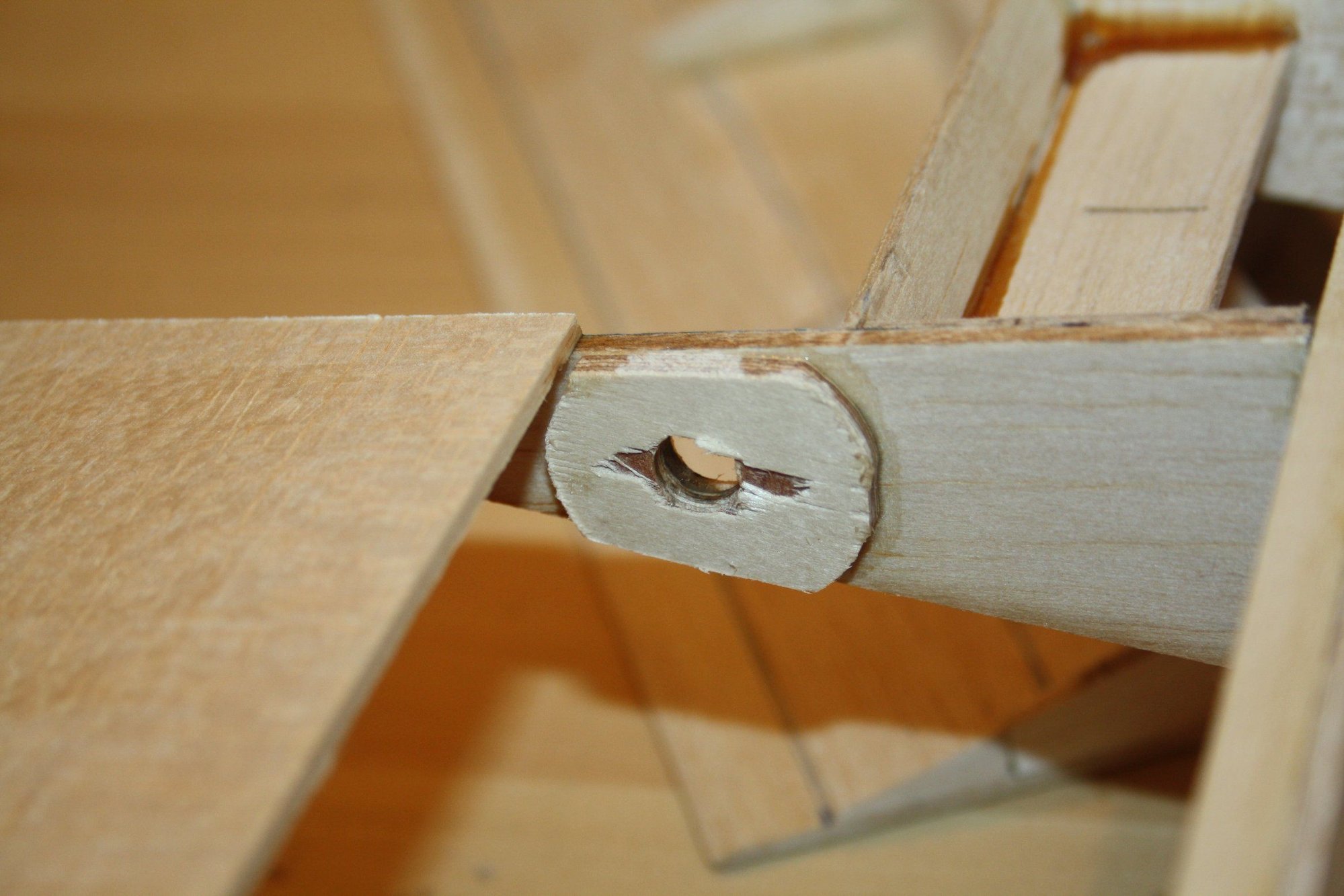

To stop the ailerons from moving sideways in the bay, I glued additional pieces of balsa to the "side wall" so the fit has almost no gaps (only the width of covering material).
Next. I glued a birch-plywood "bushing" to the inboard balsa rib (the outboard rib is already birch-plywood).
I glued a piece of plywood to the balsa rib W1 where the rods ends touch, and made a similar arrangement in the wing-tip. This locks the rod in place preventing any side movement.

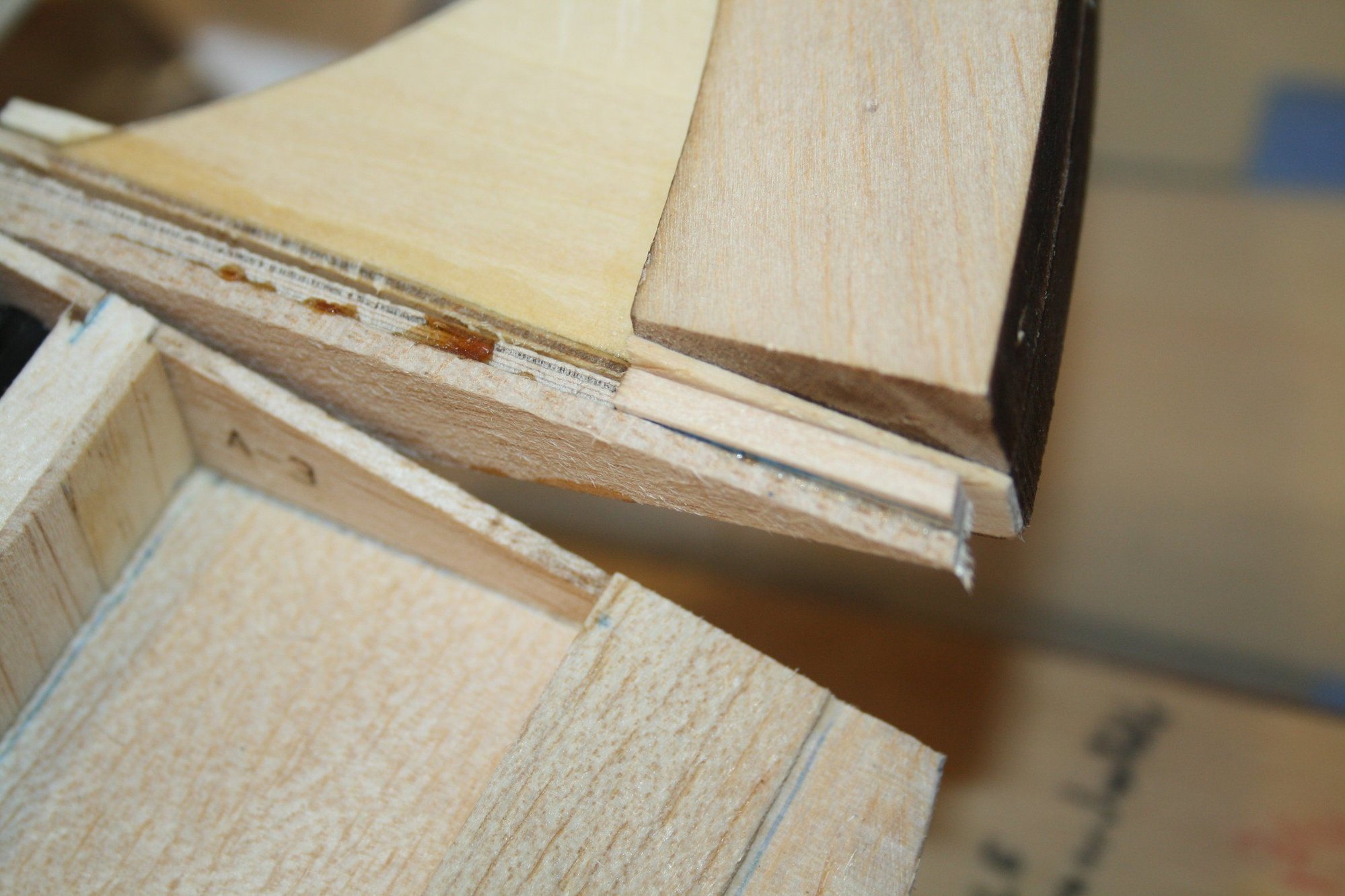

I then did some cosmetic work to the fitting of the wing-tip and the wing TE (where the plywood ribs I made had a blunt end).

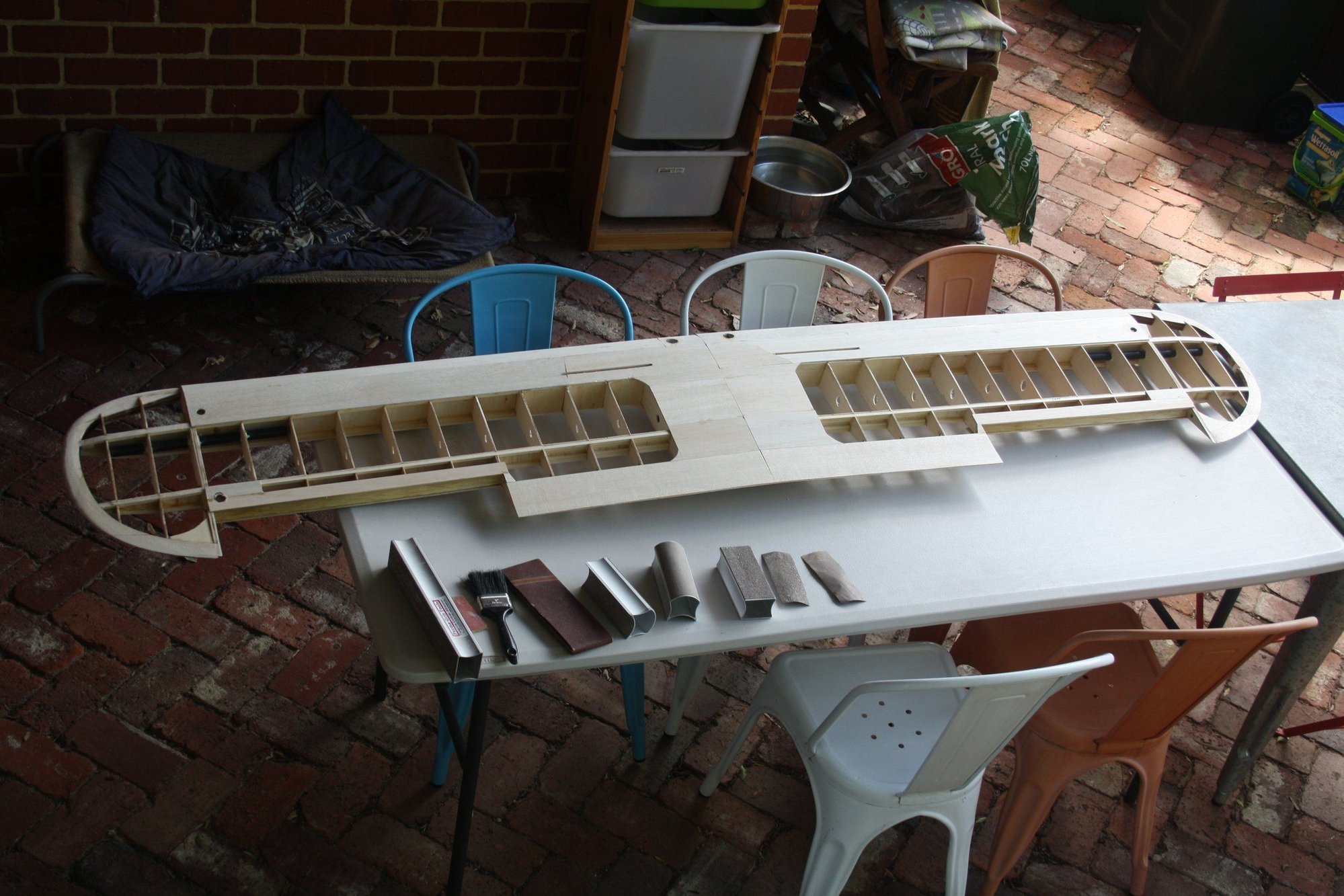

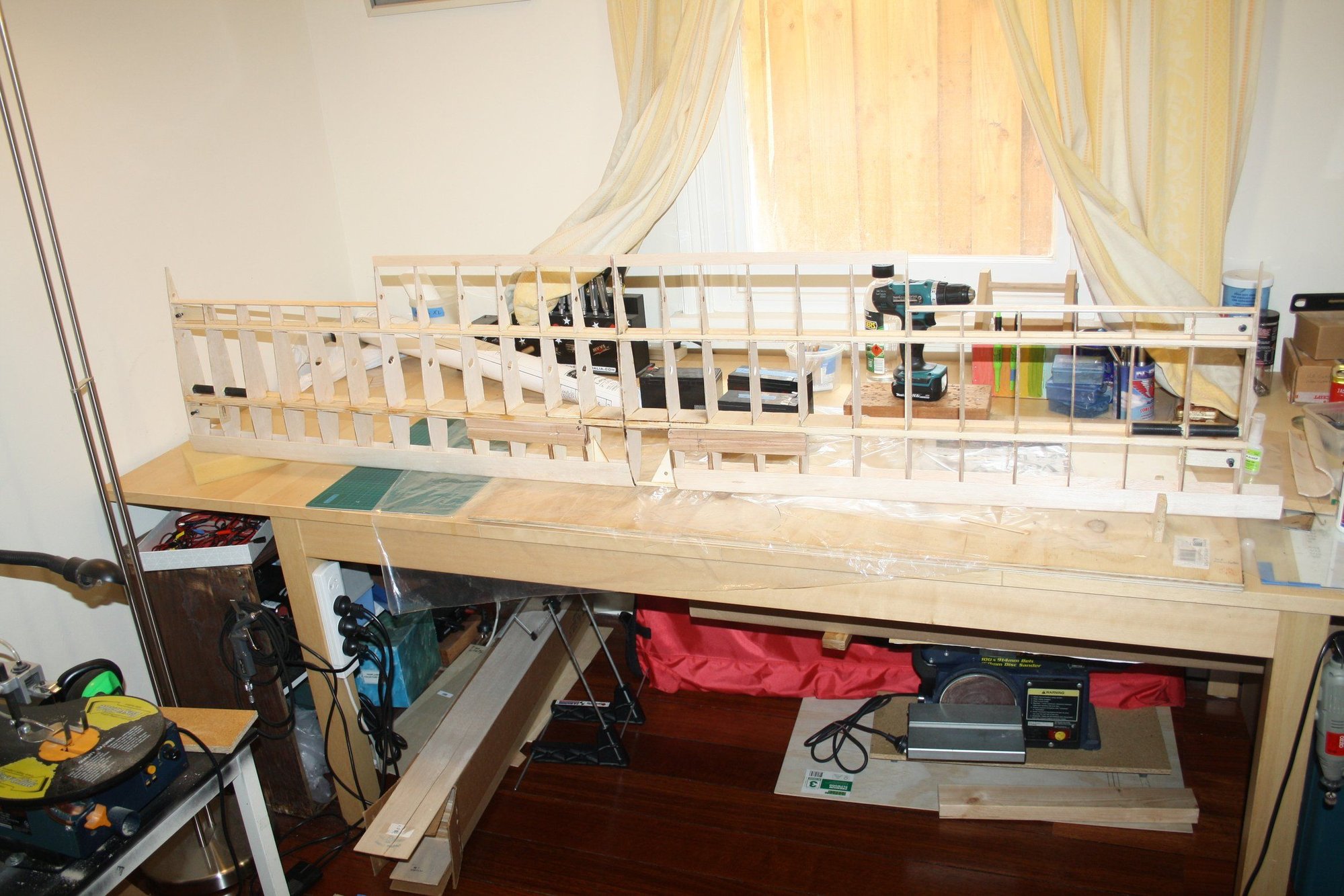

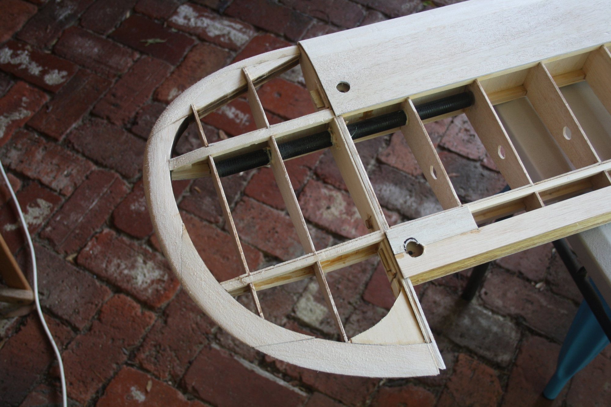

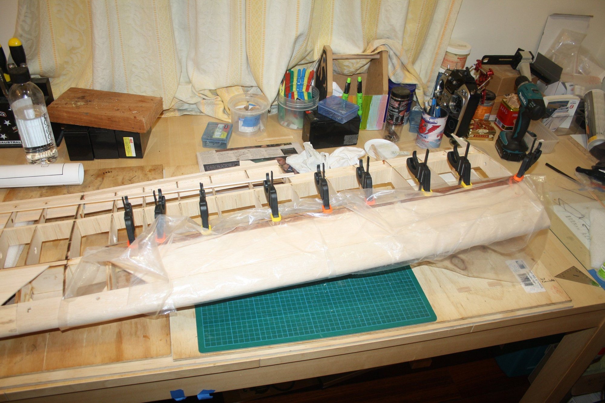

More wing sheeting on the Astro Hog. The D-Box is now complete and the top side TE is drying on the bench.
Cheers,
Eran

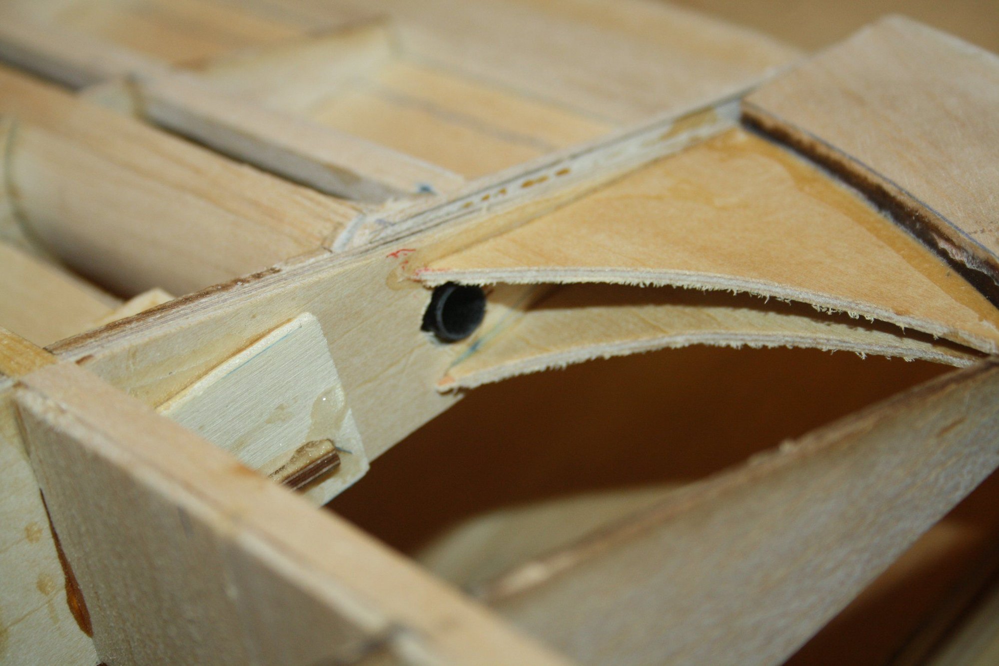

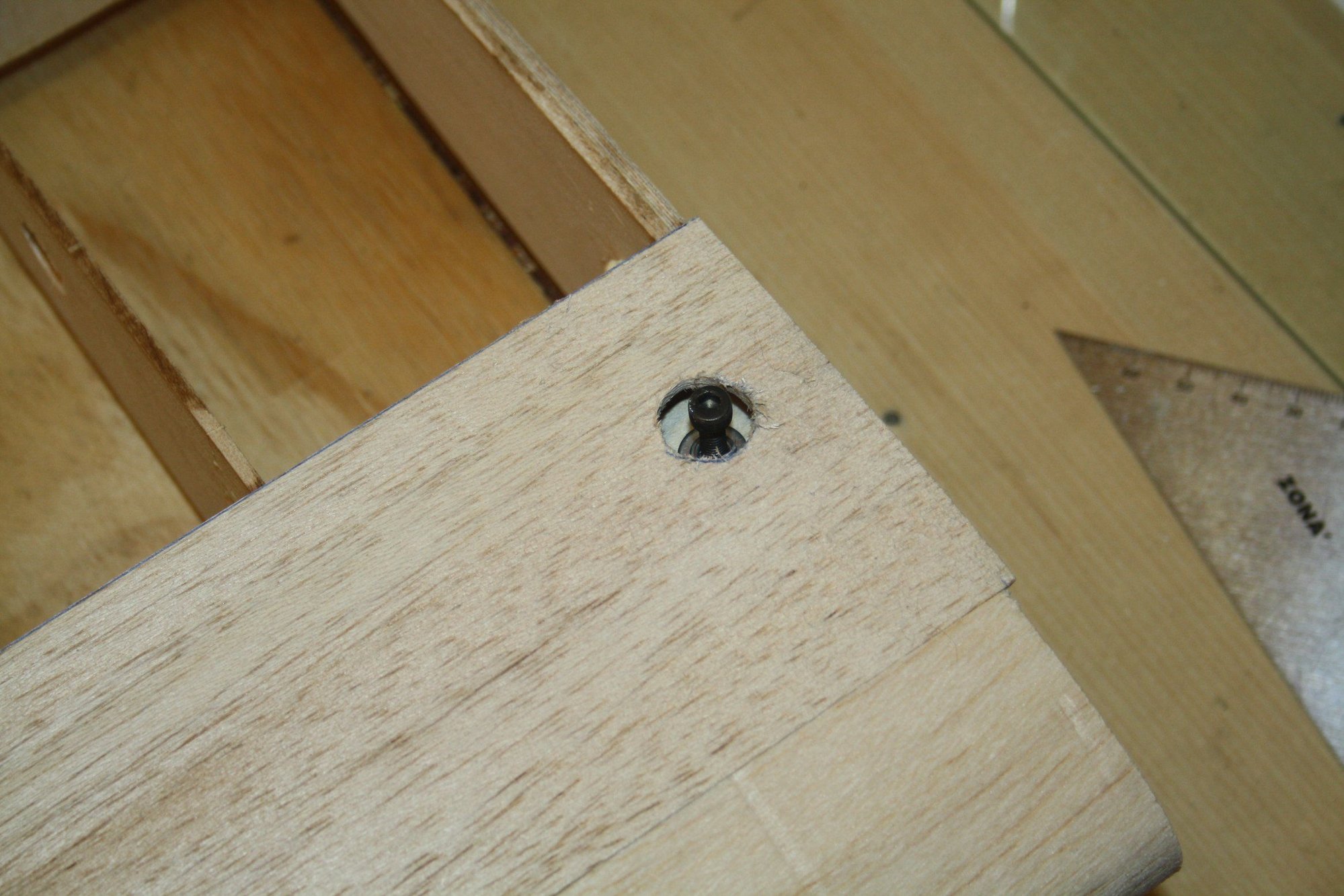

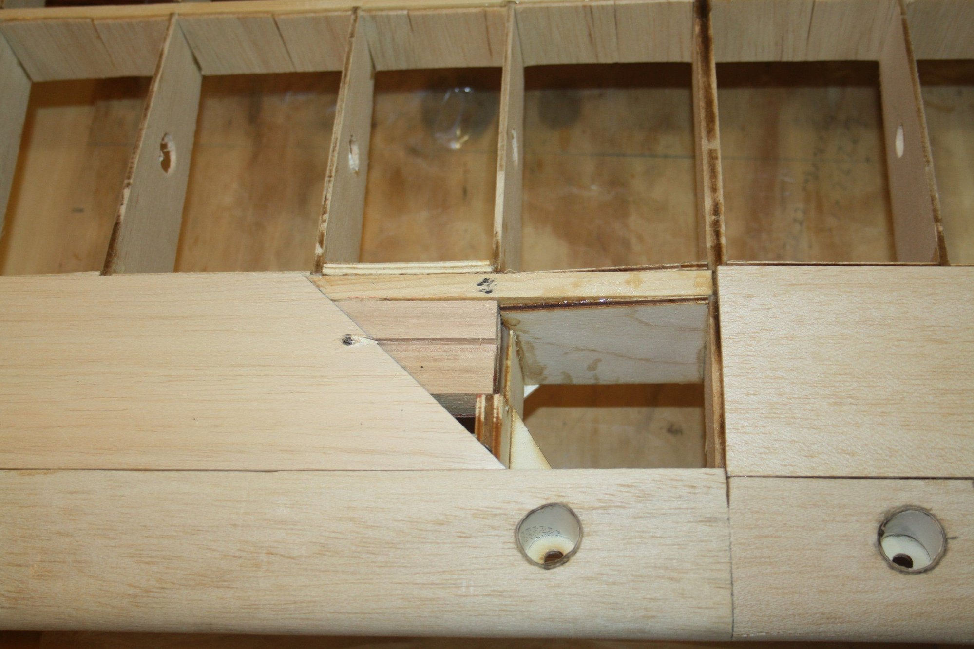

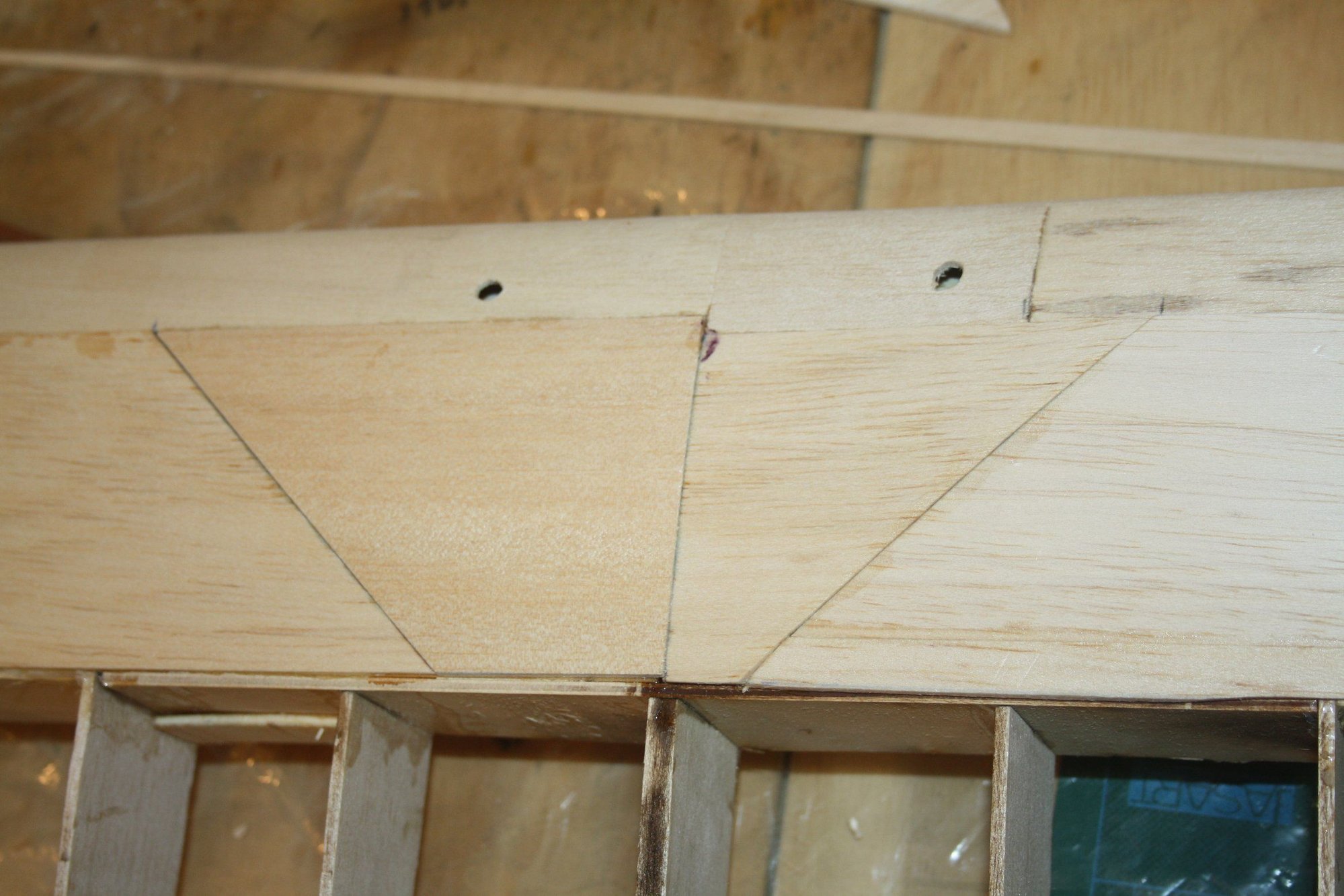

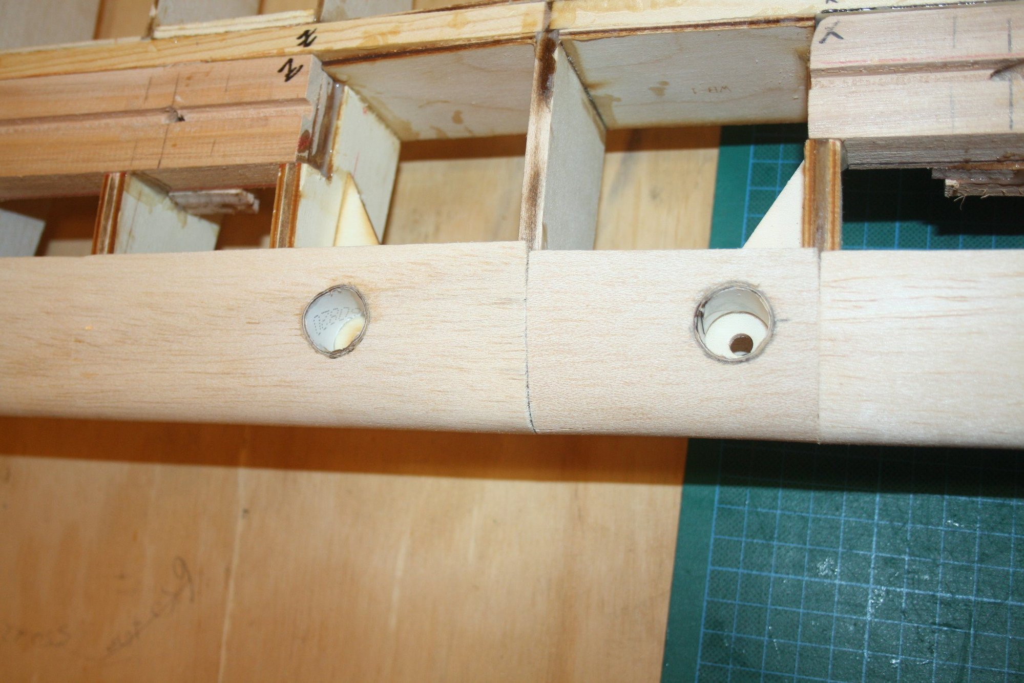

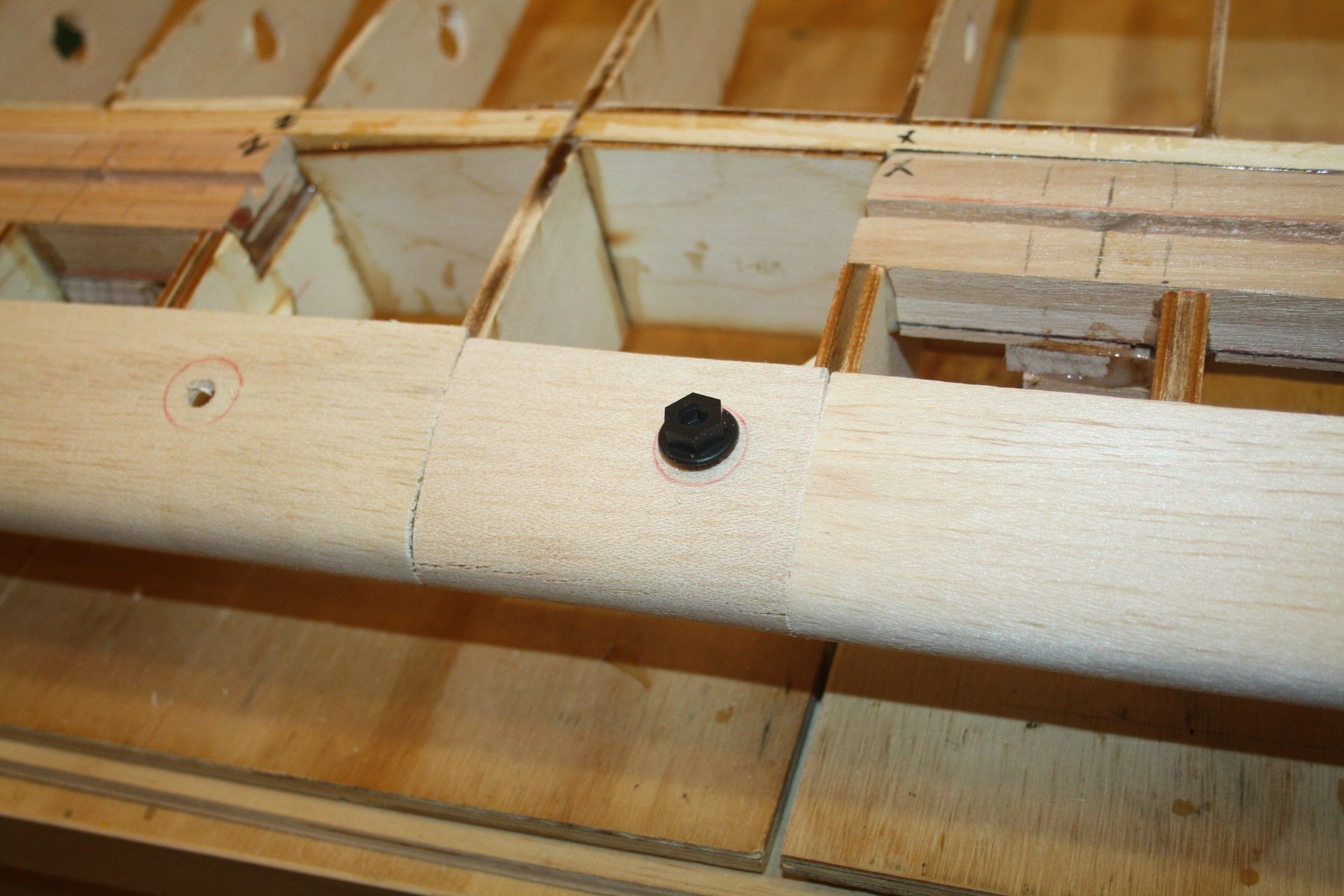

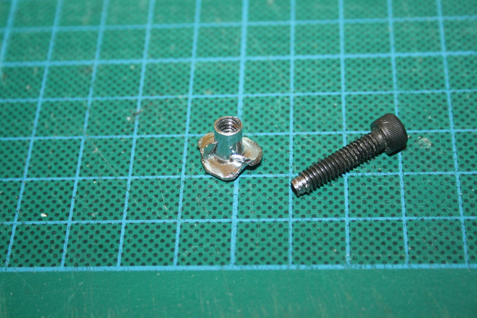

Finishing up the centre section TE sheeting, I was about to sheet over the ailerons section TE as per the plan. I suddenly realised that if I follow the plan, the aileron will be restricted in movement as its LE raise above the rib height. A quick test confirmed this (see photo). I therefore moved the sheeting slightly further to allow the aileron to clear the sheeting.

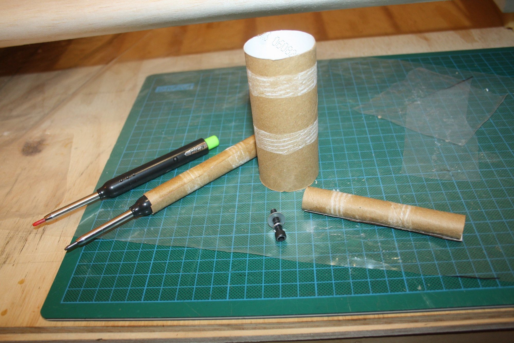

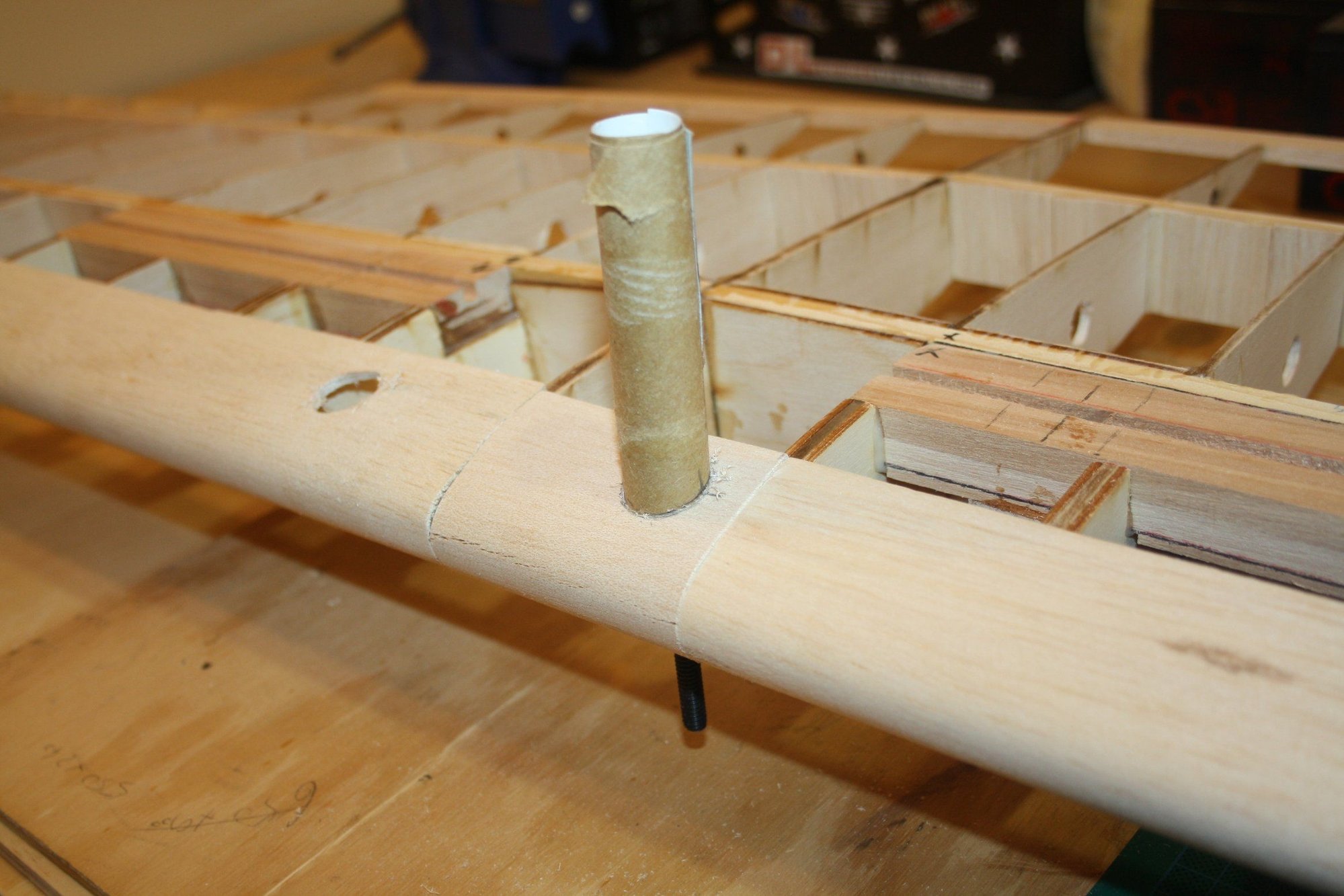

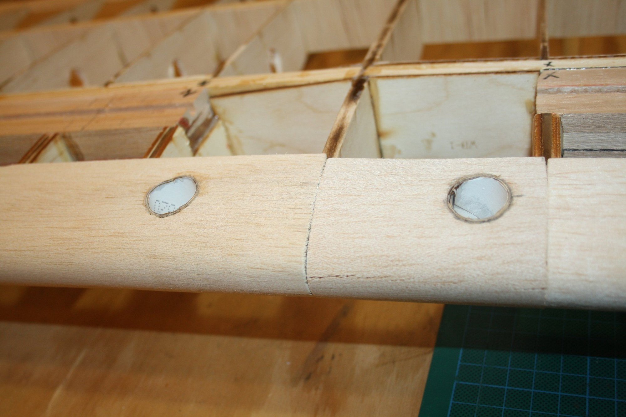

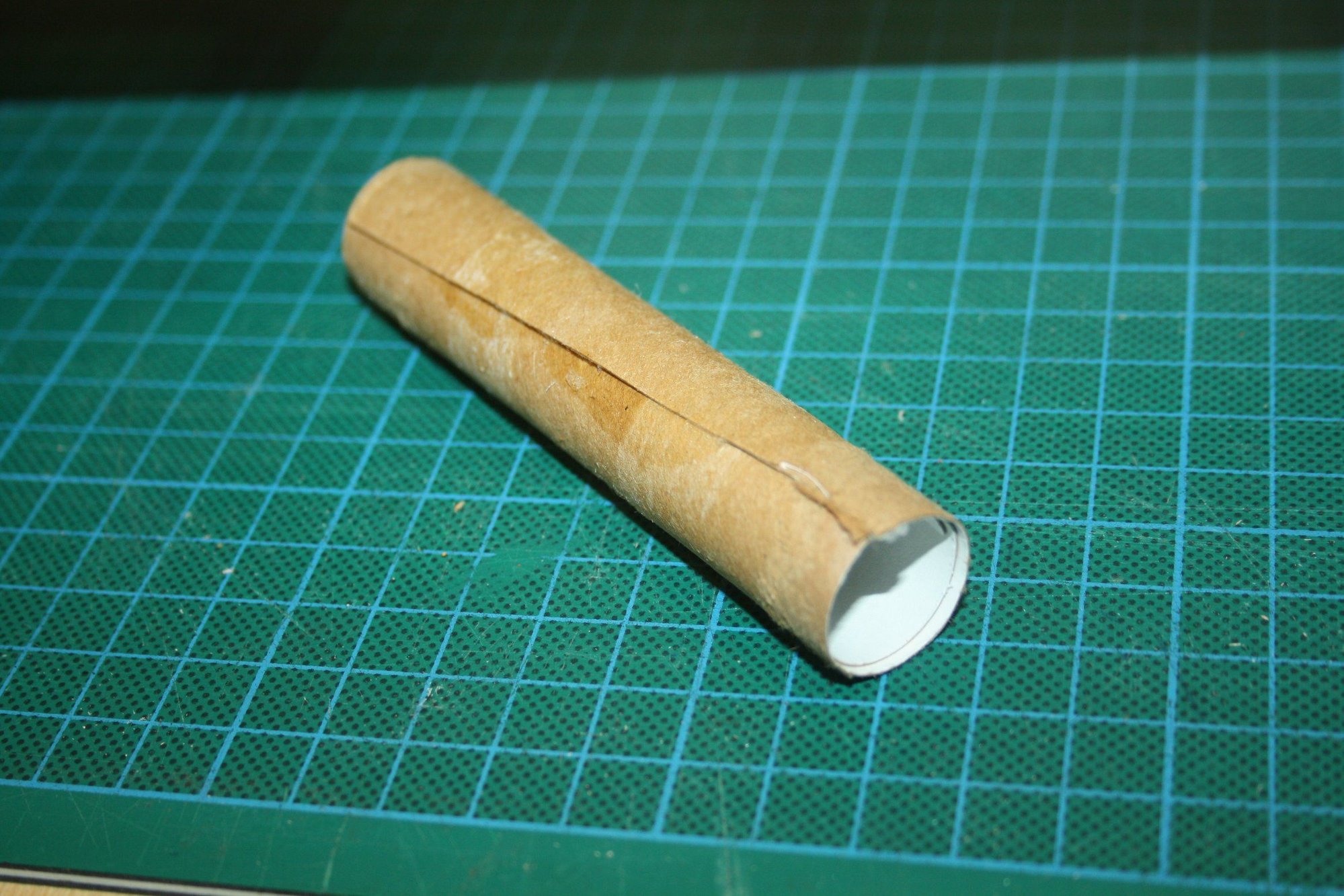

Next, I was preparing the cardboard tubes for the wing-tip screws.

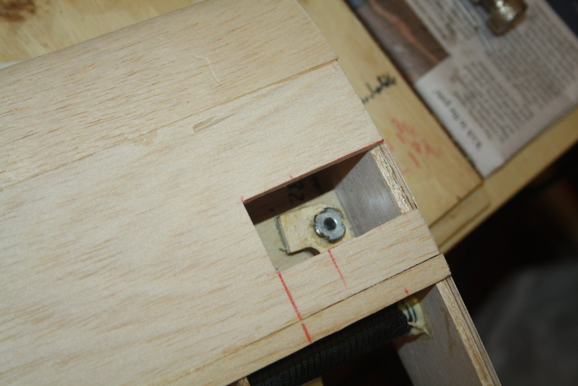

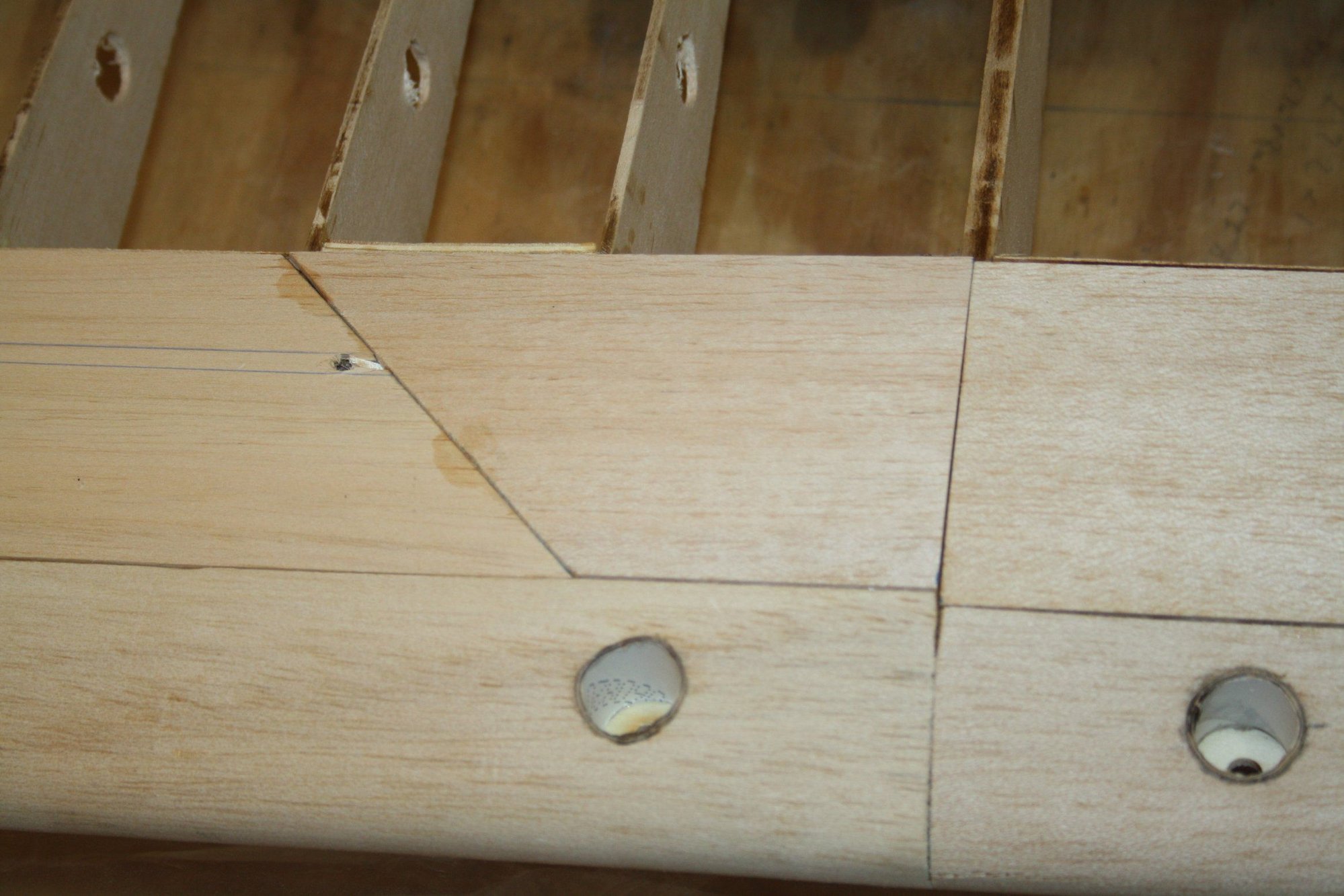

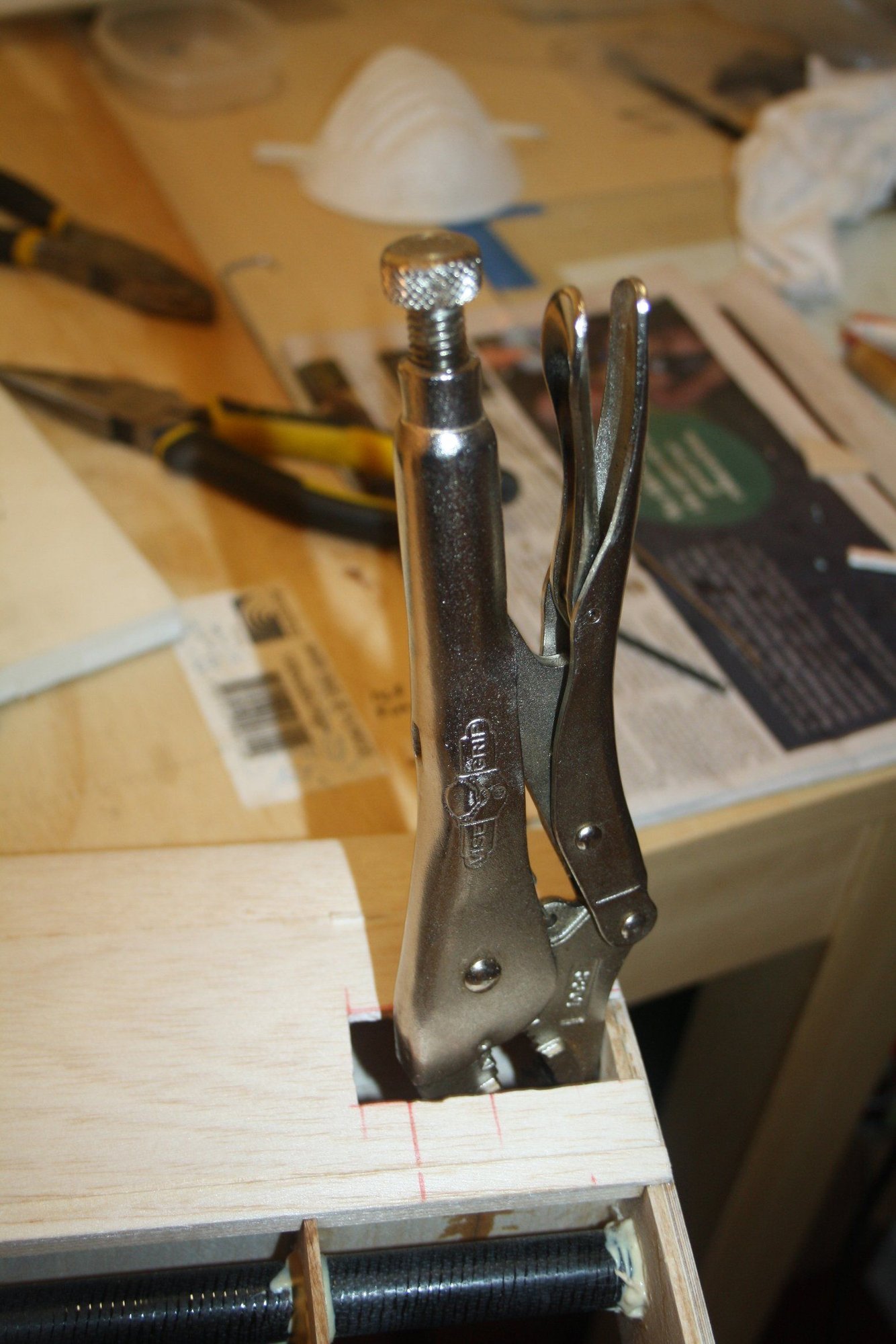

As I was testing the fit (by inserting the screw into the lock-nut), the screw got stuck and would not move to the point that the lock-nut came out of its hold.
Since the lock-nut resides within the D-Box, I had to cut the sheeting to allow me to grab the lock-nut and release the screw. I have exhausted my vocabulary of MA+ rated words in multiple languages during this episode.
What else will go wrong with this build?
Cheers,
Eran

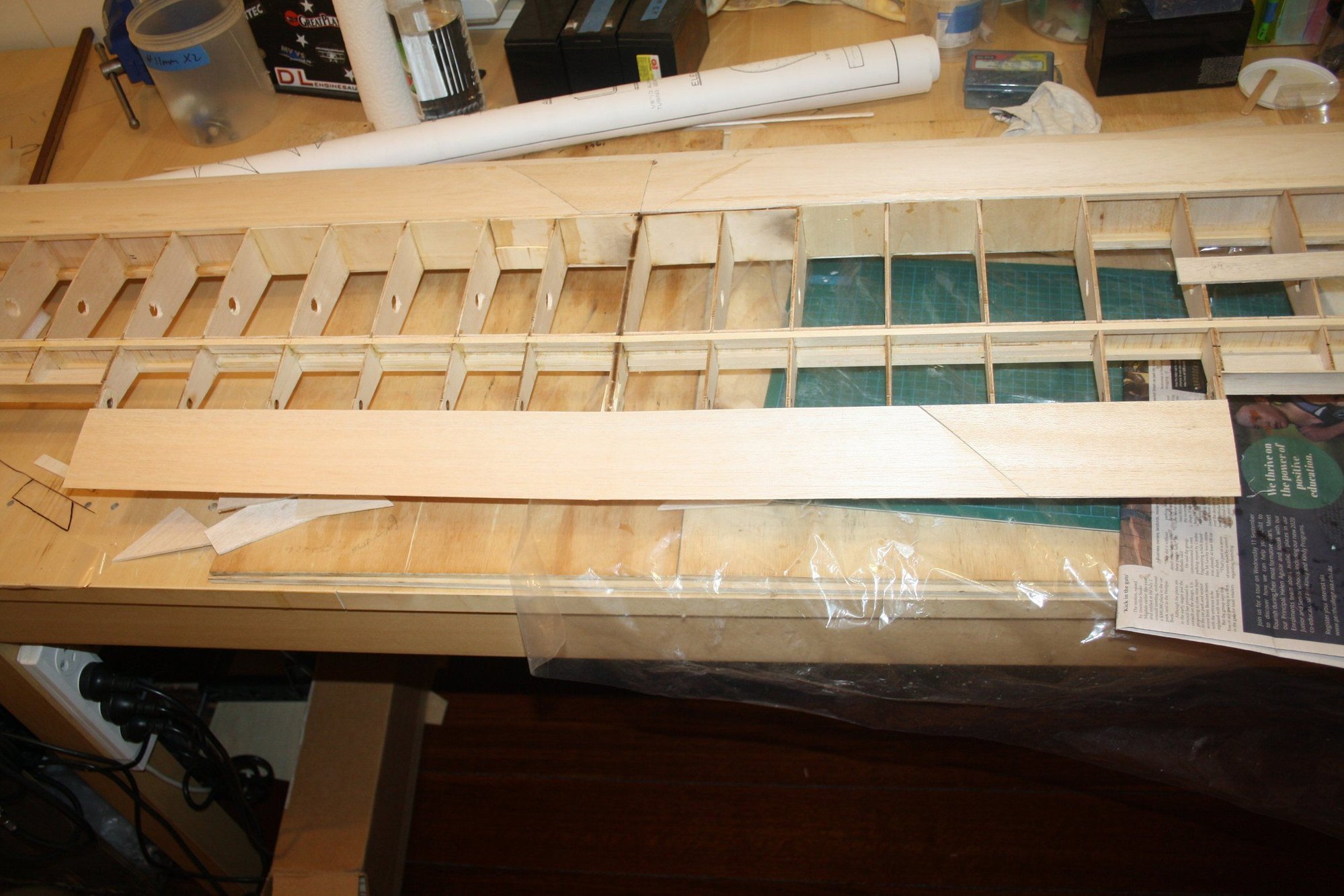

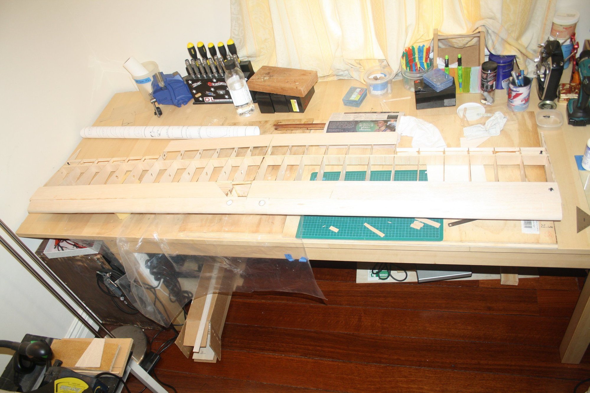

Some more sheeting...

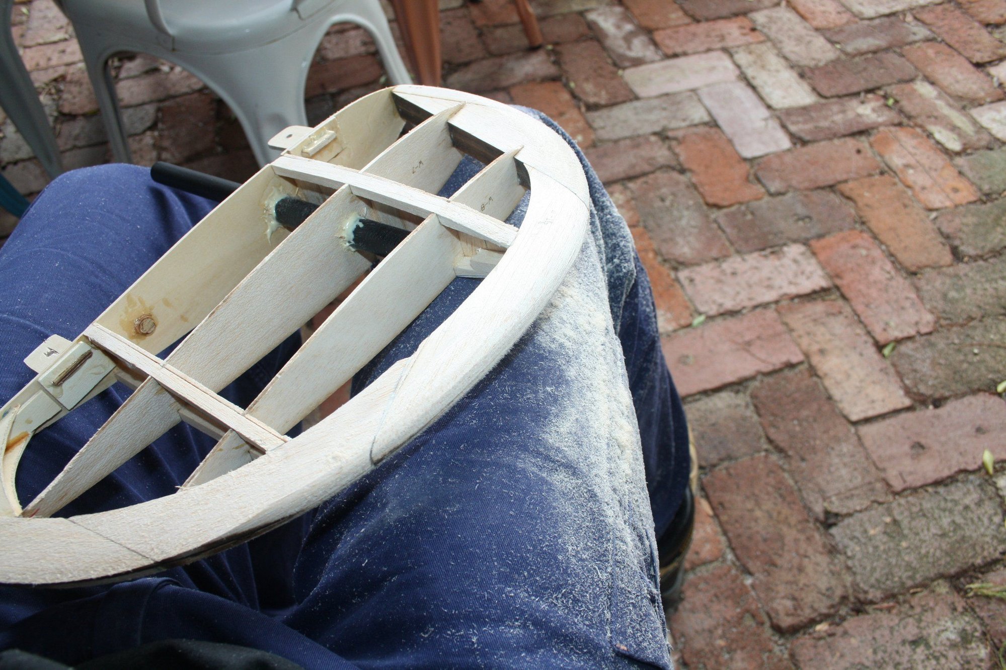

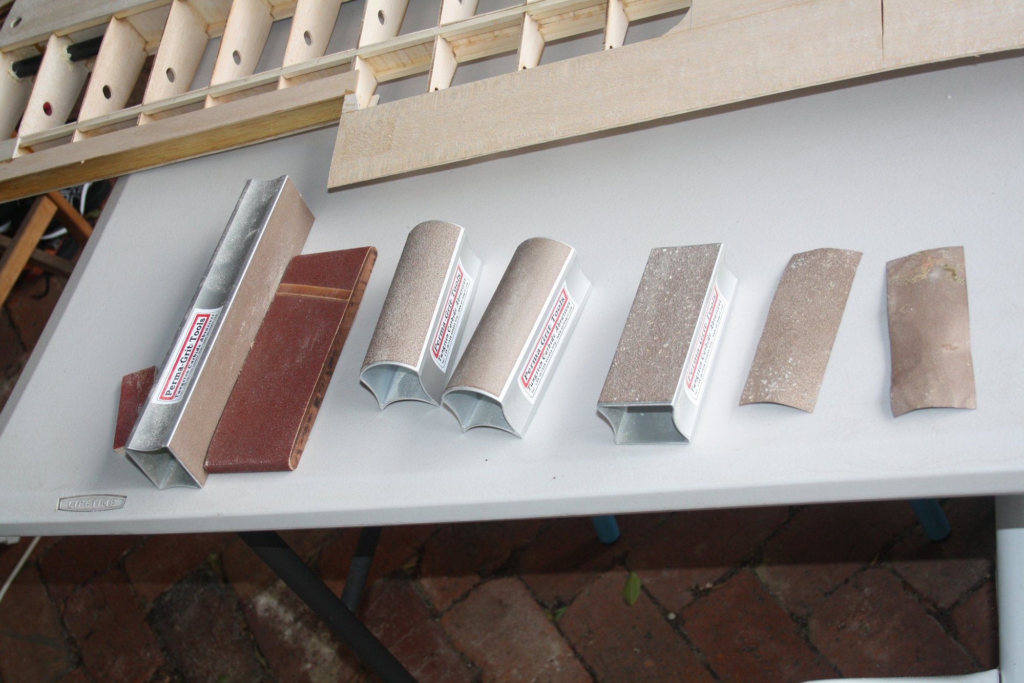

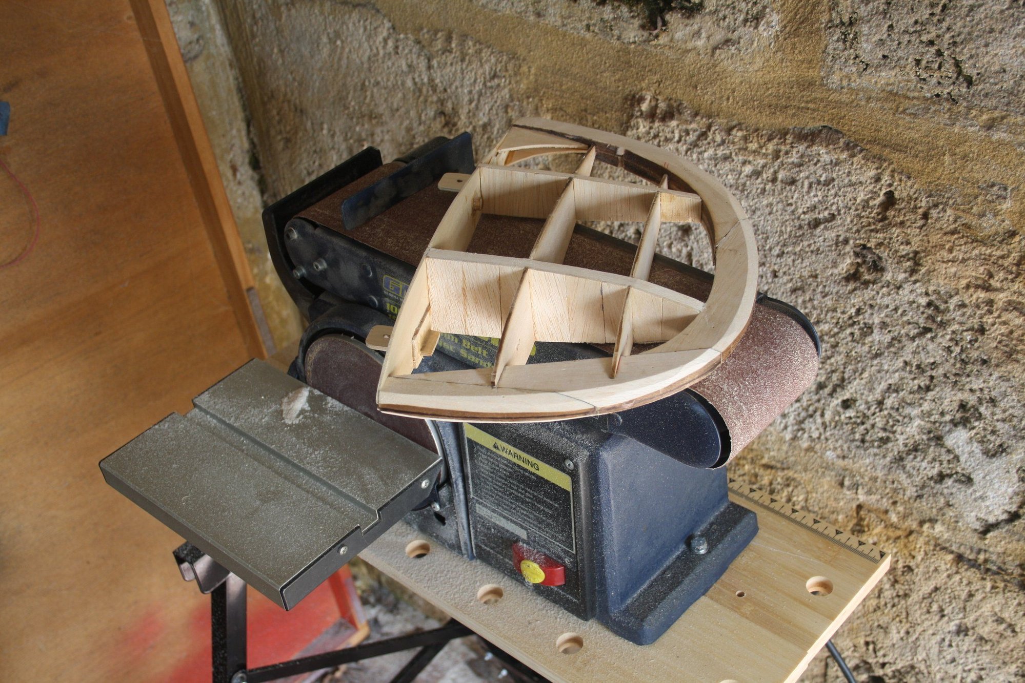

Today was the day to tackle the wing-tips sanding.
A friend gave me his old belt-disk sander a while ago and it was time to cover it with balsa dust for the first time. Once the majority of the material was removed using this sander, it was time to get properly covered with balsa dust using the Perma-Grit sanders. The wing-tips are now ready for the final sanding touches (to be done after sheeting).

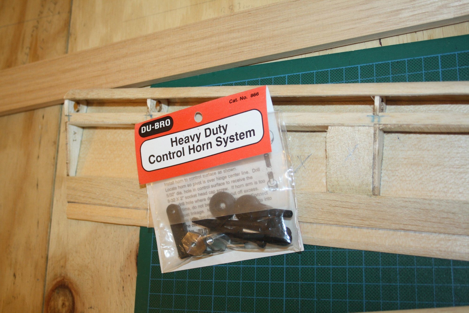

I then went to the local hobby shop and got a couple of control horns options.
Installation of standard "T-Style" control horns requires the bolts to go through the aileron spars, which I was not happy with. The Dubro "Large Scate T-Style..." (#366) will result in the screws passing both sides of the bottom spar and through the top spar (after replacing the screws which are too short for these ailerons), again, not ideal.
I think I settled on the control horn shown in the picture (Dubro #866) where a single screw passes through the aileron. I glued a hard block of balsa inside the aileron to support the screw at the full width of the aileron.
