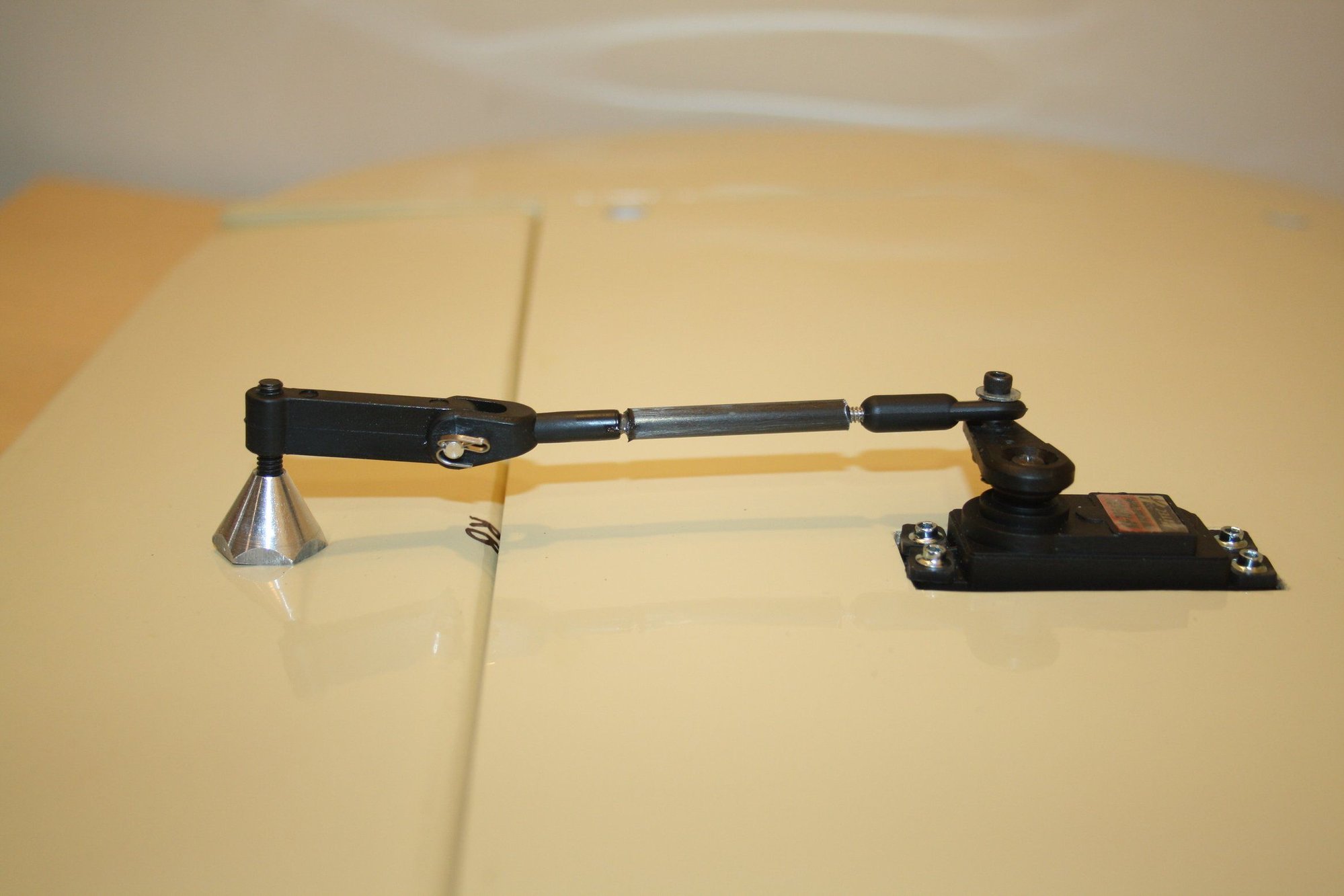

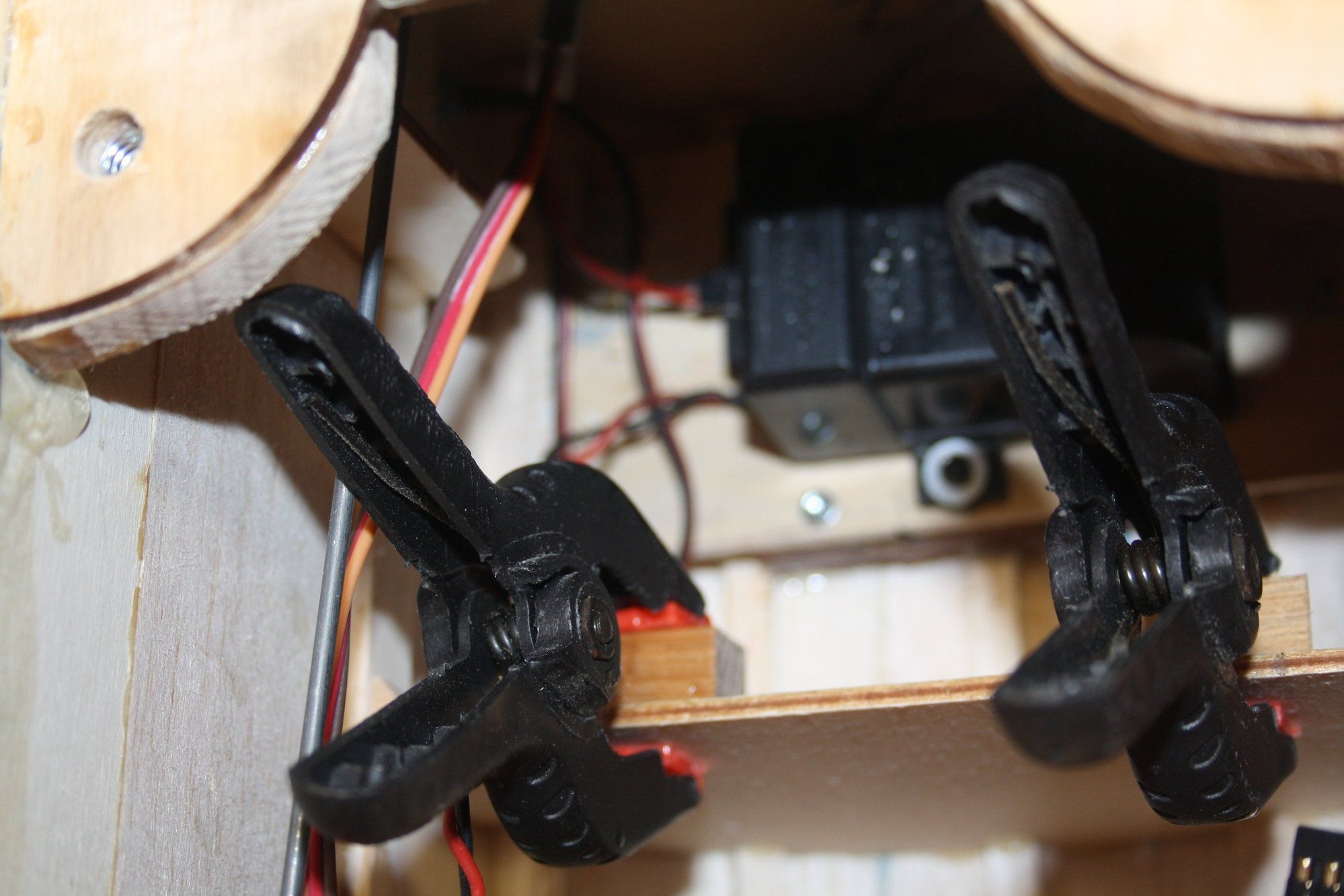

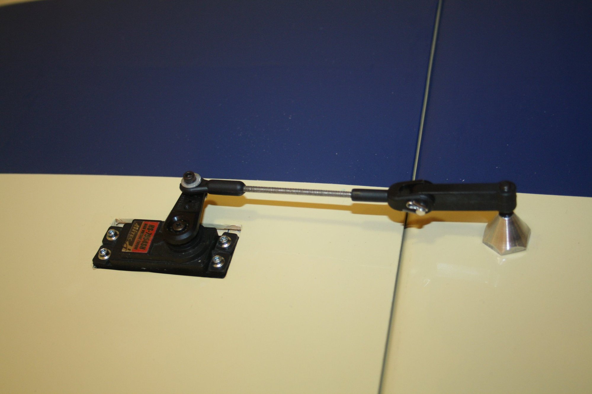

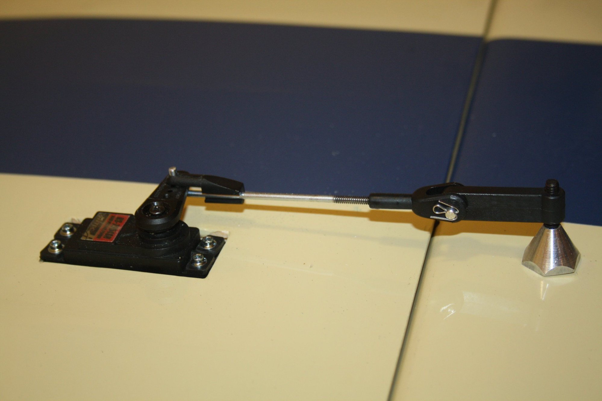

I connected the aileron servos using a 4-40 threaded rod. Also I do think that on such a short connection it is sufficient and will not bend under load (the actual diameter of the core of a fully threaded 4-40 rod is smaller than the diameter of a 4-40 rod), I decided to sleeve it.

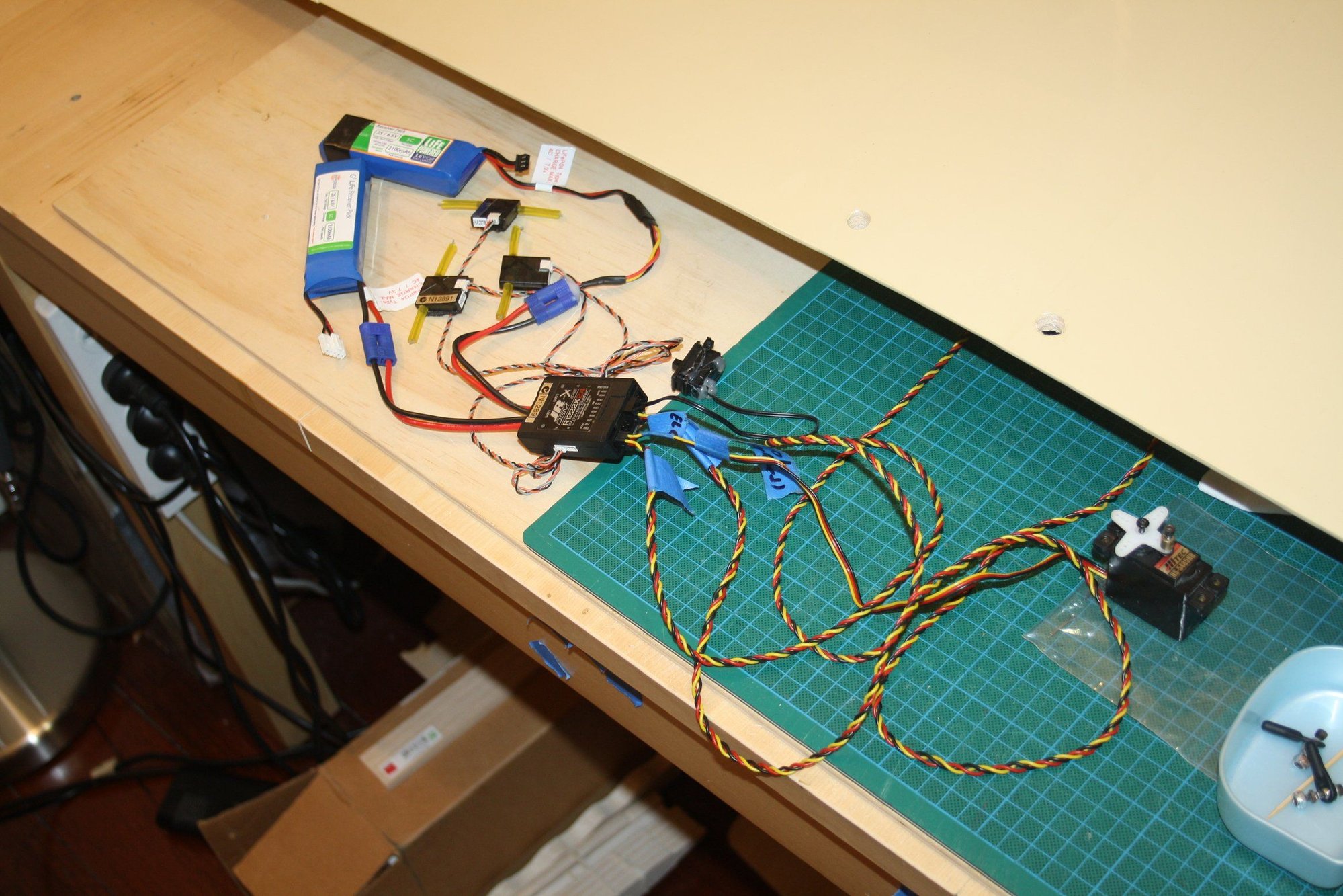

I then connected the receiver confirming that all is working as expected.

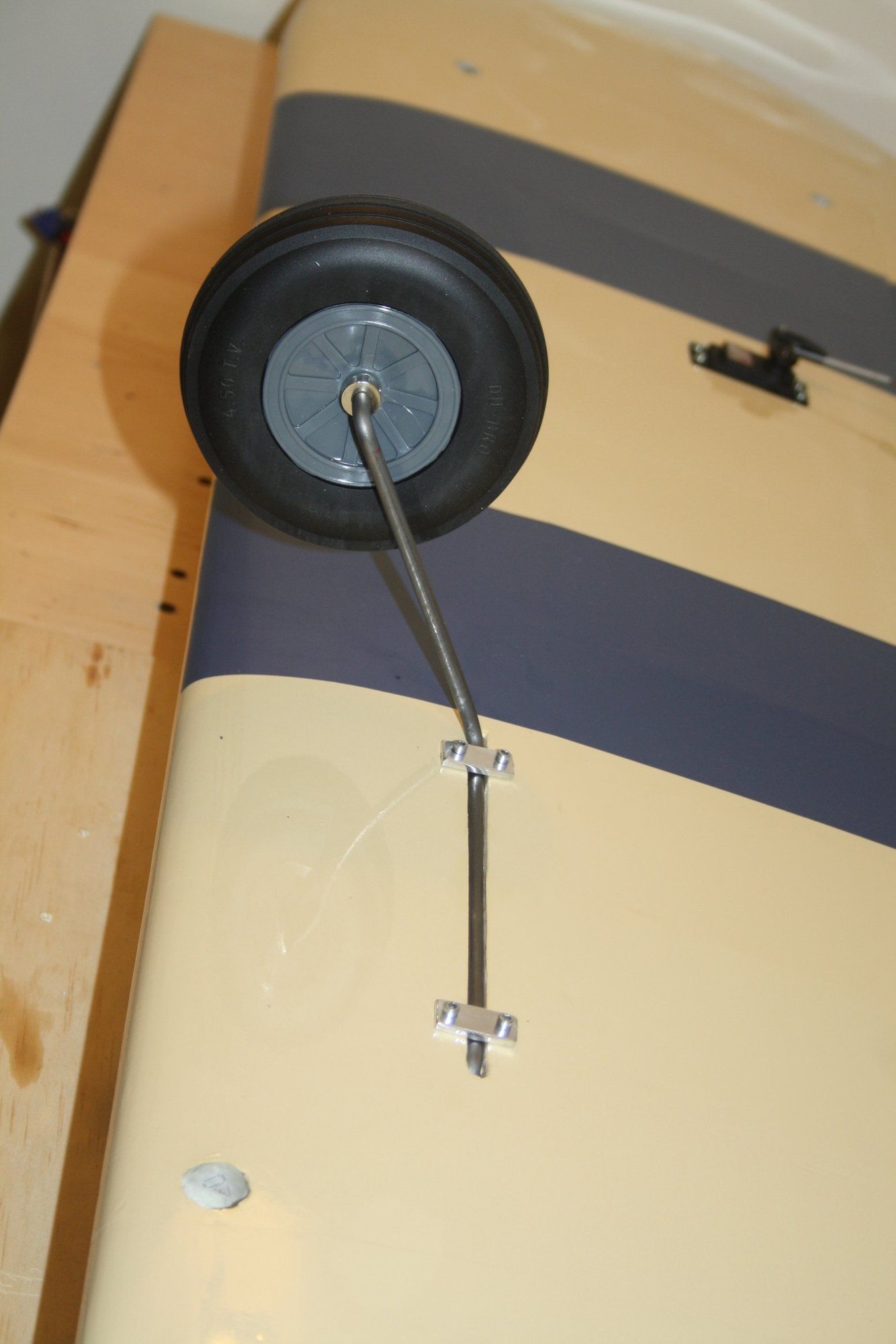

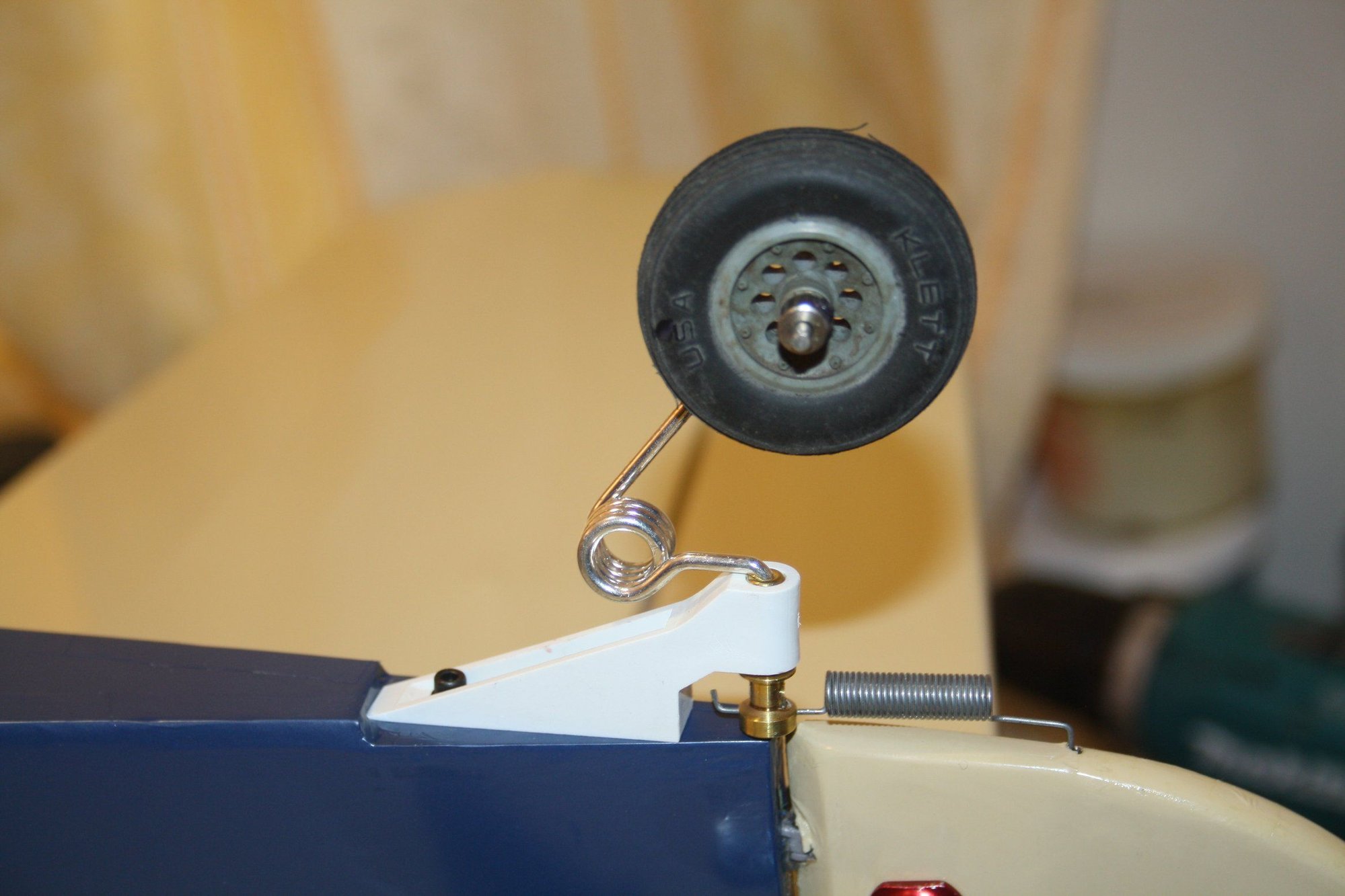

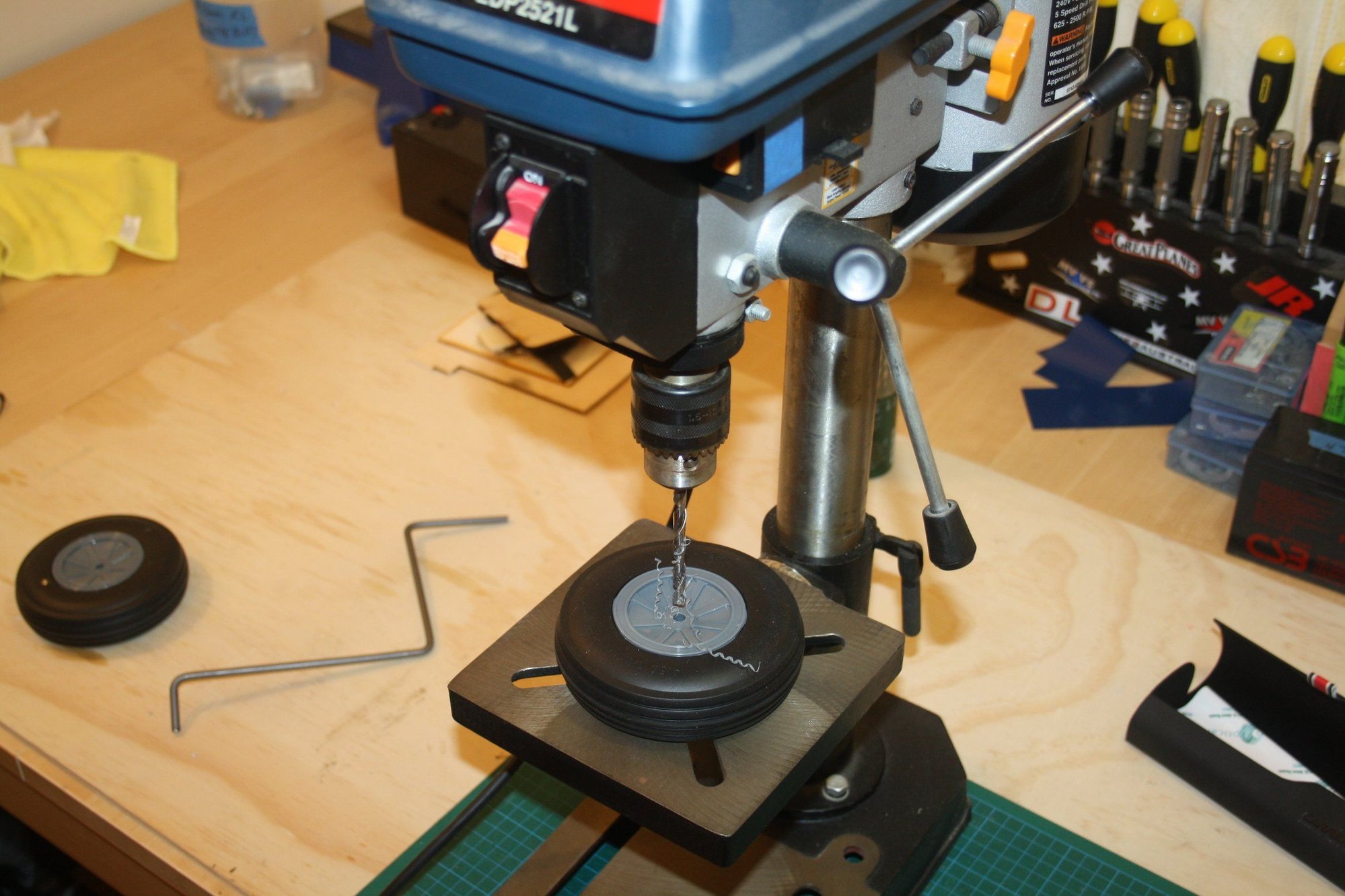

I decided that I did not like the look of the small tailwheel, so it was replaced with a 1 3/4" diameter wheel I had lying around.

A couple words of caution. Your aileron linkage may be prone to flutter. I would suggest making your control horn longer and replacing the plastic servo arm with an aluminum arm. Running a ball link on a plastic arm can cause the plastic arm to flex and the short control horn gives the mechanical advantage to the control surface not the servo. A split second at the right harmonic and you could be left flying without ailerons.
#153
Thank you speedracerntrixie, I will look into it again.
I am very rarely using ball link connection on my aeroplanes, and used it in this case due to the odd geometry (aileron horn and servo not on the same plane).
Cheers,
Eran
Cheers,
Eran
#154

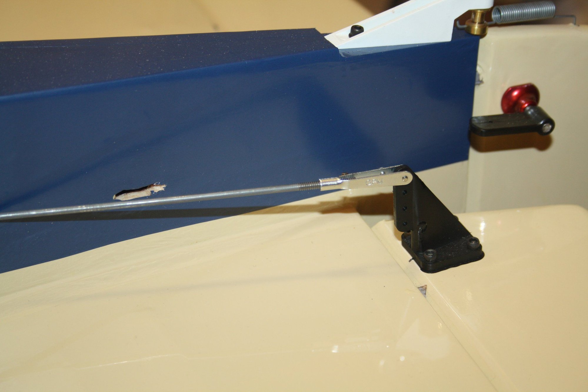

Looking at the aileron control rods yesterday, I was not 100% happy with the convoluted setup (ball link, threaded rod, sleeve) I ended up with. Then, this morning as seen above, came the commented that it may be prone to flutter (which I am not sure that I fully agree with).
I decided to replace it with my "usual" simple setup of 4-40 rod and EZ connector at the servo side. When I looked into it originally, I didn't think it would work in this specific case, however, I am pleasantly surprised that it is working well. The articulated joint at the aileron control horn is well designed and resolves the "misalignment" of plains (servo to control horn).

Earn, please regard my comments as someone who wants you to enjoy this airplane for many years. The last thing I want you to do is feel that I am picking on your work. On the subject of you aileron linkage, while you did make an improvement, I still have concerns. Eliminating the ball link does eliminate the possibility of the servo arm twisting however you reduced the control horn length even more. From the pictures I would have to approximate your aileron thickness around 5/8" to maybe 3/4". Let's go with best case and say 3/4". So from hinge center to outside surface of the aileron is 3/8". The height of the pivot hole on you control horn looks to be maybe 3/4" above the aileron surface. That gives a moment arm of 1 1/8". The servo arm from center to the hole you have chosen looks to be 1". This is close to a 1:1 ratio which will result in close to 3D control surface throws. Of course you will need to reduce the throw via your TX which will greatly reduce your resolution. Keeping this setup will also work your servos harder and consume more battery power. Best case scenario you order up some aluminum servo arms and go back to the ball links and replace the screw being used for your control horn with a longer one then use a hole in the servo arm closer to center. The object is to get the desired surface movement without having to electronically reduce servo travel. That said, you could also flip your push rod so it inserts into the arm from the top which would allow you to unscrew the flag a bit in order to lengthen you right control horn. Obviously I would rather you go with the first option. Reason being is that as the aileron moves because of the aft location of your control horn the angle ( height ) in which the push rod meets the servo is going to change.
#156
speedracerntrixie - Thank you for your concern also we may need to agree to disagree in this case.
The recommended travel for the ailerons as detailed on the plans is 1" up and down which is what currently set at 100% servo travel. I will leave it at this setup for the test flight and may adjust it once I had a feel for the control. The servos are way over-spec for this aeroplane ailerons requirements and they will deal with any geometry deficiencies forces with ease.
A fact that is not obvious (if the build was not followed closely) is that the pivot line for the aileron is further back from the wing TE (at the aileron) then it seems (pivoting on a rod and not using conventional hinges). It is directly under the control horn articulating point.
I have not too dissimilar setup on a larger 3D capable aerobatic aeroplane (also 3D flying is not my style) for many years now and it yet to fail me, so I am reasonably confident that it will work just fine for many years on this aeroplane as well. I have seen much inferior setups lasting years on aeroplanes flying much more demanding routines without fail. Please do not take the above as me disregarding decent mechanical setup.

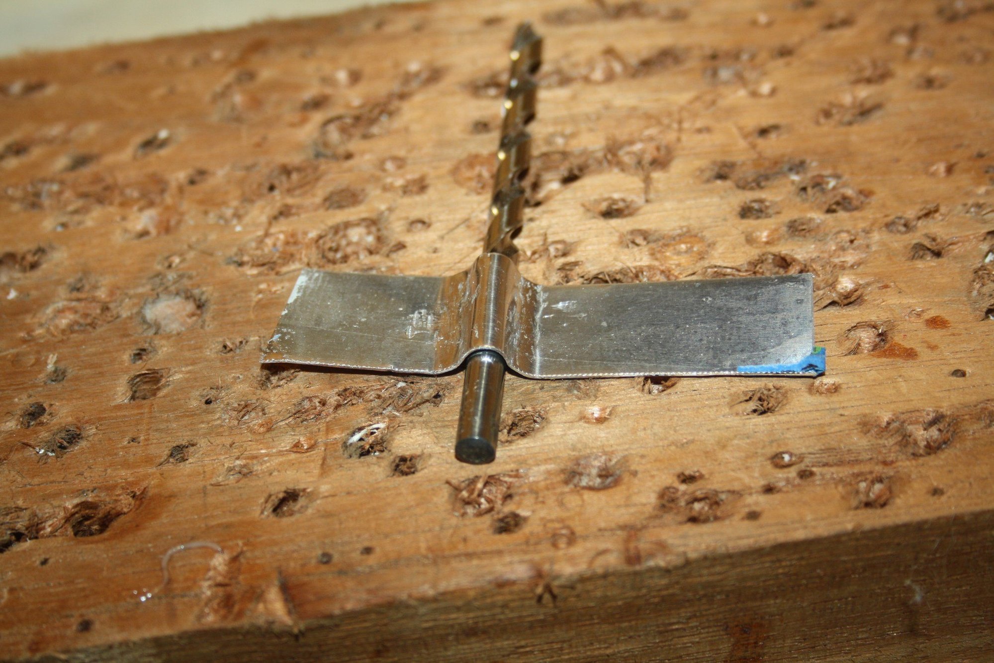

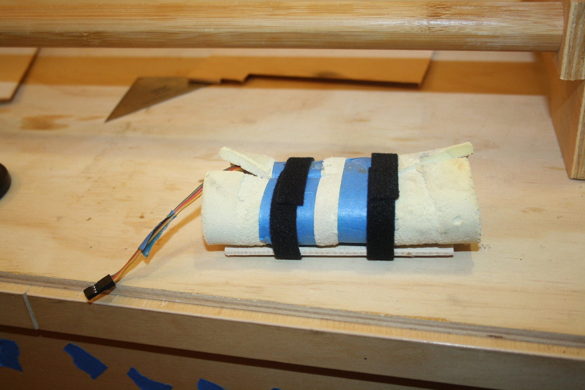

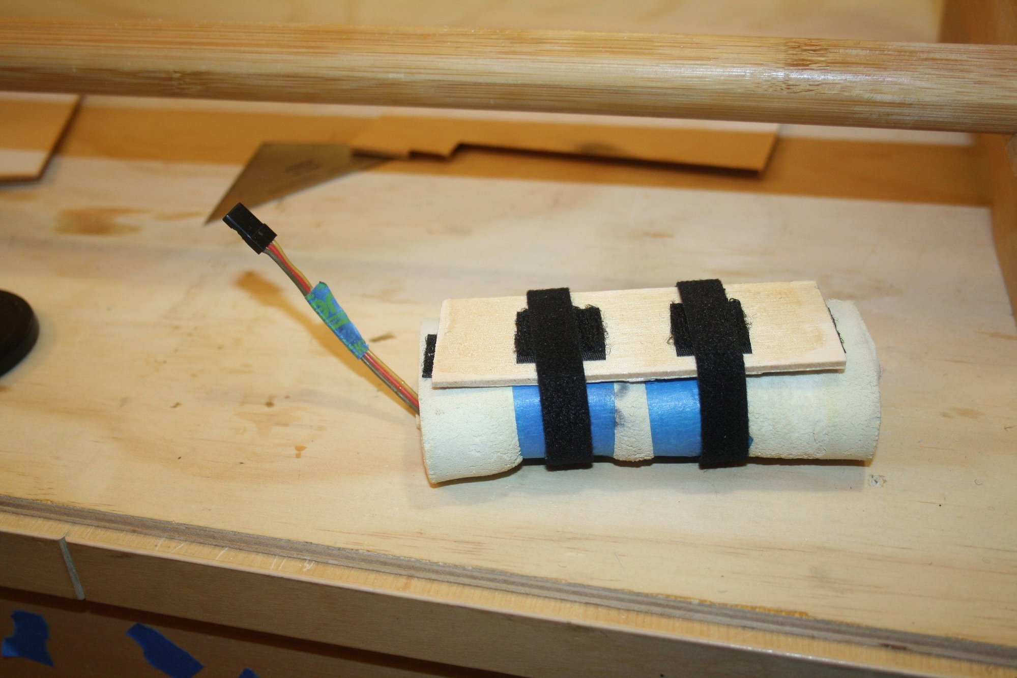

With an attempt to bring maximum weight forward anticipating a tail heavy aeroplane, I mounted the 6 cell NiMh ignition battery as far forward as I could, not far behind the firewall. It had to be mounted in a way which allows the battery to be taken out (as access is required to the Nylon insert lock nuts securing the engine mounting screws).

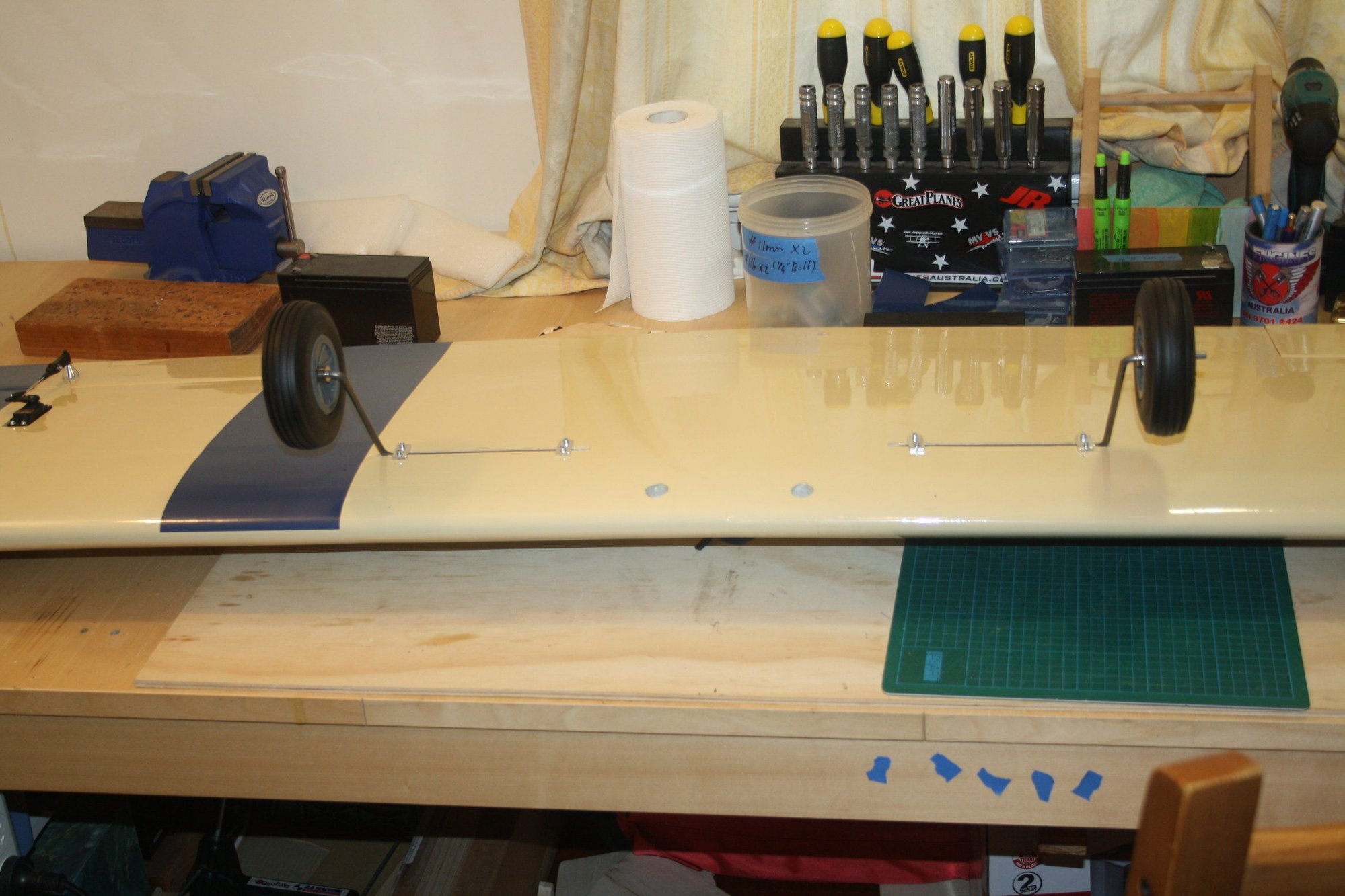

I mounted the main landing gear to the wing using brackets made by a friend.
Last, I mounted the ignition LED light to the side of the fuselage.

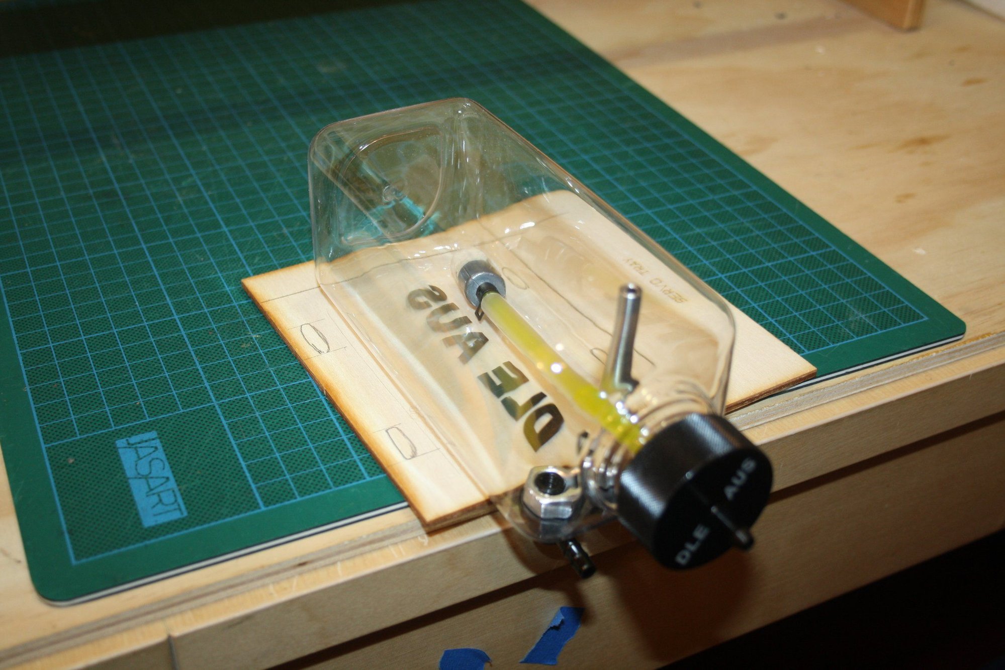

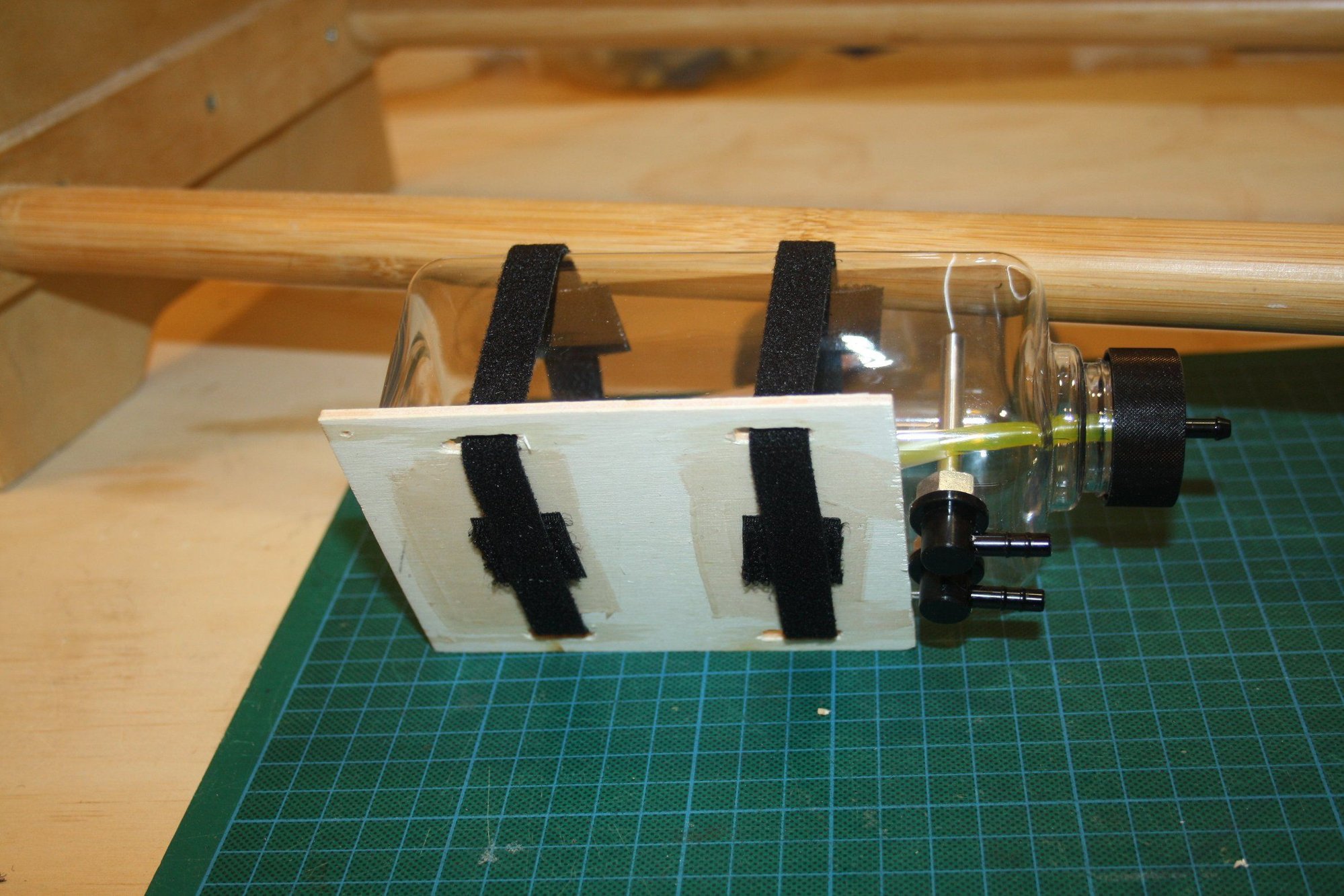

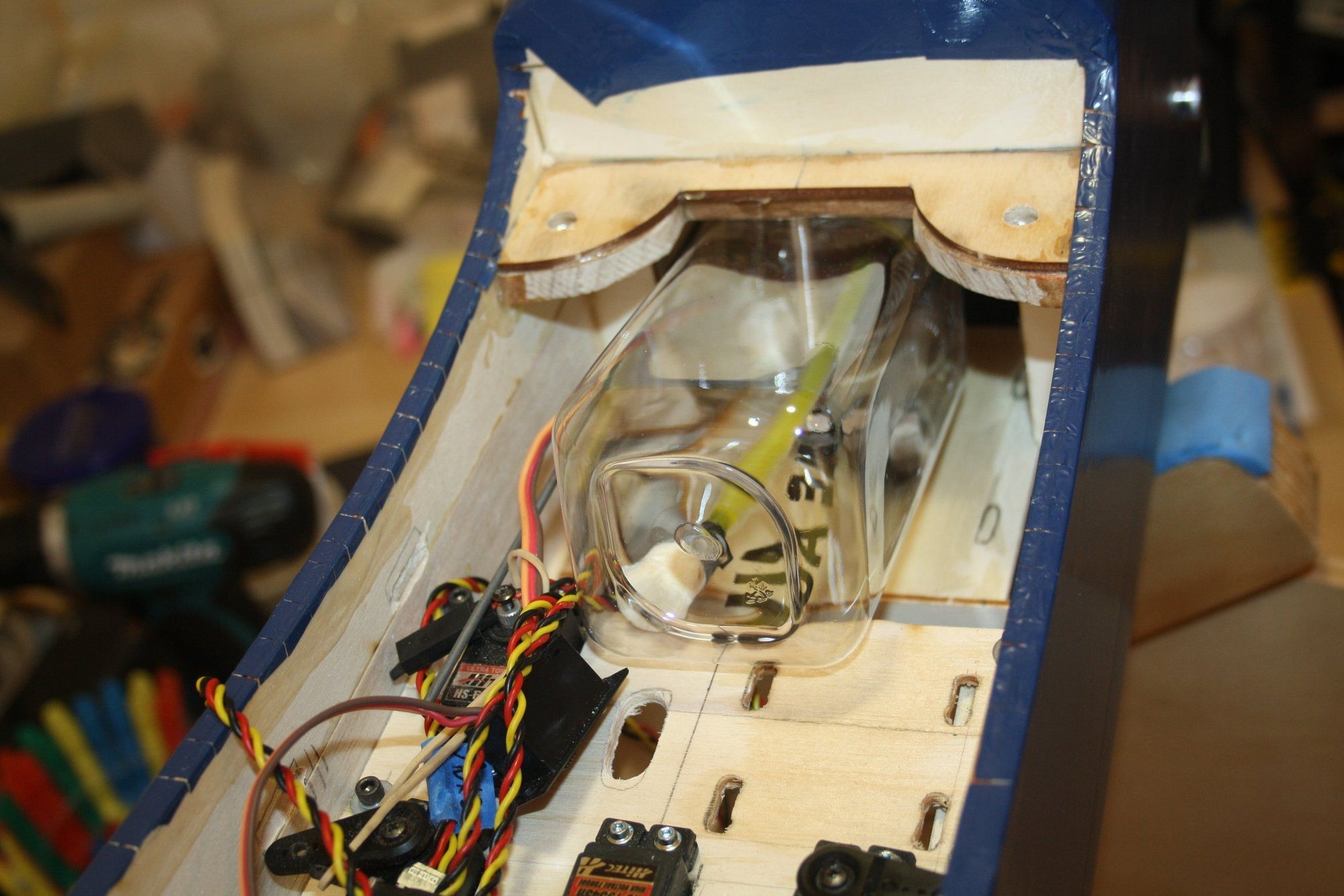

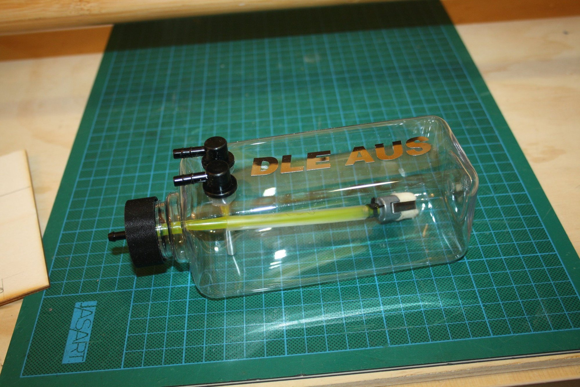

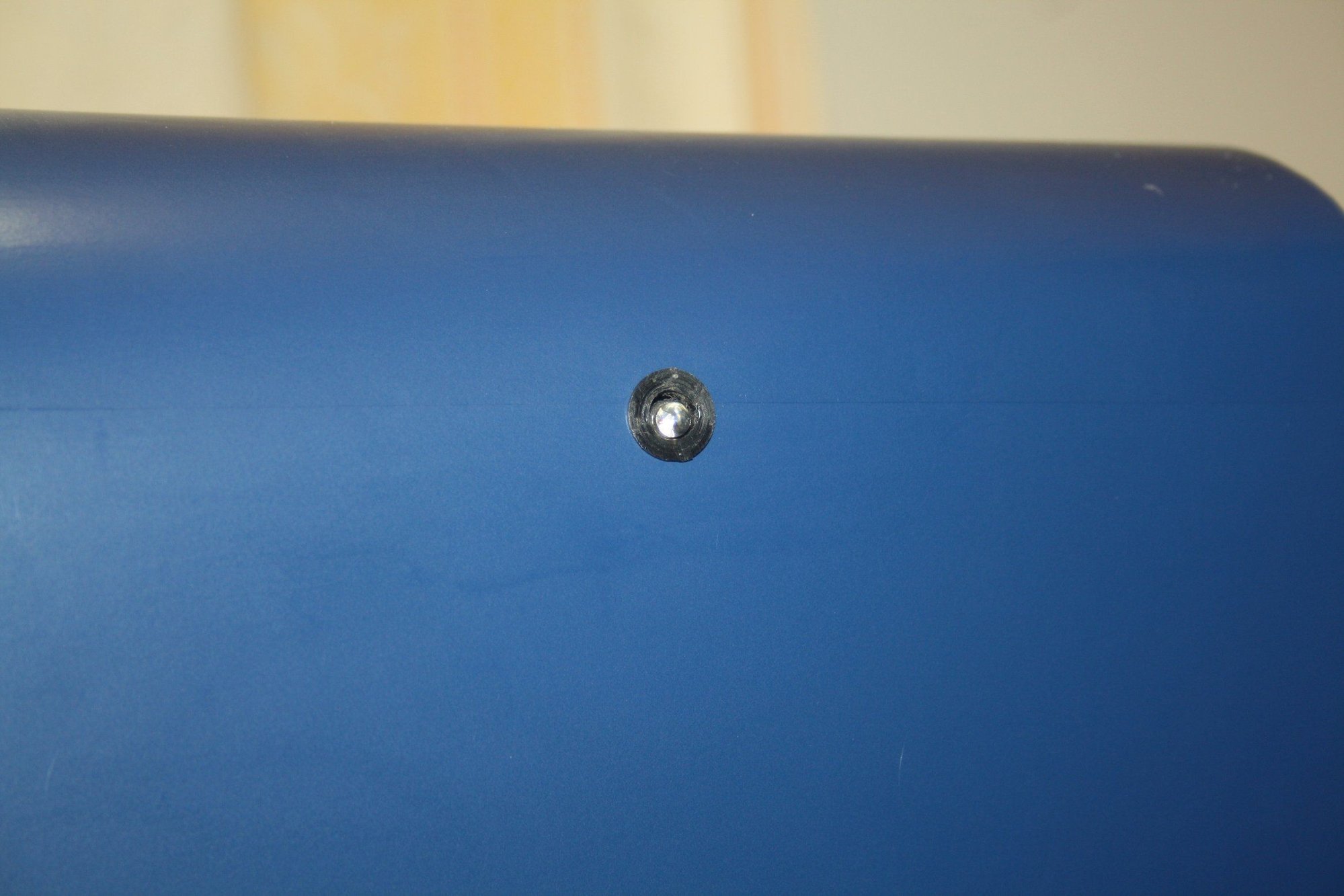

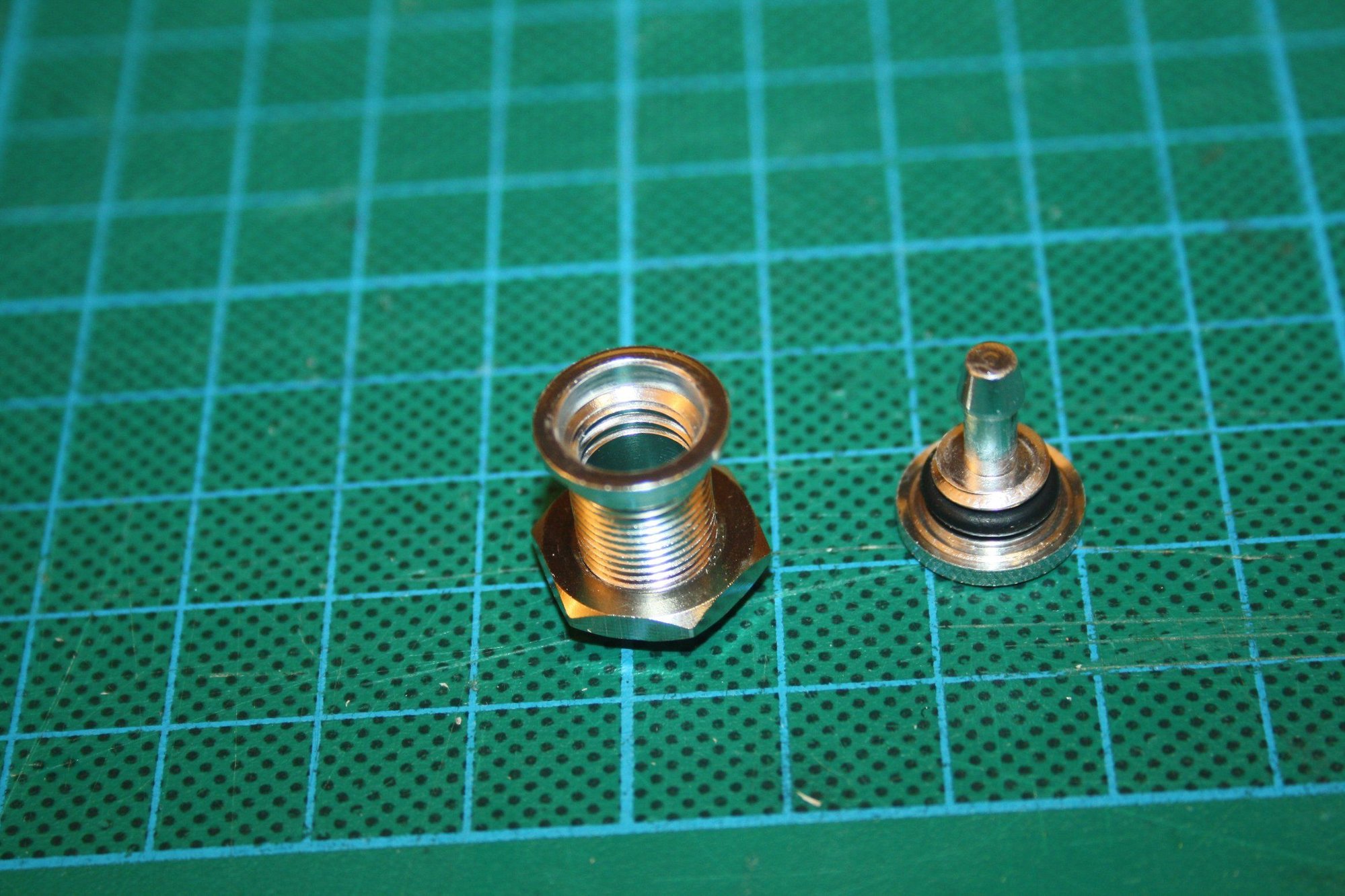

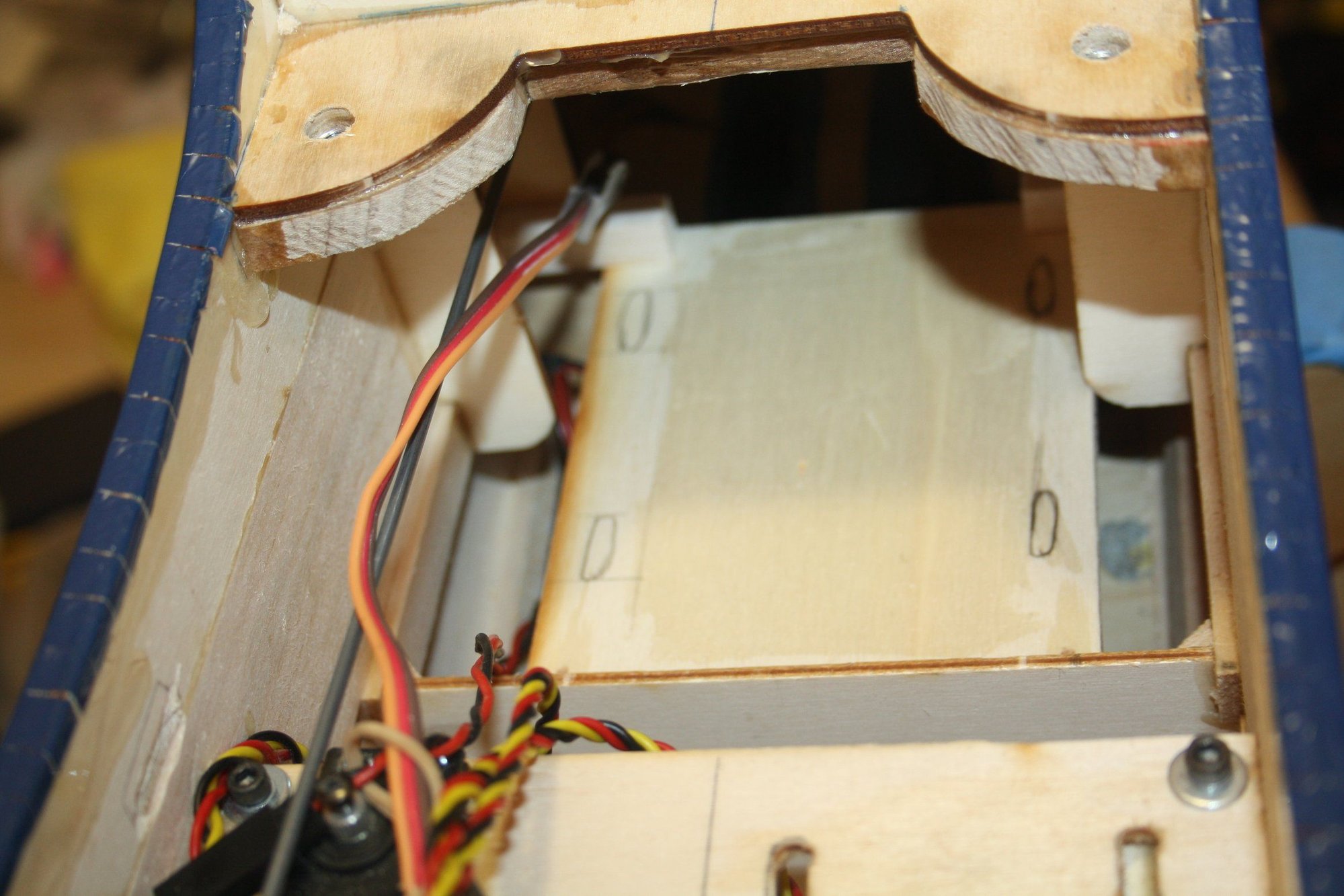

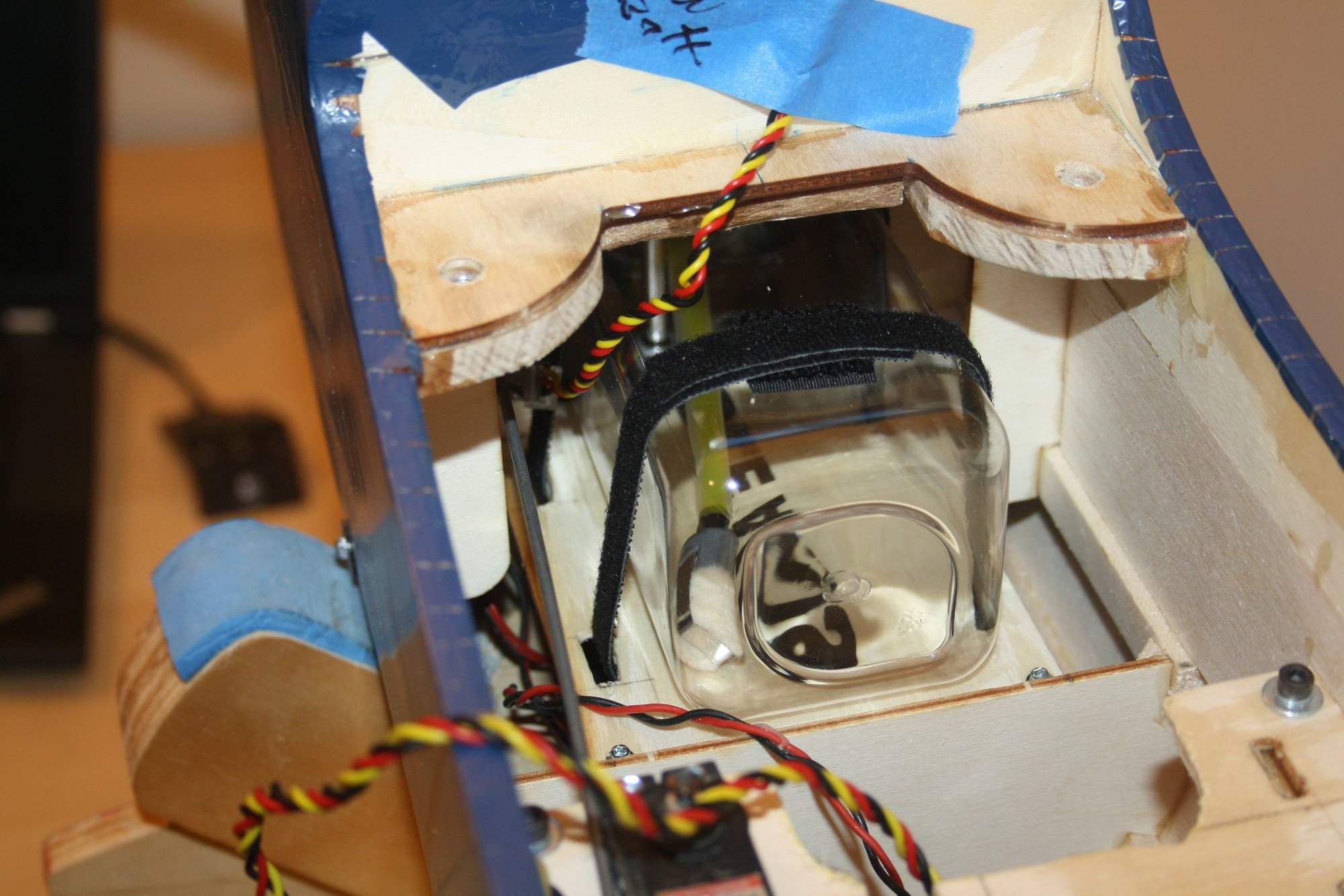

It was not my finest day in the Cave, as I was properly struggling with fitting the fuel tank. I started with installing a fuel dot to the side of the fuselage as it will not be accessible once the fuel tank is in position.
What I ended up constructing is a tray that is screwed into hardwood mounting blocks at the back and is held into a slot at the front.
I had to cut the servo tray to allow the fuel tank clearance to slide into position.

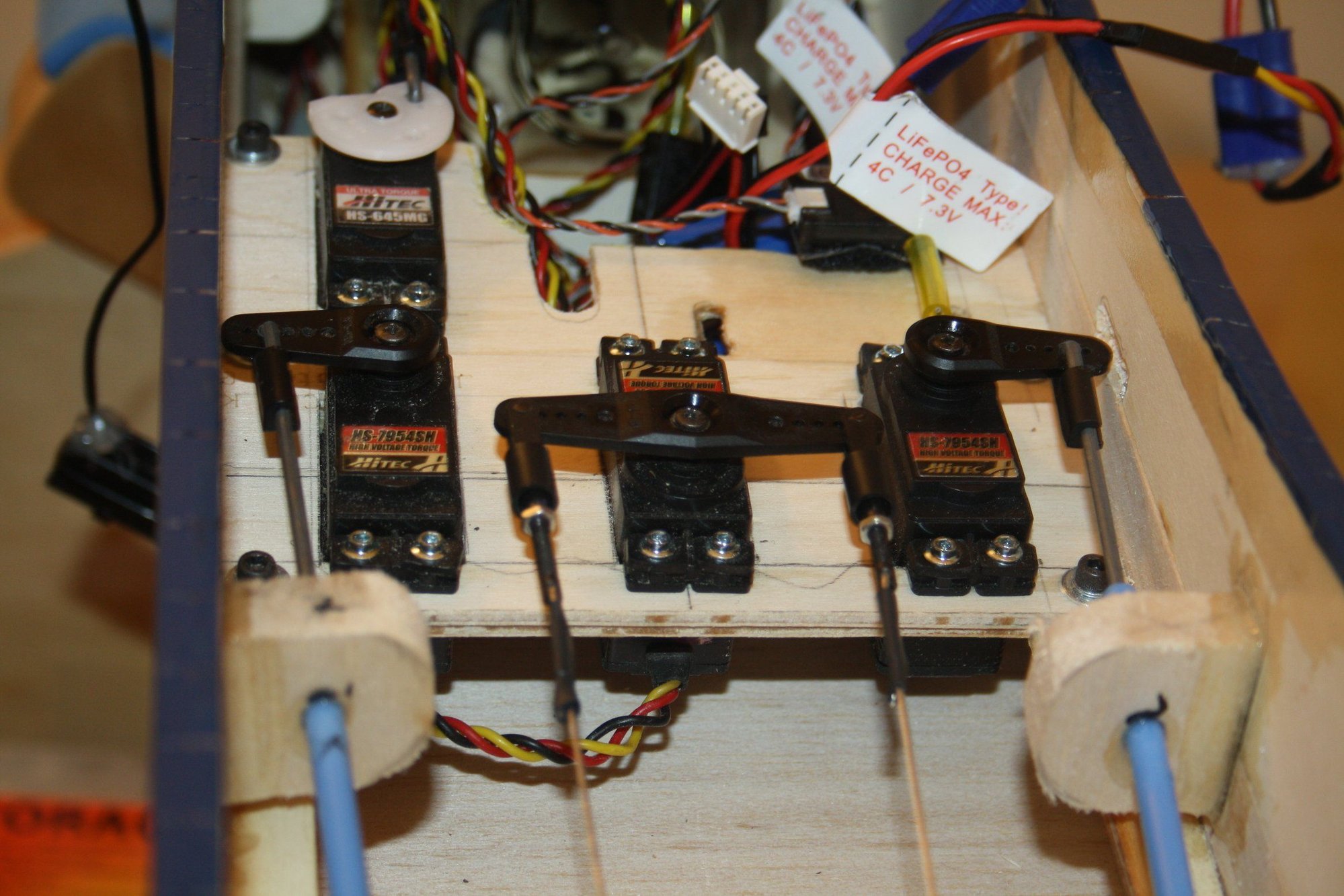

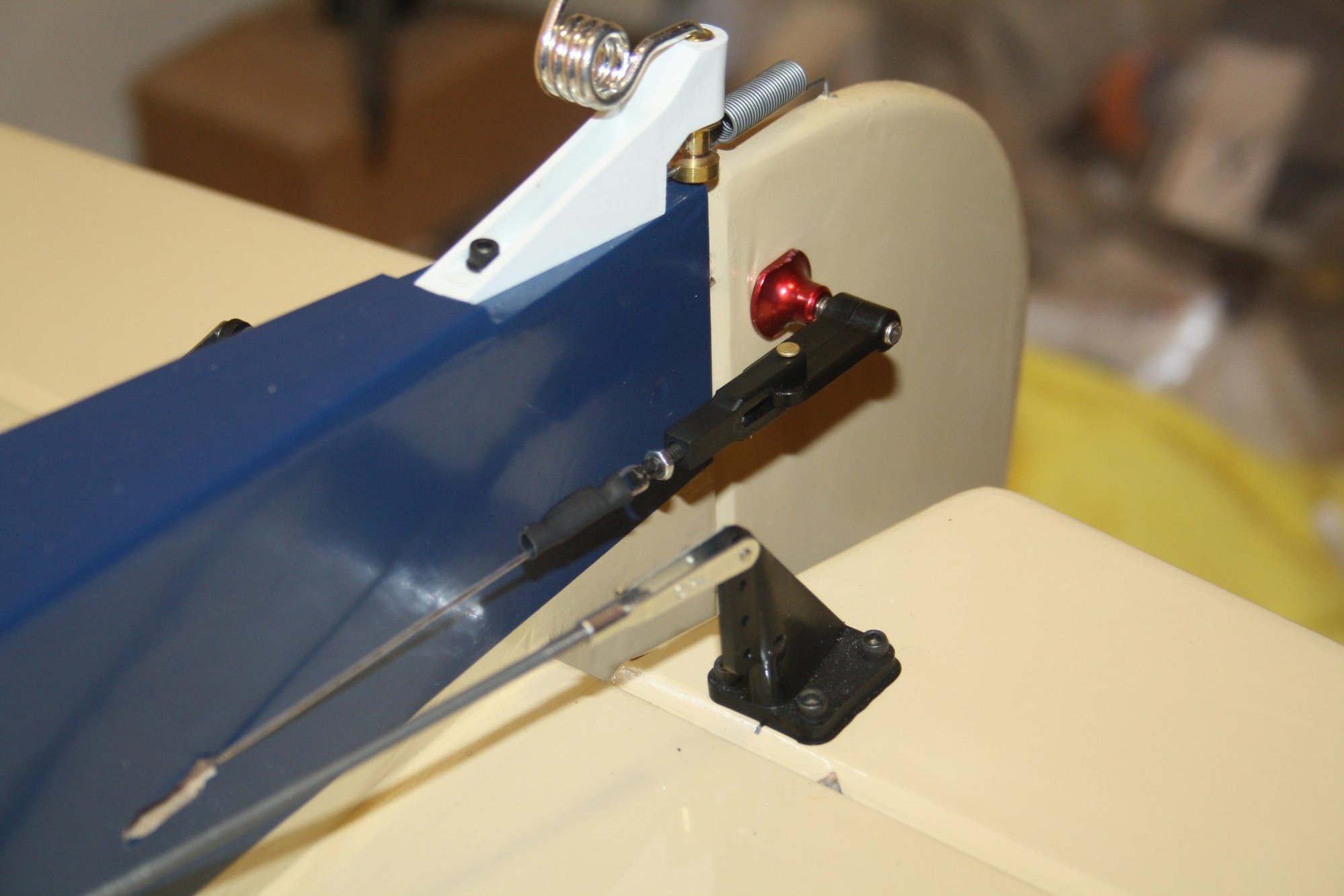

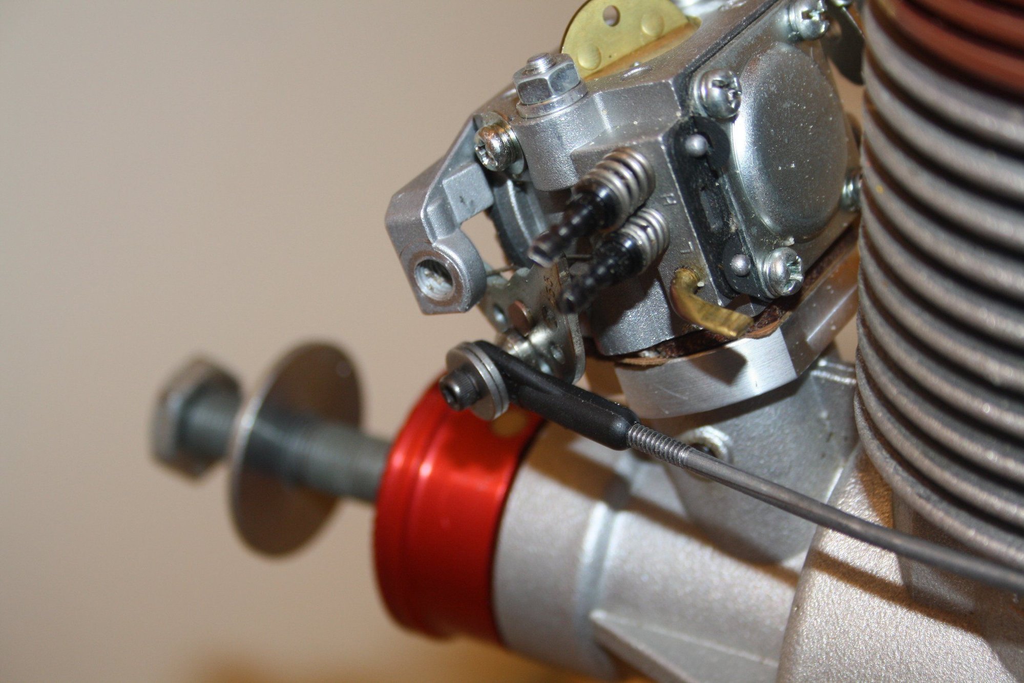

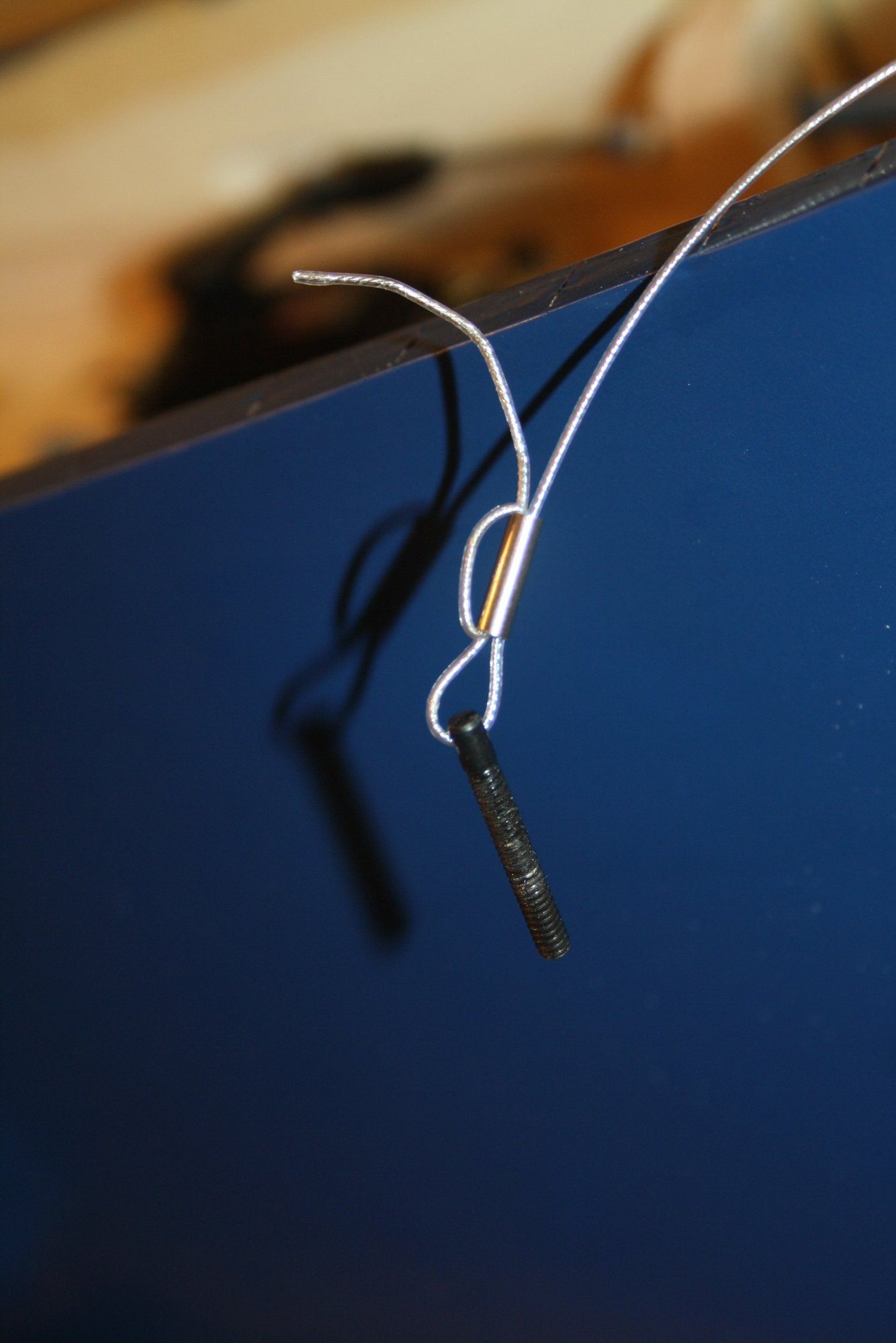

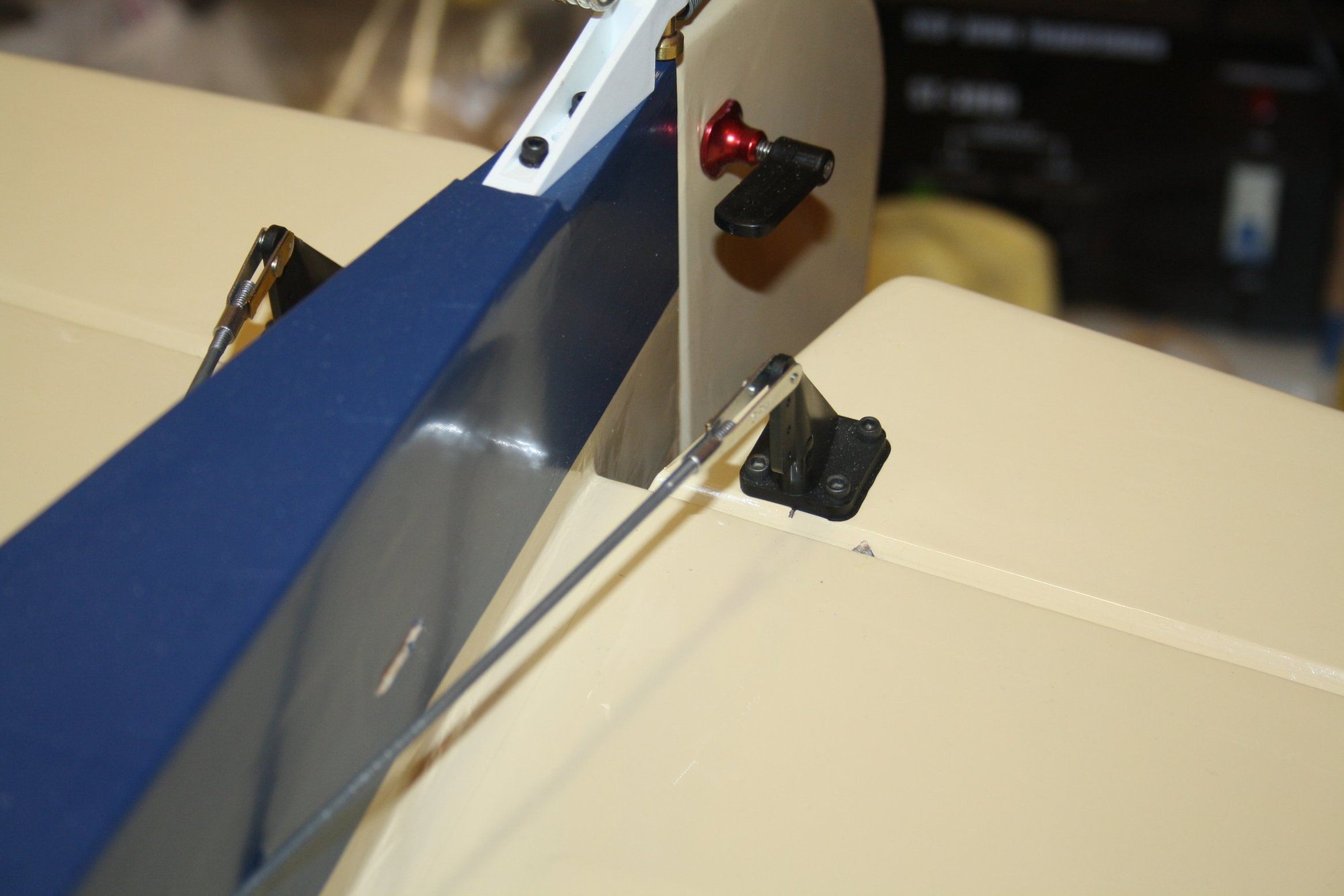

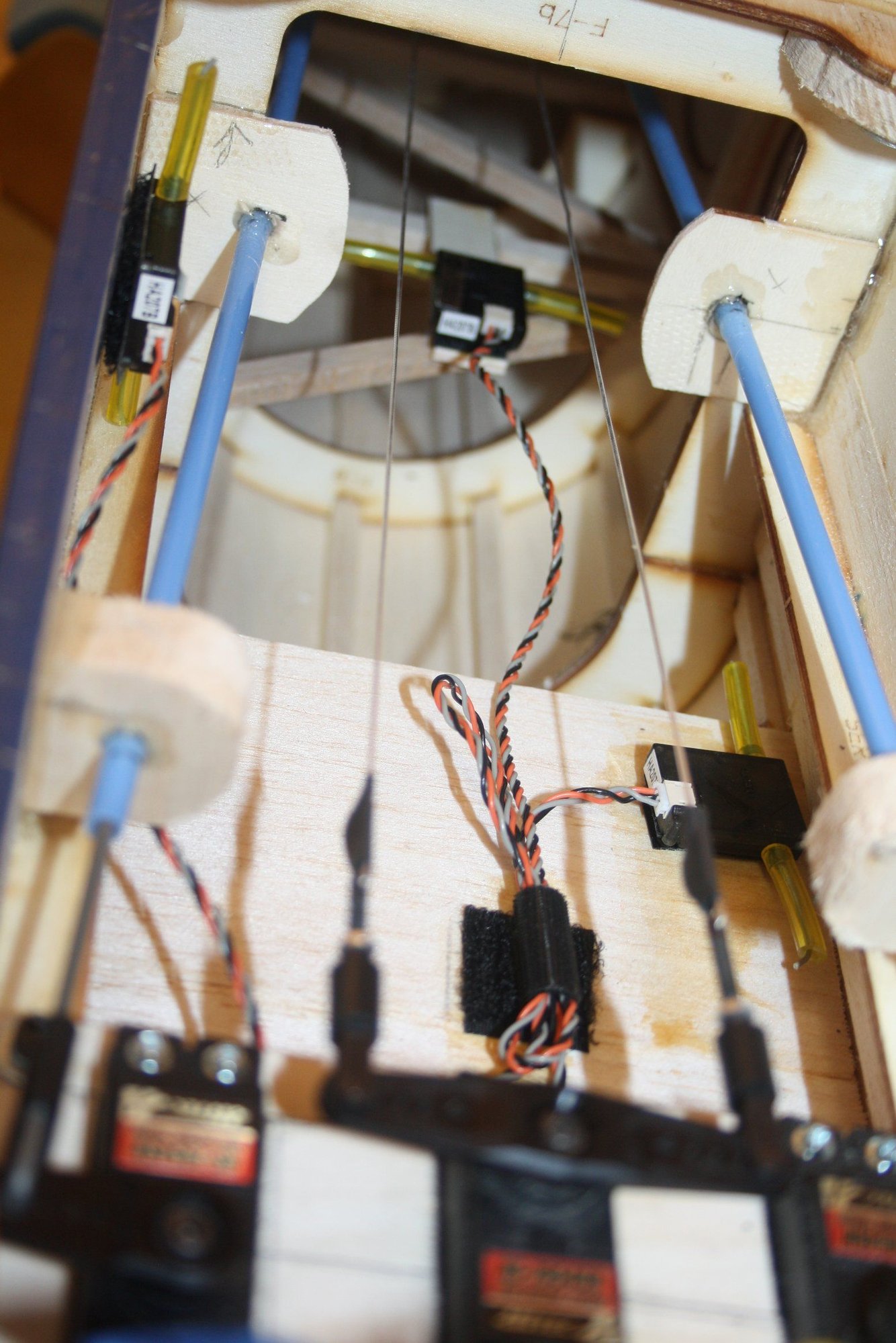

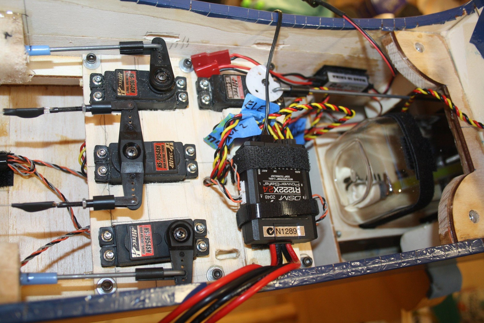

I was setting the controls for the elevator, rudder (pull-pull) and throttle today

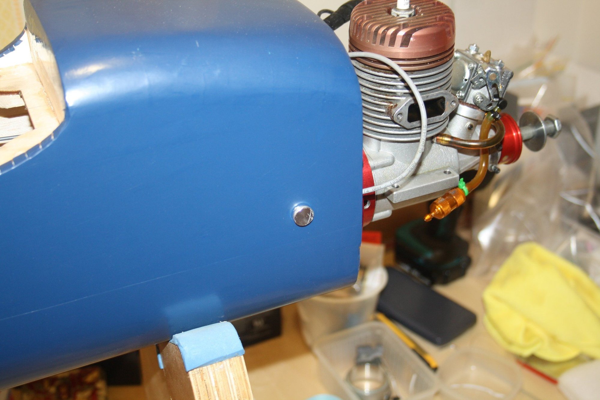

I made a retention tab for the fuel tank vent, then connected the fuel line and ignition sensor lead to the engine.
I also connected the ignition spark plug and earth leads.

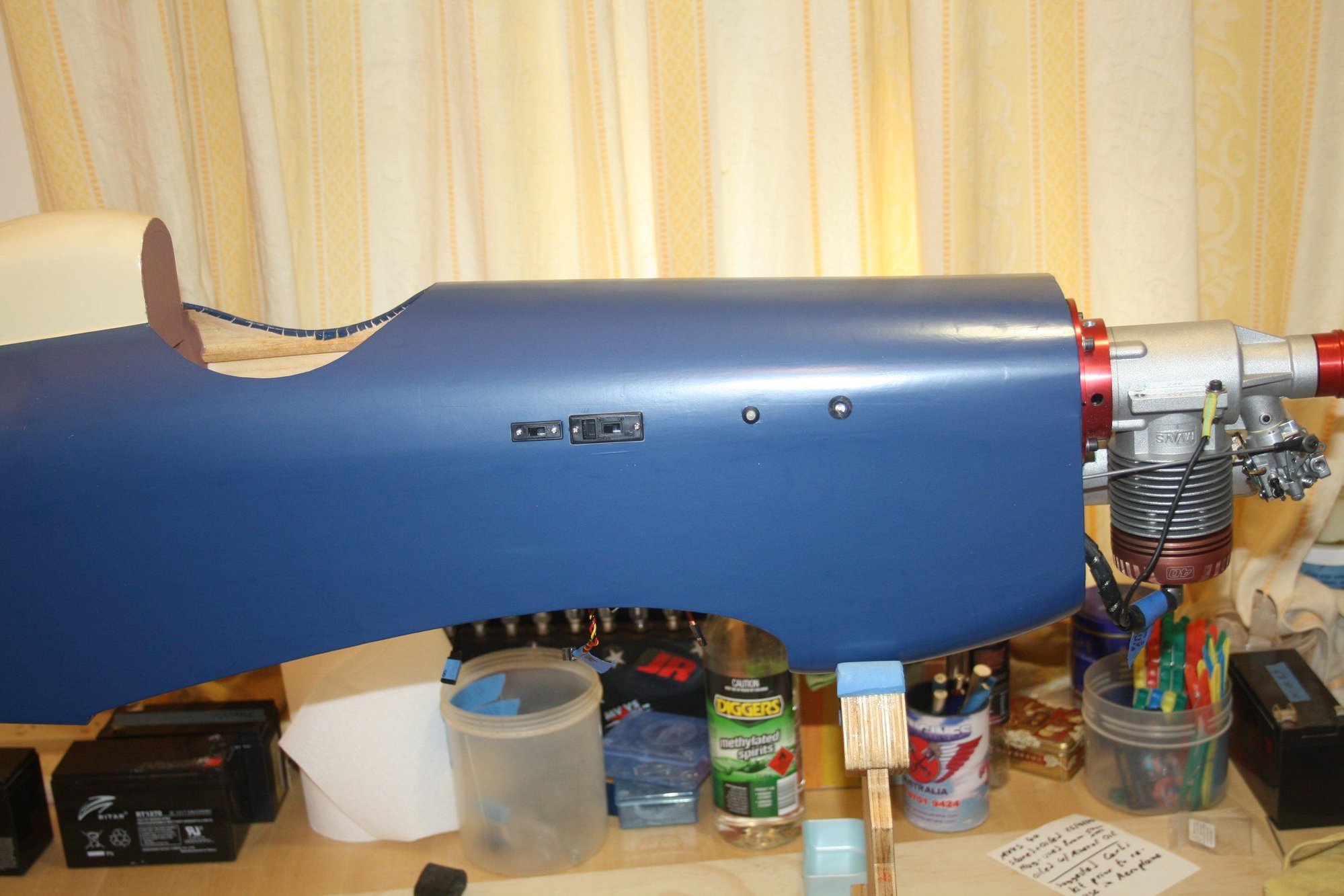

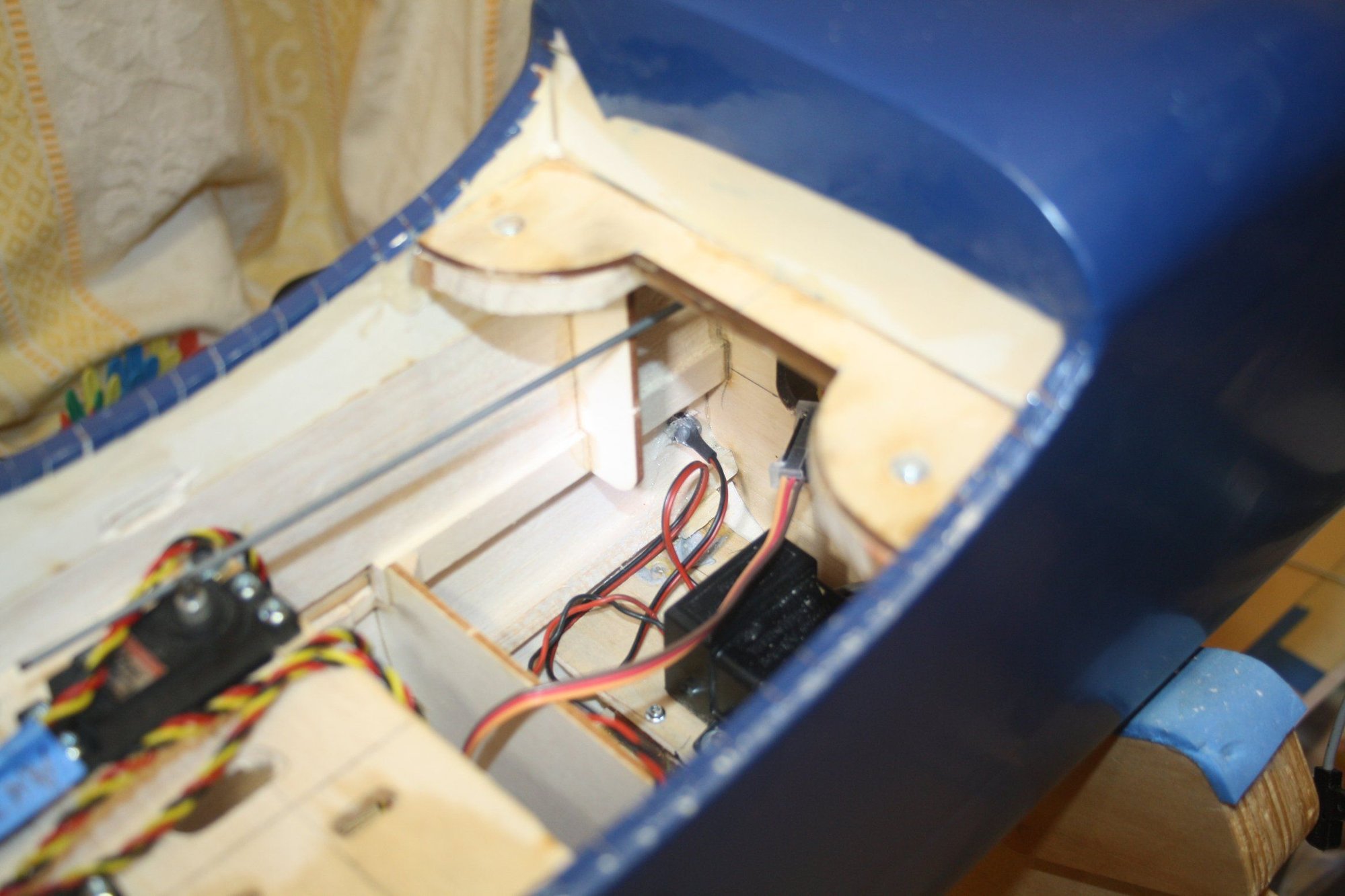

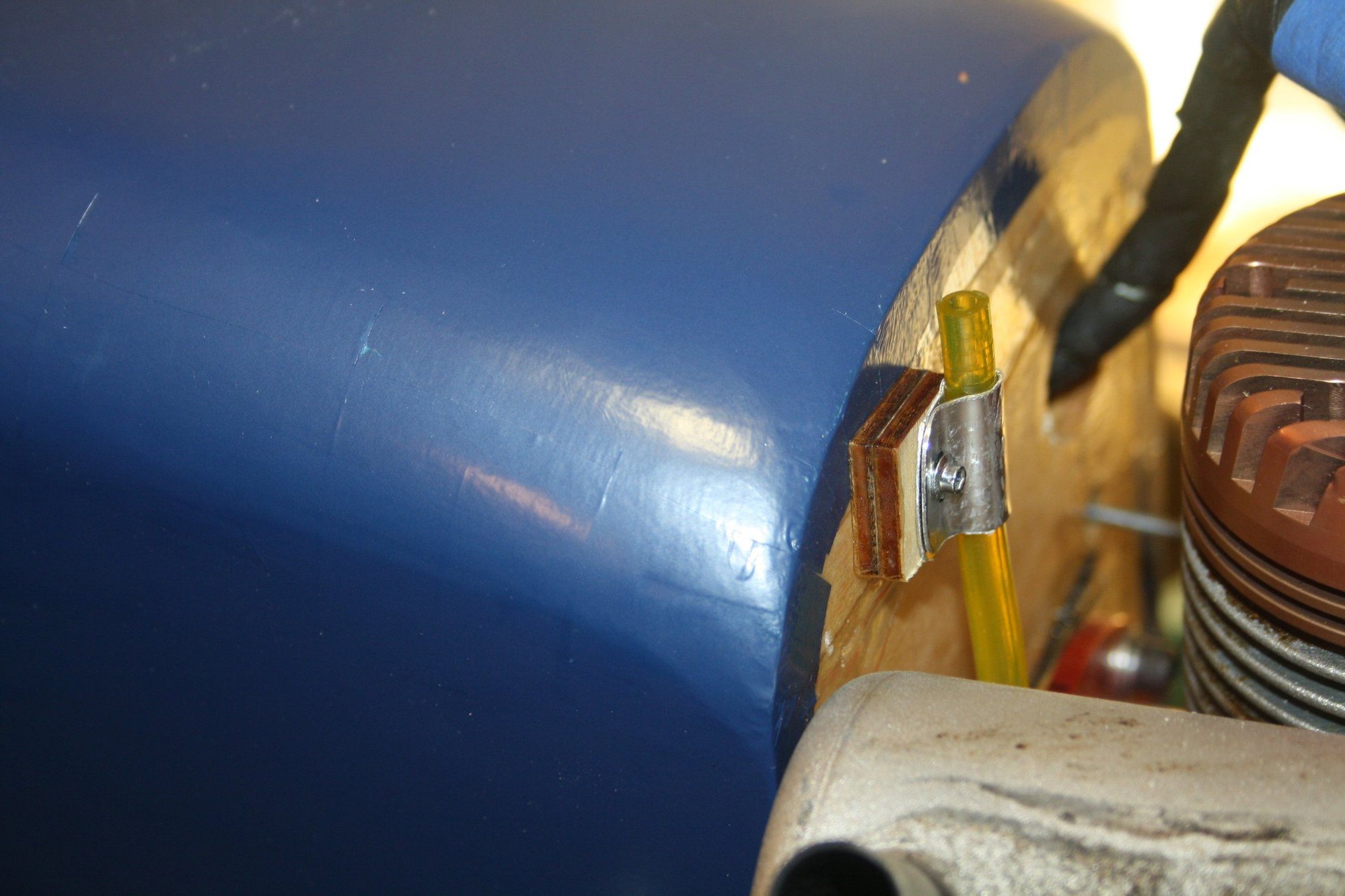

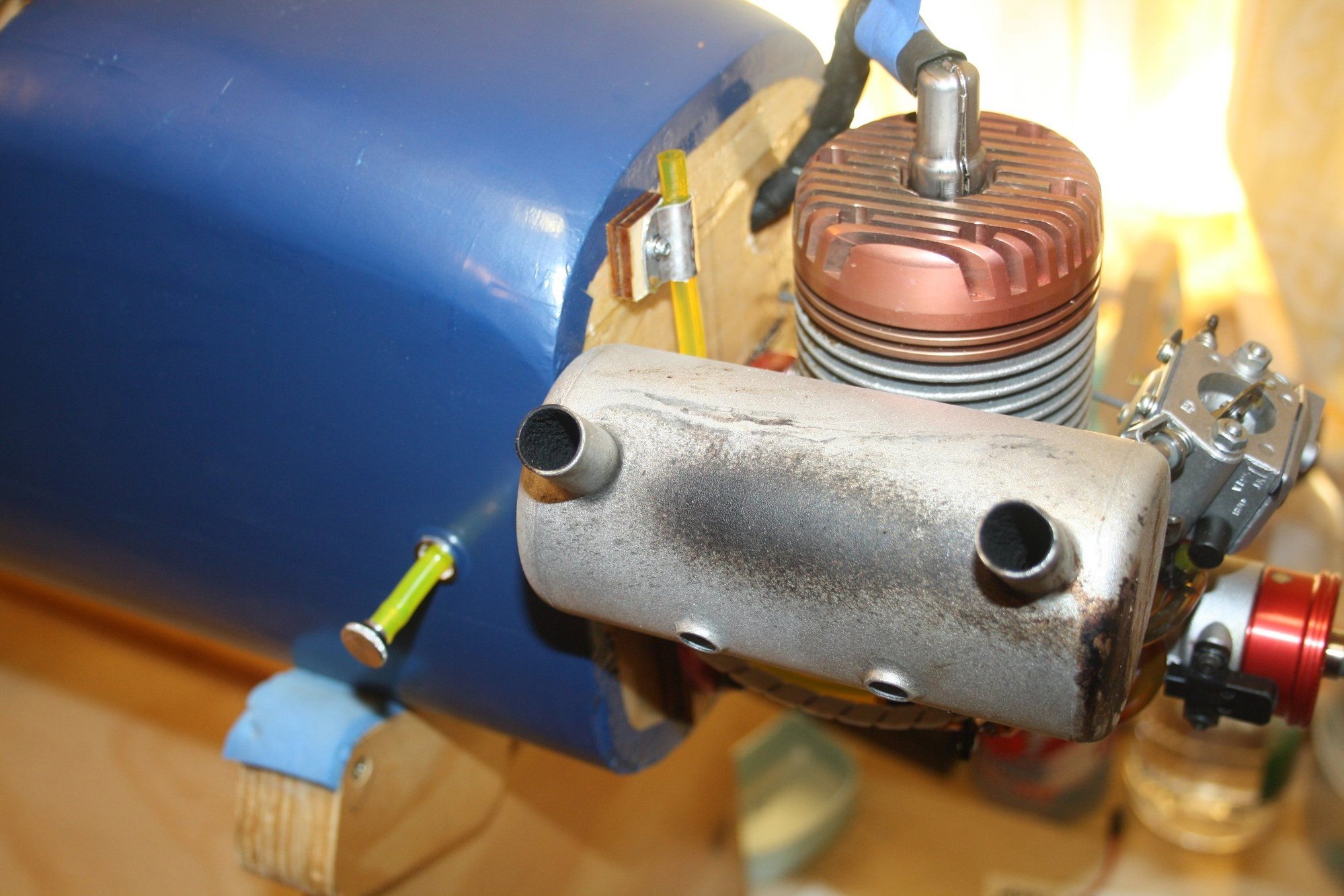

Slowly ticking off the small item list.
The muffler is on, which required me to relocate the fuel tank vent and make a small bracket for it.

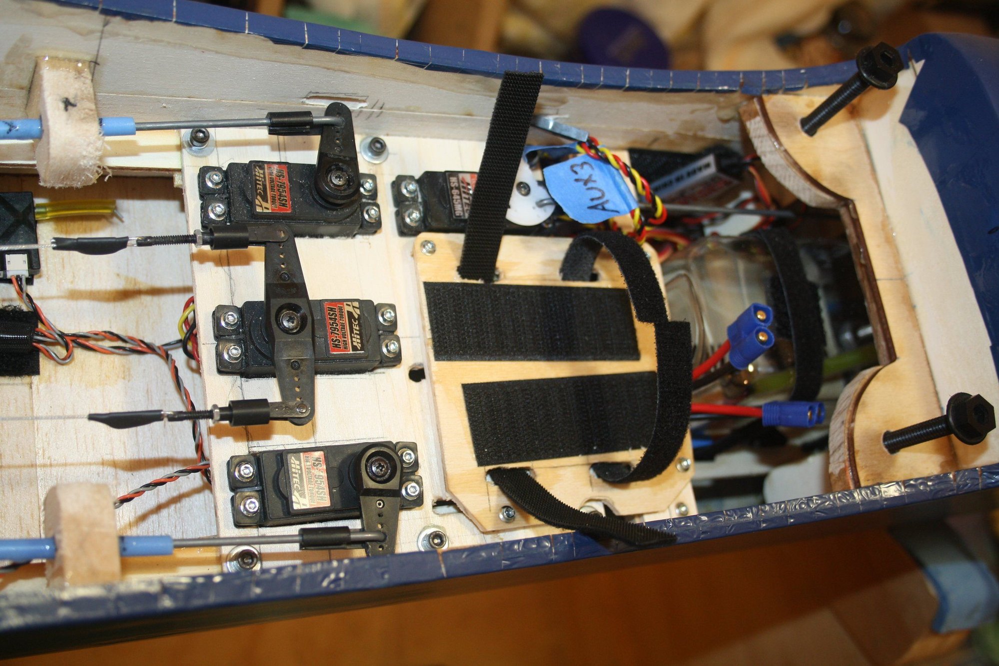

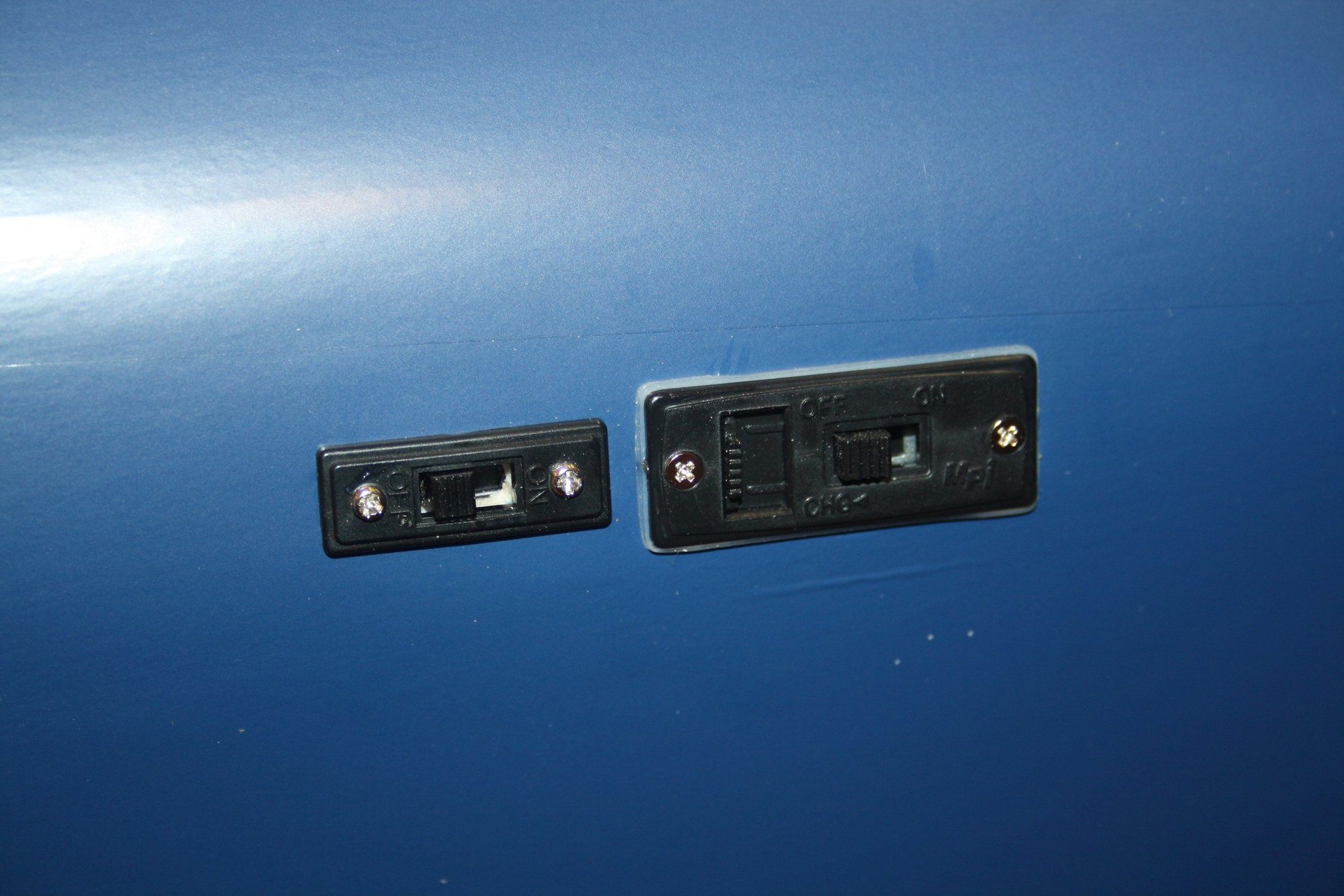

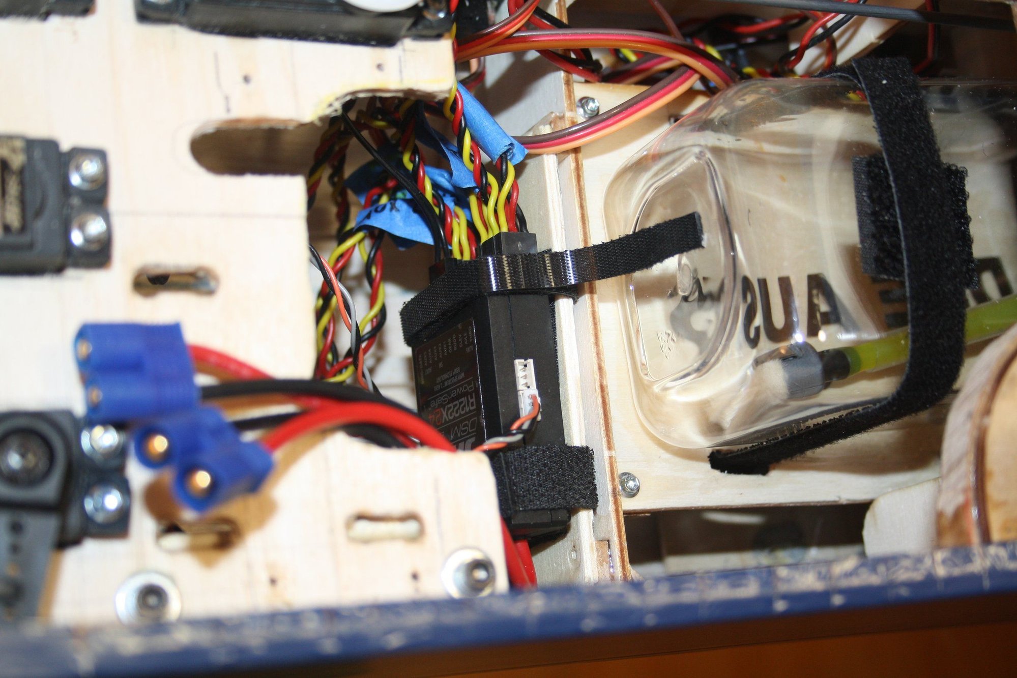

I made a removable tray for the PowerSafe receiver (over the cut-out I had to do to insert the fuel tank). I Then mounted the receiver, routed the wiring away from the throttle servo and installed the three satellites in three orientations.

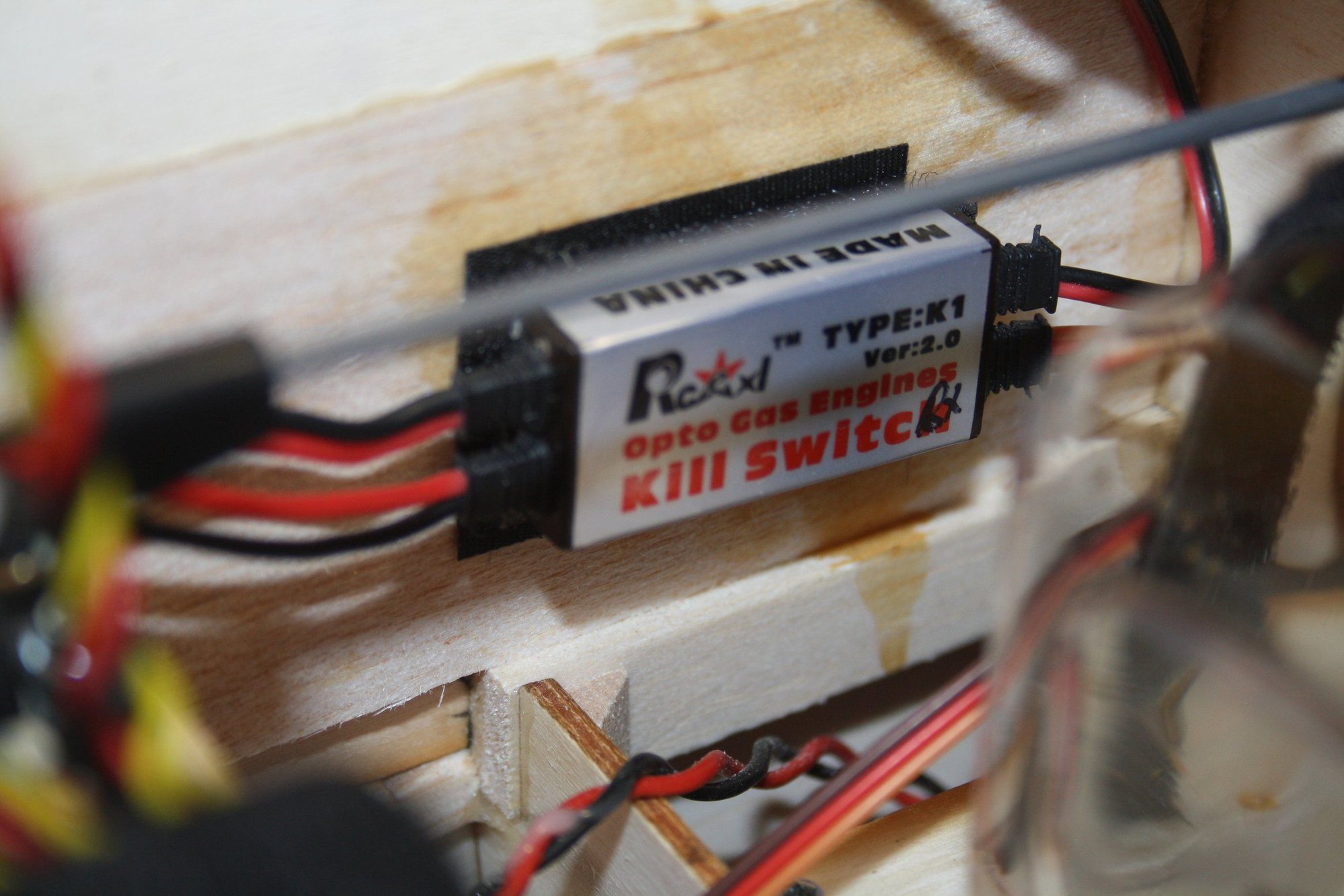

Last, I installed the optical kill switch and its LED.

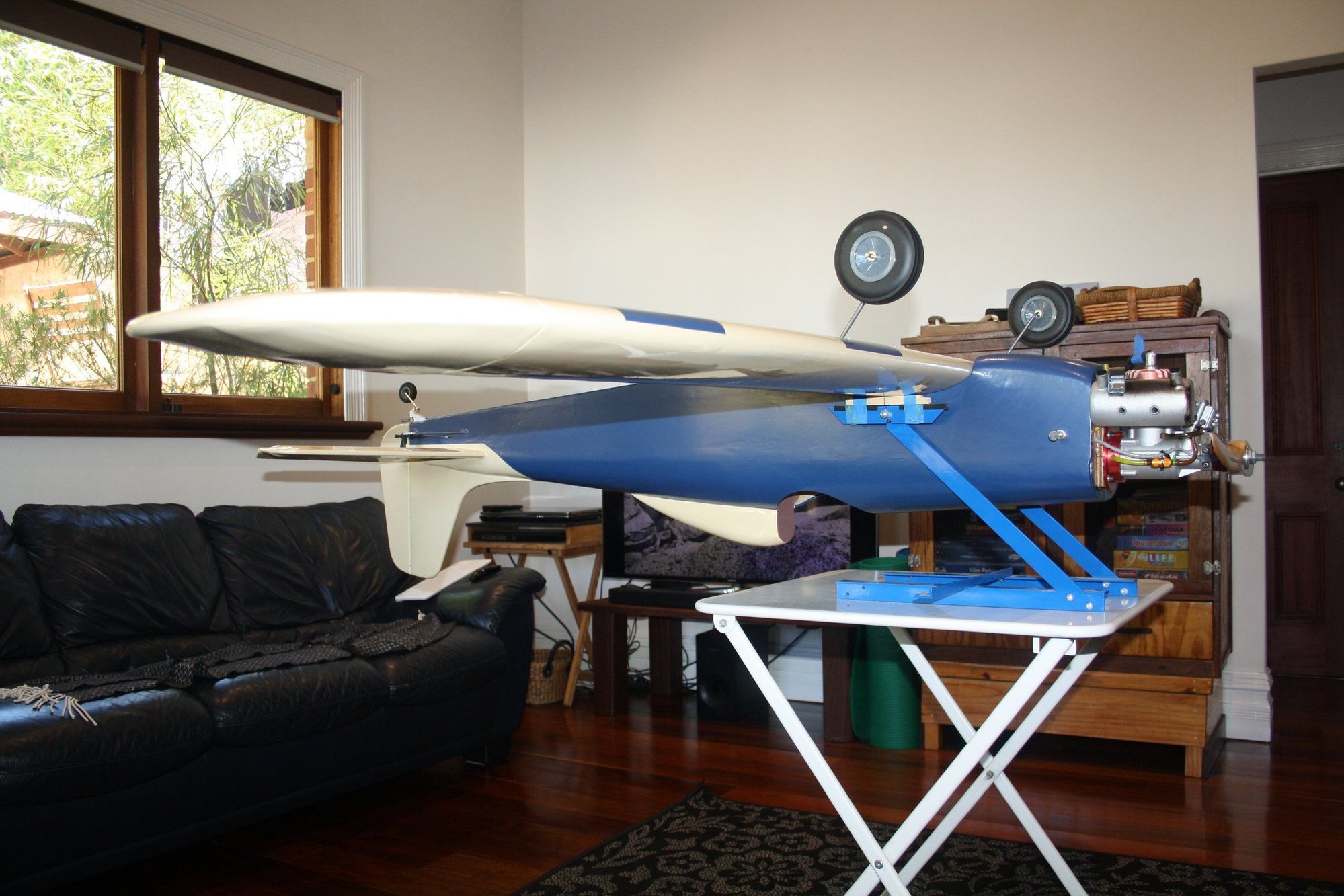

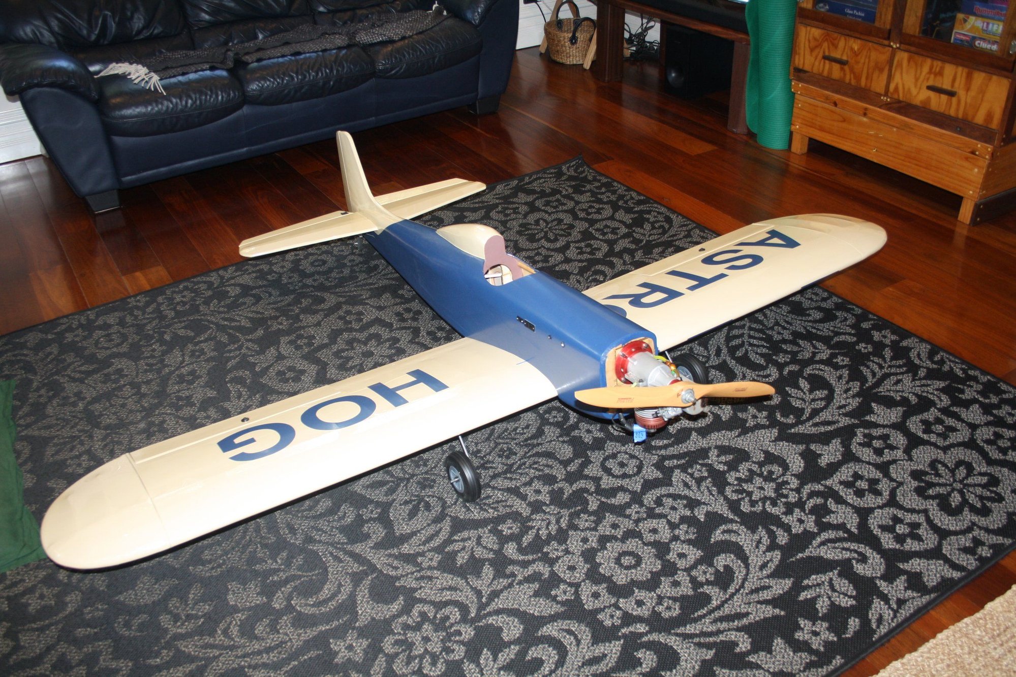

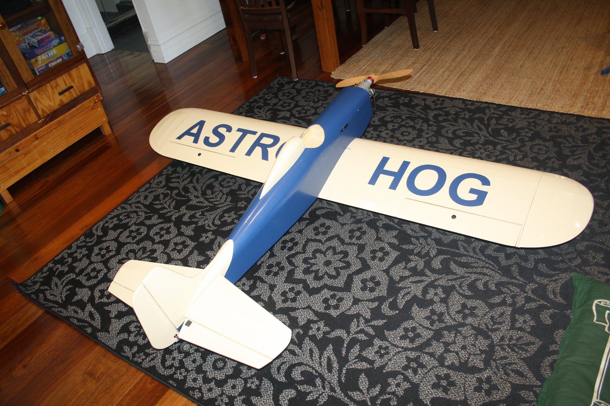

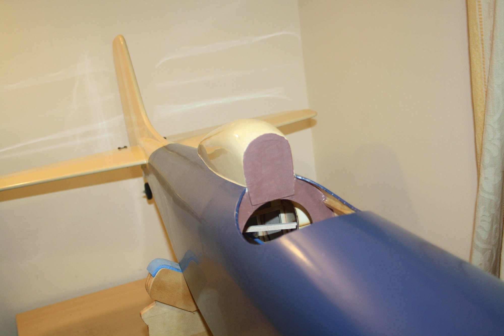

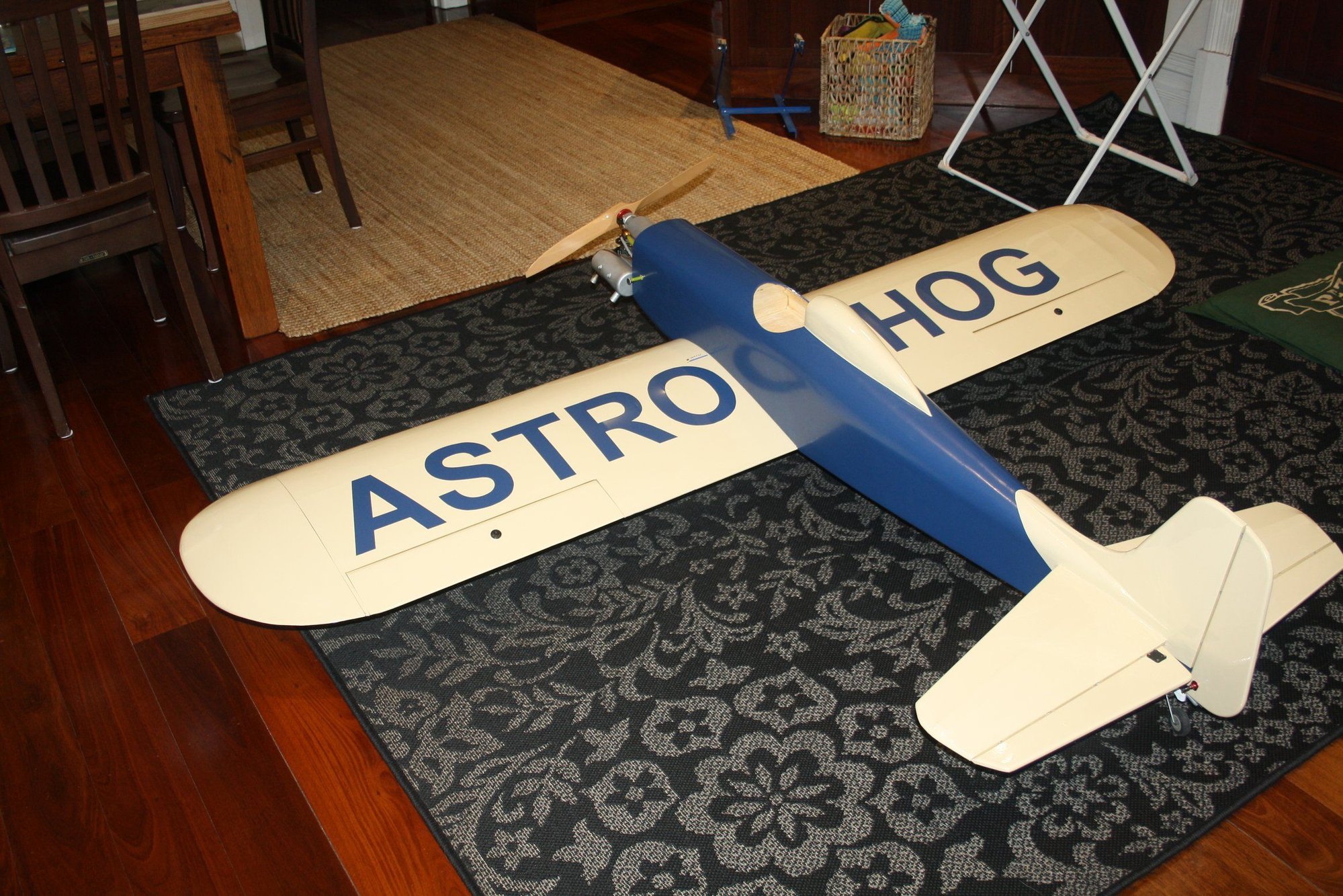

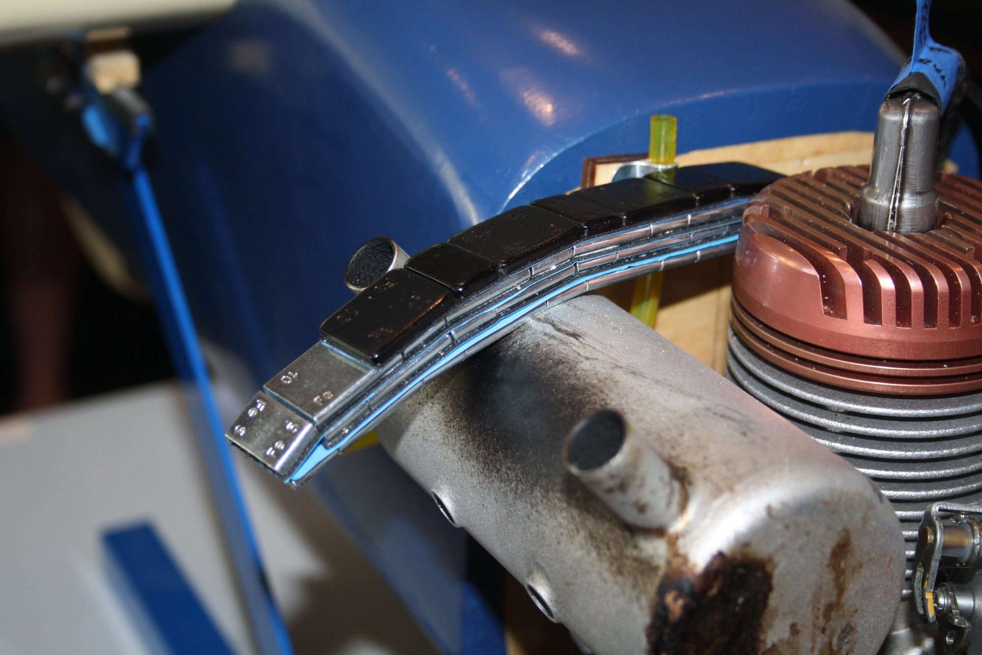

After installing the switches a couple of days ago, today it was time to check the current CG situation. As expected, the aeroplane is tail heavy, requiring roughly 240g near the firewall for balance.
Hopefully with the cowl and spinner it won't be too far off correct balance.
I took the opportunity of the aeroplane being assembled and placed it on "its legs" for the first time (it looks better in reality than in the attached over exposed photos). There is plenty of prop clearance which is always good news.
Last, I decided to relocate the receiver and place the batteries tray in the now vacant space.

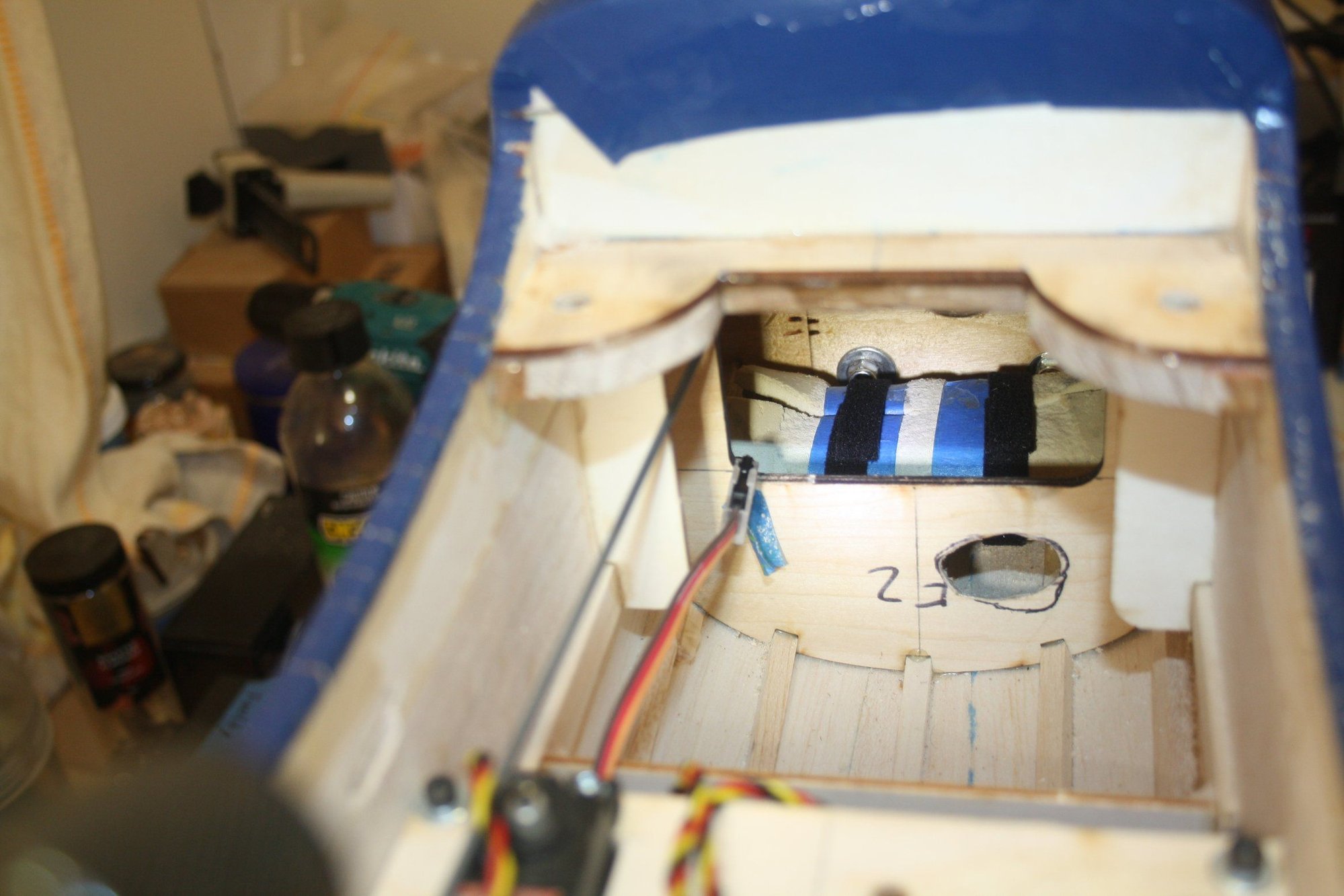

#168

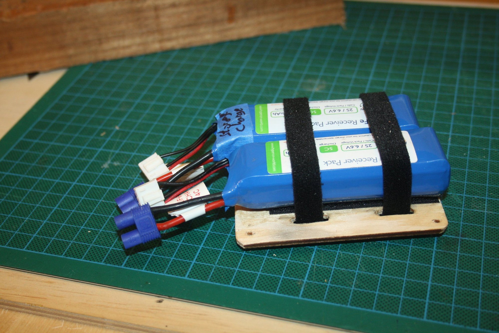

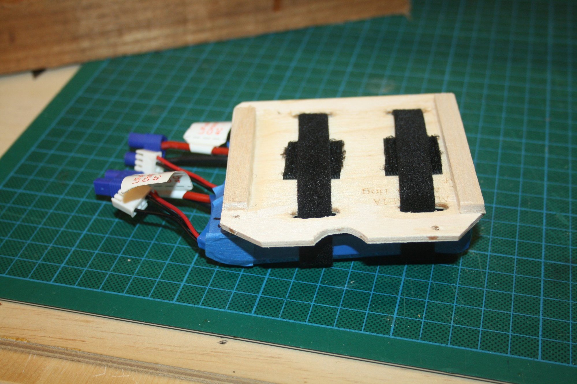

I made a removable battery tray.
This was the last item to do until I receive the cowl. Therefore there will be no further update until then.
