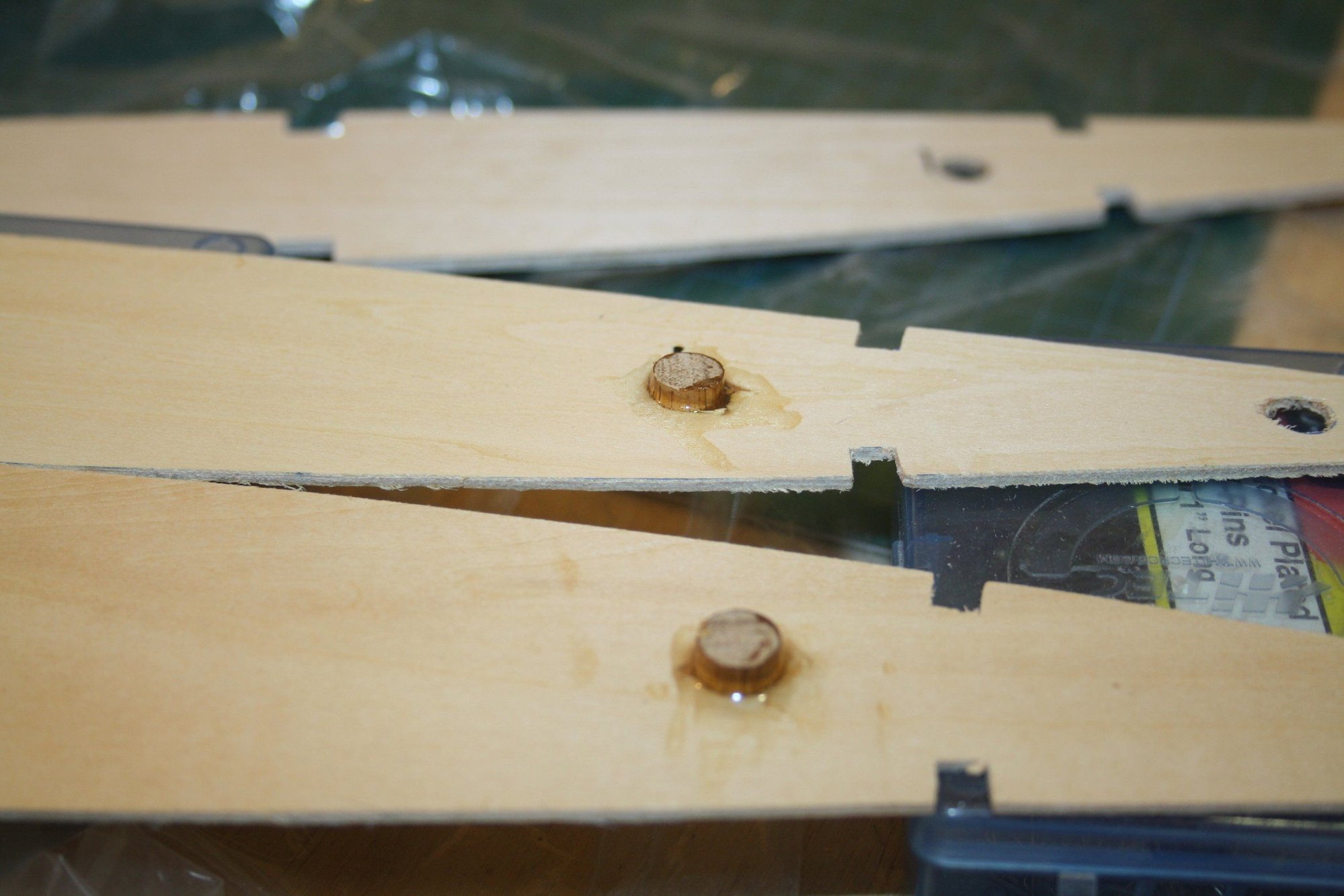

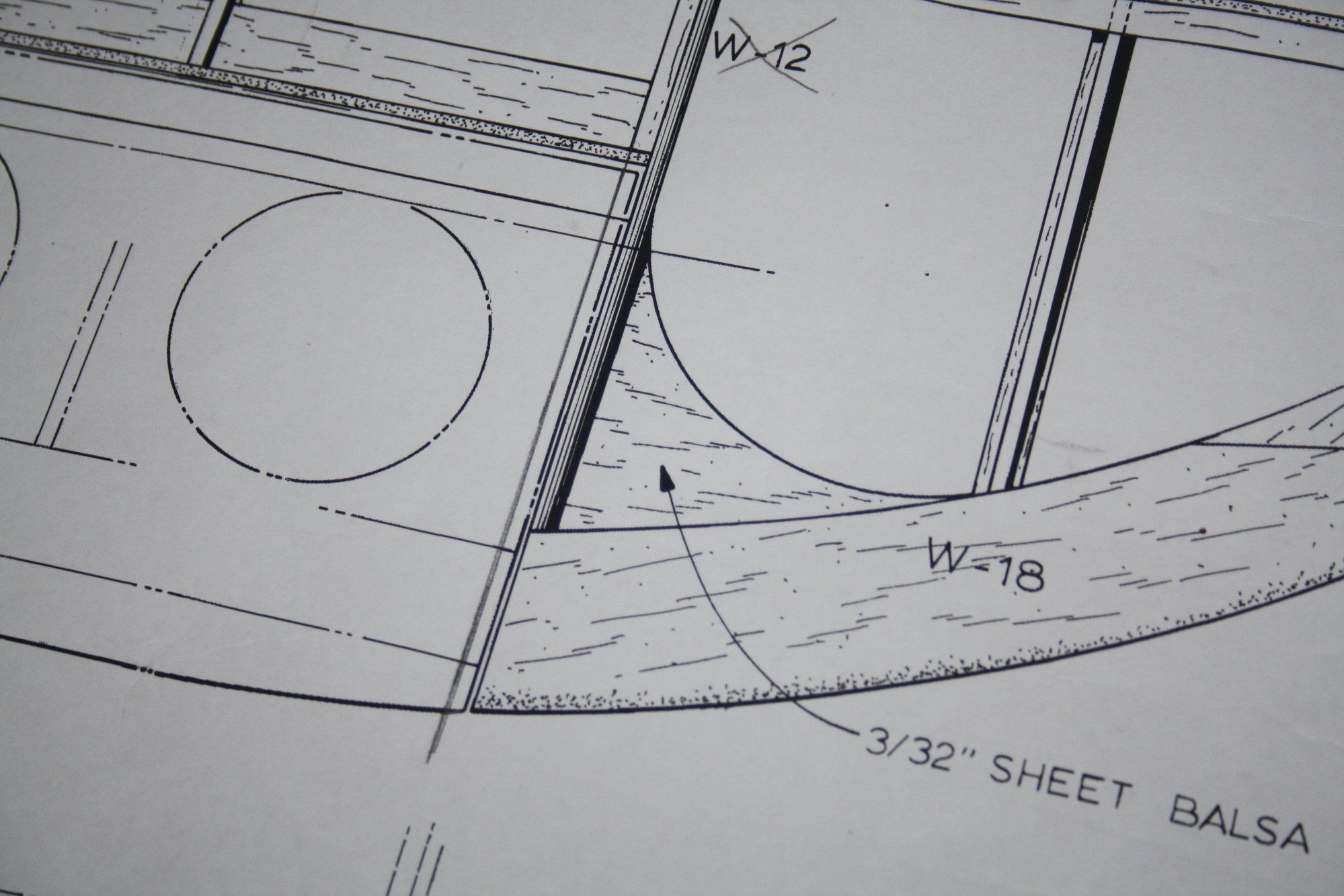

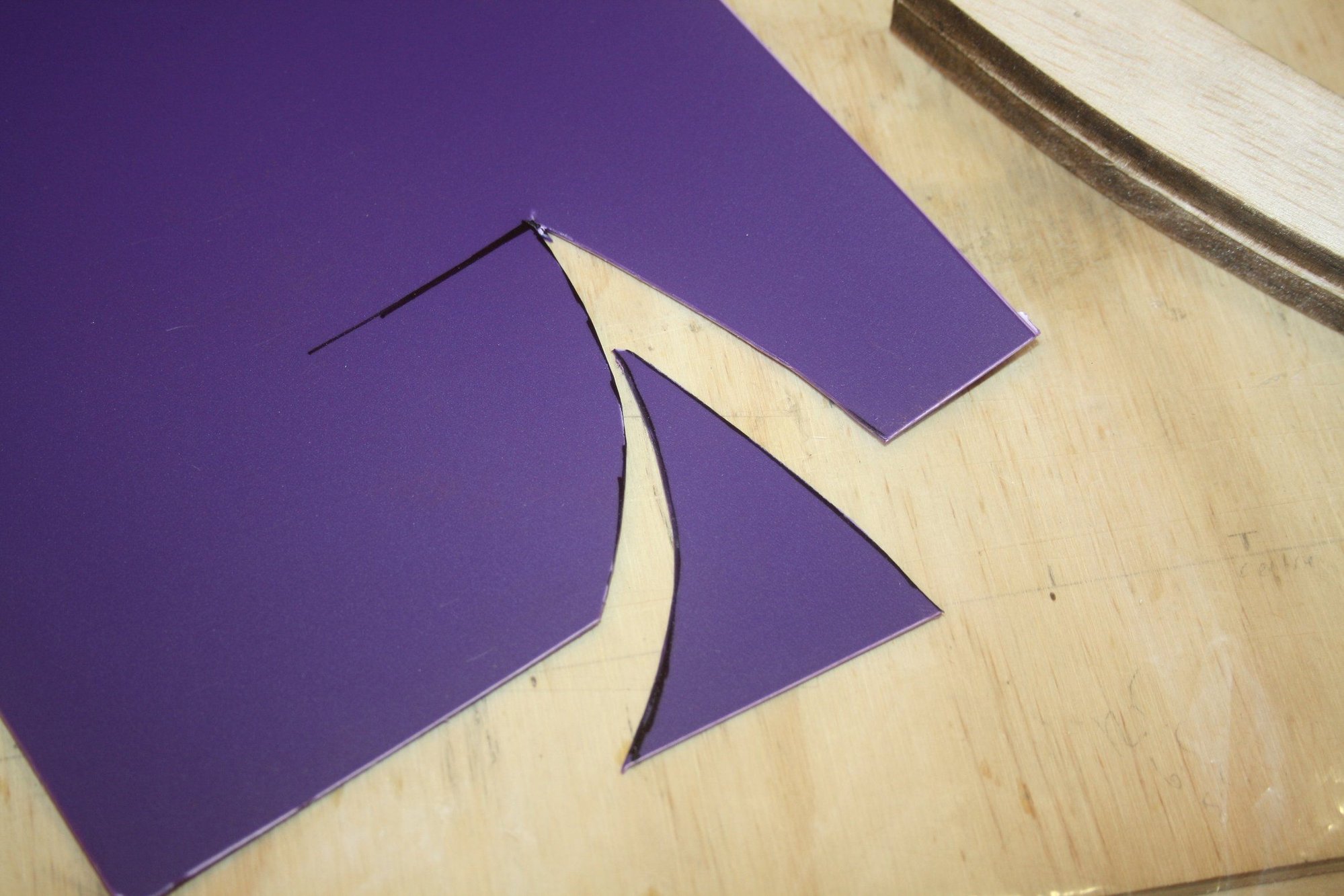

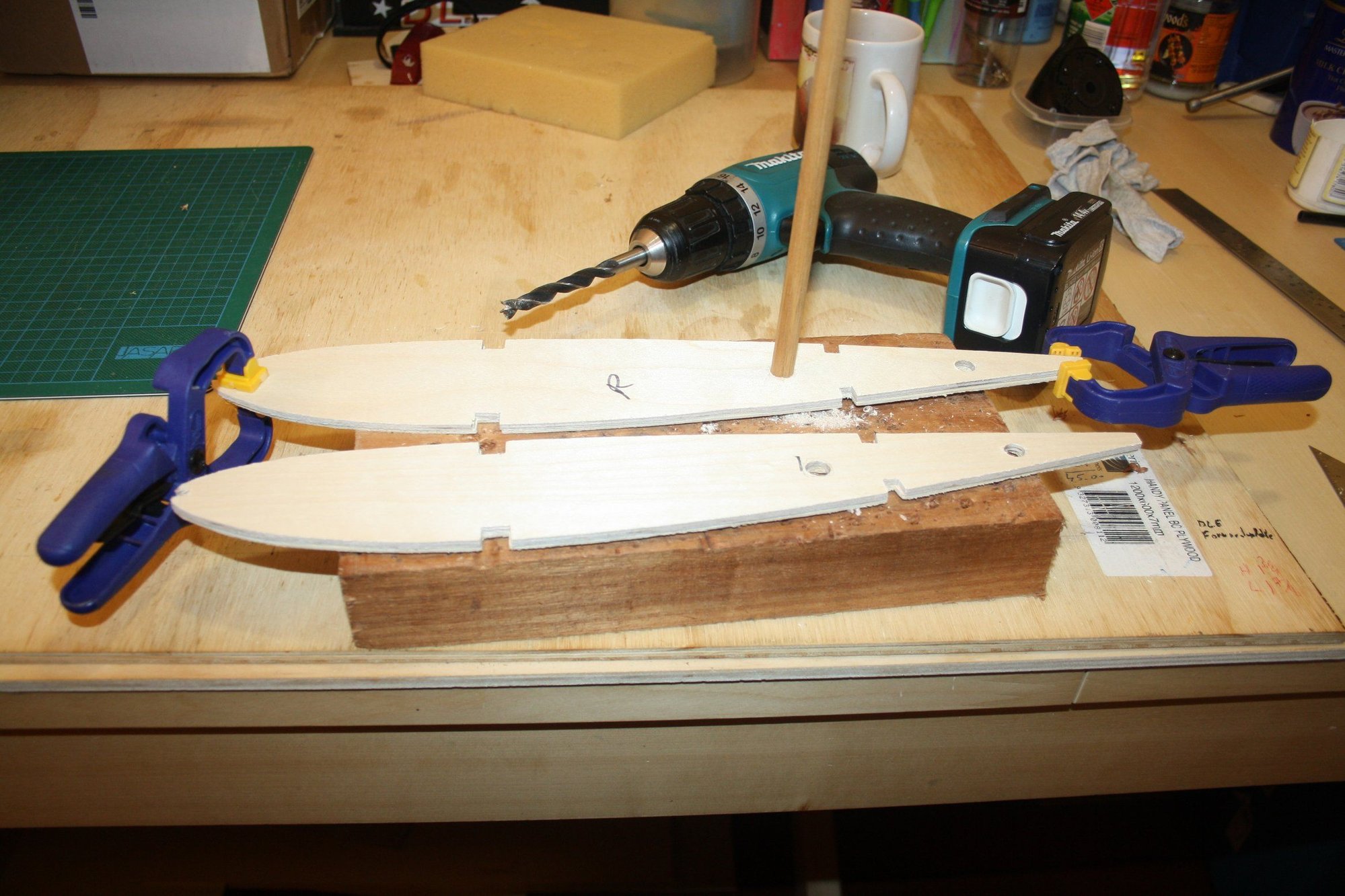

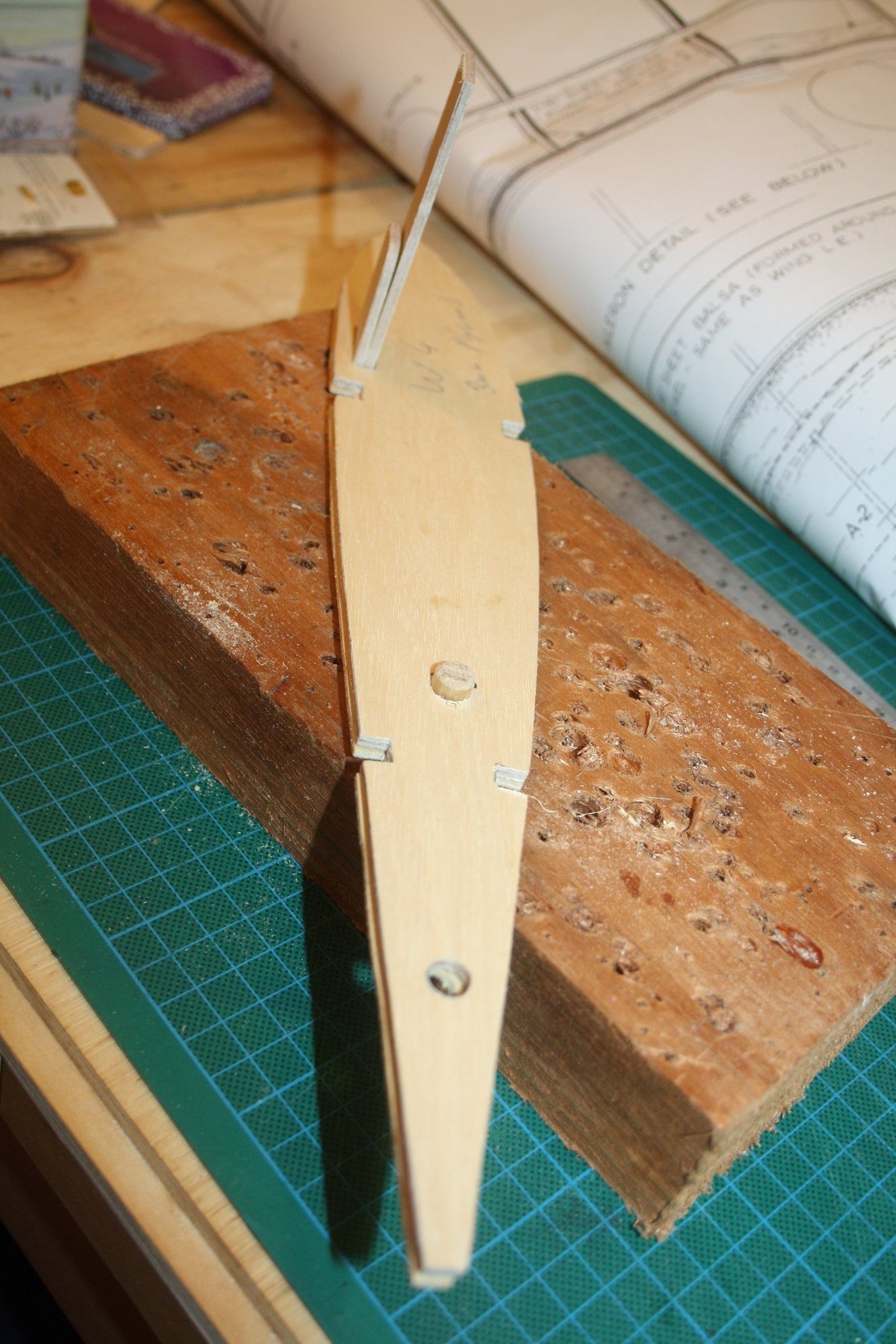

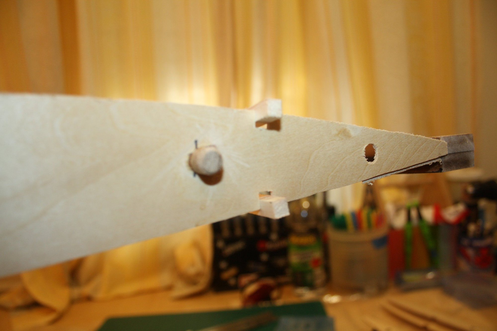

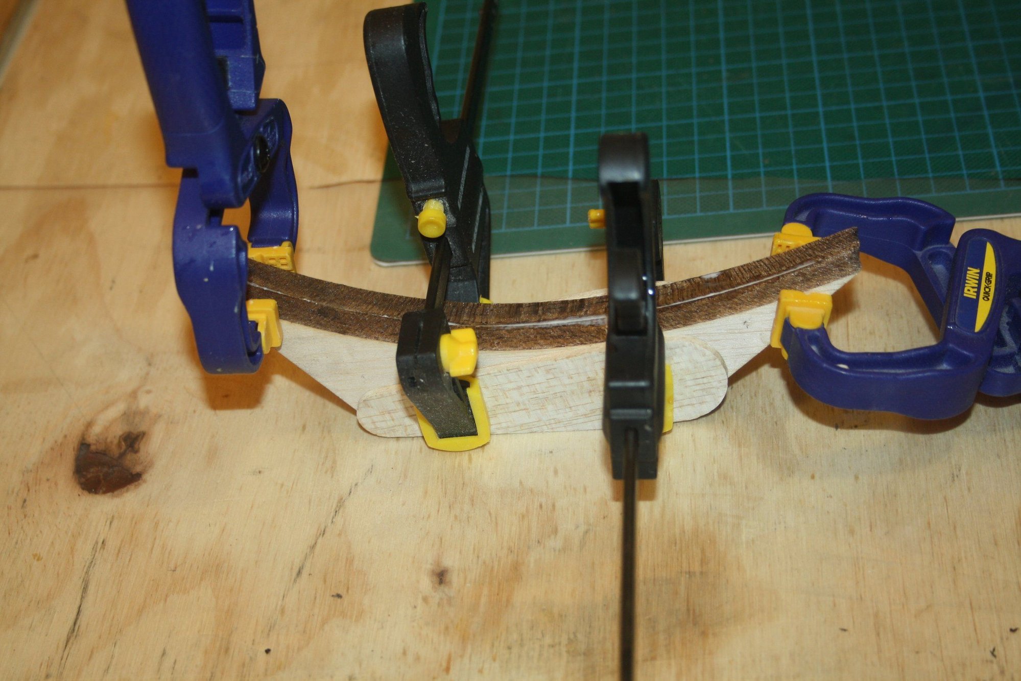

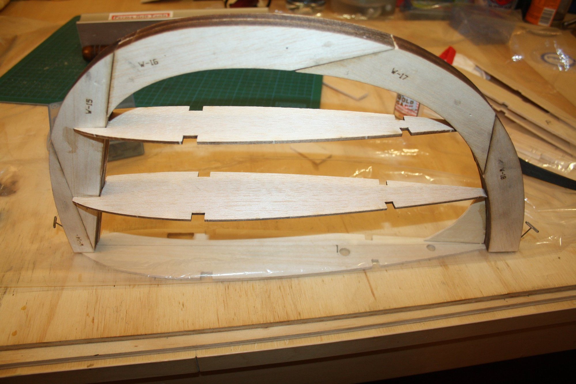

After removing the laser cut ribs for half a wing from the balsa sheets, I tested the wet formed 3/32" sheet on a rib and it fits perfectly.

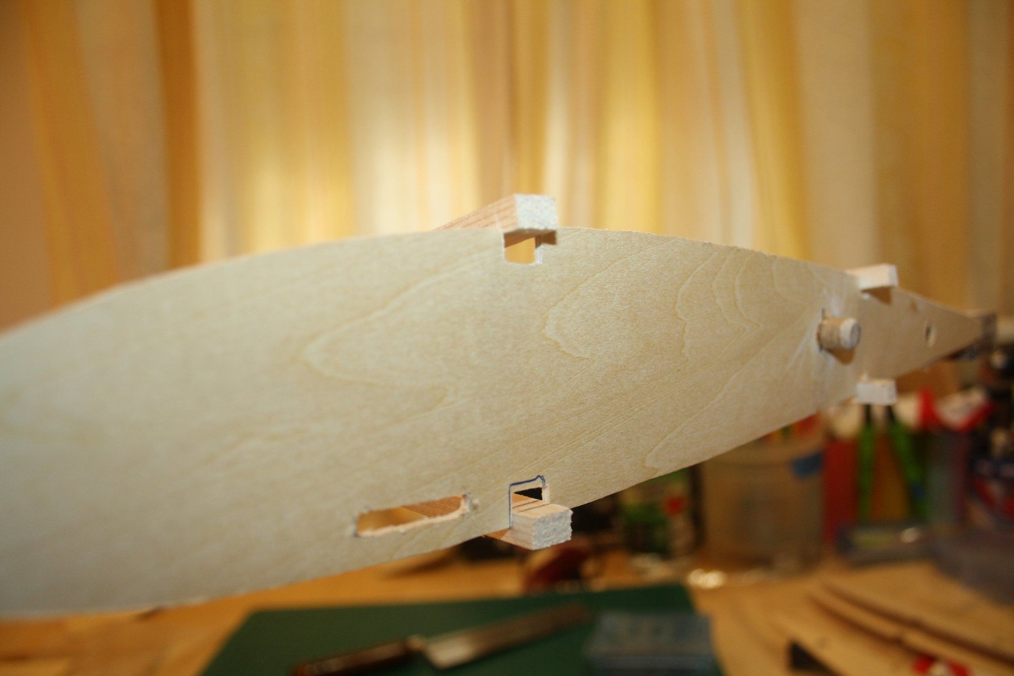

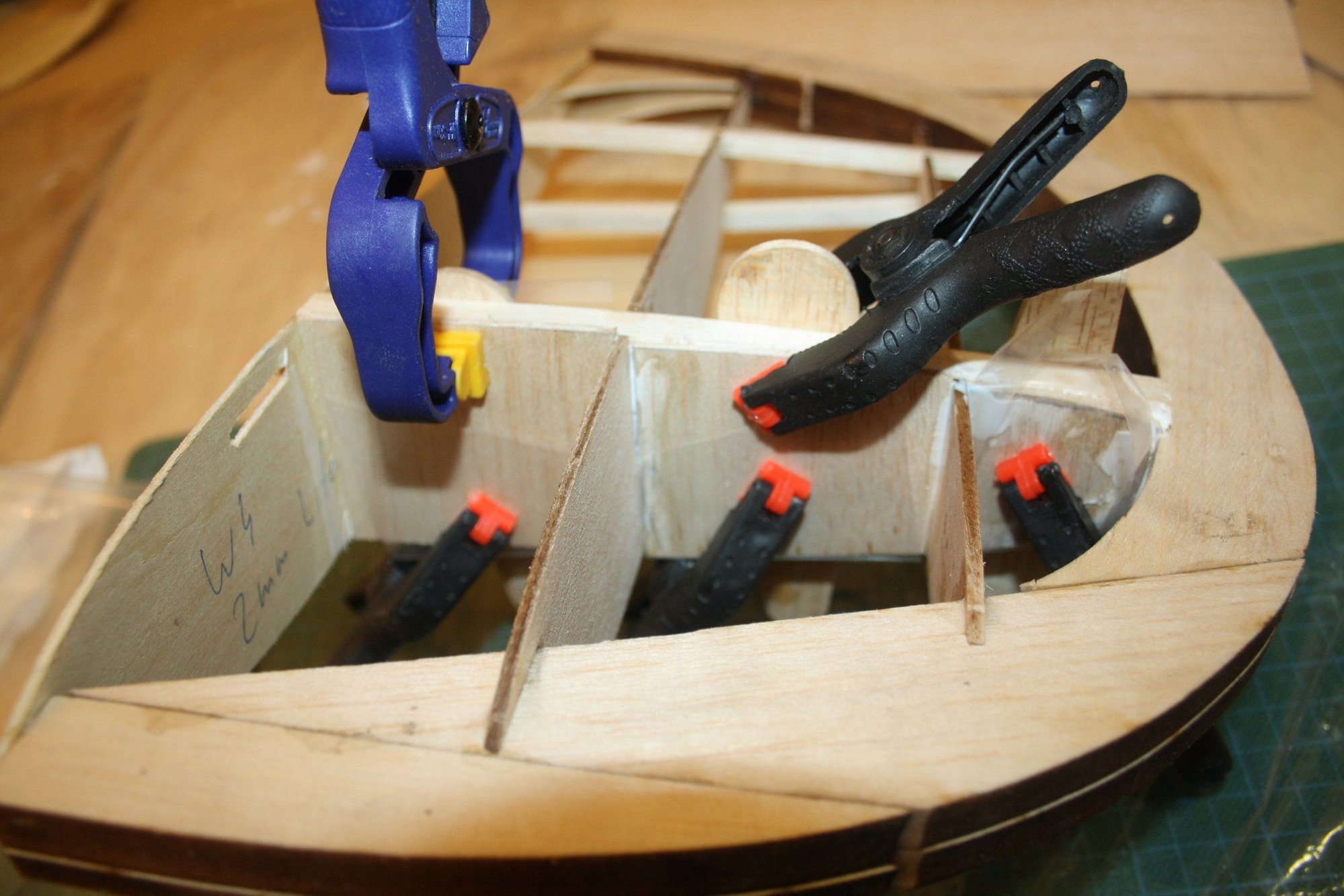

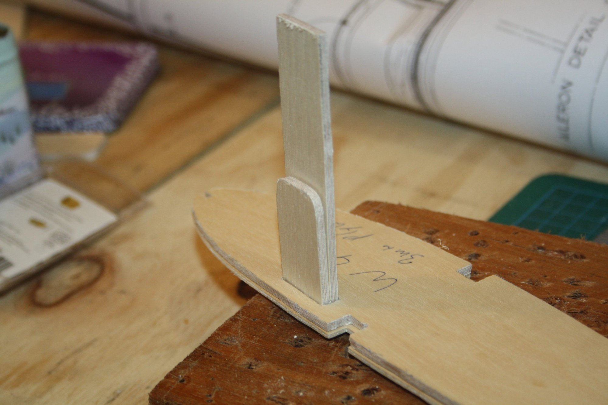

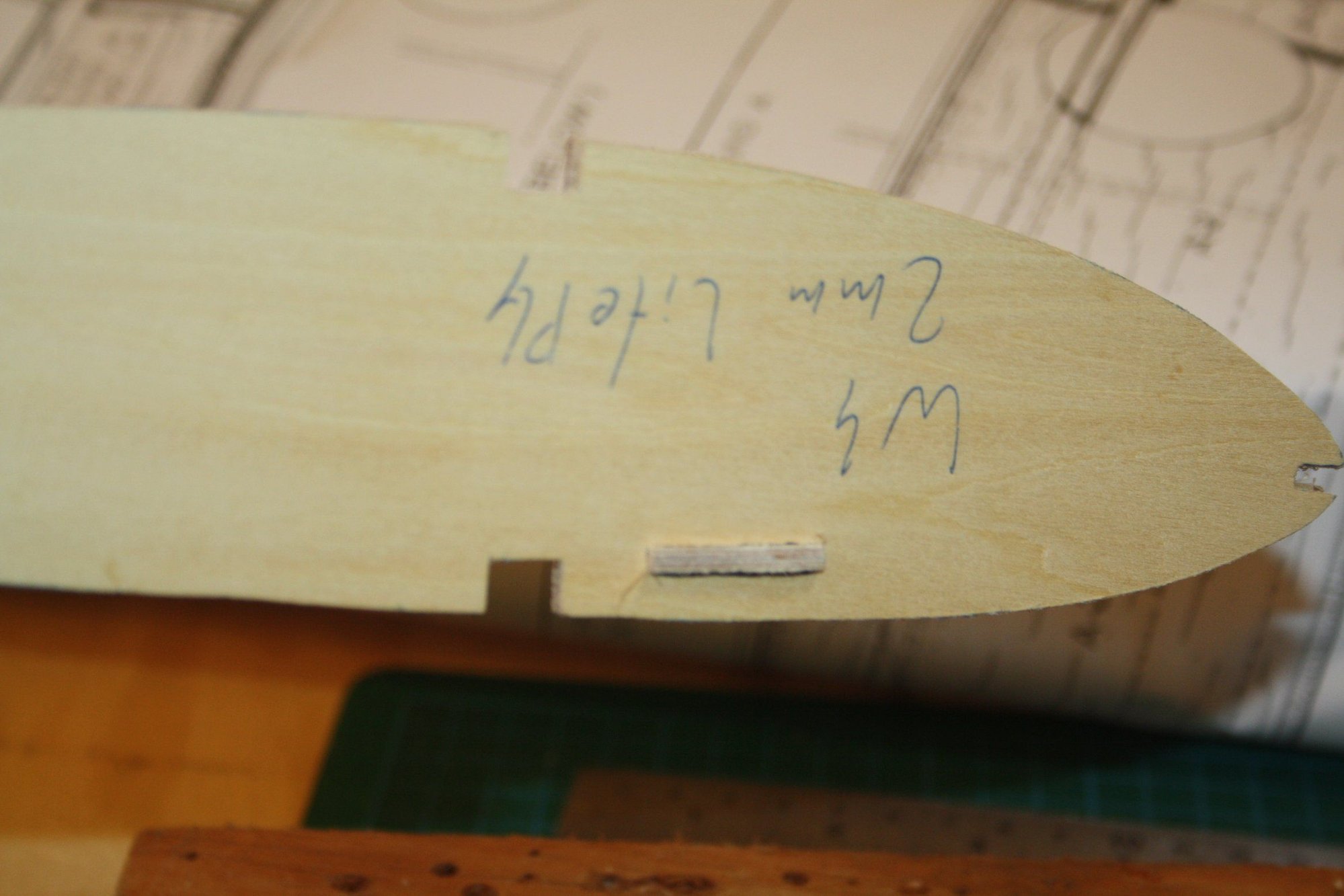

Today I was plying with the idea to make the wing-tips of the Astro Hog removable. This will shorten the wingspan by 400mm (to 1,900mm). I know from past experience that around 2,100mm wingspan one-piece wing just fit in my Mazda 6 waggon without obscuring the driver view out of the passenger window.
I did consider building the wing as 3 piece (cut after the wheel mounts), however, this solution was a bit more involved and I am too lazy.
My plan is to use two "W4" plywood full length ribs, substituting the "W6" short rib (as it had the aileron behind it). This modification will shorten the aileron by 3mm (see photos).
Once the decision was made, it was time to create some dust in my Cave. Tracing, cutting and sanding two 3mm birch plywood and two 2mm Lite ply newly created "W4" ribs.
Cheers,
Eran

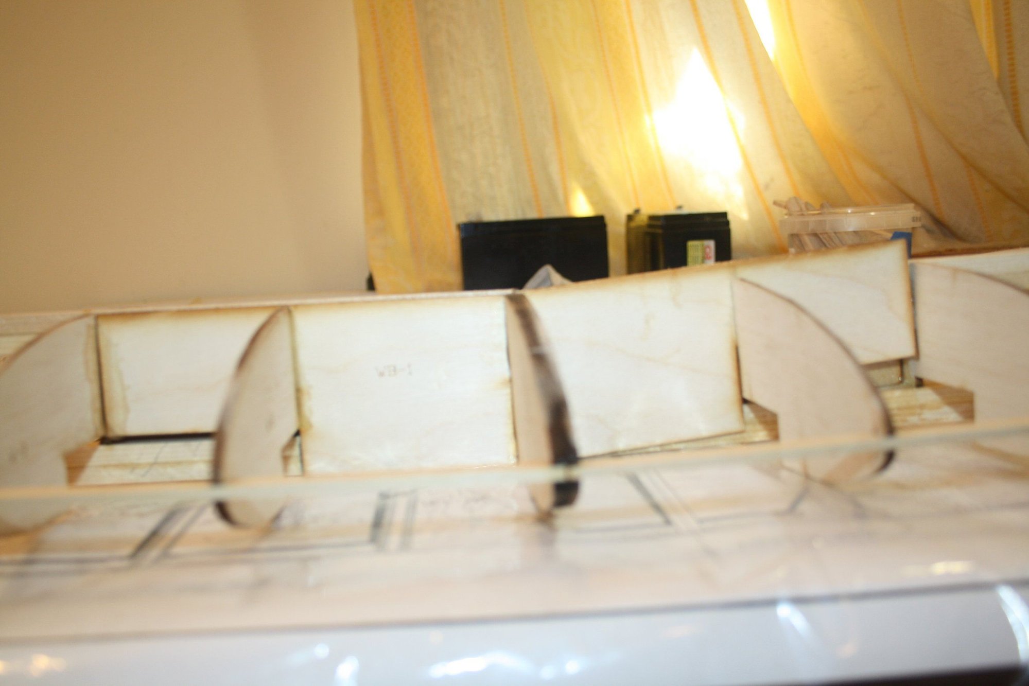

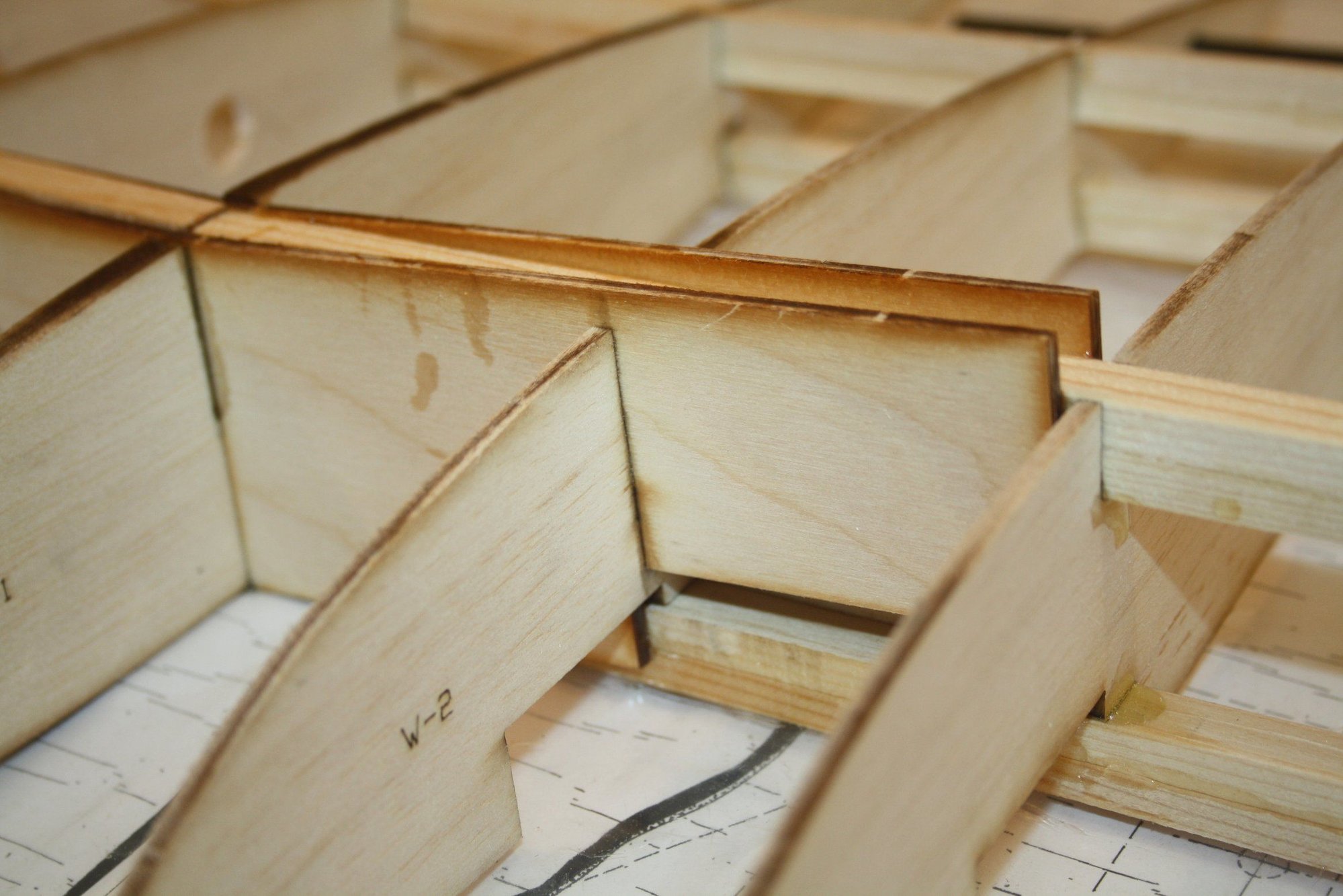

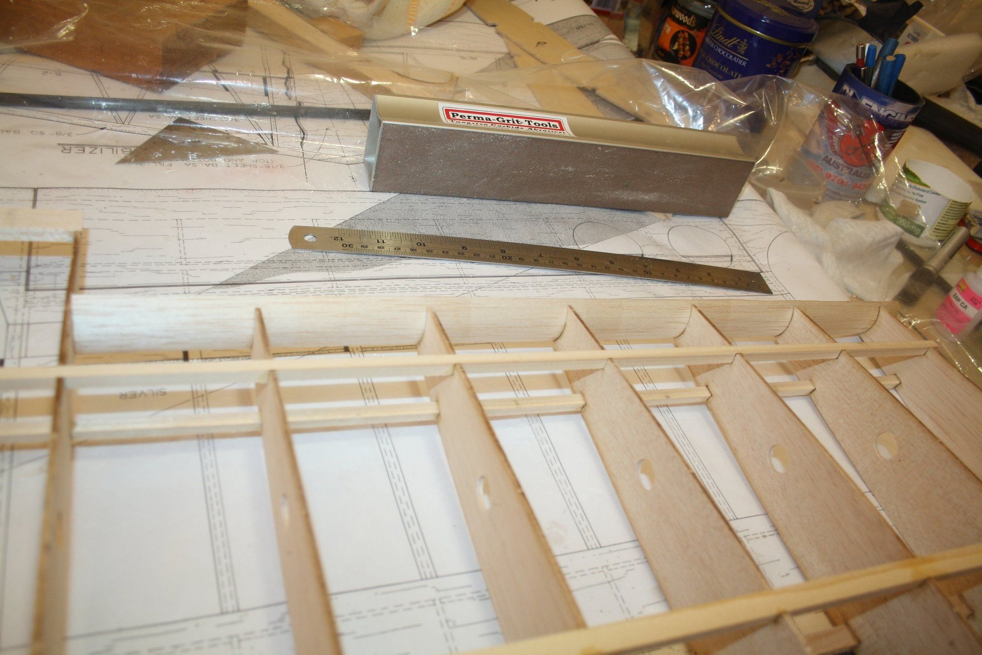

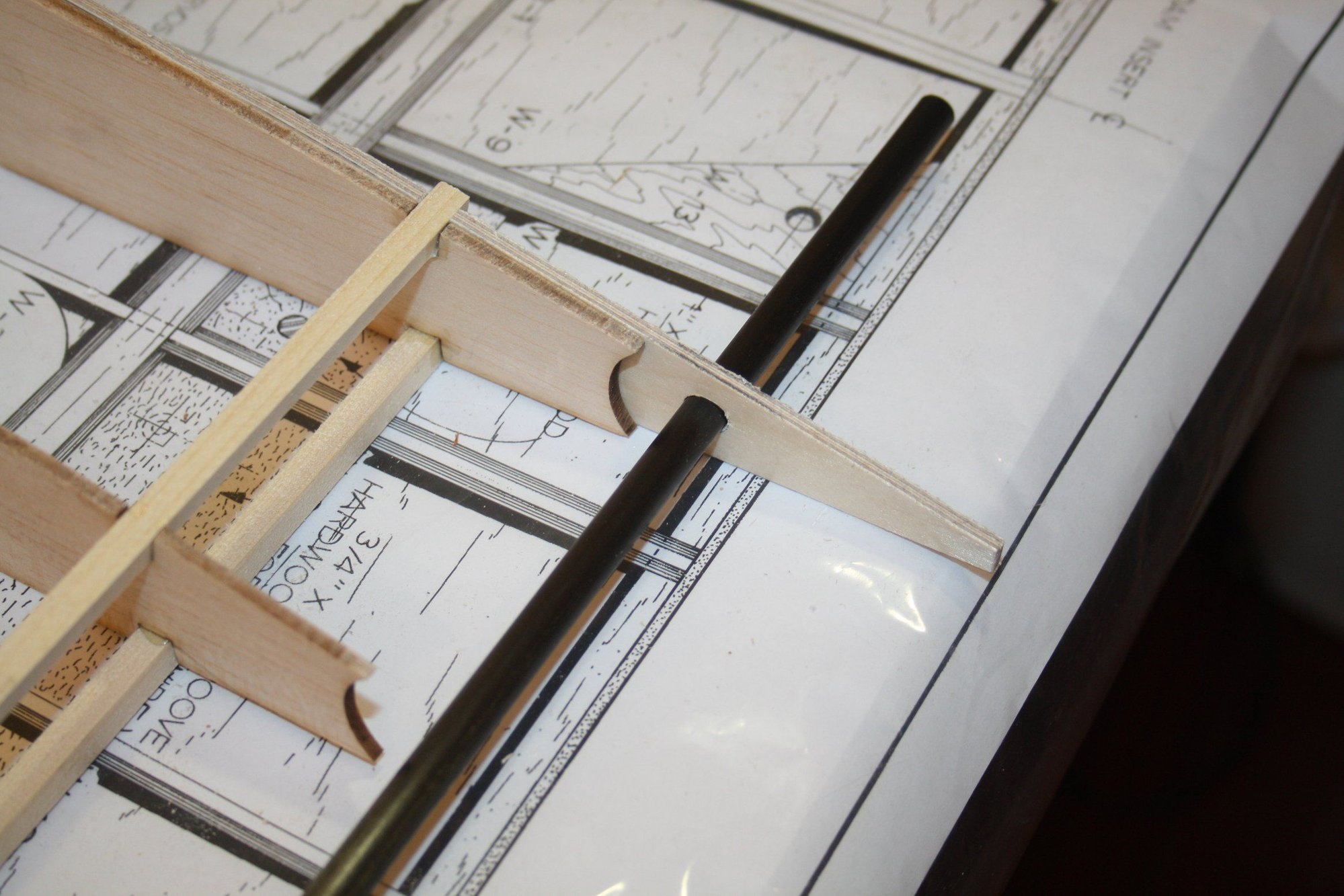

I thought that I will be glueing some ribs today, but I realised that I am still missing some spruce.
What I end up doing was dry fitting the ribs and having a look at the stages I will need to do when I am ready to glue everything. The laser cut fit is good, which helped.
I then glued the main spars to the main spar doublers. I also cut a hole in the ribs for the servo leads (my servos will be placed next to the ailerons) and wet formed 1/16" balsa around a poly-pipe for the TE of the ribs adjacent to the ailerons.

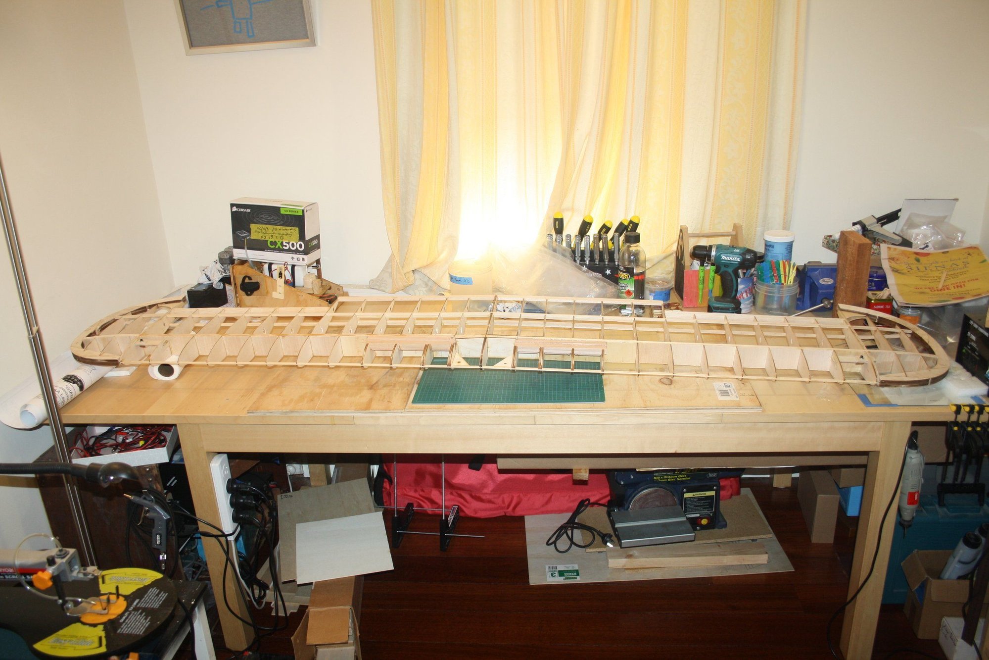

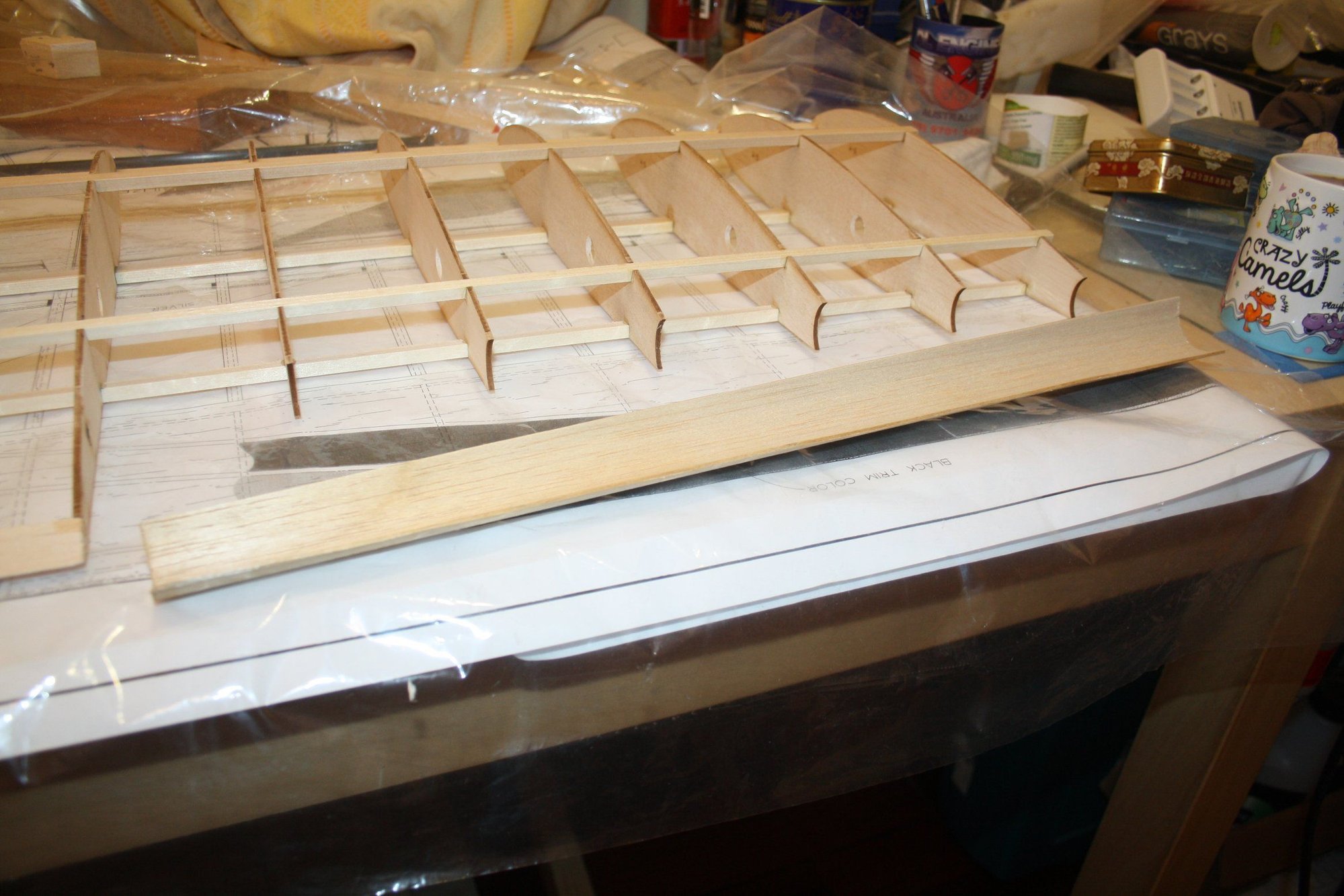

After test fitting the wing (actually half of the wing) few times, I finally glued it. It came out very nice.
In addition, I am still playing with ideas for securing the ailerons hinging. I am looking at birch plywood "bushings" for strengthening the passage through the ribs as well as possible retention of the carbon fibre rod to prevent side movement. I cut few pieces which you see in the photos, but this is still not finalised.
I also test fitted my "end rib", but am yet to commit to anything. Time for some more coffee while I am thinking about it all.

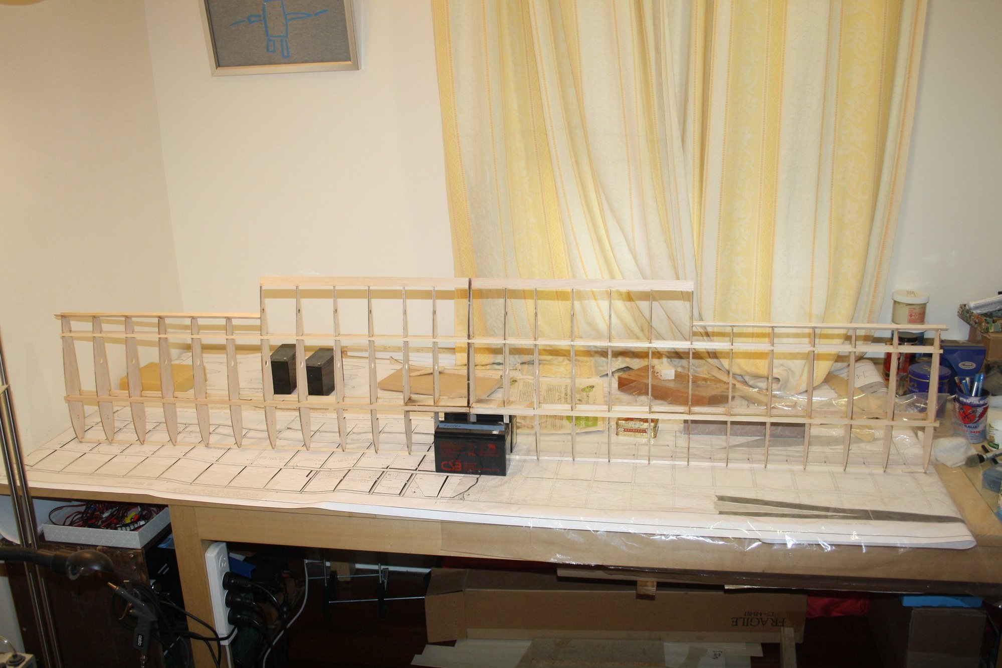

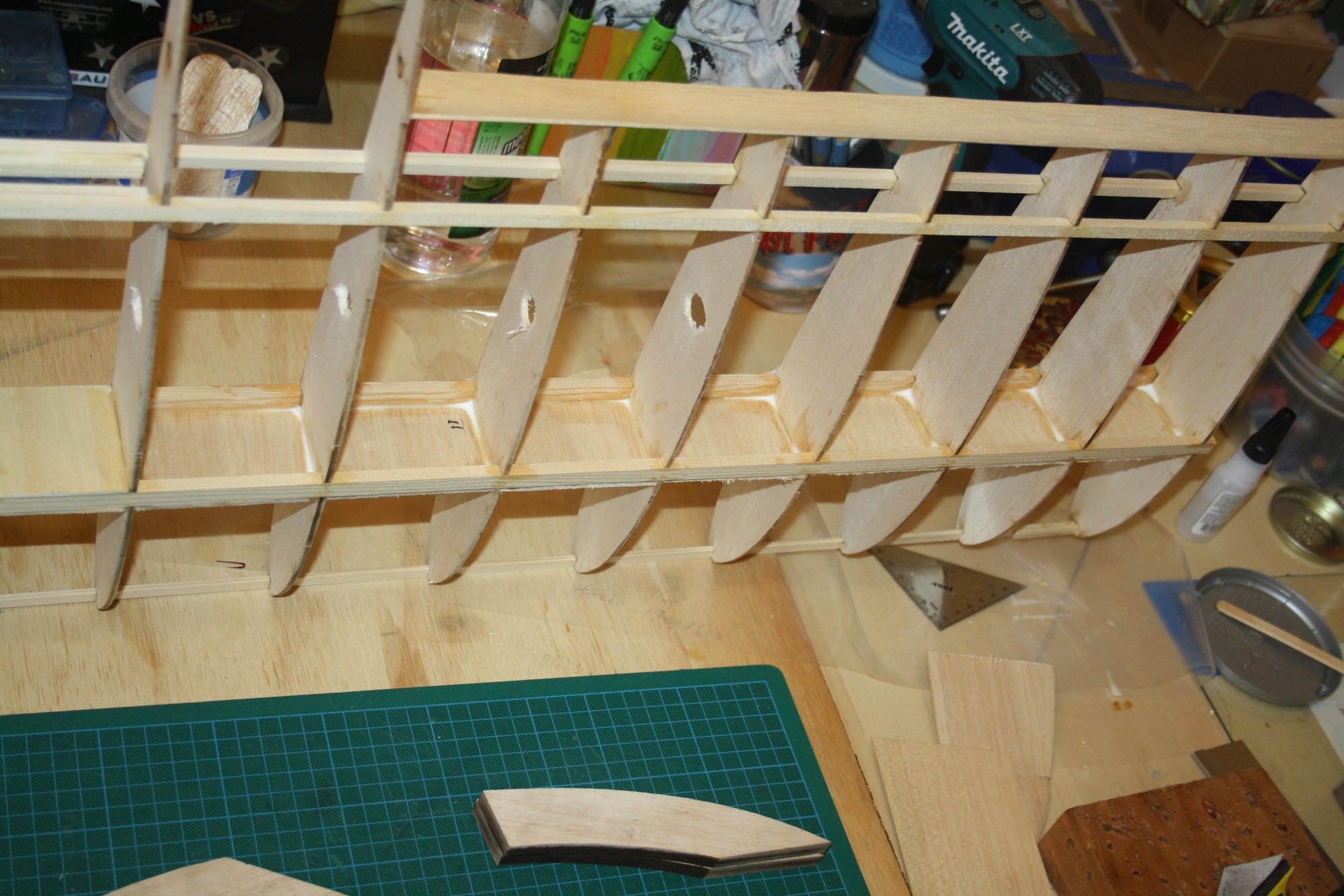

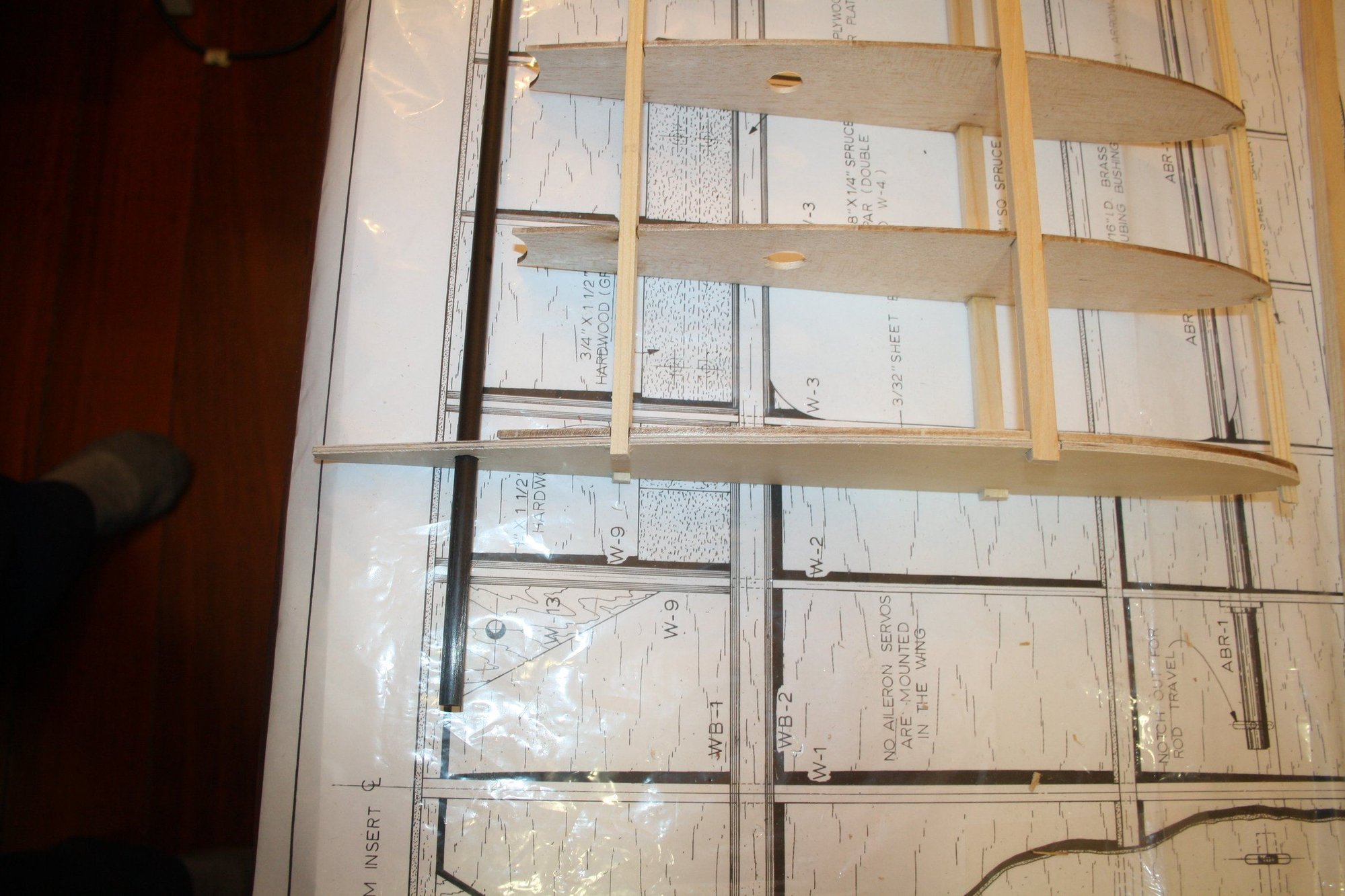

I glued the secondary spruce spars to their corresponding spruce doublers (as was done with the main spar).
I then made the left wing panel and once the glue dried, I attempted to dry fit the wing.
Two things were immediately obvious in the process:
1. That the blocks I made for the wingtips to hold it in the correct dihedral will not do. I fabricated proper cradles from the laser cut "negative" of the ribs, which worked very well.
2. The dihedral brace has substantial wrong angle to it (I did check and the laser cut perfectly fit the plan).
As I already glued the dihedral brace to the right wing panel, I glued the wing with it as is and will fix this once it is dry.
Cheers,
Eran

I just realised that I miss red the note regarding the support of the W6 rib for dihedral.
The height was for under the rib and not the rib tip as I was reading it. In that case, the brace is of correct angle. Too late for me tough...
Cheers,
Eran

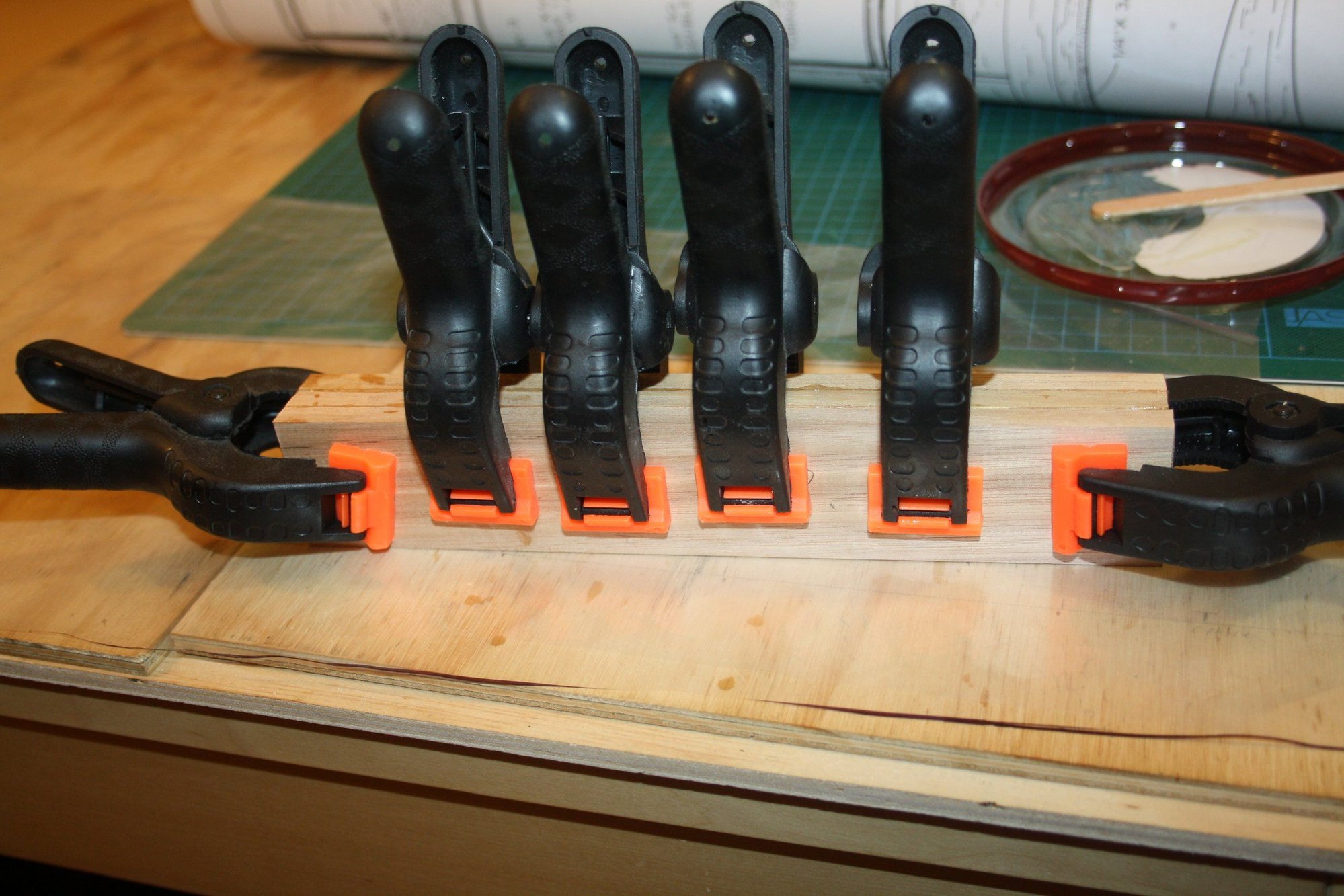

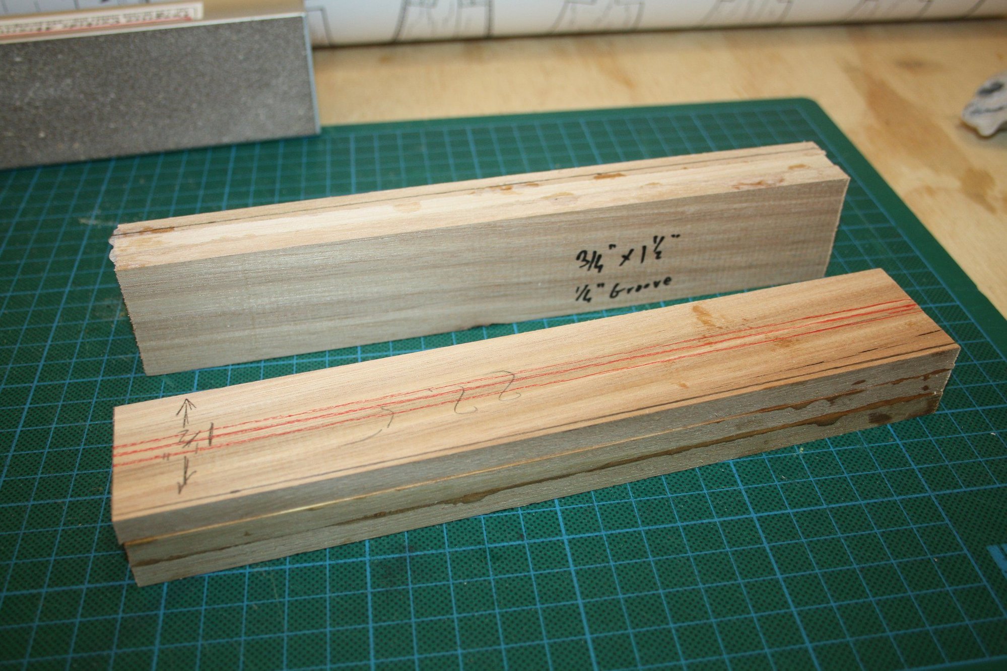

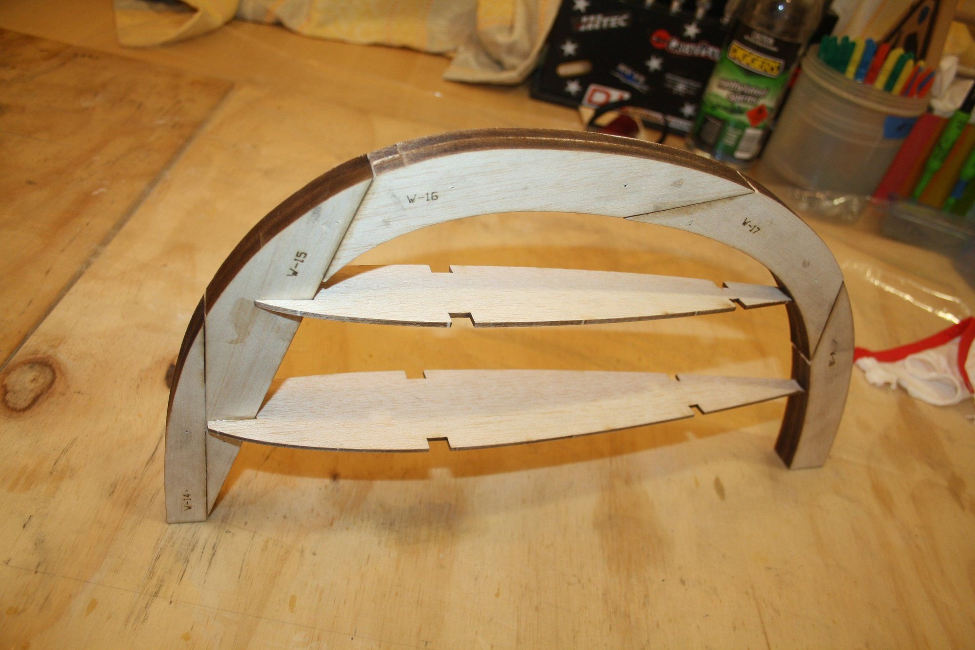

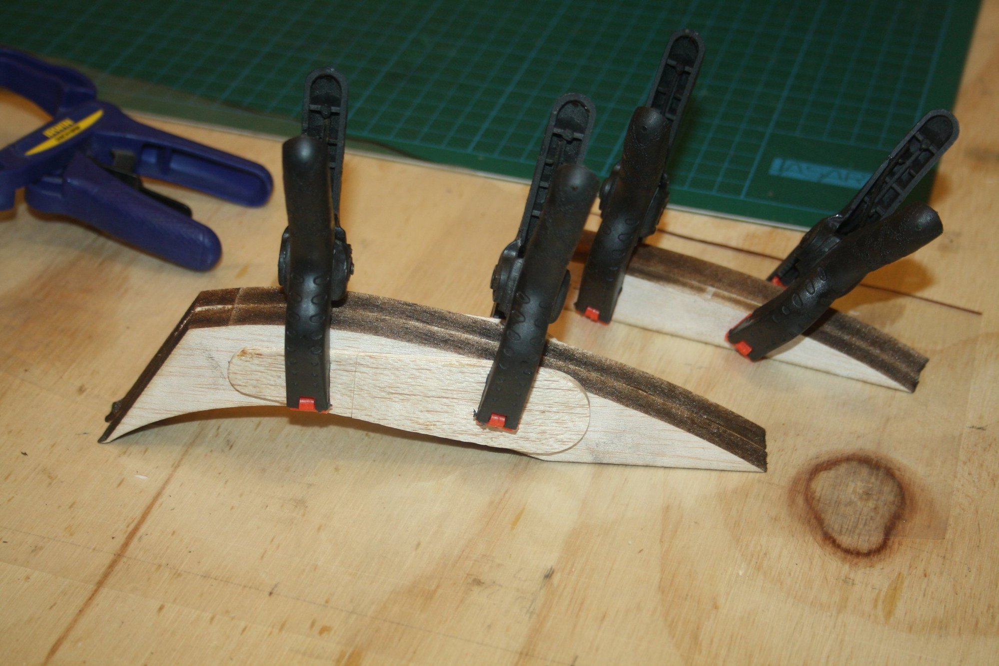

Since large blocks of hard wood are not easily found at the hobby shops here, I laminated three pieces of Tasmanian Oak and will cut it to size for the landing gear blocks.
I am also making some progress on the detachable wing tip idea. While not final, I am experimenting with locating dowel and birch plywood tongue that will correspond to a fixed plate with a lock nut to be located between the last couple of ribs. A screw will then fix the wing-tip in place.

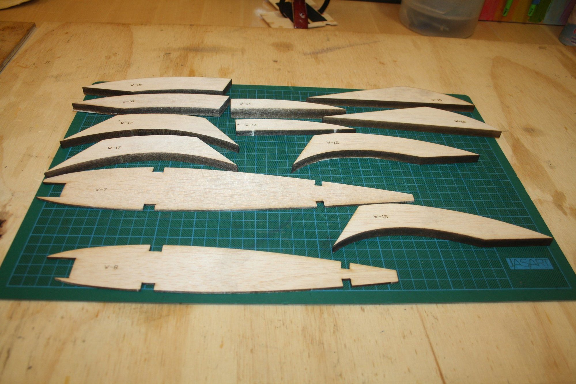

While at it, I got the laser cut parts that form the round wing tip and started gluing them together.
Cheers,
Eran
Cheers,
Eran

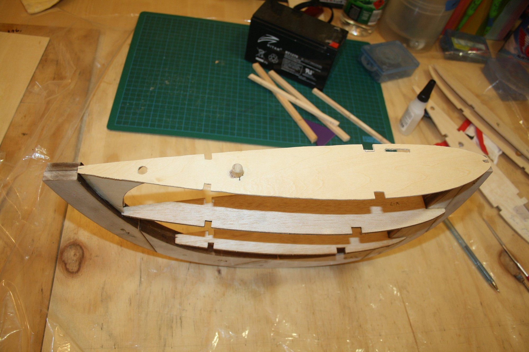

I glued together one wing-tip. I also glued the plywood sub-ribs which reinforce the landing gear blocks and the front wing-bolts plywood supports.

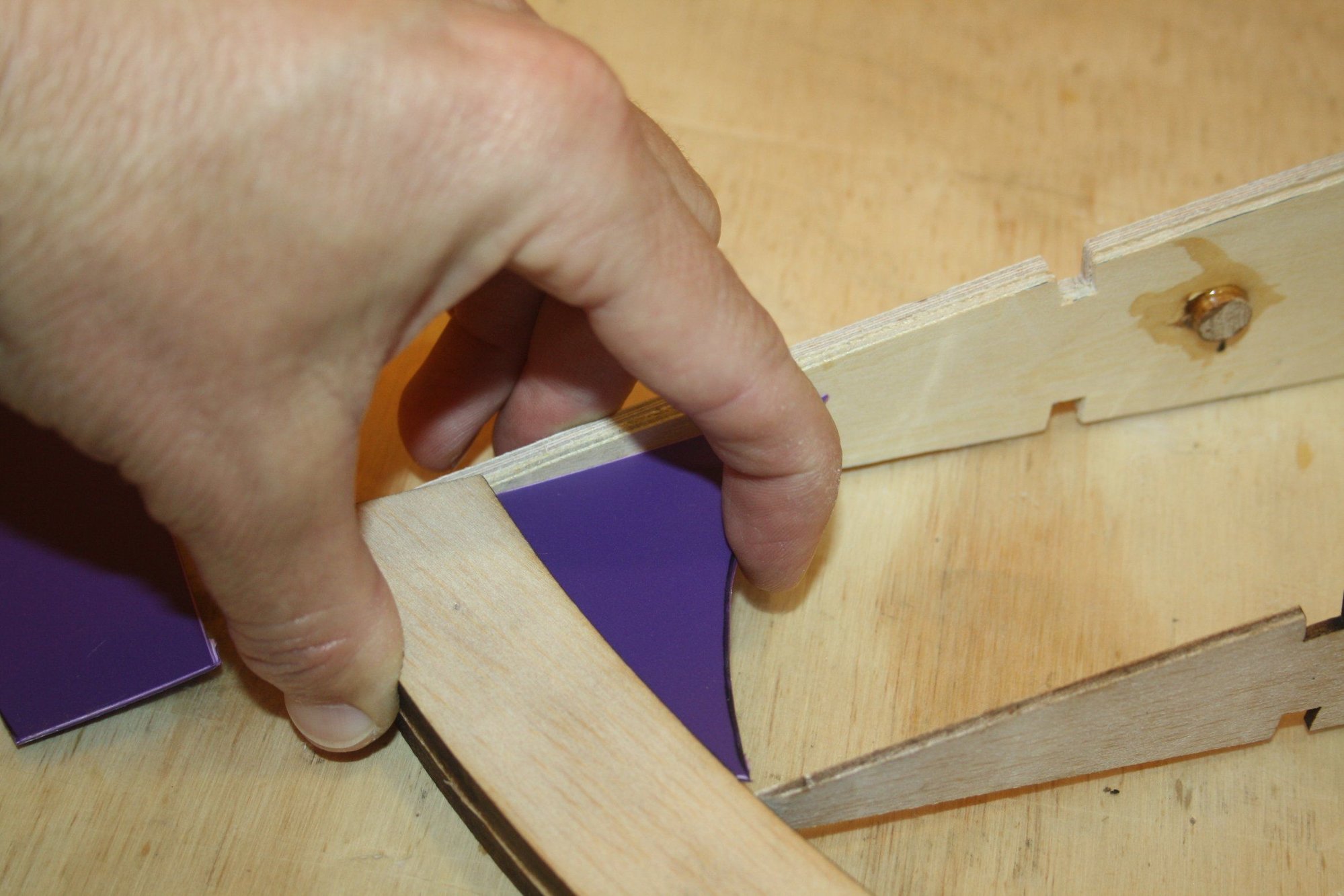

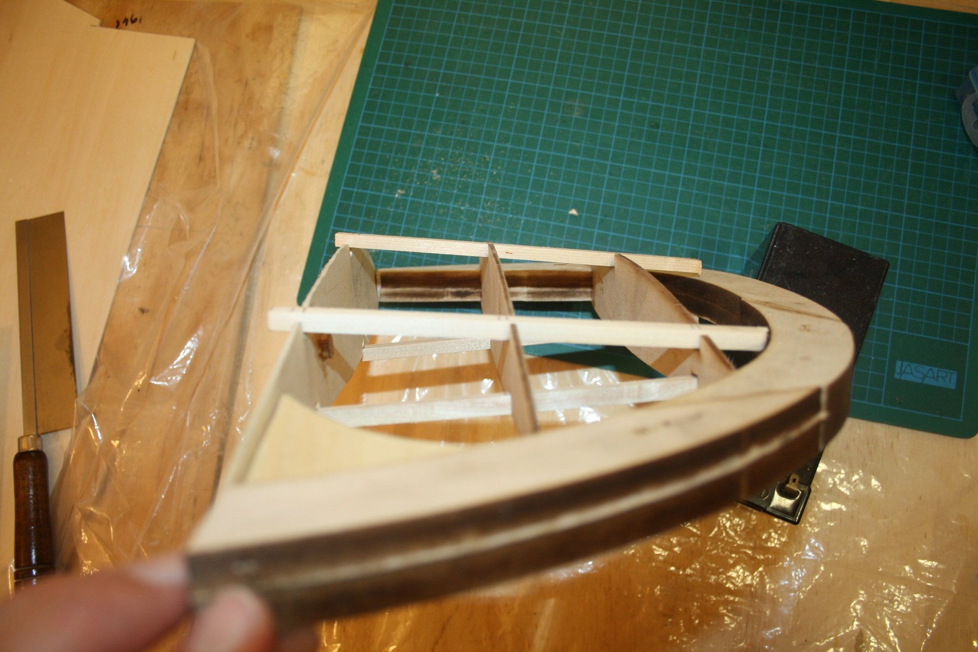

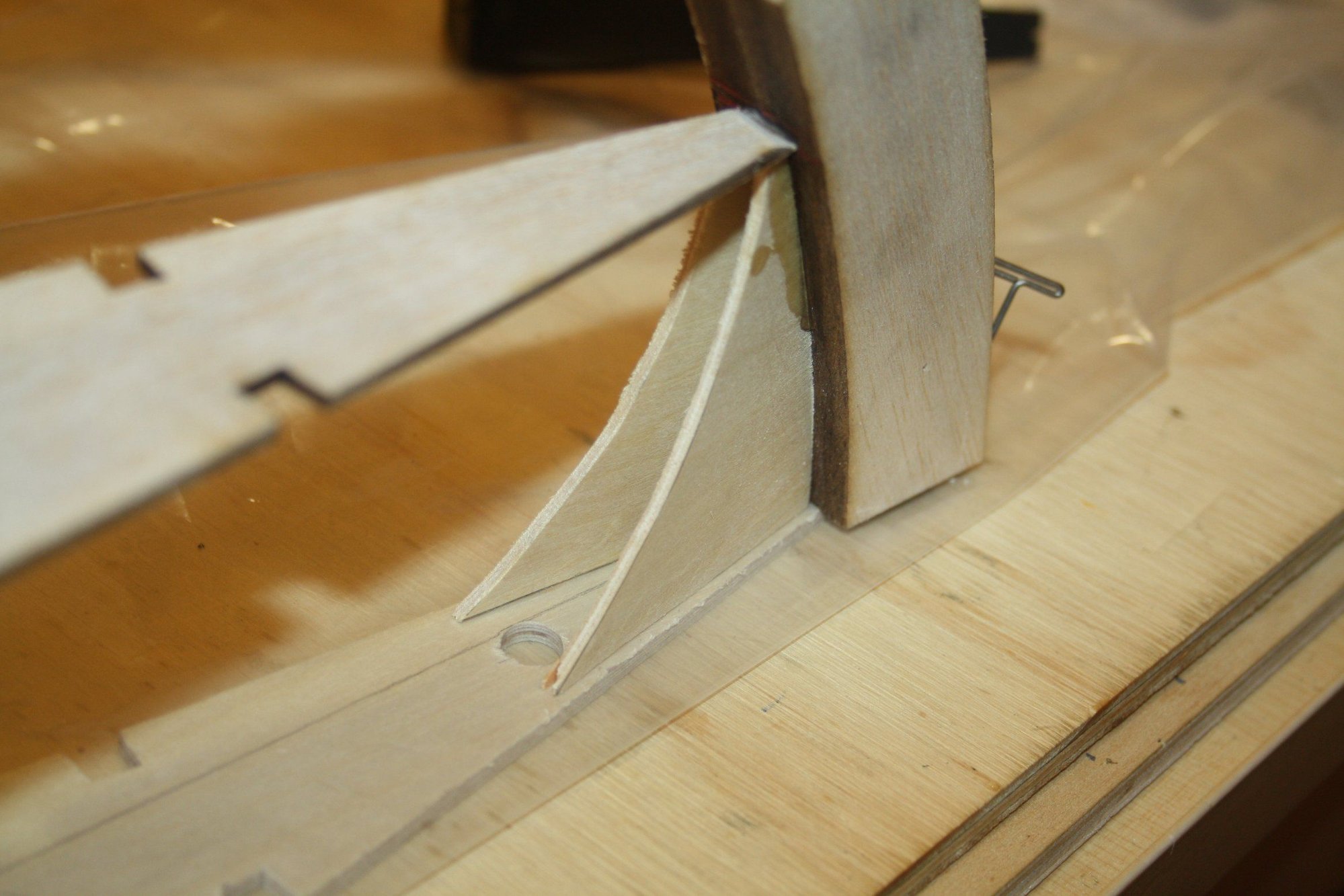

I was working on the wing-tip today. I reached the point of decision regarding my "additional ribs" as I am attempting to make it removable.
One of my concerns was the fact that on the wing-tip side I was using 2mm Lite-Ply rib which is flexible and may curve and create an untidy contact area with the last rib on the centre section (a stiff 3mm Birch Plywood).
I decided to supplement the original design 3/32" sheet balsa support at the TE with two 2mm Lite-Ply pieces. I had to be careful not to block the hole for the carbon fibre rod (which may be used as the aileron hinge). I glued the two supports while the rib lay flat on the table.
My next obstacle was the spruce spars. I could not see an easy way to bend them to fit the wing-tip. I replaced them with balsa spars which are plenty strong for this small section. I could not bend the Balsa spars all the way as well, but at least by using doublers I will be able to sand them to shape towards the tip.
Last, I glued the sheer webs.
Cheers,
Eran

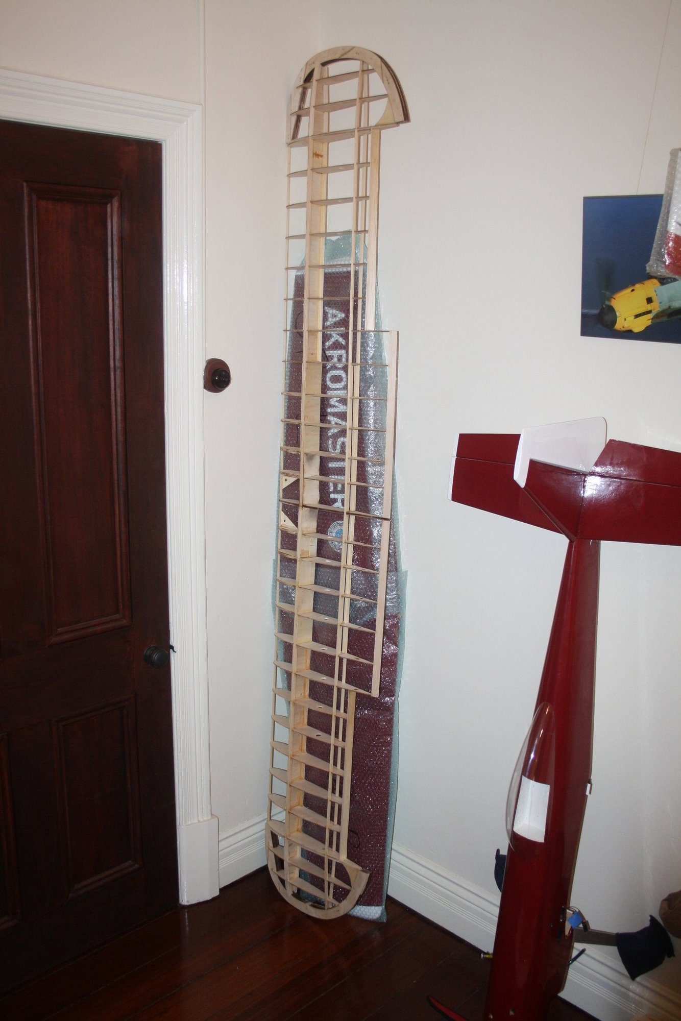

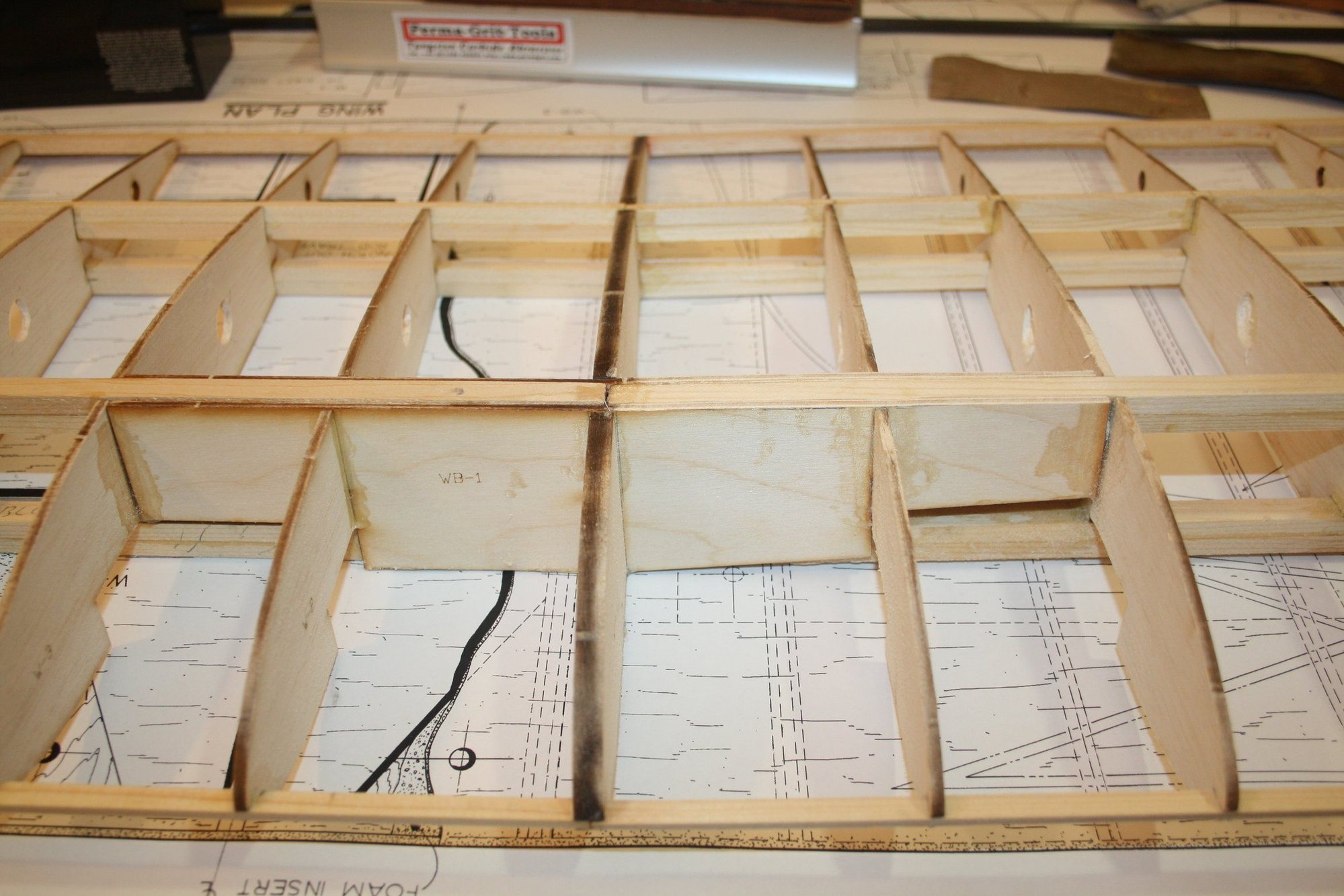

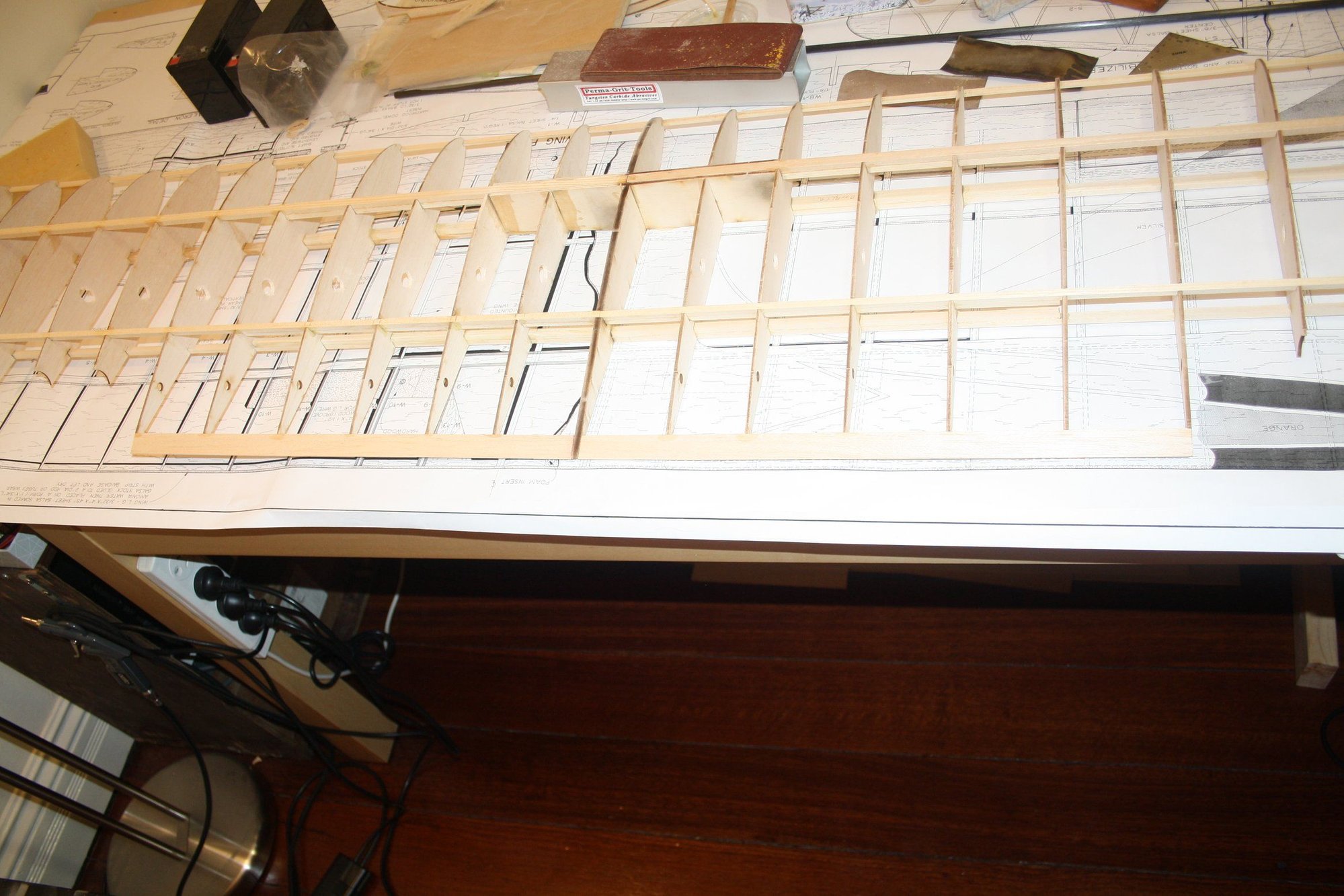

Keep chipping at the work required on the wing.
I started work on the second wing-tip, gluing the pairs of balsa laser cut parts.
I also completed the main spar shear web on one side of the wing and the plywood shear web (3 bays following the dihedral brace) on the other side.
Cheers,
Eran
Cheers,
Eran

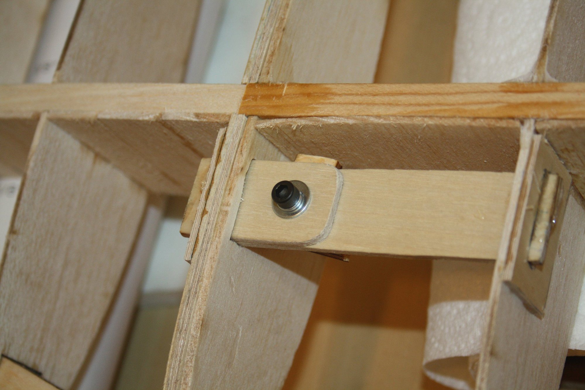

Today I only got couple of lock-nuts into place for the wing-tips retention. It allowed me to see the full size wing for the first time. It is a long wing...
