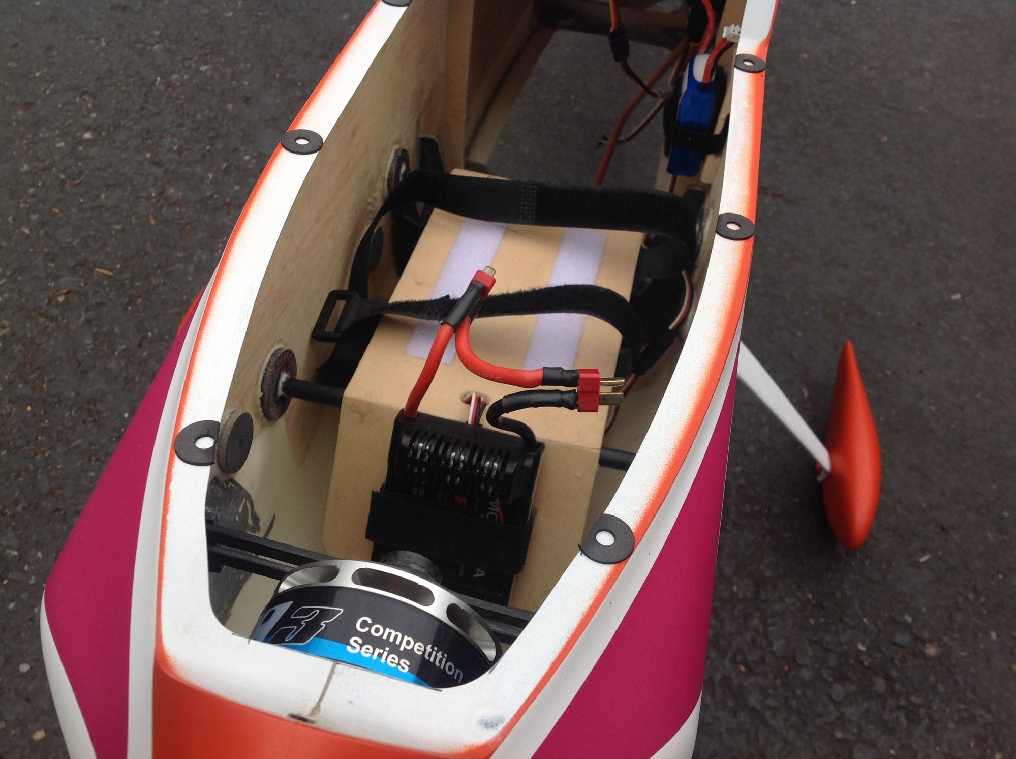

Speaking of cooling, I recently acquired a short kit for a Sopwith Baby. The designer one Brian Downham, won the Scottish Scale Nationals with it back in the 60s. It is a very British design and if you read on you will know why.

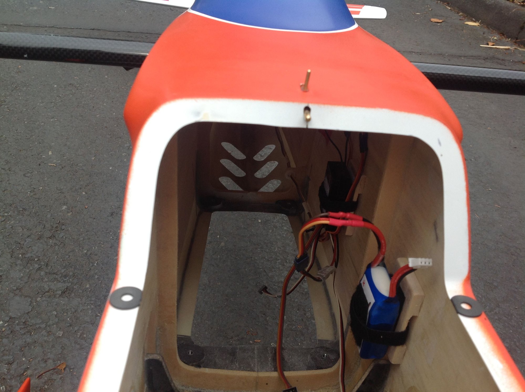

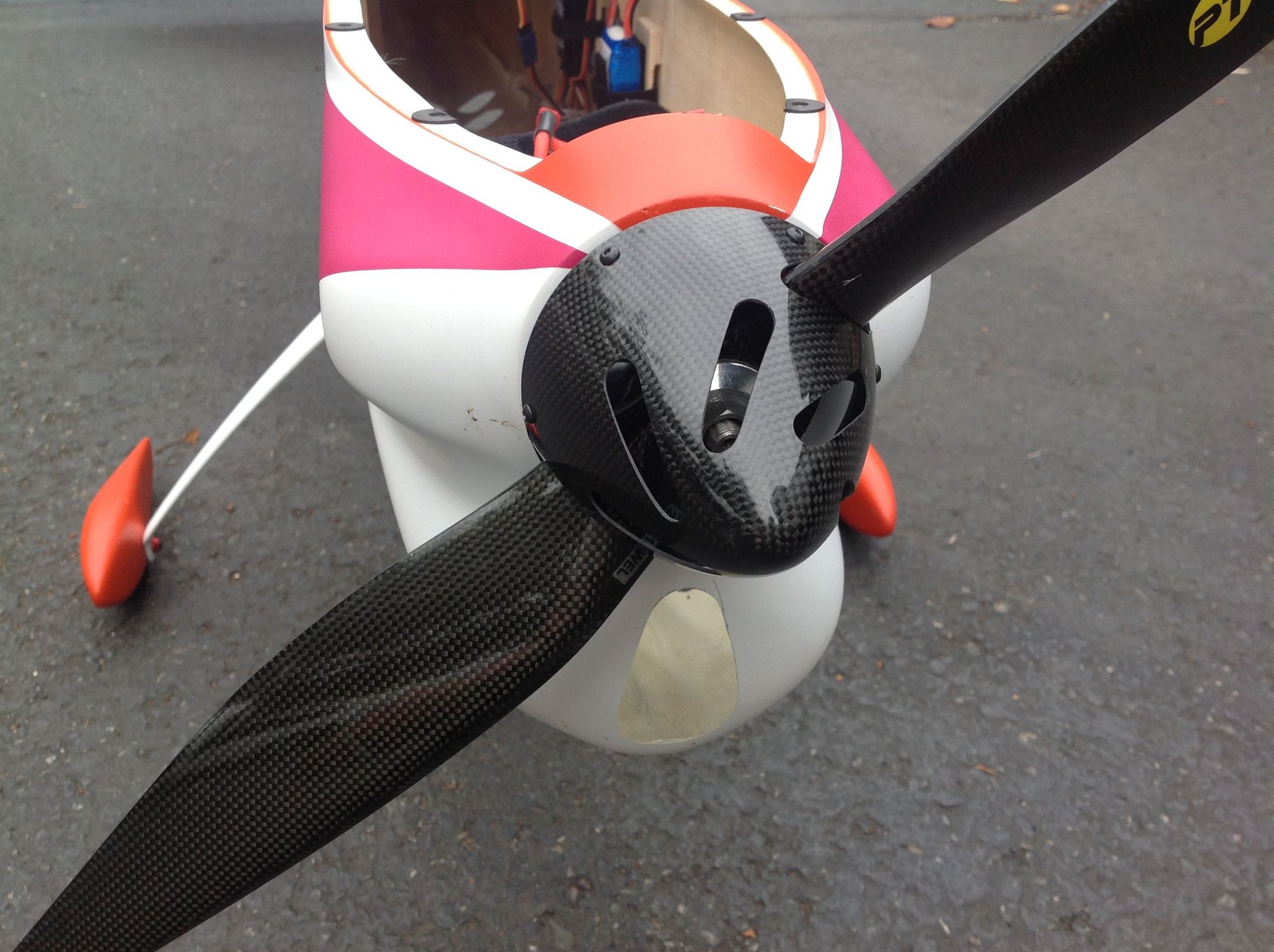

Cooling air intake below the spinner, slotted spinner lets airflow get directly to the motor ( Gator R/C has low cost options for slotted spinners )
Battery/ESC tray. ESC gets direct air from intake and angled mount directs it up to batteries
Exit holes just behind the lower wing. The fuselage shape creates a low pressure area that helps draw warm air out of the fuselage.
One of the more interesting features is a cooling tunnel going from the firewall back and down to exit out the bottom of the fuselage. The tunnel is 1/32" plywood fuel proofed on the inside. I'm planning on using a Saito .82 to power her. For those of you unfamiliar with the Sopwith Baby it is a float plane with the floats. The design has a dolly with wheels for take off. The are NOT water proof and the landing is made in grass allowing the floats to glide over the grass. I may permanently attach the wheels to the floats and do away with the dolly.
IIRC, the Baby was built for use with the aircraft carrier Argus. The planes were launched using the dolly, which stayed on the ship and was caught at the front of the flight deck. The planes were landed on the water (hence the floats) as the British hadn't figured out how to land on the ship, something that wouldn't happen until after WWI was over, again IIRC
As far as the wheels, have you considered enclosing a pair inside each float in tandem? That would preserve the look and still make it so it could roll. The only catch is the rear wheel would need to be at the back of the float so you could land it with a normal nose high flair if need be
Would I be correct in the assumption that the radio is in the box under the battery pack ?
The receiver is a bit farther in the fuselage on the right side of the picture. You can just make out the twin antenna.

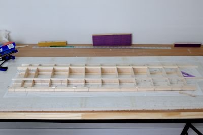

So , I think it would be good to let you know what I have and have plans for.
Today was a great day at the lhs. While picking up some epoxy I saw they had the eflite 46 in stock so I picked it up. Also they had some hitech 425's, however they only had 3, so I picked those up along with a 322.
What made the trip even better was, I actually met a guy from a flying club that is about 20 to 30 minutes from my home. He was able to let me know that they are still out during these times and they instructors. I let him know as I get closer to completing the build, I will give them a call !
My next purchase is the esc which will be the 60amp eflite.
I have had experience with the onyx brand of batteries for my rc cars, so I will be sticking with them. This is my battery of choice https://www.horizonhobby.com/product...P32004S30.html
So for props I will mainly be looking for torque and long flight time over high speed. I still have to do more reading on electrics before I purchase a battery, prop and maybe even the esc.

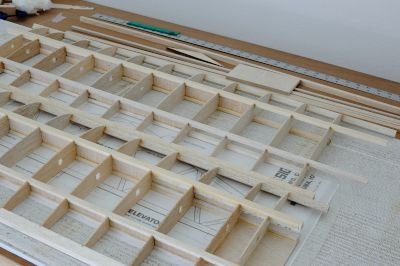

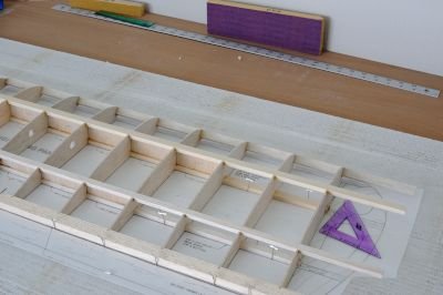

So I have gotten up to the point where I have the right wing the at the same point as the left wing.

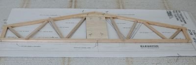

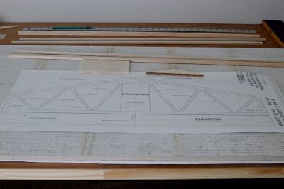

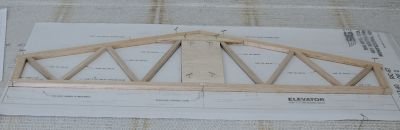

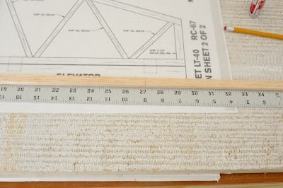

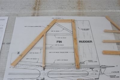

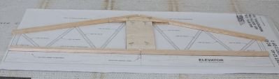

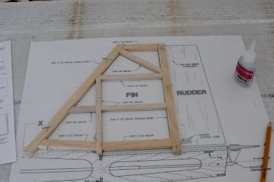

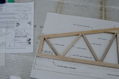

I have also done the part of the tail feathers. I am awaiting until I have all major components together, to sand and slot for hinges.
Here are a few pics of the process.
I now get to start on the fuselage, stay tuned!
Setting up for stabilizer build.
Cutting a little long to be able to file down.
cutting a little long actually ended up the correct size.
Cutting long again to file down.
All glued together
Small mishap in gluing, even though i was using extra thick ca, it set before I could get it into place.
All pieces to the to fin cut extra long to fit as I go.
Everything glued together.

Making a second wing is actually easy. Here are all the steps you will need to do:
1) Trace out a rib on to a couple of pieces of plywood or plastic, cut them out and sand to finished shape. These will be your patterns for the actual ribs
2) Sandwich the appropriate number of pieces of balsa in between the previously made patterns and rough cut the stack to the general shape, leaving them oversized for now
3) Sand everything down to the size and shape of the patterns. This will give you your wing's shape and should match the original factory cut parts
4) Cut out the spar slots and any other recesses for the structure and you're done. Obviously, if some of the ribs have additional cut outs(these being where wing joiners are located or where the spars are doubled), you will need to make these modifications after taking the stack apart. Alternately, you can make a second set of patterns with these modifications already made and make them in a separate stack
To built your second wing, including barn door ailerons, you follow the directions as before EXCEPT for the following changes:
1) Do not glue in in inner most rib until the the rest of the bottom structure is compete. Raise the wingtip to the desired height and, using a 90* square for alignment, install the center rib. This will give you the desired dihedral when the wing is complete
2) You will need to replace the sheer webs between the rear spars with thicker material at any location you plan on installing hinges. I would use the same material as the spars, laminating it to the upper and lower spar in the bays the ailerons will be. If you want the aileron to be larger(go deeper into the wing) you can move the spar forward by cutting new slots at the desired depth and install the spars at that location, only where the ailerons will be. Leave the rear spar in it's original location through the rest of the wing. You can use a thicker rib at the location of the inboard end of the aileron, if you wish, for additional strength if you move the spar. Since the original wing has strip ailerons, you probably won't need to move the spar, just giving you the option if you wish to do so.
3) When the wing bottom is completed, add another partial rib to both ends of the aileron, glued only to the trailing edge. Be sure to leave a gap between the aileron end ribs and the wing ribs as you will need room for the covering that will go on later. At this point, you can glue the strip that was originally the aileron to the rear of the wing, rather than install the hinges and torque rods used in the plans.
4) Cut the trailing edge of the wing and all ribs as close to the rear spar and wing ribs as possible to remove the ailerons. Sand the areas cut flush to the wing structure and install the top sheeting AFTER installing your aileron servos and wiring
5) Determine how you want the aileron leading edge to be shaped and shape as desired. Be sure you have enough material to support the hinges and control horns as you don't want them to pull out and cause the plane to crash
6) Add the top sheeting and sand ends flush. All that is left is to slot/drill the hinge locations, cover the wing and ailerons and install the ailerons and the wing is done. It's actually harder to explain it than it is to do it, if that makes sense
