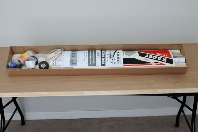

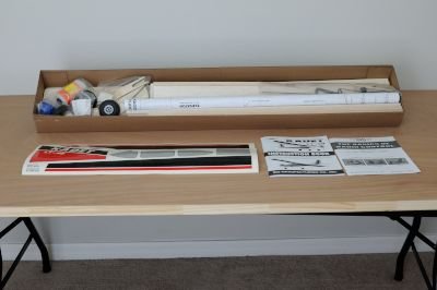

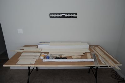

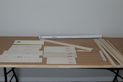

So the first thing I had to do is get some building supplies starting with a table and a hollow core door from lowes.
Next comes the unboxing of the plane. There is a lot of wood in here. Next comes a small unboxing of items.
Love the fact that it comes with rolled plans, along with many accessories like the wheels, nose cone and a gas tank(which I won't need for this build).
unboxing
First look
Many pieces, I can;t wait!

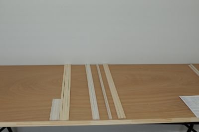

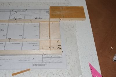

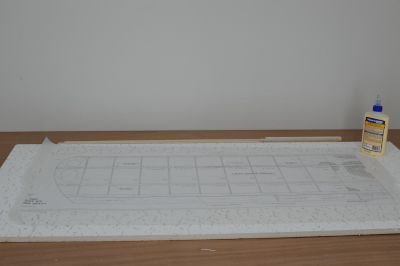

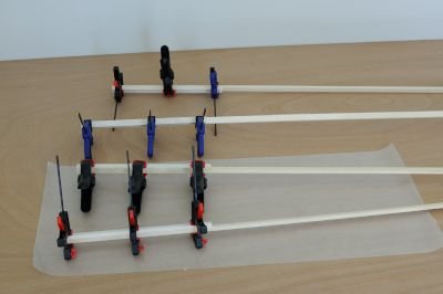

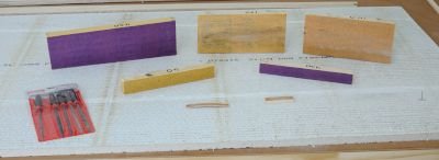

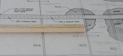

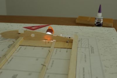

So now we get to building. When I first opened the box and saw of the sticks included, I thought how I am ever going to figure out what stick goes where.
After putting all the sticks together I found that it was easy to see the differences and was able to check them off the inventory list.
So I have my sticks separated in the first pic. I have glued my front spars and spar doublers together.

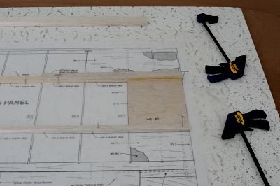

Next you will see I have pinned down the left wing panel plan.
Next I have glued my balsa doublers to the hardwood spars. First two were a little off, but by the 3rd and 4th I had them pretty straight.
I have pinned down my spars and glued some sheeting to them along with the trailing edge. I am ready to start installing my ribs, but I need to drill my holes for my two servo wires.
My first question is how far out should I put my servo's? I am thinking around the middle. So that would be about bay six from the inside of the wing. That gives me five bays on either side of the servo.

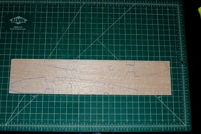

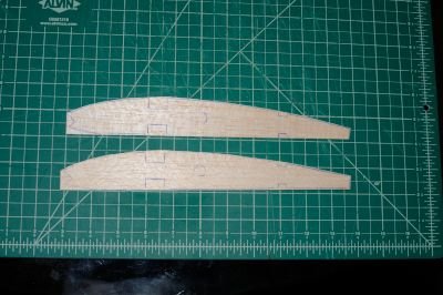

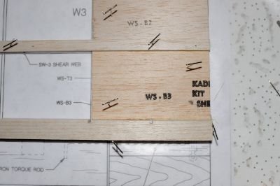

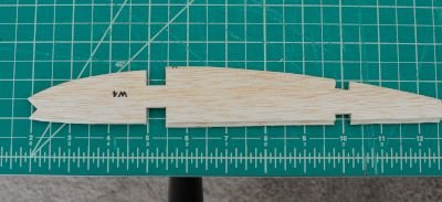

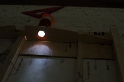

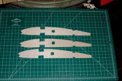

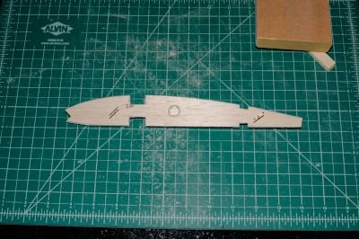

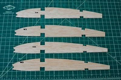

So the first problem I have run into is that ribs 3 & 4 have some issues.
After further investigation, I found that one w3 rib and one w4 rib were cross labeled. Check out the pictures.
Next I split 2 w5 ribs while drilling a whole in them, I happen to have some 3/32 balsa on hand. So I created 2 new ribs.
For some reasons I didn't create any pictures of this.
However the next issue I had was w2 was off. I attempted to try and correct this with filing, but I felt like I was doing more damage than good.
So created 2 new W2 ribs.
Here you can see the 2 w4's don't line up.
Hopefully a better pic of the issue.
the light shows where the problem with the rib.
Tracing the original W2
First cut
Sanding ribs to size
My First rib installed.

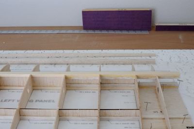

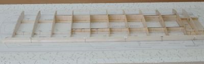

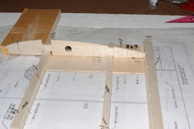

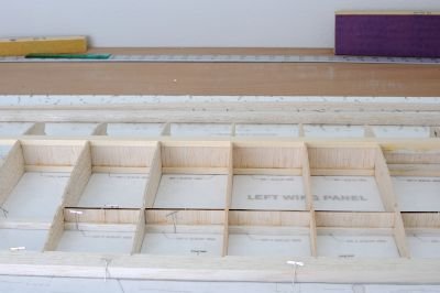

Next you can see I have installed rib 4, which is technically rib 3. Its now time to add some shear webs, so the next pic shows me labeling the shear webs.
Following that I have now continue to add ribs and shear webs.
Looks like I drilled one rib too many. I plan to have the wing servo in the bay that shows the word Left in the pic.
Ribs went in without event so am getting closer to finishing the left panel.
The rest of pics show the rest of progress up to the wing tip. I will be holding off on installing rib W1, until I complete the second wing panel.
I will be starting on it shortly.

Something that may not be in the instructions is that die cut parts are never perfect. First think you should do is put a straight edge on all edges that should be straight. If they are off, sand them lightly with a straight sanding block. When you have multiples, like the wing ribs, put pieces of stick stock in the spar slots to keep them even, tape the edges that won't be sanded to keep the parts together and sand the straight edge. This will eliminate the gaps that show up. If you can find them, Great Planes had an 11 and 20+ inch aluminum sanding blocks that used adhesive sand paper. They work great for this kind of touch up as well as smoothing the outside of the fuse and wings before covering.
As for the servos and where to locate them, the middle of the aileron is going to be your best bet. Word of caution, don't skimp on your radio gear. This is one area that you are better with a bit of overkill than having "just enough". Personally, I use all Futaba as it's always worked well for me. What brand you use is up to you but don't go with an radio and servos because they are "cheap". I'm sure you've heard the saying, "You get what you pay for". Last thing you want, when flying your plane, is to have a cheap, off brand servo to fail. There's nothing worse than watching your model crash due to losing control due to a cheap servo.
Something else you may want to consider is using heavy duty servo extensions rather than standard ones. Not sure how much you know about electricity and wiring but a heavy duty extension uses larger wires. A larger wire can handle more power and has less resistance than a smaller one making it a better for carrying the power and control signals to the servos over a longer distance due to less loss from the resistance of the wires. I know some will say it doesn't matter but, to me anyway, piece of mind is worth the extra cost.

The pic I was talking about you labeled "my first rib installed". It may just be the photo. Your work looks really good.
David

Hey David, Thanks again for checking in on the build. I think the gap in front and rear of the spar are for the 2 madb's that are added when the wing is joined. Here is a close up pic, Let me know what you think and please keep the advice coming.

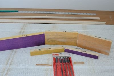

I found other options for sanding blocks:Unlike the Great Planes version, the Fiberglast aren't as long but, in their favor is you don't have to periodically change sand paperThere are others on the market as well, just a matter of finding one you like and works for you

For wing building I have a 33" and a 44" Great Planes sanding bars. I know the GP bars aren't available new anymore but you might check a local metal supplier for "T" shaped aluminum extrusions. These can be cut to any length and make great sanding bars, I have some of those too. If the handle is too thin for your liking you can epoxy wood to each side of the center post. The self-adhesive sandpaper can be purchased buy the roll on Amazon or you can use 3M No. 77 spray adhesive with any sandpaper. The 2 1/2" and 2 3/4" are the easiest to find and can be cut to the correct width with a utility knife after applying.

As far as the sanding tools go, you could also stop by an auto body repair supply shop and see what they carry. I found at a local one in my area sanding sponges that are great for sanding curved surfaces. They also are a great source of light weight fillers and solvents, even better than box stores like Lowes, Home Depot or Menards, not to mention less expensive since you can buy once and have for years or, at least until you hit the shelf life limit

Currently I am using a 1x4 cut up into pieces and I ca'd sandpaper to it. Duh, I didn't even remember I actually have a can of 3m 77, I could have reused the same piece of wood. Here are a couple of pics of what I am currently using.
Since I am having a lot of fun building this, I am sure I will continue at the least building so I will be checking out some more permanent sanding options.
