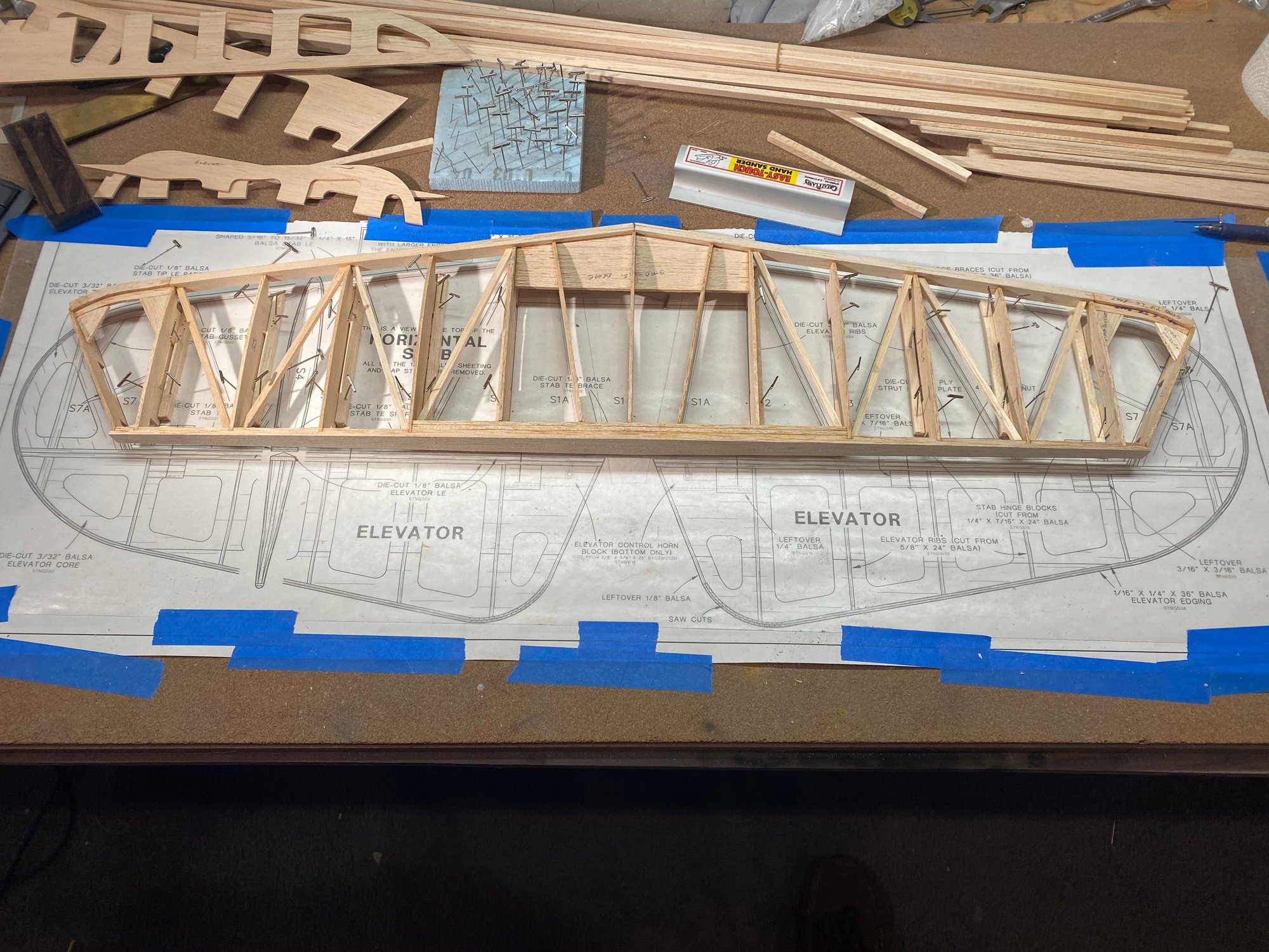

The stab is framed. I will let it dry overnight and install the hinge blocks in the morning then sheet it.

The stab is complete and rough sanded. Going to start building the elevators.

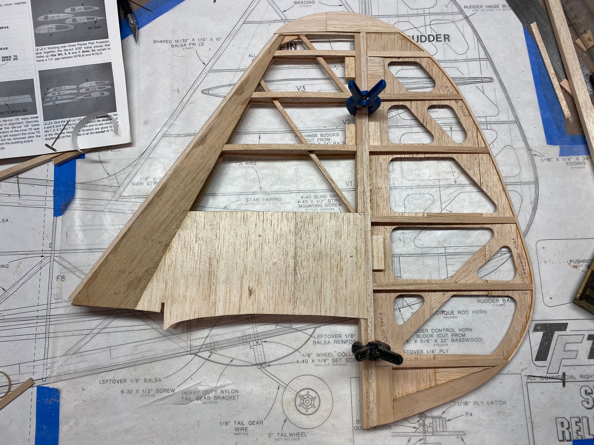

The stab and elevators are rough sanded. They turned out nice. I will start working on the fin and rudder tomorrow.

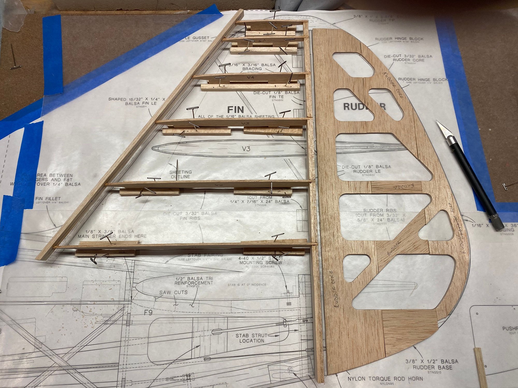

The fin and rudder are finished. I just need to add some hinge blocks to the rudder and give it a sanding.

The fin and rudder are rough sanded and edges shaped. I will have to wait until the fuselage is built to shape the bottom edge of the rudder.

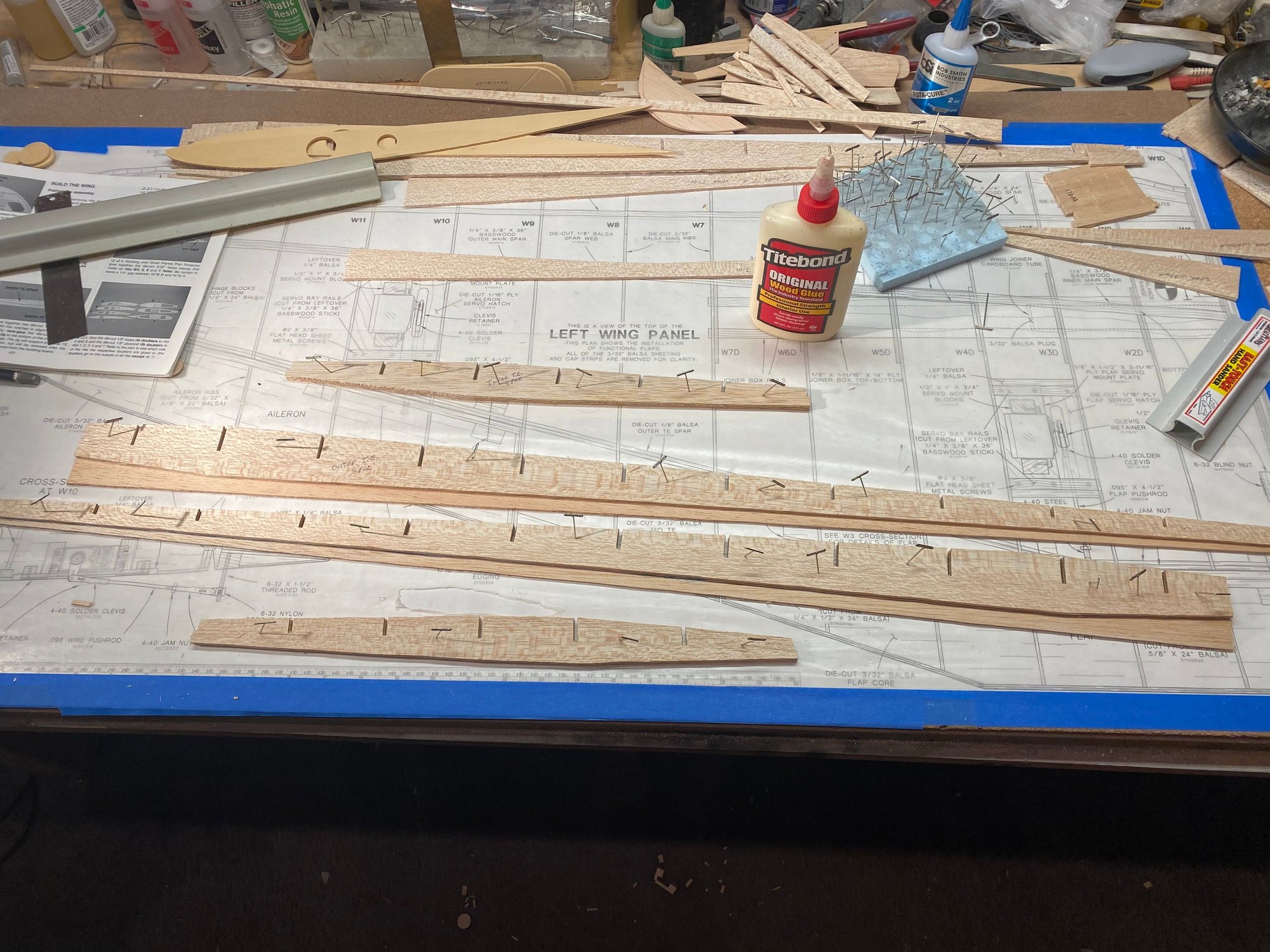

Started working on the wings. The T/E Spars are made up of die cut 1/8Ē balsa laminations. I used Titebond for the laminations.

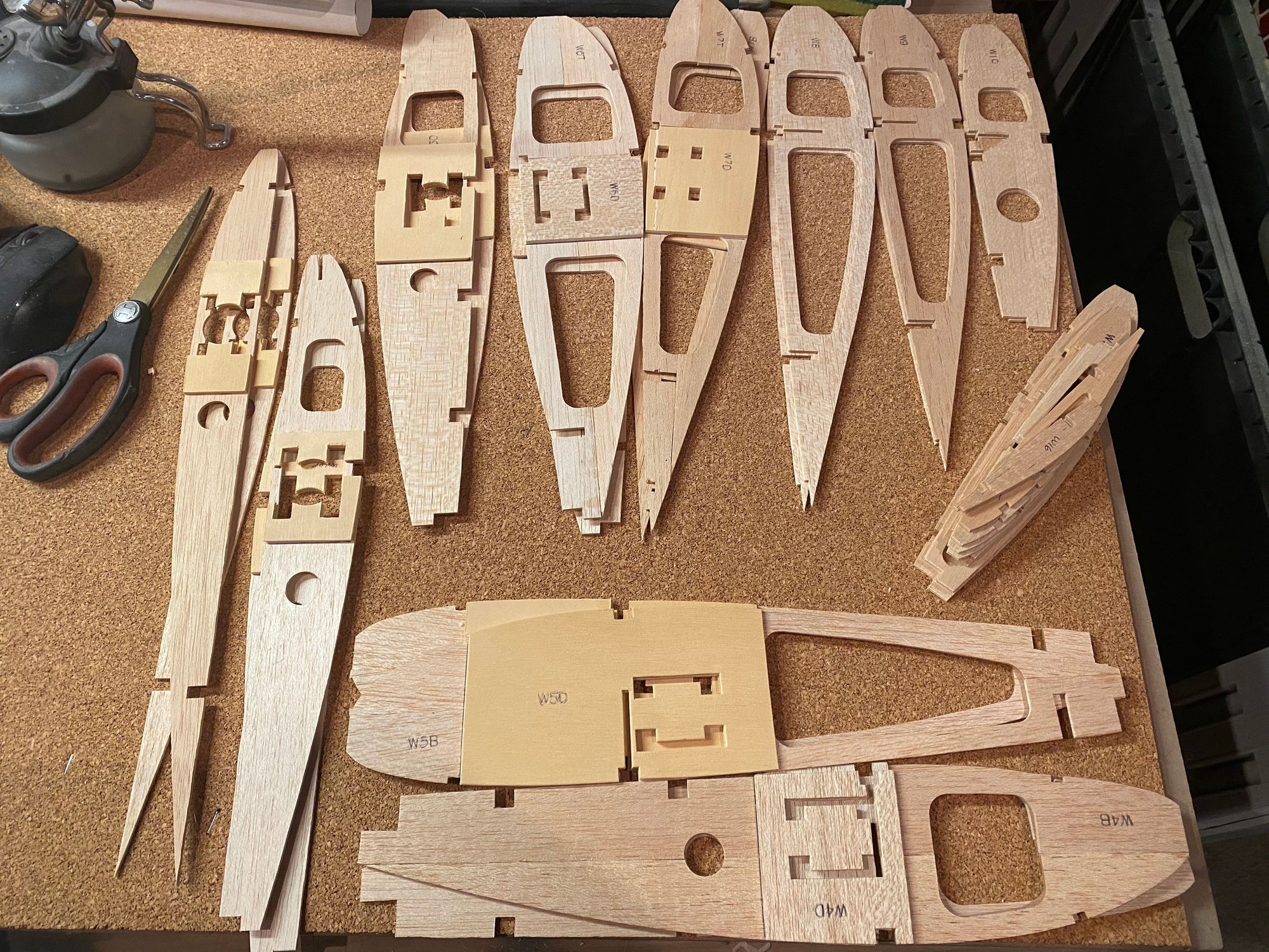

All of the ribs have been removed from their sheets and cleaned up the spar notches. Quite a few of the ribs have balsa and ply doublers. They have all been glued into place. This evening I will start framing up the first panel once the spars are dry.

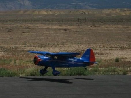

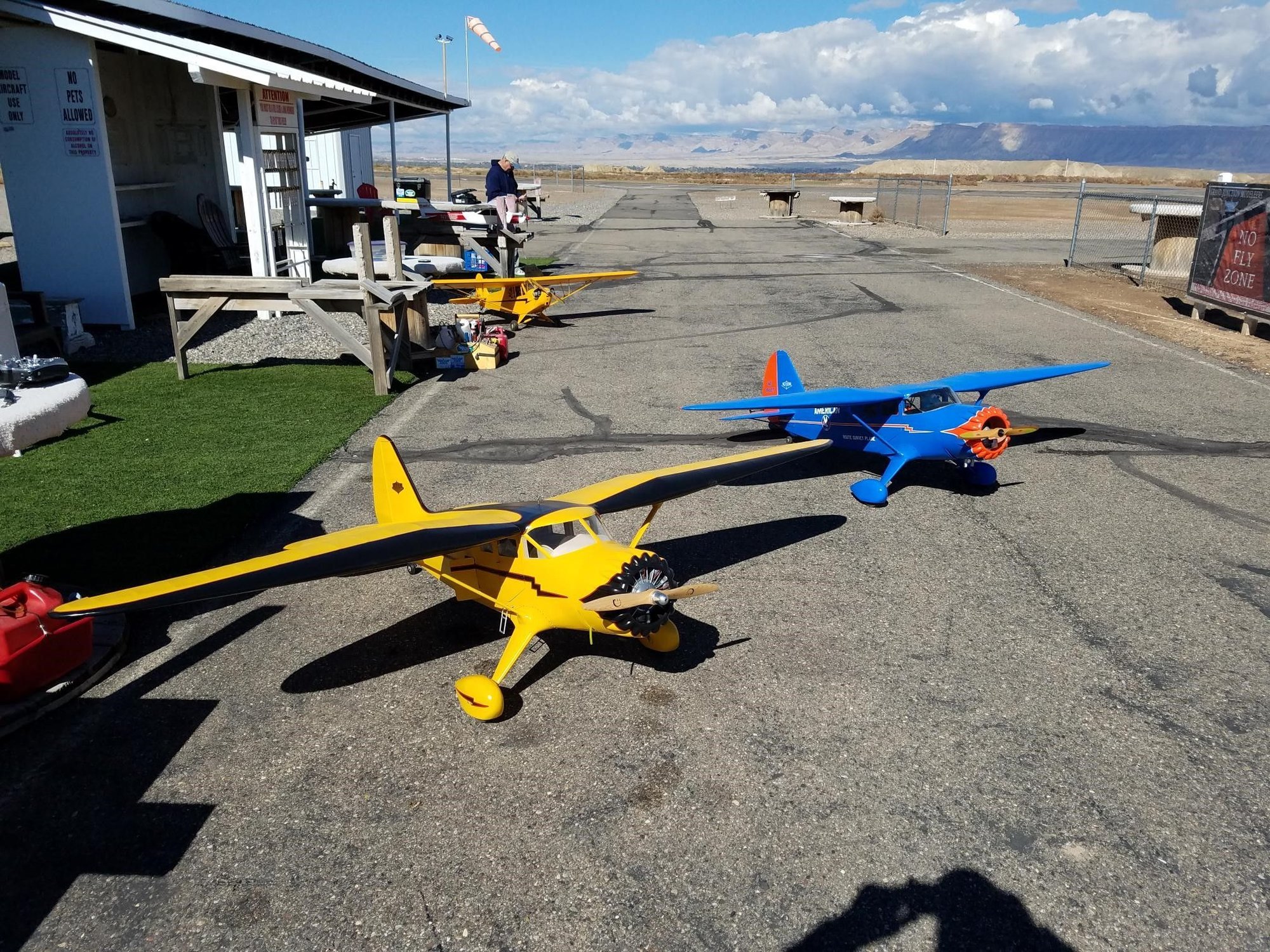

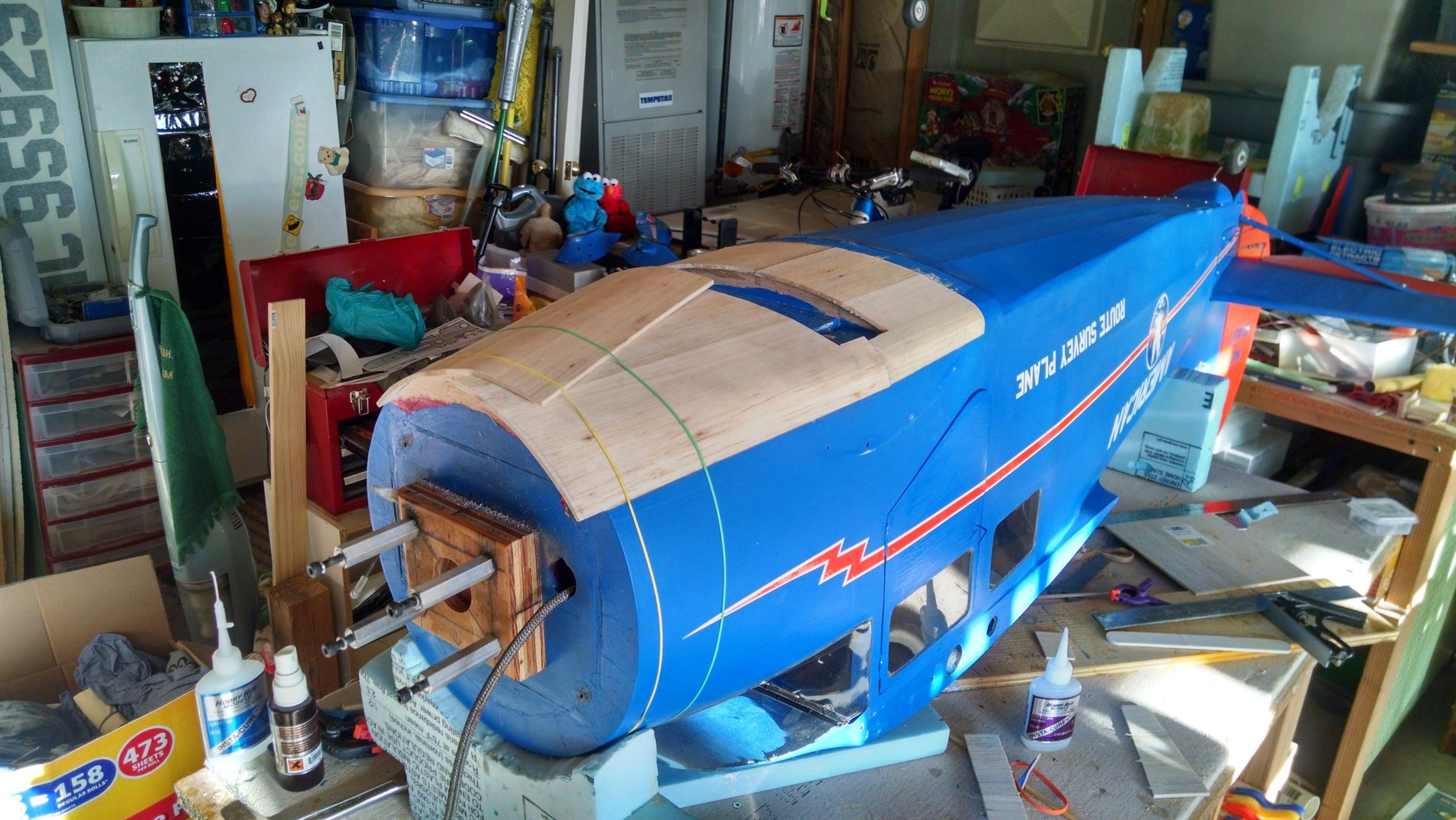

looks good, I built mine in 2012, flies great with OS GT33, weighs 21 lbs
maiden flight landing was good
My blue Stinson and another club members,(his is prettier than mine)Yellow plane has Fiberglass specialties cowl and pants.
covered with Sig coverall and dope. I did the easy to build 20+ piece cowl. I have knocked the landing gear off twice on dead stick landings so it is reinforced from what this picture shows, also removable.

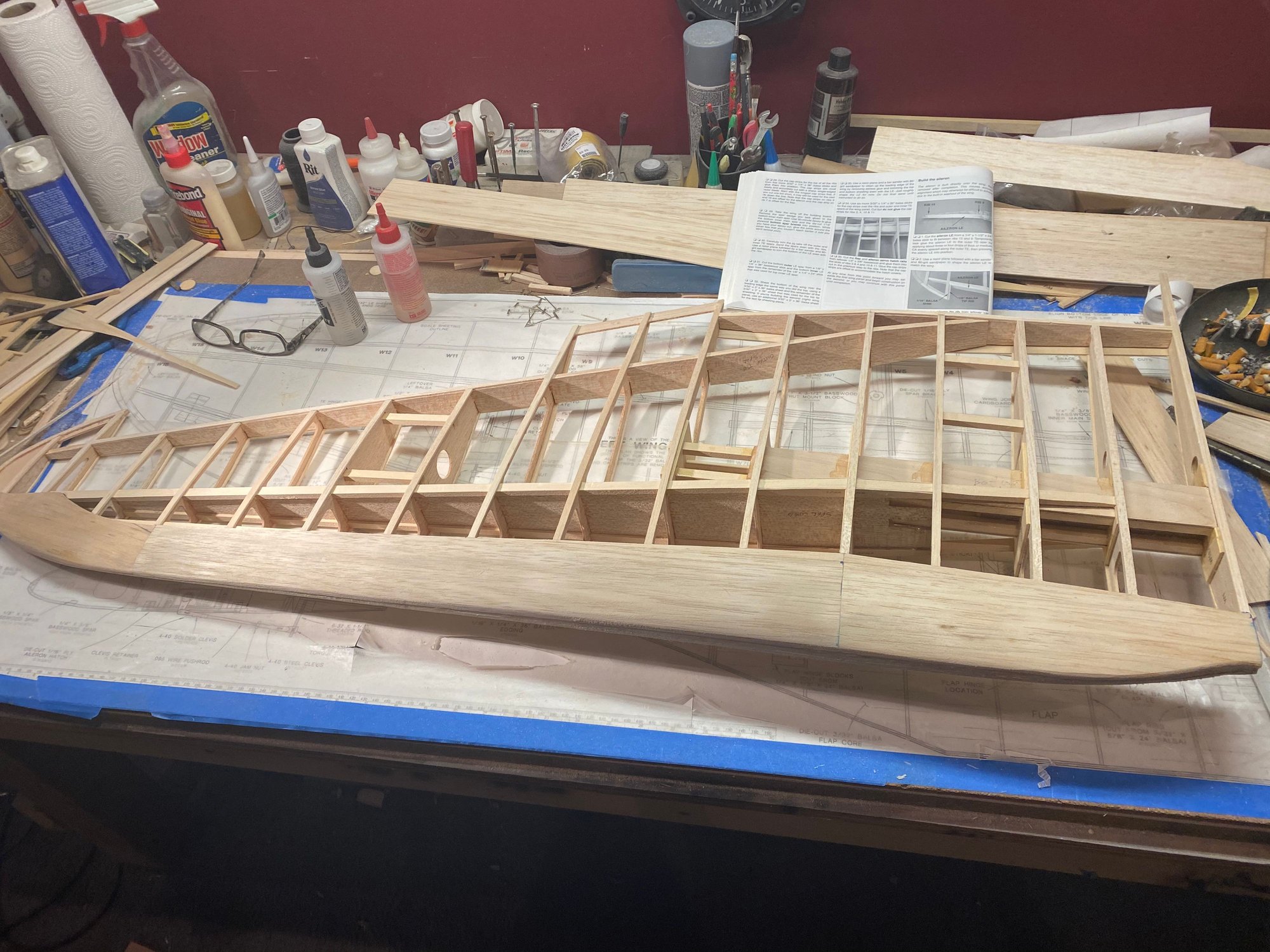

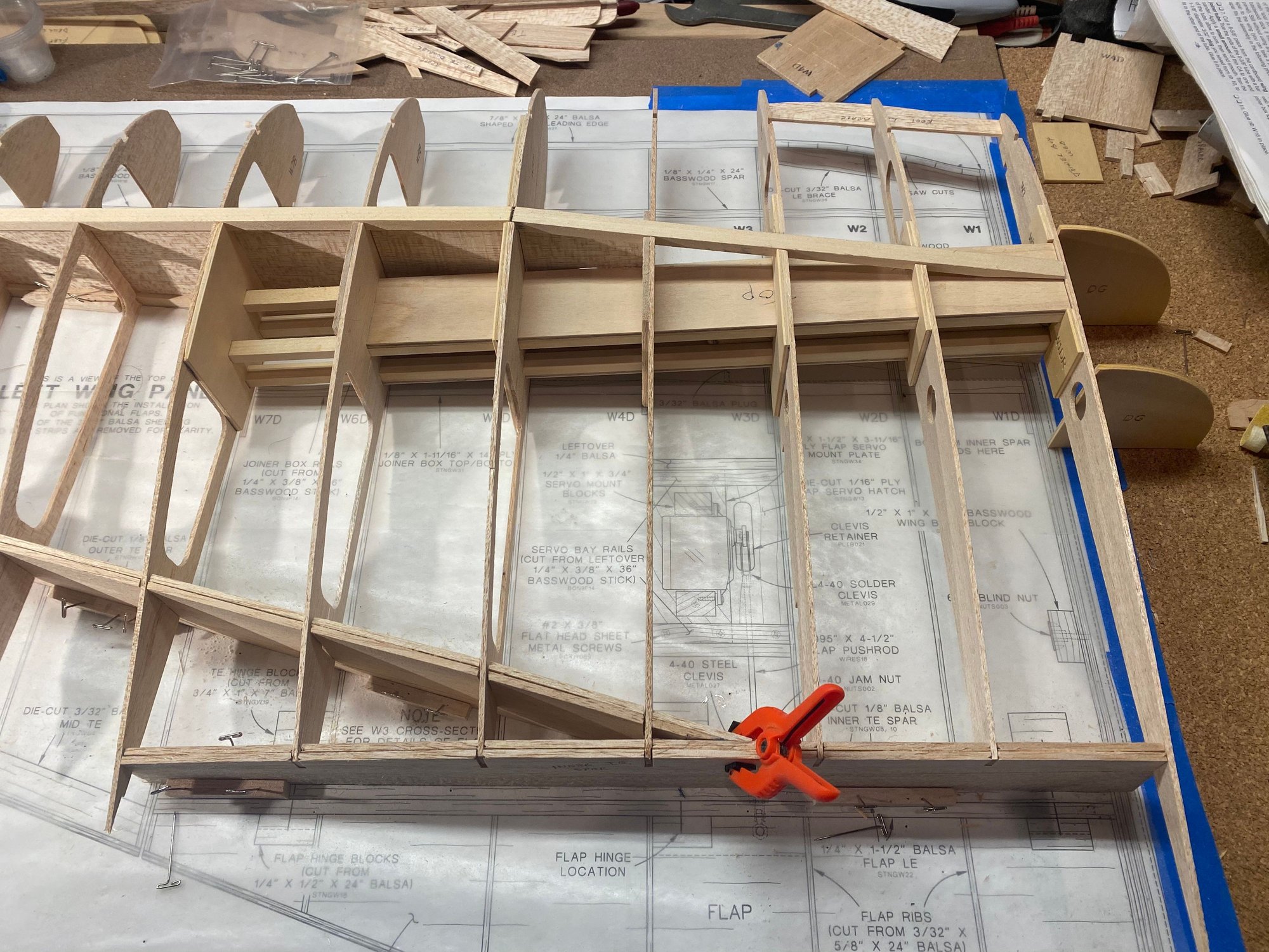

I have the basic layout of the left wing fitted and ready to glue. It takes a lot of work to fit the top and bottom joiner box. I think I am happy with the fit and alignment. Just to be sure I am going to take about an hour break then come back and go over everything one more time before adding glue.

Finally feels like I am making progress. The left wing is framed. I will let the epoxy cure in the spar braces then turn the panel around and sheet the L/E.

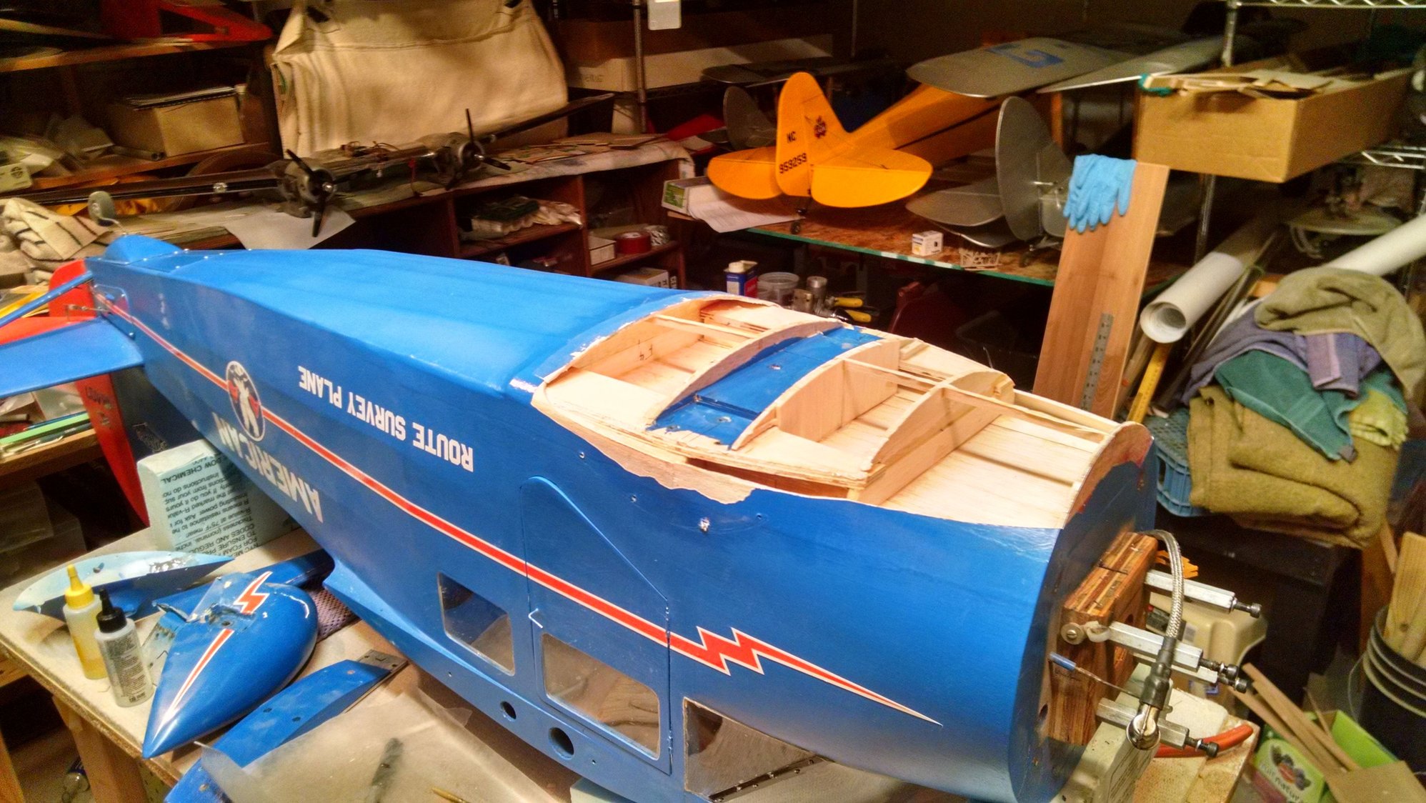

My friend with the yellow Stinson used the TNT gear, mine just has the stock landing gear, after ripping it off the first time I went back in and added additional reinforcement to the mounting area. I think that the manual shows 2 different ways to reinforce, I have incorporated both as well as making the gear removable for repairs.
here are some pictures of my 2nd repair after dead sticking in the rough.
gear and sheeting knocked off on landing
structure fixed and sheeting being fixed. cutout is where gear and filler block will go
re assembled with new plastic. (plastic was free from friends who used fiberglass parts)

Nice repair. I plan if reinforcing the gear mount area heavily. I will be covering with poly fiber lite uncertified fabric and painting with KlassKote epoxy paint. I donít want to have to repair that stuff.

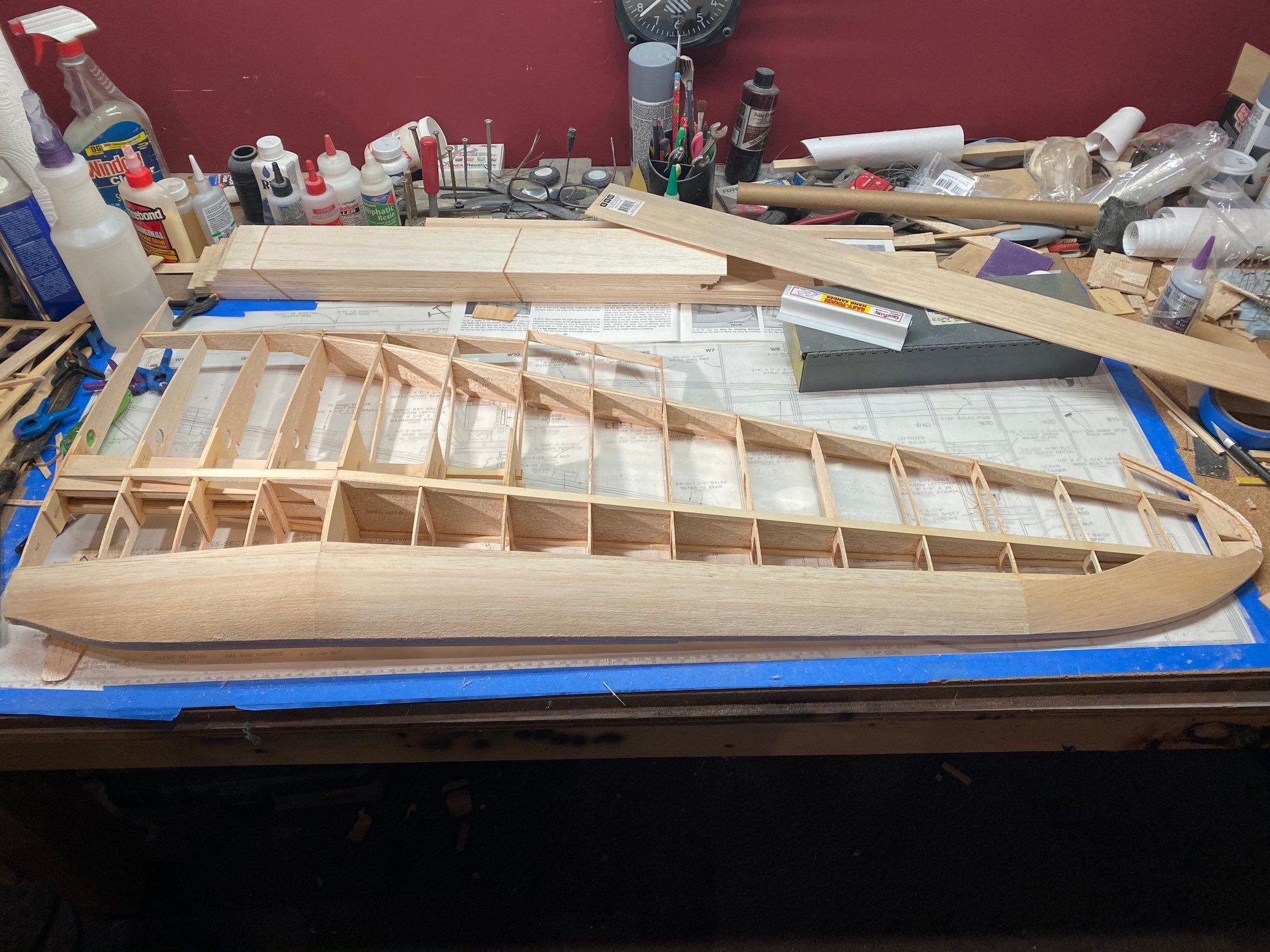

The wing panel is now stable. The top L/E sheeting is on and rough sanded. I will try to get this panel finished up this week and start the other panel next weekend.

The top of the panel has the T/E sheeting and cap strips applied. Tomorrow morning I will work on the sheeting on the bottom.

The bottom of the left wing panel is sheeted and capped. I gave it a rough sanding and itís looking good. I will set this panel aside and start the right wing. I will build the flaps and ailerons once both panels are built.
