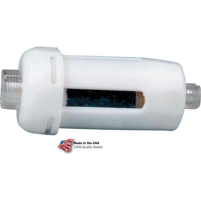

No matter what compressor or paint gun you use, an inline desiccant filter is helpful. I usually mount mine on the inlet of the paint gun. It catches any moisture or debris that may be present in the hose. One thing that hasn't been talked about much is how and where to set up the compressor. A big compressor and tank is nice but they take up space and you need to be able to get to the tank easily. A good quality compressor will have a drain on the bottom of the tank. Even in a relatively dry climate moisture will condense on the interior of the tank and must be drained both to preserve the tank and to prevent contamination. A good quality regulator is also helpful. The regulator that comes with many compressors may be just fine for airing up tires but may not be accurate or consistent enough for a paint gun.
And ... a simple regulator may not flow enough CFM of air for many modern guns. The same goes for airlines. Small lines often can't supply enough airflow. I highly recommend the turbine compressors if you are using a gun than can take advantage of one. These are tankless for the most part and some don't require a regulator. Many of these are sold as "spray systems" and operate at quite high CFM of airflow at very low pressure (true HVLP). An advantage is extremely low overspray (wasted paint). They put the paint on the surface rather than into the air and on the floor. Worth looking into if you are serious about painting.
