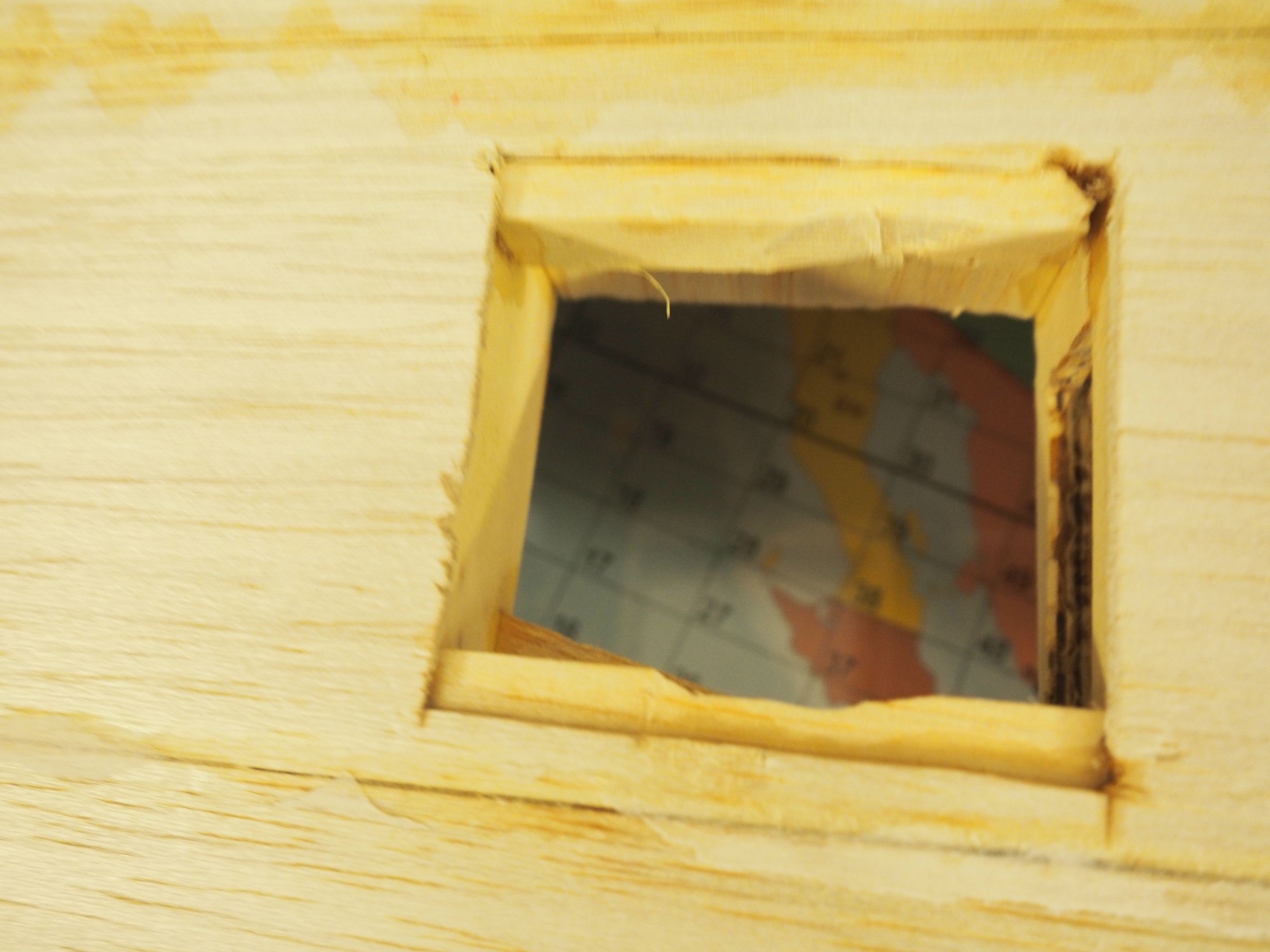

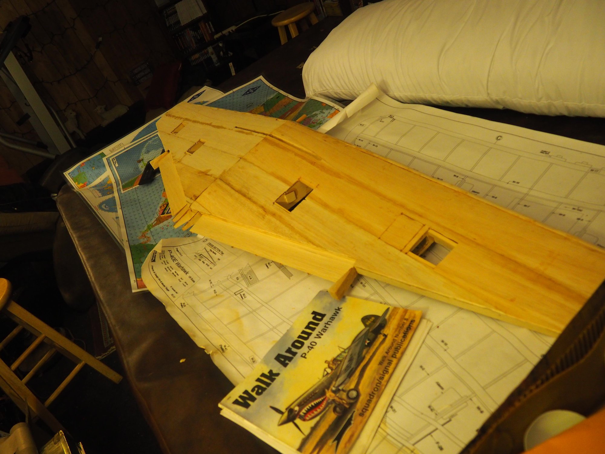

Default Bottom of wings sheeted
I have the bottom of the wings sheeted. I cut out the doors for servo access. I have ordered servo extensions and a receiver. I am going to wait until both are here and lay everything out so when I cut the servo slots for the ailerons and flaps , I will know exactly where to cut. I will post pics later.

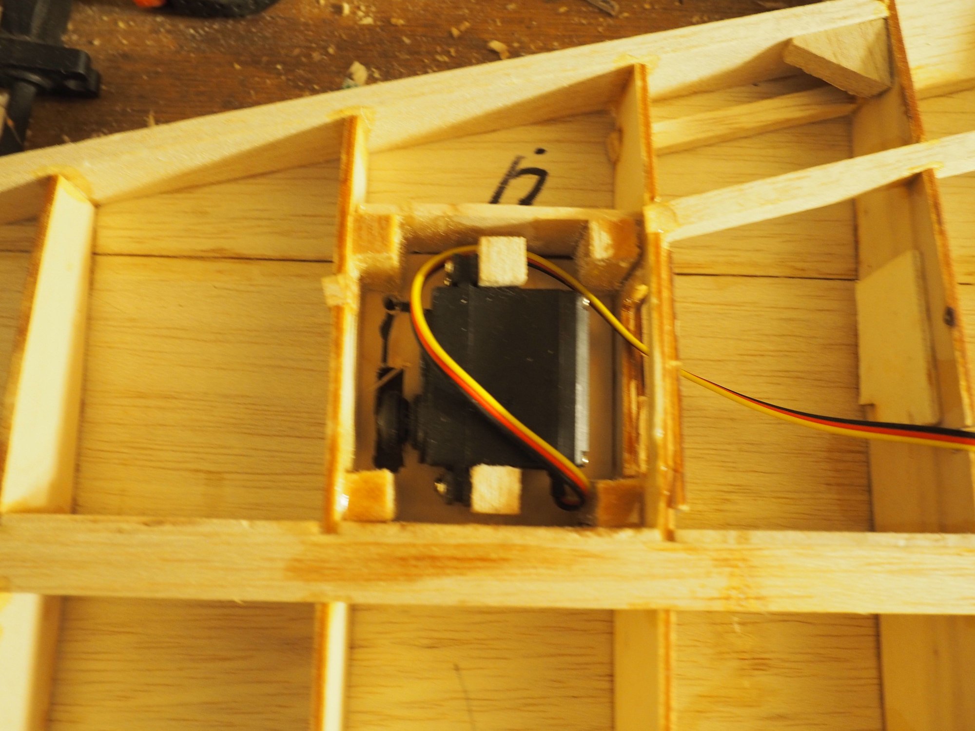

Default servo doors
Here are the doors for the servo access. I was going to mount the servos on the actual doors to be able to easily remove them if necessary. After careful consideration I thought it better to mount them in the "stock " locations in the wing ribs with reinforcements.-there will be a lot of torque on these unlike a 40 size sport plane or trainer. I can still take them out if necessary to replace the servos, replace or adjust the arms, or service the wires. Notice the extra balsa supports that I will use to secure the access doors to.

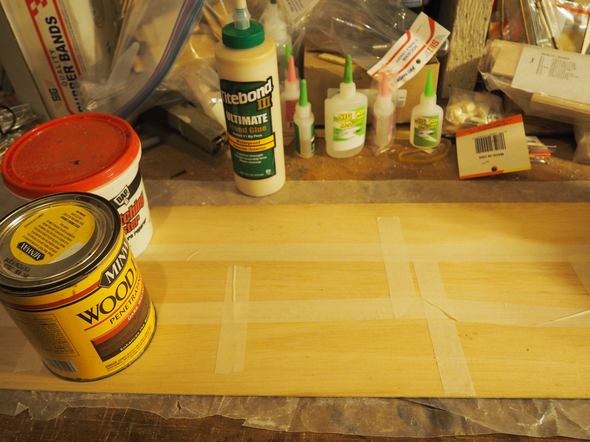

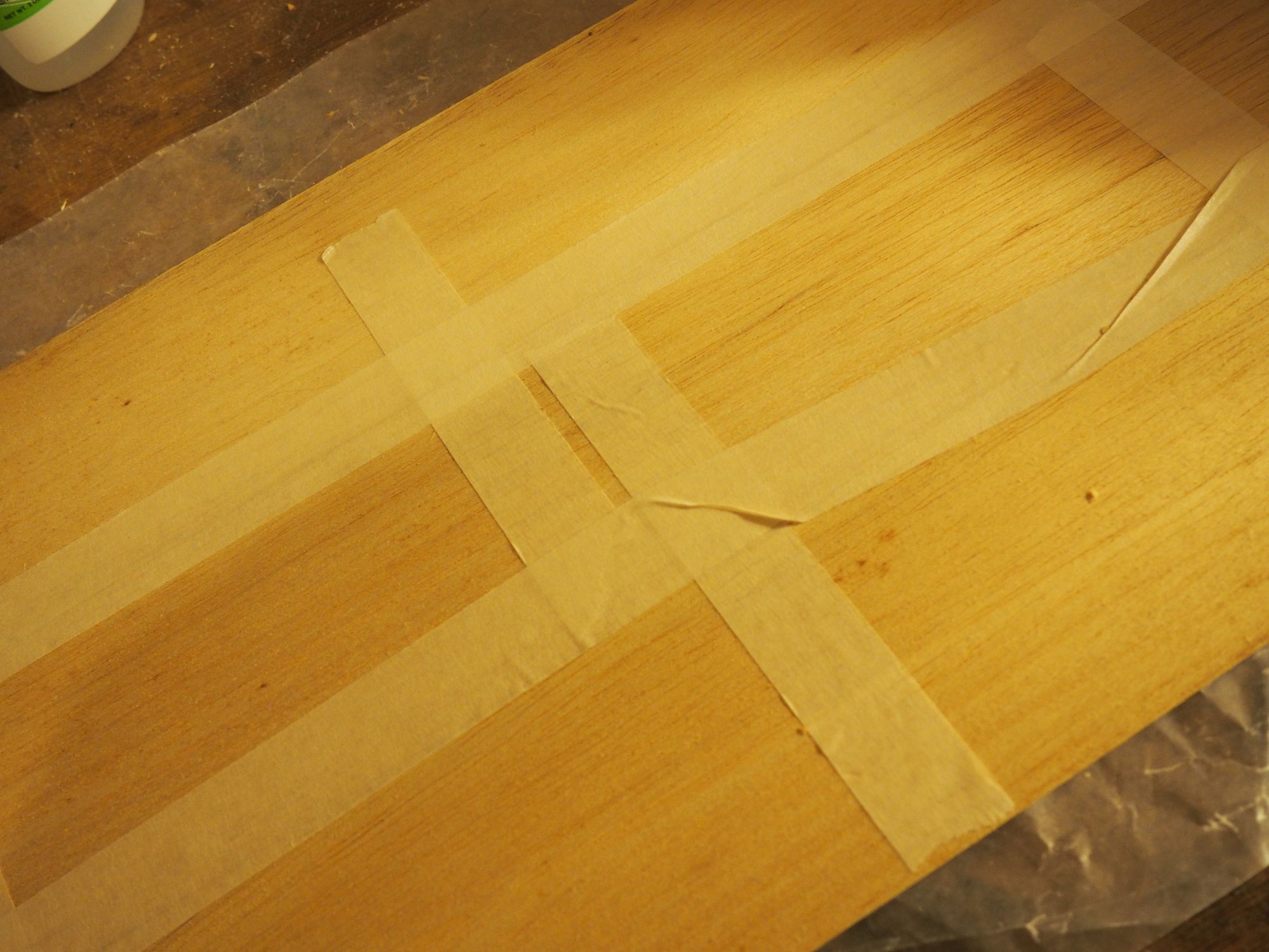

Default making the wing skins
first step is to make sure the individual sheets are straight and true. I then use masking tape to keep them that way. I also use masking tape to hold them together after glued. After gluing I take a wet washcloth over the area to pick up any excess glue. I then put them on top of a wax paper sheet so they won't stick to the building board. When in place I use weights to keep them that way.

Posts: 110
I accidentally cut one of the access doors on the wrong side of the rib! I was thinking TOO hard about that one! I also had to notch out a coup-le of the door supports to be able to get the servos in and out.

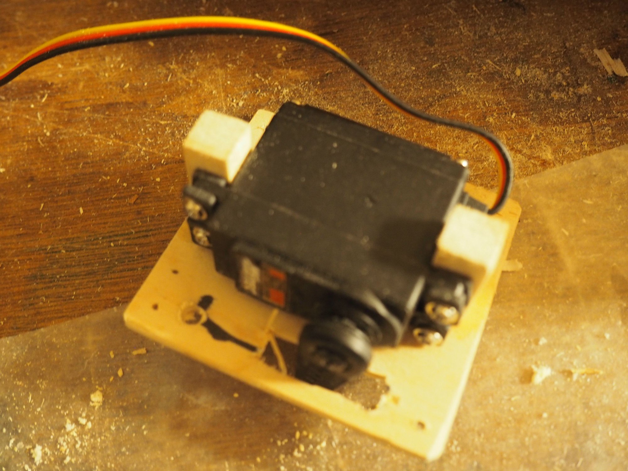

Default Servo mounting detail
I wasn't happy with my previous attempt at making a servo access door so I cleaned up the access points and went back to my first plan of mounting the servos on the doors. I used 1/8" ply for the doors and 3/8" basswood for the mounting points in the wing. I slotted the doors for the servo arms to come through.

Posts: 110
Default Servo door detail
I mounted the servos on 1/8" ply. I used 3/8" basswood for the mounting points in the wing.

Received 8 Likes on 7 Posts
I mounted servos the same way when adding ailerons to my Kadet senior. This is also the same mounting for the ailerons on a four star sixty.
