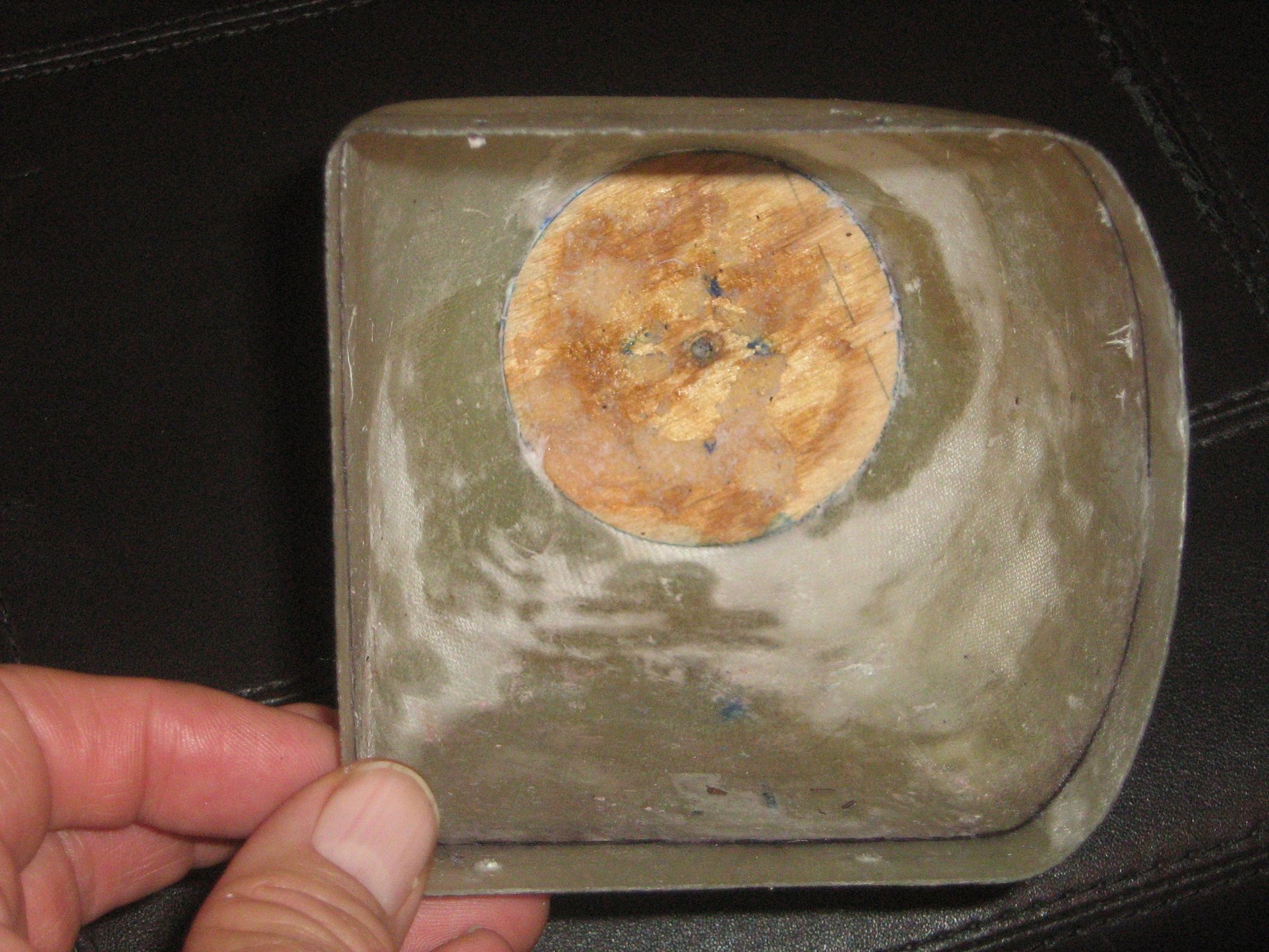

What kind of cowl are you planning on making? Wood or fiberglass? A wood cowl should not be a problem in cooler or even cold weather. But a glass, yeah you need some decent temps for the resin to properly cure.
On wooden cowls I always had some fiberglass to the inside for both structural stiffness and strength and also as a good fuel proofing layer.

The cowl will be glassed 100%. I'll make a plug out of stacked blue foam insulation and glass over that. Since this is a one off cowl I don't mind making my plug out of sacrificial material, and it's quick to shape so bonus. The roll of true red Ultracote arrived today so I'm getting a surge of motivation to get it covering ready.

The plane in my Avatar cowl is made the the way you are going to do yours. I just happened to have a bunch of pink foam, so I used that.

Haha yes! That's exactly what I'm planning to do for cowl construction. It's always worked and looks great every time. Should I get a bout of insanity I'll make wheel pants to match though they'll honestly be for maiden pictures and most likely be removed afterwards (by the grass)

I di one cowl where I used modeling clay for the mold. Wrapped a cling wrap around the engines (engine bolted onto the plane). Then I added the clay. It worked very well. All of the cut outs were already there as I just did not glass those. But man O man trying to get all of that clay out of the mold afterwards was a nightmare. Not sure I really did. Also getting the cowl off the first took hours and hours of digging out clay. Never again.

I ran across a build where foam was used with balsa formers in strategic locations for shape and glasses over. I almost went that route but last minute changed my mind in favor of sheeting. Once it's sanded and covered I think the ones I made will look the part good enough for 5' photos
I can see where a clay mold would be a nightmare to remove all the material once finished. Think I'll stick with foam if for nothing else ease of removal. The little bits that stay behind get dissolved with mineral spirits nicely.
