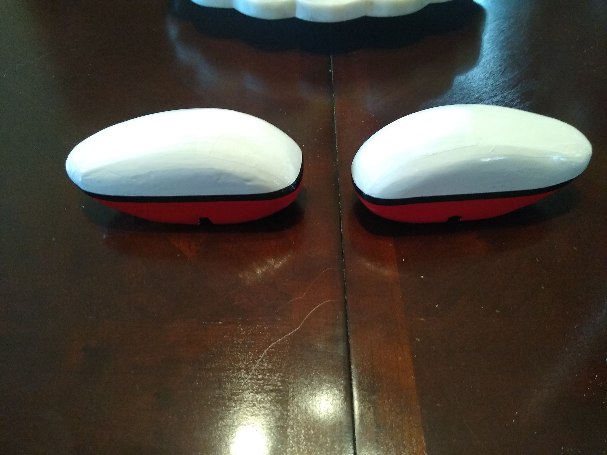

Default Finished with pants
I have other projects that need my attention now, but I'll get back to the lower cowl Monday. Really happy how these turned out think it'll add that extra touch.

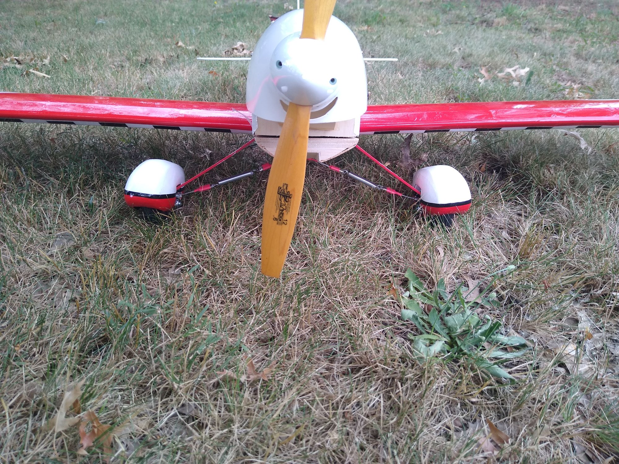

The longer wheel axles I needed arrived today so I put the whole assembly together and love it!

Now that looks good

Thanks You can't see in the picture, but I locked in the retainers for the cables/springs going from the inner strut up to the fuselage. That way I can just solder/crimp the cables in later when I get to that point. It's just a large loop wire connector, nothing fancy but effective.

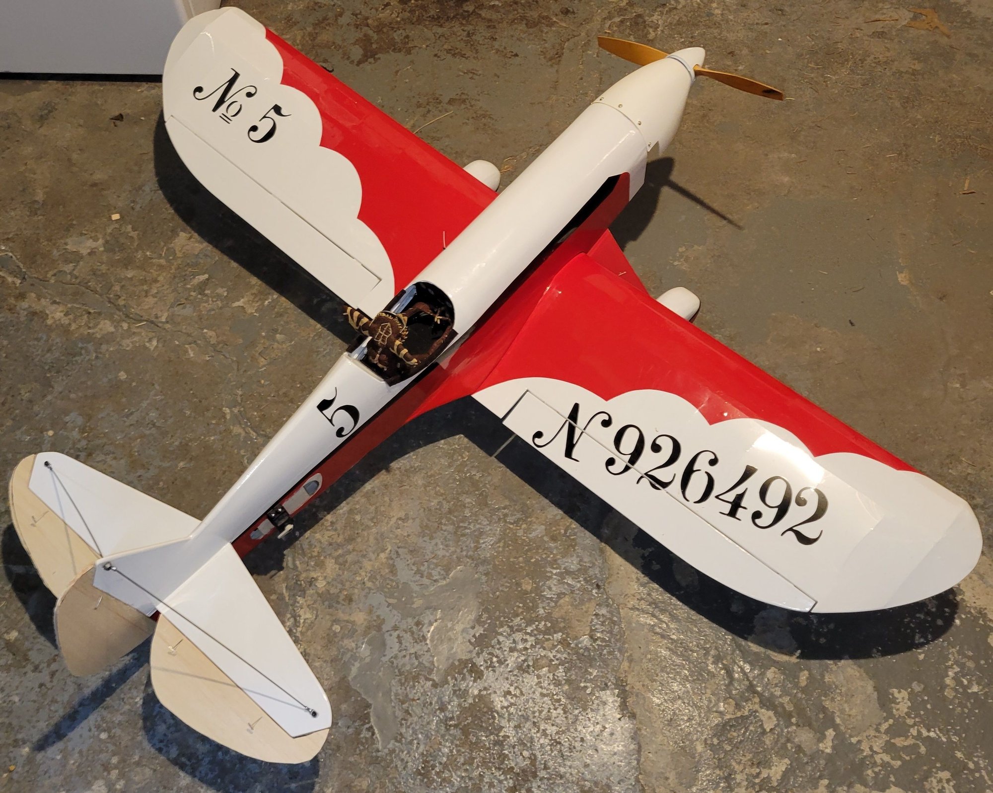

Ok this is about the time of the build I get worried and start checking things. I put it on the scale and with batteries it's exactly 4 pounds right now. Actually that's not bad and there isn't much more to build, and none of it is heavy. So I'm seeing when done the wing loading will be shy of 22oz/SQ ft. For a sport plane that wants to be a semi scale racer that's right on in my book. It's dead on with the Tower Hobbies Ryan STA and I'll have more battery. Other good news I checked the CG and at the moment it's actually dead on I didn't expect that so I'm very happy. Ok back to building

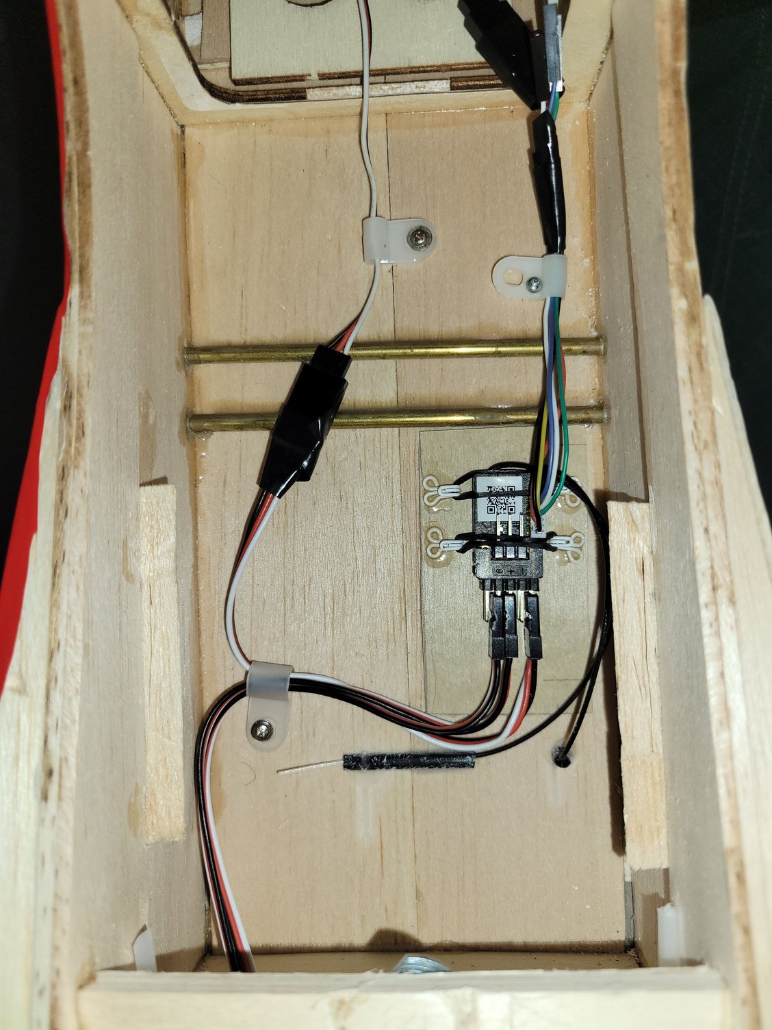

I cleaned up the wiring under the wing and epoxied the battery hatch magnets in place. I suppose I'll have to actually do that lower cowl finally.

Neat installation. What do you run your antennas in. I've been using glow fuel silicon tubing. It may not (and I don't think it is)but I also leave the actual antenna end exposed, so just the sleeved part is in tubing.

I use coffee stirrers for my antenna routing. Cheap and plentiful

I had a little time this morning to work on the build. I used that time to redraw the tail feathers and get the templates out. Since it's only I believe 3/16" balsa (didn't measure yet) I'm just going to make them out of a 2 ply balsa and cut lightening holes. It'll be strong for transportation and light enough for what I need. I might make these before the CO or just jump into that next, will depend on time I have. Hopefully get back to this later today.

Every modeler has that moment at some point in a build you pause and think to yourself that this is the coolest airplane you've built. Tonight I had that after putting the roughed out tail feathers and wing on. It's always a good feeling Obviously there's much better aircraft out there, but this one's all mine

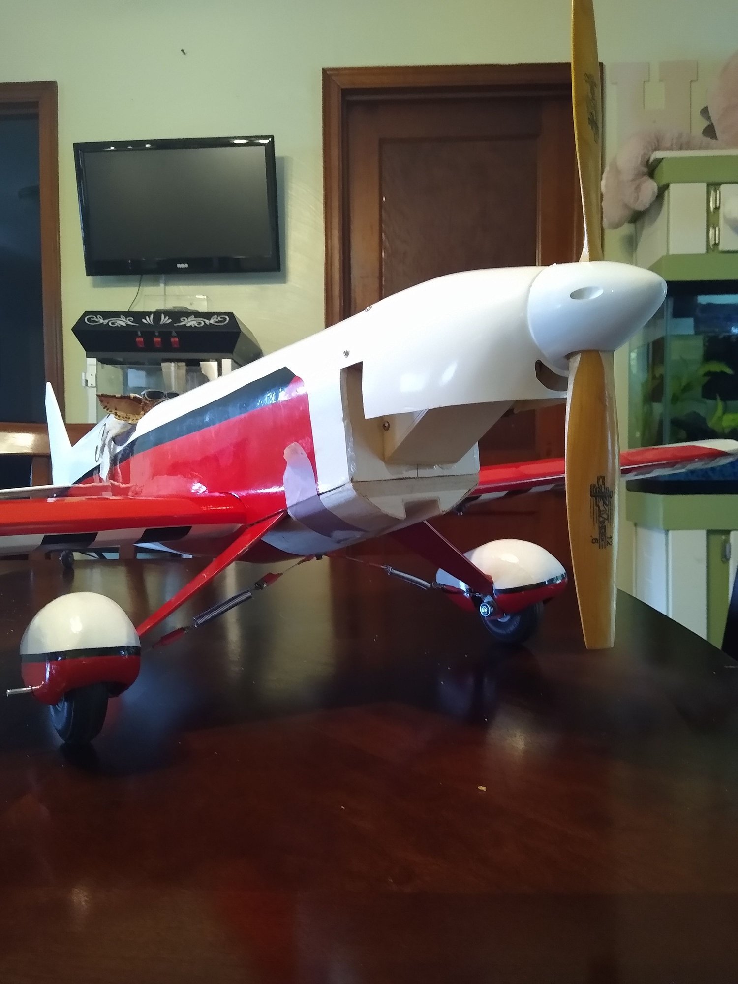

Default Let's finally make this lower cowl
