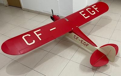

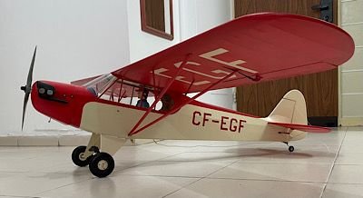

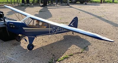

My very old and reliable Sig Cub was showing signs of age and many flight hours, so I removed the old Silkspan covering and re-covered it but this time with heavy duty high wet strength Silkspan (from Ben Buckle).
Original covering
New covering
Also used this opportunity to apply a fresh new paint scheme, from G-POOH to CF-EGF.
Still very suitably powered by an OS 30FS with APC 11-4.
Only gained 110 grams in the whole process.

Originally Posted by RICKSTUBBZ View Post
What type of paint did you use over the Ben Buckle silk-span?
Did you use dope to apply the covering or one of the heat activated covering glues?
I used a heat activated PVA type of glue similar to Balsaloc. Neat and clean to use with no odour. Applied the Silkspan wet after letting it soak several minutes.
Used a very small iron like the one used to apply strips and trim.
After it dried for a day I used thinned dope to seal.
The paint is household Polyurethane, brushed (living in an apartment means spray painting is not an option for me). All registration letters are also painted using automotive vinyl masking tape.
