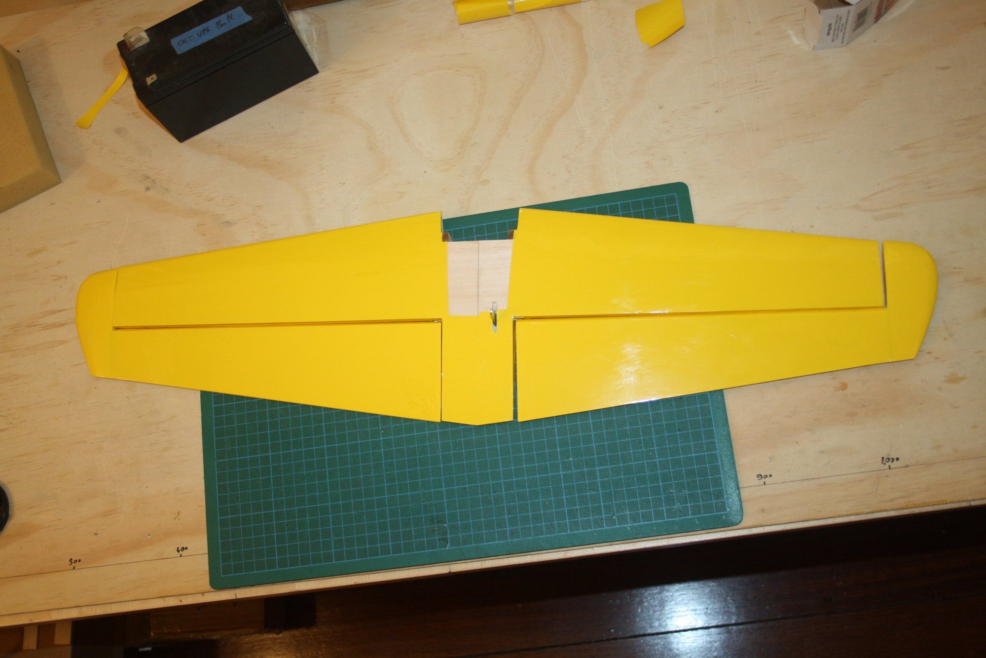

Old 07-13-2022, 01:49 AM
erans
Join Date: Jun 2008
Location: Perth WA, AUSTRALIA
Posts: 1,134
Received 8 Likes on 8 Posts
I prefer to cover major components as when they are ready, eventually ending up with an ARF "kit"... Top tip if you are new to covering is to cover the areas with 90 degree angles or that are difficult to cover by using the main covering pieces first.
Cheers,
Eran
Old 07-13-2022, 01:50 AM
erans
Join Date: Jun 2008
Posts: 1,134
Covering the horizontal stabiliser
Cheers,
Eran
