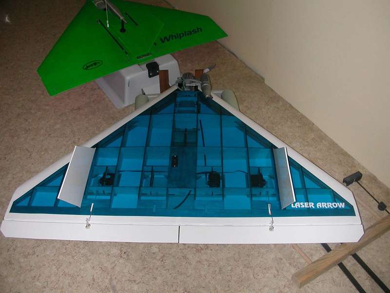

well, I builded two arrows already, and some wonder.
the arrow is definitly easier to frame up than a wonder !
because I builded also the laser 3D I understand the opinion of the fellow above, but the it's not the case for the arrow. Altough the instruction are very short, it's nearly impossible to make a mistake
when I opened the box of my first one I tought that there was something missing, in fact there is no full size plans, only an exploded view of the plane. you really don't need a plan to build it !
just be carreful that you fully push the parts in the notches and check that you are working straight using your eyes and a square
this laser cut kit assemble like a lego
the picture I will post now is a 3 days work . I could have build it in 2 days (one for airframe and one for covering and radio stuff instalation) but i made some mods who required one day extra work. it serve as inflight test stand for my eagletree data recorder
altough the one you see on the pic is fit with a .61, I recomand a .45 size engine.
it's really easy to build (more easy than a somethin extra for example)
this is also an excelent first delta with a top speed around 90 MPH with a .46 engine.
this tick profile as good low speed characteristic.
let me know if you build it, I have some easy to do mods to improve it a bit
basicly to make sure that you don't do any mistake when building your arrow, just keep in mind that if you have to sand something this mean you are going to make a mistake ......(except for the leading edges shaping and final sanding of course)

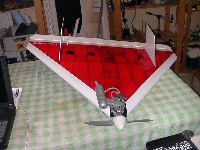

i don't putted retract in laser arrow, but I am making this mod on a BTE delta vortex.
the mods I made on the arrow are
-install a antena tube runing along the trailing edge (inside the plane), put it close enough to the trailing edge to allow that it doesn't interfer when you will install the fins after covering.
- glue tri stocks on the leading edge of the elevons, this reduce the sanding job of the "v" shape to nope
- I cutted the edges of the elevons to improve a bit the look
in the pic I join you can see the antena tube going in the 'radio compartment box' look trough the covering. This pic is my.45 arrow, you can also see the cut of the elevons
