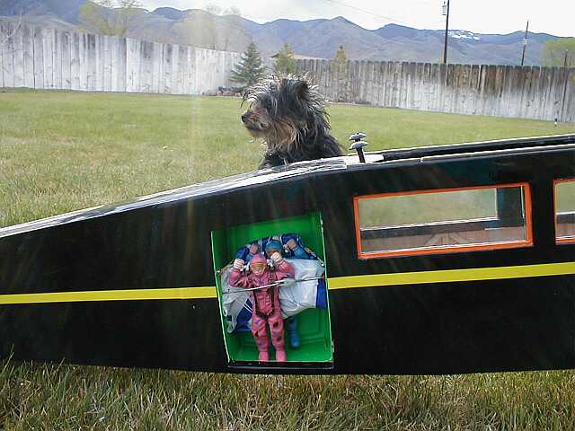

Here's one approach

now the close up. Pictures courtesy of George Nichols.

GREAT!! I'm going to use it with a little modification.
Really like the simple release - :sunsmiley
