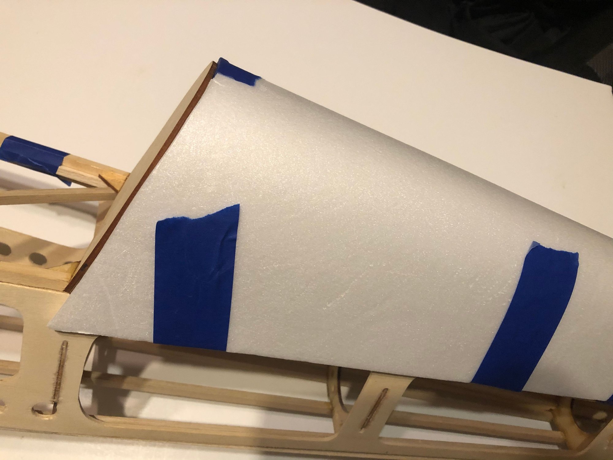

Started fitting the turtle deck, it’s molded 3/16”structural foam I use in boat stuff in the real world. Once I get the rudder and elevator in I’ll trim it in and heat mold the fillets. Stock plastic skin 104 grams, foam skin 24 grams.
instead of the 1/4” rails called for in the plans to support the skin, I only need a 1/16” x 1/8” lip to locate the foam skin.
total weight savings in replacing the plastic 4.1 oz.

Started fitting the turtle deck, itís molded 3/16Ēstructural foam I use in boat stuff in the real world. Once I get the rudder and elevator in Iíll trim it in and heat mold the fillets. Stock plastic skin 104 grams, foam skin 24 grams.
instead of the 1/4Ē rails called for in the plans to support the skin, I only need a 1/16Ē x 1/8Ē lip to locate the foam skin.
Nice!

How will you finish the foam decking?
