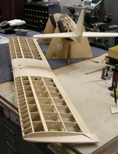

Here are a couple of shots of my BTE Venture 60 project. I wanted a cartoonish/psuedo-racer fantasy kinda aircraft so this is what I have so far. First, ALL kits should be as nice as Bruce Tharpe's stuff, how about a bipe, Bruce? Basic Mods to the plane have been strictly along the lines of those suggested here on RCU and by Bruce himself. Those being: shortened wing span by one bay each side and separate aileron servos. In addition: I wanted to smooth up the leading edge a little so false ribs were added between the full ribs at the leading edge. The cockpit was moved back 1 3/4" and the turtle deck stringers were bowed 1/8" to give a very gentle arch back to the tail. The flat looking foredeck (between the dash and firewall) was next on the list. A new dash was made approx. 1/2" taller than stock and a half former added to the top of the firewall that raised it approx. 1/2", another former was then installed midway between the dash and firewall to create a gentle arc all the way to the spinner then the whole foredeck was planked with 1/8" balsa. Next was a cowl to cover the horizontal mounted .80 Saito. A 1/8" plywood plate behind the spinner got things going and was attached to the fuselage by way of several 1/2" x 1/4" balsa sticks. Rough shaping was next to get things 'flowing' back to the fuse and then the open areas of the 'stick cowling' were filled with 1/4" balsa sheet pieces and then everything sanded to final shape. I'll post more pics as things progress. In the meantime- Get 'er done!!
The foredeck mod dimensions are rough, from memory...

Posts: 681
Default RE: My Modified Venture 60 more pics
I do not have plans for the plane stand. The first one I made is of 3/4" blue foam epoxied together. I've used it for more than a year. The plywood stand holding the Venture is just a refined copy of my foam one. The difference being that the ply stand's ends slide onto the backbone 'egg-crate style' so it'll break down flat for storage or transport. The backbone is two pieces bolted together so the stand can be lengthened if needed. Works fine the way it is for my Super Sporster .40, a .60 size Skylane, a Waco .60 and the Venture.

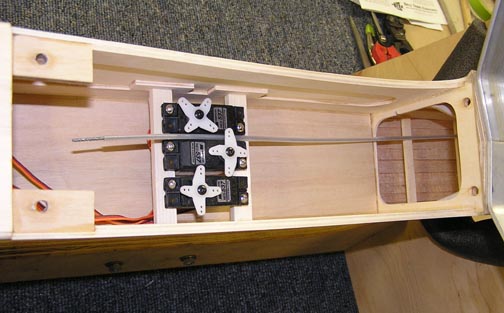

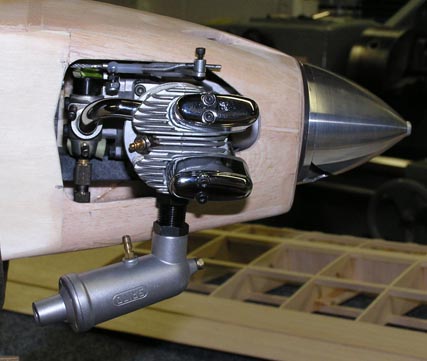

Default RE: My Modified Venture 60 NEW pics
Here are a few new shots. Servo mounting is per instructions. Saito .80 is horizontal and on a Dave Brown mount. Throttle linkage is an aluminum arm pivoting off the side of the engine mount, actuated by the kit supplied cable. Linkage from that arm to the carb arm is a ball link and pivot link with a 2-56 rod in between. I plan to shorten the exhaust header pipe a little bit 3/8" to 1/2". Should have maiden flight in about 3 weeks..........

That is a wicked cool looking nose!
Sweet. I'm gonna try to side mount an O.S. 61FX with a Great Planes mount and a slimline pitts muffler and a built up balsa cowl...don't know if it's gonna work or not. This is my first kit, so it's mostly trail and error.
