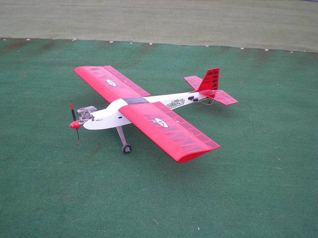

you must be looking at another model the Gizmo http://www.dldesigns.net/gizmo.htm will handle a 70 4stroke max engine its really not that big of a plane,its recomended engine range is 32-46 2stroke, its about the size of a Sig Something extra.
I love mine, I have had it for quite a few years I have a OS 46AX and it is a stunt monster, I built mine with counter balanced the tail and made barn door ailerons the stock ones have a slight taper to the wing tips its usually the first plane out on the flight line for me.
I also had to mount the tail servos in the rear of the fuse, to account for the extra weight of the engine for prper balance, without adding any extra weight, I also chose to use a wider gear from H-9 otherwise its a stock Giz.
here is a few pics of mine the origonal white fuse and now a repaired after crashed red covered version the red really shows up in the air, I also had to recover parts of the wings since they sustained some dammage in the crash, but had some replacement stickers handy, the 46 AX really pulls this plane around I use a 11/5 prop .
