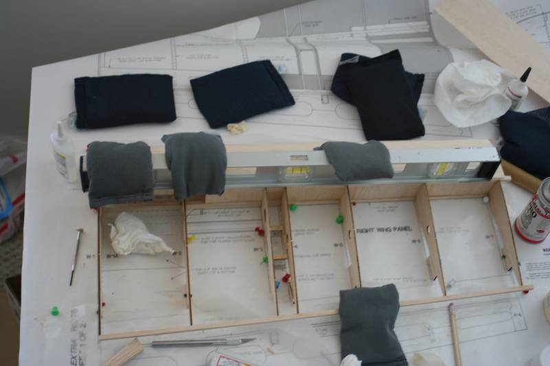

I just answered the PM, but to recap. I did as Woops said. I glued the spars and trailing edges on first and then cut them to the correct length flushed with W1 before sheeting and adding the final rib. For the trailing edge, I "built" some support blocks using scrap balsa from the kit that I stacked on top of each other until I had the correct height. I think I made about 3 or four of these blocks. I then pinned the trailing edge to these blocks while the glue was drying or use CA and accelerator to go fast.
Good luck.
I found a picture that shows it. As you can see I only used two blocks on either end. One in the middle wouldn't hurt either...
tychoc
Good luck.

I forgot the W-2 wing rib. I kept looking at the instructions and I thought something looked wrong. I got it on before it was too late. Thank goodness. I think once I get the left wing off the plans I am going to start the right wing. I do not have enough room (like somebody we know - DamonTX
) and then I will finish both wings at the same time. I might forget what I did with the left and I want to start the right while it is still fresh in my mind. We are waiting on your pics? You have to give us your new modifications for this new SSE. I cannot wait to hear your new ideas. Twin engines? What type of engines?? You are keeping me in suspense!!
Tychoc: The weights I am using are from my scuba diving equipment. I was going to make your patent $.20 weight bags, but I remember these weights. LOL
Manny

Manny5150: Looks good. Once you get going it's hard to stop. You'll be done with the wing and fuse before you know it

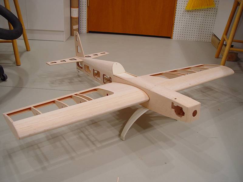

Hi Manny... It looks like you are making a really good effort to keep those wings straight, nice job with the straight edge & weights on the top spar, that'll do it.
I worked on the twin from 6:00pm-2:00am Friday night, from 9:00am-1:00am Saturday and from 9am to 9pm Sunday. By the time I got back upstairs and got onto RCU last night I figured my wife would divorce me if I went back downstairs again. So I'll get some pics tonight.
Both's fuselages are done. Most of the time was spent cutting all the parts I needed for the second fuse. Tonight will be the hatches then onto the rudder and designing an elevator.

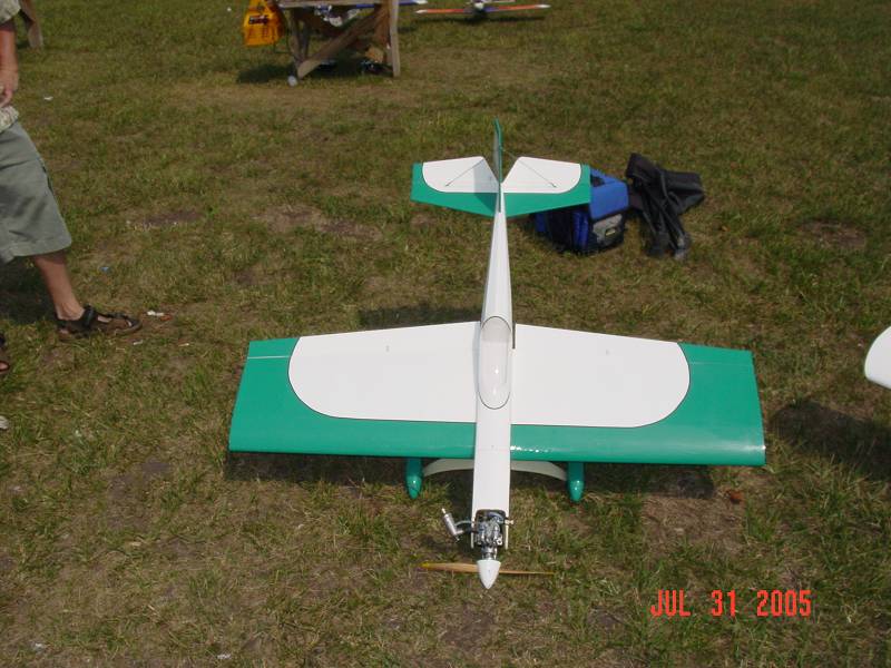

I just wanted to show you guys my SSE- it was my first kit and my first Monokote job. I have a Saito 82 in her, and am using the Dubro gear for ground clearance. I'm pretty proud of this one! She's a real monster on high rates, and soooo easy on low rates. I liked this kit so much that I'm gonna go with another SIG- the Smith Miniplane.[8D]

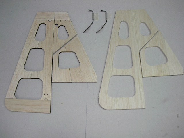

Dale...I thought about doing a boomed fuse like on my P-38 but a few things stopped me. The turtledeck would have to be rounded or made boxy, I couldn't think of a good way to transition the turtledeck into the front of the fuse without it looking ugly. Second, I'm trying like crazy to get it finished this month for a fun fly after I get back from a week long work trip the first week of Sept.
Pictures are coming tonight, I promise. On top of what I said above, I'm also drywalling the kitchen for cabinets to be installed Sat.
___Edit- I just came back to add some pics. If anyone does a twin like this I'd highly suggest just buying two kits. By the time I cut out all the parts for the second fuse & rudder I could have easily had both fuses built.
The first pic is the modified rudder. This worked well on the first twin. Also there is the tail wheel gear I'm using. It's different than whats supplied with the kit in that it has a nylon hinge that will go into the rudder trailing edge...much better than the one supplied which relied only on the rudder for support.
