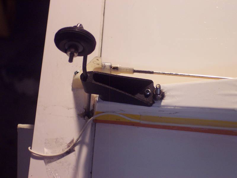

I used the brass tube (sharpened) as a drill bit to run a pushrod from the tail of the plane (through the rear formers) to the rudder servo.
I tried to take it out last weekend, but the (cross)winds were so bad it kept picking the tail up and flipping it. SO I never got it off the ground. I think I need to reduce the height of the tail wheel and possibly move the mains forward a bit. I may get to try again on Monday...
I'd also like to see how others have attached a tail wheel to this plane.

As far as the plane, it's holding up great. I've flown it several times and I love it. It looks better and it might be my imagination, it seems to fly better. I may have changed the CG a little bit in the build process. As far as strengthening the tail, I really didn't do anything. I just screwed the tailwheel into the bottom of the fuse, backed the screws out, put some CA inside the holes, and put the screws back. I always try to take up the majority of the weight on the main gears when I'm landing, so it hasn't been an issue (yet [sm=wink.gif] Let me know if there's anything else you want to know.
Here are some pictures:
