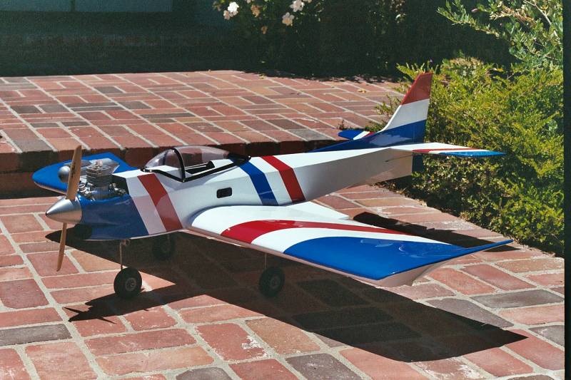

Mine flies very well with an OS .61 FX. It takes a little extra carving inside the cowl to fit, and you may want to add a shoe horn to your toolbox. The plane builds a bit heavy, and might be a bit anemic with a .45.

Robert, beautiful plane!
JS3, I have the Enya .50 which has the same mounting dimentions as a .46. That would probably be a good engine for it if propped right. I really love that .61 FX though! Runs great!
