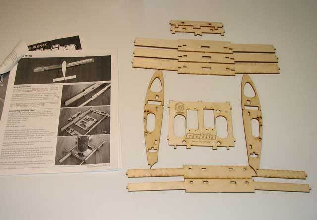

Sure enough Doc, the smell of laser cut wood wafted out of the box!

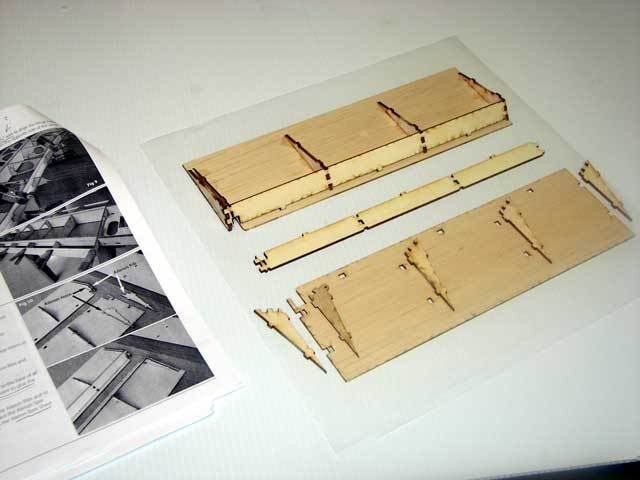

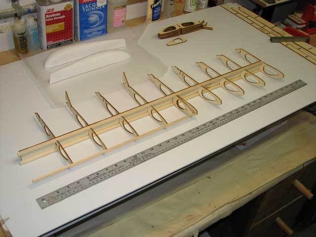

I started cutting loose the parts for step one. "Wing Construction, Assembling the Wing Cage".

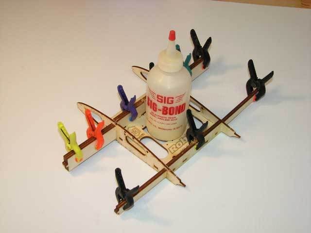

After a "dry-fit" run through I glued the assembly together with wood glue and let it set for the night.
Next I cut loose the ribs and spars and started, "Constructing the Leading Edge Spar". In the photo below the right hand wing assembly is up-side-down.

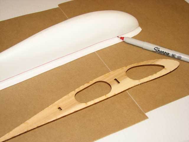

Jumping way ahead of the game I also marked a trim line on the vacu-formed wing tips by using a red felt marker on its side and sliding it around the perimeter of the part. Then trimmed off the excess with scissors and epoxied in place the outer most wing rib.
All the laser cut parts have fit together snuggly without any additional sanding required. Nice!

Good move on the wing tips. One of the few places I think I am going to modify is to make light fiberglass repalcements for the plastic wing tips. I've had some frustrating times with plastic ones before. I figure (?) as long as I have the originals, I can use them as a mold and mke plugs to remake my own. we'll see.... Keep going with your great photos and descriptions. Doc

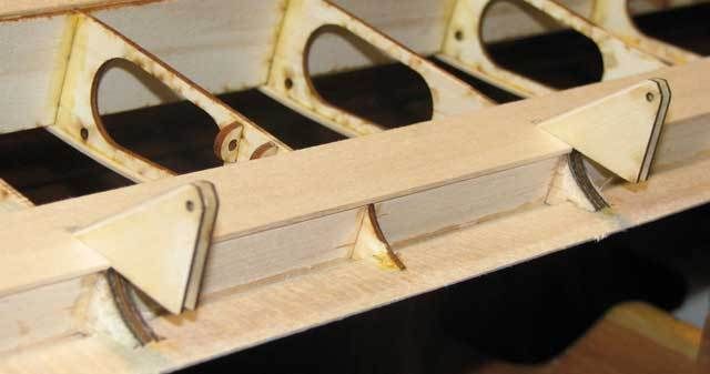

That's a good idea Doc about the wing tips but I will give these a try and hopefully not damage them. They seem pretty solid with the rib epoxied in place. Sort of like an egg. Strong until I crush it!!

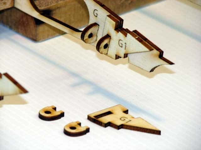

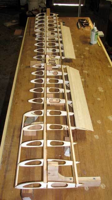

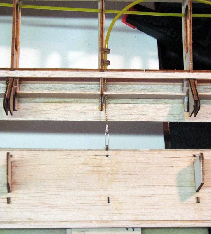

The above photo is a close up of how the Aileron Cable Anchors are located. The laser cut parts fit like a glove. I used wood glue after a trial fit. There are simular anchors for the Flap Cable.

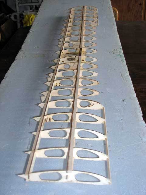

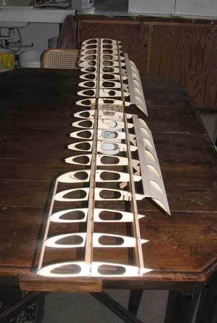

Here is the left and right wing glued to the "Wing Cage" and the rear spar in place.
And here is a start on the ailerons themselves.
I am trying to not go too fast and do a lot of checking between the manual and the plans. I read over the plans in the morning before I go to work in my shop in the afternoon. Check, check and re-check. The plans are very specific about where to use CA Glue and where to use Wood Glue. Also, right is right and left is left!! Things like that I try to keep in mind!!

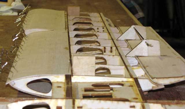

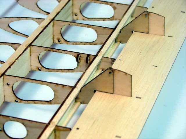

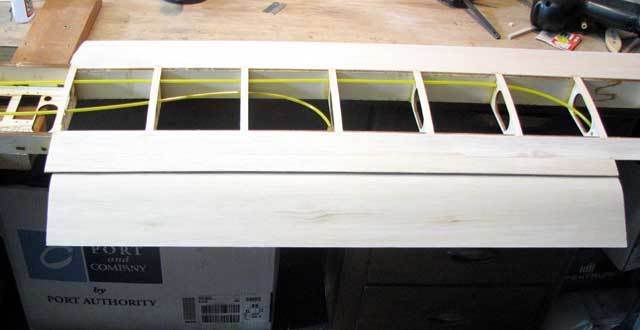

Here are the finished ailerons. It may not look like it but they ARE right side up!! Interesting!

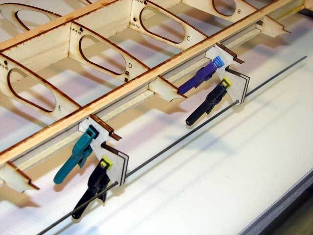

Then I installed the Flap Support Arms using a .094 rod to align the pivot points.
Flipping the wing over I assembled the Flap Ribs, Flap Horn, Flap Horn supports and Flap Pivot Ribs on the Flap Base and temporarly installed it on the Flap Support Arms to make sure everything lined up before committing to glue.
I did both flaps and they pivot nicely through 40 degrees! Oh Boy!
Here is the overall view. I'm stoked!!.

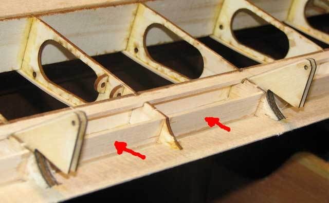

I did discover I installed one set of Aileron Cable Supports on the wrong side of the rib after all!!
Fixing that will be my starting point tomorrow!

The flaps get sheeted with 1/16th balsa. Ken at MosquitoBite did a nice job of selecting the balsa for this kit. Light weight but straight grained.
The next procedure, according to the manual is to cover the ailerons and flaps with Ultrakote.

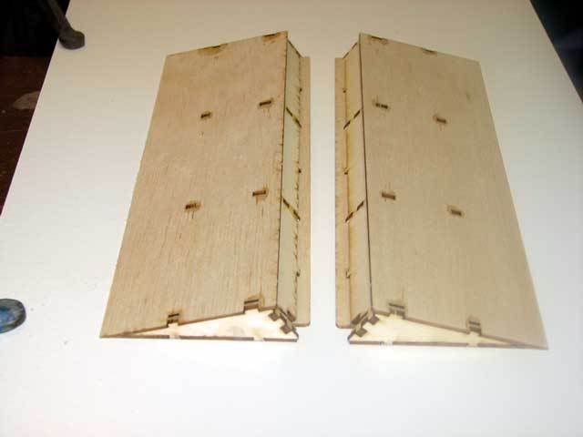

Truth be told. I am an idiot! I discovered I didn’t glue the Flap Cable Anchor on the wrong side of the rib. It IS correct. The problem is I built two right hand flaps!! (Pay attention Doc!!)
Yes, there is a wee difference between the right flap and the left flap! The actuator arms are located about a quarter of an inch off the center of each flap!! If it wasn’t for that wee offset the flaps would be almost identical!! Fortunately I had not glued on the 1/16th thick, balsa sheet, top half of the flaps so I was able to remove the flap ribs, flap arms and the actuator piece, flip the Flap Base over and glue these parts on to the “correct side”.
Now both flap actuator arms line up with the flap cable anchors!

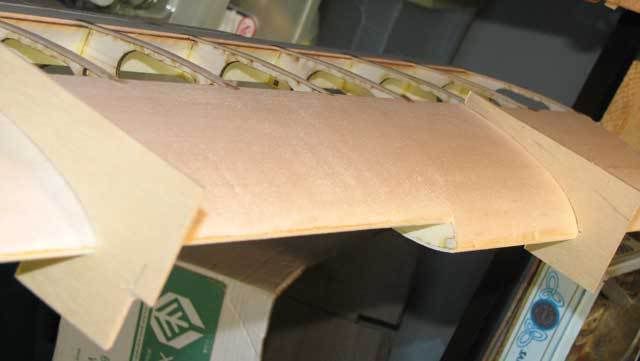

I then installed the top sheeting on both flaps. This is a bit tricky and I highly recommend sorting through the 1/16th sheets of balsa and picking two sheets that will wrap around the flap curve somewhat easily.
Next I put them temporarily on the wing. I sanded out a bit of flap gap interference by sliding some sandpaper between the flap and the wing trailing edge (grit towards the T.E.) to get the flaps to close to 0°. It didn't take much and now they are perfect. No gap when closed and a nice even slot when opened.
I like it but it took all Friday afternoon!

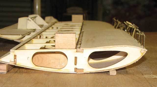

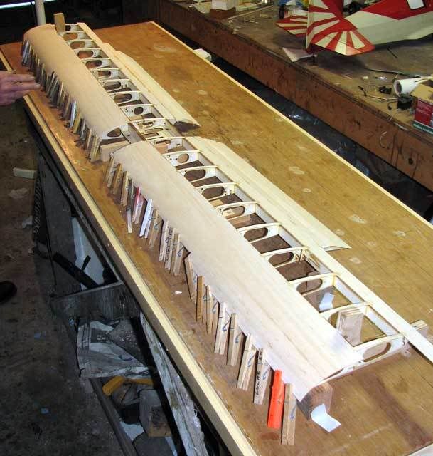

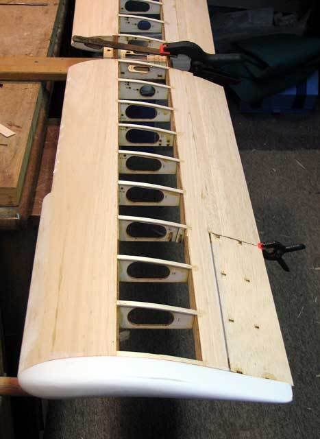

I was to the point of putting on the leading and trailing edge "skins", D-tube style, when I noticed things were not straight. There was a bit of a "S" shape when sighting along the main wing spar from one end to the other! Not a lot but more than I wanted to "lock in".
I called my flying friend and asked if I could use his big flat table and could he maybe help me get this wing jigged into straight and true.
So, today that is what we did. Screwed some 90 degree angles to his building board and then measured and shimmed and clamped where necessary to get the wing straightened out.
Then I glued on the 1/16th sheeting from the rear spar to the trailing edge, from the main spar forward and down to the leading edge and then added the rib cap strips.
Tomorrow I will lift it out of the jig and flip it over for the bottom sheeting.
I'm glad I went to the trouble to take the 1/8th inch wow out and make sure the dihedral and incidence were the same, end to end.
I had heard the MosquitoBite Tri-Pacer wing could be built in a bench vice but that's not a good idea for the Robin wing.

Today I installed the lower forward sheeting. Once again I held the wing straight and true with jigs before adding the outboard sheeting for the the NASA Droop and then the regular inboard wing sheeting.
The NASA Droop has under-camber so I used a combination of CA here and wood glue there to get the sheet to hold in place while the wood glue set up. I used wood glue on the leading edge so it will be easer to contour when the time comes. I had to use pins this time as clothes pins would no longer work.
Inboard looking out.

Tomorrow I have a bunch of filler pieces to install to enclose the space in the wing just ahead of the flaps and the area just ahead of the ailerons. Then the lower rear skin and the lower cap strips can be installed.
Thanks to my friend Dick for helping me get this wing straightened out. "Next time" I would build it over the plans even though it would have to be up-side-down because, right-side-up the NASA Droop and the Flap brackets are in the way.
Tricky business!! [>:]

I moved the Robin wing back to my shop.
Using some tracing paper I traced the outline of the leading edge of the NASA droop and the inboard leading edge from "Sheet Two" of the plans, then contacted cemented the tracings onto some thin plywood stock. I band sawed them out and hand finished to shape. Using these templates I contoured the inboard and outboard leading edges.
Next, I started cutting and fitting 1/16th balsa sheeting between the trailing edge ribs to close off the space ahead of the flaps. They will also support the lower trailing edge. Six pieces per wing.
And here the trailing edge piece is cut to size and fitted.
Lots of fiddly work and it sure ate the afternoon! [

Thanks Doc,
This wing is taking a lot longer than I thought it would. Getting it straight to begin with would have saved a couple of days! Now that it is straight I find there is a lot of piece work involved with the trailing edge area, sanding the trailing edges to fair and getting the gap correct on the flaps. I am learning the straighter I build parts to start with, the easier additional pieces will fit. Let me say it again... the flaps are tricky.
I gave the wing tip a trial fit. It looks like it will fit just fine. (The trailing edge is not sanded to length, yet.)
I also delved into installing the Golden Rods for the Aileron and Flap cables. I soldered on the Sullivan Link to the cable that actuates the flap. The wing is upside down in this photo and I have the flap and wing spaced apart to illustrate how it is set up. A "push/pull" action deploys and retracts the flaps. It works because the flap pivot points are located about an inch below the wing. (The Golden Rod, cable and Sullivan links came with the kit)
This is the routing of the aileron and flap cables out from the central servo tray. Laser cut holes were already in the ribs to locate the Golden Rod. Sweet!

Doc,
The clevis attachment points on the flaps and ailerons are accessible but hopefully not needed once assembled. As for the attachments of the flap and aileron cables to the servos, yes, they will be fully accessible.
Now then……
Since I seem to be the one breaking ground on this build let me confess my mistakes so others can avoid them. Note: I am what I would call, an average builder (maybe I’m optimistic), smarter guys and gals will have enough foresight and wisdom to avoid these mistakes!
On page seven of the manual the instructions say “…after assembly of the aileron, cover the aileron with Ultracoat”.
Well, hey! I had not decided on what color Ultracoat to use so, I skipped that part.
Yesterday that decision came back to bite me because yesterday I temporarily taped the Ailerons in place, retracted the Flaps to 0 degrees, made a template of the chord length of the wing from the plans and set about trimming the wing to length. Simple. Constant chord. Nice and straight. Perfect!
I then removed the Ailerons and looked into covering them with Ultracoat (which I now have). In the process I discovered I had about an eighth of an inch “overhang” where the aileron hinges to the wing!! If I had finished and covered the Aileron when the manual recommended I would have noticed this and trimmed off the overhang before I “finished” the wing to length!
Now, with the ailerons trimmed to length, they are shorter than the flaps by an eighth of an inch! Now, I have to re-cut the flaps to the new shorter length or add to the ailerons trailing edge. Either way it isn’t much but…. Dang!
It has also become apparent it would be best to finish and Ultracoat the Flaps when they are assembled back there on Page 5!
My other mistake… I cut one flap actuator cable too short by an inch and a half! I had “assumed” (there’s that word again) both right and left flap cables would be the same length. Wrong! The flap and aileron servos are side by side, either side of the centerline and so one flap cable needs to be about an inch longer than the other.
I fixed my mistake by adding cable by using a brass sleeve and solder. That brass sleeve, now visible in the servo tray area, will serve as a permanent reminder to, “check, check and double check”!
Another interesting feature, which is not mentioned in the manual but noticeable on the plans, is the way the aileron cables attached to the aileron servo arms. I will have photos soon but be aware that there are (two) holes laser cut in Rib A and Rib B for the ailerons and (two) for the Flaps. They are labeled A 1 and A 2, F 1 and F 2. The Left Wing is 1. Right wing is 2. All this because the cables come into the servo tray “over and under” for the Ailerons and “forward and back” for the Flaps. The aileron servo uses two arms of a Dubro four arm servo arm. They are 90 degrees to each other facing forward; like a V. The left aileron attaches to the right arm. The right aileron attaches to the left arm! One to the topside of the servo arm and the other to the bottom side of the other servo arm. This way they won’t interfere with each other where they cross.
The end result is proportional ailerons! Cool!
Now then……
