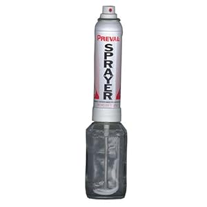

Nelsons has some great fuel proof paints and clear coats
You can always spray with one of there
this is interesting too
http://www.amazon.com/Green-Billet-A...f=pd_sim_auto2

Thanks sscherin
That is a rather neat item and looks perfect for apartments and water based poly C
