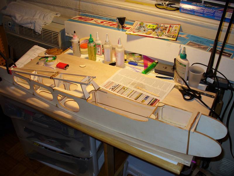

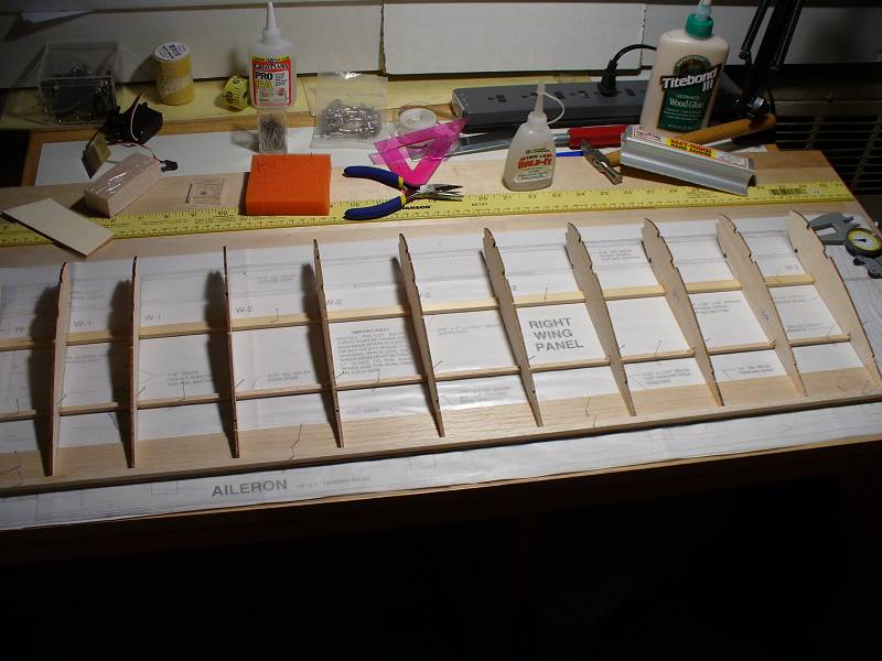

And decided to build another Mid Star 40, this plane flies so well and so easy I decided to have another one (the first was caught by a tree on slow approach for landing).
I didn’t like too much the titebond nozzle, came out too much so I went back to CA, I’ll try it again later, meanwhile I’m using mask and goggles and a tip on the CA bottle.
Don’t have irritation yet but it will come I’m sure.
I put Titebond into a smaller bottle with a better nozzle (you can get these at any craft store for less than $1). I can only imagine the mess the original Titebond bottle generates. If you really want to give Aliphatic Resin (Titebond) a try, I'd get a new bottle, transfer some into it and give it a whirl.

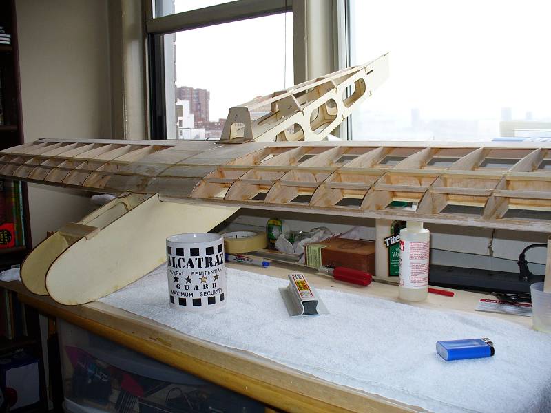

I glued the fuselage today with medium CA and now I’m coughing my lungs out, I used the glue in an open space – roof with dust mask, not indoor and still terrible cough.
The wing I glued with TiteBond mostly.
Fuselage I believe has fewer pieces to spread stresses on so the stress on fuse parts should be bigger then the wing?
My question is whether Titebond III can glue and hold light ply wood?
Alex
Alex

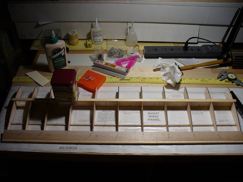

HeliTB
I didn’t try Sig bond, I like very much the TiteBond III, some say now that TiteBond II is more flexible, im gonna try that.
as i look at it right now, with titbond its getting built faster, i dont need time to recover from CA....
Alex
Alex

I remember, years ago now, in my highschool wood shop class something my teacher passed on to me.
The single best thing you can do to ensure a good glue joint... Clamps.
Always, always, always clamp materials whenever you can. When gluing two surfaces, weighting them is good, but the surfaces can still "float". Clamping is always the prefered method.
I would be willing to bet you the price of a donut that you could use Titebond II, or Titebond III, or SigBond.. Any of them, and the wood around the joint will break before the joint does.
When gluing big surfaces, like fuse doublers, make sure to spread the glue over the entire surface being glued. You do "testfit" pieces first right? During the testfit, trace the doubler's edges onto the fuse. Then when applying glue you spread the glue to the lines you drew.
These simple techniques will ensure a joint so strong, and so long lasting... It'll last the lifetime of the plane. The joint will never fail. The wood around it will break first...
But to answer your question, the Titebond II or II should glue plywood. Like I said, just clamp when/where you can... I've used, not problems yet....

From the first Midstar I learned its flying much better as a tail dragger, the OS 46 is a heavy motor which leads to nose heavy and the front wheel just adding to this phenomena, even placing 1000 mAh heavy battery behind the servos was not enough to balance the plane, leading to add weight to the tail which avoided.
the mid star is much more fun as a tail dragger.

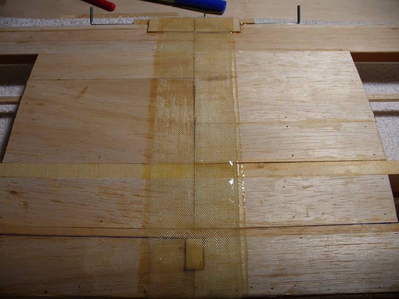

I just added wider fiberglass and epoxy to the wing joint.

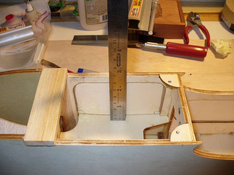

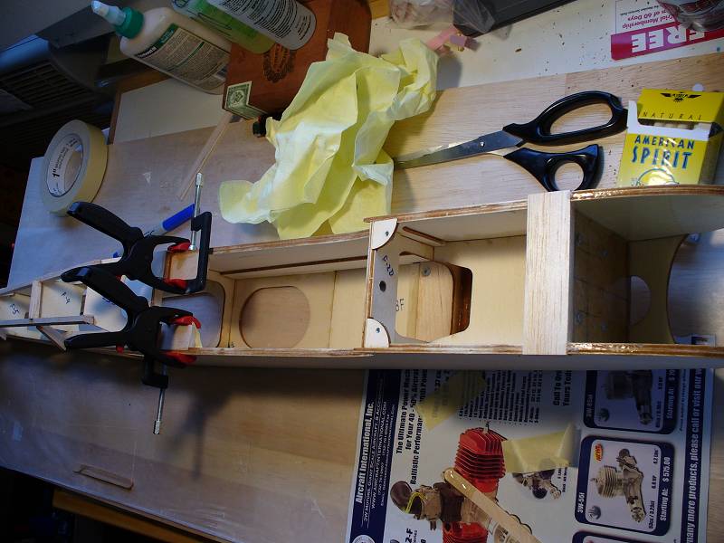

As for weak points of the mid star:
1) the tray of the horizontal stabilizer is too narrow, I’ll add triangle support, prev mid star i broke the stab in flight and landed easy
2) added balsa to formers behind the canopy for easy covering, manual just mentioning it without a picture
3) made the fuel tank floor lower by ¼” so can accommodate bigger tank and to support the tank with balsa frame and not rubber foam, tough foam worked well.
its done when gluing the dubblers of the fuse
Alex

Alex, did the LE come pre-shaped or do we have to carve that one (I'm always worried that I'll screw up the shape). As for the tail-dragger, the jury is still out but I'm leaning in that direction. It's just that I already have a lot of Tail Draggers and might just want something different. Still, it would save weight in the nose where I suspect that the Saito is heavier than the usual 40-sized engine.
I'm not being picky, but the LE in the photo (Post 4) looks a little 'sharp'. I'm saying that because I made my Four-Star 40 with the same sharp LE (got tired/scared of carving) and someone else made that comment at the field. They felt that it might make the airplane 'twitchy' in the pitch axis, which I have to agree with.

After flying mine for a couple of season, I experimented with cutting a bay from each wing and replacing the ailerons with larger ones. (I believe the originals were 1", and I went to 2".) It rolled better, and seemd to settle in for landings better. But I ended up selling my Midstar before I could really wring it out in it's new config.
Good point about the horizontal stab. I forgot to mention that I also added tri-stock to mine as well.
I built mine as a tail dragger for the same weight concerns. I think it looks better that way too.
N1EDM,
RE: Another Mid Star 40
Hi N1EDM,
Hi Bruno, it also behaves better in the air as a tail dragger.
The LE comes as a square and you need to sand it to shape, I choose to do it at the final sanding because the plane is getting beaten in the process of building, mean while I put some thin CA all over the Leading edge just to harden it so it will be harder to screw it up.
i sanded it to shape at the middle to fit the dwel in.
Now that im thinking about it, I might keep the 8 oz tank, just to have the option to change it into 10 oz.
Alex
the manual say to hold the wing support dwells with med CA, i think 30 min epoxy will be better.
This time I added the wing support dwells after sanding them a little bit for match, covering them with masking tape to keep them clean of epoxy for gluing triangular support not like the manual say, other wise you have gaps that held by CA and you need to reinforce it.
I’ll also be using blind nuts to hold the wing and not taping into the wood for thread.
Alex
Alex
