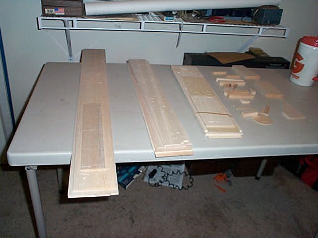

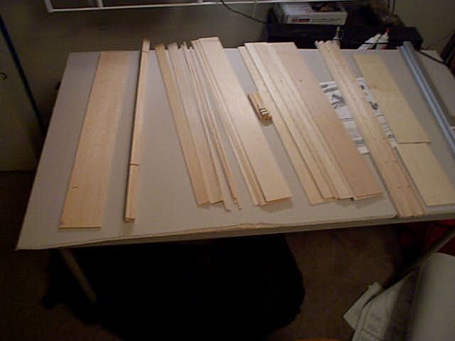

Ok, I decided to start a new thread on the Great Planes Super Sportster 40 MKII kit. Here are the pictures that I have so far.
Images 1 and 2 are self explanitory
3 is all the die cut plywood
4 is all the die cut balsa
5 is of all the die cut parts
6 is all of the wood in the box
7 is the new style leading edge
8 horizontal stab being sanded
9 horizontal stab being fit
10 vertical fin being sanded
11 the glue up
12 improvised wedge clamp

The wood glue that I ended up with is Elmers Professional Wood Glue. It seems to be very similar to Tite Bond 2.
I am planning on using the wood glue any place that may need sanding. I also plan to use CyA, and Epoxy where appropriate.
The improvised wedge clamps are clothes pins. I wanted to do something different here.
The weights are 1 pound ingots made from melted wheel weights.

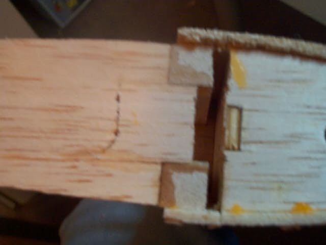

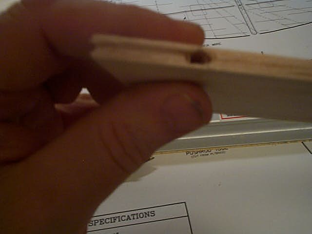

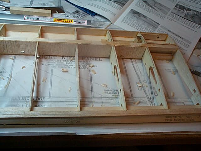

I did the rest of the tail as in the manual. I am not the straightest with a hand drill so I am going to have some patching to do later. Where I am going to change from the manual is in the rudder so I didn't do anything else to it now.
1. This is the Horizontal stab and elevator after setup. I marked the center-line off the plans onto the leading and trailing edge on the stab. The leading edge is not centered right. I will have to adjust this before it gets glued up.
2. Sorry so blurry, this shows the connecting wire as it is hooked up to the elevator halves.

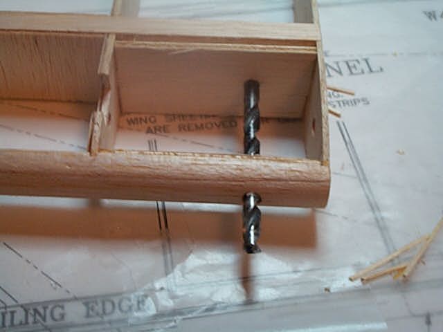

3. The hole and slot in the LE of one rudder half. I used the 1/8" bit on it's side to dig out the slot. It pulls itself off center so this method is not good. I don't have any 1/8" tubing on hand, but will have it before I get to ailerons.

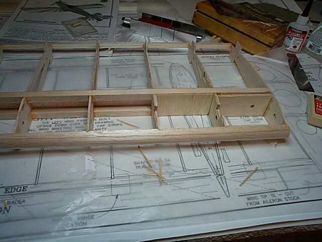

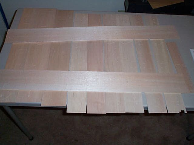

4. About 90 percent of the wing wood.

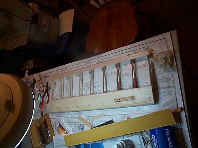

5. This is the pile of parts after they are separated from the die cut sheets. The balsa released easy and didn't need to be cut. The plywood parts released ok, but I had to sand the back sides to get the small holes out.
6. Here are the center ribs getting setup for landing gear blocks. As you can see these are set up for either trike or tail dragger.
7. Glued up with 30 minute epoxy

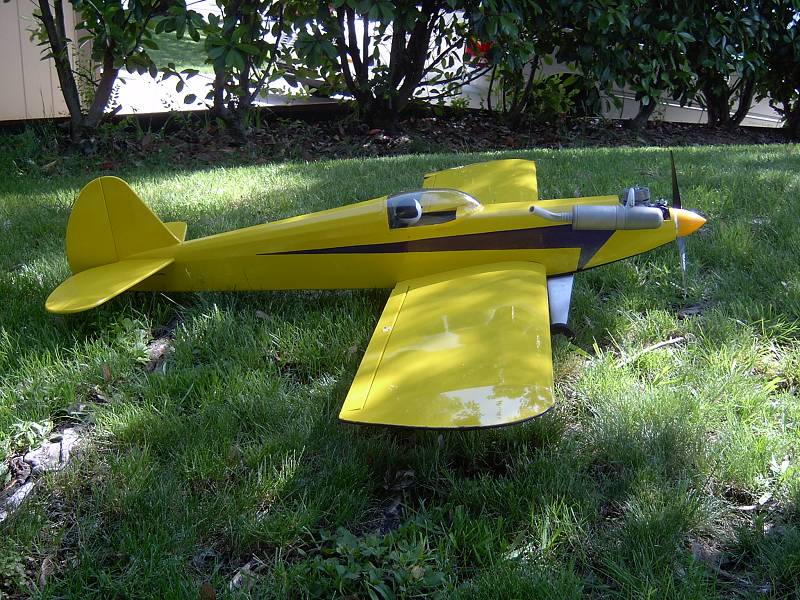

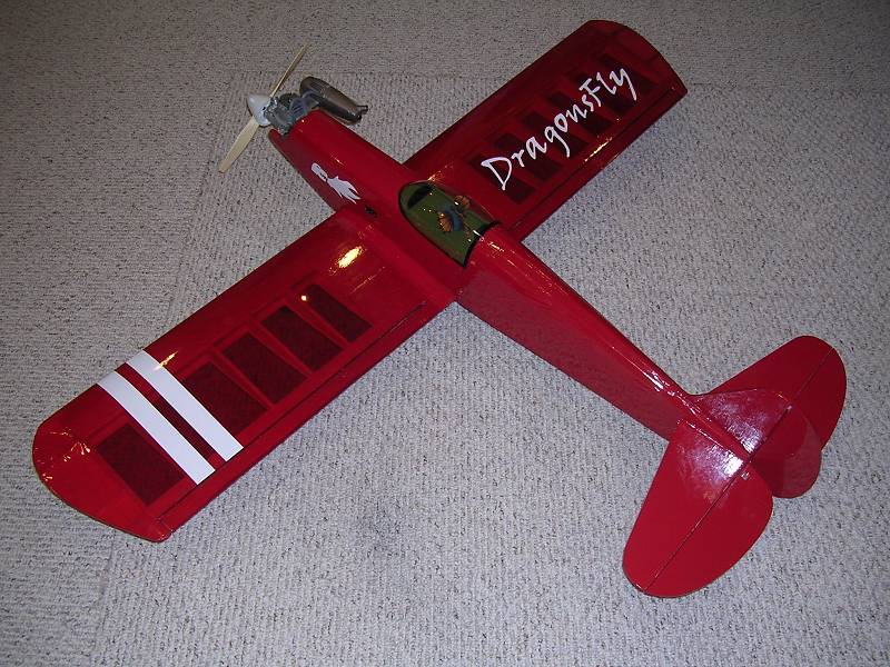

Here is my completed SS 40. I used a OS Max 46AX, I really love this engine. Much better than the 46LA, which is still good, but the AX is awesome. It takes the SS40 straight up as far as I want. I was able to do square loops even. This is my first low wing and is quite easy to fly. As far as construction, I bought an original kit off of ebay. I learned that when someone says, "It looks complete, but selling as is", that means there are no plans!!!!! However, the only difficult part was the CG. The spars already had grooves for the ribs and everything was easy. CG, I had to guess from the manual which was present, thank goodness. I think the original has CG slightly forward of the MK II location. It is slightly behind plan, and performs very well. I did not try to build the entire "cowl" the engine was too big for it to fit very well. So I only put the sides on. I also used a single servo for the ailerons. This plane doesn;t seem to have a fast roll rate, not sure if the single servo is the reason. I will likely try to add some throw and see if it can go faster.
I added a couple pictures. Notice the name and pilot! My family thought it was a dumb idea but they have warmed up to it.

PierceDB, Nice looking SS. Since you covered that one with racing stripes, are you leaning toward going into pylon? I see you have two build projects going on. So what are those fuselages to sitting in the background of that last pic?
I haven't decided on a covering layout yet so keep posting pics to give me some ideas. I am thinking on something with the Nike swoosh.

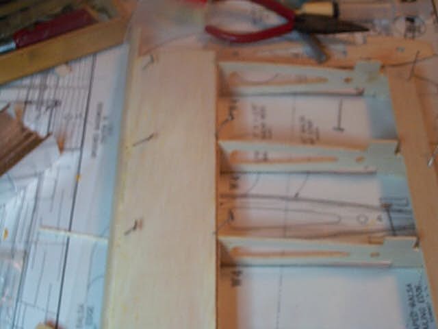

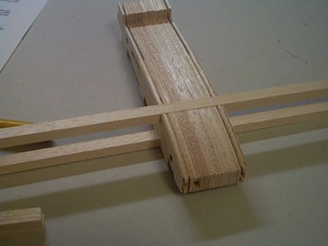

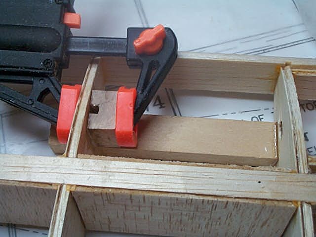

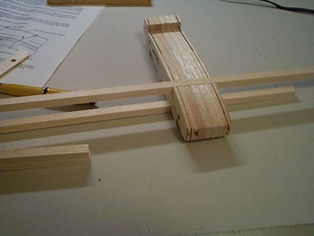

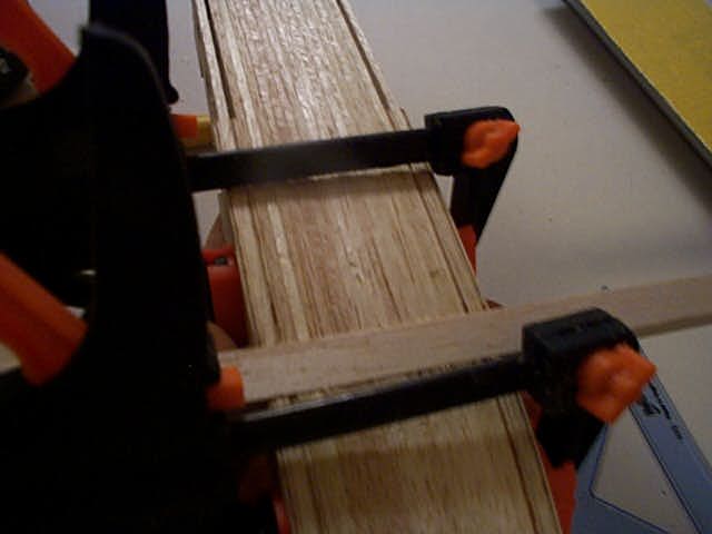

1. and 2. I put the ribs on the spars to line everything up, At this point I tried looking through the jig holes and they were not even close.
3. and 4. I then clamped the ribs as a module to sand them.
5. I then cut out the balsa on ribs #2 and #3 to fit in the Landing gear block.
6. and 7. Here are the #2 and #3 ribs ready to be installed.

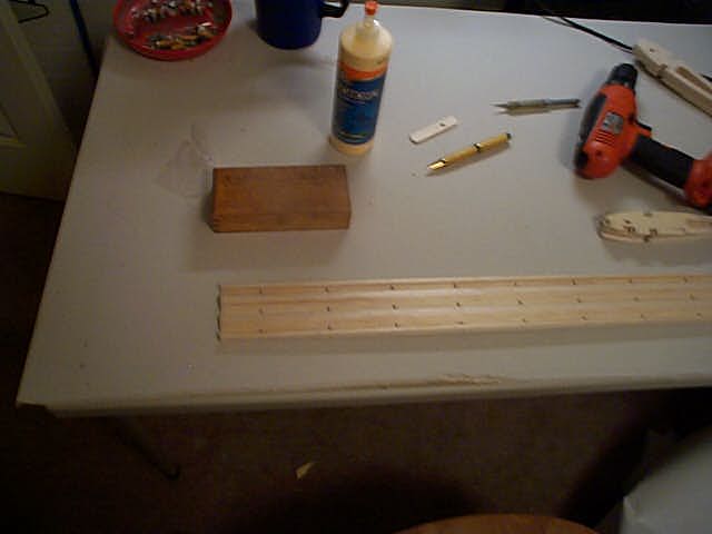

8. and 9. Here is what the leading and trailing edge block looks like. I cut one LE and TE from the block, cutting first in the middle between each, and then I was able to fine cut them to shape.
10. and 11. This shows the warping of the LE and TE after they are separated. Luckily they are warped fore to aft so when the LE and TE sheet go on it should straighten every thing out.

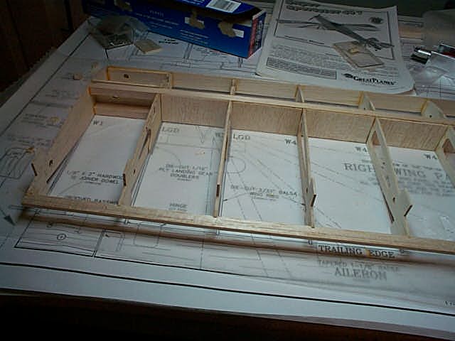

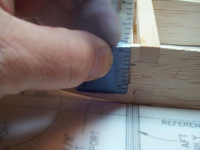

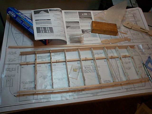

Now we are ready to start building wing panels. According to the manual they are built up-side-down to get to the landing gear block.
1. and 2. Here we have the spar after some carefull pinning. I started by staggering vertical pins in front of and behind the spar to line it up. Then I started the cross pinning as in the manual.
3. Here is everything ready for glue-up.

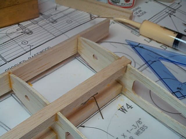

4. I couldn't fit the square between the ribs so I had to install the top spar for a flat surface, then use a block layed beside the rib to square up to. I used thin CyA to glue the TE first, then the LE, bottom spar, and last the top spar.
5. This is the dihedral guage set up against the root rib, #1. As you can see the top is angled out for up-side-down building. This is different than the old style SS series.

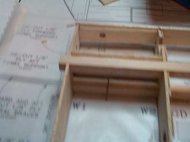

6. and 7. As rib#1 is being glued in (medium CyA) The fore and aft wing dowel blocks are glued in.
8. and 9. So, here is the wing so far.

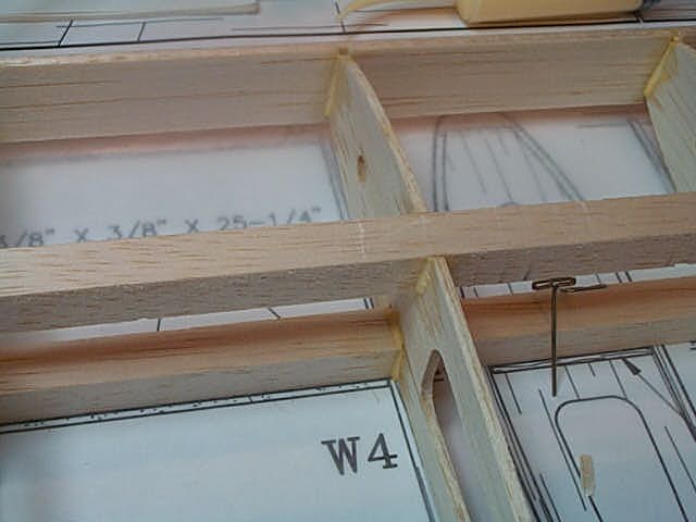

Last night after I posted the pics, I went back and added a fillet on every joint with wood glue. When I got up this morning I checked the ribs, The tip rib wasn't square. I had to dig out the wood glue in that rib, and use debonder to loosen the CyA. I ended up breaking the front section of the rib, and broke the tab off. I used medium CyA and kicker to the tab, and I will have to wait till all the debonder evaporates before I can continue. I will give it a couple of hours to be sure.
1. This is the fillets of wood glue
2. broked rib, That is as far as I had to go, the bottom spar joint was square, and so were the LE and TE joints.

1. After waiting a few hours, I CyAed the top of the rib back on and gave the joints a wood glue fillet. We are back in business
2. I can't remember where I picked this saw up but without the spine it is great for flush cutting. just lay a finger on the side of it and it cuts straight. very little sanding to flush things up.
3. and 4. Flush cut spars, TE, and LE on inside only. outside is to support the wing tip
5. 6. and 7. The next step is to add the shear webbing, this kit gets it all the way out to the tip rib and a double web on bay 2. The dihedral brace will fill in bay 1.
8. Now it is time to drill out for the alignment pin. The older kit used 3 or 4 nylon bolts to hold down the wing, this one gets only 2.
9. and 10. Now we get to epoxy in the Landing gear blocks. I made sure to add a good fillet on this.
I used 30 minute epoxy so now it is time to let it set up.
I keep using the fast reply and when I go to add images, the link is not there. Good thing this lets you cut and paste.

1. Here is the landing gear block, finally, with the mess-ups. They won't show after the landing gear go on.
2. I test fit the landing gear, it is very tight.
I let that cure for a few hours, and when I removed the clamps and set the wing back down on the board, I noticed that the wing was twisted. There was almost a 1/4" gap under the left side, so I pinned the corners down.
This afternoon, I pulled the pins out to see if there was a difference, the left side lifted but no where as bad as before. I pinned it back down and here is glueing the TE sheeting. I used wood glue so any edges are easier to sand. I first set the piece on TE and pinned the rib to give the sheeting something to lay against, then put my straight edge/yard stick against them to pin a center rib.
3. and 4. Here is the glue-down of the sheeting.
5. and 6. Next step is to cut a 3/8" deep groove in the root rib for the dihedral block.
7. Then I had to sand an angle on the LE of the LE sheeting (not in the manual but for better glue joint) and press down on the landing gear block to imprint it for cutting. here is the final result.
When I did the glue up on the LE sheeting, something told me to check the incedence. it was 1/4 degree low on the tip. I removed the pins from the spar side of the LE sheeting and wedged a piece of balsa under the TE at the tip rib, and re-pinned.
8. 9. and 10. Here is the wing with the sheeting done.
If this didn't fix it I might have to overflex the LE sheeting on the opposite side of the wing.
