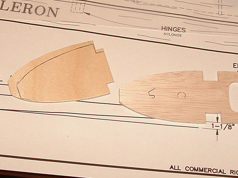

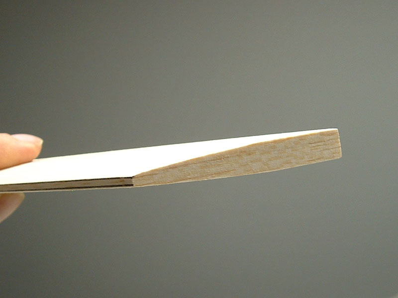

Started out with the Fin/Rudder and Stab/Elevators.
With the pieces glued (CA) the end caps were glued to the Rudder and Elevators and they were all sanded to shape.
I just want to say that I have always really liked the idea of the end caps which greatly reduces the amount of end grain showing.

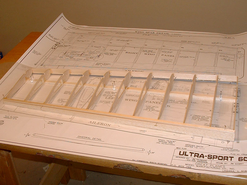

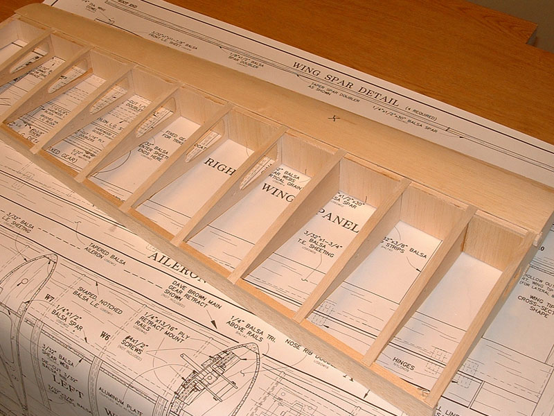

On to the Wing.

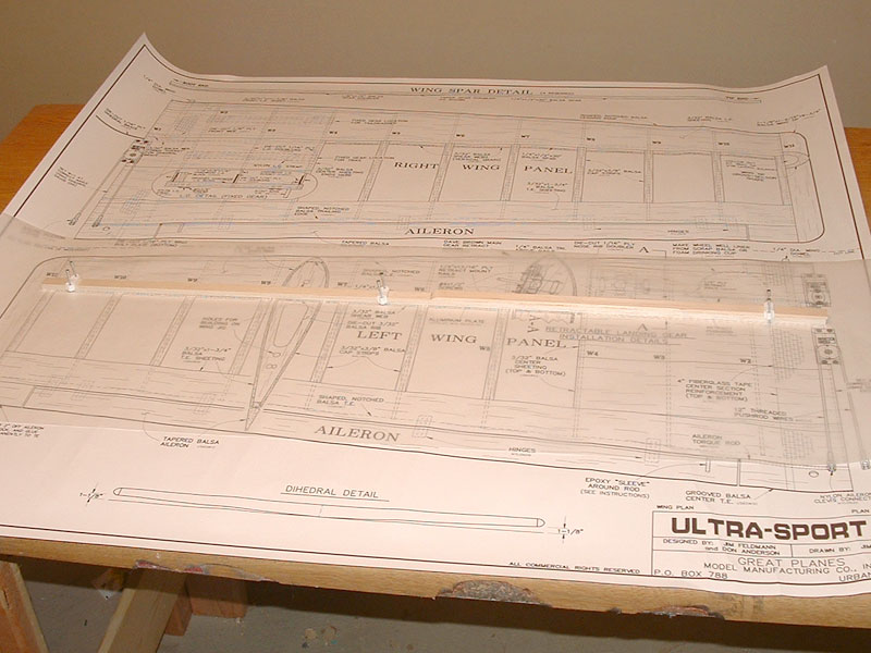

With the spar doublers in place, I nailed a Spar to the workbench (I like these electrical wire clips much better than pins)
Before continuing, since I want to move the retracts out by one bay, I needed to mark the Retract Doubler for the #3 rib to fit the #5 rib.
With that done, the ribs, TE and LE are installed, then with the TE weighted down against the TE Jig, I added the Shear Webs and made the pocket for the Wing Joiner.

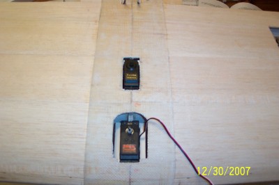

I plan to fully sheet the wing and add flaps, so I had to do things a little out of order from the manual. Namely, I need to sheet the bottom of the wing first so I can route the aileron pushrods.

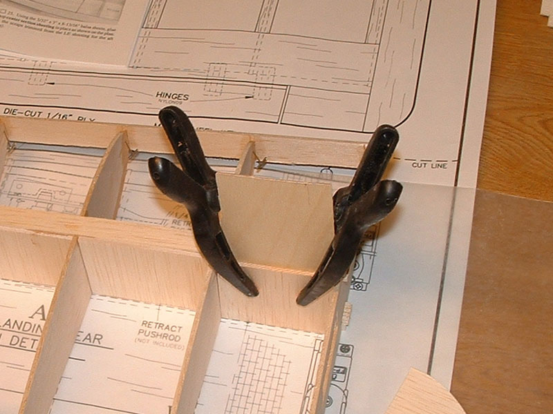

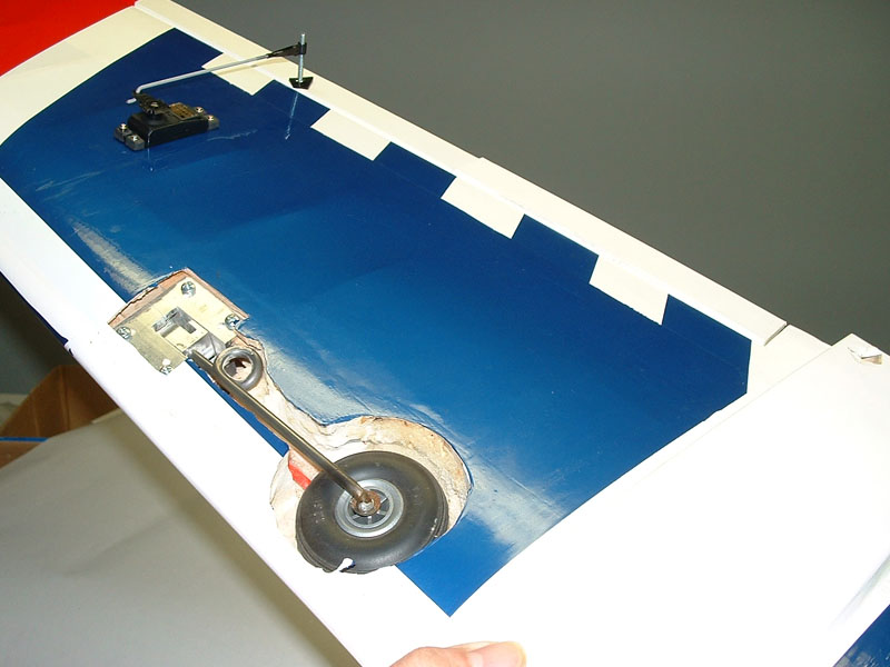

So at this point, I had to install the retract rails.
Again, instead of adding the rib doublers to ribs 3 & 4, I added them to ribs 4 & 5.
Then I placed a retract between the two rails (With a small spacer shim which is just barely visible) and once they were lined up, I tack-glued them together so they would hold their relative position while I installed them.
Once they were epoxied in place, Tri-Stock was added to the undersides and after the epoxy had set, I knocked the braces off.

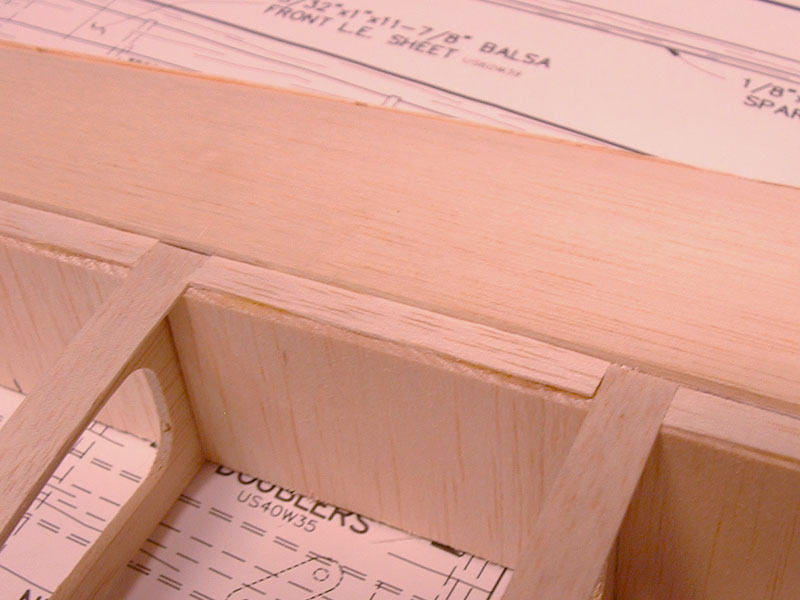

Now the front-bottom sheeting is glued to the leading edge and the forward edges of the ribs.
While the LE dried, I dampened the outside of the sheeting with water and let it sit for a while before continuing.
Once the sheeting was attached to the rest of the rib fronts and spar, I took advantage of the open top to reinforce the glue joints. Too bad you can't do this to the sheeting on the top side too!

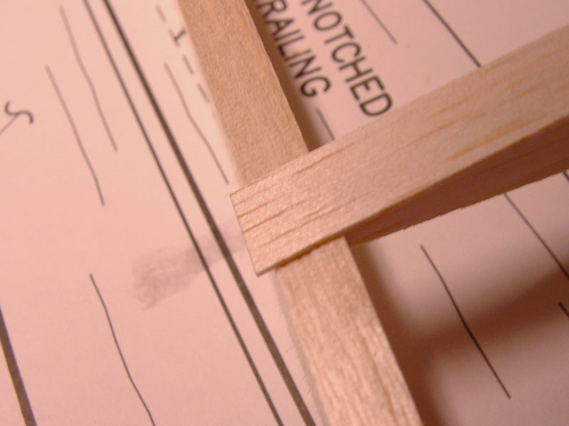

Ok, now I got a little crazy.
I went to the hobby shop last night, and they didn't have any 3/32" sheeting (Except in 2" wide) So I had to make a decision.
I decided that even though it would be a lot more work, I would sheet the rear of the wing with 1/16" sheeting, but to make up for the loss of thickness, I placed some 1/32" strips on all of the rib tops, the spar and the TE.
It was a lot of work, but since it's only a base for the sheeting, none of the cuts had to be precise, so it wasn't too bad.
Also worth mentioning... I glued all of the strips down with wood glue with a drop of CA on the ends and in the middle. This kept the pieces locked in place so no pins were needed. Wood glue alone would require pins or weights, otherwise the 1/32 balsa is so thin that wood glue will cause the strips to warp.

The Cable tacks work great. I've been using them for years. When Ken was here last summer we used them on the trainer we built and he really liked them too. You have to nail a few holes in your building table, but that's why I did the wings on my "other" table (Didn't want holes in the table I use for reviews )
The pics here (Where the cable clamps are used) were on the first wing panel. On the second one, I put them outboard of the ribs, so I only had the center one to deal with when it came time to do the shear webs (I usually do this, but it's been so long since I actually "BUILT" something that I must've just had a brain fart).
Anyway, for the shear webs, you put all of them (that you can get to) in place, then remove the clamps and do those (3 on the first wing panel, but only 1 on the second)

Green River: I move the gear out one rib because to me, they just look too close together. Moving them out gives more ground stability. It also gives a little more room to make the struts longer, but I don't recommend going more than about 1/2" longer than stock or they will bend too easily.

fstevenj, You locate the retract blocks the same way you do in the original location. You can see in the picture above that the rear block goes against the spar, and as long as the two blocks are secured together, the front block will automatically align.
I will soon fill the forward bays with foam, then when the top sheeting is added, the retracts can be put in place and their outline traced on the sheeting so it can be cut. And yes, everything lays below the sheeting.
I'll attach a pic of one of my US40 wings so you can see the final result.

The threads looking great , and man , you build fast !
In your Ultralite wing pic , are those Dubro control horns ? And do you like them ?
