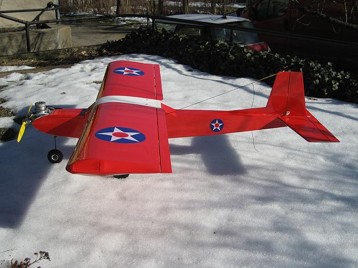

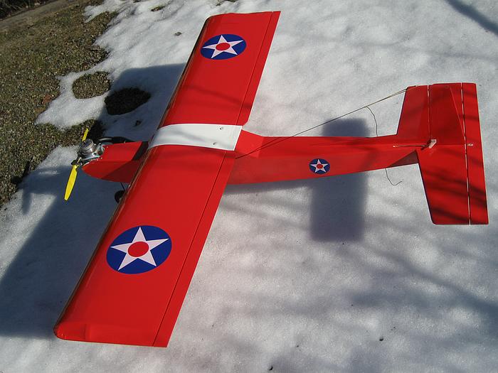

I have flown my original RCM Trainer all summer, and it's real aerobatic, a pattern trainer.
I have a pumped Veco 60 in it and it halls a??
And I have a NIB 60 kit to.
If any one is intrested in the 40 size, my dad has 2 or 3 kits NIB-
It's a great flier.

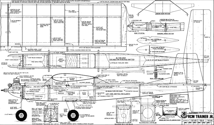

It's definitely on my "to build" list. I enlarged the .40 size plans for a sixty and had them printed out, I just need to start cutting wood.

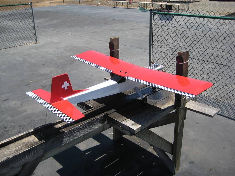

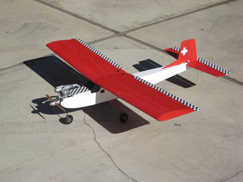

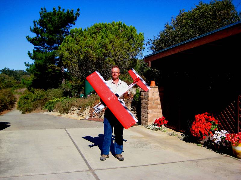

I have been flying my 1982 vintage Bridi trainer 40 that I built in high school for about 6 months now. Every single time I take to the sky with it I'm left awestruck and amazed at just how well this darn thing fly's. To say that it lands like its on rails would be an understatement. There's not a trainer in productioin these days that has the look or the feel in the air that these things do, and this was the standard in the 80's.
What on earth happened while I was away from the hobby for 20 years????????????????????????
Now I wont say it was easy getting it back to flying condition. 25 years in the loft at my parents house left the wood dry and the monokote brittle. I pretty much cut the tail off and rebuilt it from scratch. Seems alot of 2 stroke oil found its way into the seems around the vertical fin and the wood was worse for wear. I remember the fin began to wiggle one day while I was learing to fly it, my fix back then was to drip HOT STUFF (remember that?) around the fin base and keep flying. When it cam loose again I put triangle stock around the fin and under the stab.
So this time when I set it on the bench I was an 18 year certified airline mechanic and licensed pilot. Gave me a completly different perspective on structural repair. I looked at my high school repairs[:-], gave a long *sigh* , said something like " what on earth were you thinking" and started in on the repairs. I sectioned out the last 6 inches of the fuse sides to give the stab a fresh place to rest and added thin plywood doublers to solidify the tail. I then flipped it over and sectioned out the upper deck around the fin area to get rid of the oil soaked wood, added a 1/4 inch doubler plate under the deck and slotted it so that the vertical fine is held by a 7/16th inch deep slot rather than the 3/16 slot that was original. Cut out a new fin to fit the deeper slotted fuse. I belive the Great Planes 40 was redesigned with these mods. Once that was done I added some Monokote and Ultrakote, found a fresh OS .40 FSR on ebay just like the original, dropped in a JR radio with fresh batteries and off I went into the wild blue.
One thing that everyone is amazed at is how blistering FASSSSSSST she is. Crazy FAST for a trainer, yet completely stable at speed. I should mention that I pitched the 1/4 inch plank ailerons and installed 3/8 by 1 and 1/4 tapered aileron stock. They fit like they were made to go there and I think are part of the reason that she's now so fast. It never seemed like it was so quick when I was learning to fly it. I think the old ailerons were much more draggy. Anyway, if your building one I highly recommend the tappered ailerons!!!!
The fully symmetrical airfoiled Bridi and Great Planes trainers are not exactly the same like some folks believe. The GP has one extra rib bay on each wing for a longer wing span and the GP tail has split elevators and full length rudder at the tail. I'm told that mod was for better knife edge flight. The latest offering in a .60 by Bridi has a Semi Symetrical wing on it which doesnt make it a T-60 in my book.
I may retire my old Bridi 40 before something happens to it and just build me another from plans. She flies well but the sentemental side of me cant bare to crash it. My father and I worked on it orginally and he passed away some 20 years ago. I guess I just needed to revisit the memories and see if she really flew as well as I remembered. She does.
Hmmmm, RCM plans service does have the plans to a Trainer 60 and KAOS .60................Where's my credit card?.

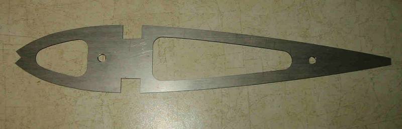

I bought one of the Bridi Krafty 60 kits and it ain't the same.
So,.... I purchased RCM plan #476 RCM Advanced Trainer as well as plan #1327 RCM Advanced Trainer MKII.
Does anyone know what the difference(s) are between these two designs? I haven’t received them yet. I’ve got the MKII plans on CADD and used Mastercam to Wire EDM and wing rib template out of stainless steel.
I added the lightening holes (just a habit from building control line stunt models)
One of the GP Trainer 60's just sold on *bay for $155 and the kitkutter version of the RCM MKII is $200 available in late 2009.......
I'm just going to make templates so i don't have to go through withdrawls again.

WOW! NICE RIB PATTERNS JOHN!!!!!!!!!!

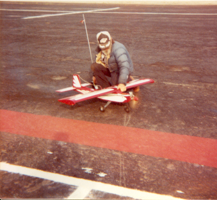

I just found an old photo of Bob Boess, my R/C flight instructor at the RC BEE's field. Bob always had a scratch built, 0 dihedral, highly modified, over powered and tuned piped Trainer 60 at the field. This one was a light ply fuselage, painted by his wife, who was an artist. She painted all his planes including the Christian Eagle biplane that he flew, and sadly crashed after this photo was shot (another student used his radio for a buddy box and reversed the ailerons![&o]). I'm guessing this was photo taken in the winter of 1982, showing the legend doing what he did best. He was the king of touch and goes and slips to landing, and always taught me that anyone can fly a plane but not everyone can land one well. He spent hours perfecting the latter and we watched his every move.
This was also the first day I took my Bridi 40 trainer to the field and Bob took her up for the maiden flight. He was doing the flying, but as I recall, my knees were still knocking!!!

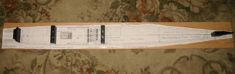

Here are a couple shots of the "soon to be" RCM Adanved Trainer MKII that I've been longing for.....
I bought three sets of plans from RCM and started gathering balsa.
I made this Fuse Jig out of a very flat peice red oak and some Delrin Blocks that I machined. I have a GP Wing Jig for the wing. I'm still making former templates out of aluminum sheet stock.
The fuse is built upside down on the jig. It's a perfect rectangle between formers F2 and F3. It ought to make a nice square Fuselage. Making fixtures to manufacture your models is probably overkill but I'm sure that once I'm finished
there will be others. I've found that once you set-up to make the first part you can make a couple extras just as easy so I'm thinking ahead. After the first one is done I want to build a "woody" like Cafeen Mans Rustick. Maybe inlay some very thin dark venier for trim.
I'll machine the 2* degree right and down thrust onto the engine mount.
One of the reasons that I like this design is the landing gear. With the Flutes Tooling dual strut nose gear and aluminum main held on with "break-away" nylon screws it should hold up pretty well to my limited flying (landing) abilities.
I've got a New HB 61 PDP waiting for this model.
