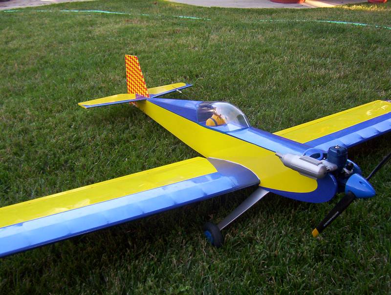

Old 08-15-2008 | 11:44 PM
saramos's Avatar
Joined: Dec 2003
Posts: 3,058
From: Northridge, CA
Default RE: Another 4* question

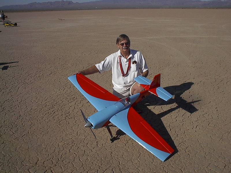

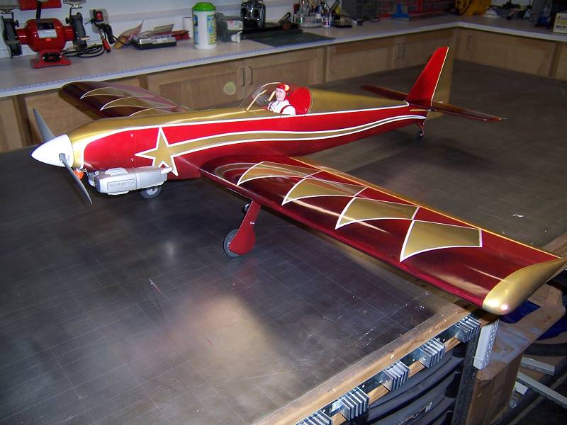

4 *s can be built a lot of different ways. Here's a photo of my first one, pretty much stock. And a photo of my current one, highly modified.
Scott

Old 08-16-2008 | 07:24 AM
Joined: Feb 2004
Posts: 262
From: Mississauga, ON, CANADA
I am just putting the finishing touches on my 4 * 60. I am doing the same thing you are, progressing to a bigger plane.
I am flying a PT-40 trainer now, and have some very well with it, next moving to the low wing tail dragger 4*, then to a .40 Corsair I have built, next will be a 90" Chipmunk with a 31 cc gas motor that was my project over the past two winters. From there I have not given it much thought, but maybe a big war bird.
I think it is all a progression as you get into more complex and scale aircraft.

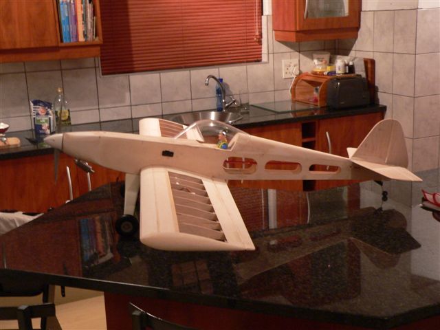

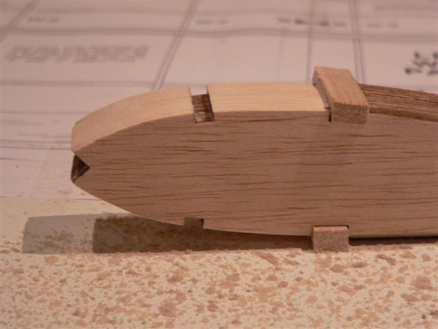

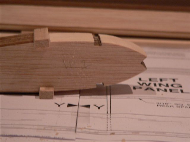

If you decide to sheet the leading edge then this is how I did mine.
Using the W1 ribs as templates I sandwiched all the W2 ribs between them. I then used two short pieces of balsa to alighn all the ribs in the slots for the spars. Then just sand the W2 ribs until they have the same profile as the W1 ribs. Now you can sheet up to the main spar. If you cut the notch for the balsa spar deeper then you would be able to do this all wth one piece. I sheeted in two sections leading edge to balsa spar then balsa spar to main spar.
Why not give it a go - if it doesn't help the 4* it won't harm it either and it will help develop your sheeting skills.

Andrew, that really is A nice build and you look like you did the mods I wanted to do. I'm teaching my 13 year old student to build with this kit so I kept it simple for him.
As I said, the wing wasn't any big deal one way or the other but I sure wish now I would have done the turttle deck like that.
That sure came out nice!!!

Andrew: Great way to do that and well done by you. Works fine for barn door wing but not quite as well for wings with tapers. Tapered wings will probably benefit by cap strippng ribs beyond the leading edge sheeting, for simplicity.

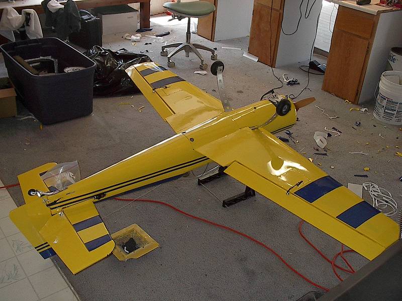

Sheeting, no problem, sheeting and glassing, no problem. Planking??? Well, some things should be left alone. I can get away with it but don't hide my giant tub of filler.
