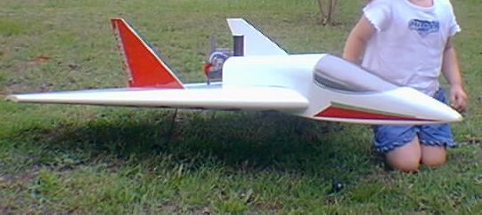

Default Enforcer
The enforcer is a great flying plane, even in the wind.
I didn't like the canopy that came with it either, so I
put a laker canopy on it, and stretched out the fins.
What do you think?

Ok,Ralph...Very nice looker..Sharp as a tack litteraly.

PS: Ralph - Beautiful. wr.
