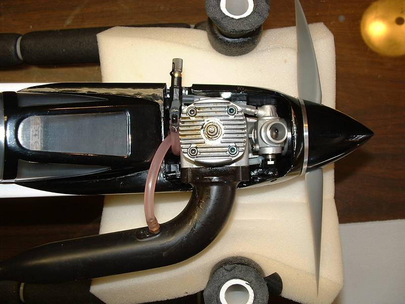

The .25 should be just about right. This is one of those little planes that people tend to do engine over kill with. I built one for a friend for racing with a WEBRA .55 in it. You think wolf had a tight engine fit in his. I had to mount the engine, build the cowl around it then cut enough away so the engine could be removed if needed. It came out OK but it was a lot of work to get that engine in there. Then came the CG problem!!! When the pilot did the maiden on that little buzz bomb all he could say was, mite twitchy!!! Took a while for his knees to quit kinocking too.

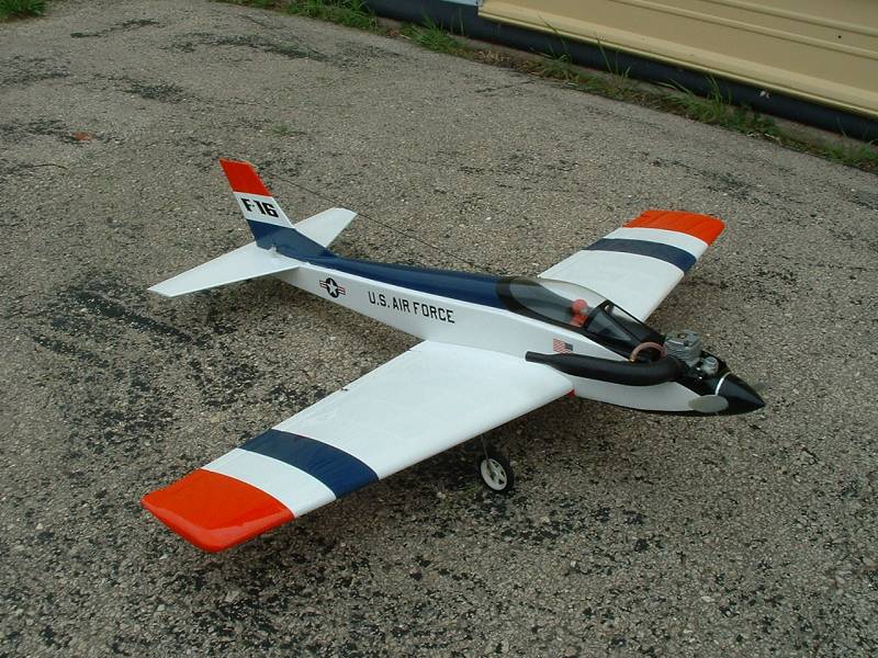

I shoe horned a OS46 in, Grey Beard helped me with making it a tail dragger. This little plane would probably do fine with a hot 25, would be more balanced and light. BUT-a 36 to 46 or even that Webra 55-well smokin!! Gene you never said how that plane flies with the Webra??

Mark, it is a mite twitchy!!!!!! The .55 does tend to over power it a little. That little plane lifted off in a couple of feet and went straight up, needed a little trim then it took a bit of getting used to. Glad I'm not the pilot. My fear was it would go real fast on the straight and not turn around the pylons but just skid. It turned very well though. This is the first race plane I have built for this pilot that he ever has put EXPO in the radio. He takes off and lands on high rates but fly's on low rates. I did talk him into using the muffler like you have to remove some of that weight up front. The plane fully loaded came in at 3 pounds until I installed the engine then it hit 4 pounds. { I think, been a while} If I built one for me I wouldn't go any bigger then a .32, I say that because I have several of them and a few .25s under my bench doing nothing.

I agree Gene, I would do the same-32 or 36. Mine came in at 3lb-5 1/2 oz so it's within limits. I take off and land on high rates and fly on low just like your bud. Amazing little plane-Thanks again for the help with the tail dragger conversion.
