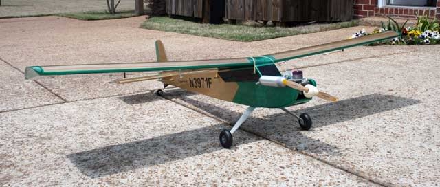

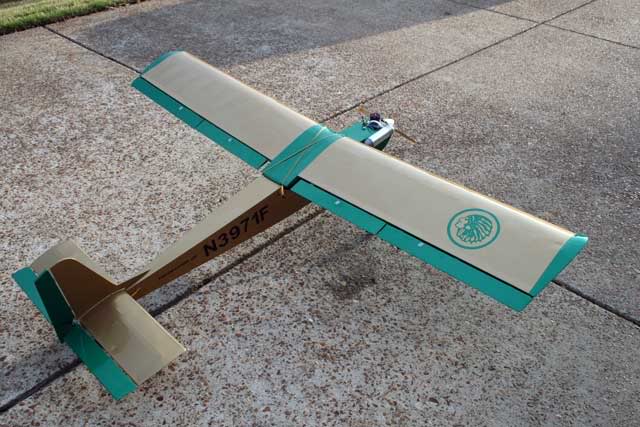

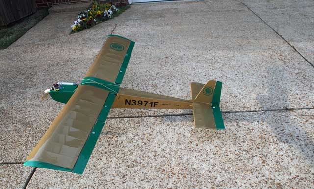

My father and I just finished building and covering a tele 40 - fun build and ready to fly it (been to windy). Covered in his high school colors and I laser cut his mascot out of monokote and ironed it on the wing and tail. Wasn't sure how it would cut, but after a bit of a learning curve the cuts turn out perfect every time. Way, way more detail than by hand and sticks better than any sticker or decal. Just lay a piece of old cotton bed sheet on the logo and iron it. Works great for multi layered color logos as well.

Don, I use a Epilog Helix 45 watt laser. I do marble laser engraving and also robotic chassis cutting for the DIY robotic community; [link=http://www.cascabots.com]cascabots[/link] is the site name. As far as alignment, it was pretty easy to just eyeball it - placed the ring where I wanted it and ironed it on, and then placed the logo centered inside of it; monokote "clings" so it's easy to line everything up.

Wouldn't be an issue :-) Vector formats are the way to go because they are so seamless to resize - as an example, the logo on the wing is a 6" diameter and the one on the tail is 2". The size change took all of 10 seconds. Converting art to vector isn't hard either - just takes a bit of time.
The limitation is that your art needs to be silhouette; details can be added with permanent marker (think nose art with facial features) if you need it. The logo on the Telemaster is a silhouette. The laser can mark extreme details in hard materials and excels at cutting softer ones.
