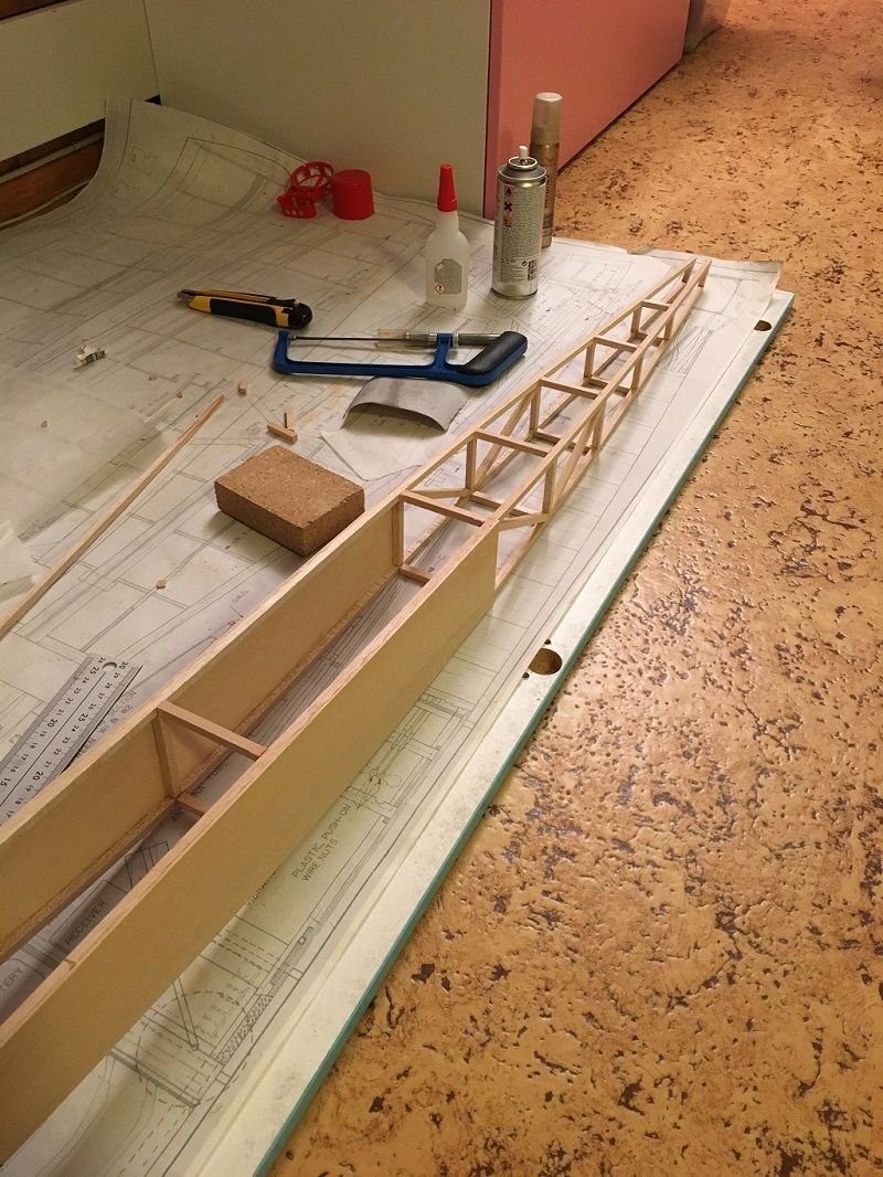

Made some progress today... The original fuselage looked like a banana after being left in the shed for years. I decided to build a new one from sticks. I hope it will work. Still quite a few hours of building before it's finished, but I'm closer than ever

Old 01-11-2020, 06:05 AM

That single wheel makes a lot of sense for a Butterfly which I remember always hand launching. Makes the plane even lighter. Good luck getting it back down!

Interesting wheel placement. It should work for landing if you're running electric. I'm not seeing it would have much prop clearance for conventional take-off, so I'm guessing the intention is to hand launch. Although landing these things is very easy with conventional landing gear (although it does take quite a long slow final approach), I'm curious how that center wheel will work.
This is the first Butterfly I've seen with a landing wheel like that... It's pretty cool indeed.

DGrant and thailazer, you are right - I am going to hand launch the plane and use the center wheel for landing only. I used the advanced method of Looks About Right to decide where to place the wheel, so I hope it will work. Ideally it should balance and roll out on the wheel after landing ... time will show.
Today I finished the fuselage! I'm using a Turnigy 2217-20 860 for power and will put enough LiPo in the nose to get the CG right. Looks like I'll end up around 3300 mAh
