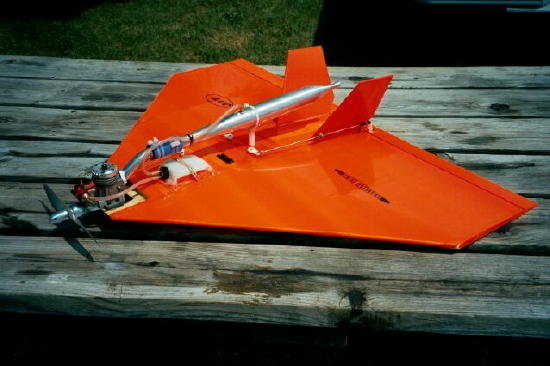

the dust builds FAST, there isnt much there, I built mine one day, covered and finished it off the next, two days box to flight!
No landing gear, its a belly lander. It is fast with a good engine on it, put a .50 on it! Ive got a BB.46 and its pretty fast! scares some at the field on flyby's!
