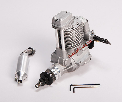

This will be my last question of the day I promise. I just found really cheap 4 stroke motors on hobbyking.com. I think I already found the motor that I want but not sure about ASP motors.
Below is a link let me know what you think!!!!!!! I want to be able to hover if I want to.

Concerning your engine choice, the ASP series is the same engine as the Magnums with the ASP name. I have several Magnums including the one you listed. I have always been very pleased with mine. Very dependable and easy to start. The outside finish is not as good as an OS or Saito but that's not important to me. I have flown the .91fs now for 2 years as my weekly flyer without issue and if I were building this plane, that's the engine I'd use although it may or may not hover it depending on how heavy you buld it.

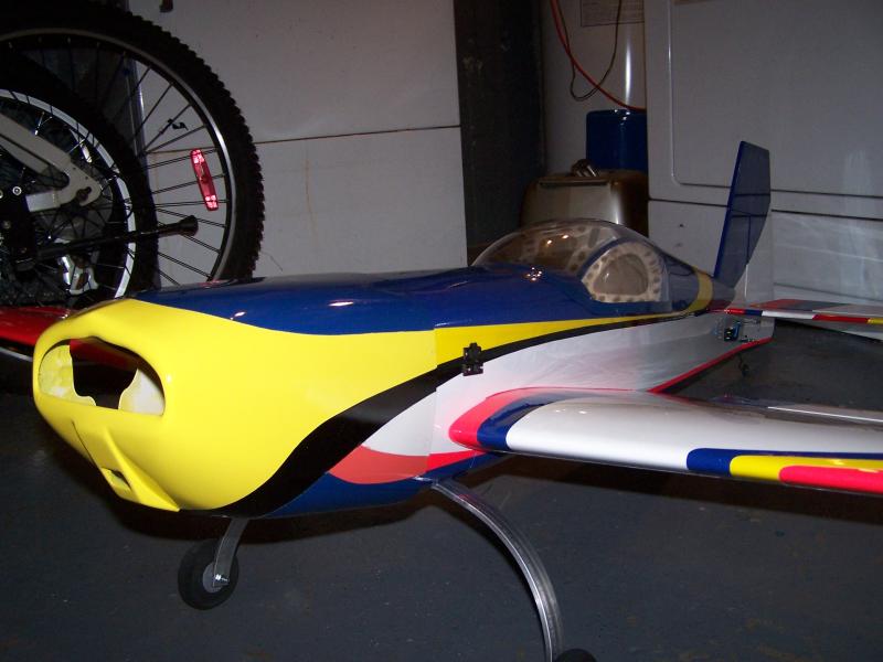

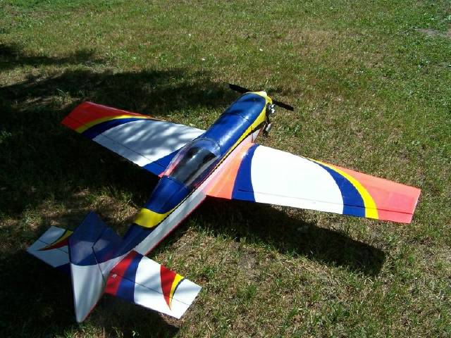

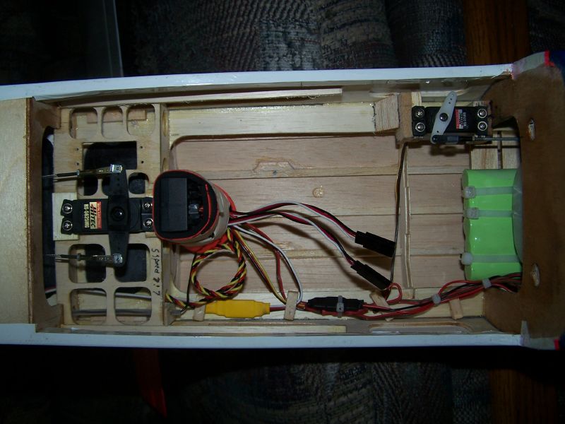

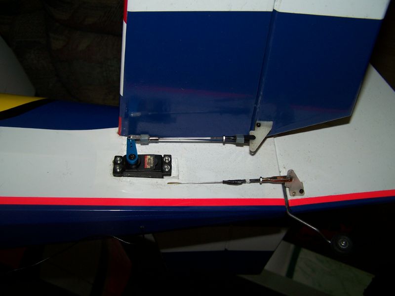

I'm running a pumped Saito 100 on 30% turning a ma 15-6 at 10,000 rpm on my Gp Extra 300s. Light and good power more than enough to hover. But I think the best choice would be a OS 120ax with a pitts muffler, u would have space shuttle blastout from a hover and only need 15% to do it... Cheap right here in canada and usa... I'm running a 120ax on my goldberg ultimate and i love this engine, very reliable and LOADS of power.
There are a few mods that really help this plane if yer interested.
I got mine down to 7.4lbs. I'm running hitec mini digitals all round. Rudder is pull-pull 5625. all on 6v

The asp91 will not hover this plane even on 30% nitro as well as getting it as light as mine. When I ran my saito 100 on 15% on this plane it was terrible, it only became fun when I started using 30%... Don't cheap out on the engine. If you are going to go with a 4 cycle go with a 120 size or bigger motor. This plane flies best the lightest you can get it and that includes a light motor with a lot of power, You can't beat the 120ax for this. I have a magnum 91 (same as the asp 91), ran it in my twist 60 was very let down by the power. replaced it with the saito 100, BIG differance! But remeber the Saito 100 is good in this plane if you want to run higher nitro (last I checked $37/gallon in canada)
Don't get me wrong the asp91 is probably a good engine but it is something that I would put on a 40 size plane... Besides magnums and other knock off engines like the asp yer looking at are heavy. My magnum 1.20 is 34 oz (2.1 pounds!) These are great for war birds not extras.
Best bang forthebuck, go with the 120ax u won't be sorry... Or even the new os 95ax.
ASP FS91AR Four Stroke Glow Engine
Weight: 640g (640 g = 22.5753 oz)
OS120ax ( http://www.greathobbies.com/producti...od_id=OSM120AX )
Weight: 22.82 oz
