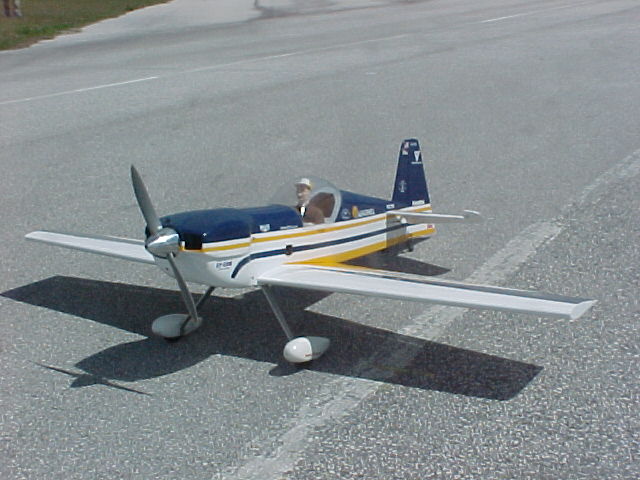

Yup, Badge is right! I got mine from Stan's via TNT Landinggear too!! I use TNT Gear for some of my "sport" stuff so I got them togather to save S&H charges.
One thing you may want to do to the Cap is to reinforce the gear mount.(I speak from experience!) I made a bridge of 1/8" light ply going over the mounting plate connecting to the wing mount former, and going a couple of inches foward the mounting plate and epoxied to the side formers. I then put a couple of 3/8" balsa triangle pieces on top of the gear mount and epoxied to the bridge. I since have had one rough landing (bent the gear clean up to the wing level!) but NO damage to the mount at all.
I suggest using a good quality finishing resin for all plywood(Z-Poxy). It is thin, light and will soak into the wood and give you added strenght.
Best of luck, and thanks for the compliments on my "baby",

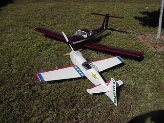

My GP's Cap is one of the best flying planes that I have flown, I am thinking of building another one and incorporating some improvements such as a pull-pull rudder and two elevator servo's (makes it easier to get that 40 degrees of deflection for 3D). My current Cap airframe has a good year and a half of wild flying on it, it's still quite airworthy. The plane is large for a .40 size craft, see picture, GP's .40 Cap and a 1/4 scale Piper Tomahawk.

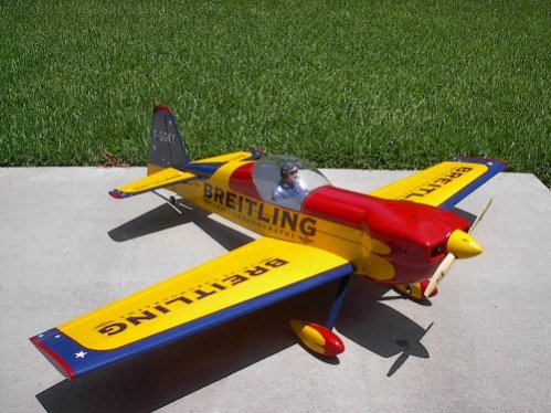

Just back from the field after the first flight of my GP Cap (with an O.S. .70 four-stroke).
I was extremely nervous (C.G. Tiger 2 is the only plane I had flown before this one) but there was really no need-- this thing flies beautifully! Gear mounted in stock position had absolutely no tendency to nose-over. Take-off at less than half-throttle (mind you, I've only had three tanks of fuel through the engine... I cannot wait for full break-in!!). A few clicks of right aileron and I was doing loops, rolls, inverted flight and hammer-heads on my first flight. For landing the thing slowed to a crawl (no snapping tendencies here!) and touched-down perfectly! I've had three flights now and cannot wait for more!
I now understand why so many people say that this plane "flies large." It just feels so stable in the air.
What an amazing aircraft! Mrs. Cross-- you're husband did a fine job with this one!

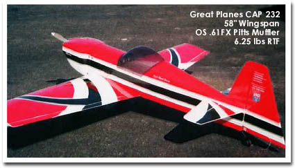

This is my GP CAP. I wasnt really interested in a small CAP, I figured it would be heavy & snappy. Through a bunch of winter trades I ended up with this kit partially built, a .61FX and a handful of very good servos. I bought a PITTS muffler and treated it to a little covering and VIOLA!
I am in search of 40 size CAP nirvana with this one. I now have the CG about 1/2" aft of plan, some right thrust and some down thrust. It flies a little bit too much like a small CAP, but it does fly good. Real good.
Build time was about three weeks. Fiberglass cowl from Stans. No wheel pants
