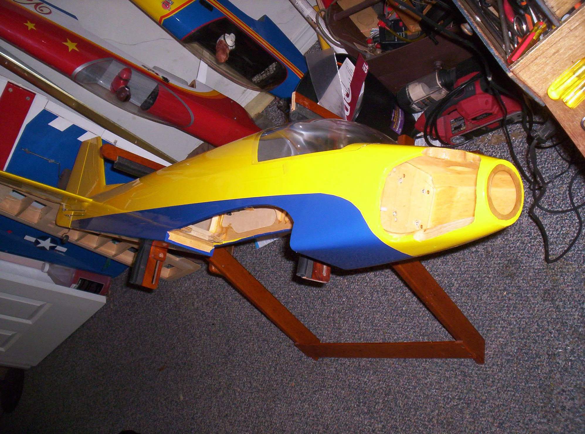

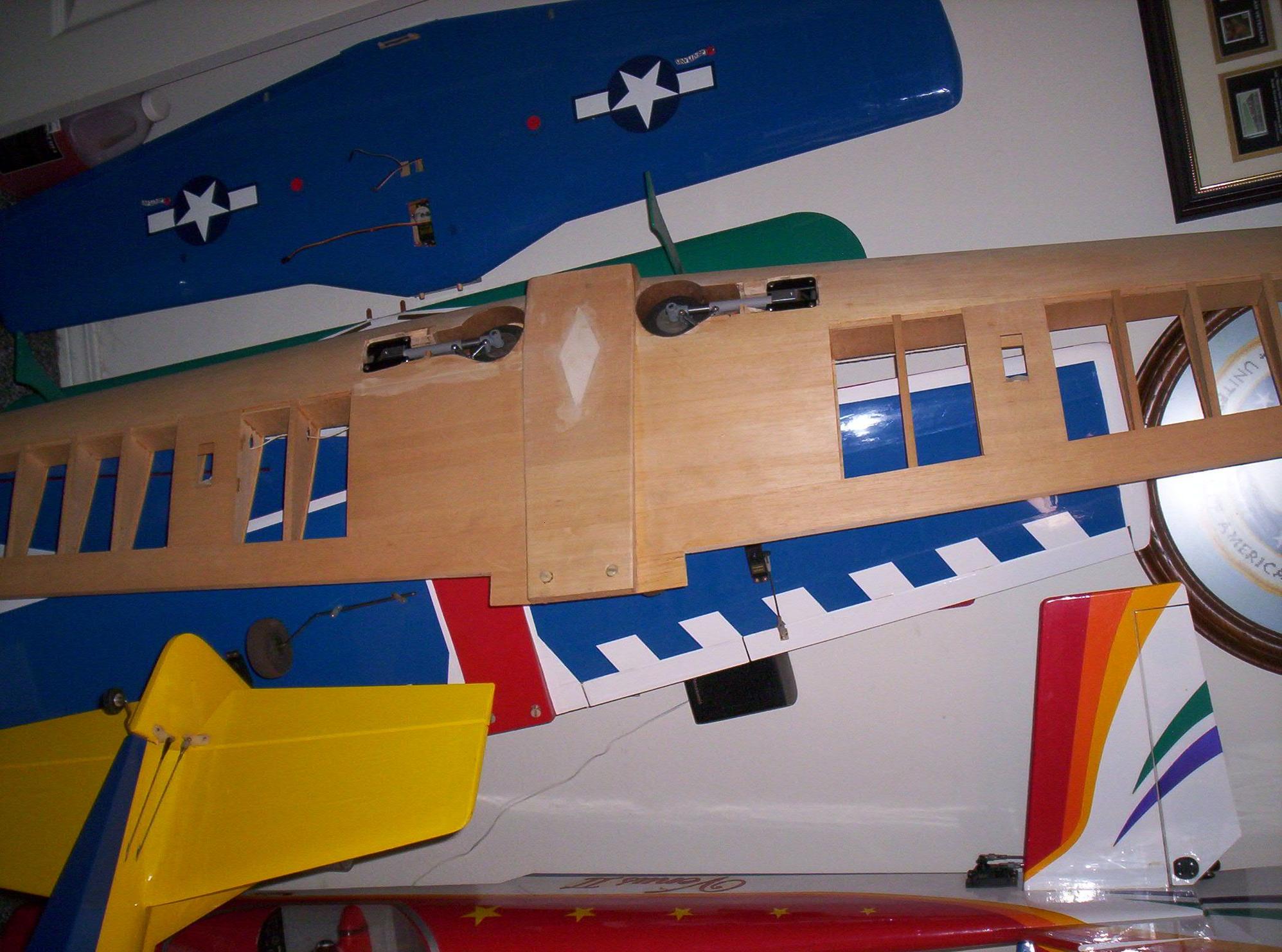

The next US is a 1000 the seller told me that the person that was in the process of building the plane past away and what you see is what I bought the fuse was already covered but was missing the canopy and the push rods to the tail feathers and motor mount and ailerons. I told the seller that I'm not worried about those things I most likely have them in my parts box which I did. The wing did have some hangar rash but some sanding and some cutting all that was gone. What drawn me to this plane is that the builder had already made the progress to install retracts so I already have a set of Robart electric retracts to install in this thing so I have everything I need to complete this plane except I did have to go to ebay and buy me a canopy but that is a must to finish this plane. As of this writing I'm waiting for the epoxy to cure in the tank compartment and the engine compartment so next all I have to do is cover the wing and fuel proof the wheel wells install the tank and finalize the balance. I'm going to use a OS 1.20 AX on this plane I really think this engine will make this plane very lively.

If anyone is asking about the wheel wells I used cardboard from the box that you buy a pack of soda. If you take your time the cardboard will be cut to fit from the surface of the sheeting down to the other side of the sheeting. Monokote does stick to the cardboard and then when you fuel proof the wheel wells you then glue down the covering. I will post pictures of the final look here shortly.
