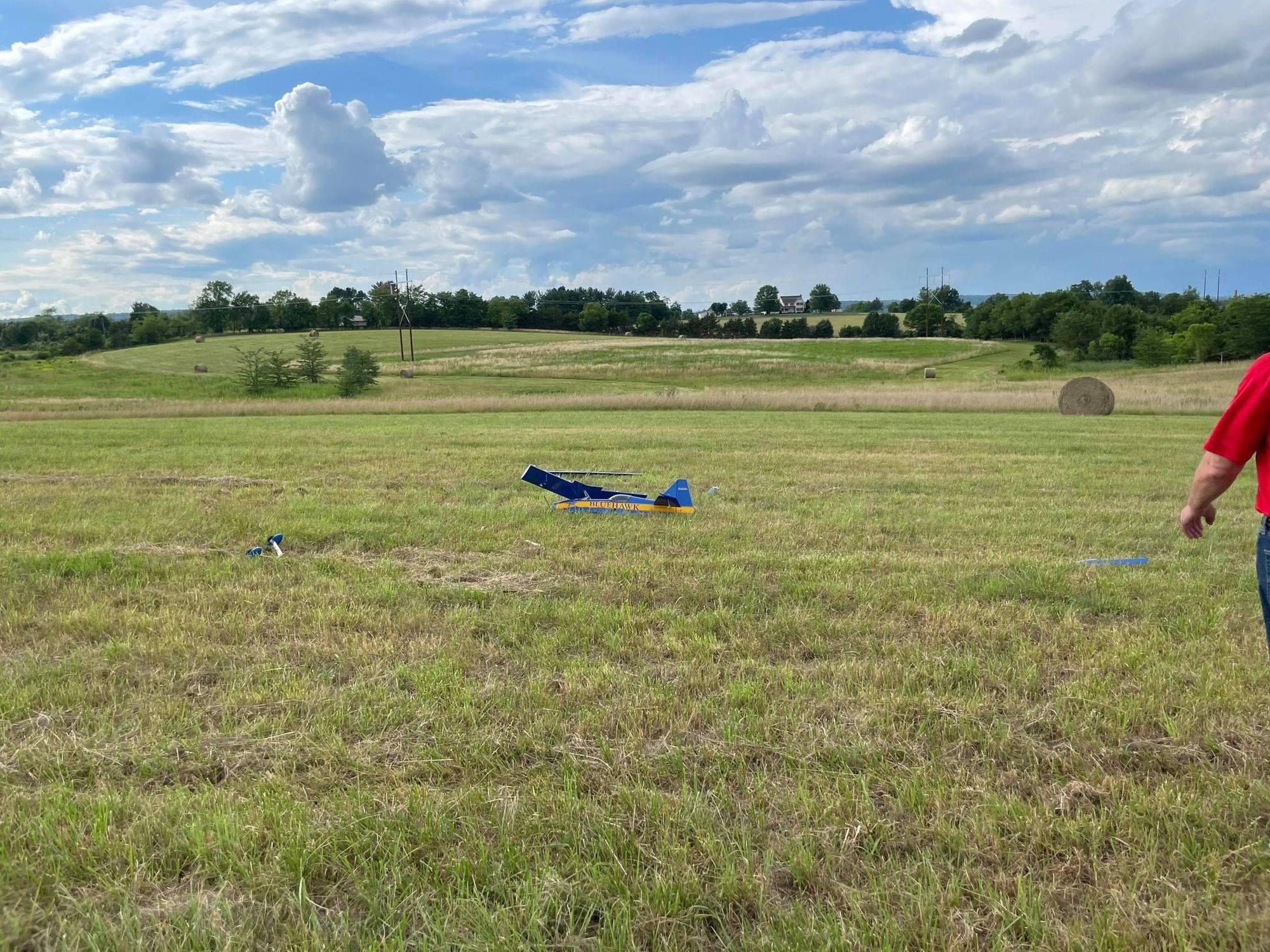

Default Cumulus Granite - radio failure killed my Ultimate
Today I took the Ultimate out for only my second flight of her. Everything checked in preflight. Engine was strong (Saito 150) and controls normal. Taxi around ok. Takeoff run straight and true - liftoff perfect. On my first turn after takeoff I noticed sluggishness in response. I turned downwind and intended to land. Then the nose started to dip, and no response from elevator input. Chopped throttle and I think I heard it cut - down it went. Crunch. When I got to it it appeared to have impacted right side up but nose down. Fuse broke in front of cockpit but wings both survived. When I got back to the line and my Tx, I tried the controls - all working. Mystery.

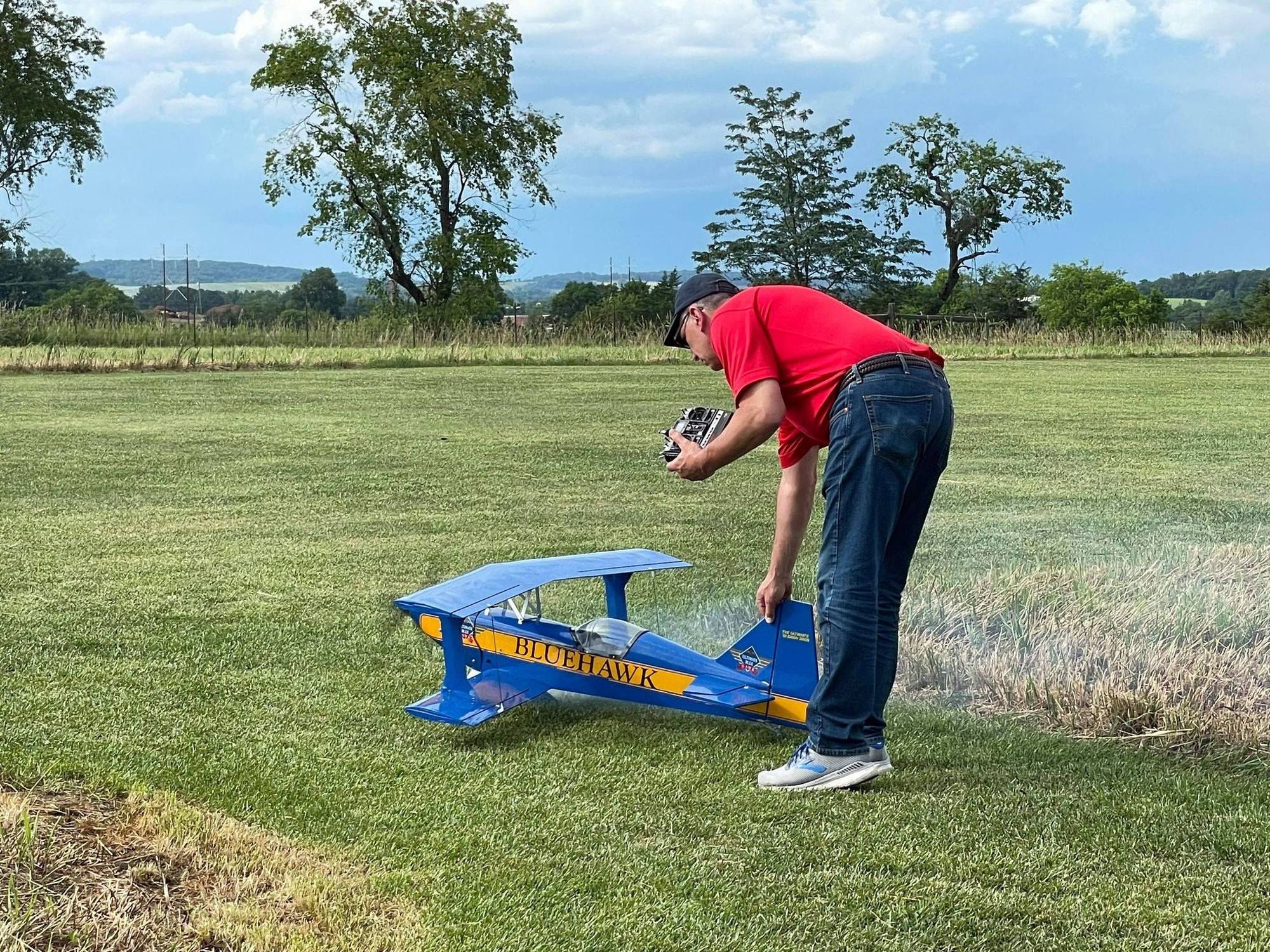

Location: Fishersville, VA
Posts: 121
Appreciate that. The batteries were less than 6 months old, and I had cycled them recently and got over 2100 mah out of them. Still well within performance expectations of them, under load. Power is (or was) Saito 150, nitro, so no BEC used. I am suspecting my 2.4 module/link as an issue. Although I had a good range check in accordance with the manufacturer's procedure, I believe the antenna orientation may have had an impact on the signal. My radio has a 2.4ghz module in place of the regular 72mhz module. I've not had problems with it before, but have, on rare occasion, noticed that when the antenna is pointed directly at the plane, I would, again rarely, experience some "glitchyness" or momentary loss of signal - or that's what it felt like. Have never been able to duplicate it on purpose. I may do some experimentation with this set up on an old trainer I have -
Here's the short video of the mishap: =AZWlLKHDh8mGHgKFSWMZ26xKyGZPBE64IlvSylBqLoCHYR0CP Rcai3ZnUpOpmEVXJgVpHymDQEQkxIrmKQWhAr_LZAapkCpQrgb WCpT3LTZwlPV4DRsZgGJltYA9bmuED5inqYx4Eq4bFTZfT04an uS65Q3orvIQSczgf4Xhoz-8zQI19kTL5PAP3ijxQxeTuNQ&__tn__=-UK-R]Ultimate Takeoff and Crash
The "Before" photo
The "After" photo of the remains. Landed flat with wings off, but intact. Fuse broke just forward of the cabanes at the firewall.
Don't point the antenna at the receiver. More than likely that can cause a LOS. Imagine a donut, thats your radio signal. Put the antenna in the "hole" of the donut sticking straight up. the signal is great anywhere in the donut, but fades drastically at the top or bottom of the hole. You want the side of the antenna facing the plane at all times, which is why 2.4 antennas have joints and can swivel. In all cases you want the 2.4 antenna tip pointing straight up. The way you described the flight is a perfect case of Loss of Signal. It is kind of strange the Ultimate was affected, but a lot also depends on how you have the receivers antenna(s) oriented too. If it has two, one should be vertical, the other horizontal to provide maximum reception. 72Mhz have the very long string antenna, and work quite different from 2.4, and antenna orientation is pretty much irrelevant. 2.4 uses tight beam patterns so antenna orientation is critical to get the best reception.
Looks like you have an easy repair, have it back up in no time. Imagine a 53 pound, 16 foot WS Rascal with radio issues. Now THAT was scary.

Navy_Flier I see your Ultimate is the RTF version, just like mine! I also notice that your radio is a Futaba Field Force 7, of which I also own one (mine is T7UAP Super) updated to 2.4Ghz with an original Futaba S-FHSS 2.4Ghz module.
Please, read carefully "acdii" spot on explanation. In fact I would only add that if your module accepts pointing the antenna staright down to the floor, that is the best position. If not possible, straight up as suggested by "acdii" (but you must avoid flying overhead!) or folded to one side are the best options.
My comment on the BEC is not related to the power systems as BECs are offered aside electronic speed controls (many call them U-BECs) as a receiver/servos power system, so you may use a 2S Li-Fe or Li-Po pack as battery but the BEC powers with selectable 5,0 or 6,0 volts. Main problem is many, many such BECs are offered with very interesting current capabilities that, simply, they do nor met.
It is a very good idea to gain experience on the 2.4Ghz technology and capabilities with the old trainer and sincerely hope you decide repairing the Ultimate!
