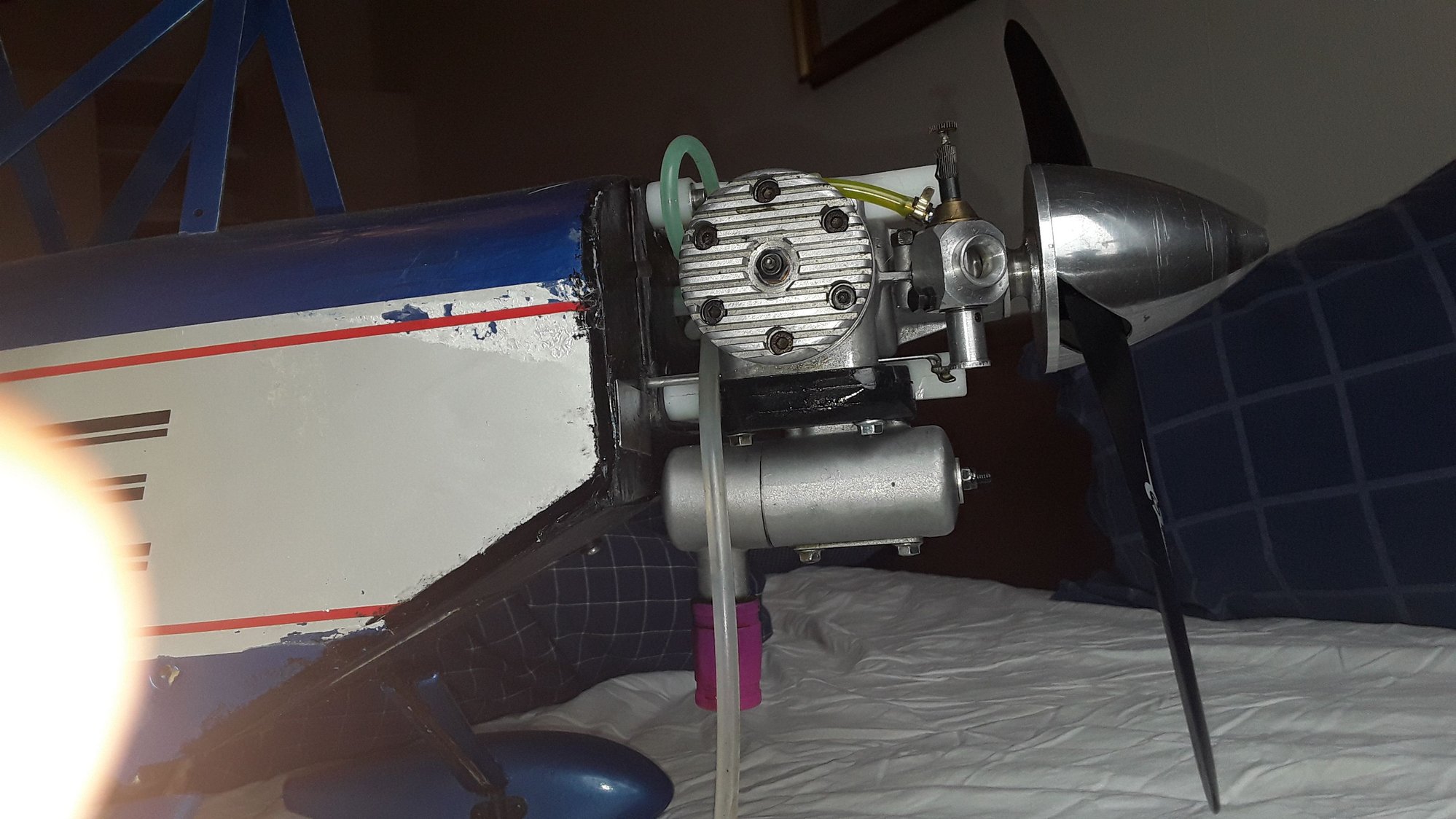

Hi everyone .
As a new owner I finally found a relevant thread !! Have not read all the posts yet :-)
Recently I came across a Ultimate, at first I had no clue of the plane, but as I was offered it almost for free I gave it a new home.
The plane needs some care and I have started with test fitting a OS FS91iiP (pumped),, Looking at the cowl, It looks like this plane have had several different engines
in its past career.. Will a OS 91 be enough for reasonable performance ? I have an old refurbished Webra 1.20 (two stroke) but not sure I like the sound and weight of it.

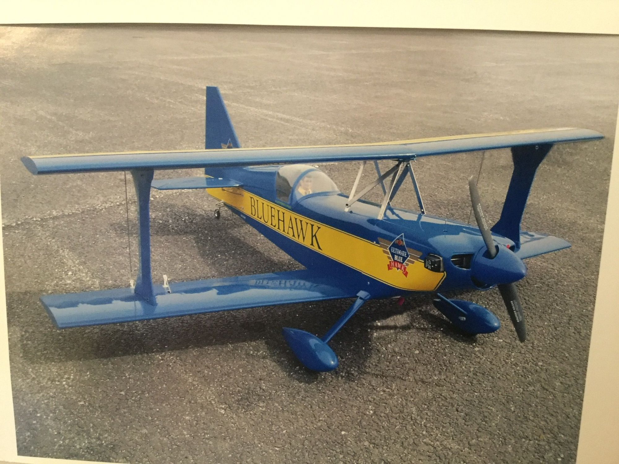

Hi, and congrats on a bargain!
I had an OS FS-91 in my first Ultimate.
It was a lightweight combo that flew great. Big loops and beautiful hammerheads. NOT unlimited verticals. Just enough power for IMAC Sportsmann in low winds I think. Basic is no problem.
If you want unlimited verticals you need the 1.20.
Here is a pic of mine.

I will go with the OS91 to begin with and go from there.. What prop size did you use on yours ?

Starting to suspect that the OS FS91 will give me CG problems,, unless I want to mount a lot of led up front (I dont like ballast)
Briefly checking the CG I will need 150-200 gram up front, (7-8 ounces)
What I understand the CG range is 25mm and I would like to start with forward point.
How and what is the best procedure checking the CG on this model ?

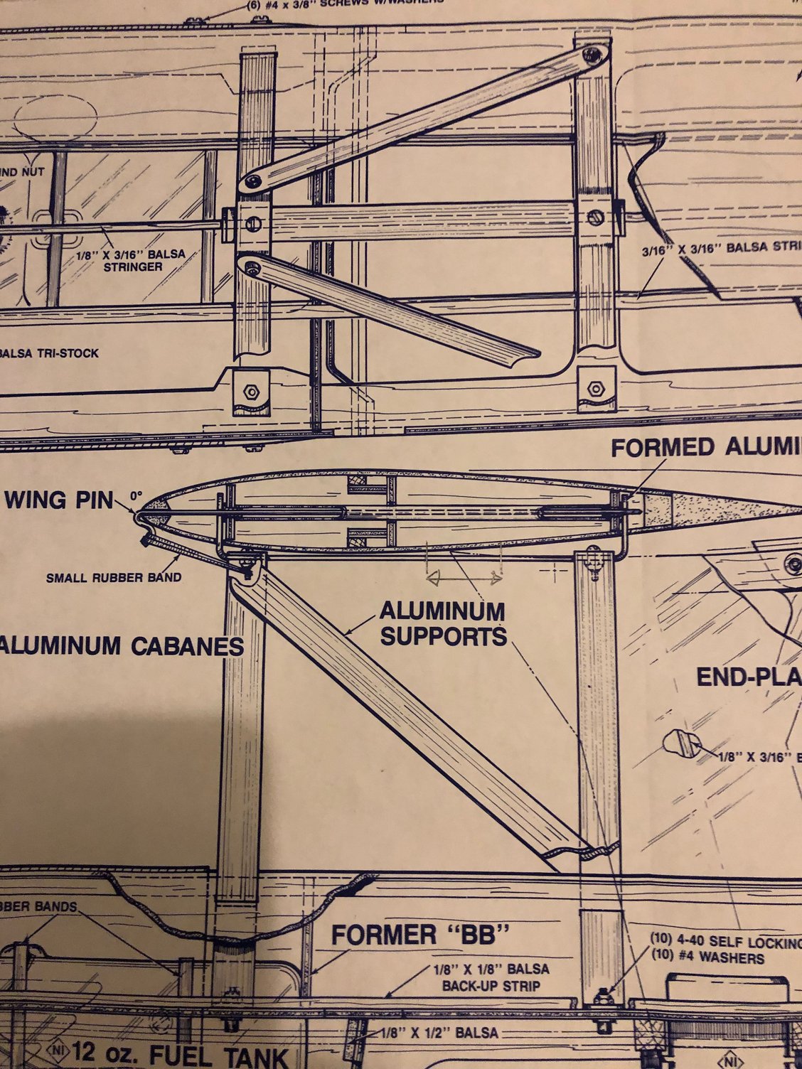

#2383
I just put a piece of masking tape around the horizontal bar between the cabane struts after I transfered the CG up from the lower wing.
If you measure from the front edge of the front cabane the CG range is 70-95mm. Then you can just feel for the tape and lift the plane with your finger. This plane quite CG tolerant so if you start at the foremost point you should be safe. Since english is not my first language I have attached a picture to clear things up.
#2384
Your English is perfectly understandable...
I use Swenglish... the Swedish version of English :-)
Yes I did the same,, transferring the CG from the drawing, I was considering if there is any other and more precise way.?
I will probably try to confirm the CG with a Vanessa method and try to minimize the need of ballast in the front.
At this point the weight is 3.9kg and I am not sure if I can go higher considering my "small" engine.

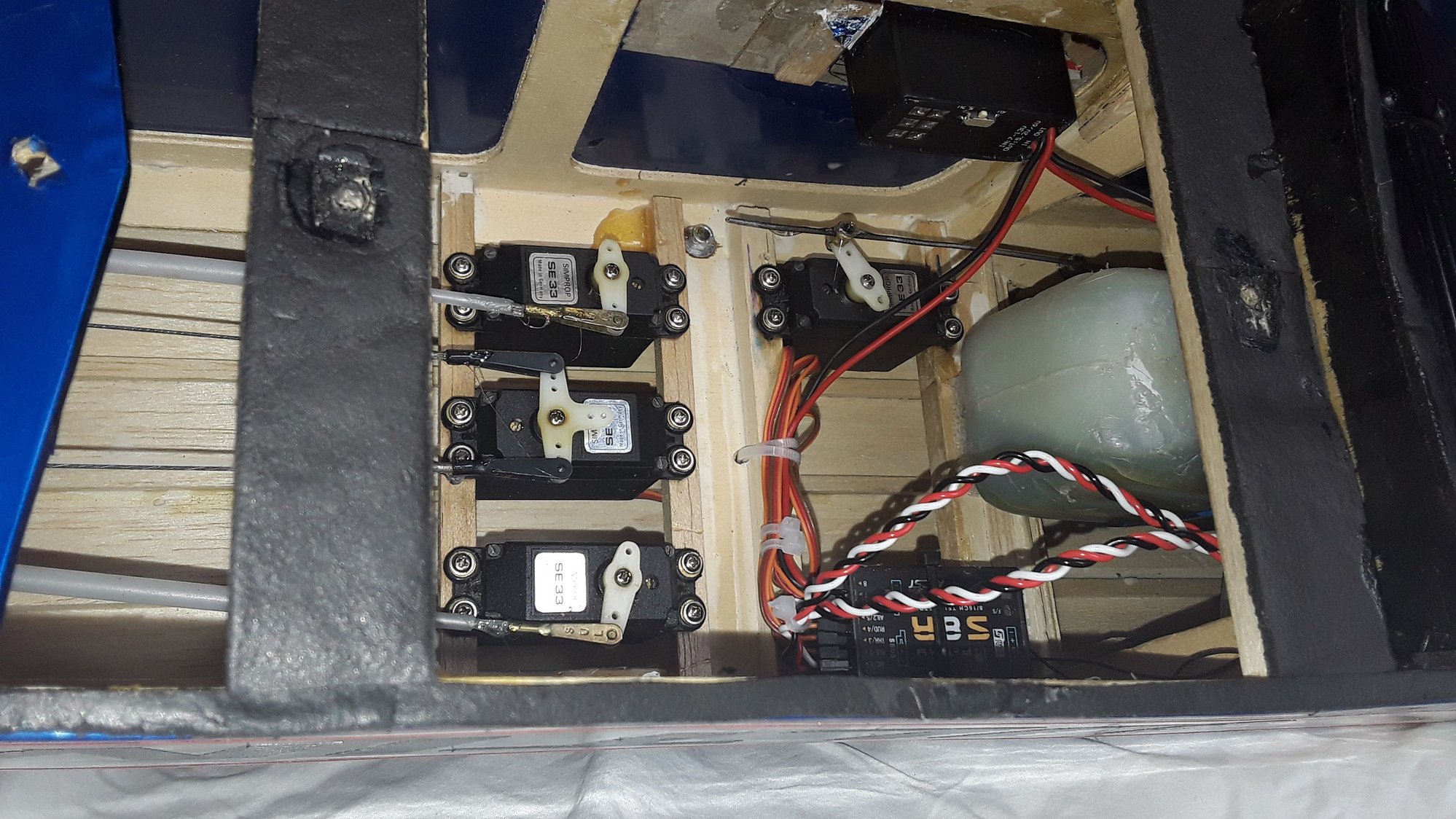

Have you checked the CG on it yet? Mine is nose heavy (kit built) when using a Saito 125 fitted with a slimline pitts style muffler with a weight very similar to the OS FS90ii. The saito is 618g on its own. The RX pack (4 cell 2400mha) is mounted against the inside of the firewall and I've got two 25g servos in the tail for each elevator. Fuel tank is mounted on CG.
- Thomas
- Thomas
Note that my model is old, probably one from the first batch 30 years ago. I got it almost for free
My full size servos are slightly behind CG (2 for elevator, 1 for rudder and wing servos in lower wing for aileron, finally one for throttle)
The cowl is a heavy glasfibre with several "patches" however the model have never been repaired from what I can se,, I suspect that the model have had several different engines in the past.
I am not sure but the wood might be different or maybe the covering is heavy. I was just coming from my garage picking up my refurbished Webra 1.20 speed.

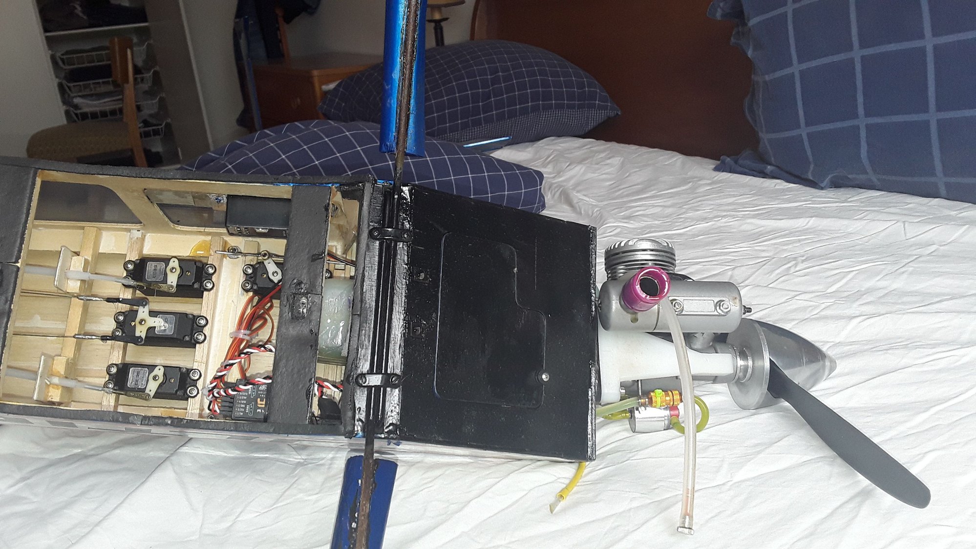

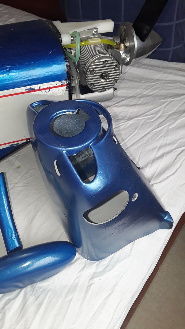

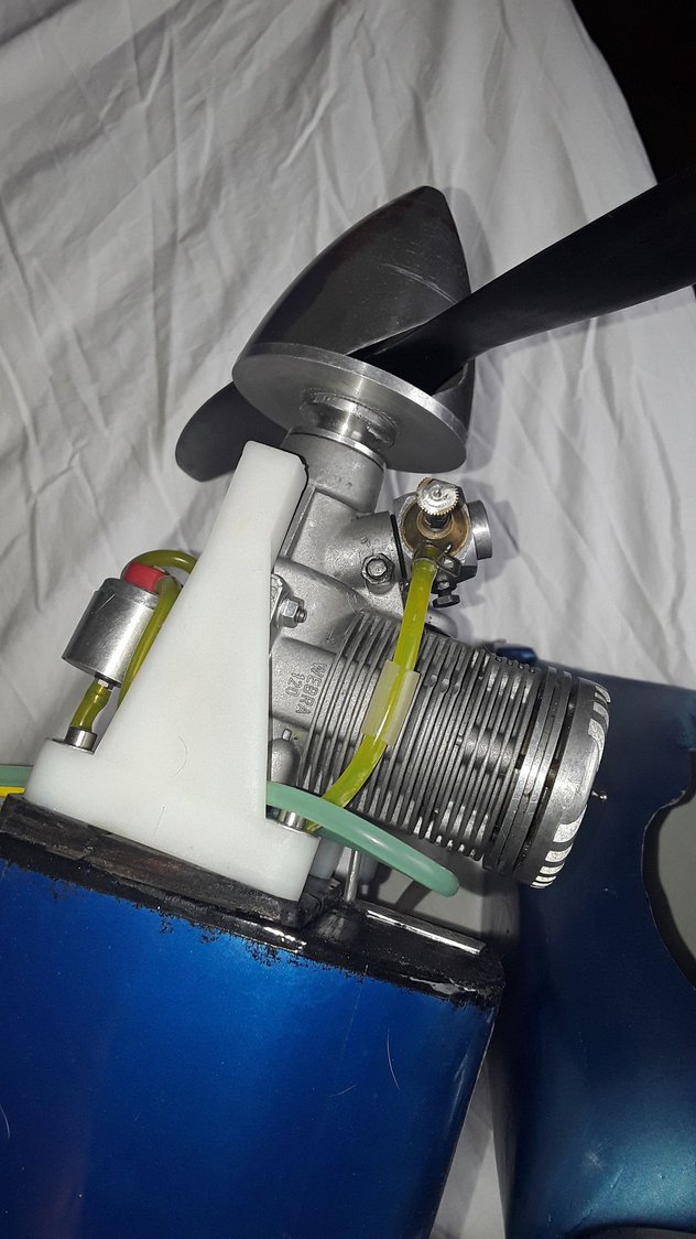

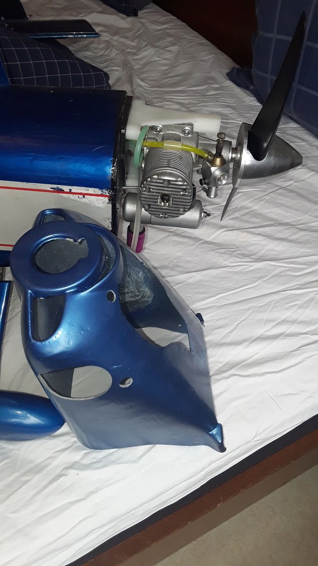

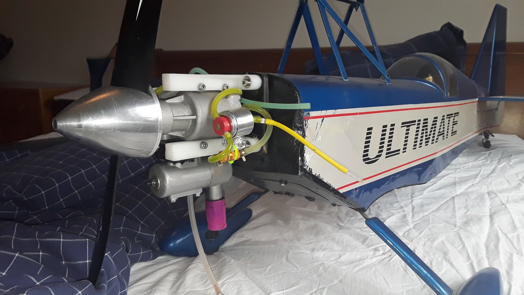

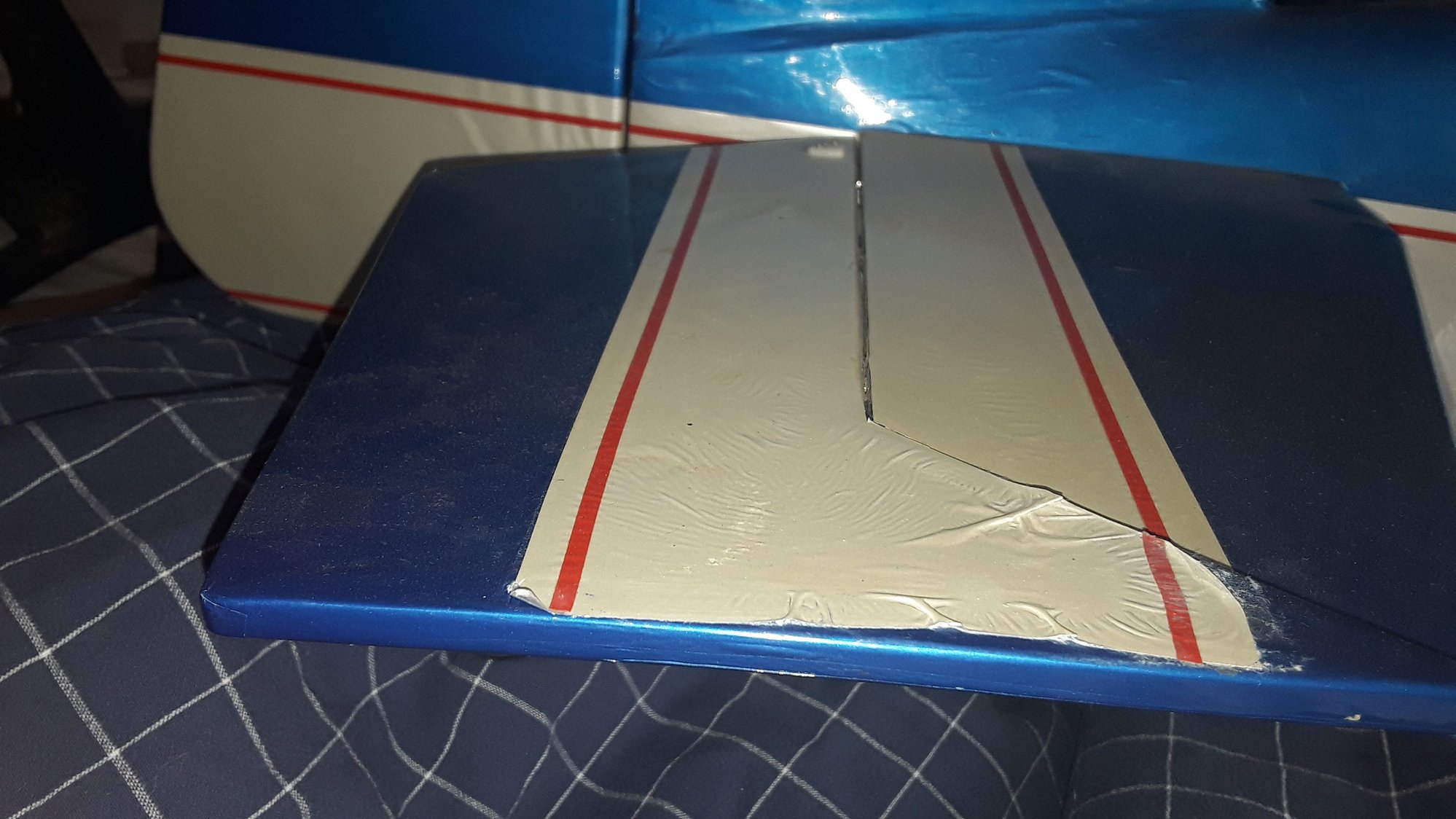

I suppose the thread is not so active anymore.
Here is some pictures of my Ultimate for your consideration.
When I have confirmed the flying characteristics and are happy with it, my plan is to refurbish/ re-cover it
in to another colour, cause the present old covering is not sticking and wrinkles no matter what I do.
The fiberglass cowl is patched several times in the past and is rather heavy. Looks like there have been several different
engines mounted in the past.
Initially I was aiming for my OS91iiP but it turned out heavy as I had to add weight for CG, but with the Webra 120
the CG turned out in the mid-range of the CG span. (I am not sure why its so tail heavy)
I will be happy to receive whatever comments & suggestions you might have. :-)
