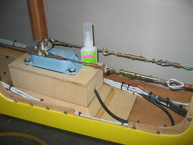

sensei 08-24-2013 08:20 AM
The only good reason to have pull, pull is if you have a tail heavy condition, otherwise servo direct in the tail is the best way to go. If you must go forward with the servo's then you can build or buy a setup that places 0 tension on the servo in a pull, pull setup. This setup comes from a company called SWB manufacturing and sells for $90.00, or as I stated you can build one for just a few bucks if your willing to do the work yourself. 1xtray-1__82722_zoom.jpg
Bob

sensei 08-24-2013 10:44 AM
From an operational standpoint a servo to pro link and pro link to control horn through ball ends is the cats meow, it doesn't get any better then that. For those that need to use pull, pull due to a tail heavy condition, the setup I show is great way to keep the load off the servo's and the cables tight so there is no slop in the system, especially for those that have larger airplanes with long cables and wish to possess a precision feel in flight.
Bob

Gray Beard 08-24-2013 12:53 PM
I have made up a system like Bob has shown and it really is slick and easy to set up. I'm a bit surprised at the $90 bucks for the one shown but it is very clean and positive. Ackerman Ackerman, how did we ever do it before we heard of Ackerman??? The idea is and was to make sure you had equal tension on the pulls without an slack in the line. If done correctly it is very positive without any delay in the rudder control. Getting it set up 100% correct is a pain though. I forgot all about the system Bob showed but wish I would have thought of it before I did the set up on my new plane. Brain farts are happening more and more. I recall a system just like it with springs installed between the linkage so there was no servo shock on landing if you had the tail wheel set up directly on the rudder. So many ways to do something this simple. Karol, what plane are you setting up with a pull/pull?? If room isn't a problem or weight then two servos set up as push pull is also a good way to do it. I haven't done that in ages either but it doesn't get any stronger or or positive then that.
